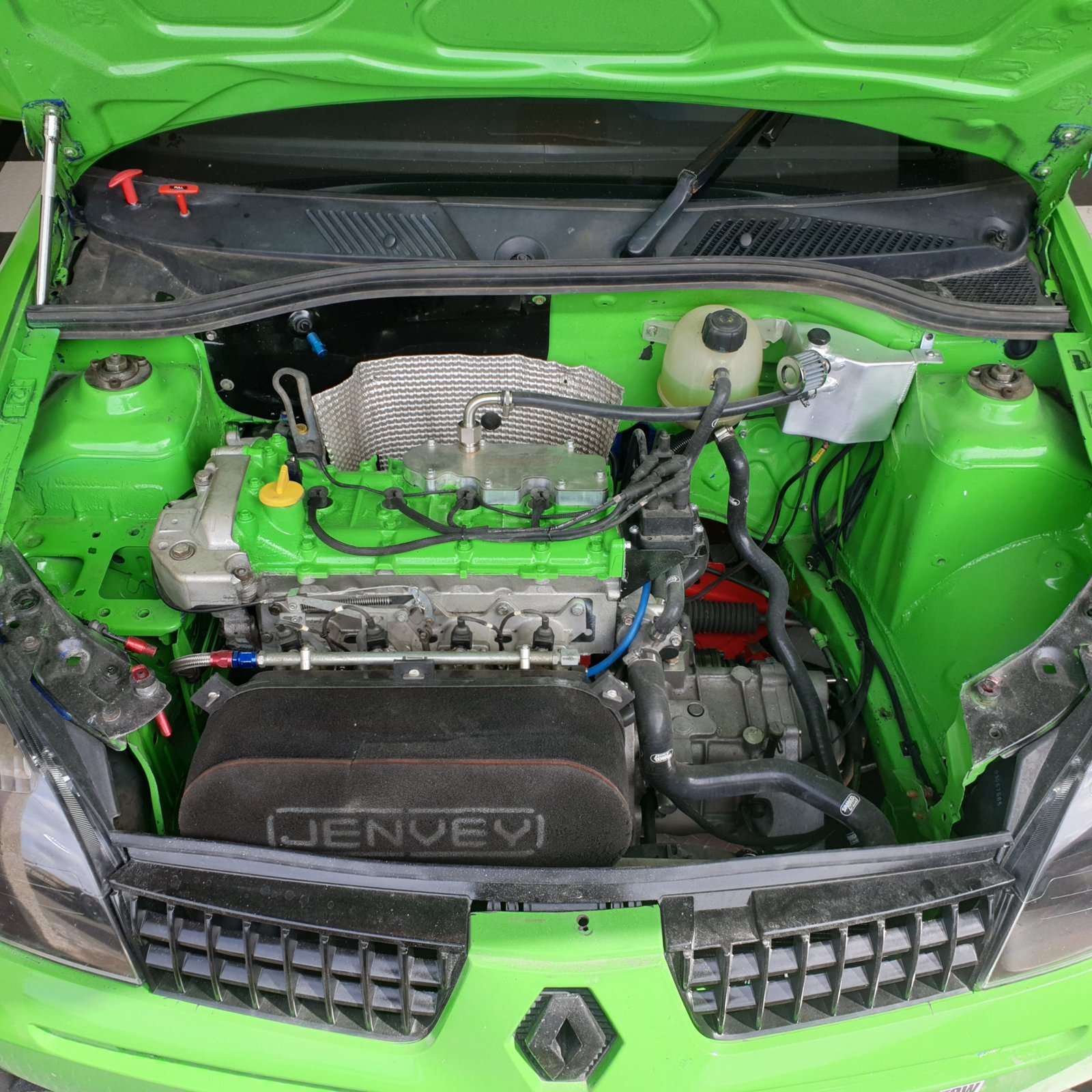

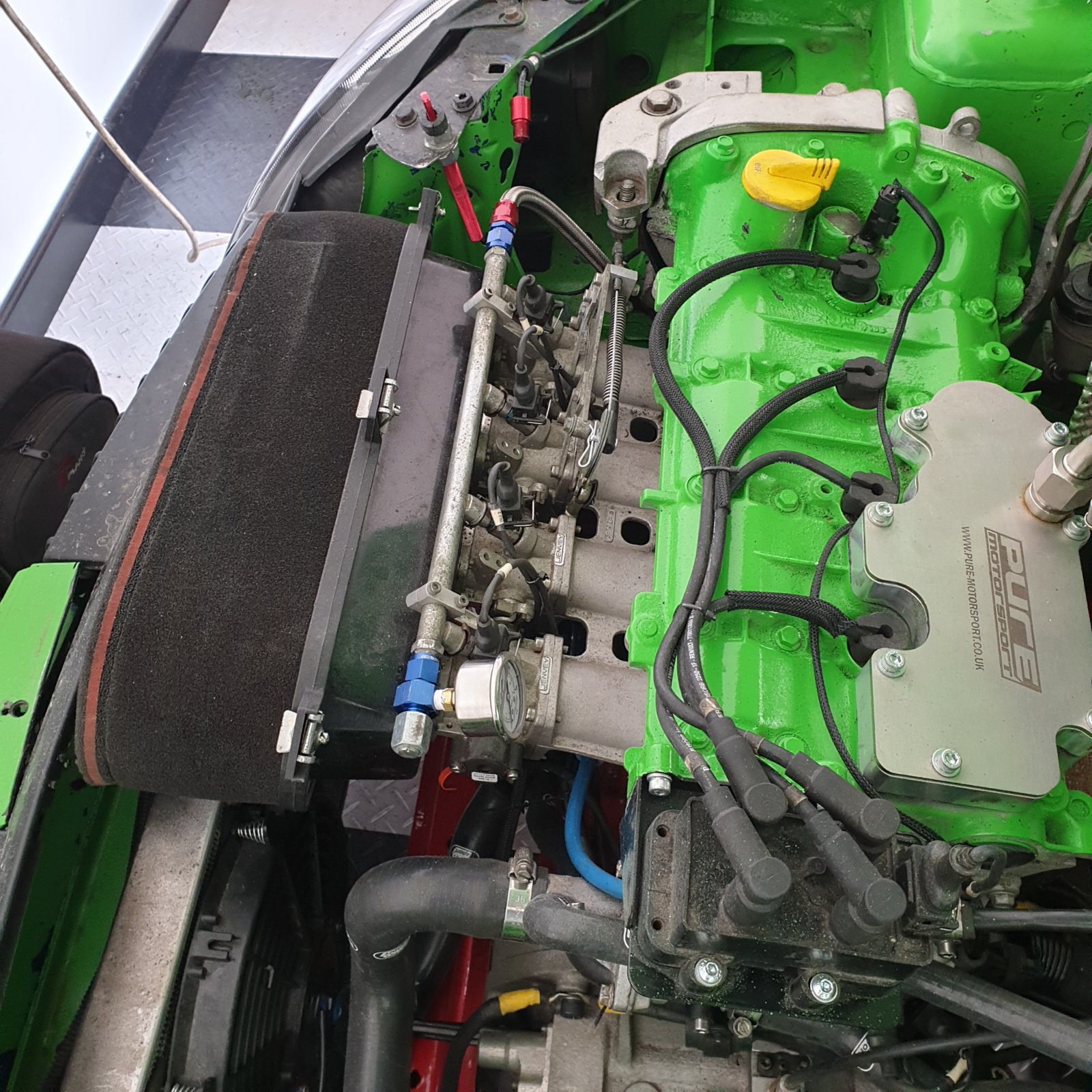

Decided the engine bay needed a bit more colour.
Where are your engine mounts? :)
Already seen how it's mounted. It's purely mounted to the subframe? Is this done for ease of dismantling? I'd say that the original engine and gearbox mounts would be a lot more around the center point of the engine. Now, there is a lot more weight hanging on the dogbone mount. What's your opinion on this?
I would guess it was done on the cup cars to ease engine removal and also clear access for working in the bay. Plus with the sequential box you really need the engine solid mounted
To drop the engine its now probably a 25 min job once the car is in the air.
Yeh it give a good bit more room.
I did think about chopping out the frame work on the inner wing , but decided to keep it so could put a standard engine/box back in if needed.
Yeh it give a good bit more room. I did think about chopping out the frame work on the inner wing , but decided to keep it so could put a standard engine/box back in if needed.
Would be nice to remove it, visually and for access to the engine but I think you have done the right thing for sure, always good to have an easy back up option.

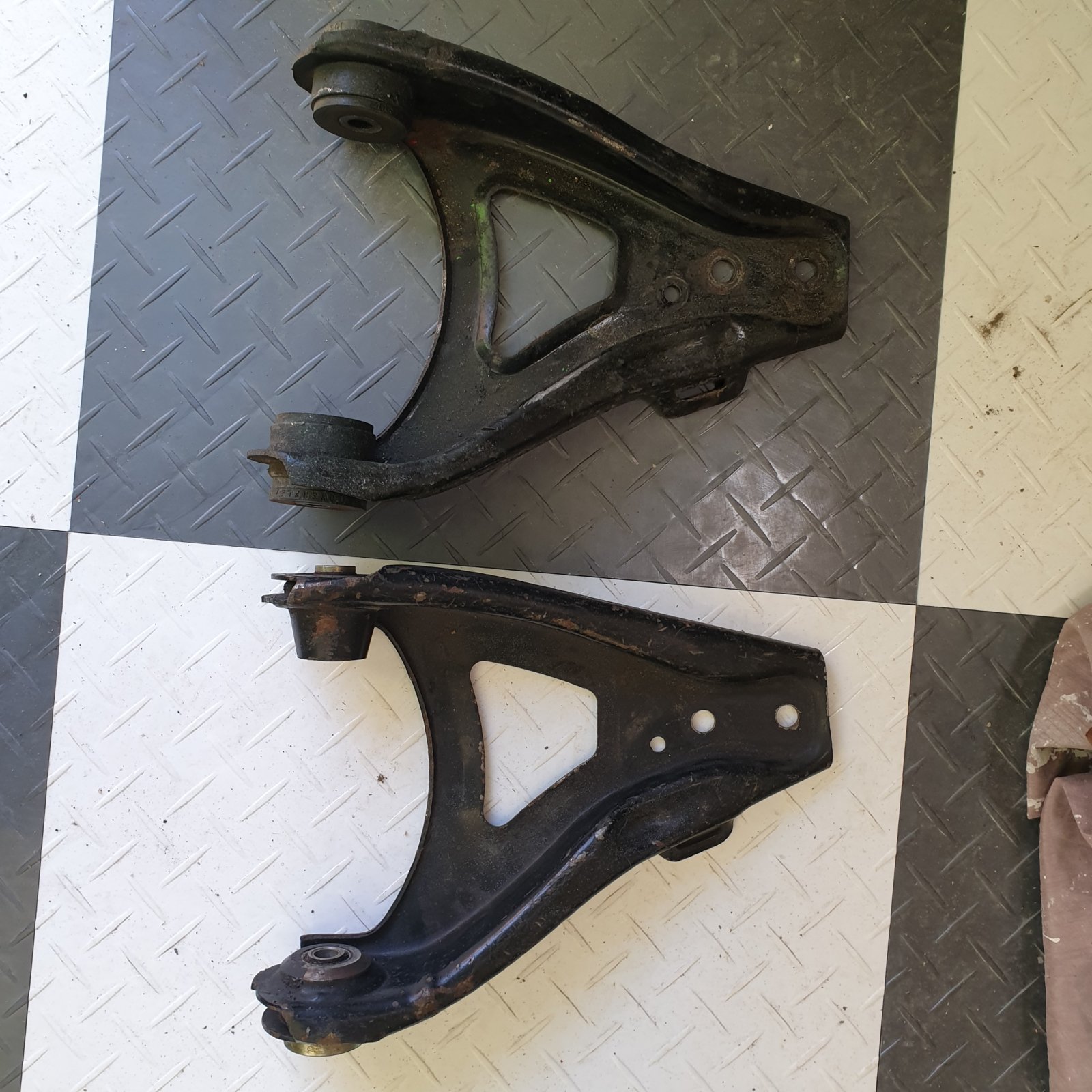

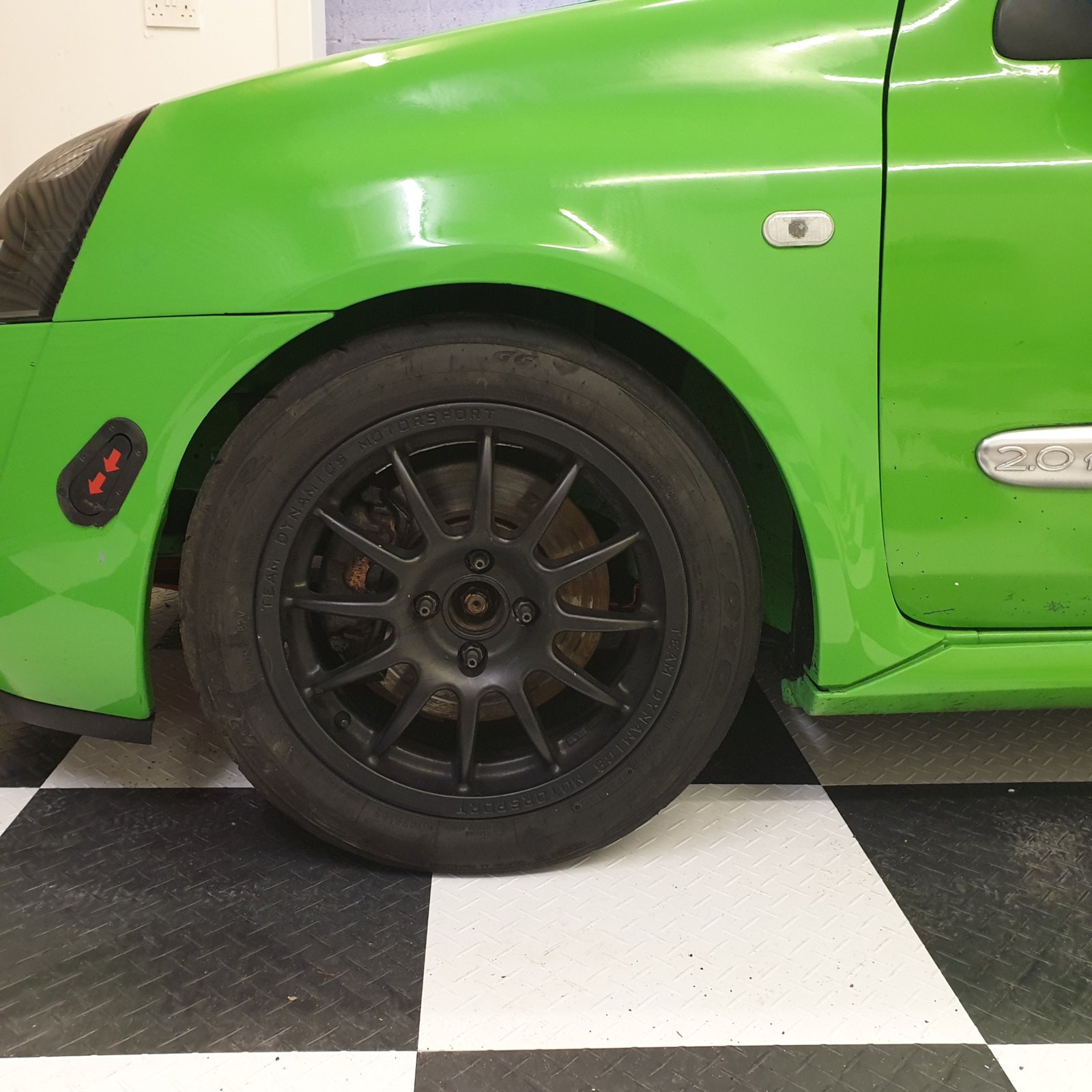

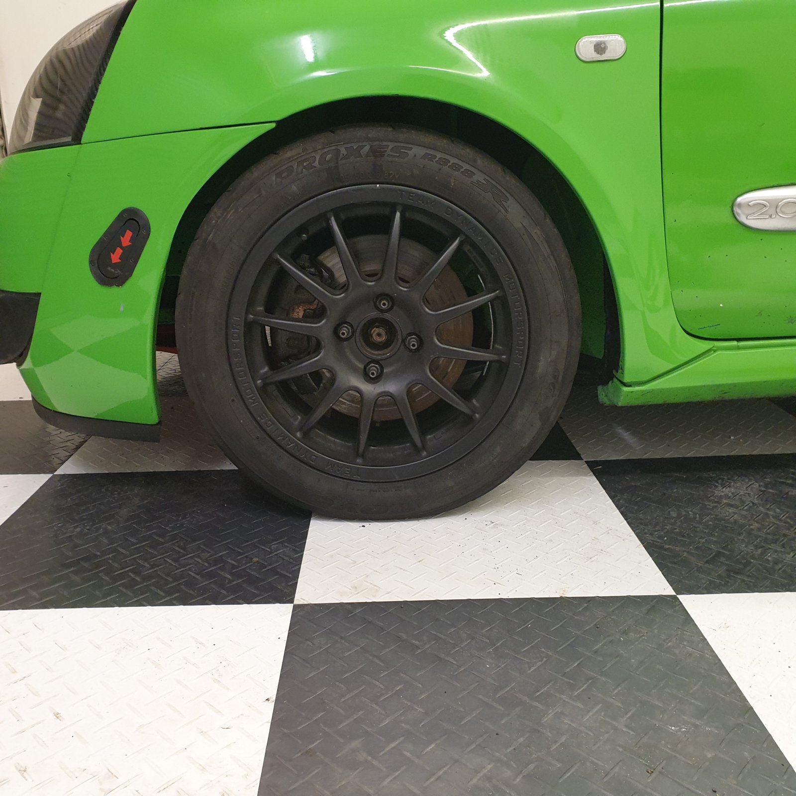

I fitted one of the cup racer lower arms tonight to the passenger side.
Without getting a before and after alignment I wouldn't say there looks to be a big change to the caster over my old polybushed cup bottom arm.
I do think they may be slightly longer though.
Before
After
Looks the same to me. Guess you’ll find out when you get alignment done.

It's not much of a change but the actual bush design is better so will have less play.
Cup top
Cup racer bottom

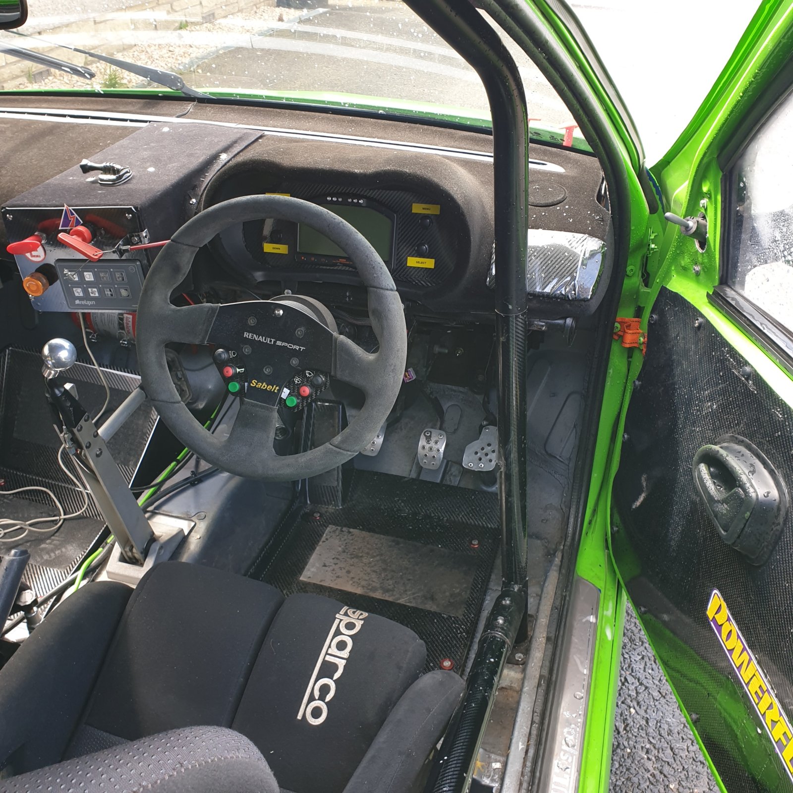

The inside as it sits justnow , but if anyone knows of a lhd dash top. I have a plan for the inside

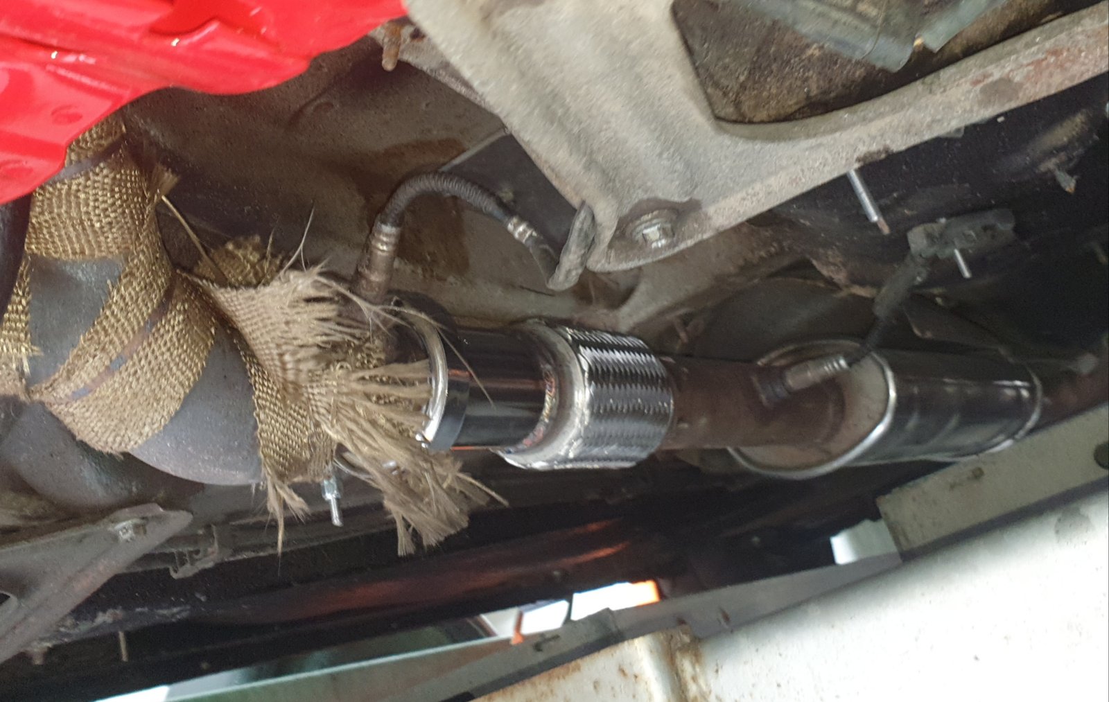

Little more done today with a v band and flexi fitted to the manifold.
Badly need to re do the heat lagging on the bottom section of the manifold. But the exhaust now seals up well and little less vibration in the car.

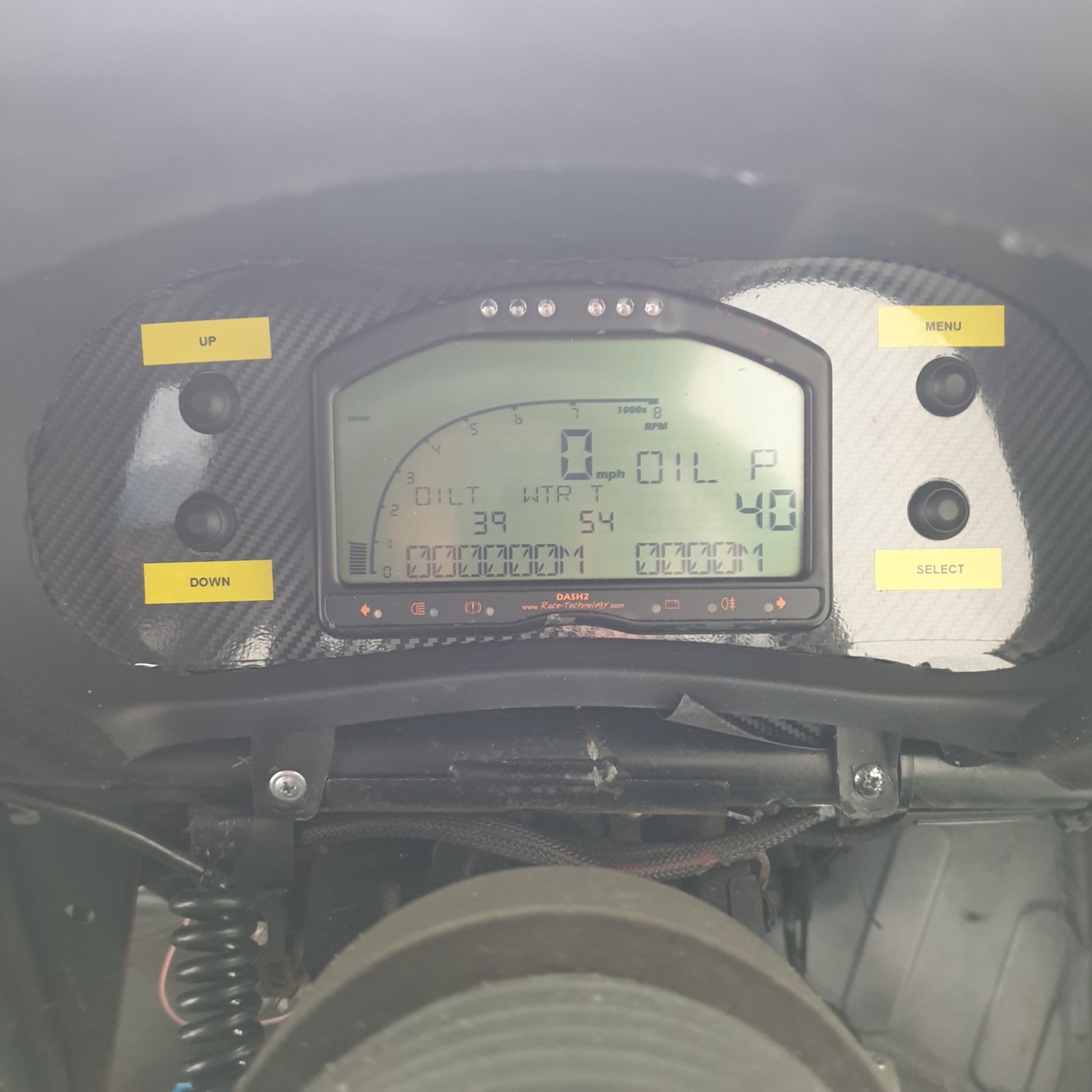

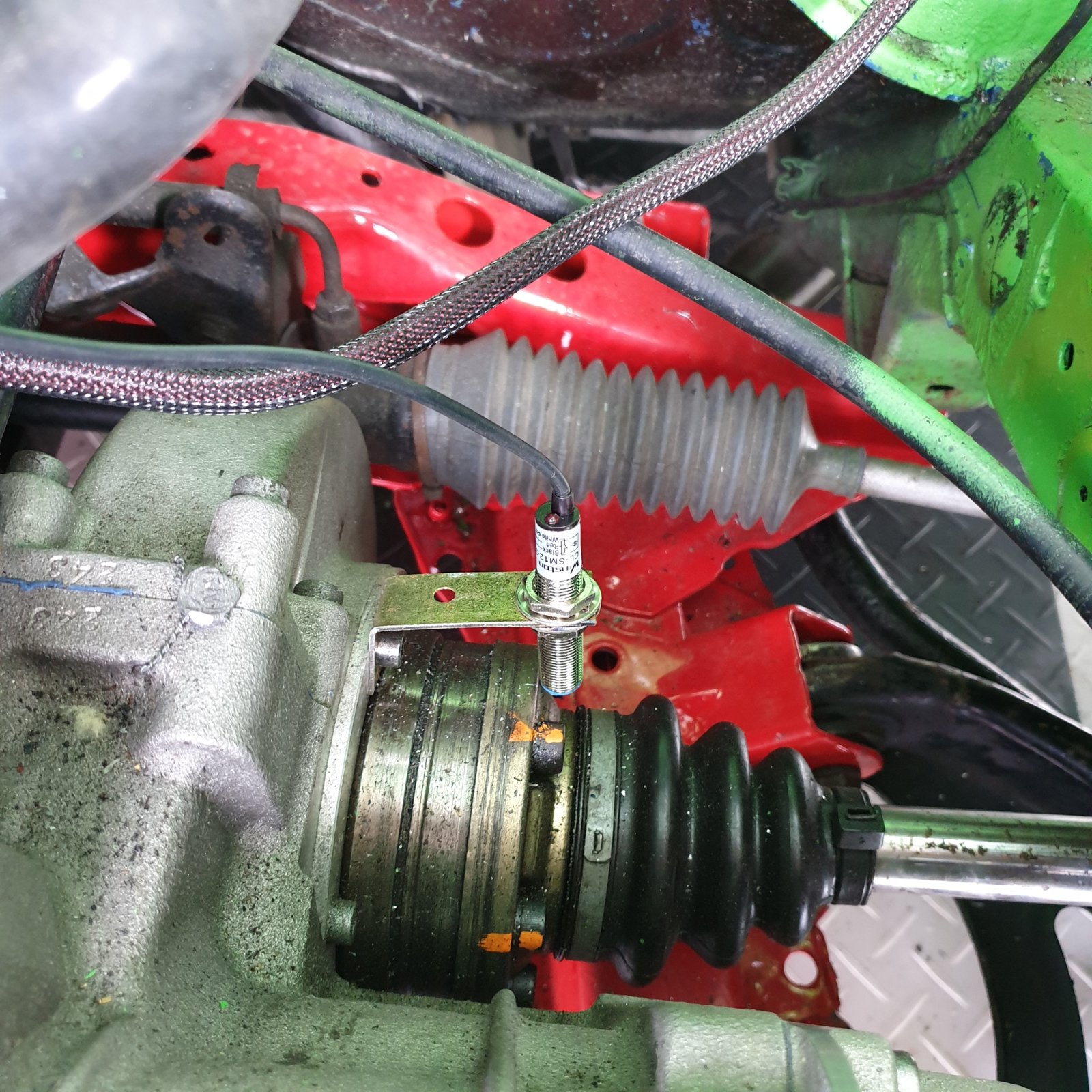

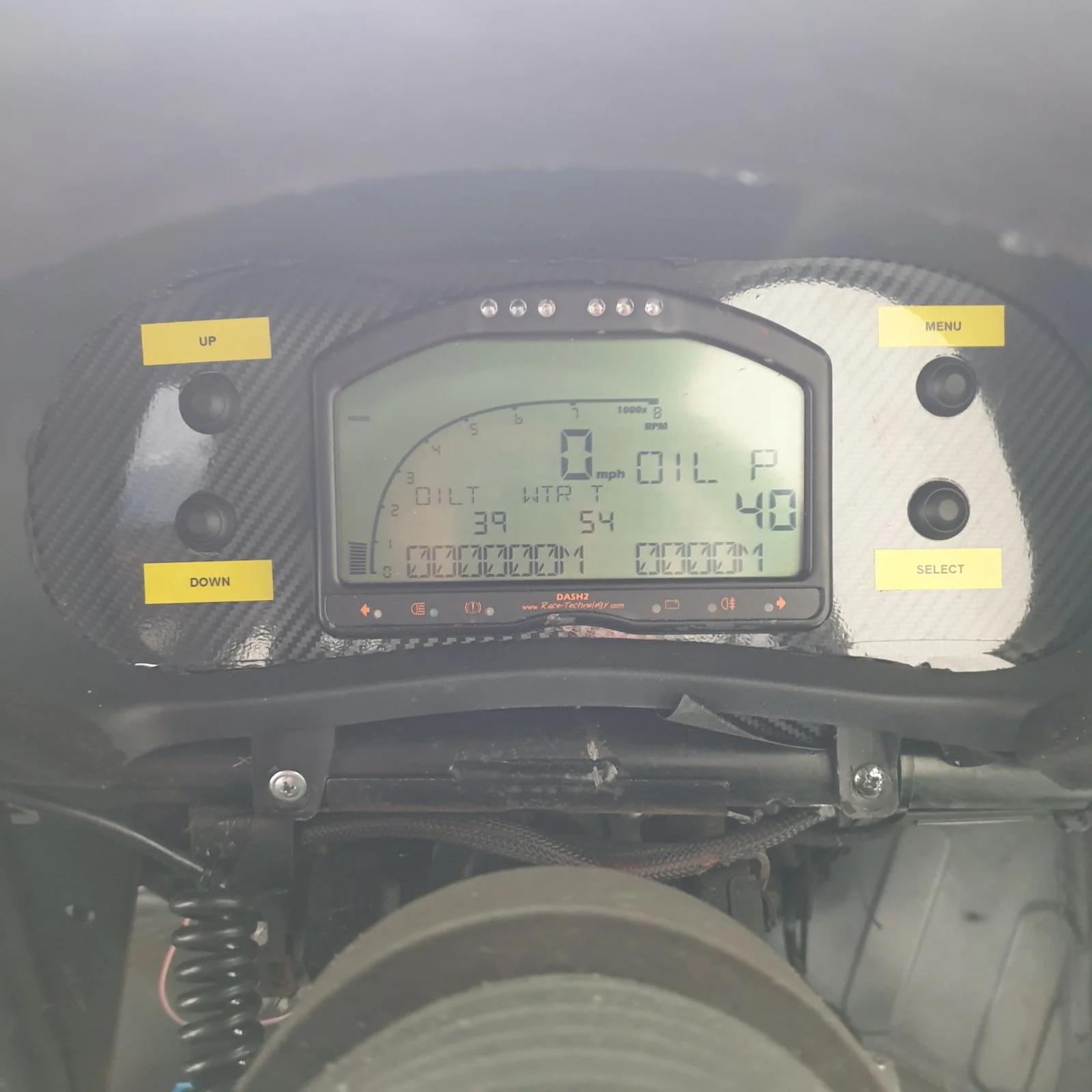

Think that's the car now ready for alignment. Eventually got the dash2 set up with all sensors working and speedo pick up fitted.
I still have to calibrate the fuel sensor but the tank is full justnow.

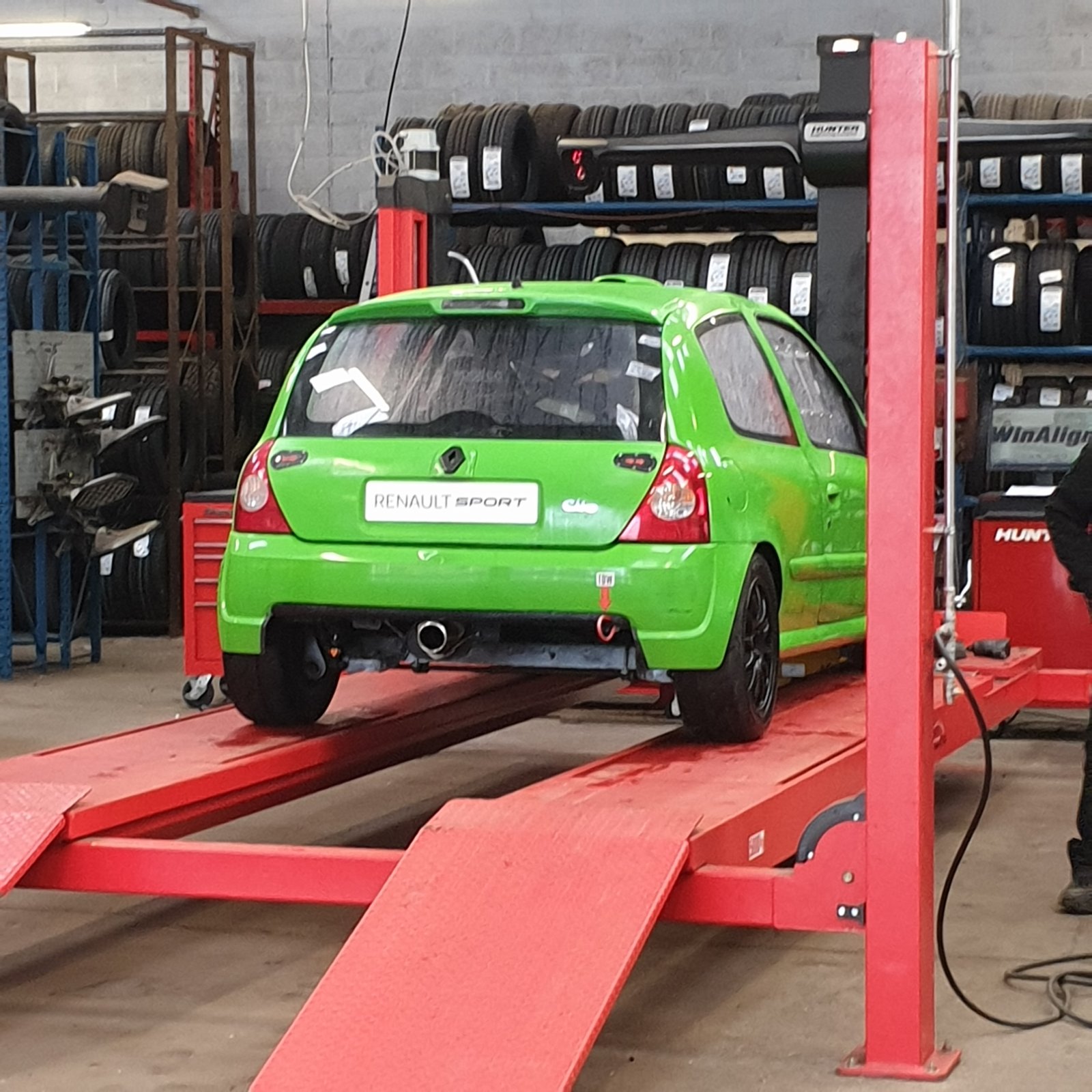

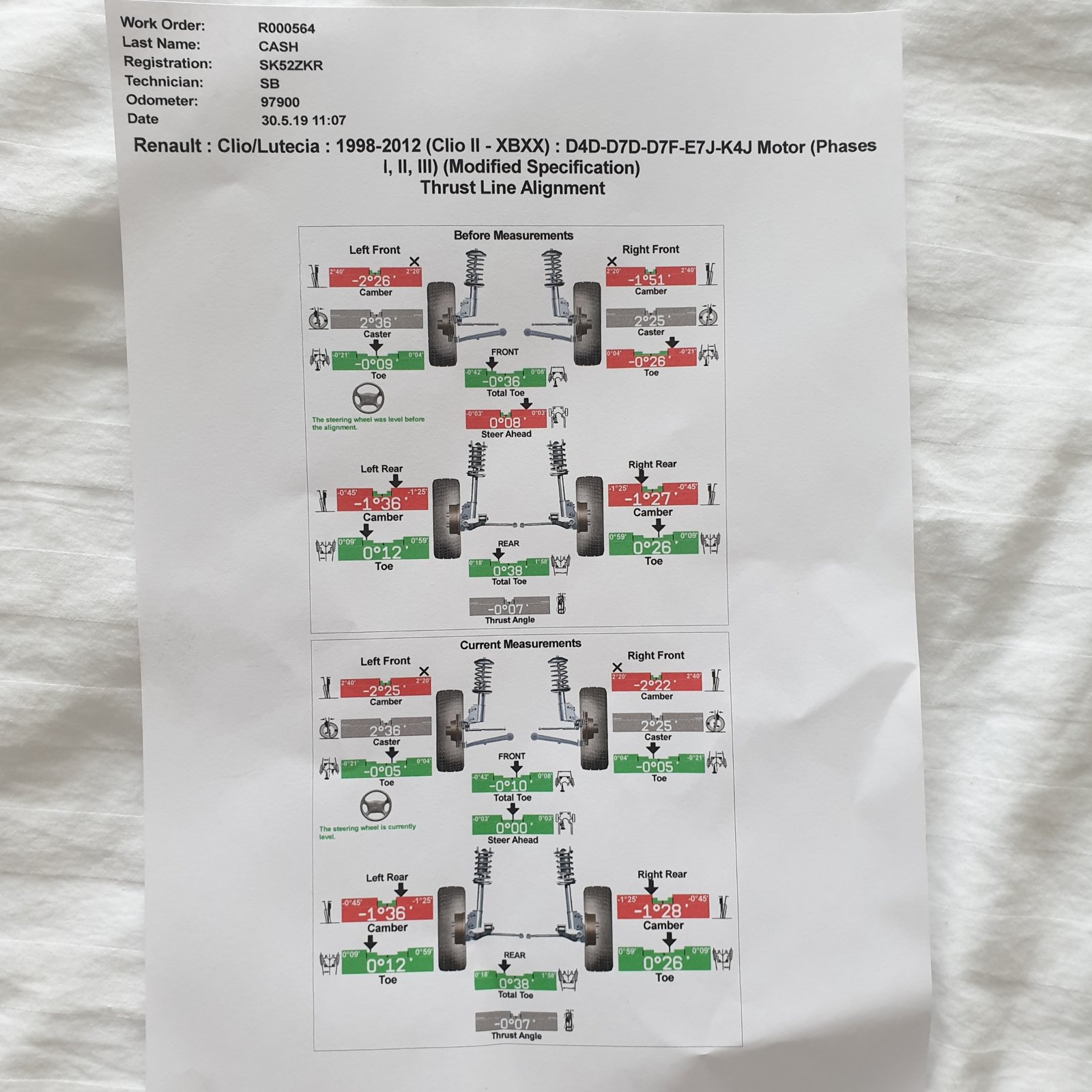

Had the car in for alignment today took it to a local place I've used in the past with a hunter machine, so haven't had it weighed or corner weighted justnow.
Looks like the cup racer lower arms dont give any more static caster than the regular cup road car ones, they just have a uprated bush design. This is handy as means I can keep my old arms as spares.

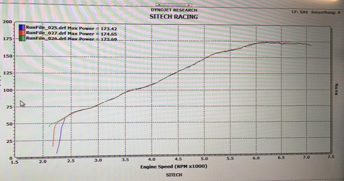

Back on the dyno tomorrow morning to re check the dueling after I balanced the bodies and changed the injectors. This seems to have sorted the hesitation at 2000 rpm.
Well things didnt go to plan today but in a good way I guess.
After changing the injectors to qure the low down stutter , I wanted the map checked. Instantly the AFR was different ,so started to adjust the map and re scale the TPS to give good low down throttle control.
The car was making less power than before but still 175 ATW , but then the full rev range went lean on the second last run. Adjustments were made to the map but it still wasnt as safe as liked to be.

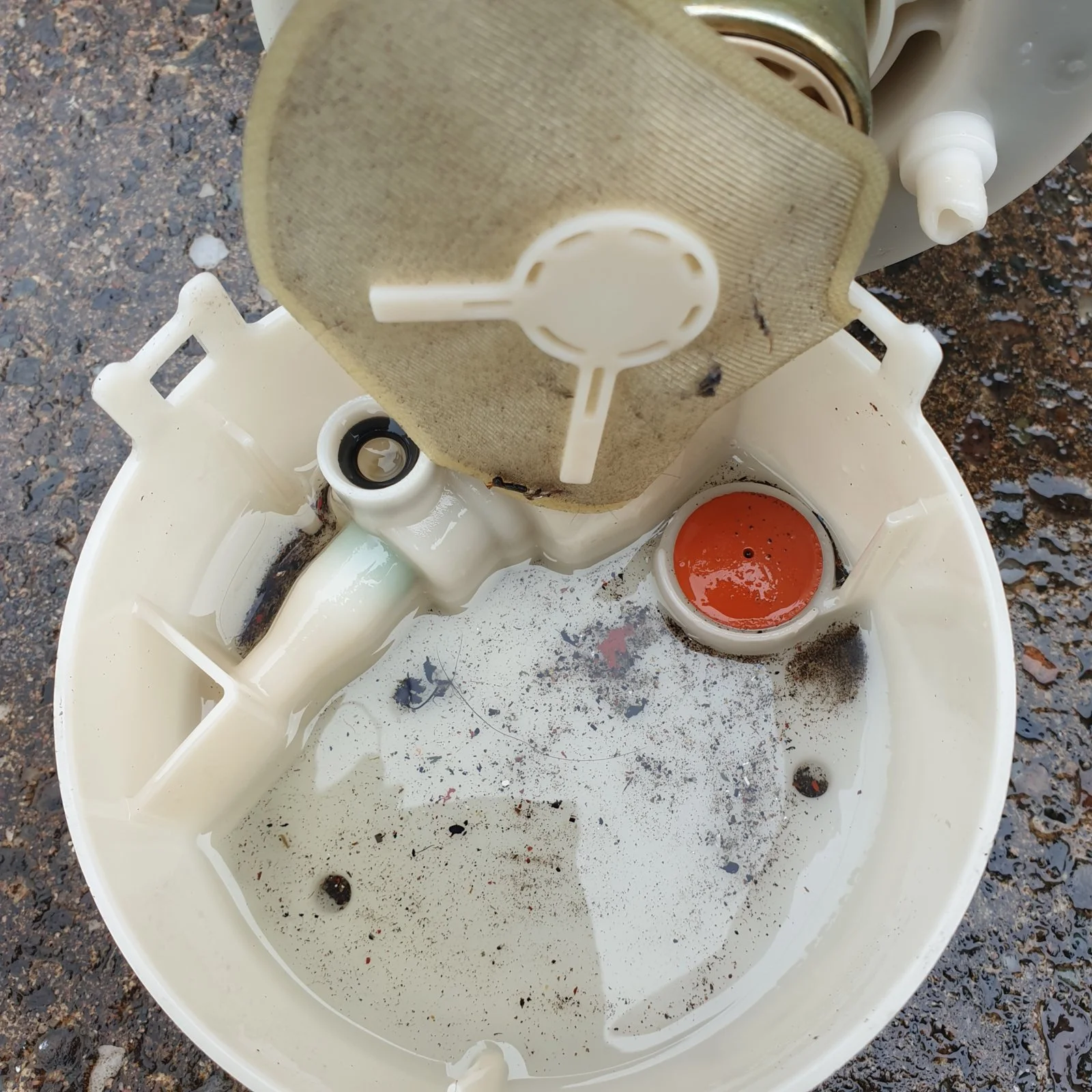

Plan now is to change the pump as it looks to be dying when It gets hot.
I will fit a gauge to the rail , replace the pump and re check it. If the standard injectors are getting too close to max I will fit my larger ones.
Lucky I got it checked or could of easily melted an engine if pushing on track, as it was getting towards the dangerously lean stage.

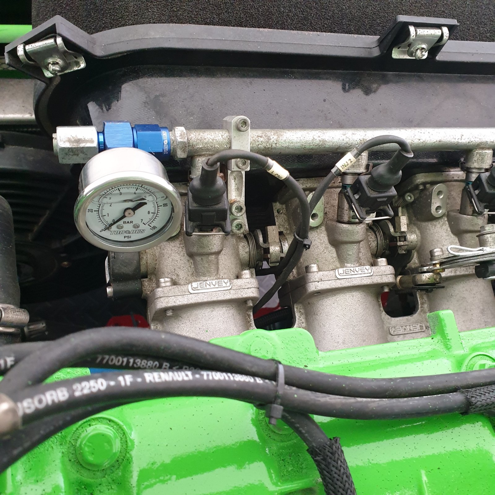

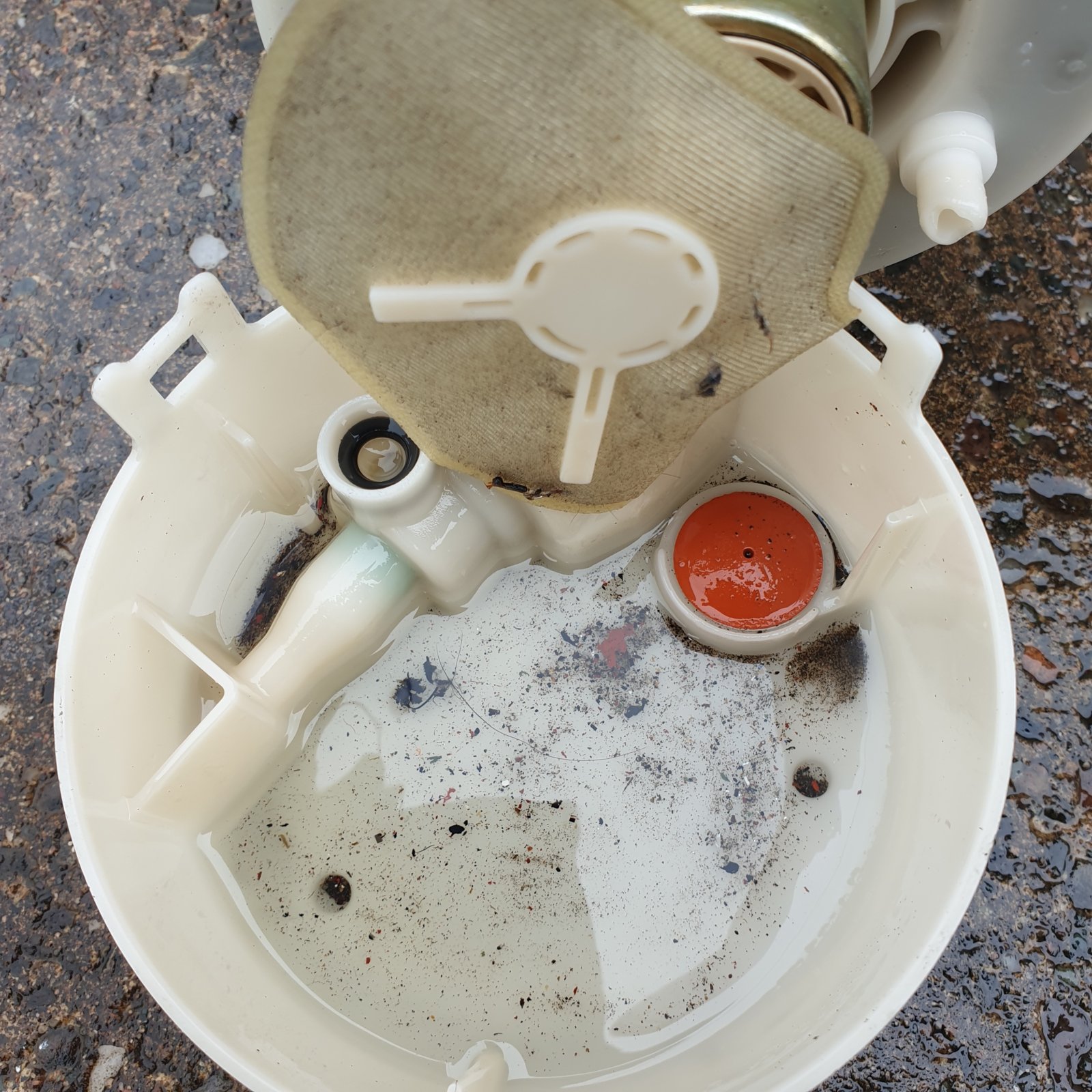

On getting home I pulled the pump and found a fair bit of dirt in the bowl which wouldn't be helping either.
I've fitted a new pump and added a temporary fuel pressure gauge to the end of the rail to monitor pressure while it's on the rollers.
Justnow its showing 3.5 bar and seems steady under light load.

Dropped the car off yesterday to get fueling checked after changing the pump as I'm booked on track on Wed night.
Got a shout from Simon at Sitch this morning to say he ended up fitting my larger injectors and adjusting the map to suit and it was responding well with smooth curve and 173 bhp so will pick it up tomorrow.
That was at the wheels so will be close to 200 at the fly I would think.

My rev counter was working fine , I wired and calibrated the fuel level sensor yesterday so probably just messed something up in the dash 2 file. If i had my laptop with me i could of checked revs from the ecu and messed with the dash.
