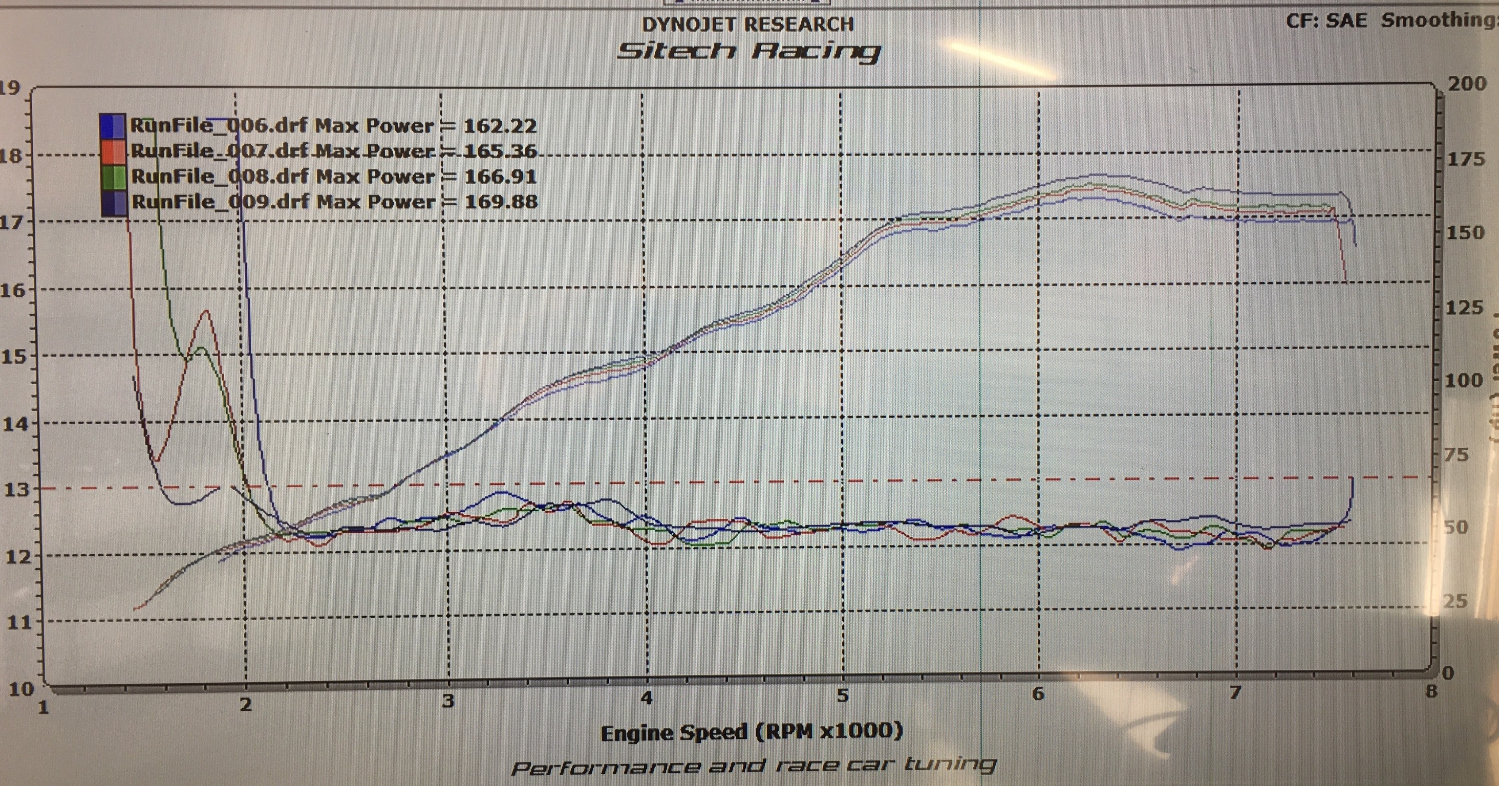

Did my first trackday last week since fitting the engine with group N timing and efi map . I was impressed with the power delivery , and low down torque out of tight corners.

Had another one done, not massive gains but almost hits peak torque at about 2,500rpm. Drops a bit after but then picks back up.

just had this car back in for a 182 exhaust manifold to see what if any difference it makes. hopefully get it up for a run this week.
