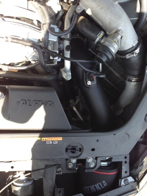

Intake kit and ams coolant tank

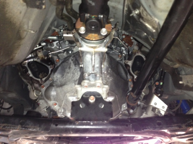

down pipes came off without much hassle ready for new exhaust. :) full non catted system
Was chatting with Iain and we decided to replace the bellhousing with a Litchfield spec one since the new upgraded one by Nissan was failing already.
