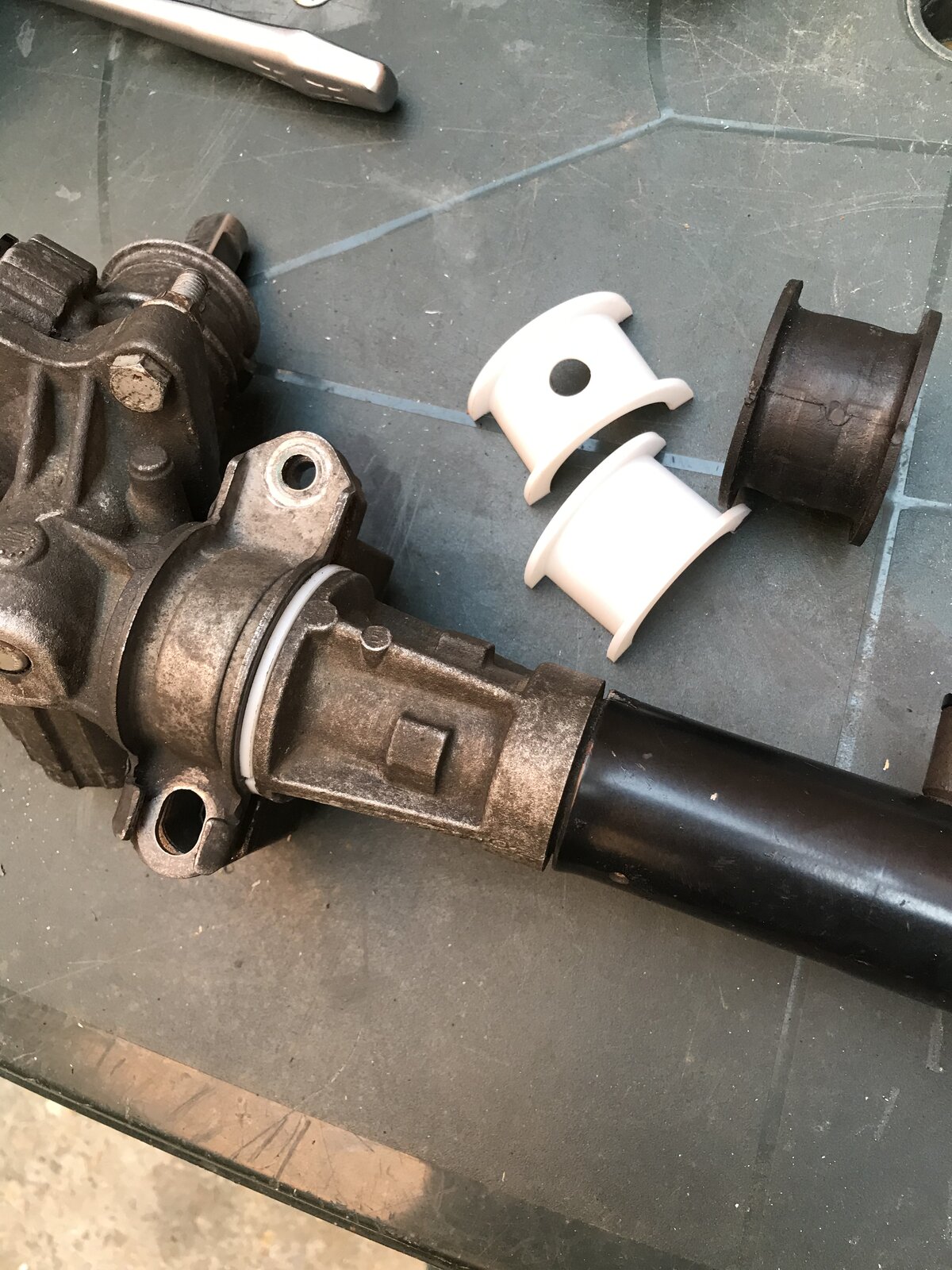

Have you checked:
Wishbone bushes
Bottom ball joints.
Track rod ends inner and outer
Steering rack bushes
Play in the steering column

Have you checked:
Wishbone bushes
Bottom ball joints.
Sent from my SM-G977B using Tapatalk
I've checked them visually and seen nothing alarming, it does clunk occasionally on the drivers side front. But the bushes all look OK when had it on a ramp earlier
