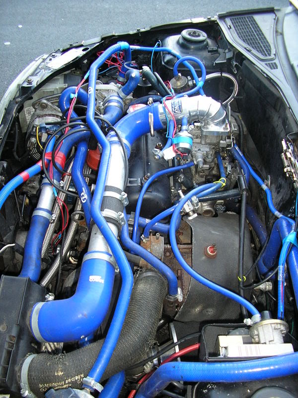

I've slung a few of these in to Clio's and Twingo's in the past - Easy enough conversion to carry out on the Clio I using Renault 19/5 mounts and the required wiring work is basic to say the least.
I wouldn't say its a terrible engine providing the boost isn't stupidly high and the coolant system is very healthy but that said they're not without faults. My Gordini Turbo was a proper mare to change certain bits on but to be fair the orientation is different so you won't have any of those problems. Thankfully they're stupidly easy to work on anI'veve even been seen straighteninpush-rodsds at the kerb side with a brick before at Northampton Motorsport.
Would deffo make an interesting and reliable Clio with say an easachievableable, genuine 170bhp up front.

They are fantastic little engines, its all about getting the fuelling right to match the boost. A wideband lamba and afr meter are a must and very easy to tune by yourself, any help you need give me a shout if you need advice on tuning regarding setting up of the carb etc.

I dropped a C1J into a 19 16V Chamade for a laugh, stripped the interior out and fitted buckets, 180bhp an 180ft/lbs
Had a track based R5 with the same power, very reliable, gave a lot of cars including a Megane 225 a run for their money at FCS at Rockingham a few years ago. IIRC i took Mick out in it.
Easy, cheap power, as long as fuelling and cooling are sorted it will run all day every day.
fueling is the key to these engines, in the R5GTTs hay day in the early to mid 90s companys such as Gt tuning, turbo pacs, k-tec etc..sold the most ridiculous engine mods to customers who wanted to increase power
Group A carbs with bored out venturis, bleed valves, adjustable boost kits that came with huge 150 main carb jets, cheaply built alloy intercoolers...etc all these contributed to killing hundreds of engines

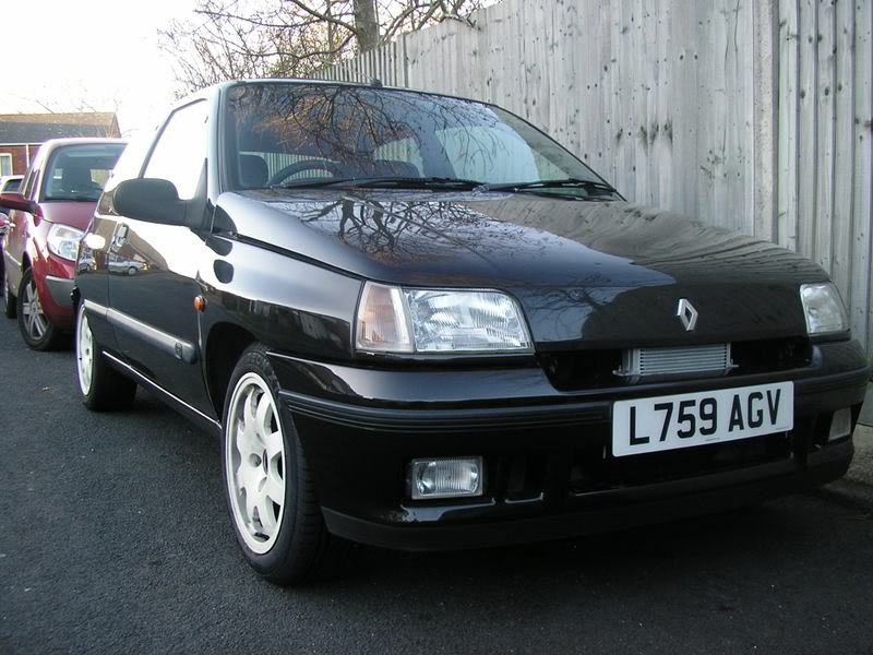

i had one in my old clio....one of the funniest cars i ever had and always made me smile at the traffic lights
