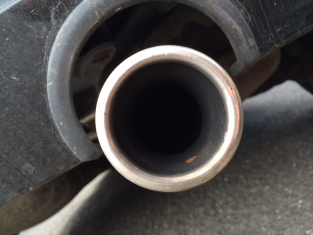

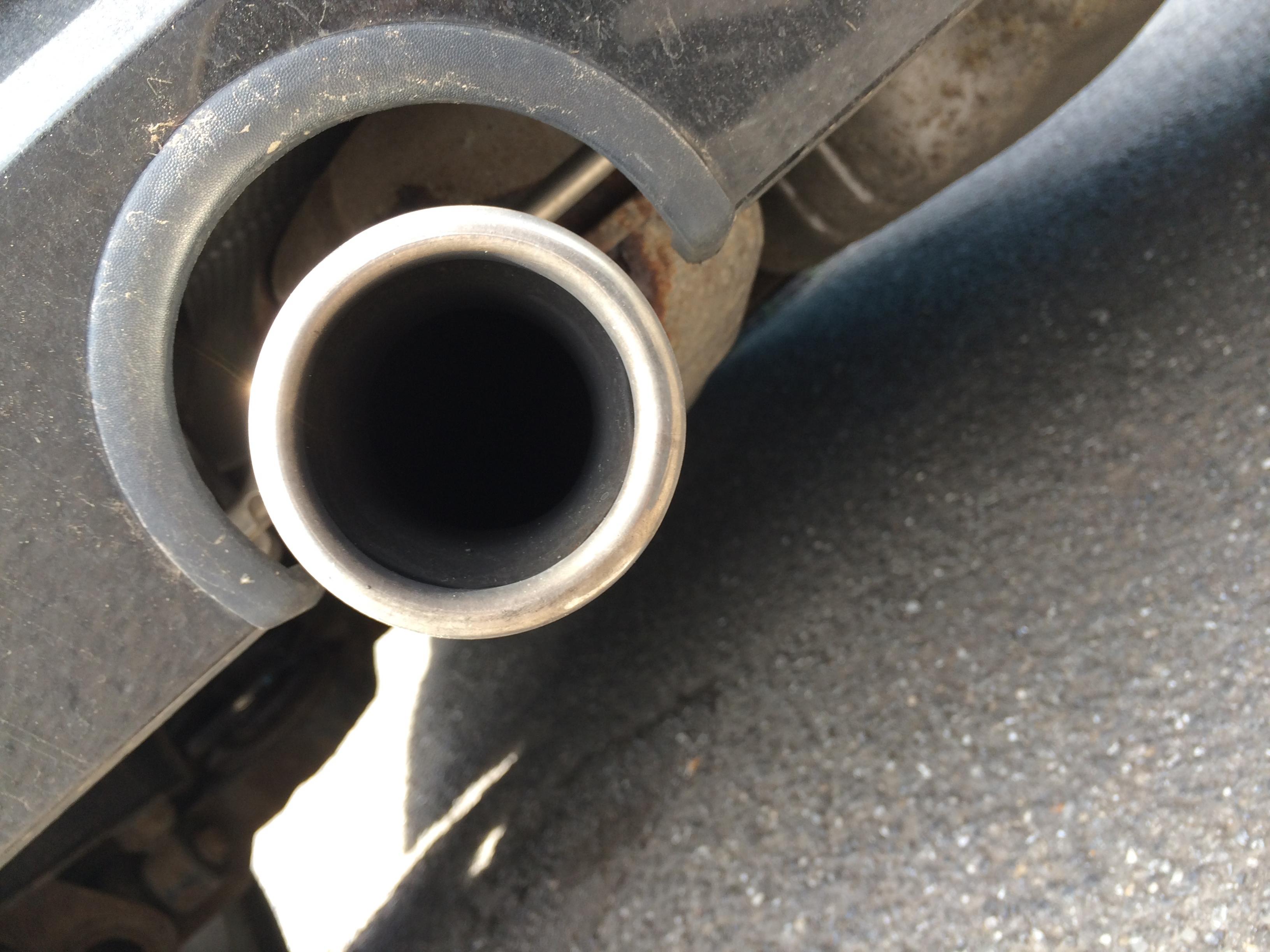

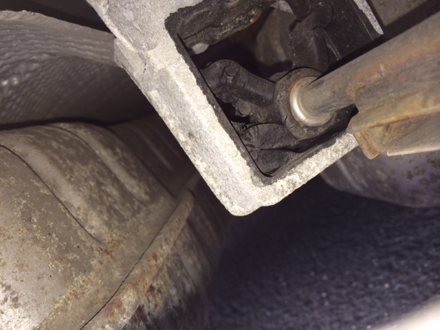

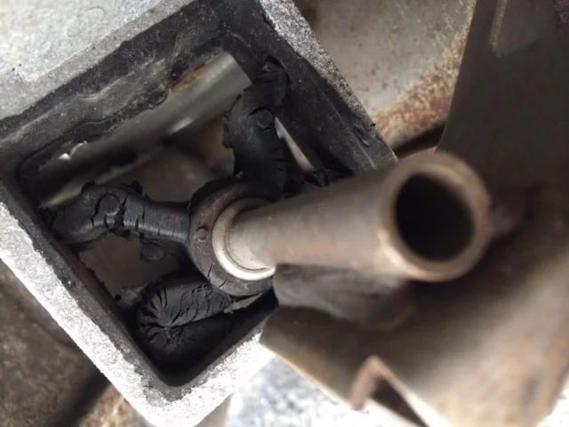

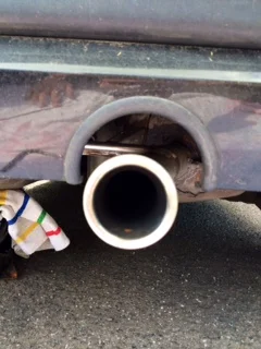

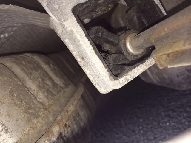

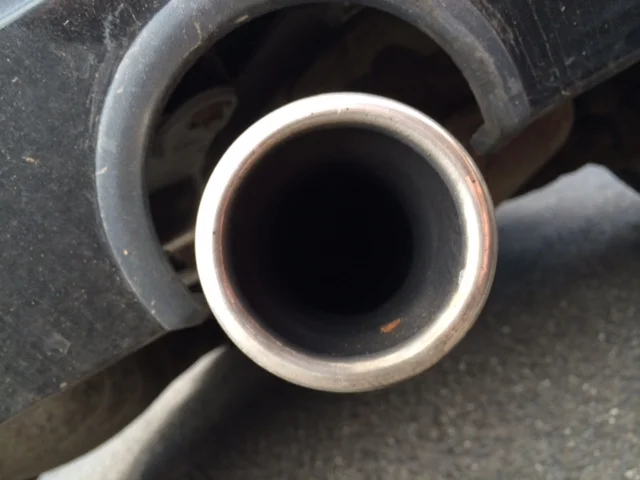

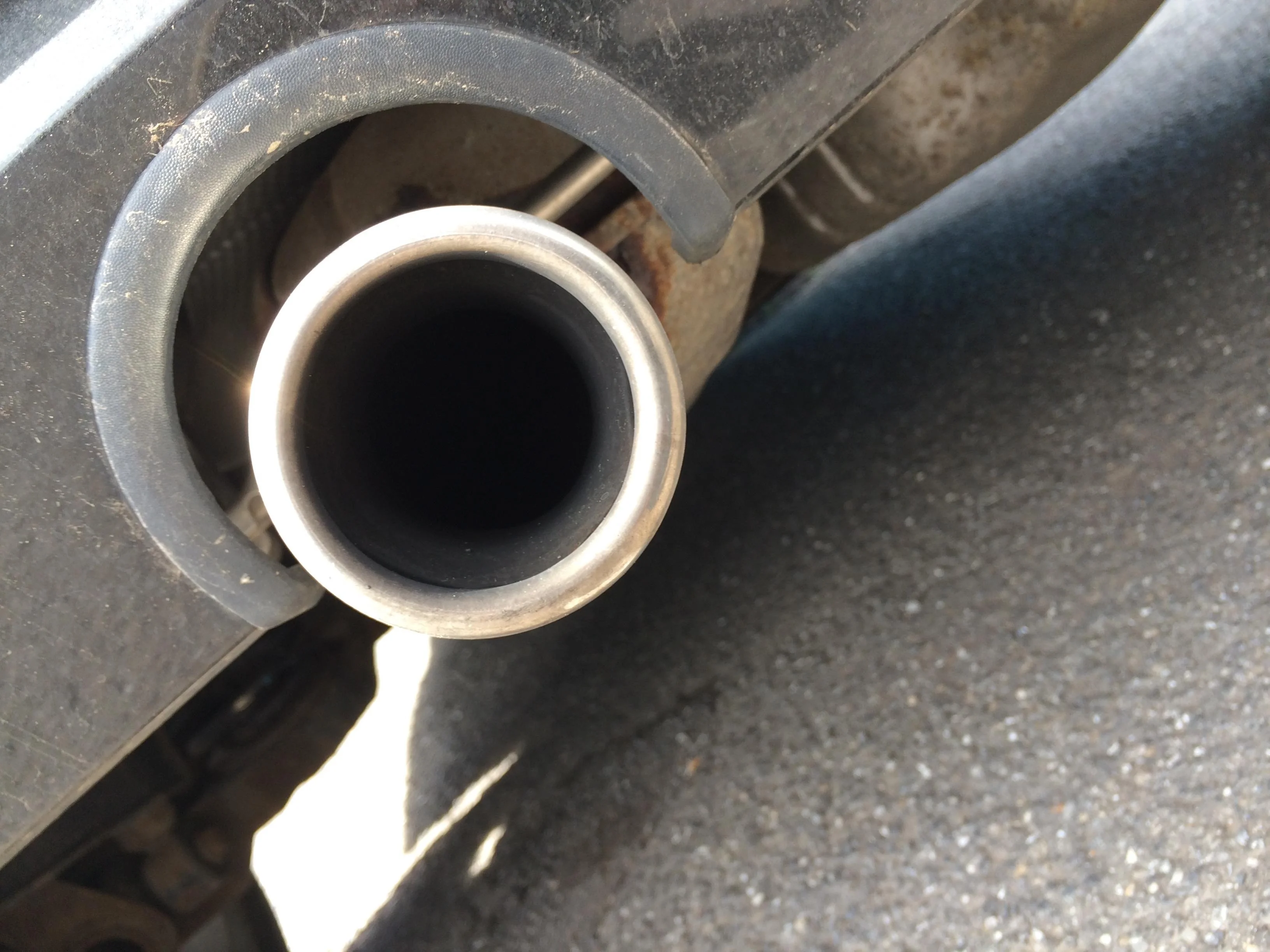

Got my 182 back in January. Initially seemed fine however I have run into a few problems since. It has required a new alternator, battery, brake pipes, front spring, caliper and one wheel refurb (my fault.)
The latest issue, however, i noticed when returning from the shops - my exhaust seemed a little low. Upon further inspection the mounts seem under a lot of strain and are folded over at the bottom. Is this right or am i going to be needing a new exhaust and mounting system?

just put the powerflex square poly mounts in the square holders and secure with cable ties. Fit and forget pretty much
  330i. E30 Touring.
This is an option, but tbh I prefer a bit of flex in the exhausts.
Mounts are so cheap and easy to change you could do them yearly without noticing.
  BG 182 FF
Thanks guys hopefully it'll survive a few work trips and I can tackle it next time I have a few days off. Just have to find thread saying how ;)
  BG 182 FF

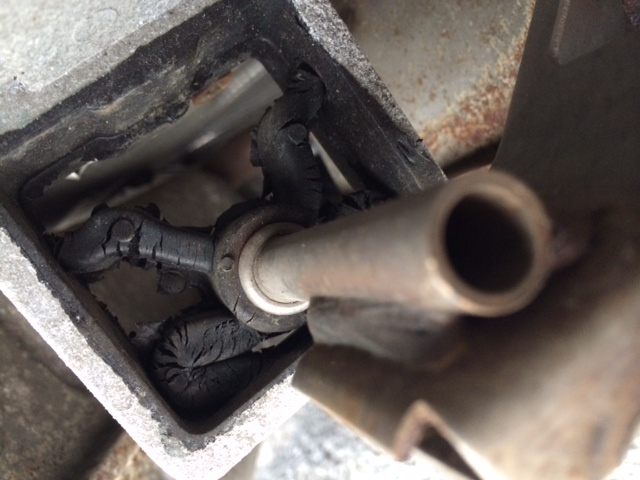

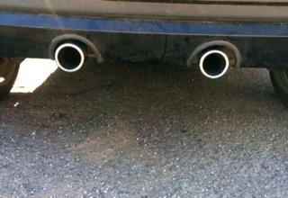

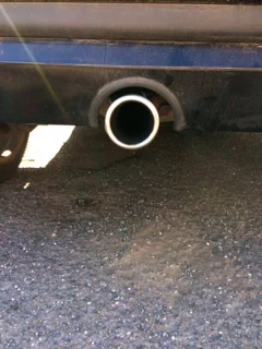

All sorted. Very simple as you said. Also fitted a ratchet socket in the mount to hopefully stop it dropping again. Similar to how James has in the guides.photo_3[1].JPGphoto_2[1].JPGphoto_1[1].JPG
