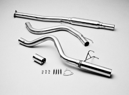

Anyway do you like my exhaust or not? Genuinely not sure if you're on my side or the other guys.

How come it is so loud? Is it Simply a pipe and nothing else?

Pretty much just a pipe. There is a silencer but I don't think it's doing much - no backbox as such just a silencer/bung you can choose to have in the tailpipe.
