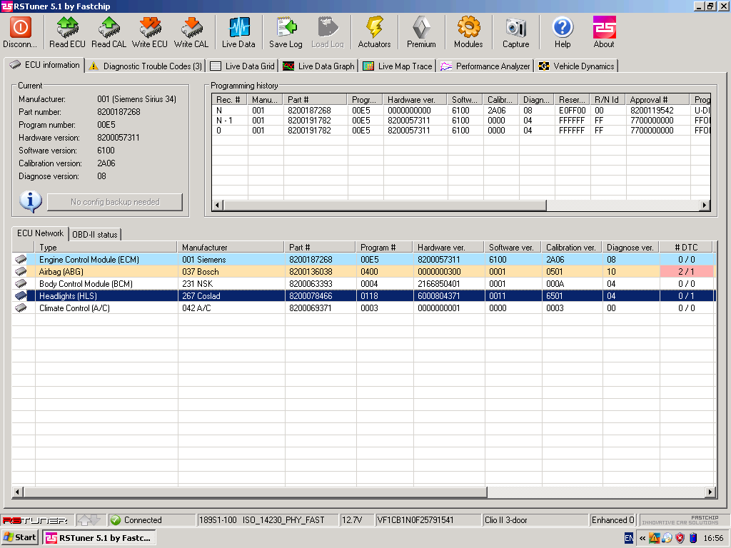

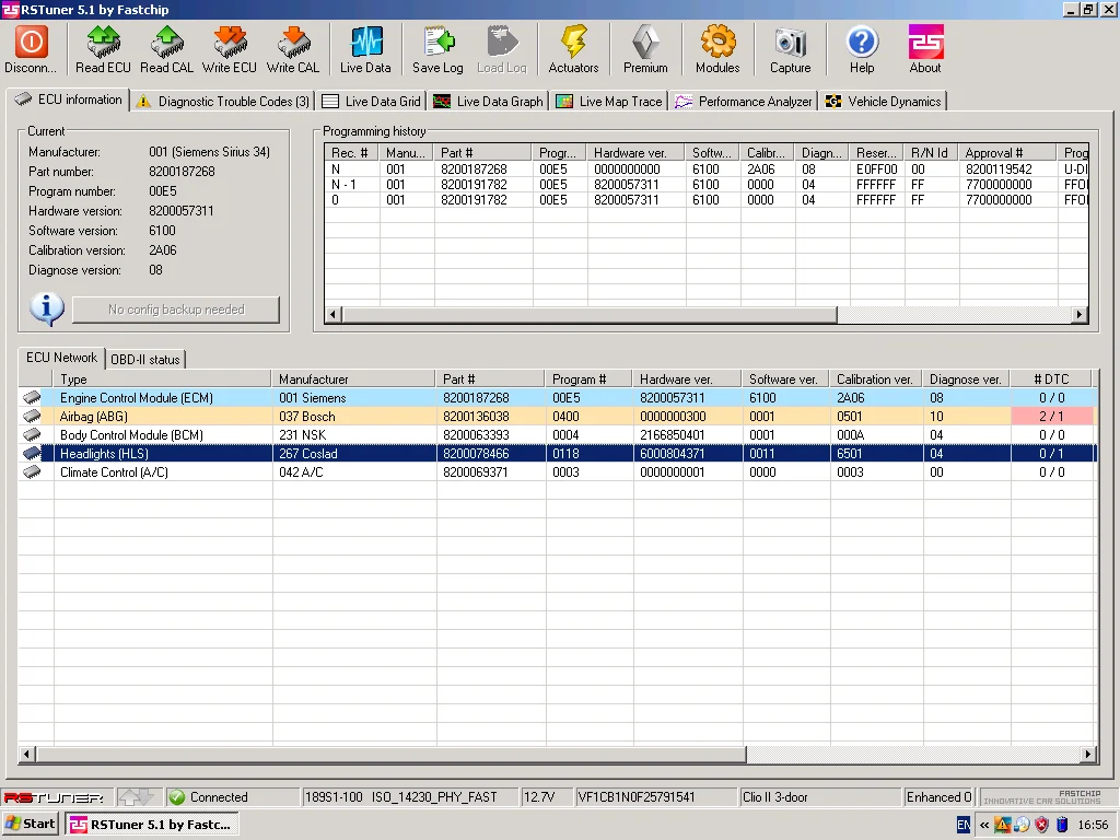

Having acquired a RS Tuner box I duly connected it and found no fault codes other than one for the airbag (Its currently not connected). Presumably if I had an issue with the UCH in regards to the headlamp washers then RS Tuner would bring it up? I have attached (hopefully) a screen print of RS Tuner below.
