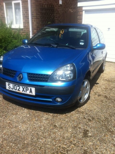

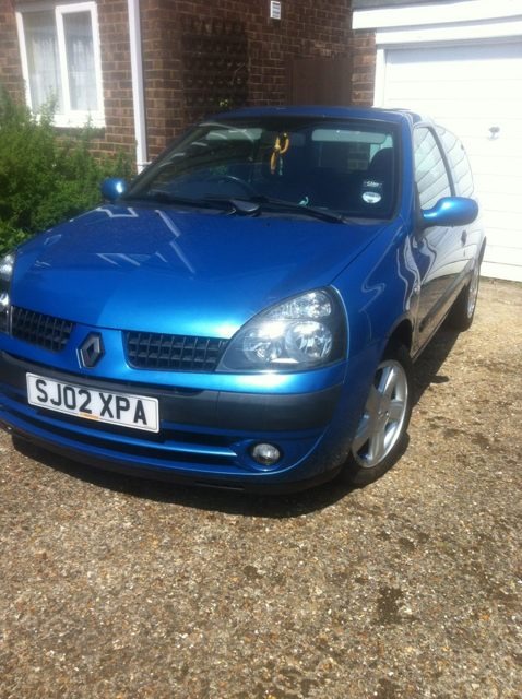

I did 1200-1500-2000 then used scratch x and super polish resin. Allot of elbow grease and water ImageUploadedByTapatalk1371332975.356869.jpg
