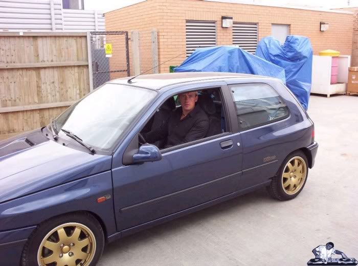

What do you drive now, is it really your mums Williams or is that a myth too?
Just as a williams will stop faster than a 172 as it weighs less but has similar levels of grip. Its just simple physics.
We have a Williams and a 172 in our house and have owned Williams Clio's since 2002. The 172 brakes are miles better, not even close.
