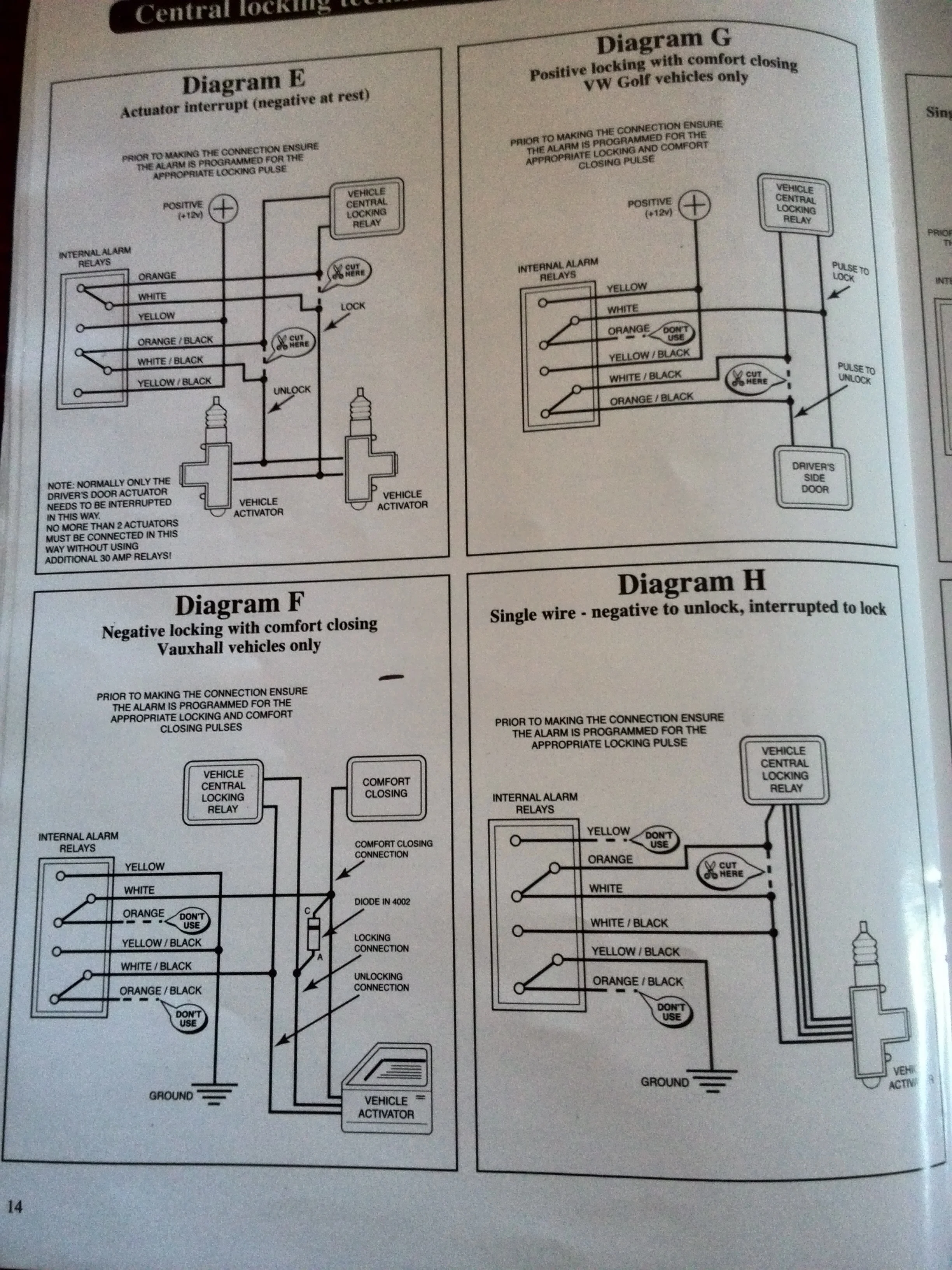

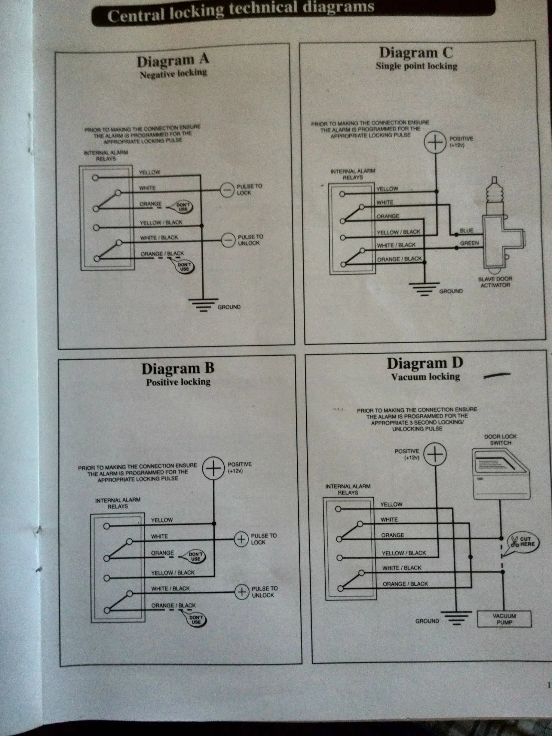

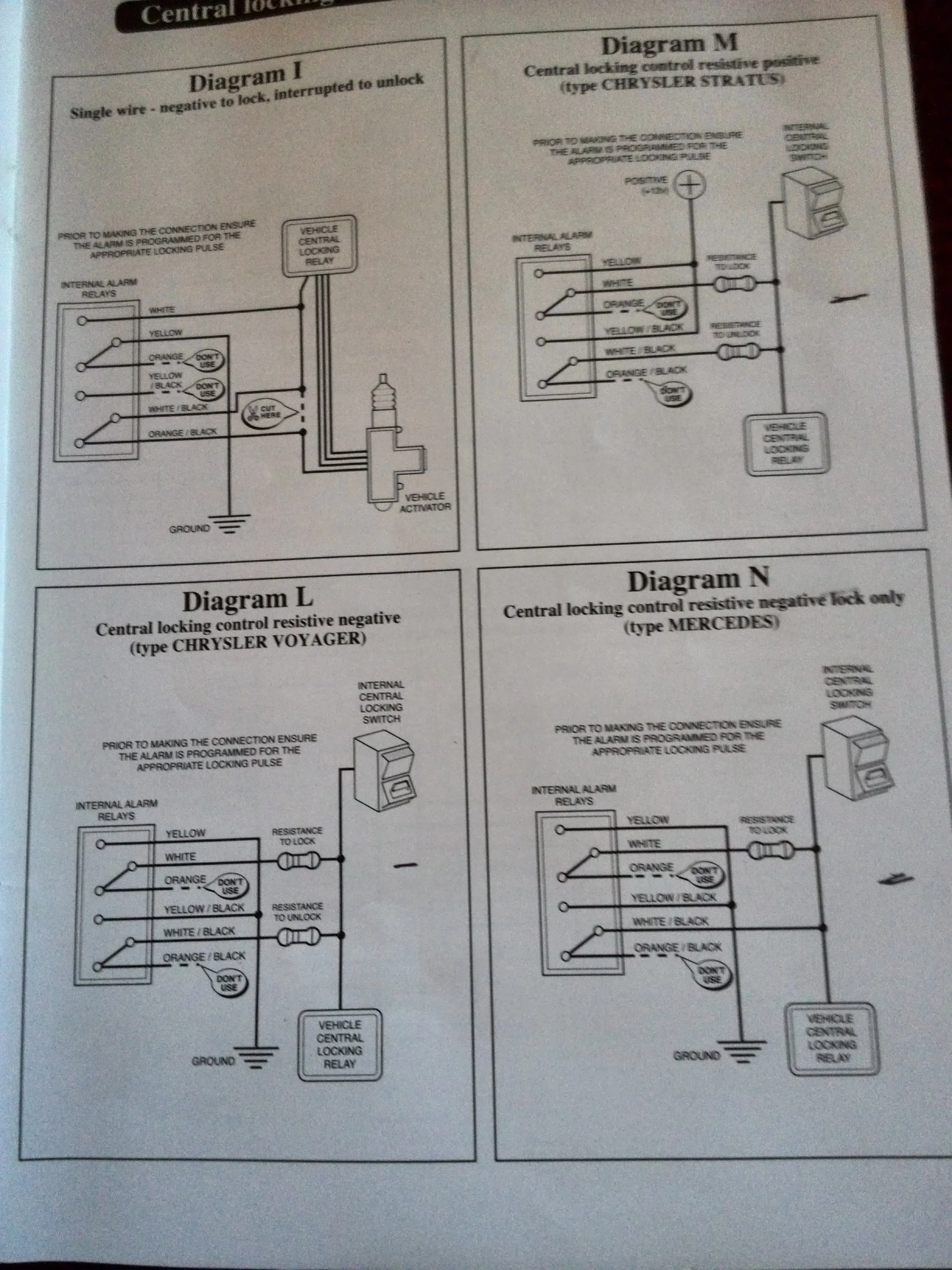

Hi,
im trying to replace my old car alarm (aint going as smooth as i thought :)) and i was hopeing if anyone can tell me witch central locking diagram clio 2 uses? ( pls refer to pictures)
regards,
J.Helm
hi jay
motor interrupt
lock - green wire (pin a4) in black 18 pin plug near fuse box
unlock - white wire (pin a6) same plug
