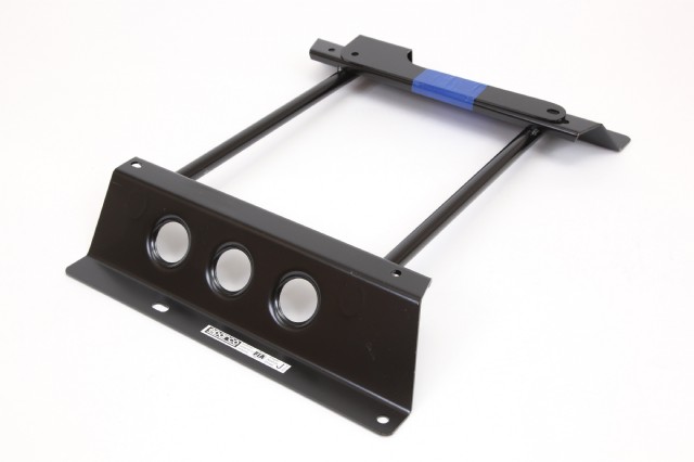

2 x Sparco subframes like this

The subframes line up perfectly with the existing seat holes in the car, however the side mounts are too far apart for them to line up with the top of the subframes once fitted to the seats
I've done a search for Clio Sparco subframes and these have come up :http://www.sportseats4u.co.uk/brand/sparco-seats/sparco-car-specific-fitting-frames/sparco-seats-renault-clio-mk2-direct-fit-sub-frames/prod_1729.html
Presumably the subframes i have aren't the right ones ? And the ones above are actually what i needed ?

The subframes you linked to will probably be the same as the ones you already have, the photo is a stock photo, most definitely not a clio subframe.

sorry to revive the thread but i have just got my subframe which is the exact one shown in the picture (not the link), and was just wondering if these sit flat when installed unlike the omp ones? and also how do you mount the extra piece with the eye bolt hole? as it looks like it will be in front of the lap strap hole instead of behind it? (probably obvious when i get my arse in the garage and try and fit it)
  Track 172, Focus RS
for anyone thats bothered, i also had the same problem as the op. Im sending it back to ktec and they are sending me out the omp one that i originally ordered
