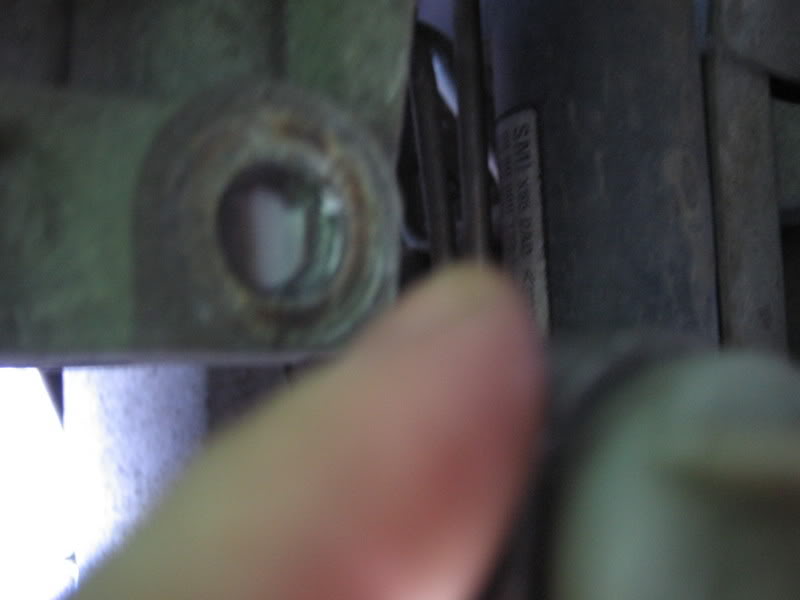

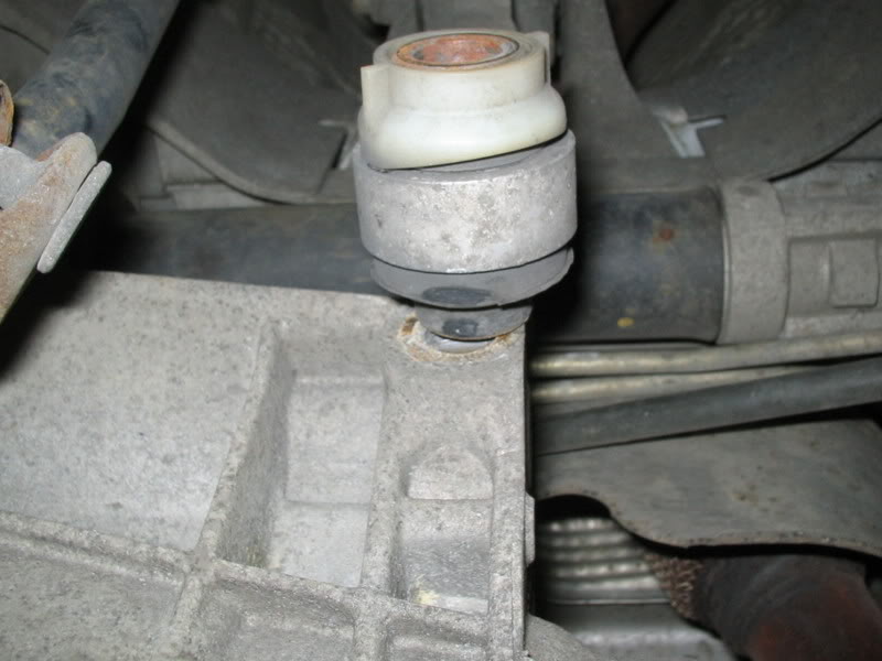

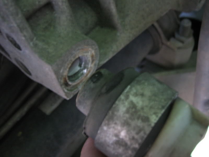

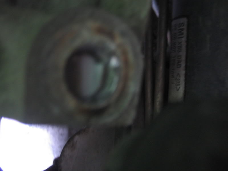

hit a pot hole BAM gearstick now laying horizontal and gears work but a b**ch to change.
get home find this!
engine mount bolt under the car has snapped clean off.
as its sunday no garages open. got work at 5am tomorow.
how am i going to get this bolt out? or bodge it together to at least make it till tomorow.
thanks millions.
you can get a modified bracket and dogbone mount that does away with the mounting point on yours that has sheared. Was a commen problem and it was an official renault mod. see your local dealer but if they havent a clue pm me and i'll try to sort the part numbers.
