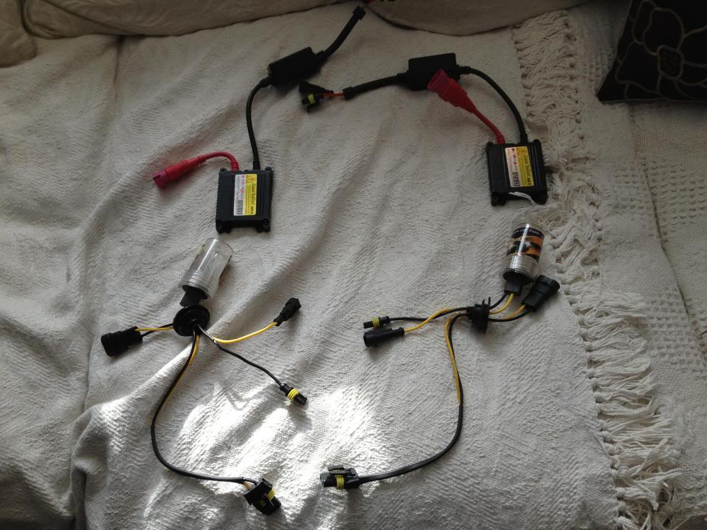

This is the HB3 HID kit i've got:

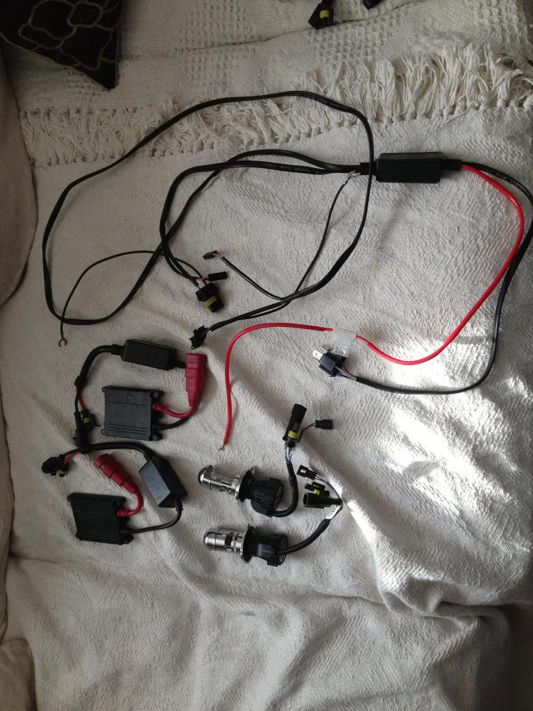

This was the one for my H4 bulbs :
What I was trying to say is, is the HB3 kit right not to have the big long wire with the fuse on ? Or do I need that wire ?

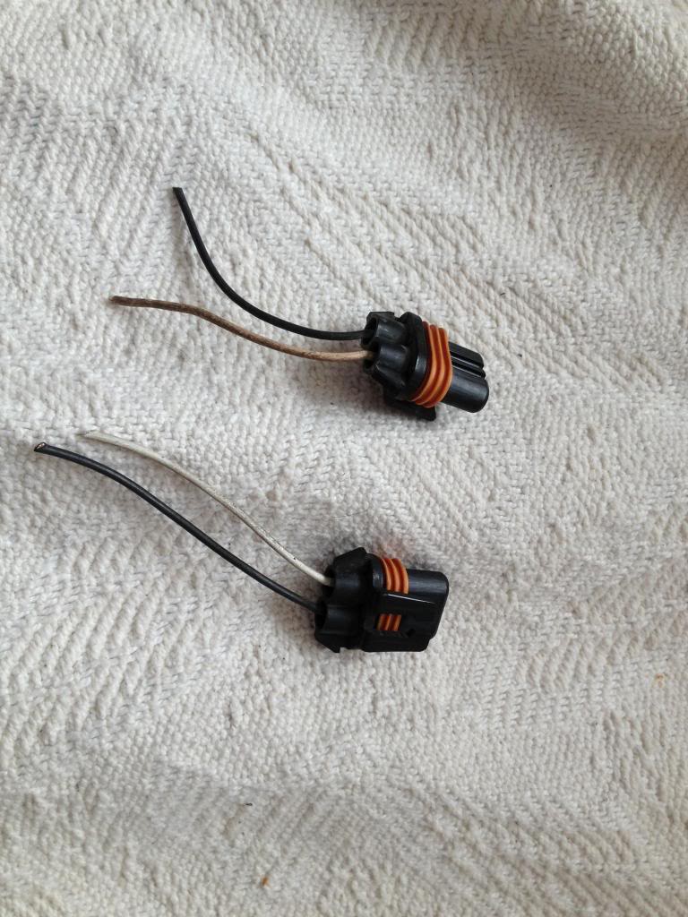

I also got these from the scrappy if they are any help ?
Any help is hugely appreciated :)
The HB3 kit is right. The positive and neutral wires go into the red connector on the ballast, then the bulbs plug into the other connectors from the ballast.
