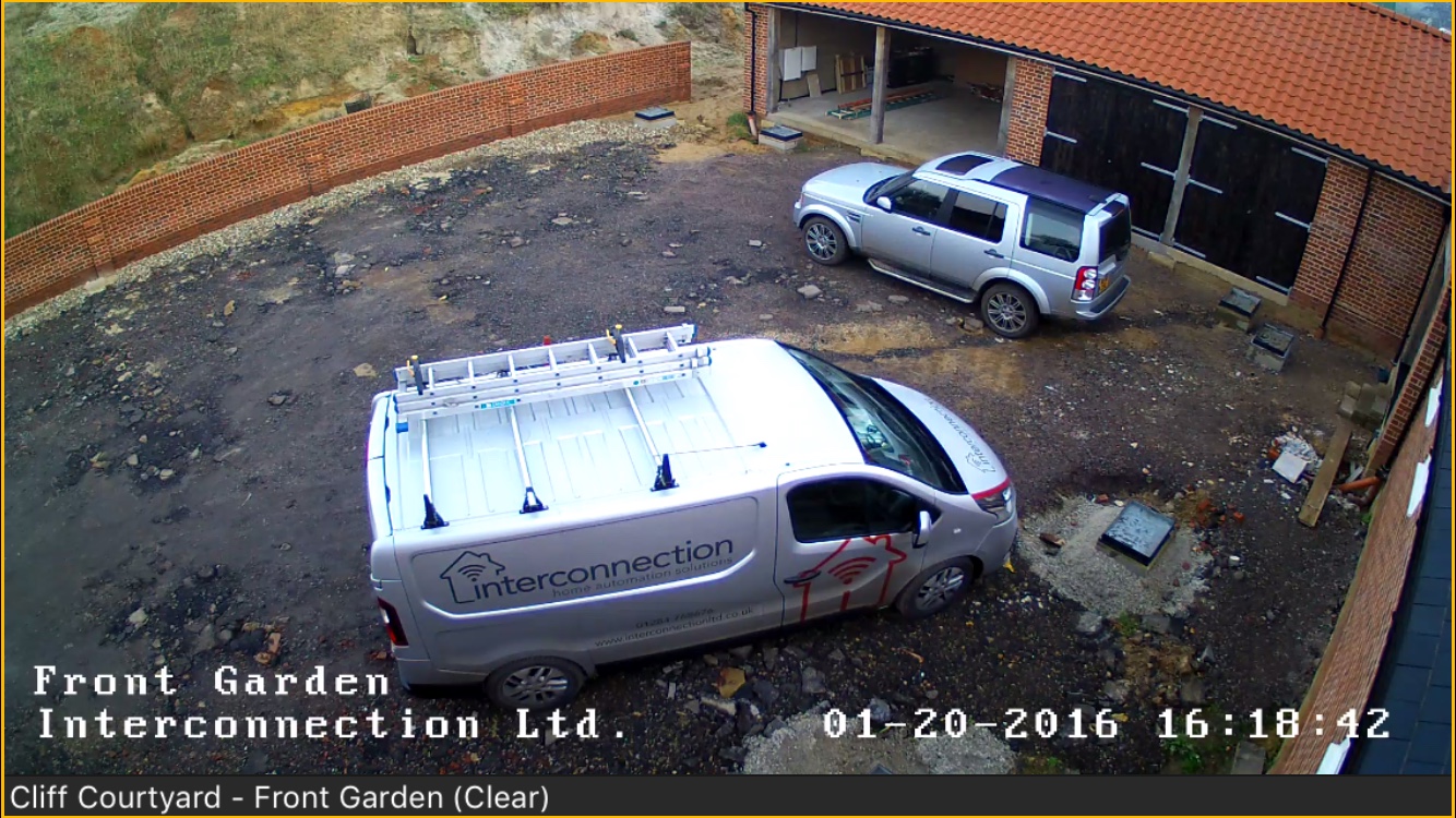

Draw power using Power over Ethernet. So you just have one Ethernet cable going to it and it draws it from a POE network switch.
For all that your looking at about £800+VAT.
If you wanted a monitor you would need to connect it all to an NVR so looking at another £500+VAT.
These are proper quality though.

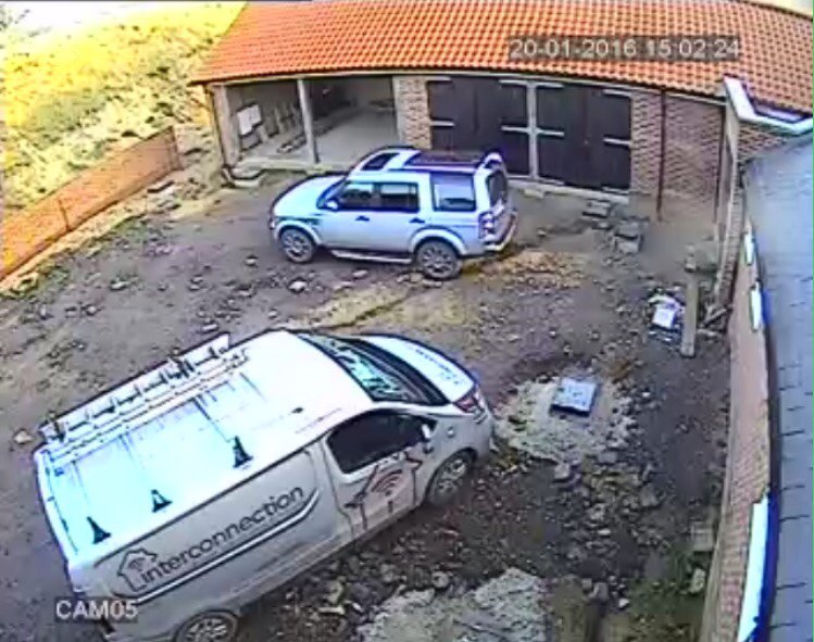

Standard CCTV Image
Vs. HIK Vision at 1080p 30FPS
