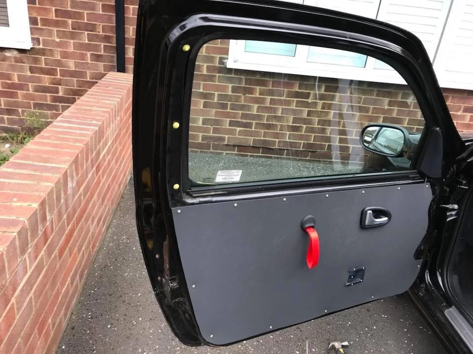

Wanting to tidy up the doors on the mk1 with some kind of doorcard. Don't really wanna be spending hundreds on some carbon fibre jobs just for track.
Has anyone made their own? What materials are out there that could do the job?
Post pics if you have them
Thanks

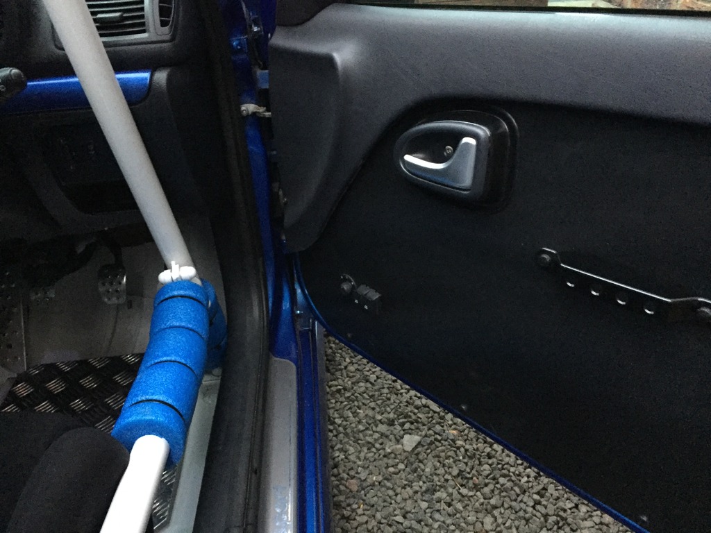

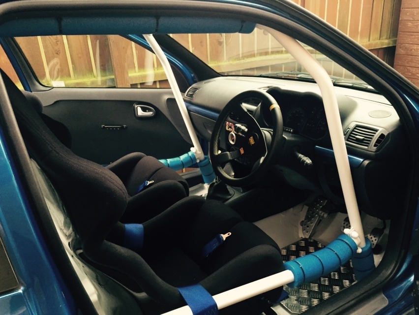

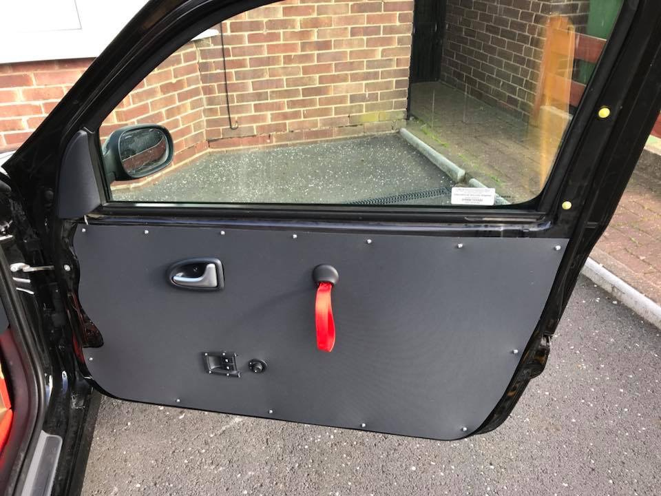

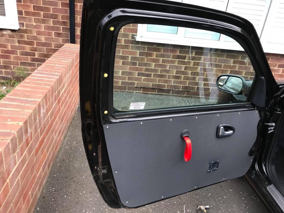

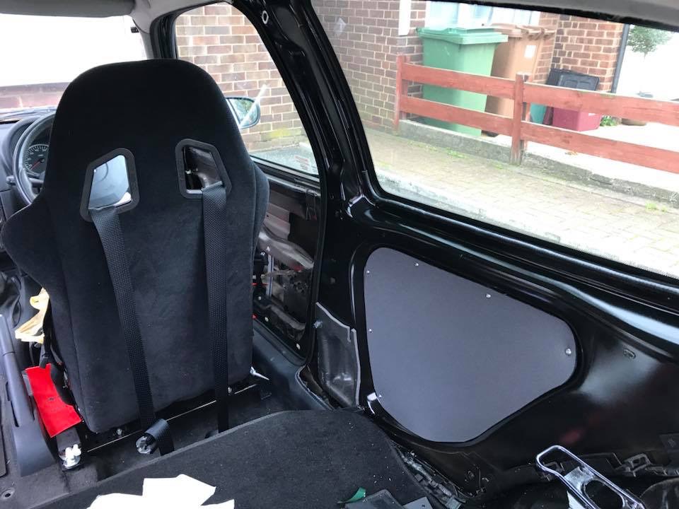

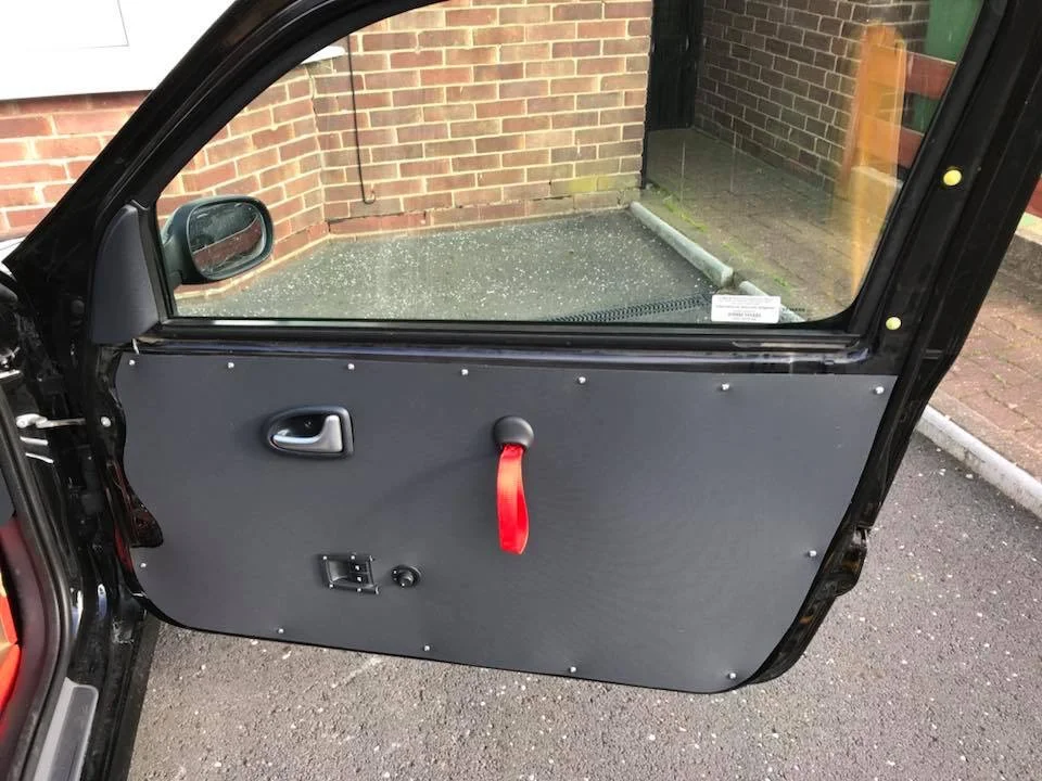

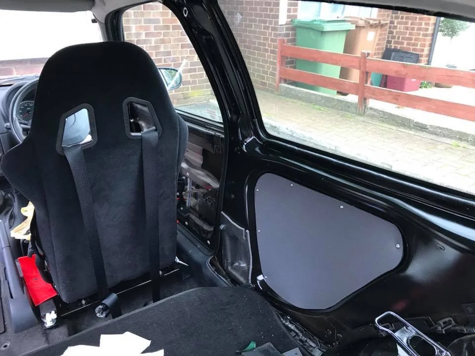

3mm foamex, cheap, light and very easy to cut :)
Original cards chopped up and added optional :tonguewink:
