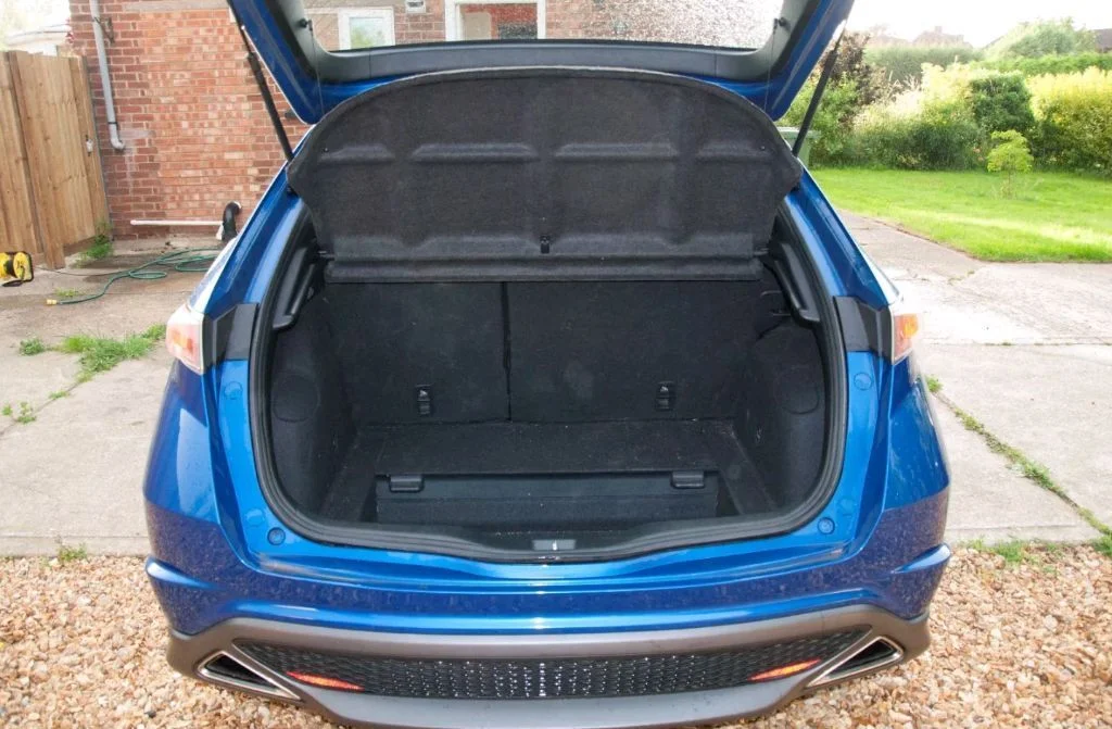

Fix water leak in boot

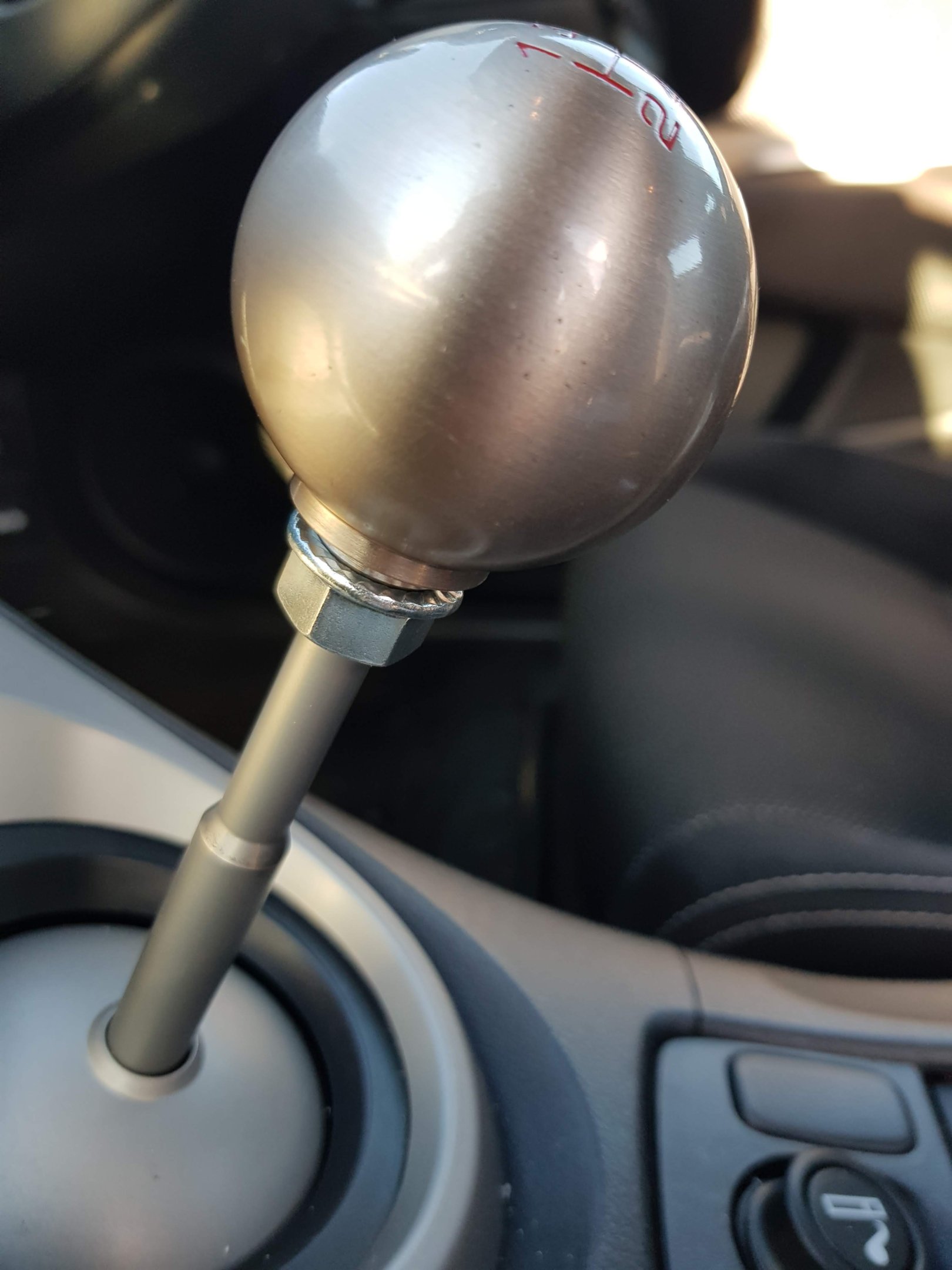

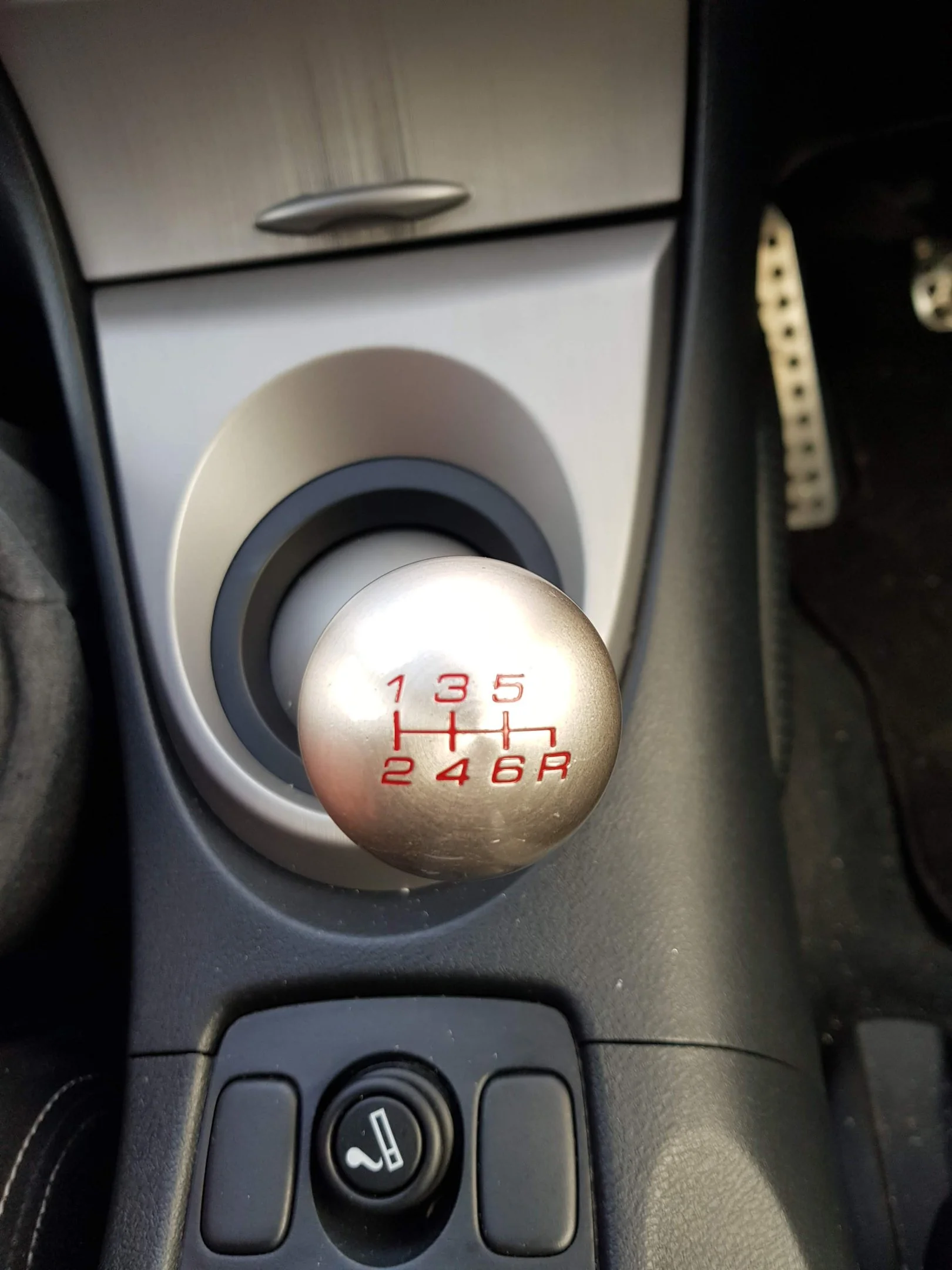

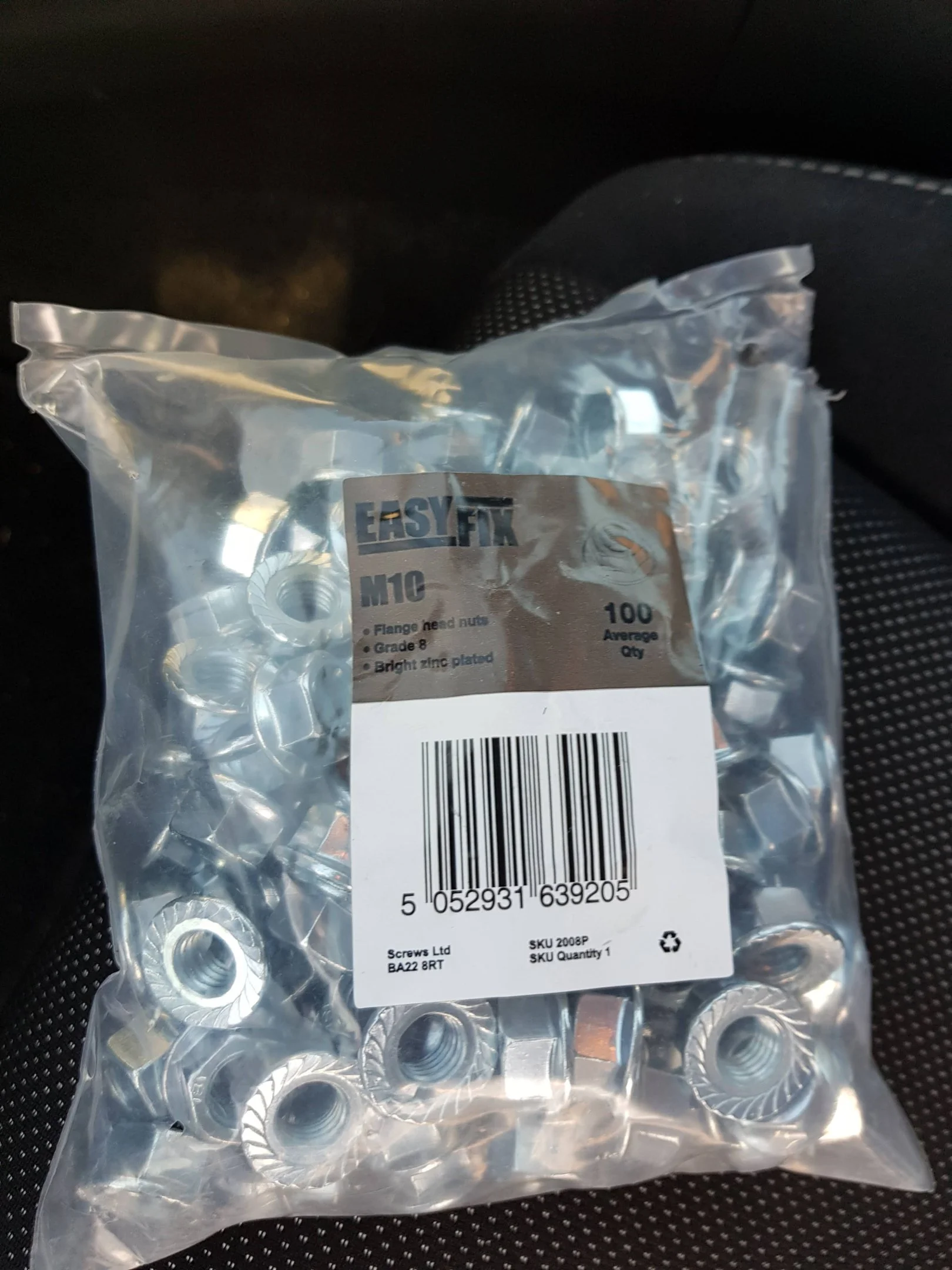

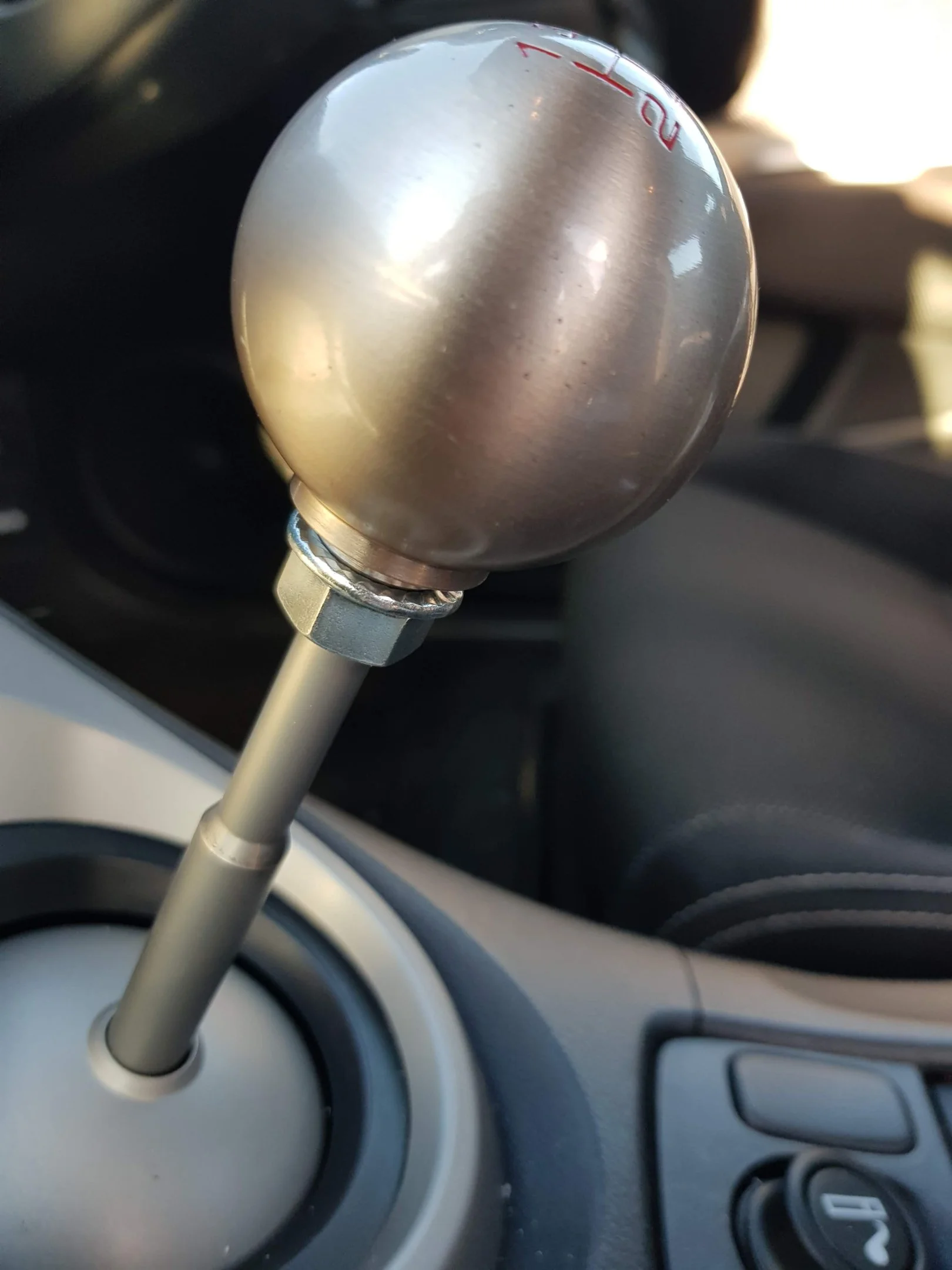

First mod, need the lock nut tho.

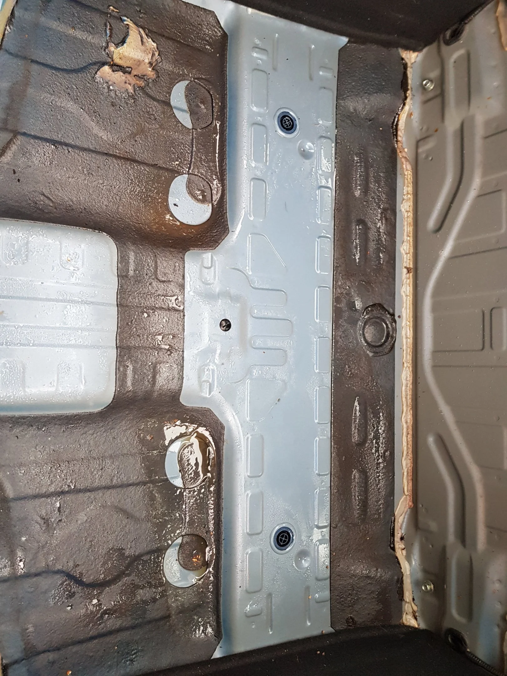

Started to strip out the rear and found the puddle, sadly the weather went against me so i had to stop before i could finish stripping the interior.

Cheers, i have been doing some digging on civinfo and online etc. I have a post saved that @Danith was involved in. I think its probably coming from the cracked seam sealer at the rear or the roof gutters, but i need to strip the rest of the interior out and test first.

Same mod as mine.

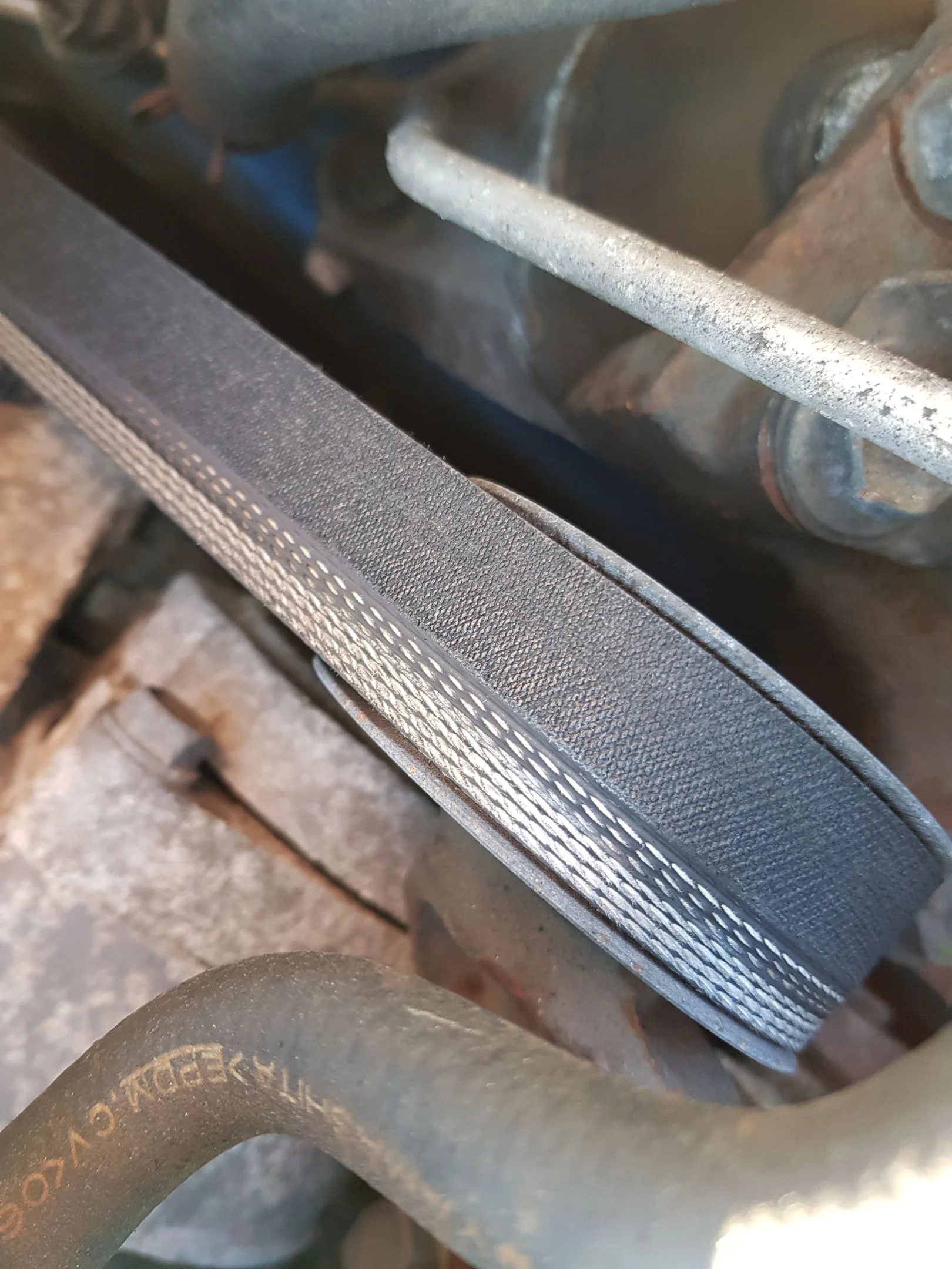

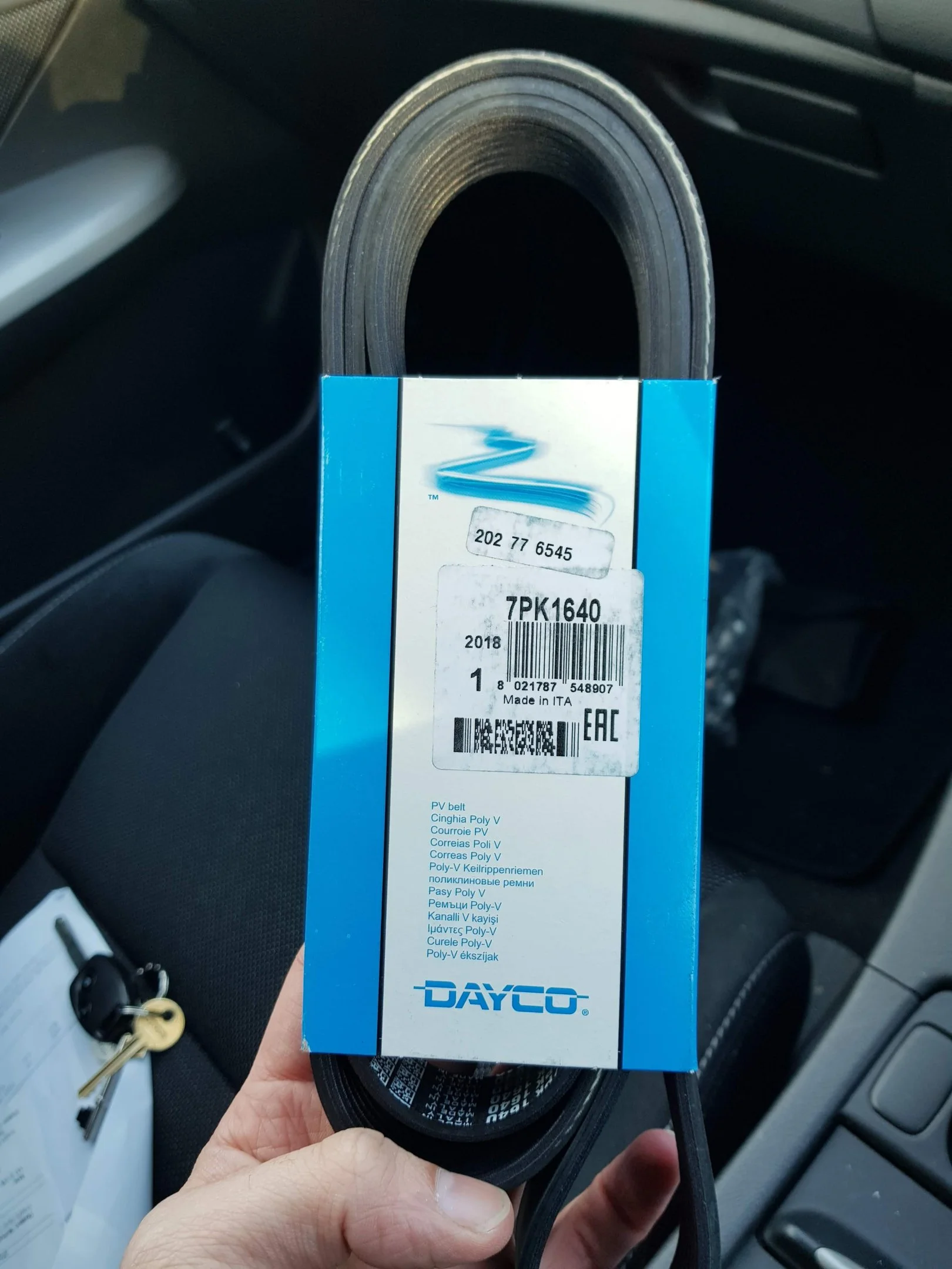

I just popped out to Euros to get my new alternator belt, got some fuel cleaner and an M10 nut to lock my gearknob in the right place. As you can see the alternator belt is not long for this world. Hopefully i have the right belt as i don't trust Euros and it would be a nightmare if it was wrong!

Find the cause of that belt wear mate as it'll only do it to the new one.
Yer from what i could see top side it's only done it to part of the belt. When i change it tonight i'll have to dig around and see if it catches anywhere. I think im probably going to have to change the pulleys as well as they sound like a roller skate.

Yer that's right, I just changed the aux belt that was a bit of a b**ch! Hour and a half later lol.

I checked my belt this morning after driving to work and i can see its a bit dirty on one side, i can't see it rubbing anywhere tho so not sure why that's happening.

So exhaust manifold was done yesterday by Honda, haven't smelt any fumes and sounds a bit quieter. The leak seems to be fixed aswell so just need to clean the interior and put it back in.
