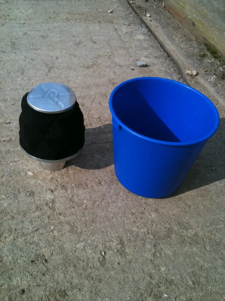

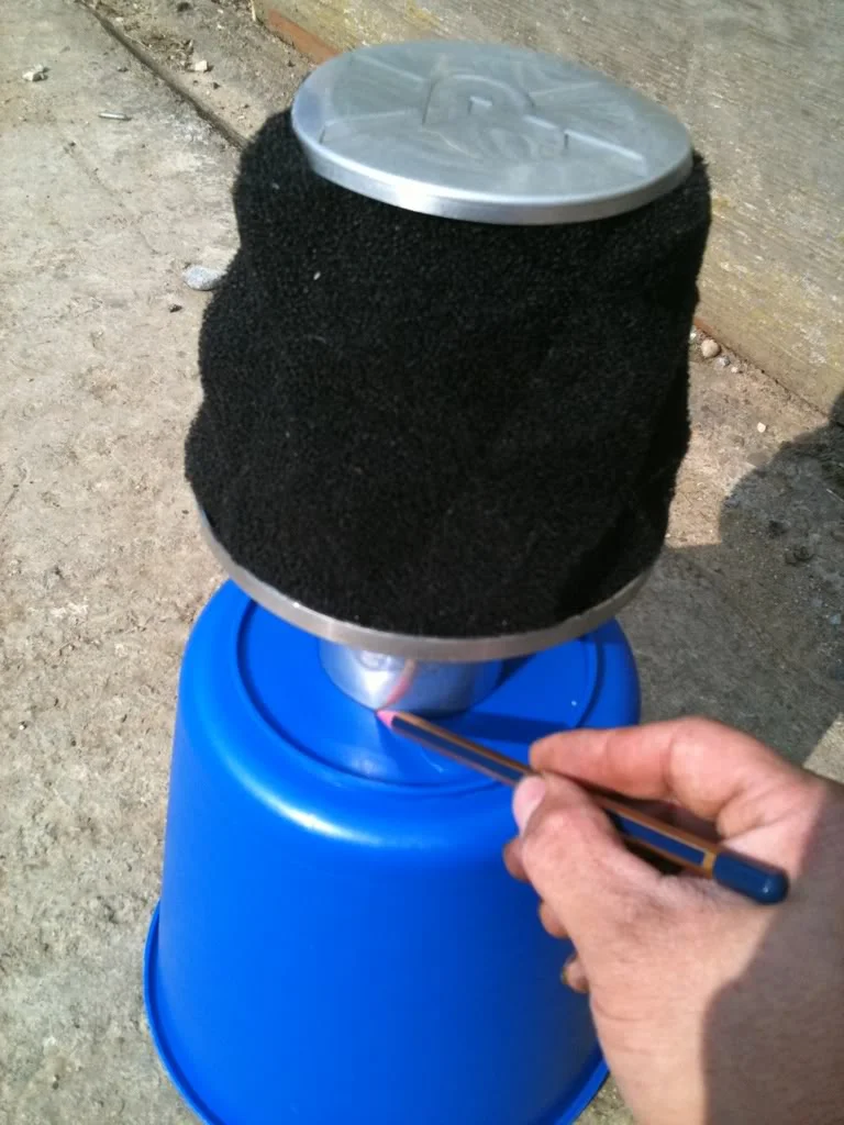

First u need to get hold a induction cone. I bought this pipercross one off a member on here for £15
Need u need to go to any agricultural supplies shop and buy a 5 litre calf rearing bucket for £1.50, everywhere sells them

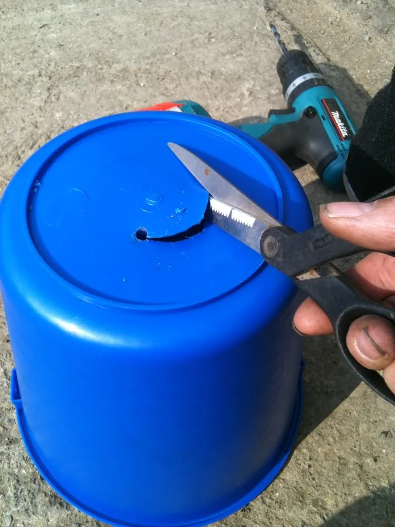

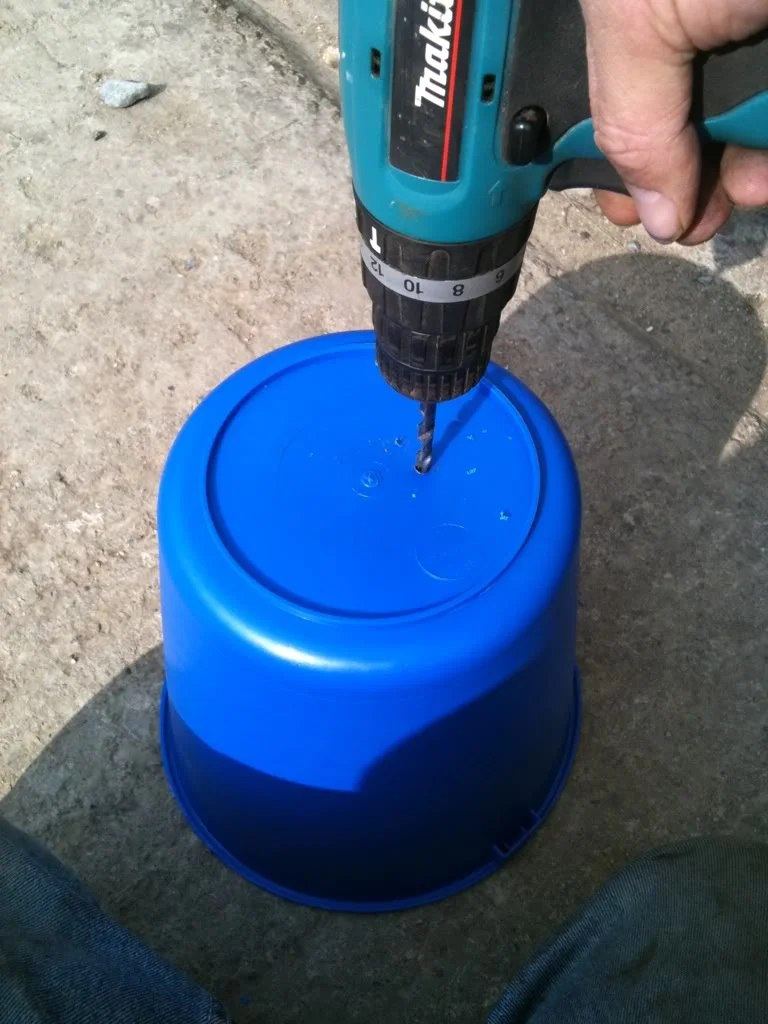

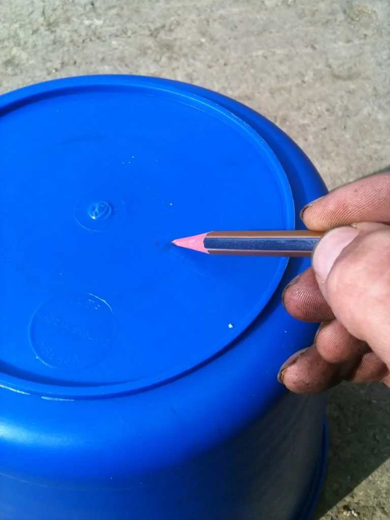

Next make round the IK with a pencil

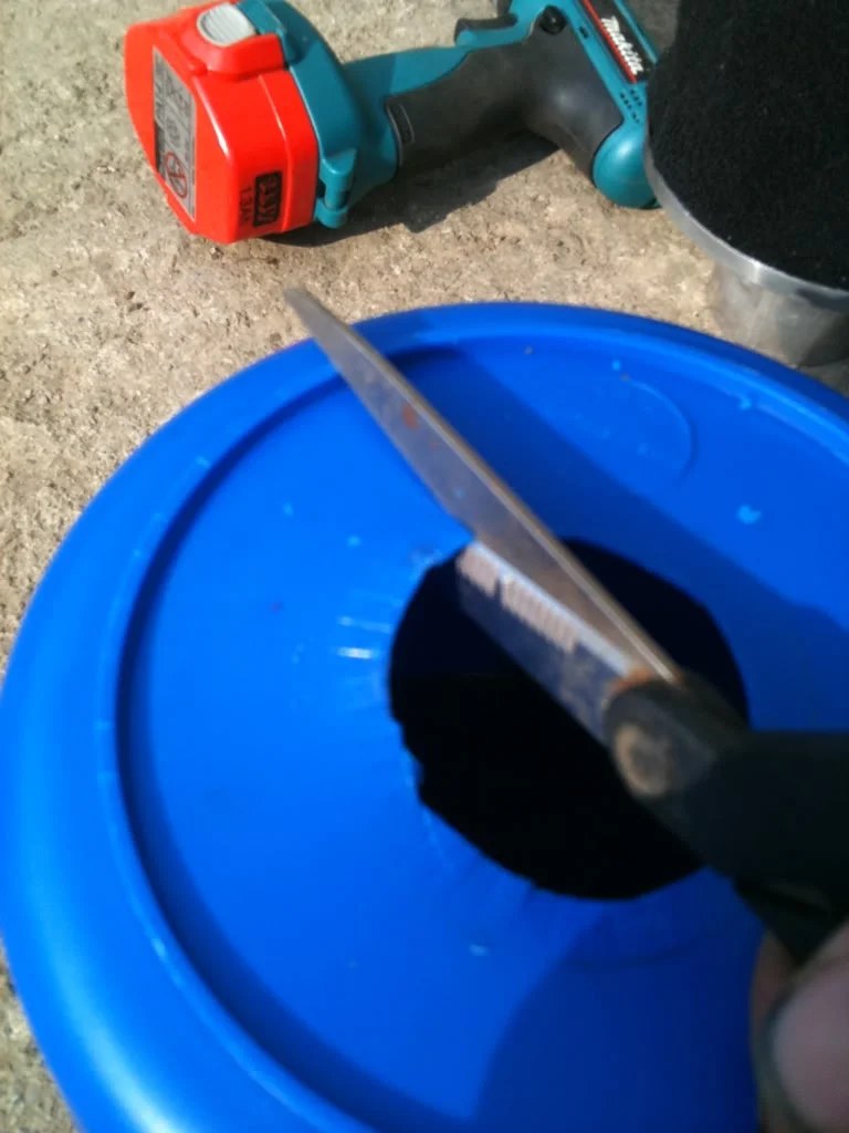

Next drll a hole one cm from inside the circle drill a hole and then cut out a circle with your scissors

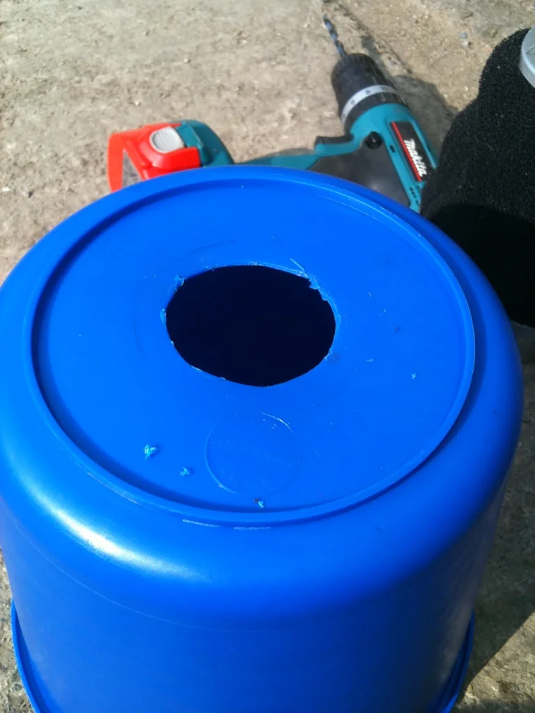

Next cut round the hole with your scissors up to the circle u marked with your pencil

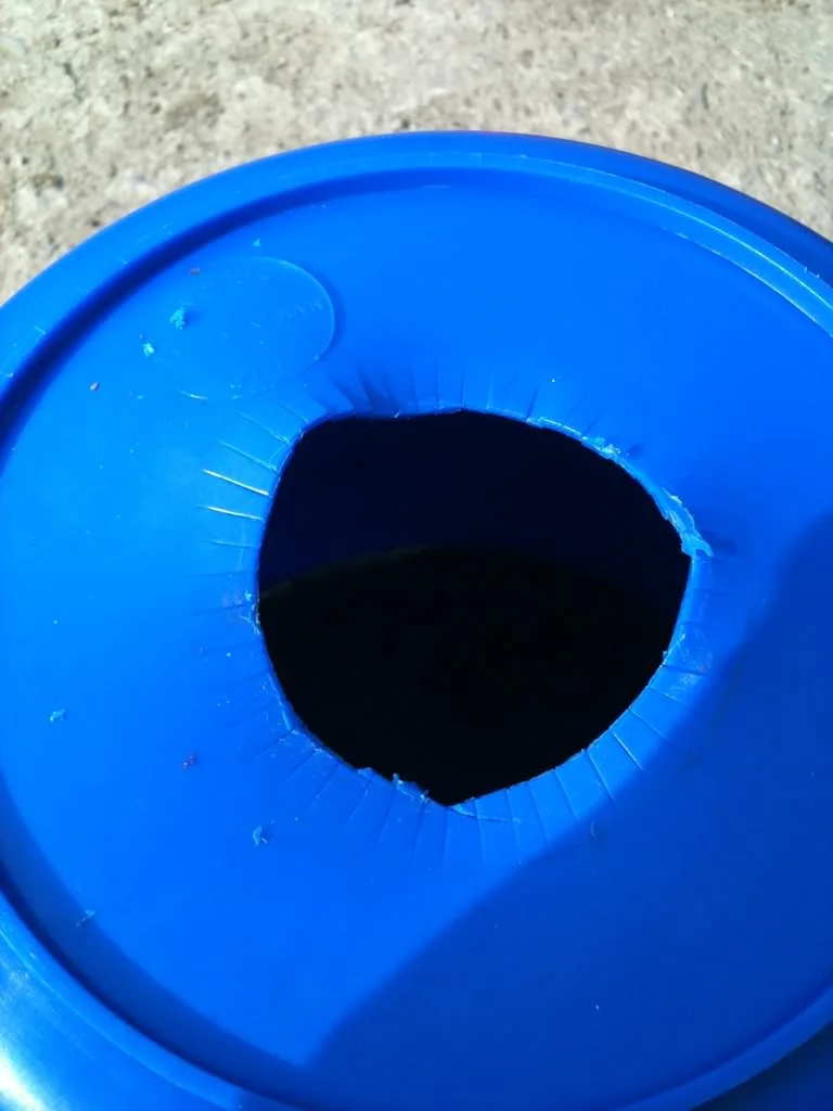

Now your bucket should look like this

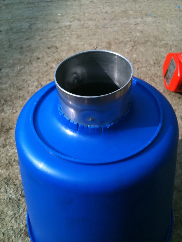

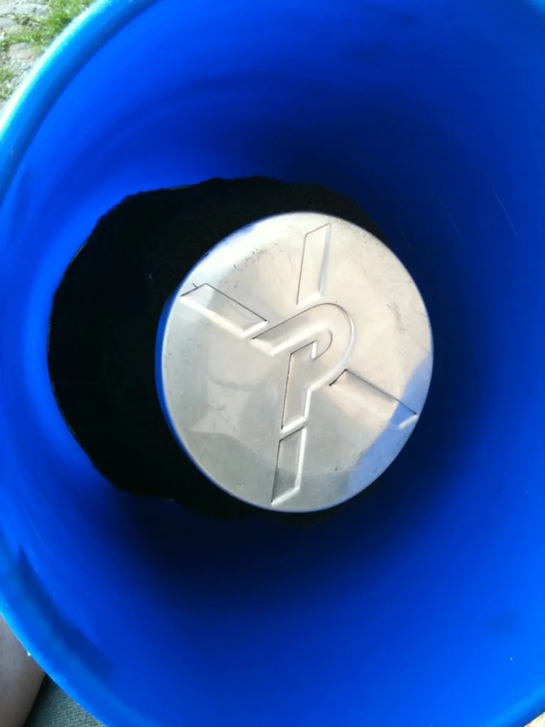

Now pust the induction cone through the hole, it will be tight and the bucket will grab it and be very secure

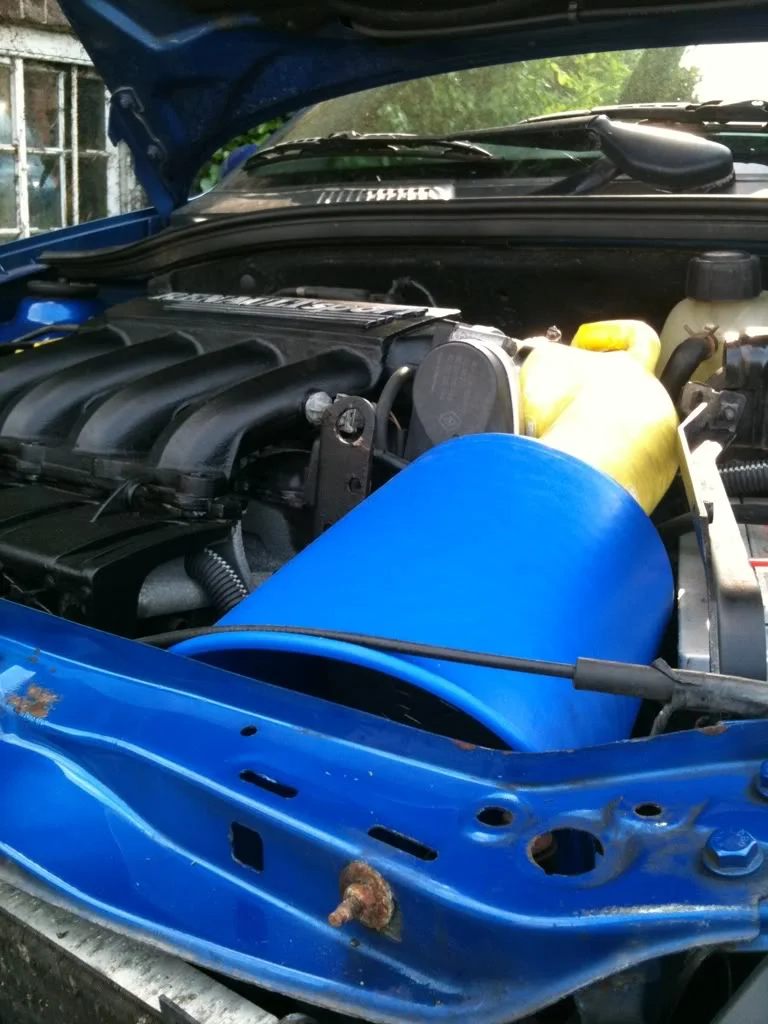

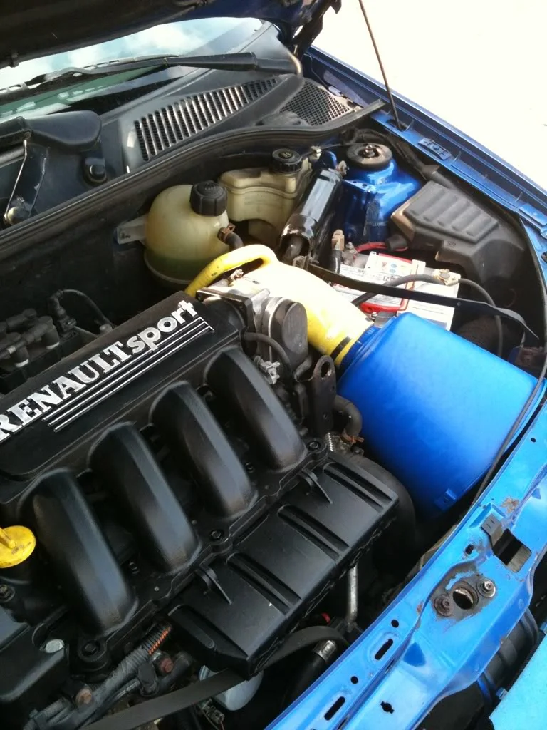

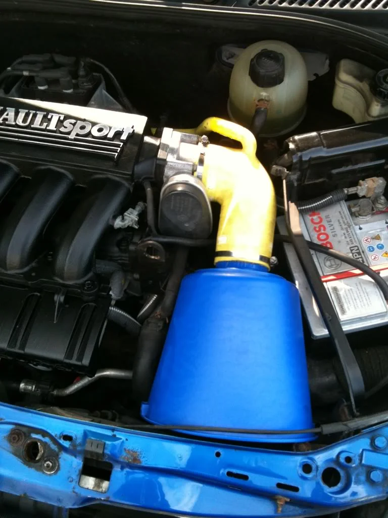

Now fit to the thottle body, the bucket fits perfectly into the 172 engine bay
This is a very simple mod that takes 20 minutes tops. Now u can enjoy the induction ROAR!! Without loosing any bhp as the bucket shields the filter from any heat soak.

Except you have a bucket in your engine bay thats sucking allll that hot air from the rad. Shot son!

As it's not sealed, what's stopping the air inside the bucket getting hot?

I have some heat wrap so will put some on, surely this is still better with the bucket than without
After a fast run i opened the bonnet and had a feel of the cone filter and it felt quite cold
Pulls really well, certainly doesnt feel any slower than with the standard airbox

I think its a good idea. Could you not put a feeder pipe to the bucket for that bit more cold air ?
TheEvilGiraffe
South East - Essex
Still wiping the tears away here...
Why not just use a v6/ph1 airbox + ITG filter if needed. At least that actually has actual cold air feeds and probably a TUV mark on it.
  Ph1 track 172
you may well have gained 2bhp over not having the bucket,
but you've still lost 5bhp over the standard system!!
and surely its still sucking air from directly behind the rad?!

Carbon wrapping it would be a definite improvement, but my main concern would be that the particular filter has a large sold silver piece on the end.
So, it's not like it takes in air from that top part, so are you almost starving it a little?
  Clio 172 cup
Certainly doesnt feel like its lost any power. At speed the bucket will catch all the cold air going through and over the rad
But omg to sound is just incredible!!
