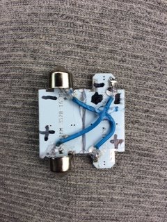

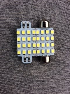

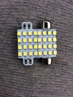

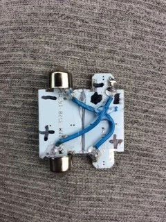

My solution to this problem is to get two led lamps hot glue gun them together and solder them to each other in opposite polarity. So therefore when the light is in door open mode one of the led lamps light up then when you switch the light to always on the other led lamp lights up due to the polarity being different, hope that makes sense and it is an easy enough fix if you have basic soldering experience.
Image below of the final led lamp that works!!! :smile:
p.s on the image the polarities are labled on the leds just follow the wires and you can see what goes where.
