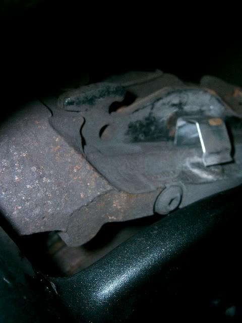

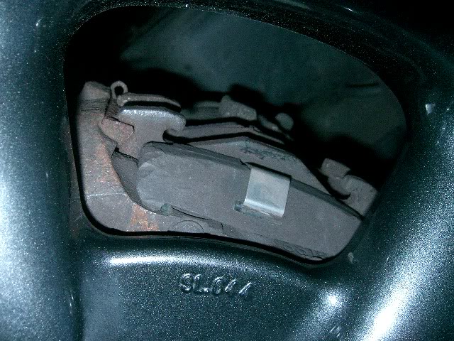

ok, having had what can only be defined as a crap handbrake for a while now, and having had it advised on the MOT, I finally had a look at them.
And now I'm concerned.
This side looks fine:
but this side doesn't:
:eek:
Anyone tell me what's wrong? It looks like it's missing something to me?
I don't want to take it to a garage and get my trousers pulled down... :S
Thank you! :D
certainly looks odd compared to the other side, but I'm not totally sure of the rear brake setup mate. Try asking over at retro-renault.com - best place for tech advice on mk1's along with williamsclio.
Nah, its fine, just missing the squiel shim, not needed really. Handbrake will be down to the cable. But while you are looking at the calipers, check the piston isnt leaking.

Why will they die? they are squeal shims, infact they are shims that didnt even work when they left the factory..
16v rear disc brakes have always been crap..mines failed several years running. Frequently it's down to the handbrake cable, as spanner monkeys just tighten and tighten it up...great idea, but does not allow the full movement of the handbrake level (on the caliper), so fails horribly. Calipera are not too expensive (GSF), and even discs, pad and cables are easily replaced. Stay clear of 2nd hand calipers on eBay and a like...they are usually on there for a reason.!
