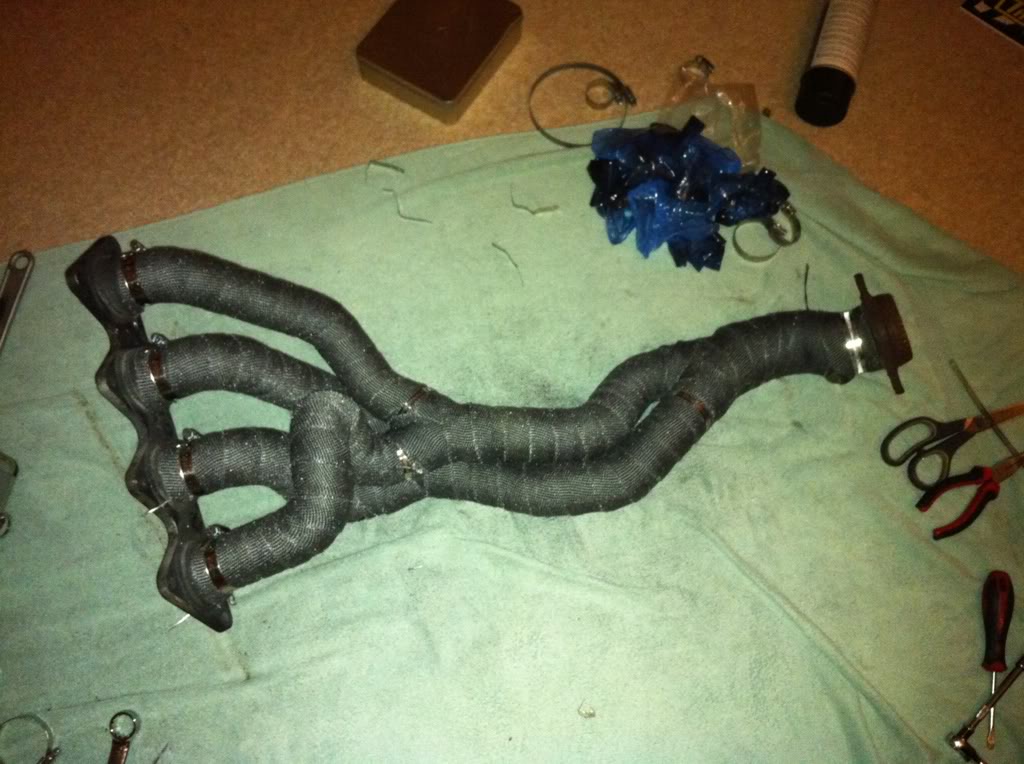

a few things i've noticed
posh header tank - i wouldn't as you can't visually check the level
mani wrap - those metal zip ties are crap, they will break!

form over function ftl... stainless lockwire ftw....

What do you use Fred instead of those ties as they were quite expensive and I thought they were meant for the job? As for the Tank, yeh form over function and I do so like a bit of bling :)
Not sure what Fred uses' but I use stainless locking ties, never had a problem.. (touches *wood)
*penis
I used Joubilee clips where i could when wrapping my Mani.
Not sure if your suppose to but i saw it on another car so i did it myself.

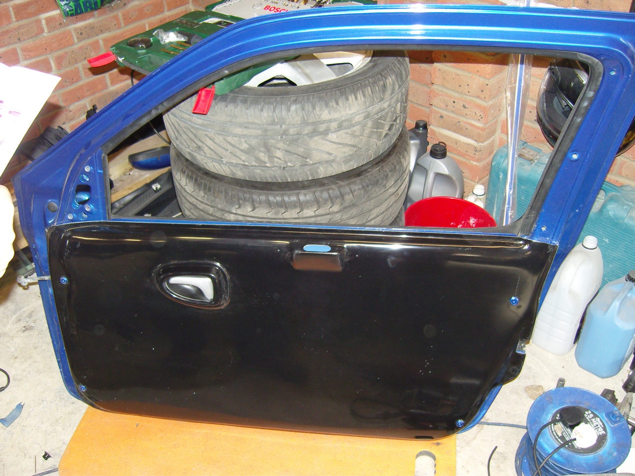

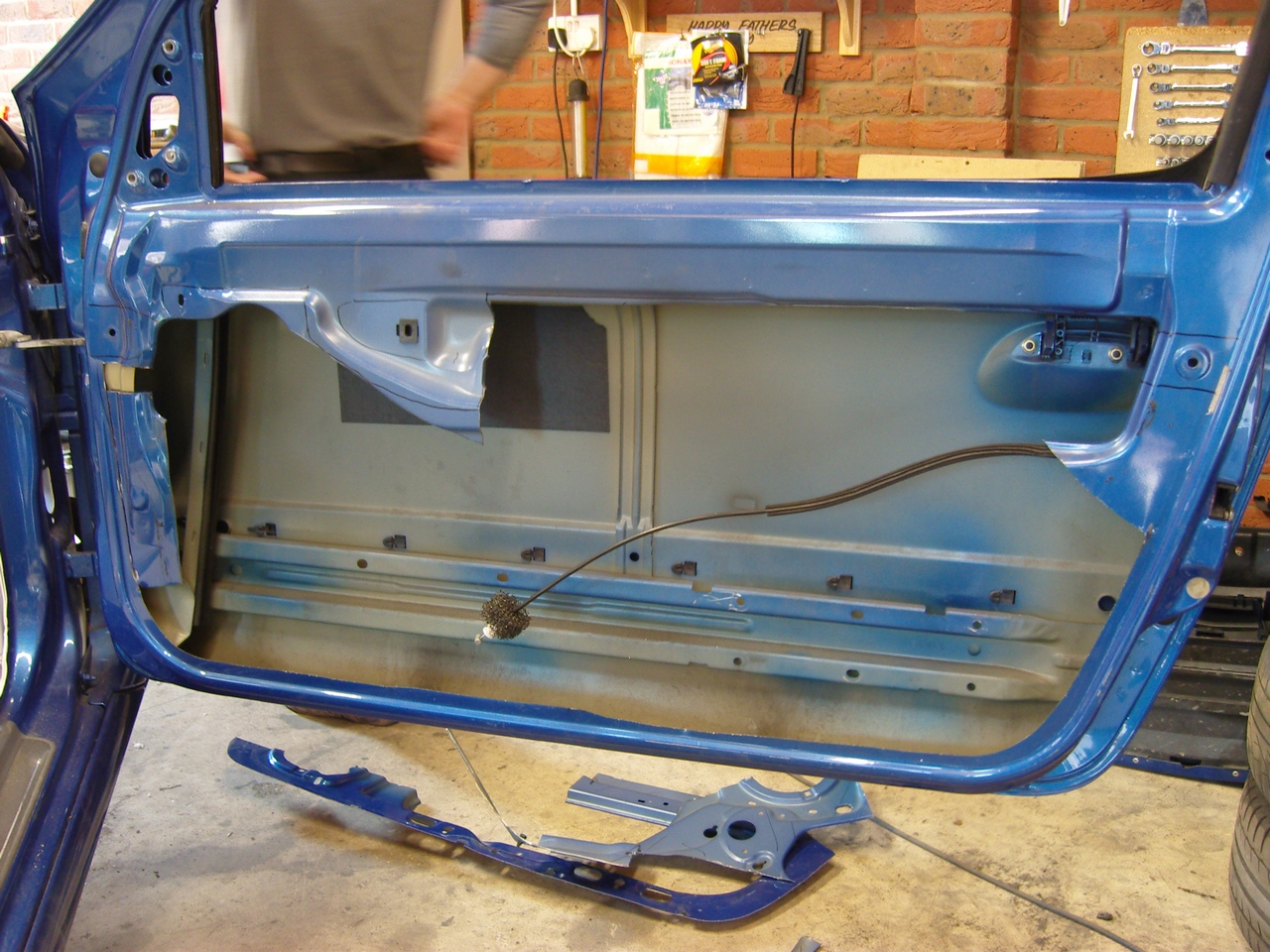

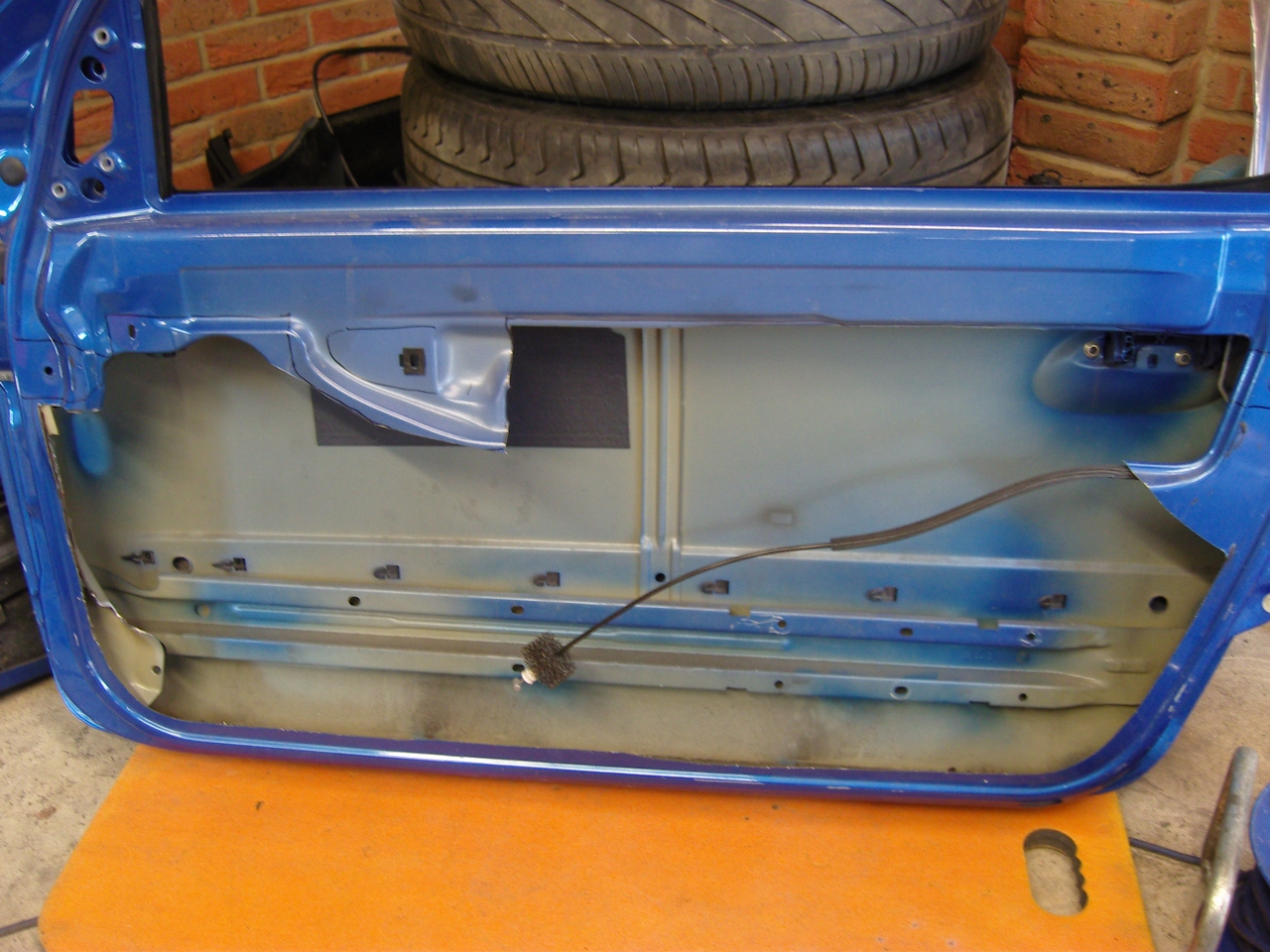

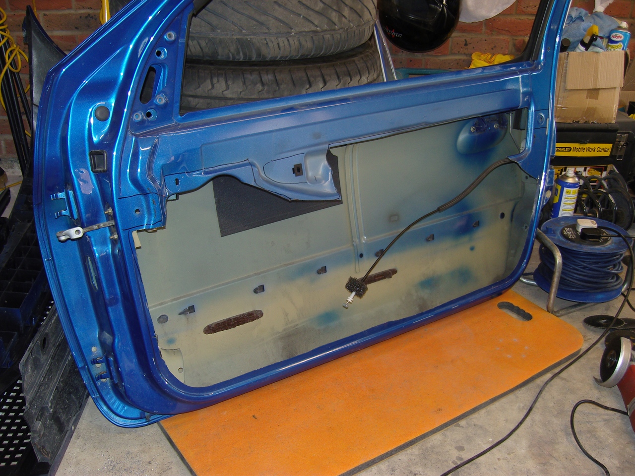

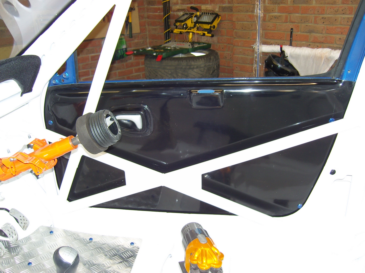

So firstly we set about cutting my doors out and fitting the Oreca (Fail) doorcards.

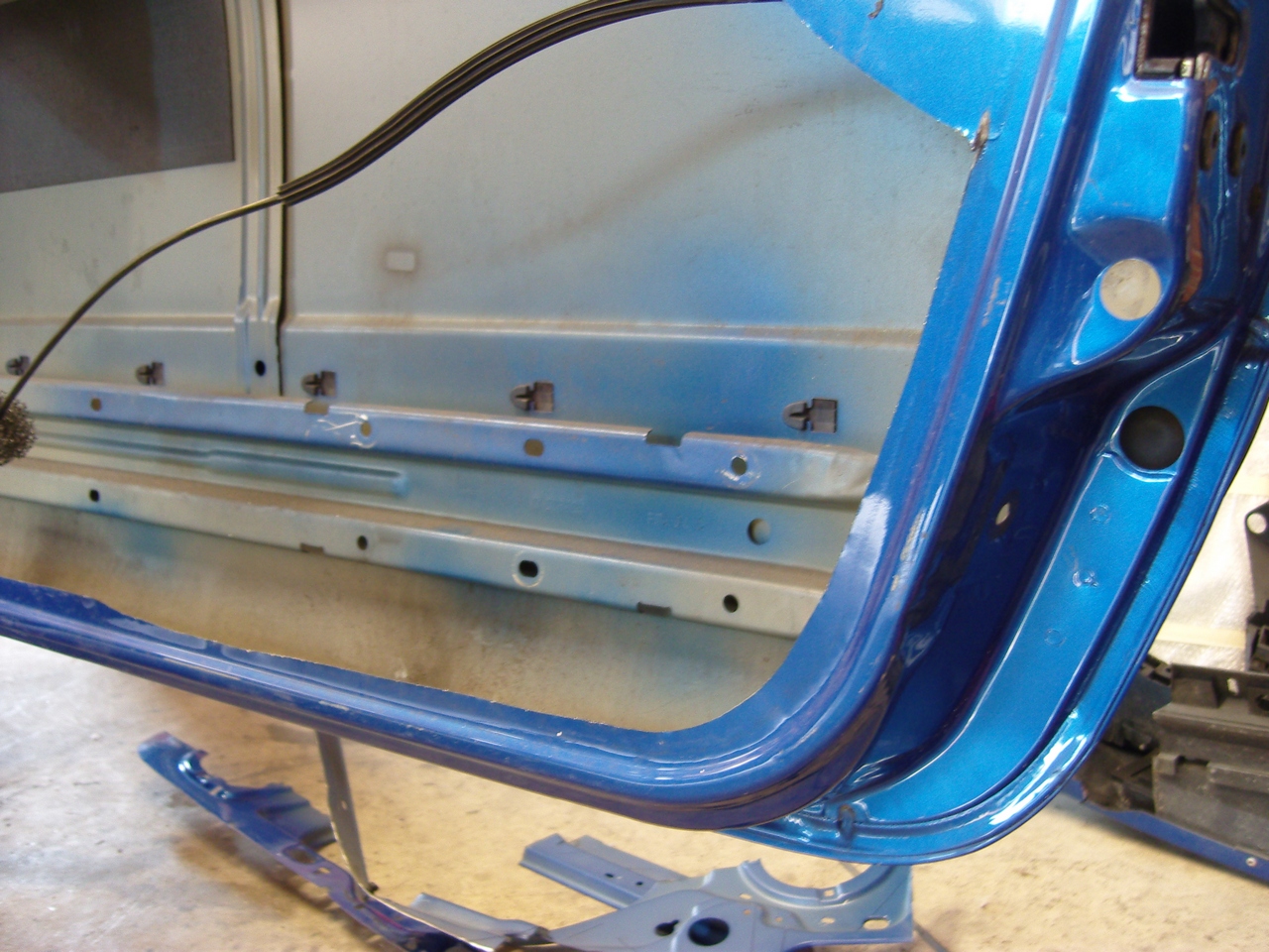

Cutting the doors out to lighten them up a bit.
The final fitted Oreca panel. As you can see the Oreca fail is that the door handle is now upside down DOH. It still works but it is of course a bit odd.
Still they do look very nice with the blue screws and all :)

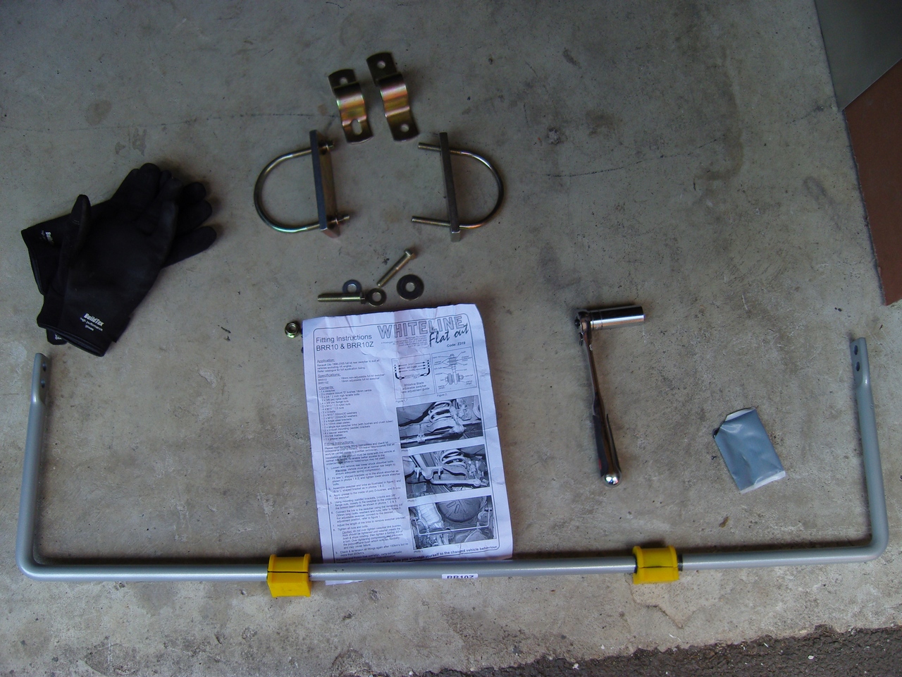

My Whiteline arrived yayyyyyyyy

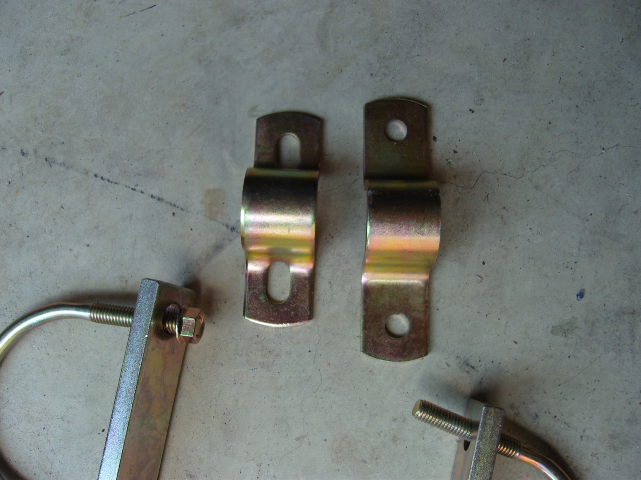

Wrong Bracket FAIL! DOH.
I have come to the conclusion that Motorsport is full of companies that do half hearted and shoddy work with zero quality control. I have lost count of the number of parts that have arrived now only for them to be wrong and have to be sent back, the packaging is generally awfull too, you never get any fixing bolts or screws either. This has cost me countless wasted hours and phone calls.
There are some serious gaps in this market for quality and quality service too. Let me down once and I will forgive you, let me down twice and I'm pissed. You don't get a third chance in my book.

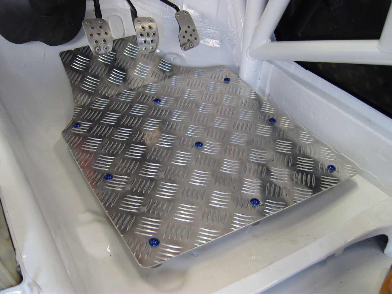

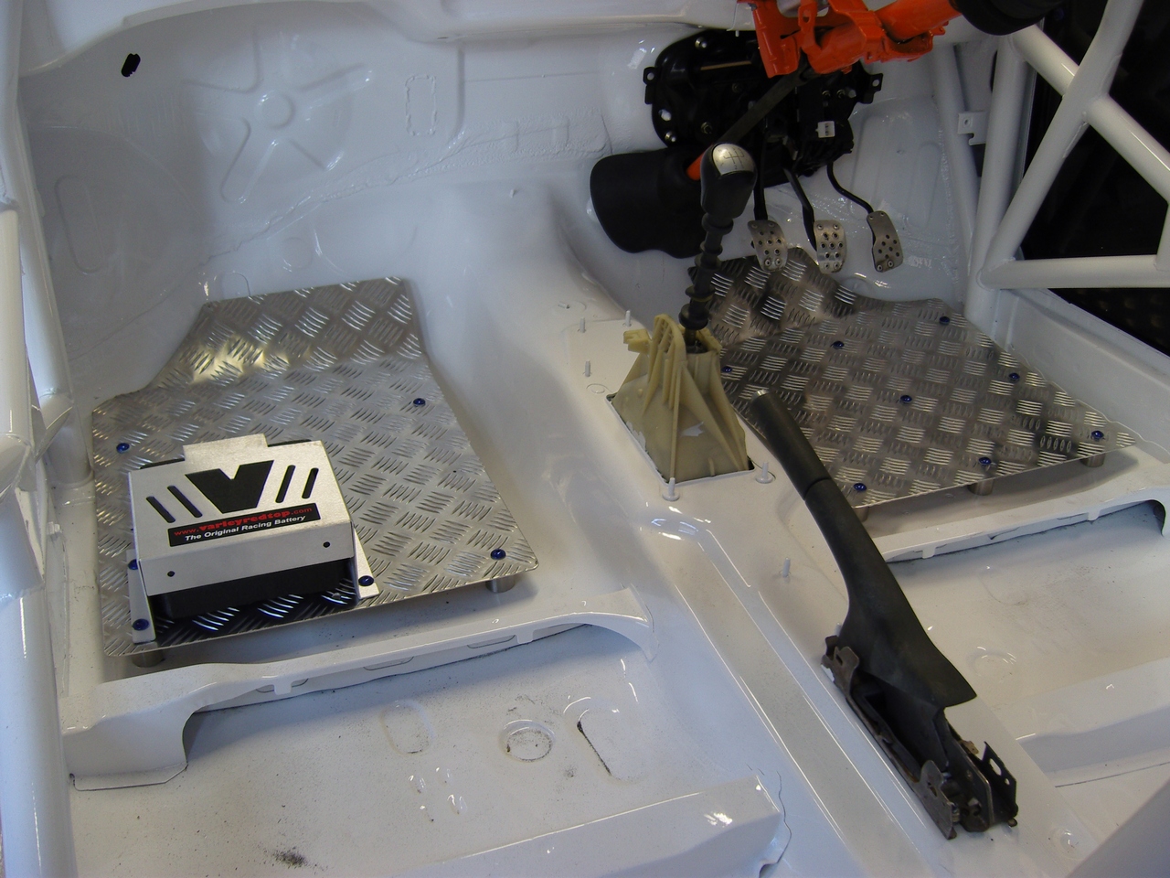

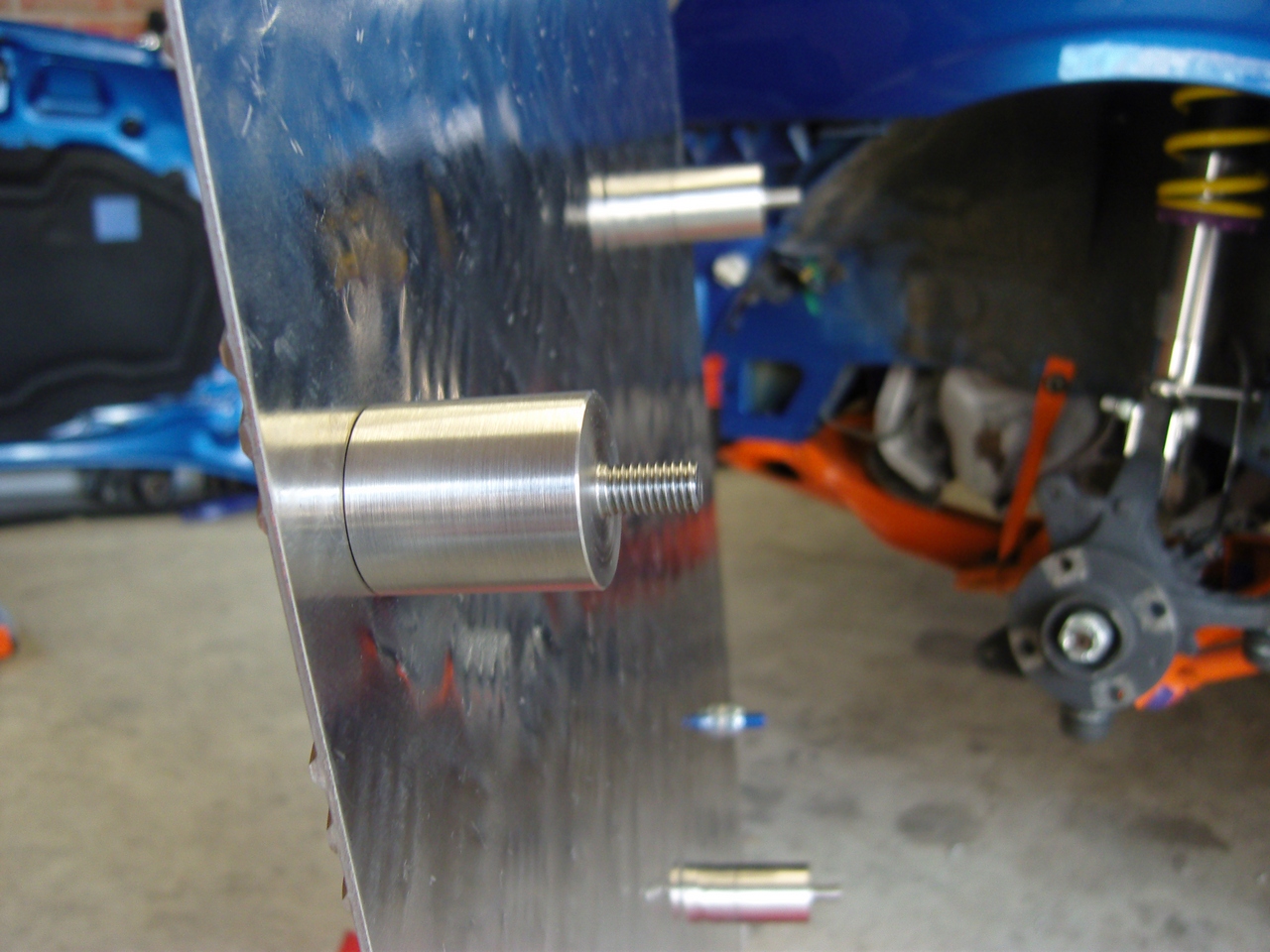

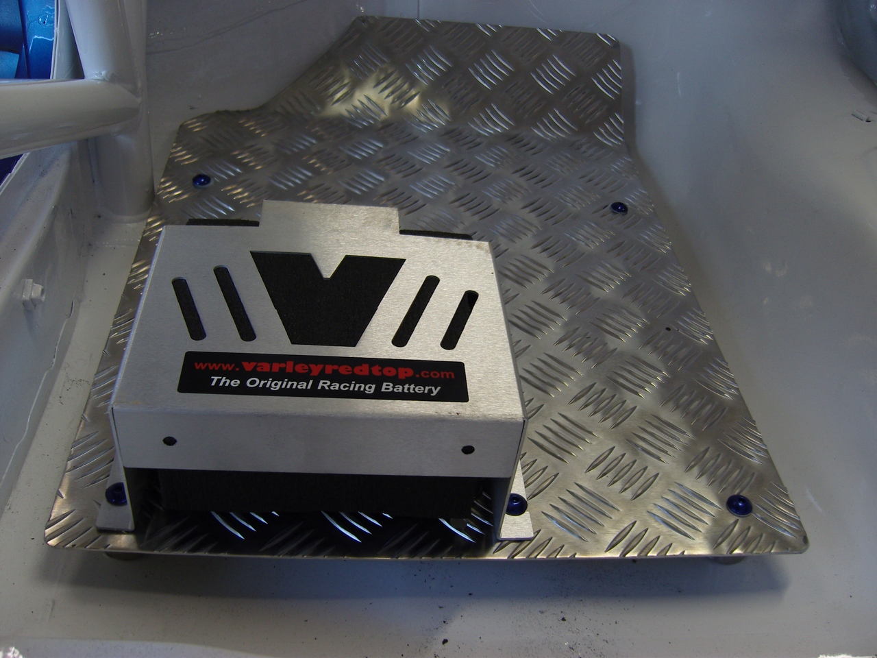

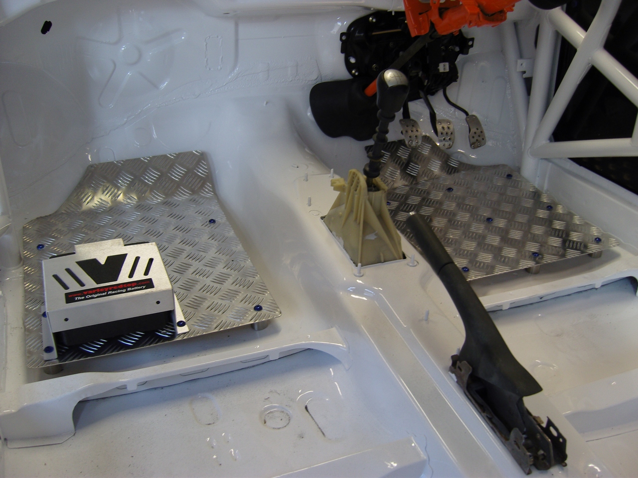

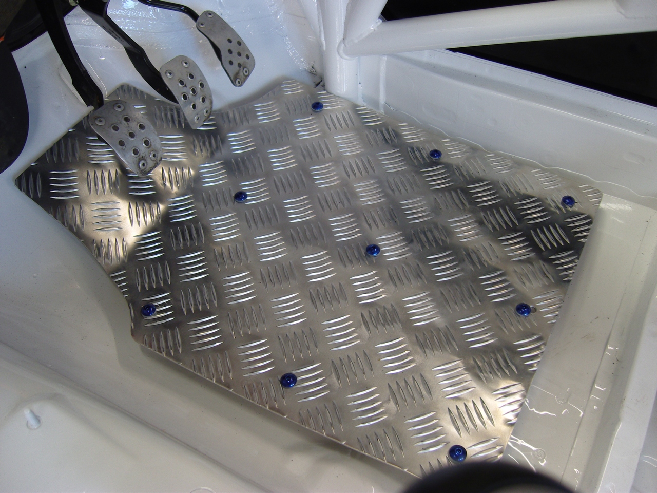

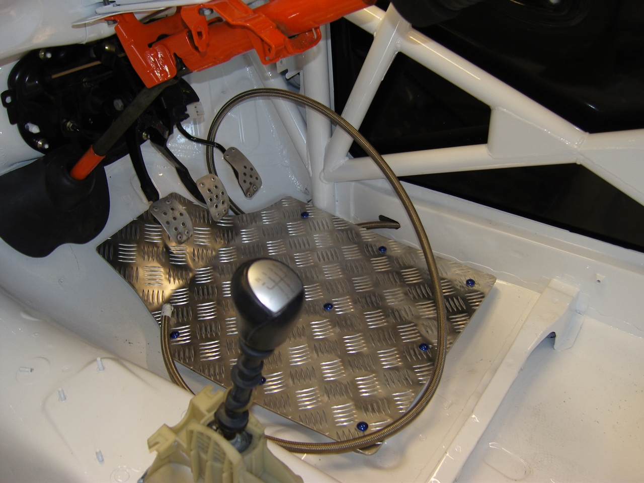

So moving swiftly on. I set about fitting my shiney new flase floors. My mate who owns the Radical company had knocked up some spacers for me at 35mm.

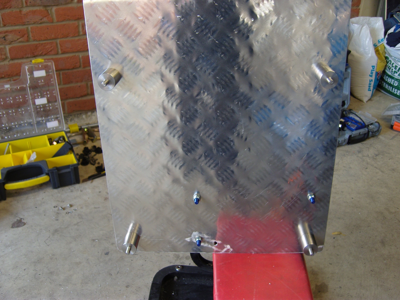

I will get him to make some at 25mm too just in case 35 is to high. This is the driver side fitted using M8 bolts into the spacers.

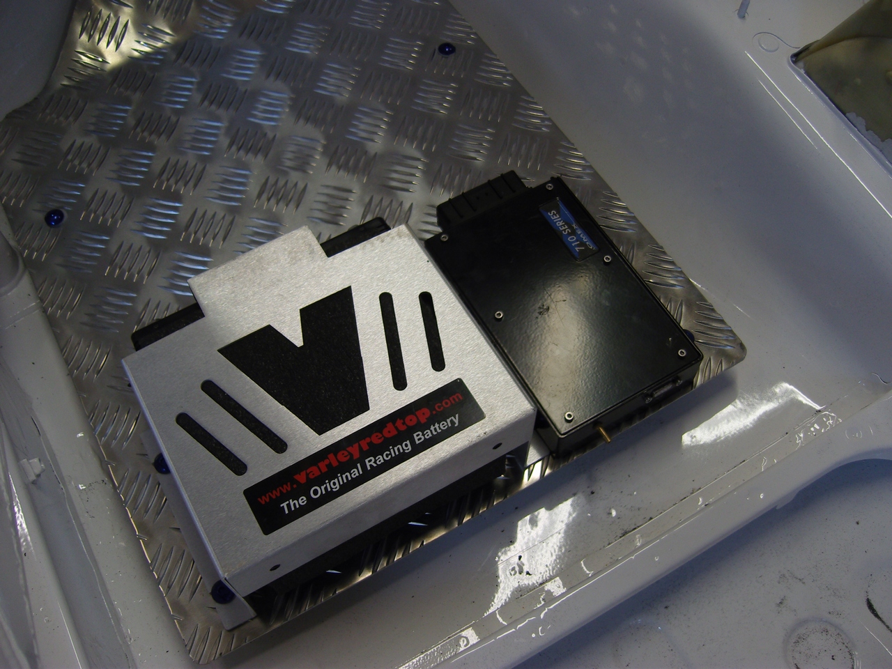

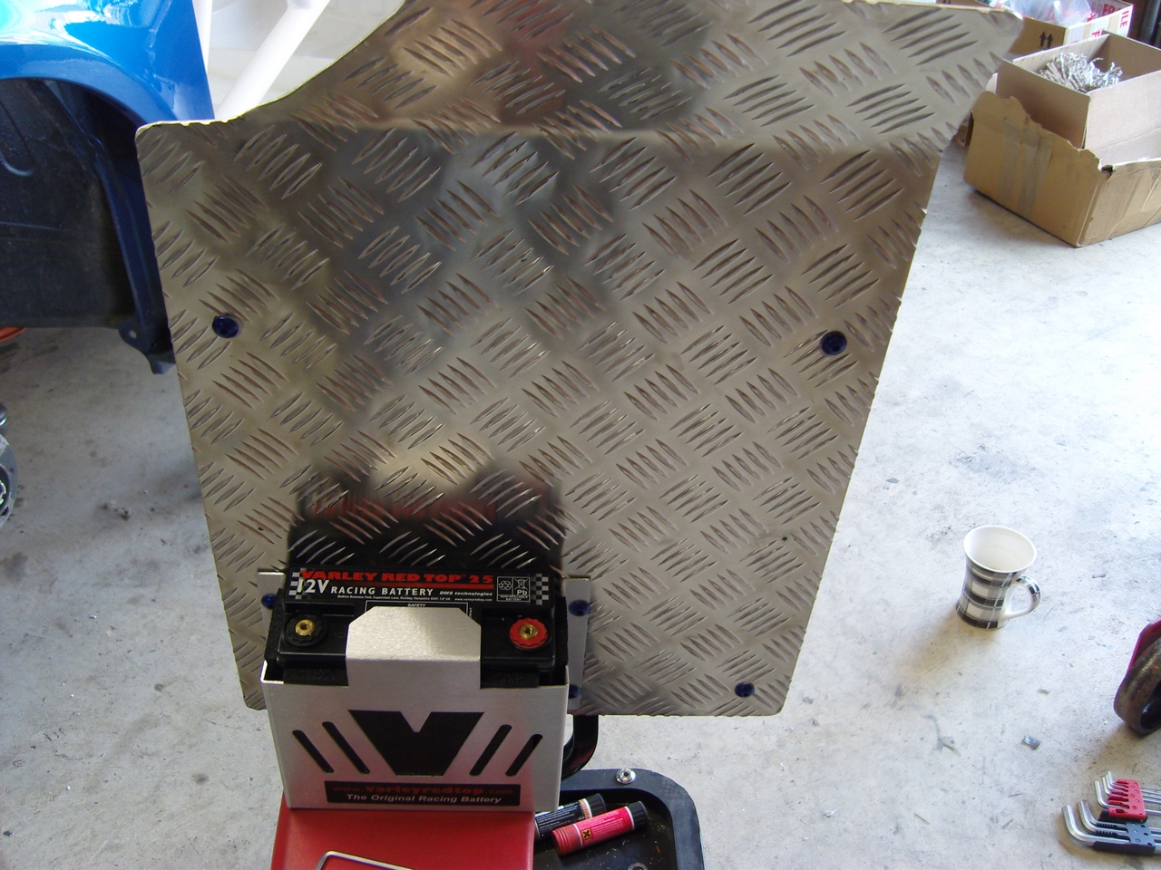

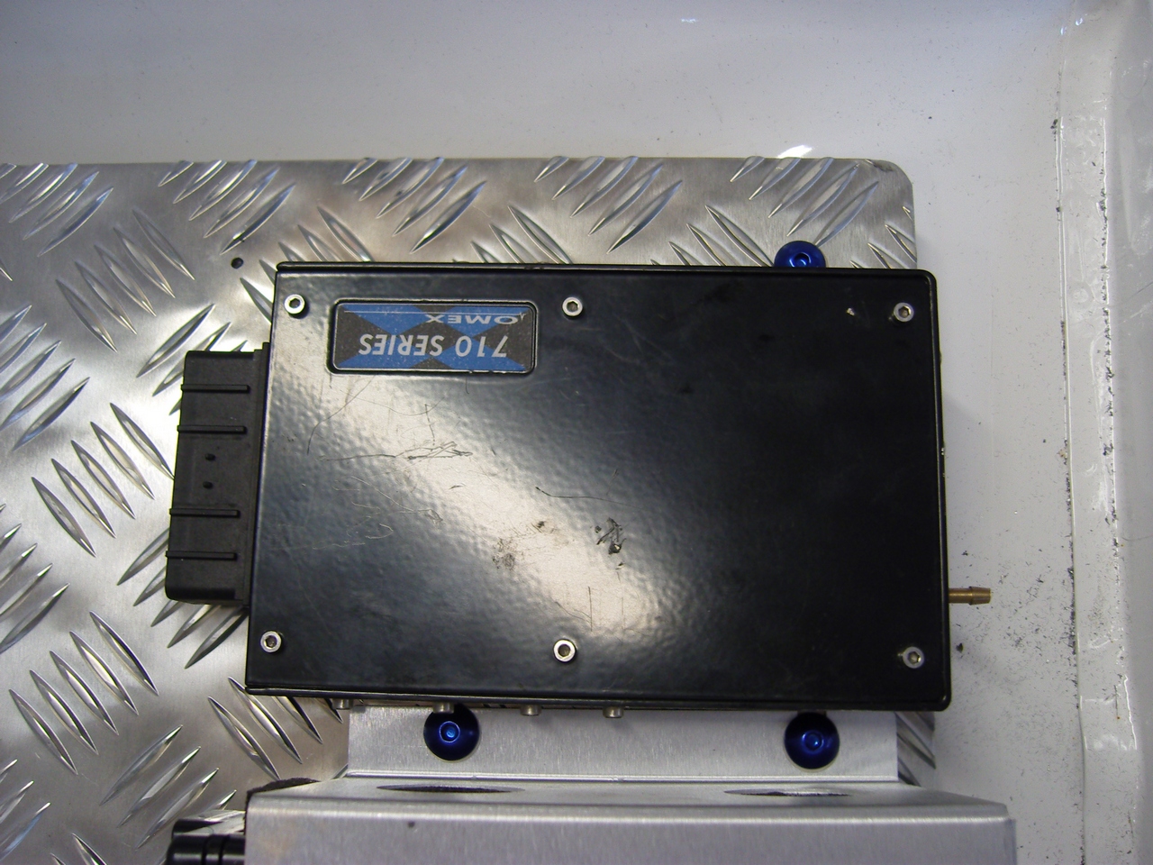

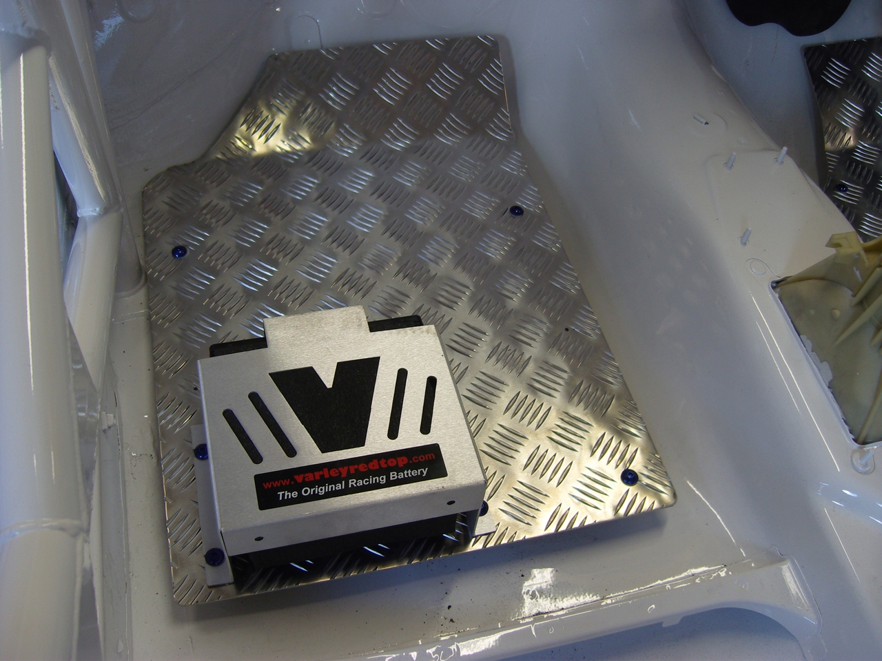

With that side done I set about the passenger one which is going to have all my electrics on it and also the battery.
A very nice chap called Doug then roared up on my drive and demanded tea and cakes!!! What a cheek. Still as he gave me a nice OMEX 710 I did a trade with him :) Very nice car he had too :) Mmmmm. Next time when I am not so pushed for time he can take me for a spin in it.
So both floors fitted. I like. A lot.

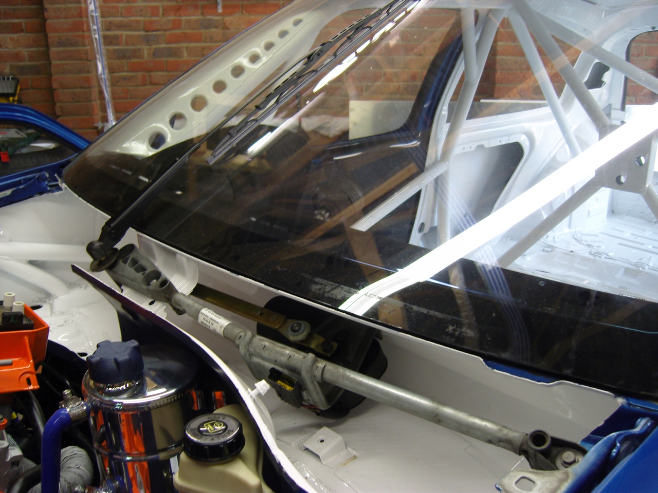

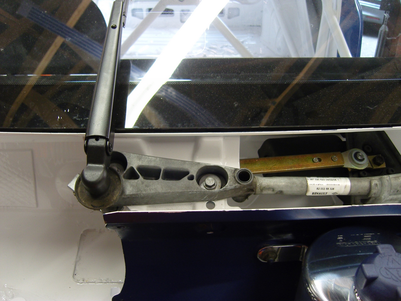

I then fitted my Storm single wiper kit. This was very easy and I just have to set the park on it once I get power to it.

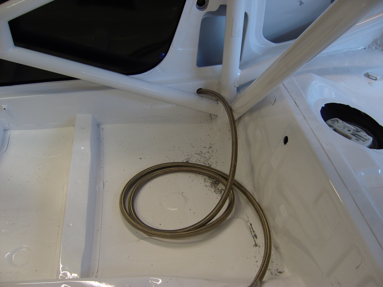

Lastly I started to route my fuel pipe. As you can see this is going through the sill but on reflection im going to run it down the centre of the car. I saw a nasty Golf T bone recently and it caught fire because his pipe was in the sill and got nipped up.
So that's it. Wheels next and I still can't decide between 15's or 16's and also what offset to go for. It seems the lower the offset number the larger the offset (wider track). So I guess an offset of around 20 and then I won't have to run spacers at all.

Nice work as always. love the false floor mate. Wheel wise, I thought you'd decided on 16's due to cooling? Not sure if you'll get away with using an offset of 20 unless you roll the arches out. Especially as i'd imagine you've dropped it a few cm on the KW.

Im sure this cant be right? Someone must have made a misstake in production, did you speak to K-tec about it? At K-tec website they are turned the wrong way as well.
Mine will be sent from K-tec today and I dont want them to look like that :dead: Function must be wierd to
I do love that flase floor, looks really good.
Mine will be sent off from K-tec today and I dont want them look like that :dead: Function must be wierd to
Yes they are the wrong, the handles dont fit in the orginal holes and when you pull the handle it hits the metal so you will need to cut part of your door away and attach the handle with a new bolt and nut.
It didnt matter too much with this cars doors as we were trimming the skins anyway, and we didnt have the time to mess about and send them back. Still look great tho :)
Re: Latest Update
Okay, so K-tec are aware of it anyway? I have no plan to cut my doors on to pieces to make them fit.
My Whiteline ARB arrived with an incorrect bush. Dropped an email to Whiteline in Australia and within a day they had contacted the UK distributor and got a replacement bush in the post to me. Got handled well, but it shouldn't have happened in the first place.
I'm unsure if they know about it but if you actually look at the middle picture of the door cards it shows that the handle mount is upside down
http://www.k-tecracing.com/show_product.asp?id=3811&catid=25&appid=2&pic=4
I'm 100% sure they DO NOT fit unless you hammer the sh*t out of the door to push the metal back and drill a new hole for the handle.
Yes Sean sent me out a new one same day. Ktech are and have been VERY good at support when we get these little manufacturing incidents to deal with and thats what I look for in a company as I do understand that happens, just seems to happen a lot to me :(

Love that false floor - I need to do that in mine
I've found since the carpets come out I get bad ankle ache after an hour or 2 driving - I put a box under my foot last time I was driving and it was LOTS better.

I will get him to make some at 25mm too just in case 35 is to high. This is the driver side fitted using M8 bolts into the spacers. Mark.
So all spacers are 35mm? In that case I guess the alu plate is slightly bent to fit?
Superb update, Some really nice work there. All this spare time Chris has his should be done by now :P
Re: Latest Update
Yes it is although it's hardly noticeable. My original idea was to mount with all 35mm and then get them adjusted accordingly but both Chris and I thought it looked ok once it was in place so im not sure I need to now. The passenger side one is beng altered as one of the spacers needs to be 50mm, the front right one.
The floors came from larkspeed for £40 I think.
Okay thanks,
I consider making something similar beacuse of the beam on the drivers side floor.
If theres trouble with the door cards I think Ill go for these instead. They have some other parts you may be interested in as well ;)
http://s430.photobucket.com/albums/qq22/team_hink_racing/Carbon%20delar/Carbon%20parts%20Renault%20Clio/
Both my floor beams were removed when they fitted the cage for me. Just drill em out with a spot weld drill bit. Chrispy loved that little tool of mine, till he busted it that is :)
