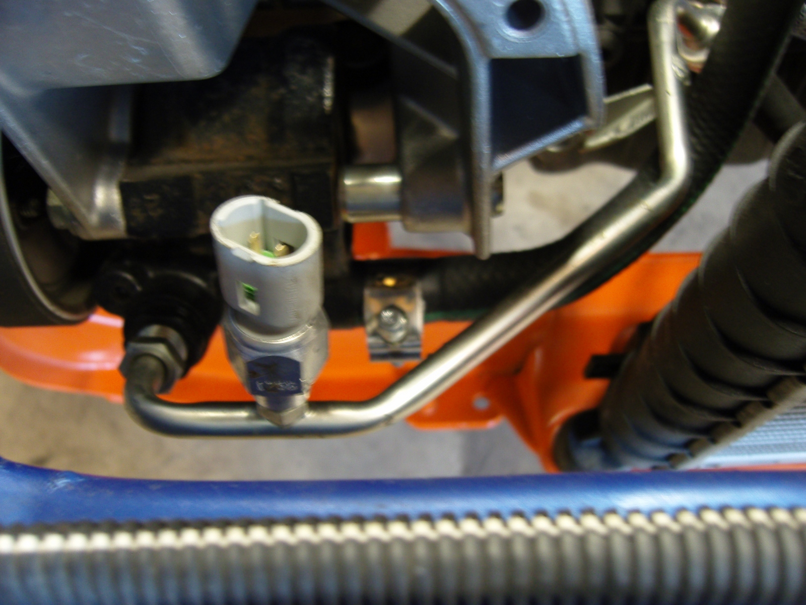

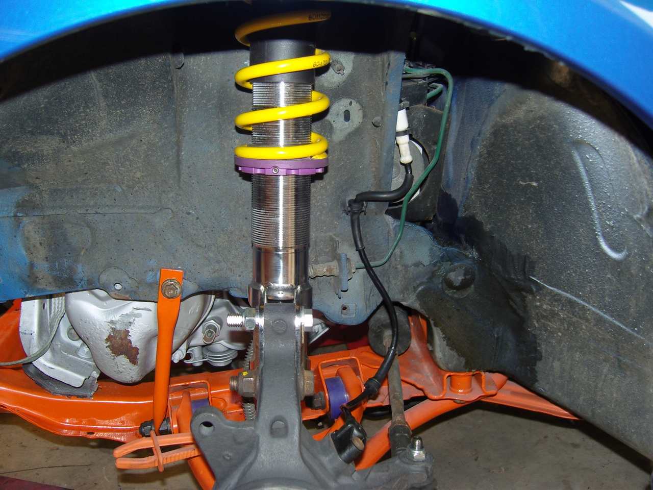

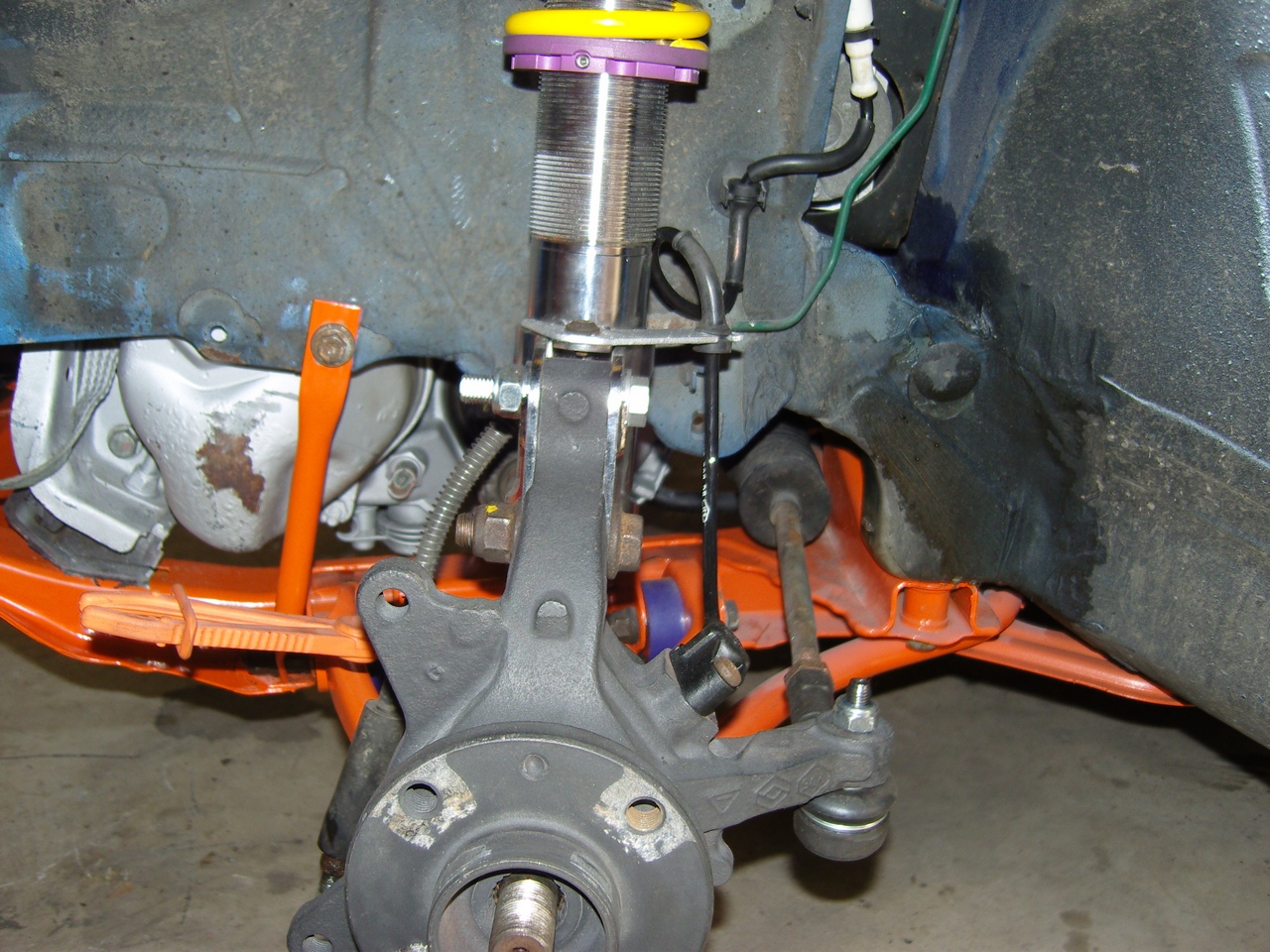

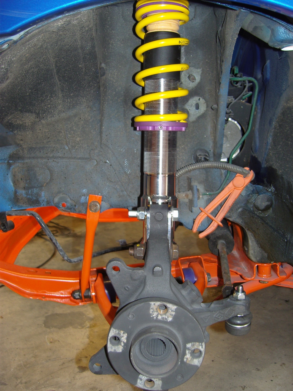

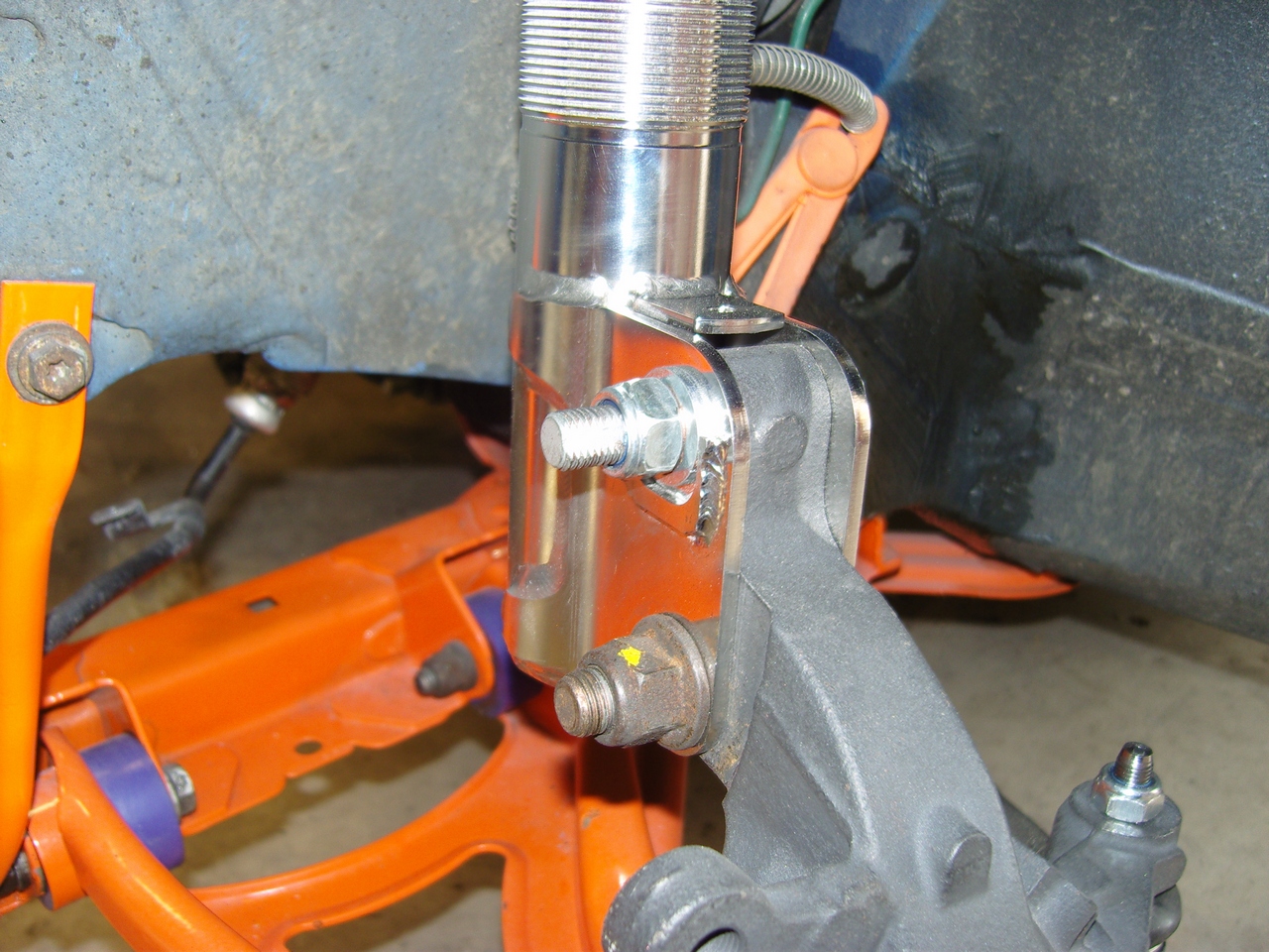

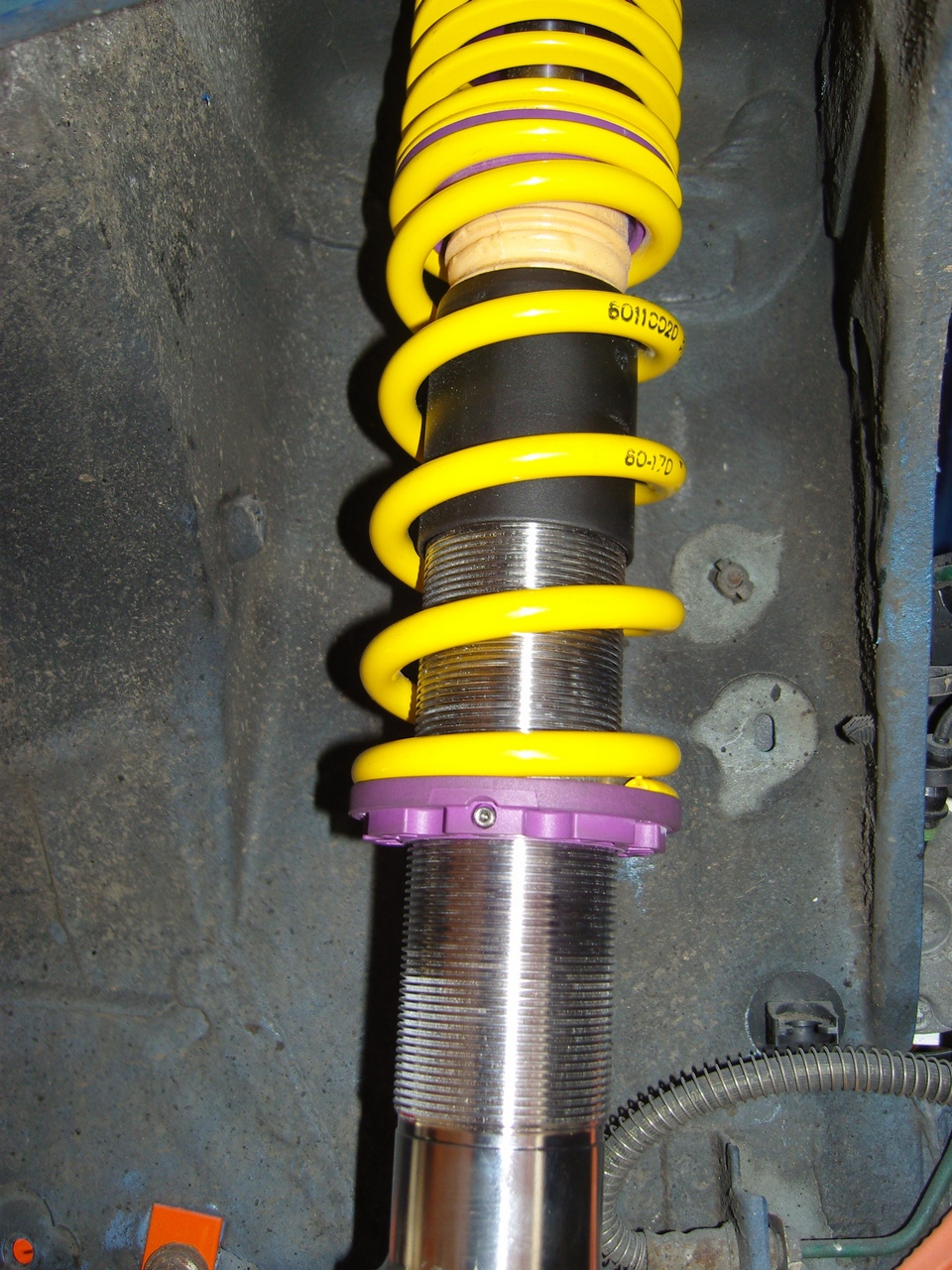

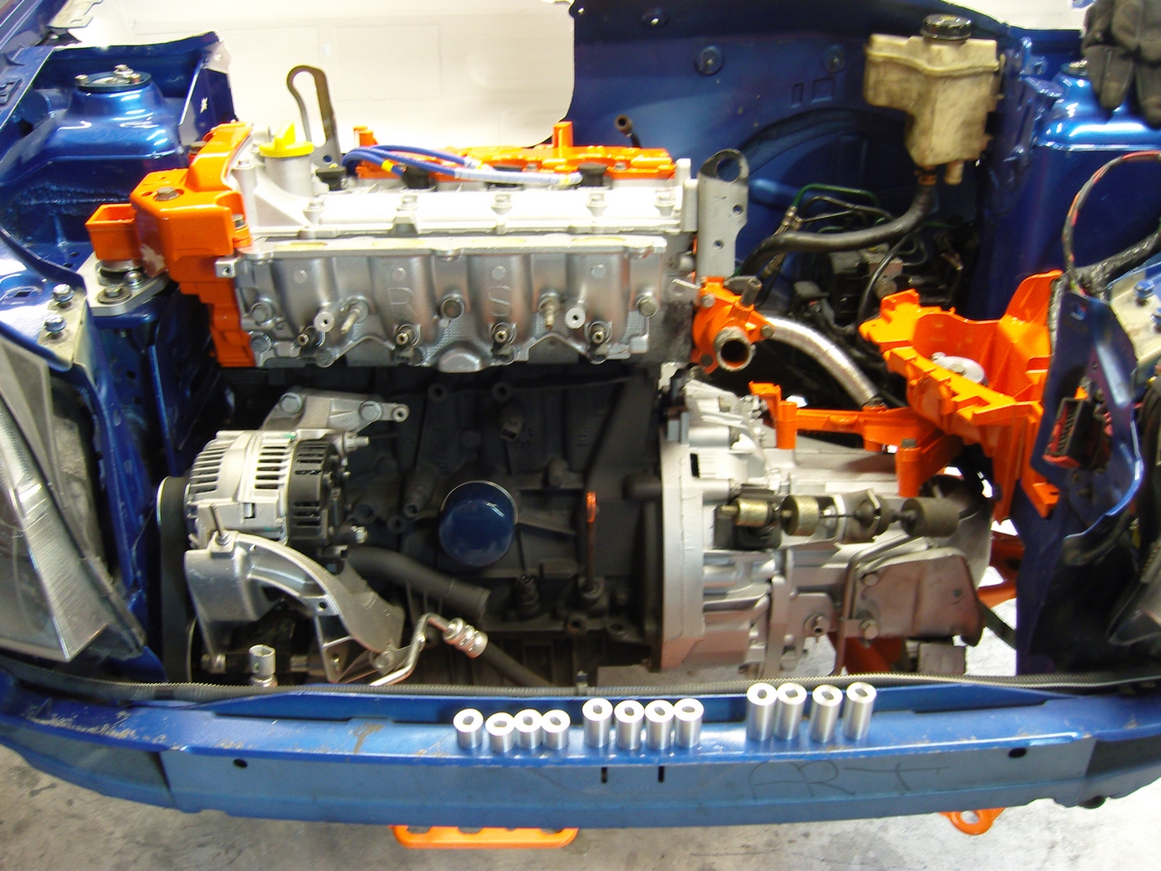

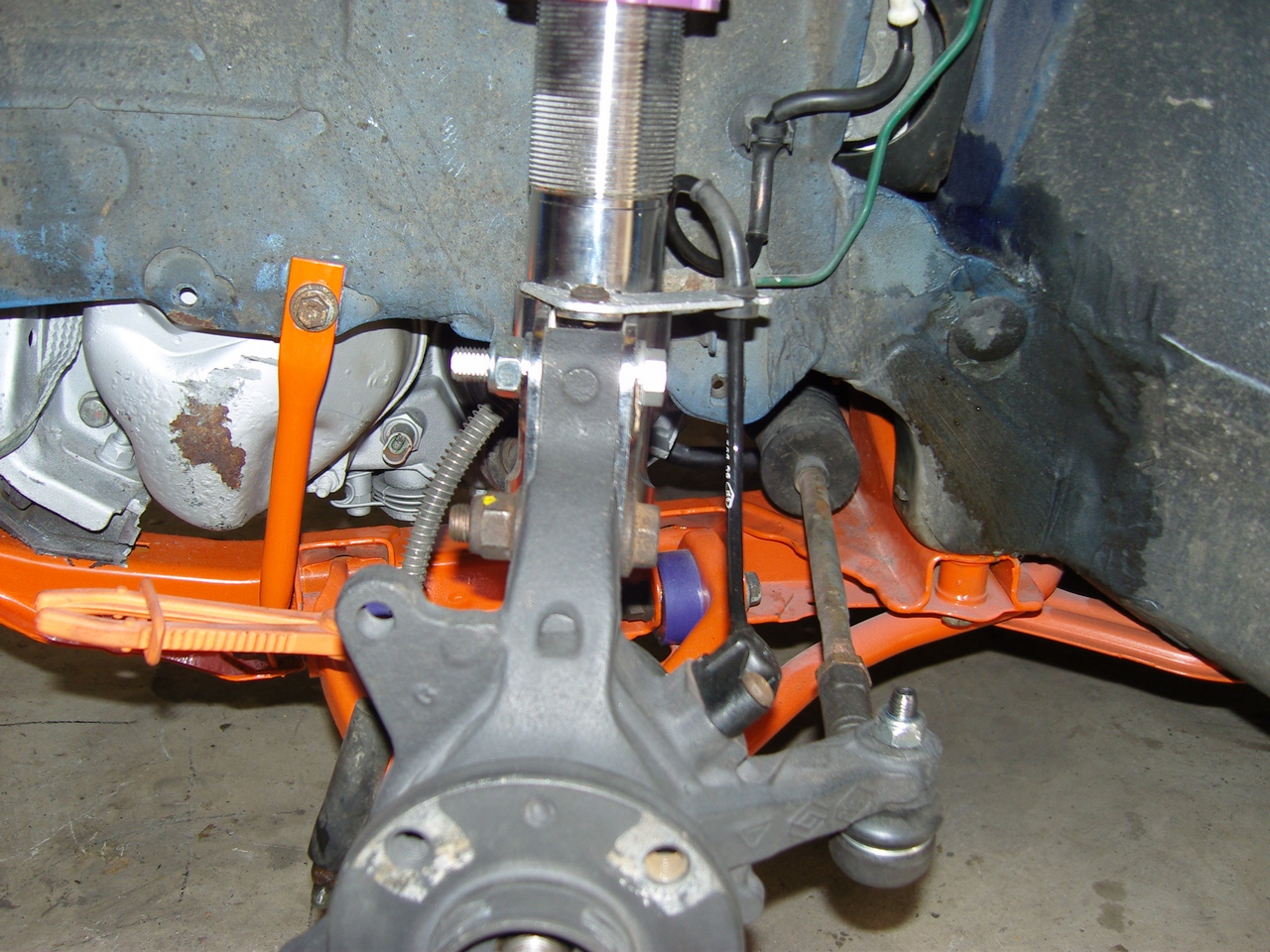

First up are some shots of the front suspension in place and my new ABS sensors. The old ones were welded in place and had to be chiselled out.

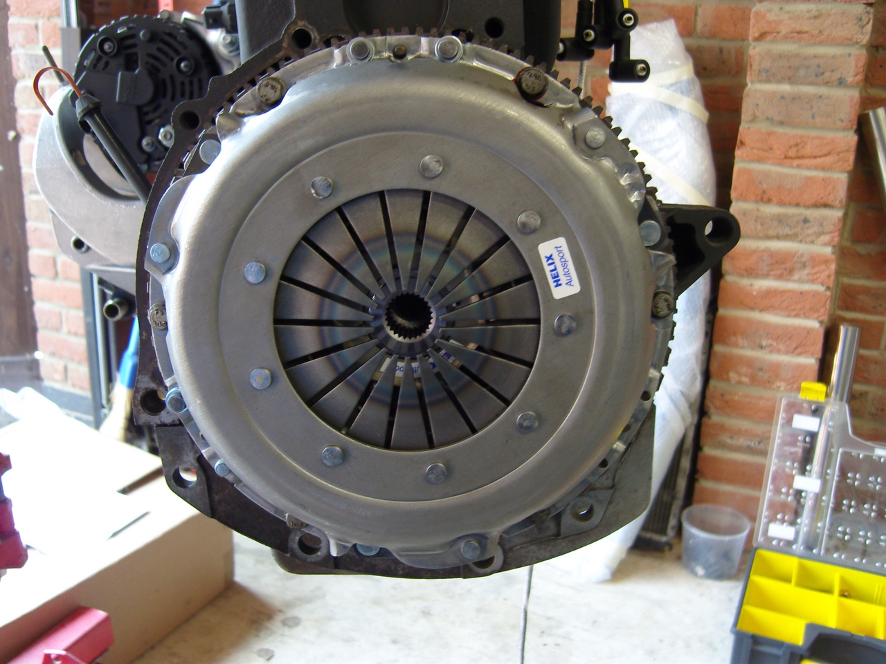

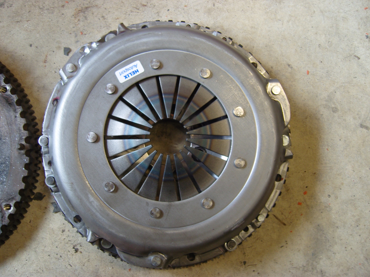

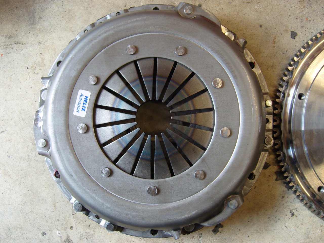

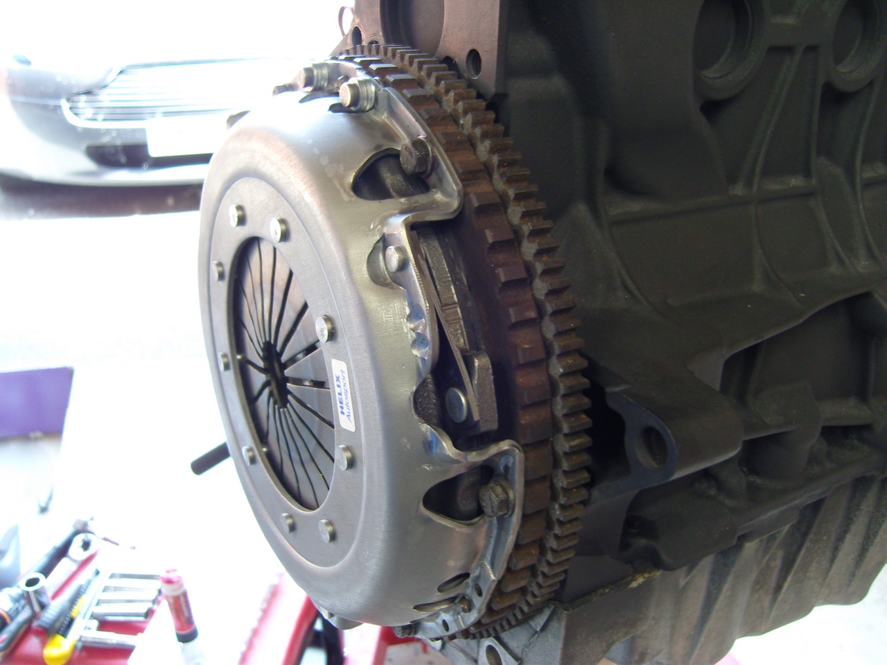

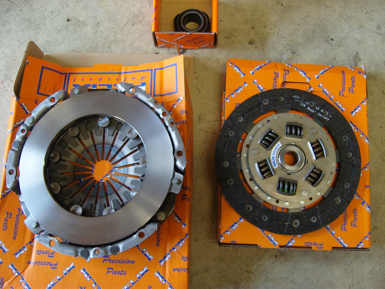

Next I thought I would put my new Helix organic clutch on. This clutch was grown on a bio farm it seems and will make me healthy.

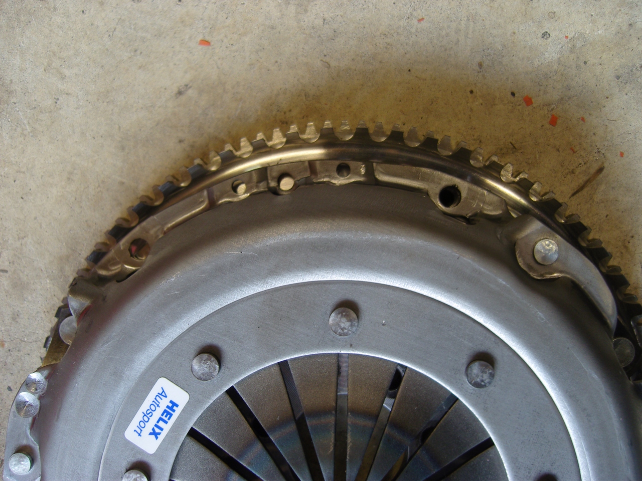

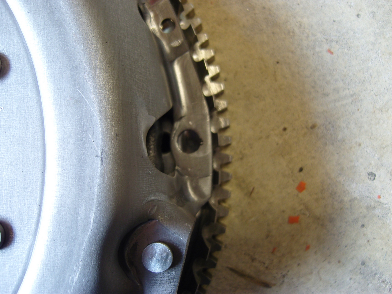

Sadly when I went to put the helix on my nice flywheel it did not fit as you can see the cover is too wide for it
So I put my old flywheel back on for the time being and until Matt and I can investigate this.

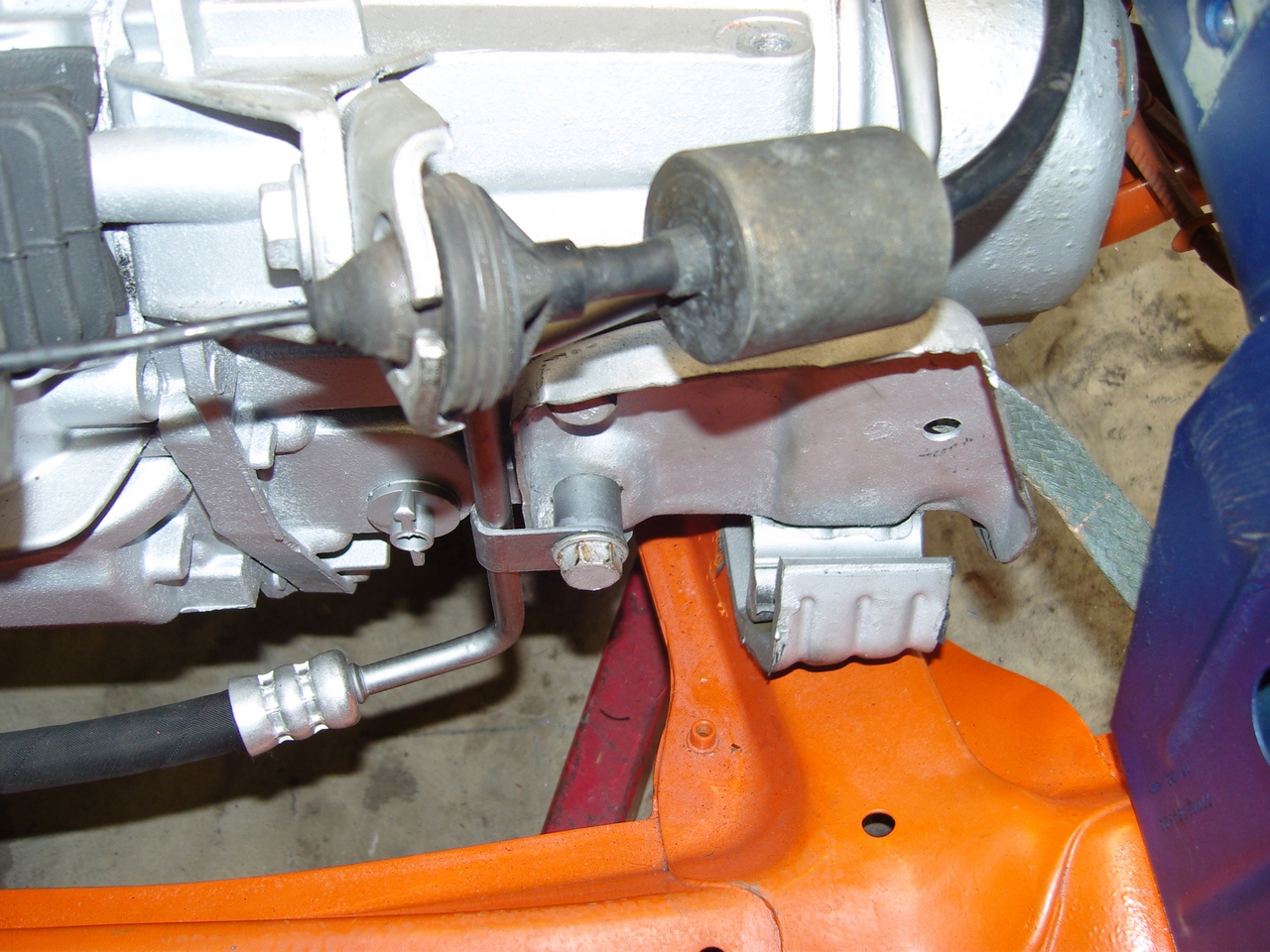

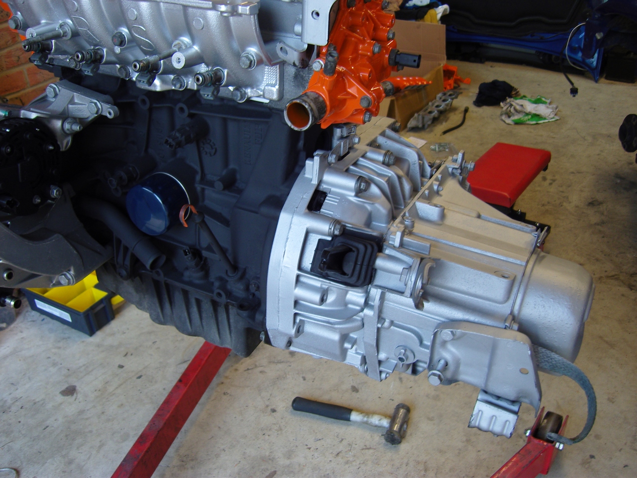

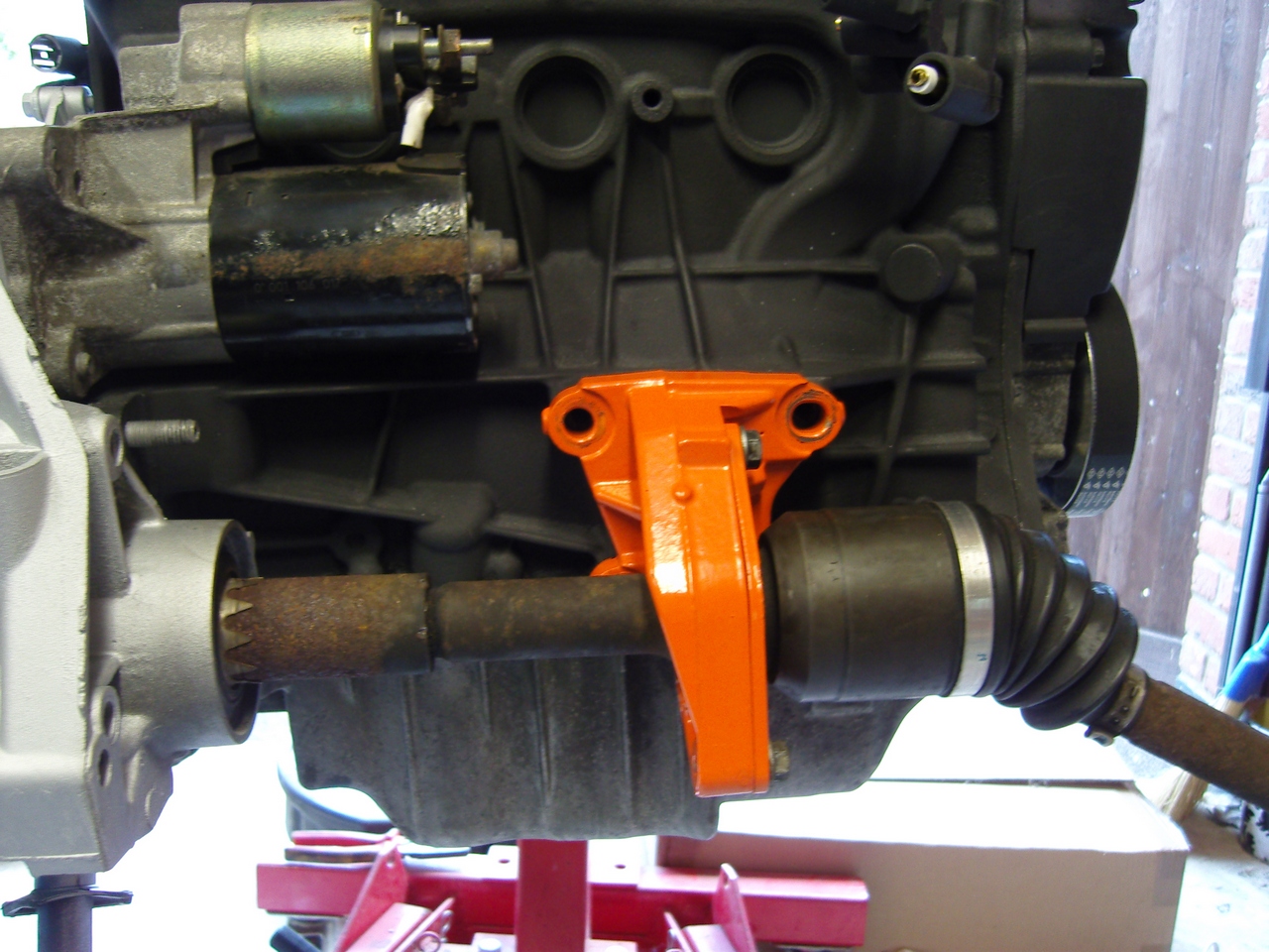

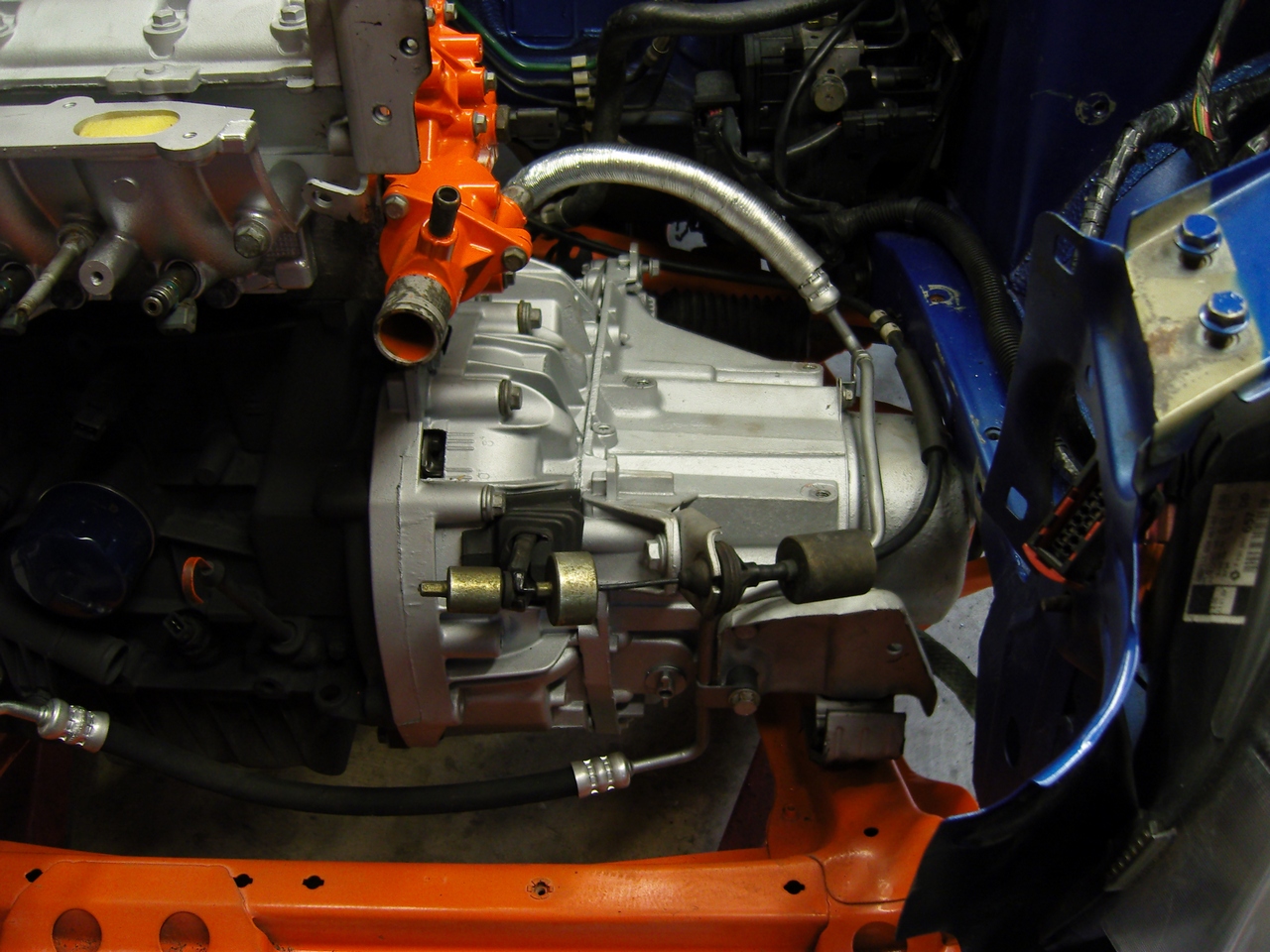

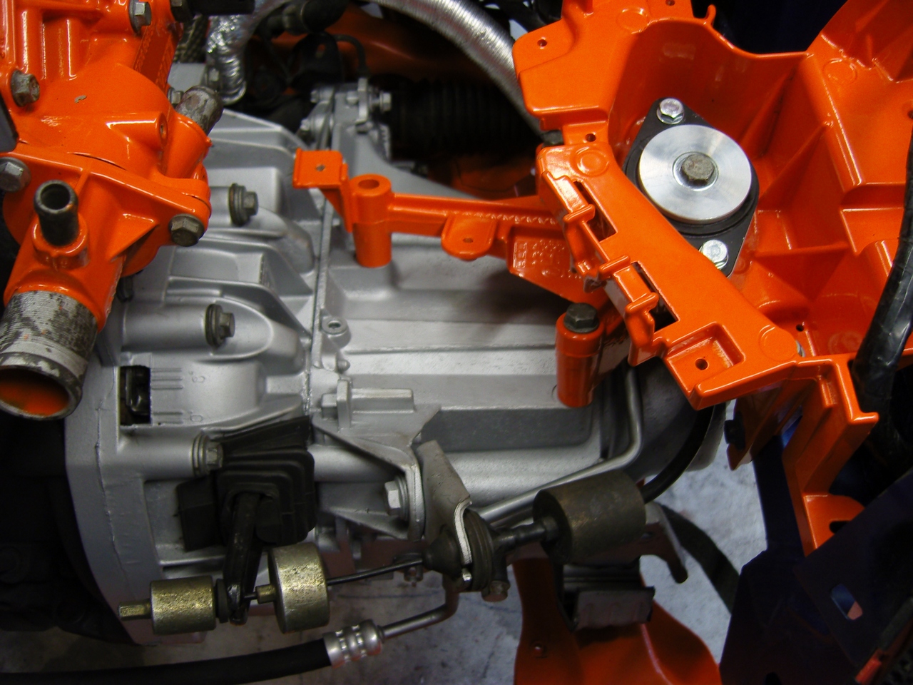

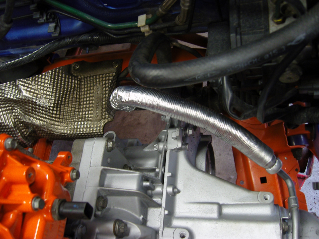

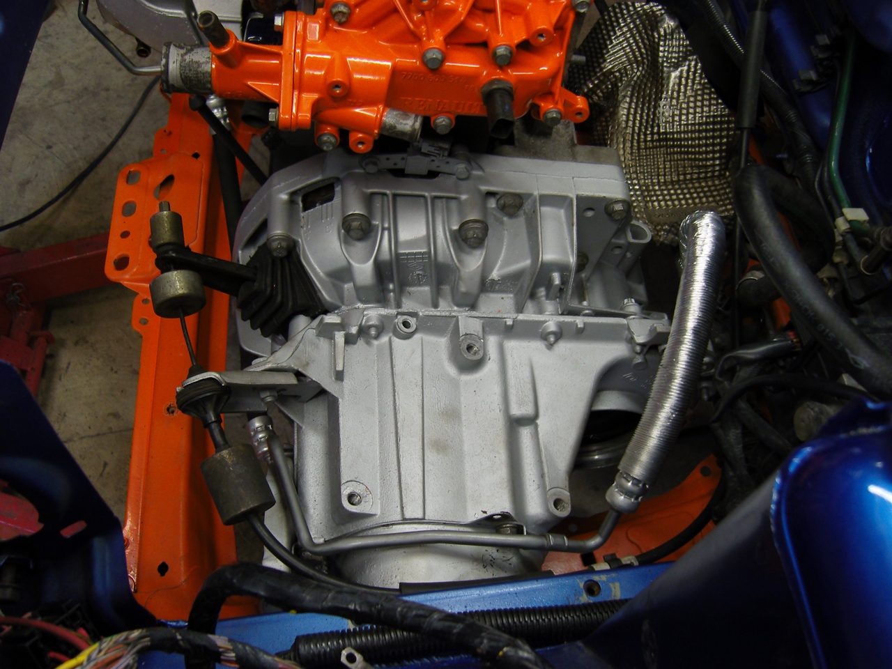

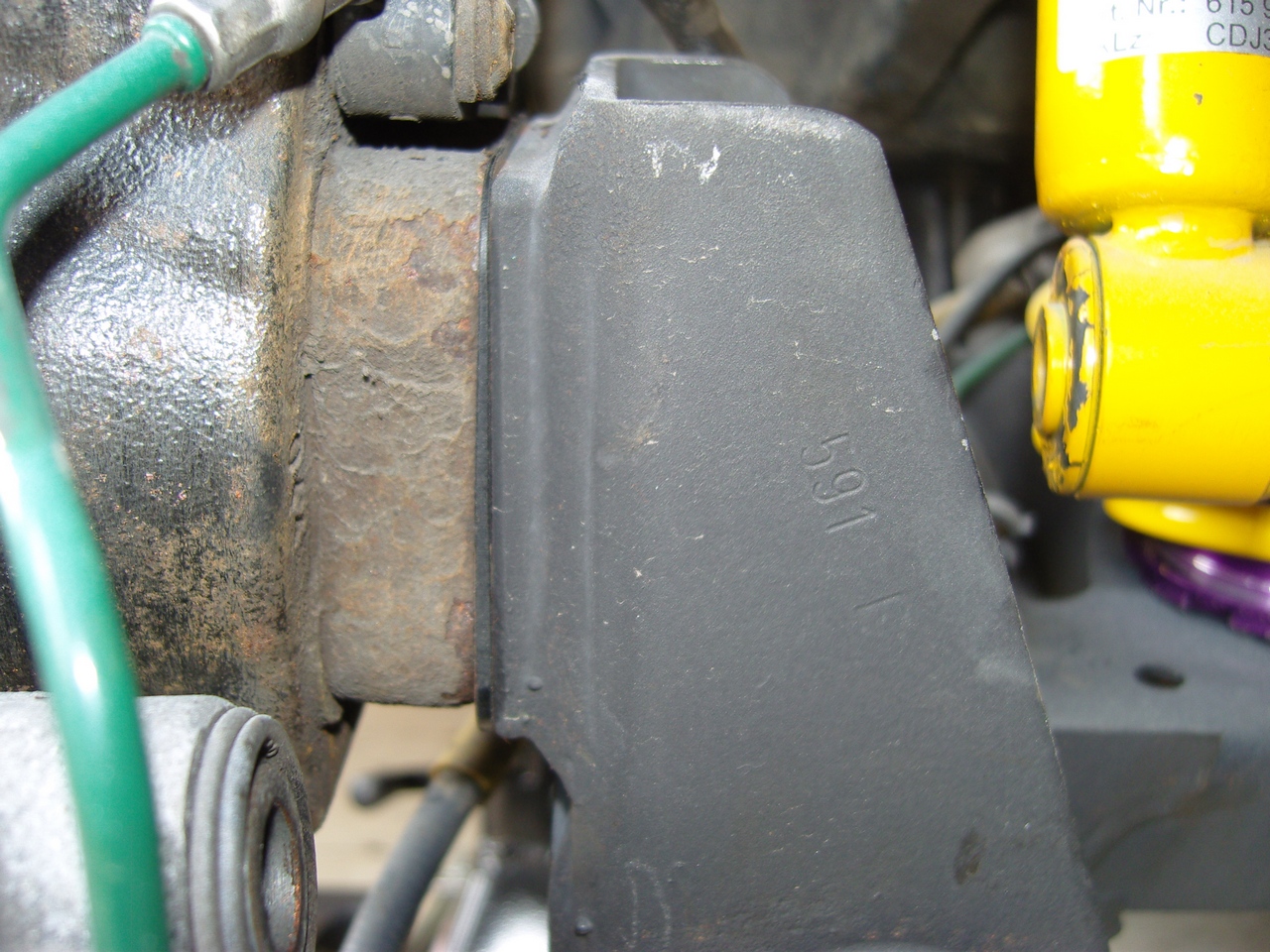

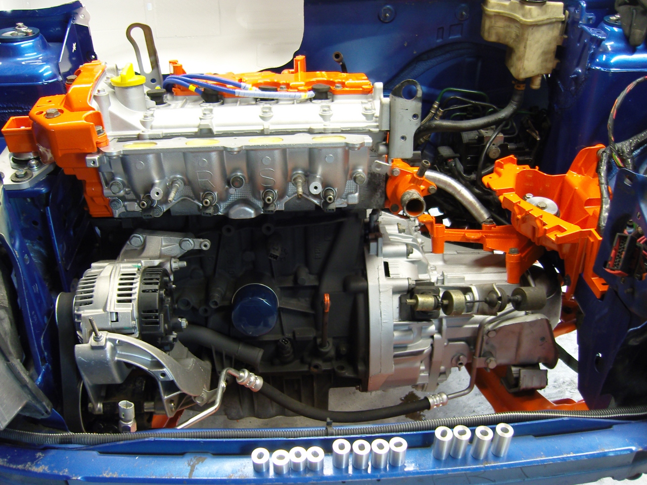

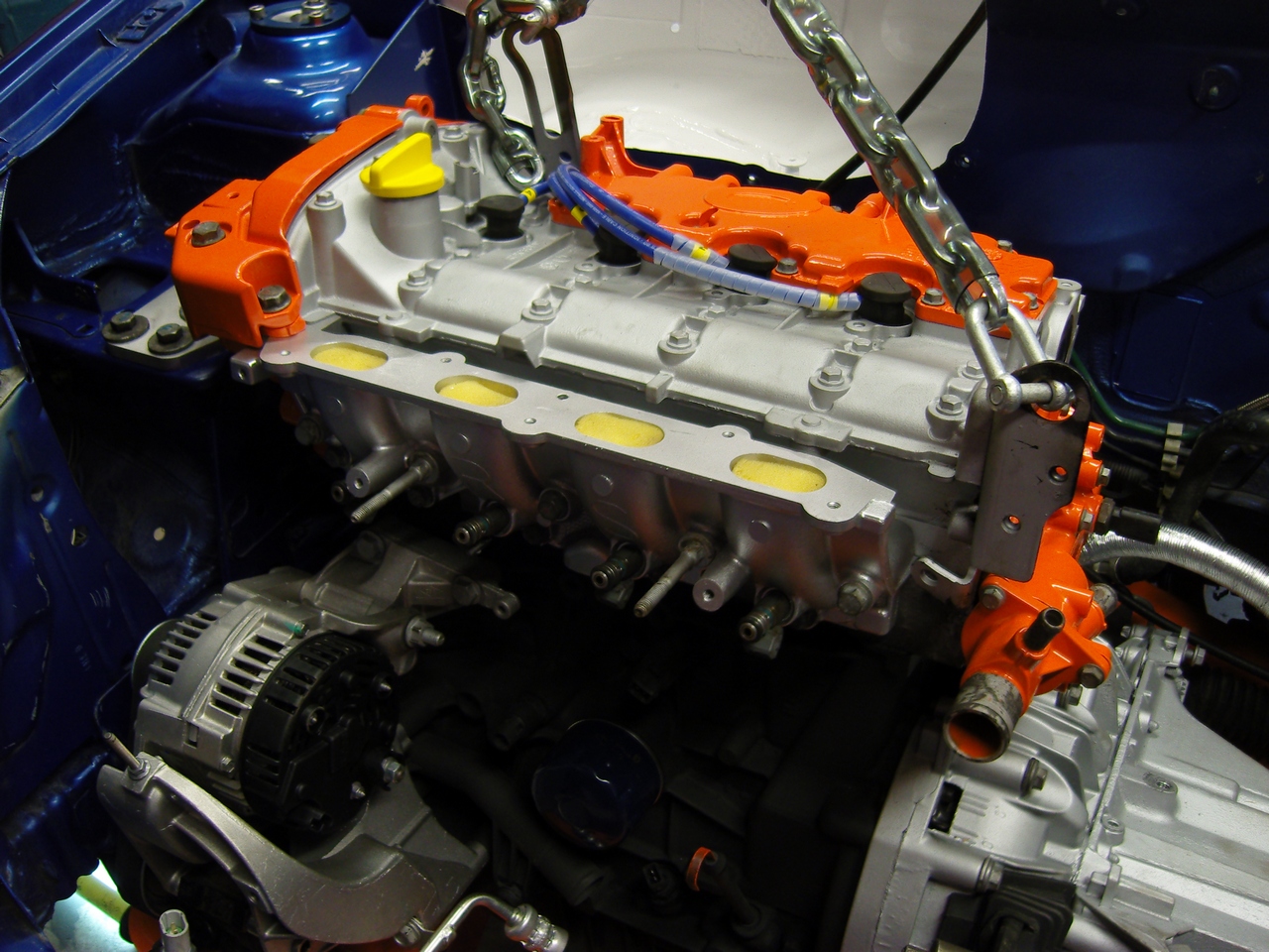

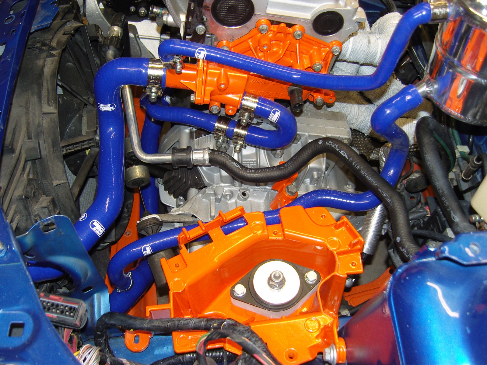

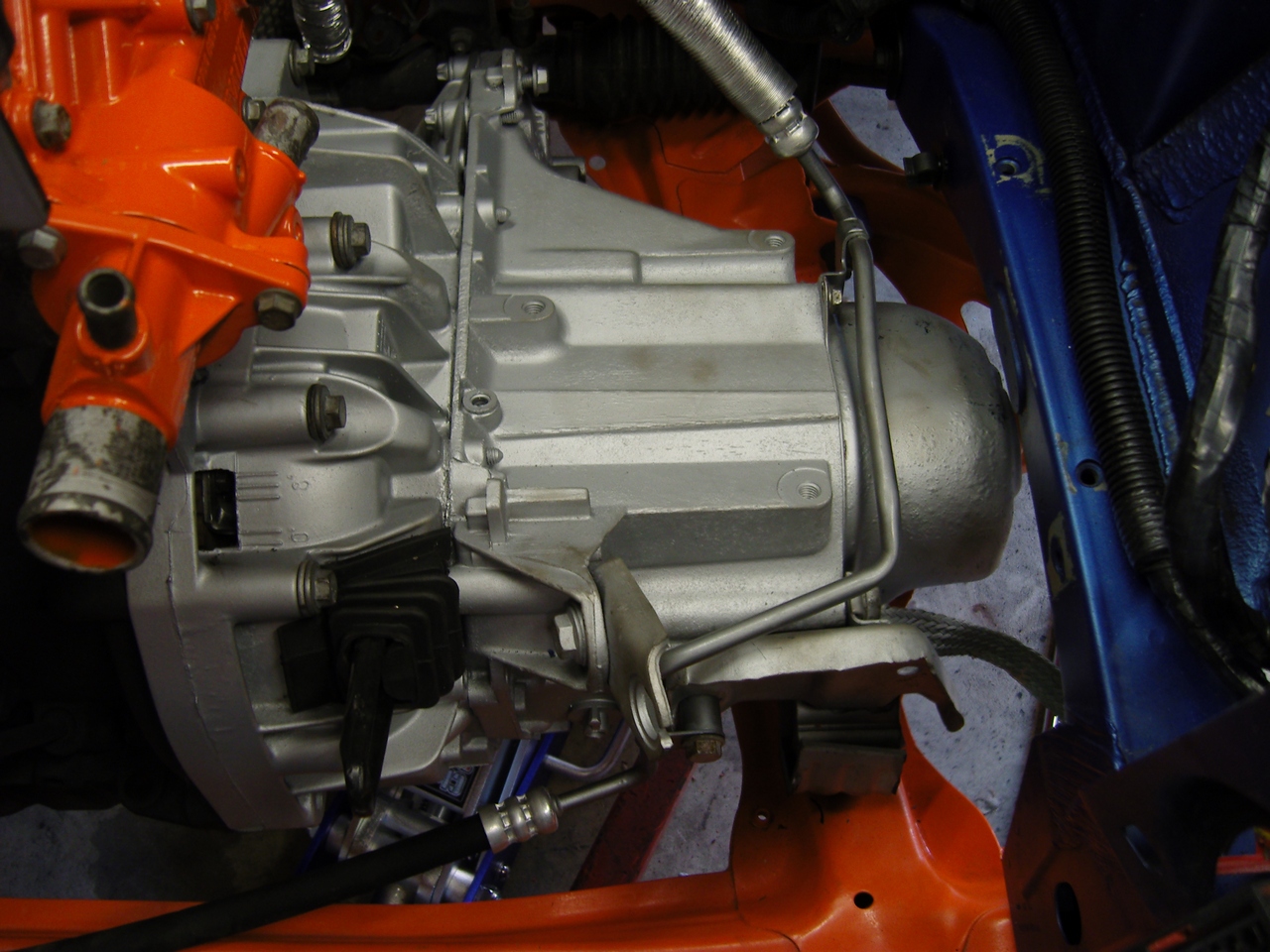

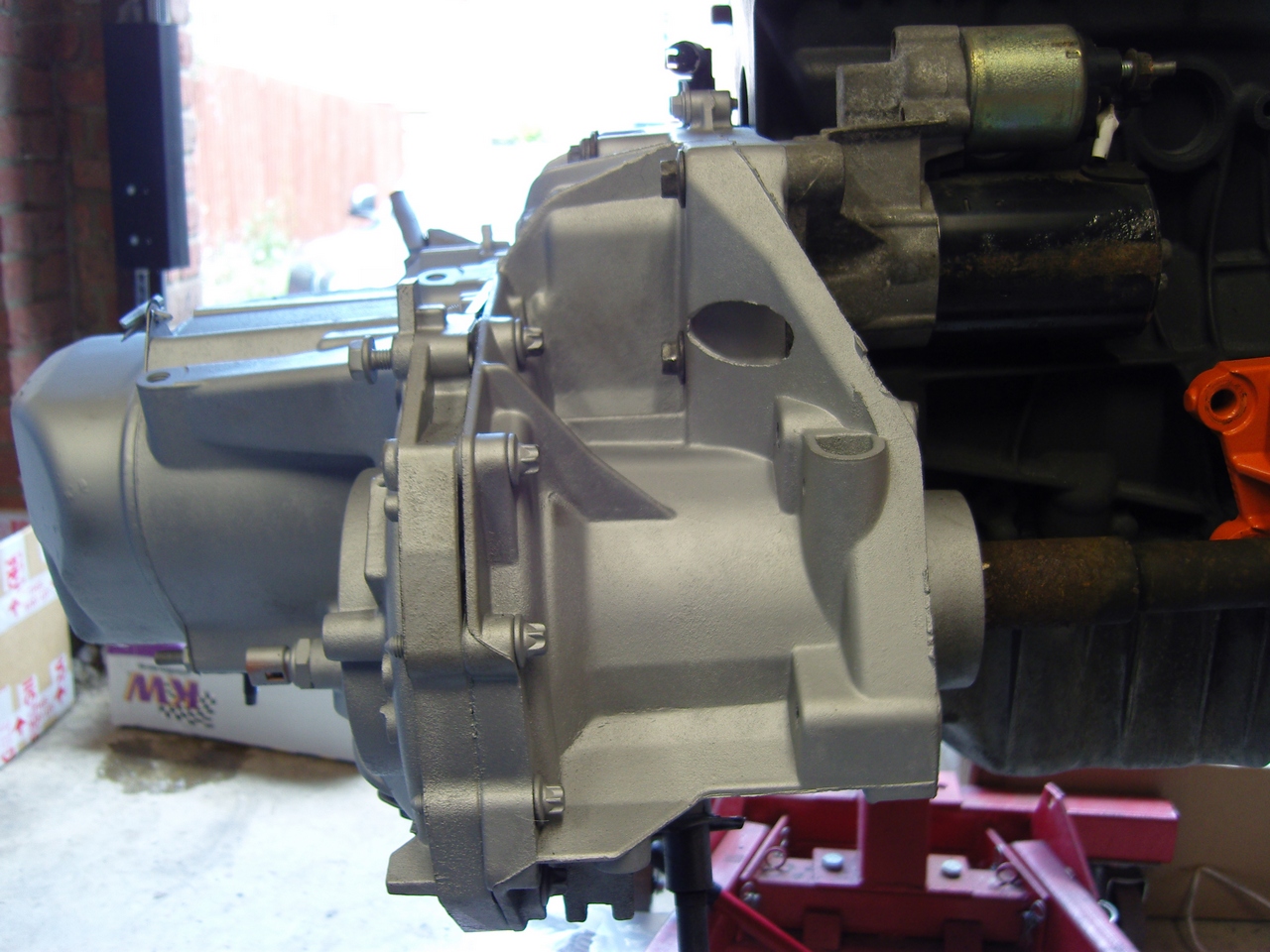

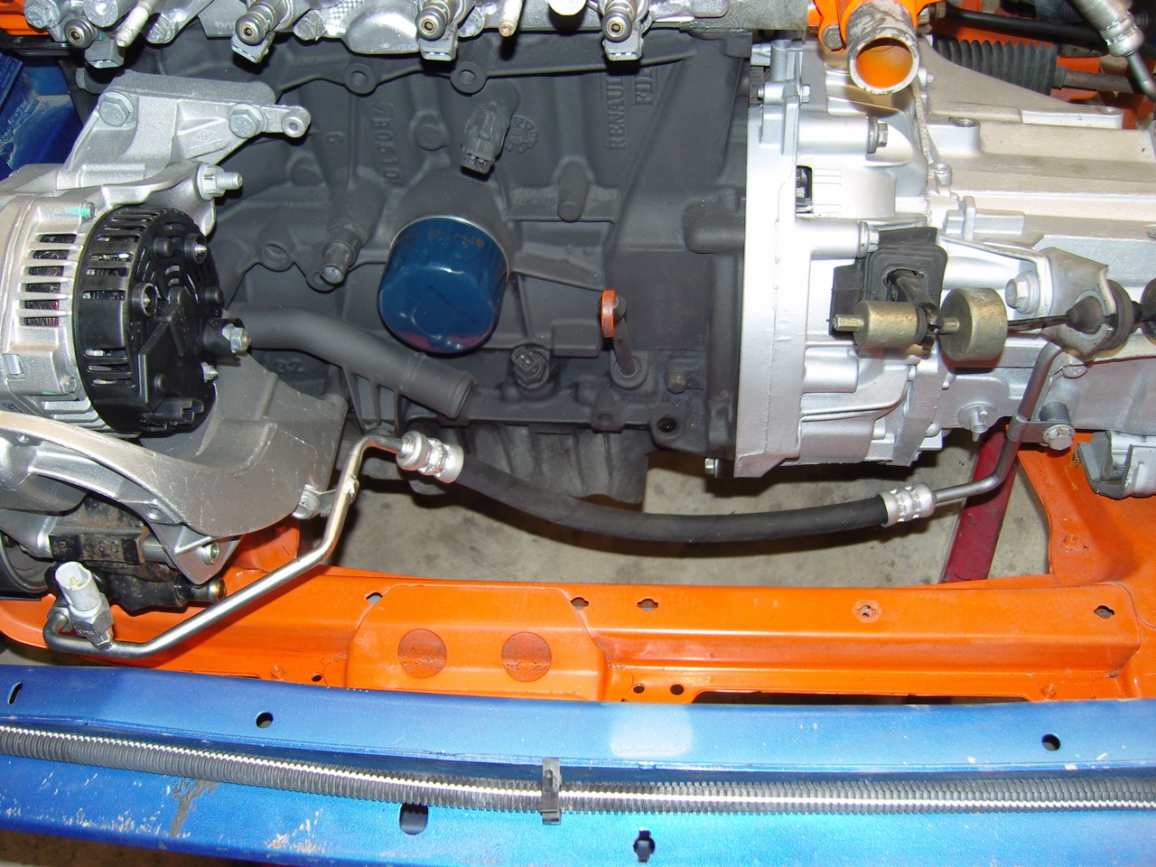

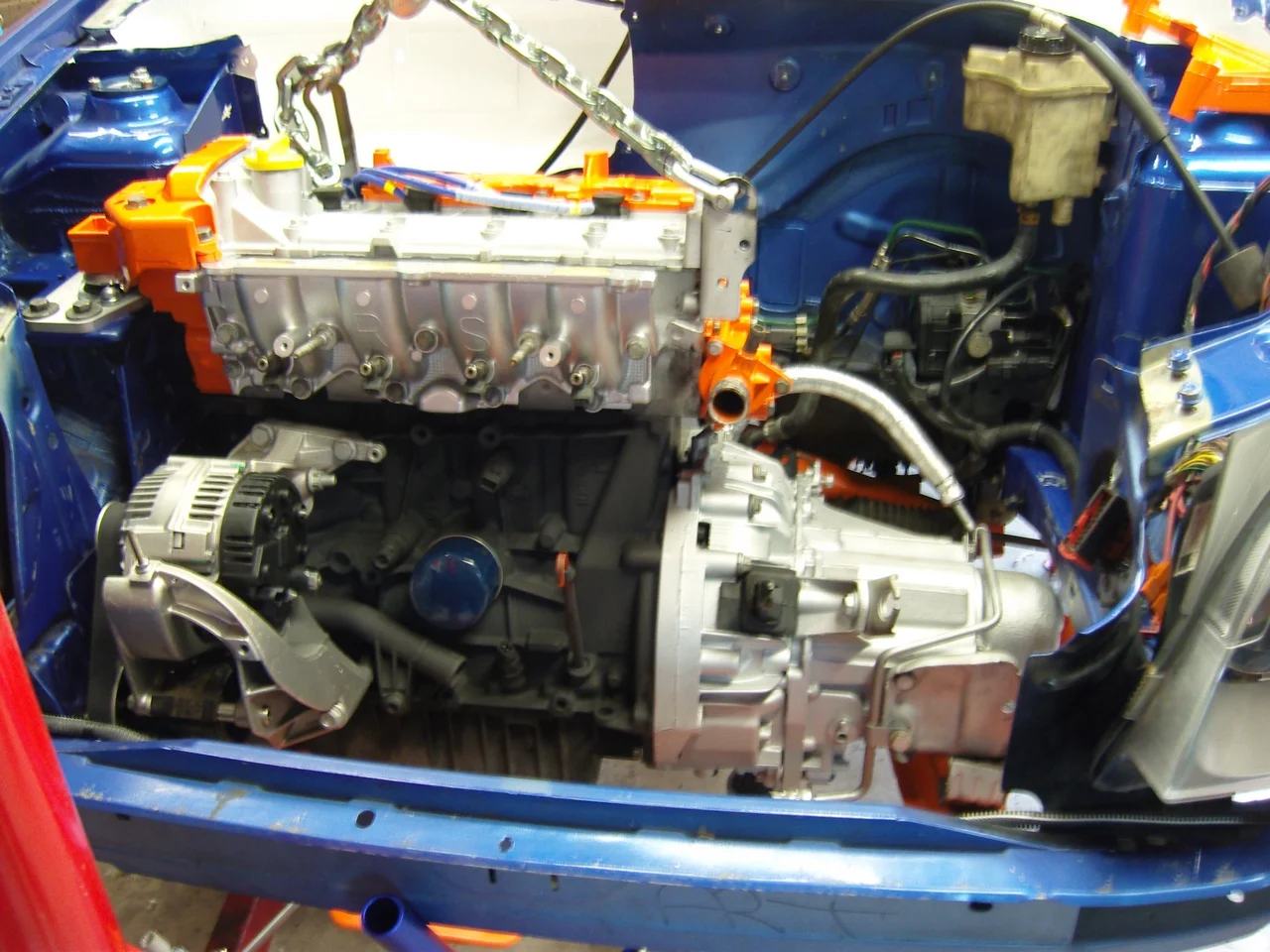

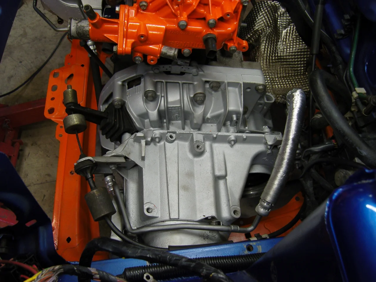

Next up I put the gearbox on the enigine out of the car. I wanted to try putting the engine in with the gearbox attached to see if I could do that. It worked thankfully with the right angle and also by taking the lower gearbox mount off.

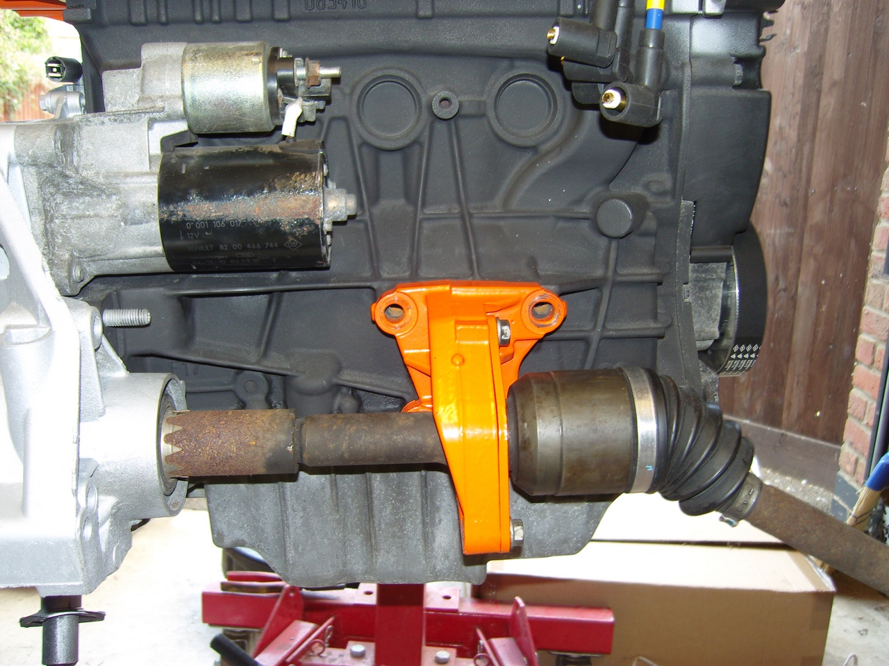

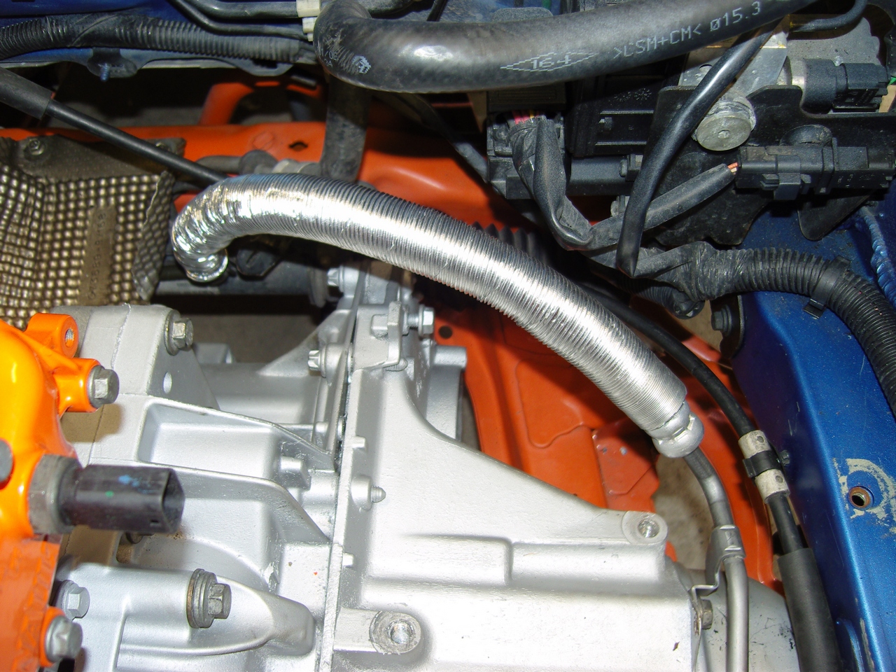

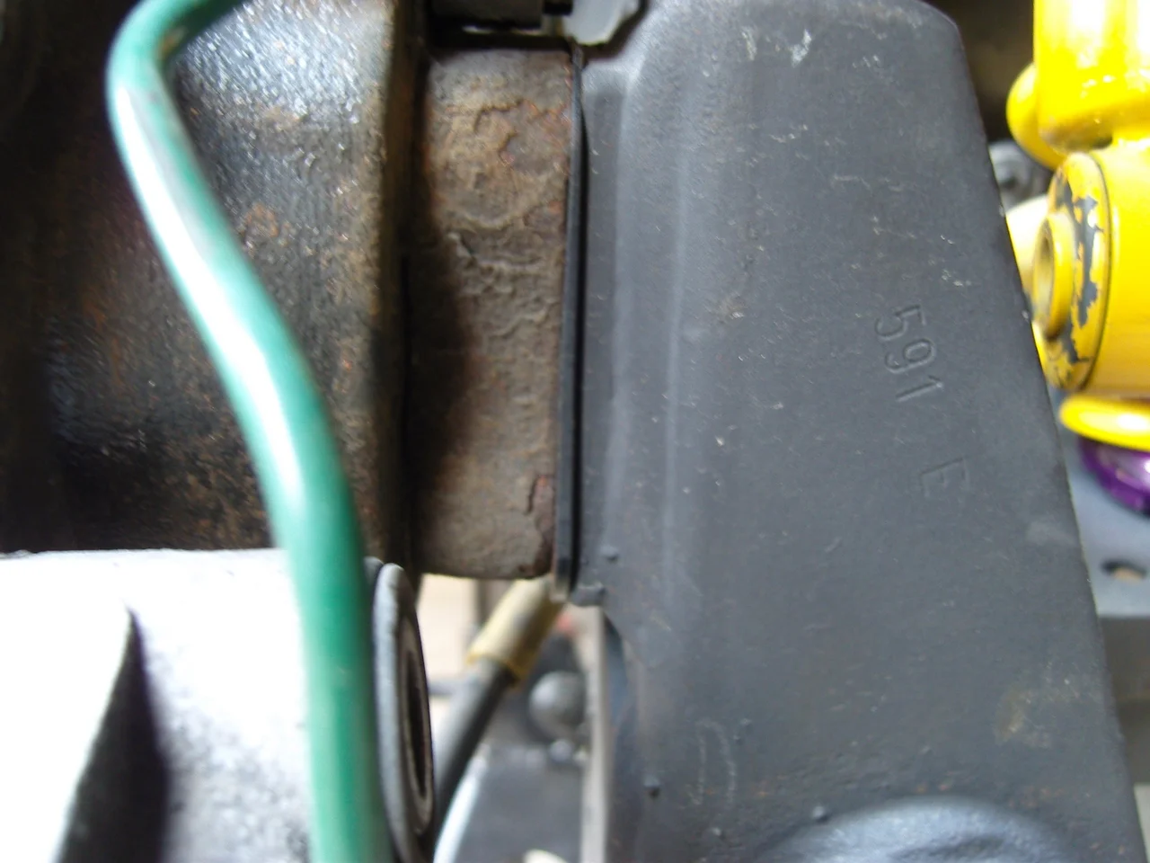

I also test fitted the driveshaft to make sure it was not tight anywhere.

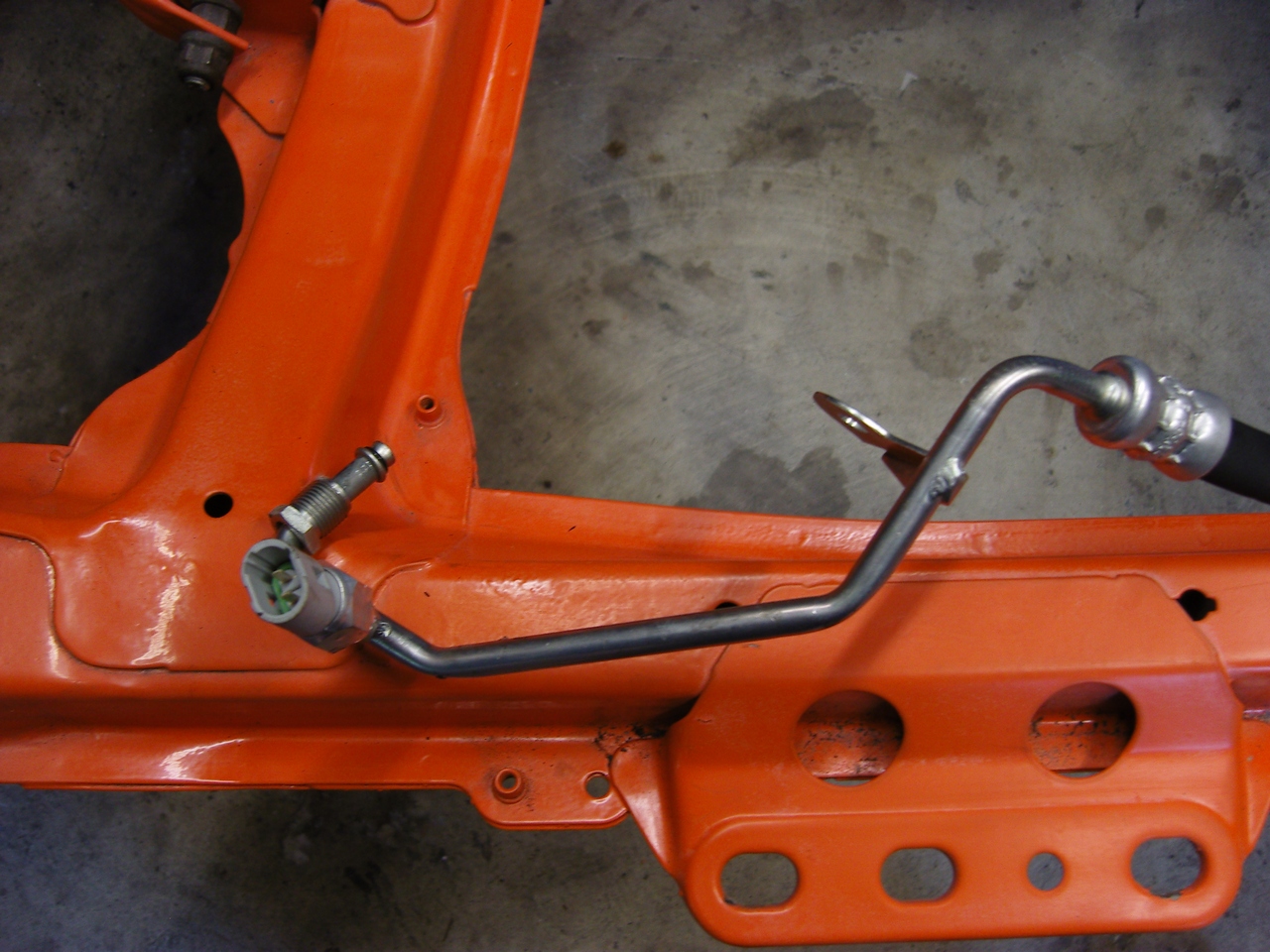

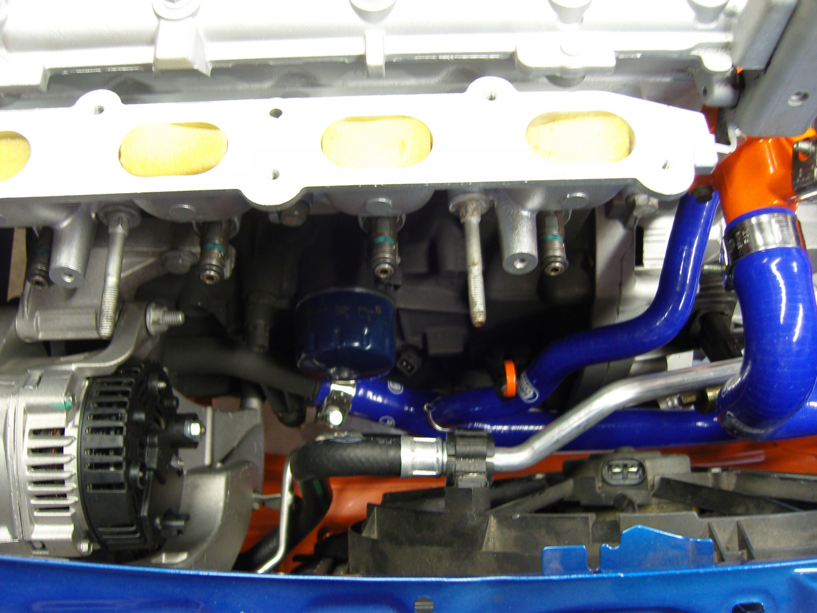

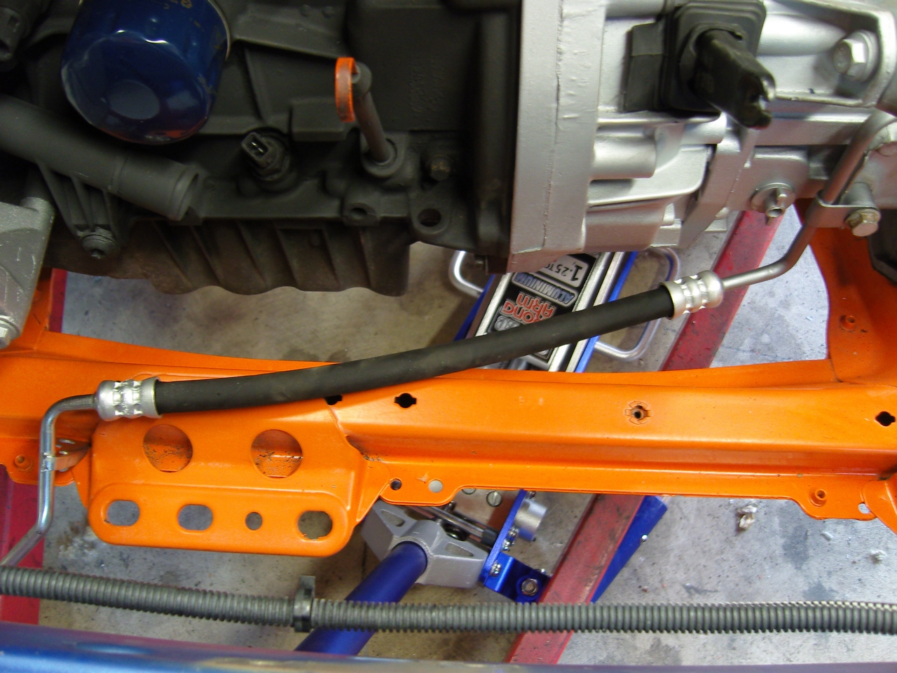

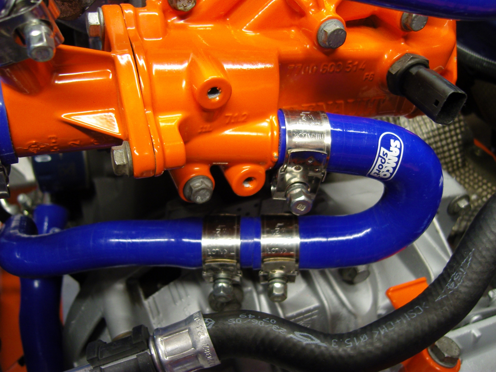

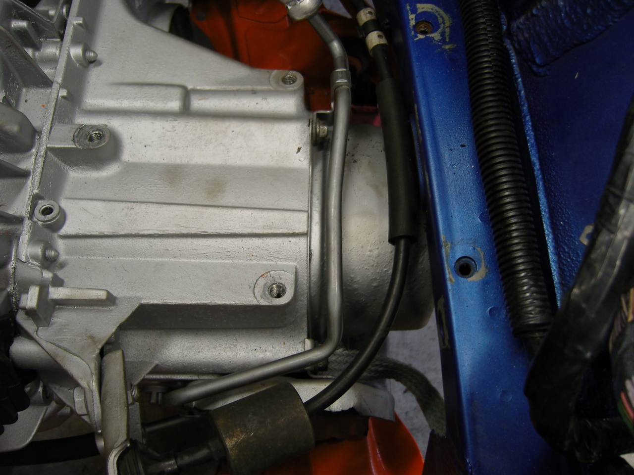

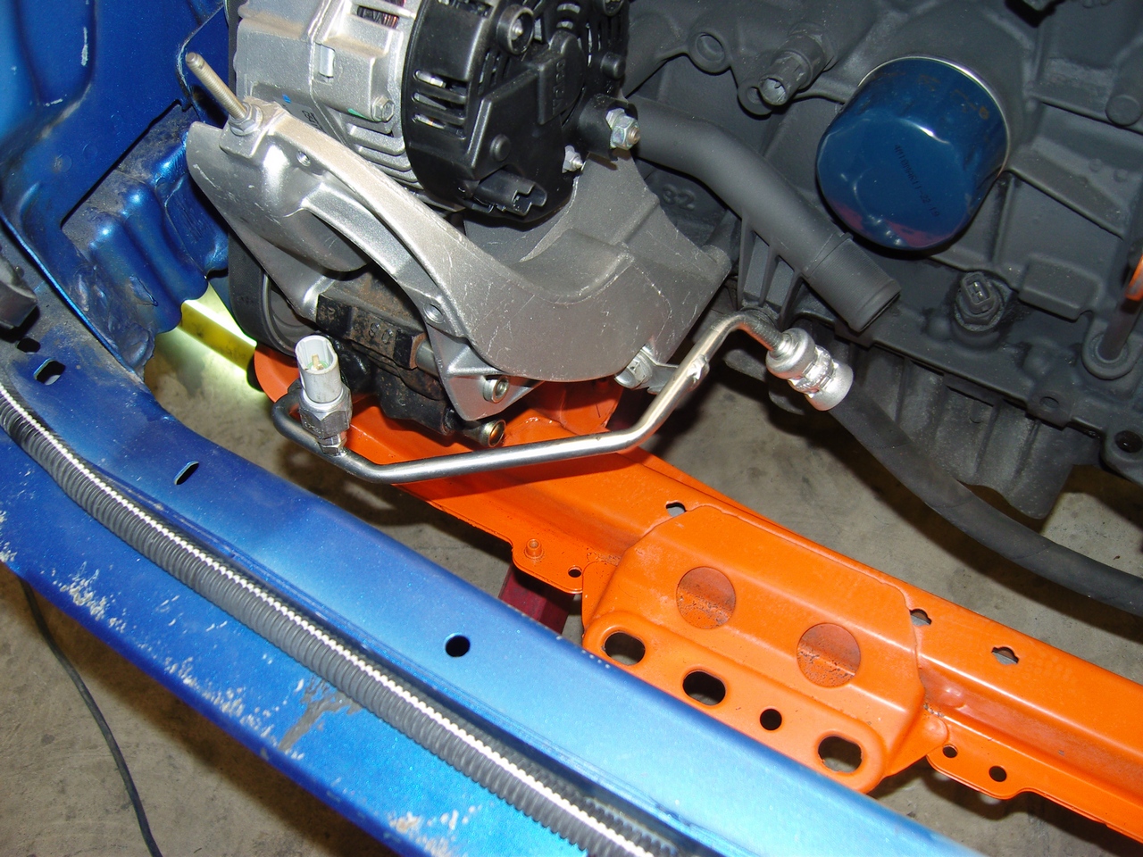

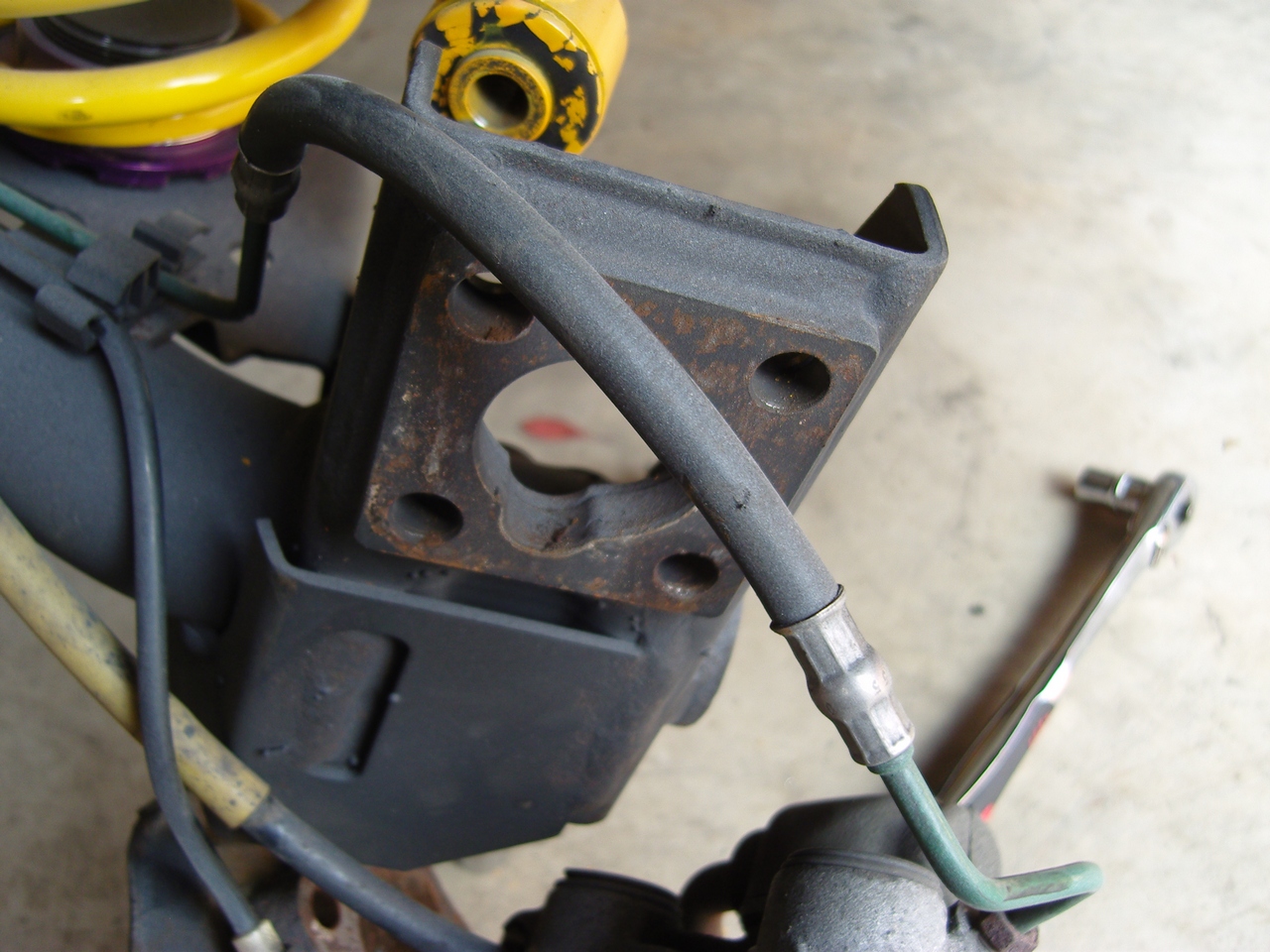

I also fitted the new cup hydraulic pipe although had forgotten to order both pipes doh, the other one is coming this week. These pipes of course fit as designed and so don't need bending. However they are £200.

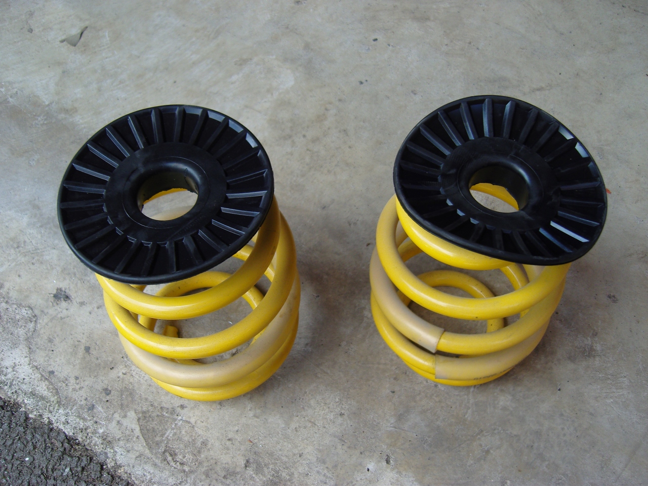

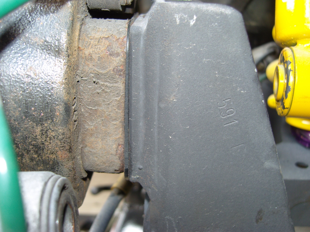

Ok lets put those rear spring rubbers on and also my rear camber shims too. Those rubbers were £80 and will teach me not to chuck stuff out so fast.

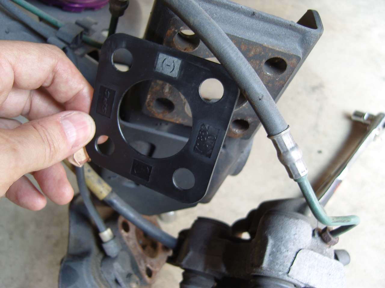

My camber shims are 1 degree so I shall see how we go with those first.

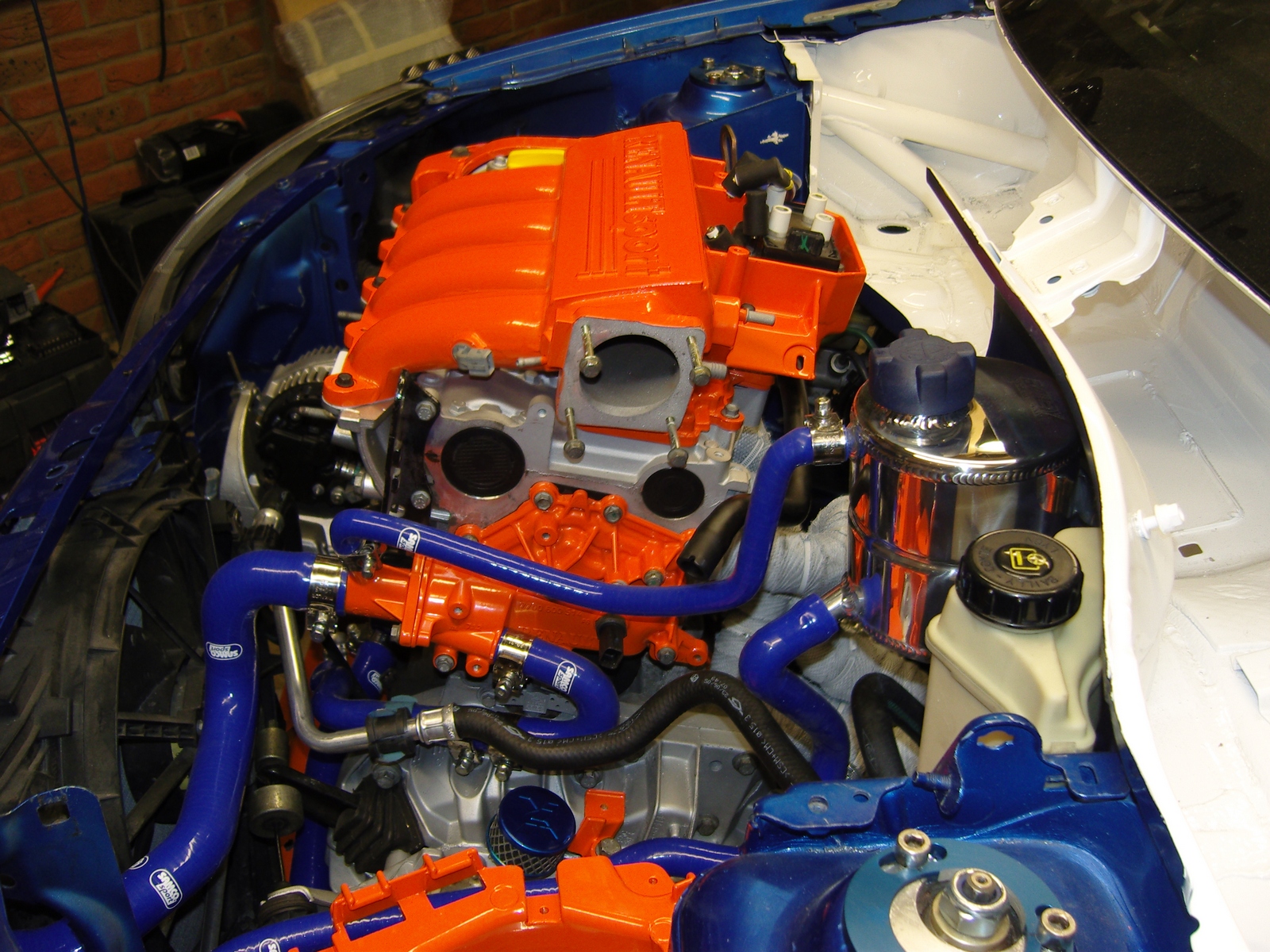

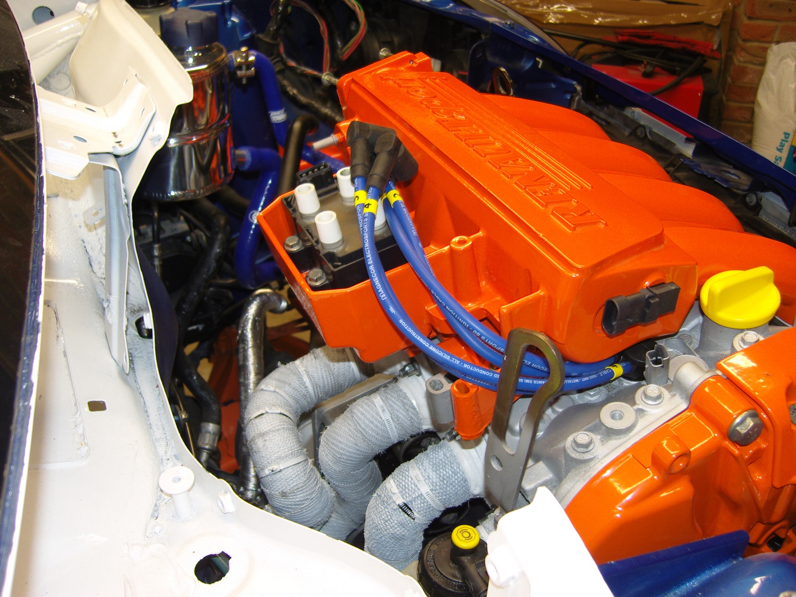

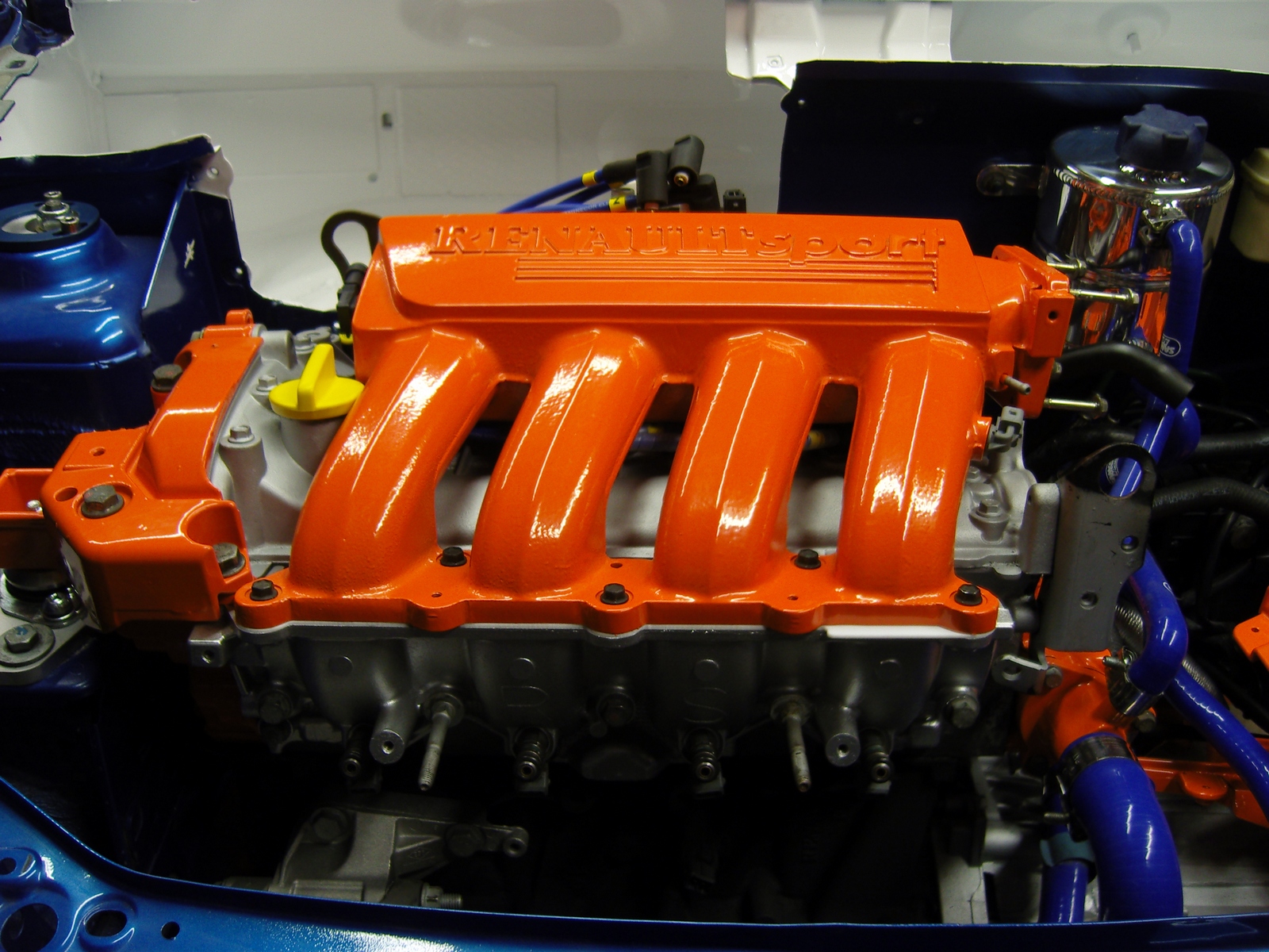

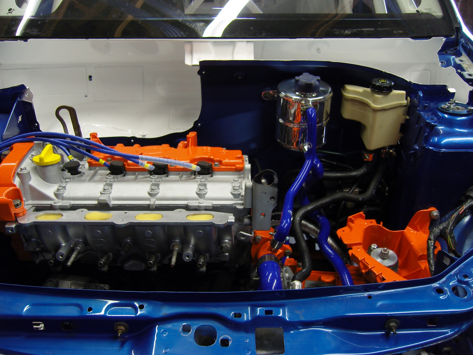

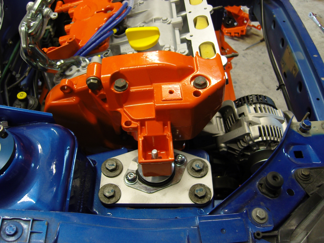

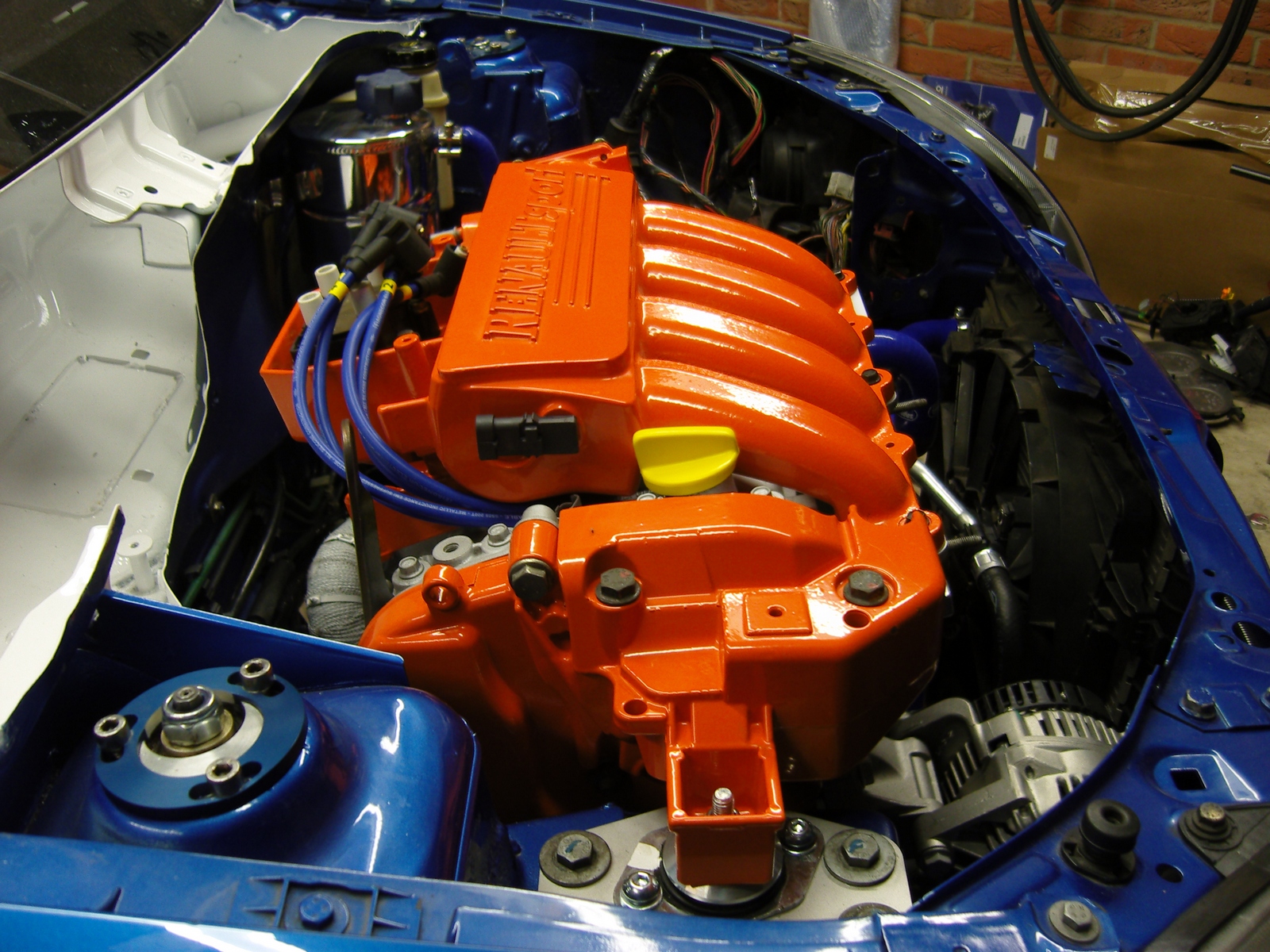

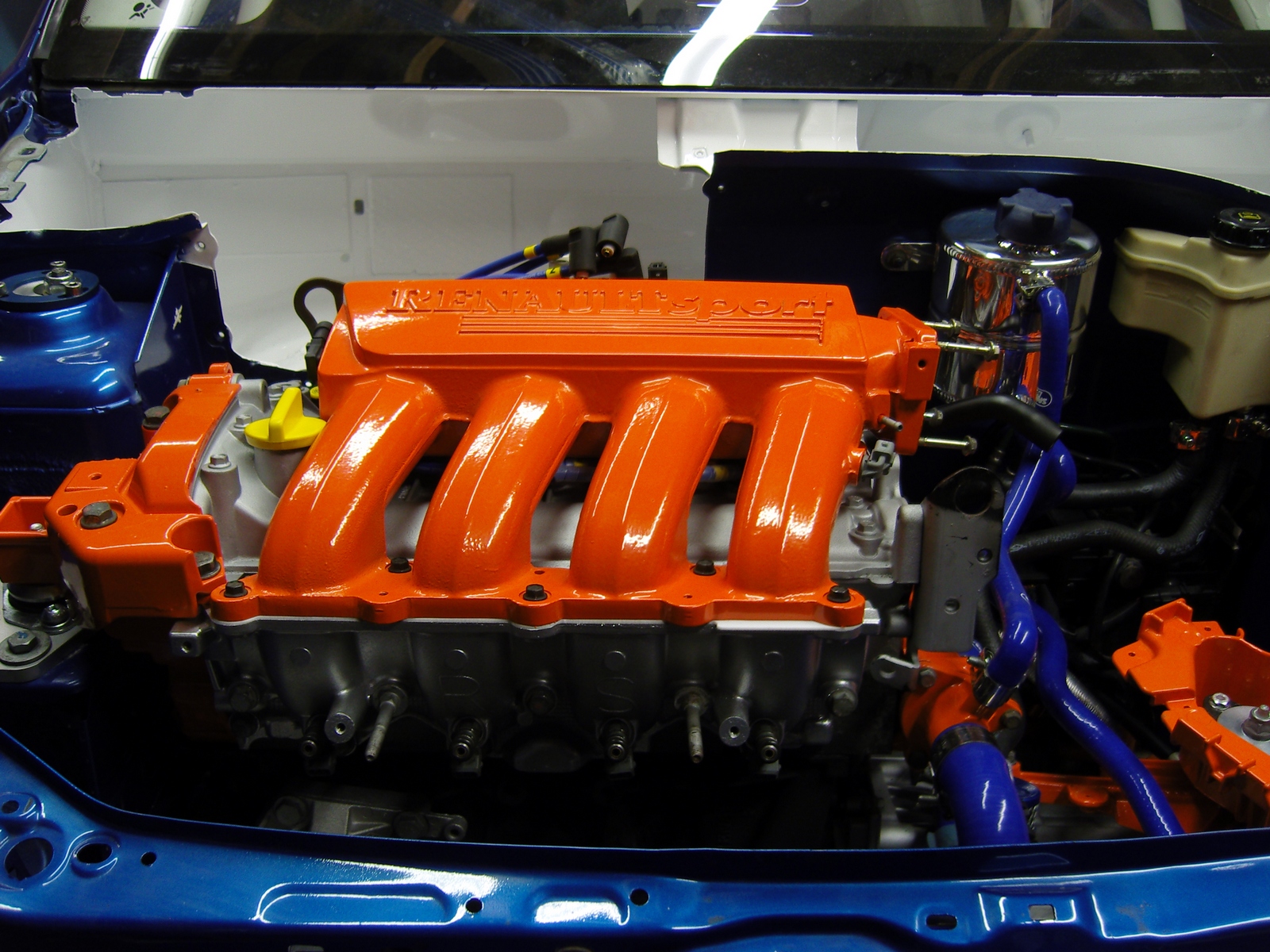

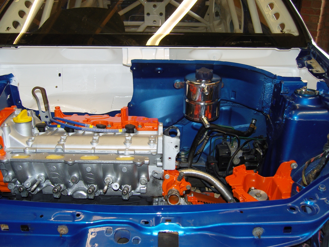

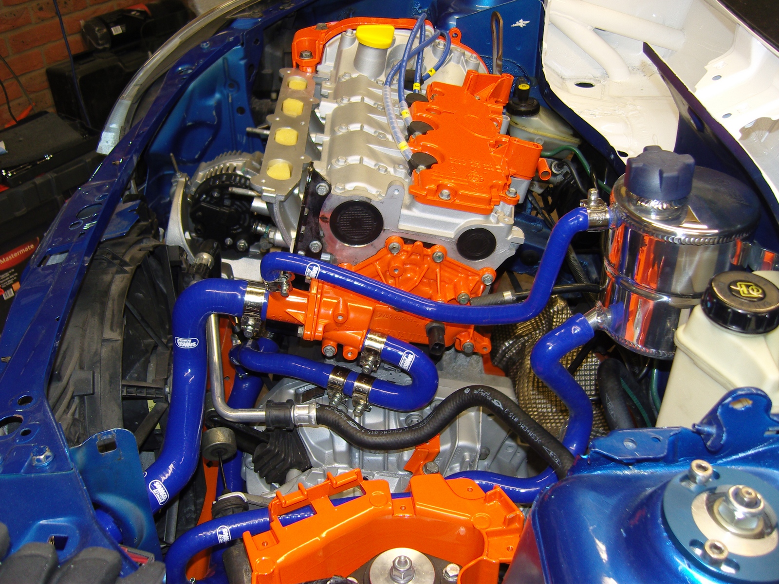

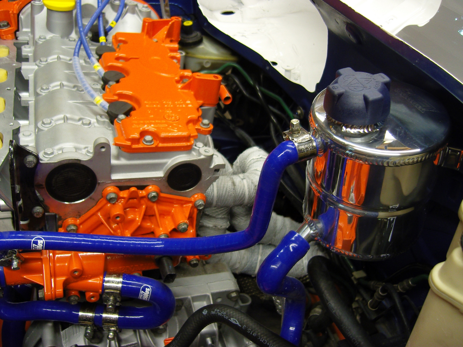

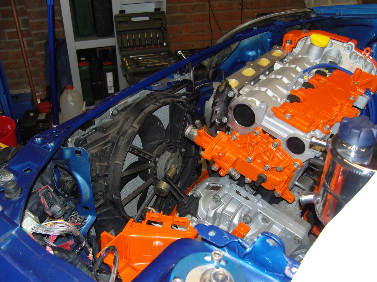

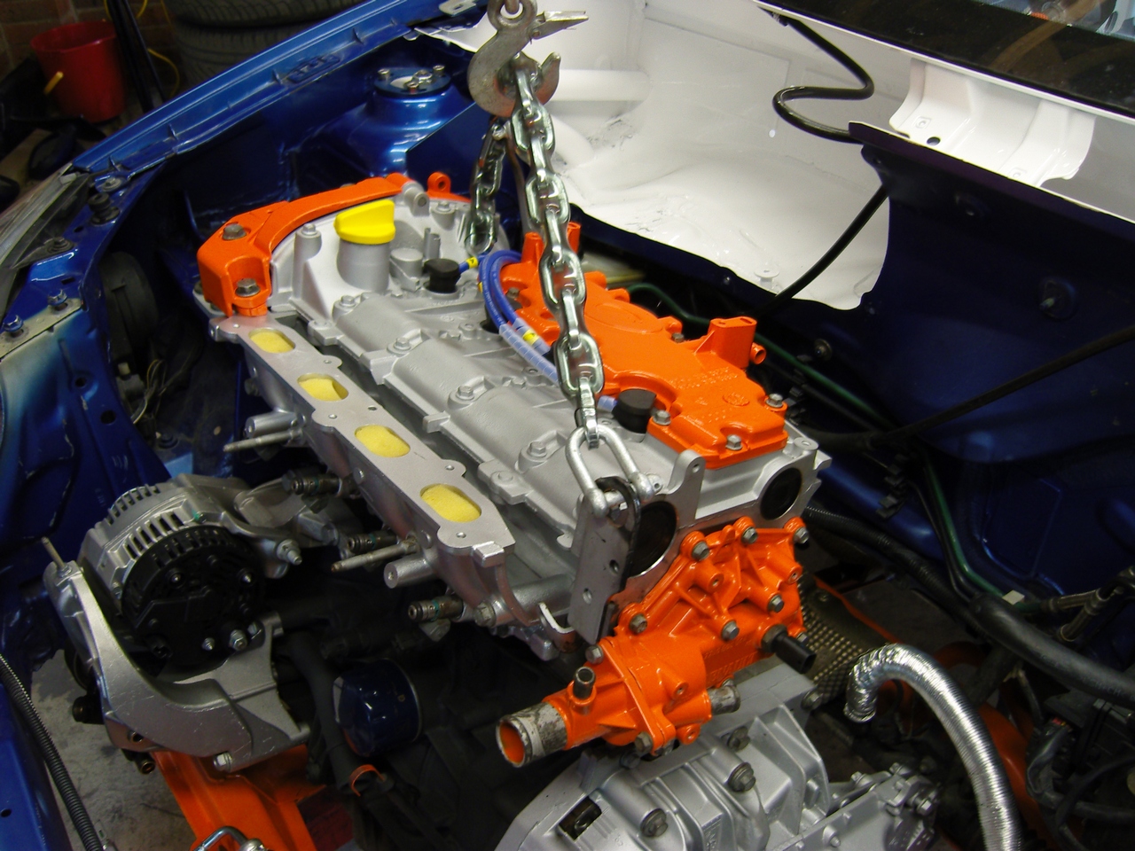

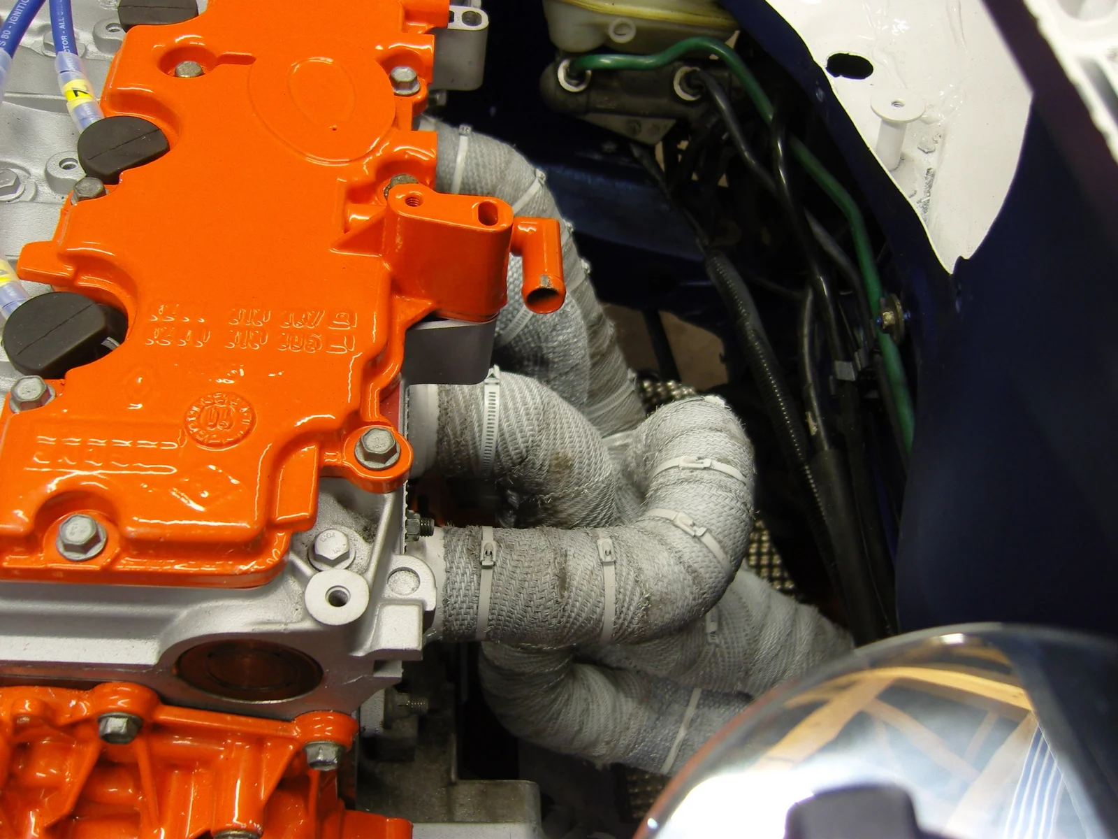

Finally I put the engiine in the car.

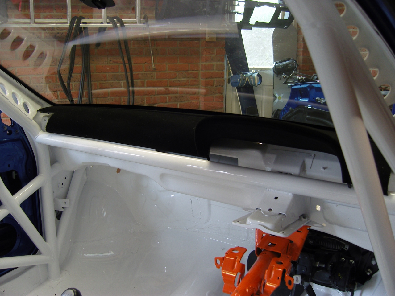

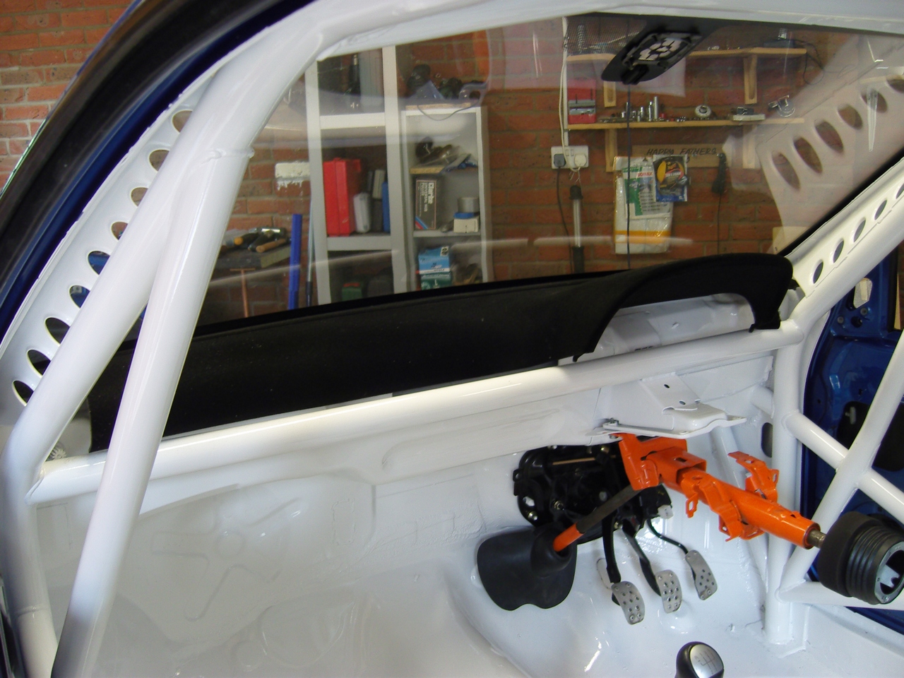

Lastly I fitted my dash. I had to cut out quite a bit to get this in past the cage bars etc. I might fill those gaps with something if I can think what.
