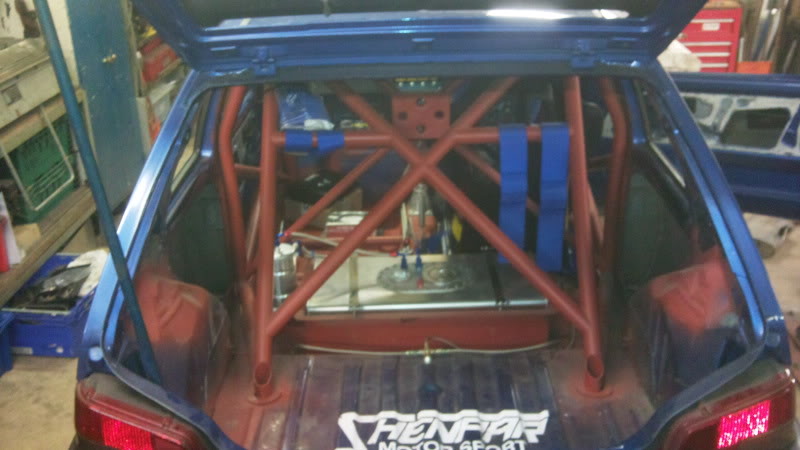

Cage, paint and top mounts look great! Cage is hugely expensive tho! But top quality is pricey. But why no harness bar? Over £3000 and you'll still need to attach your harnesses to the floor!!
Can't that back bar be used as the harness bar? I will look at this with Matt when it goes to him.
If you mean the bar between the shocks, I think it's too far away to use, plus the X section will get in the way of the harness angle. Strange they haven't put on it though. Still looks epic though :D
cage looks VERY similar to the CC one in my pug (but my kit came with harness bars in the rear stays/X)..
having fitted it myself i can assure you the work involved is immense and when you take that into account there charges aren`t that high..
fingers crossed i get to have a look over it @ TDF next time i drop in to see Lord Faulks the pics lok great but my guess is its even better in the metal.. SUPERB work so far..
I see what you mean about the bar and am a bit pissed about that to be honest! I shall speak to them as what a ball ache if I now have to weld in an extra bar there. Wonder if I can get away with a clamp on bar/tube that I get fabricated?

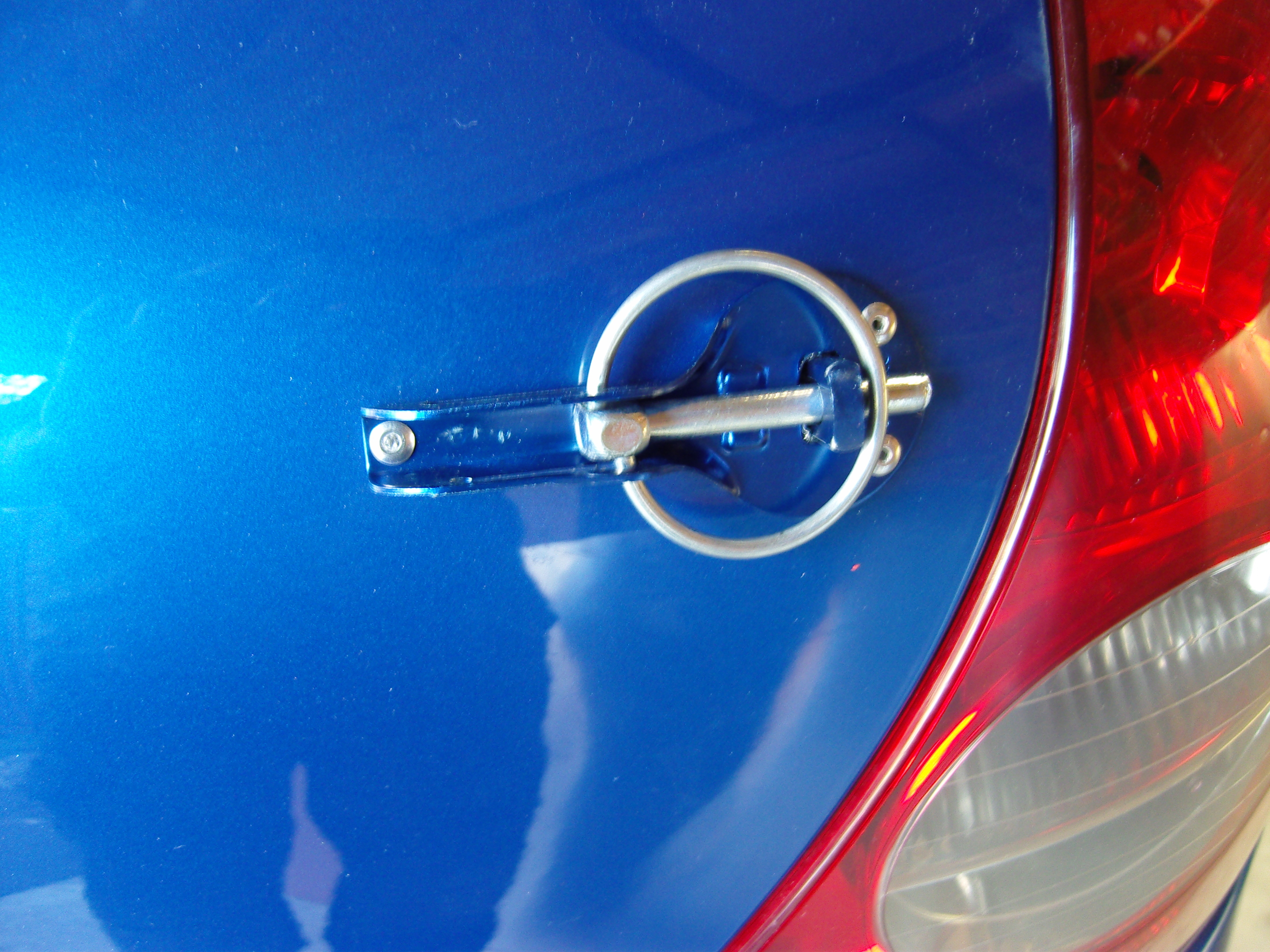

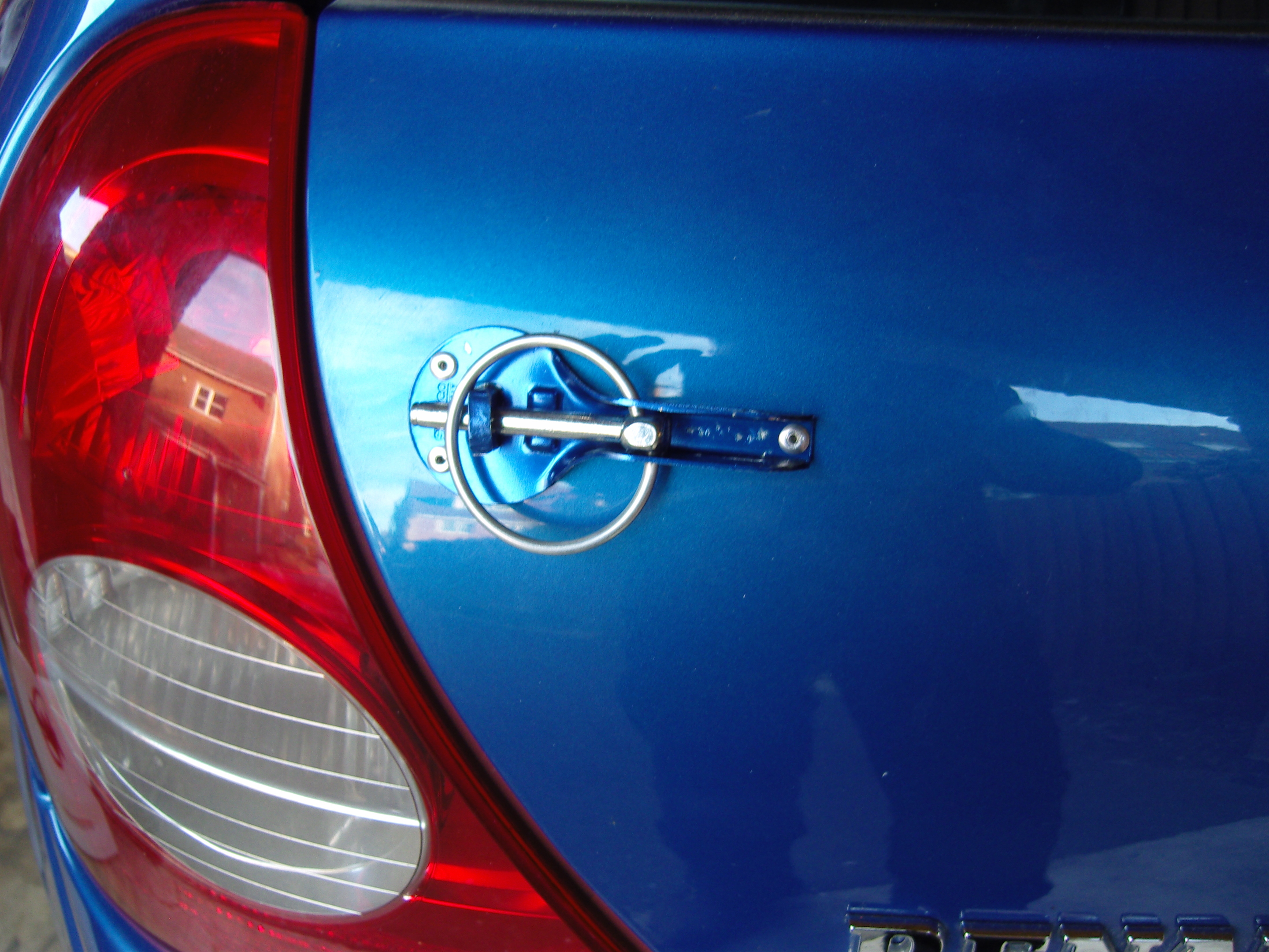

First fitted the rear door pins to get that job off my list.
Right side Pin

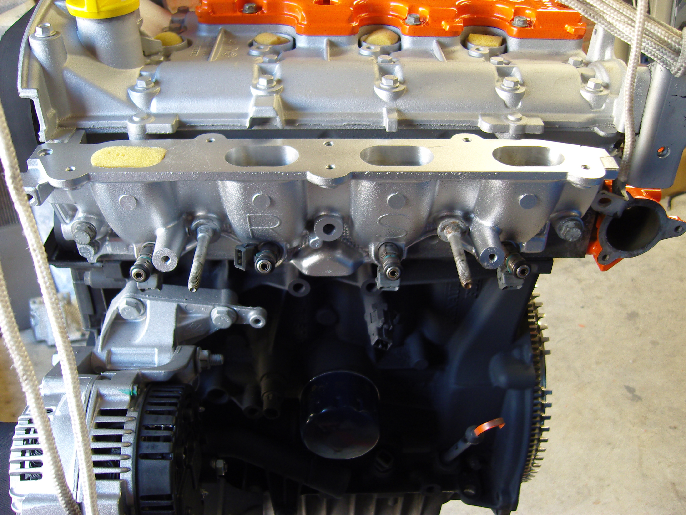

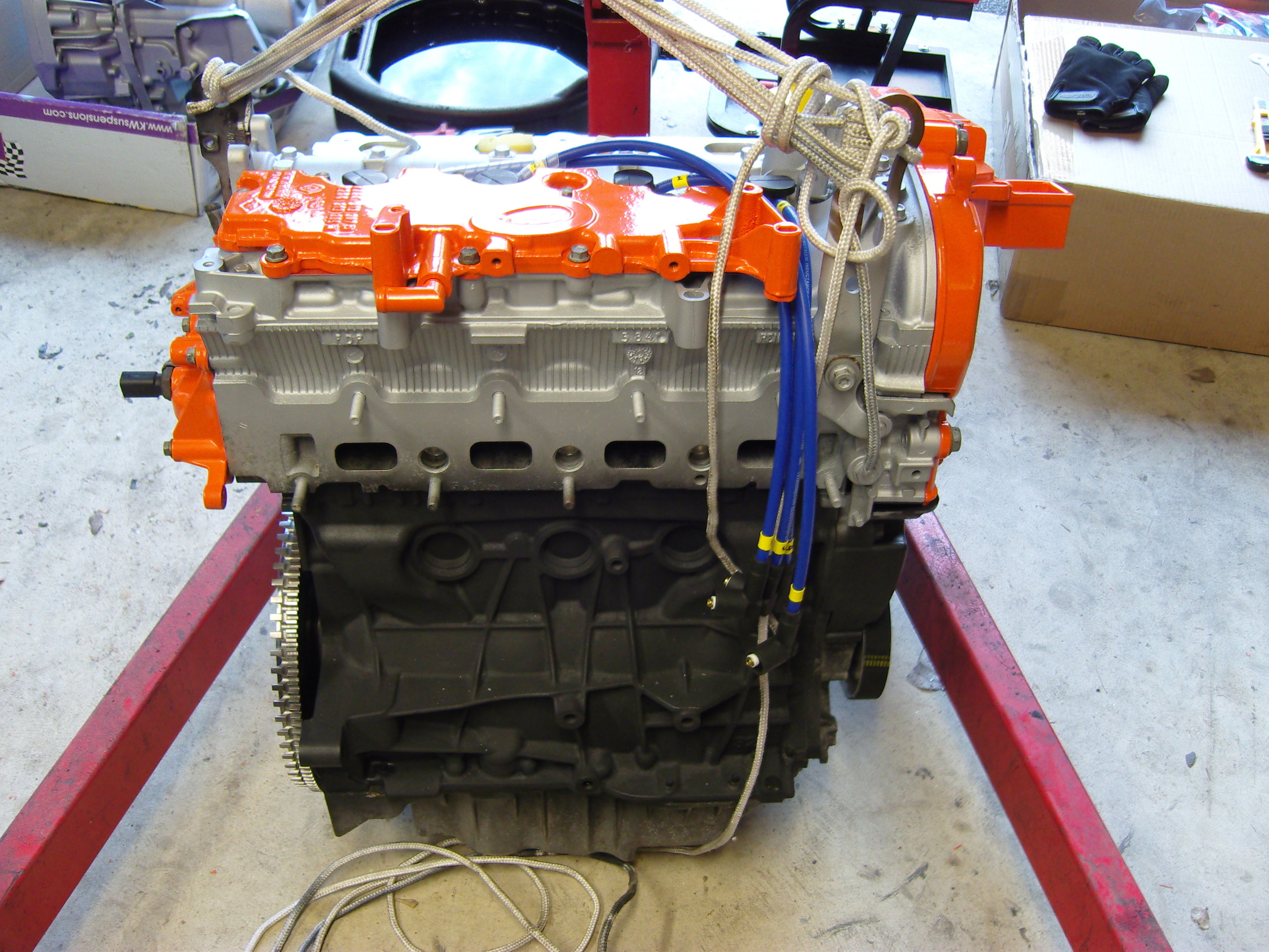

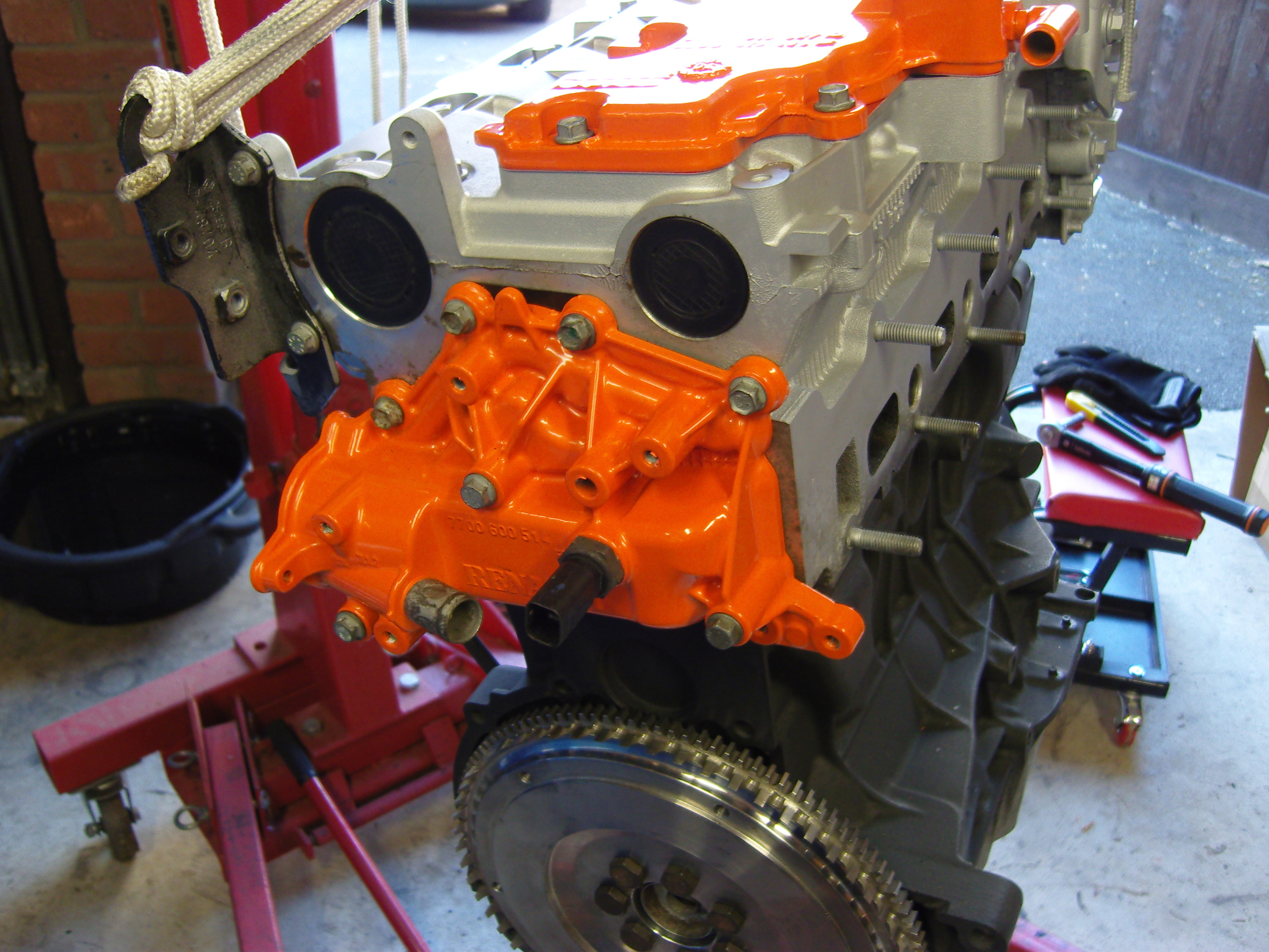

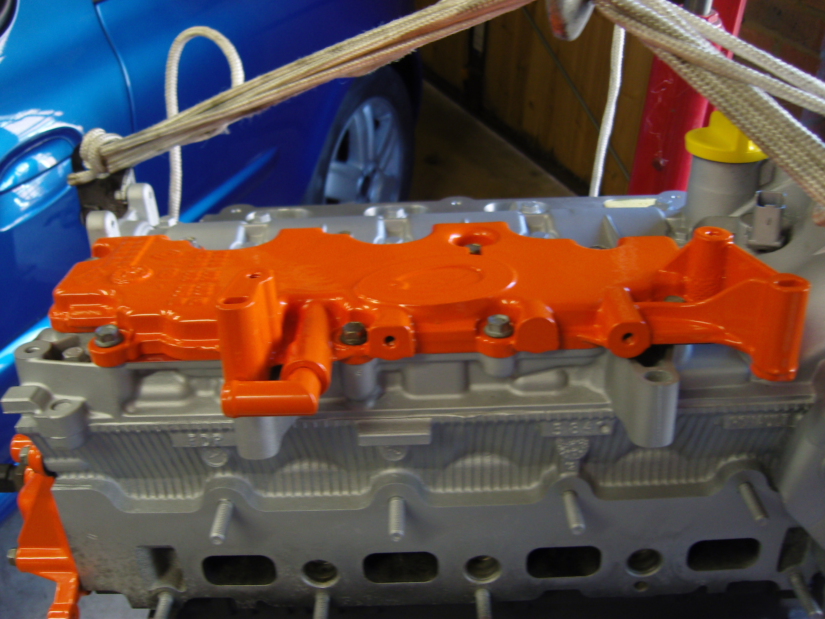

Then I set about doing some more on the engine so its ready to slot back in when my helix arrives this week. Very nice cam breather plate

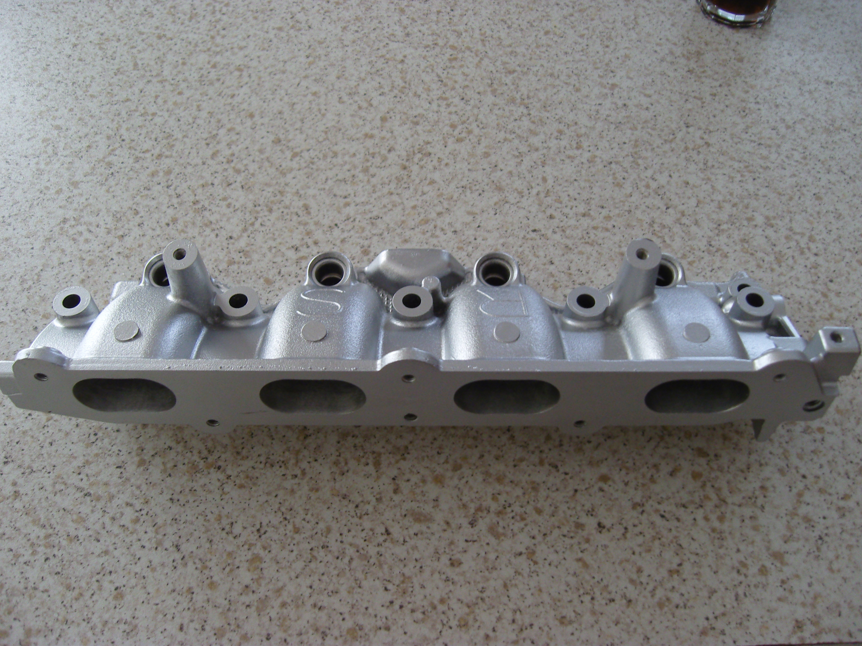

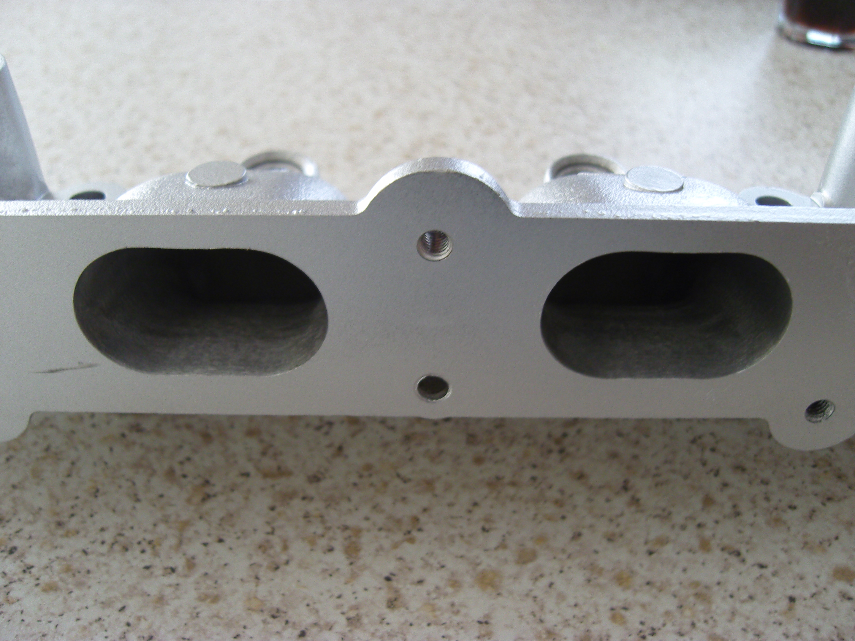

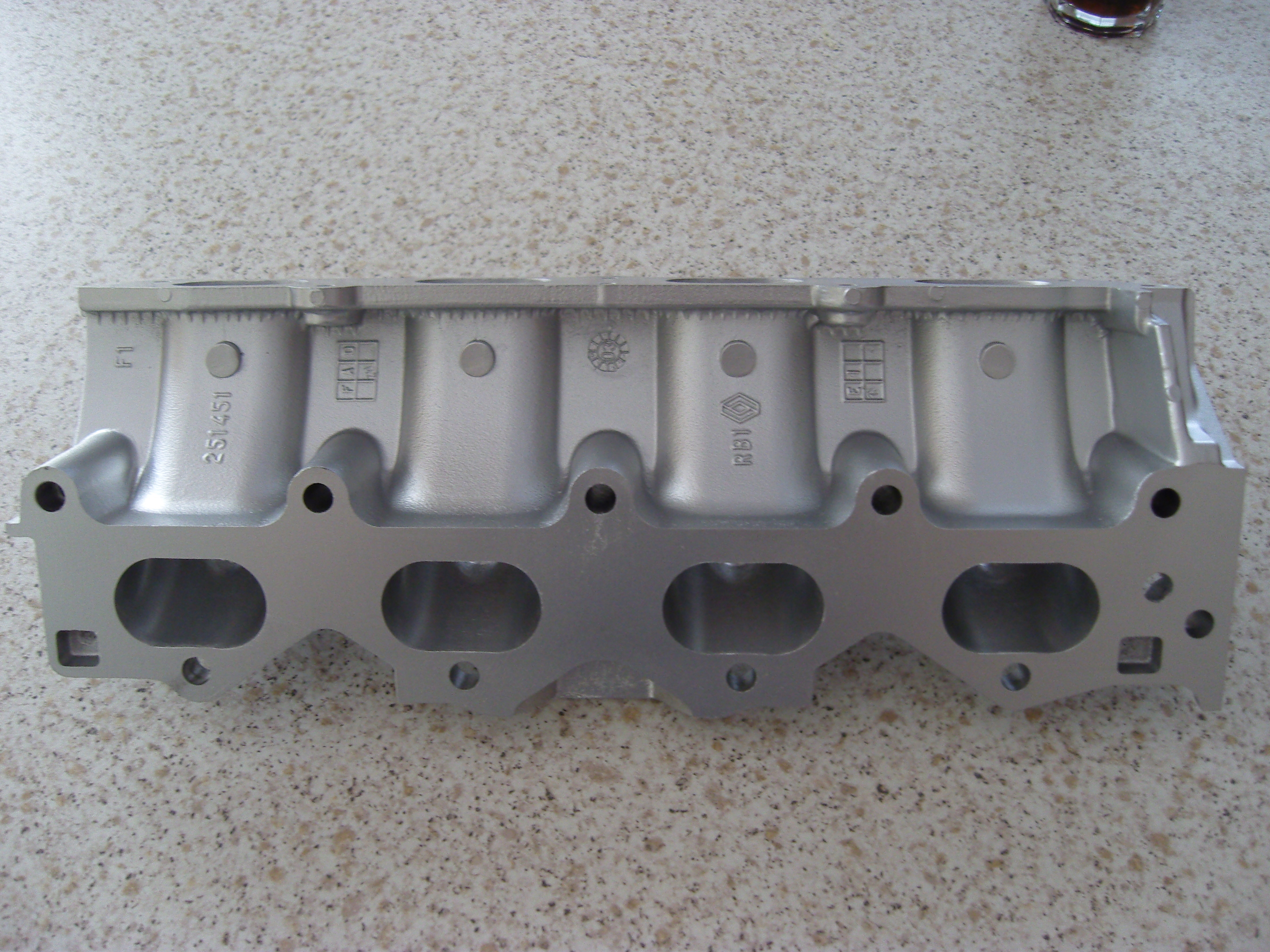

Inlet manifold

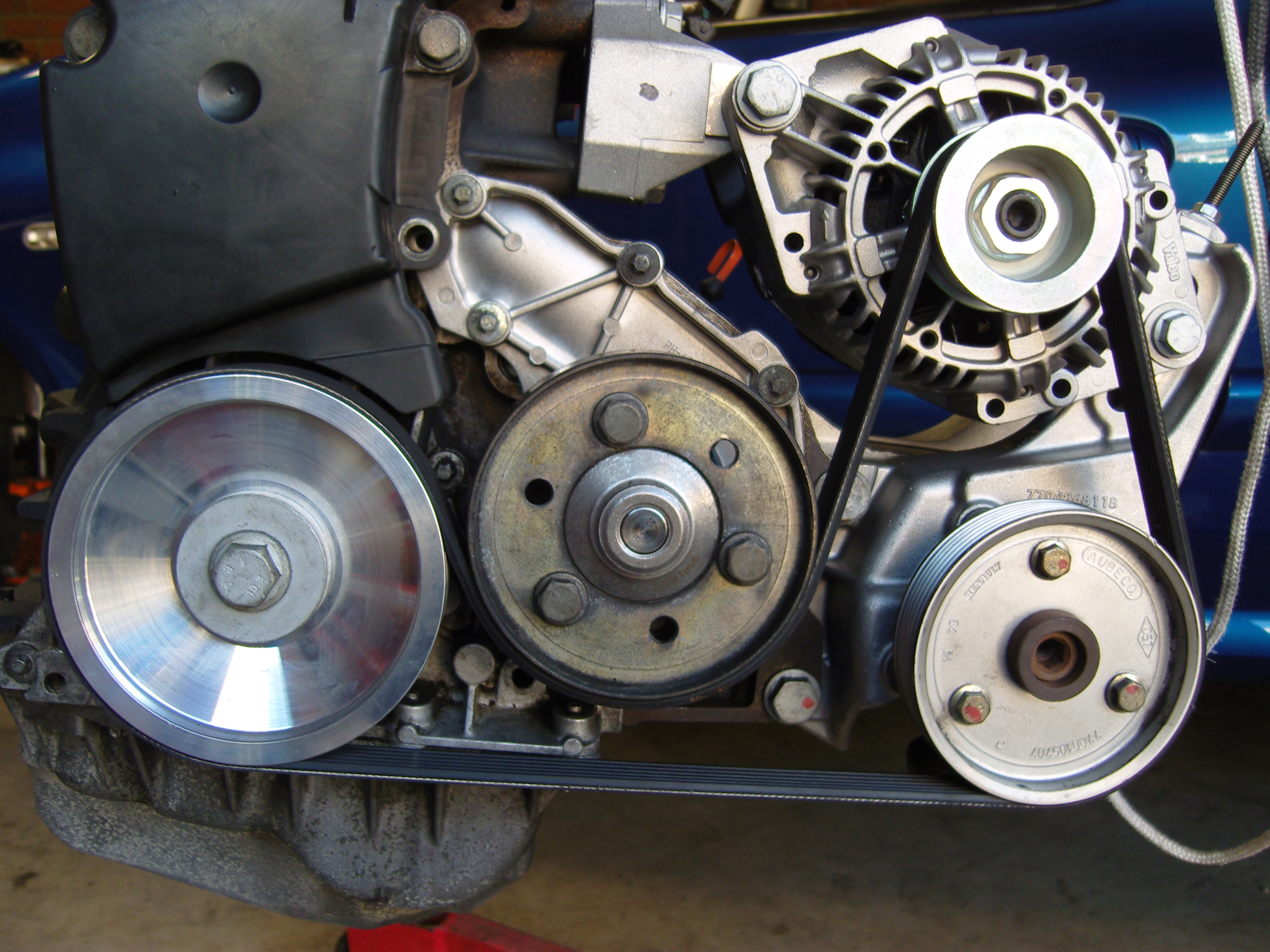

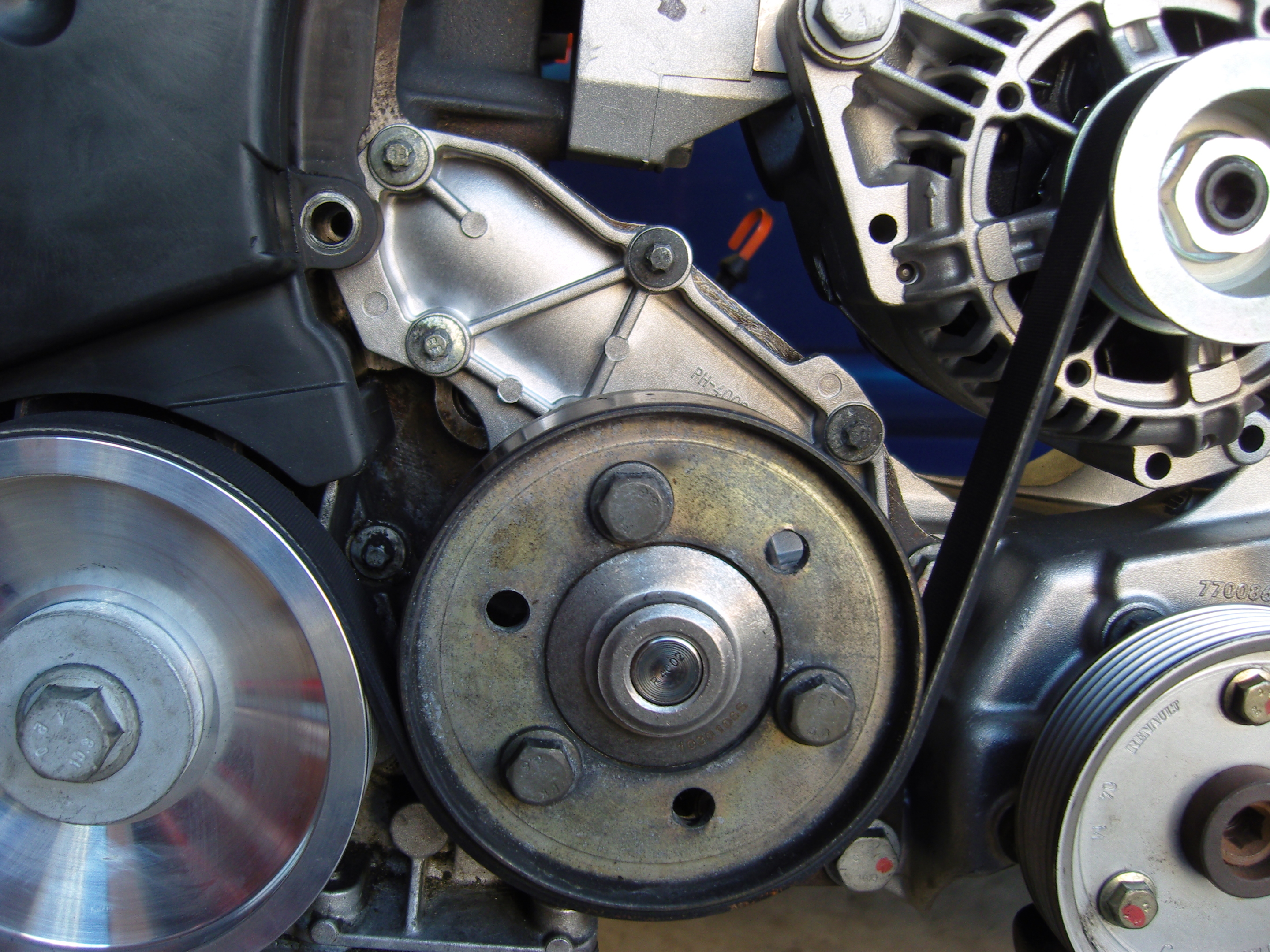

The ally crank pulley and also new waterpump where I sliced my finger :)
New water pump

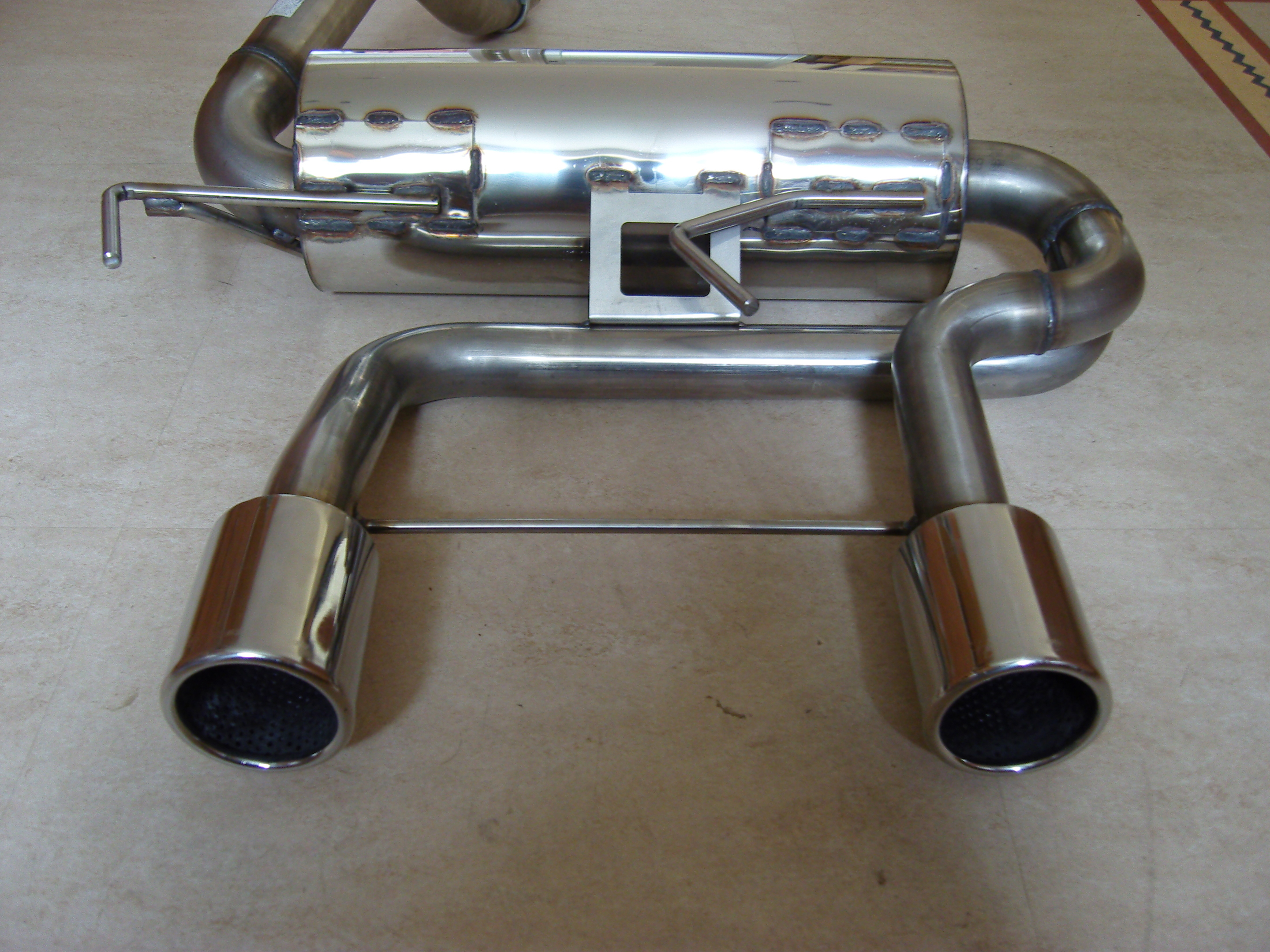

Oh yes my new Exhaust arrived so thats ready to on once the engine is in.

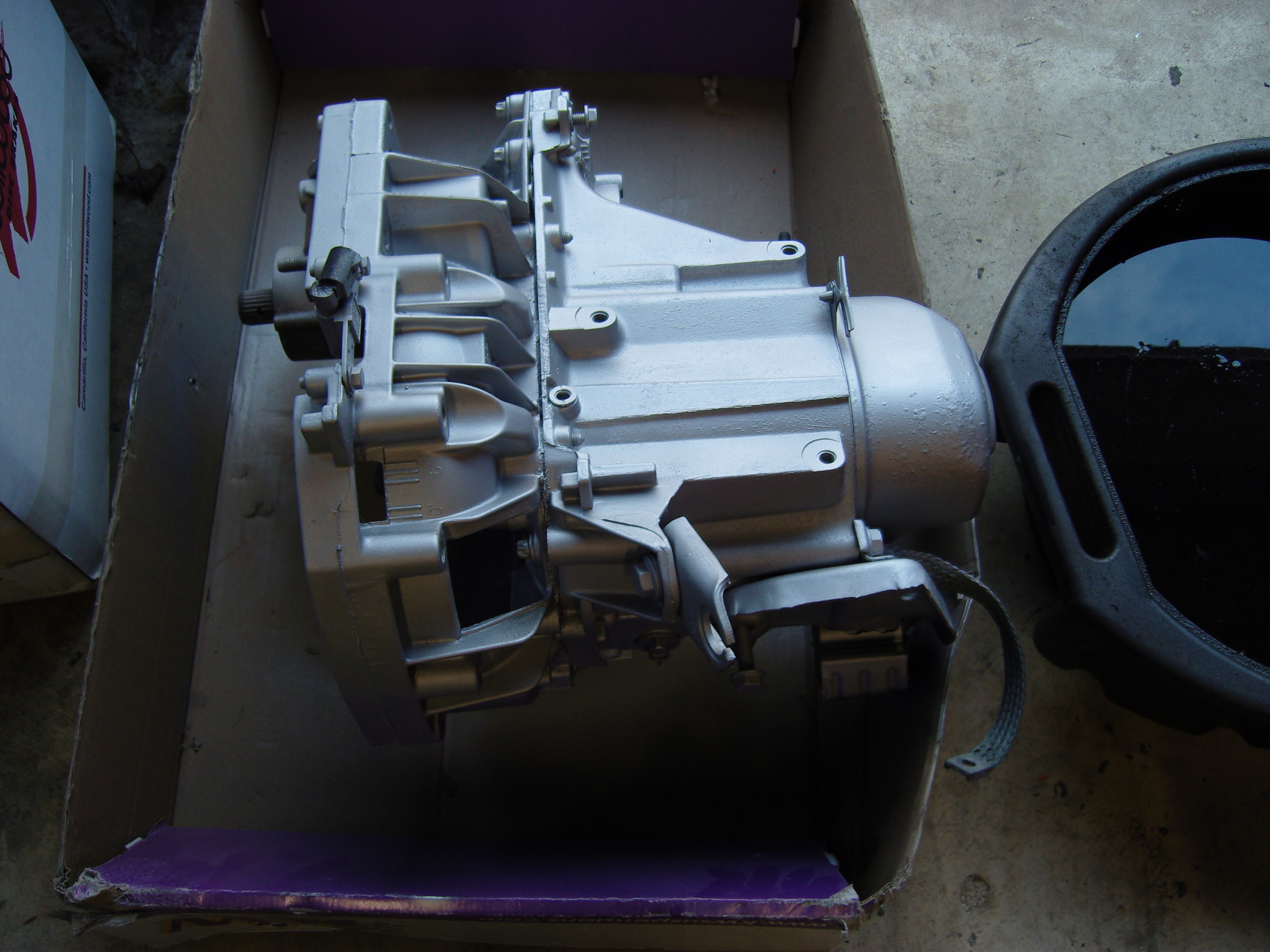

Painted the gearbox after giving it a damned good clean :) and as I did it with a steam cleaner I cleaned myself too LOL

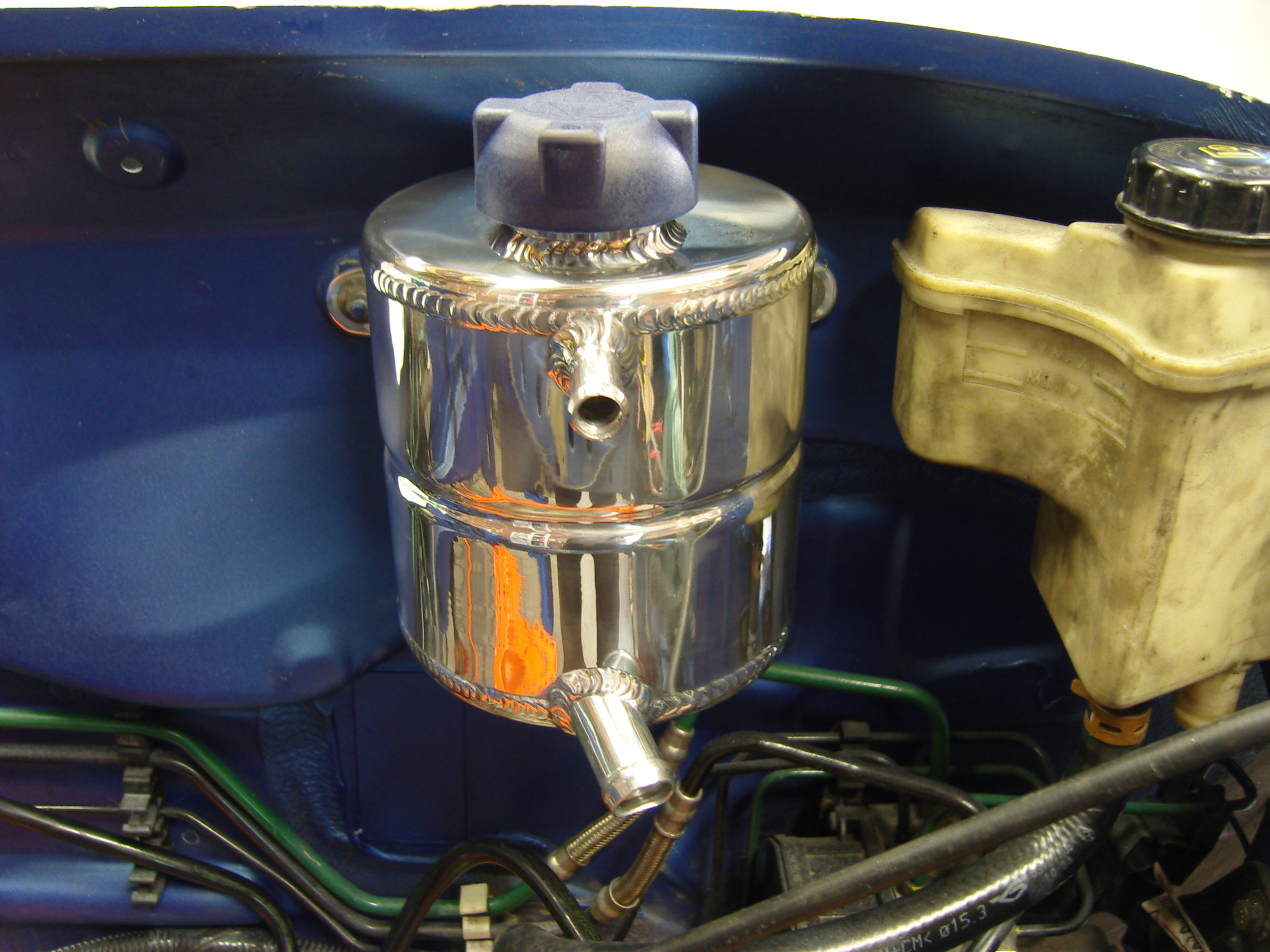

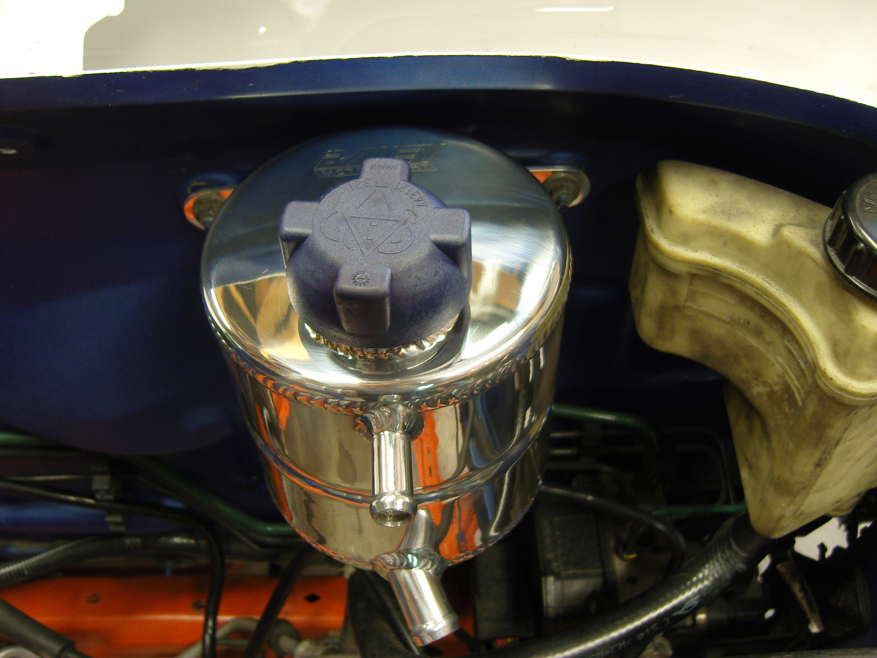

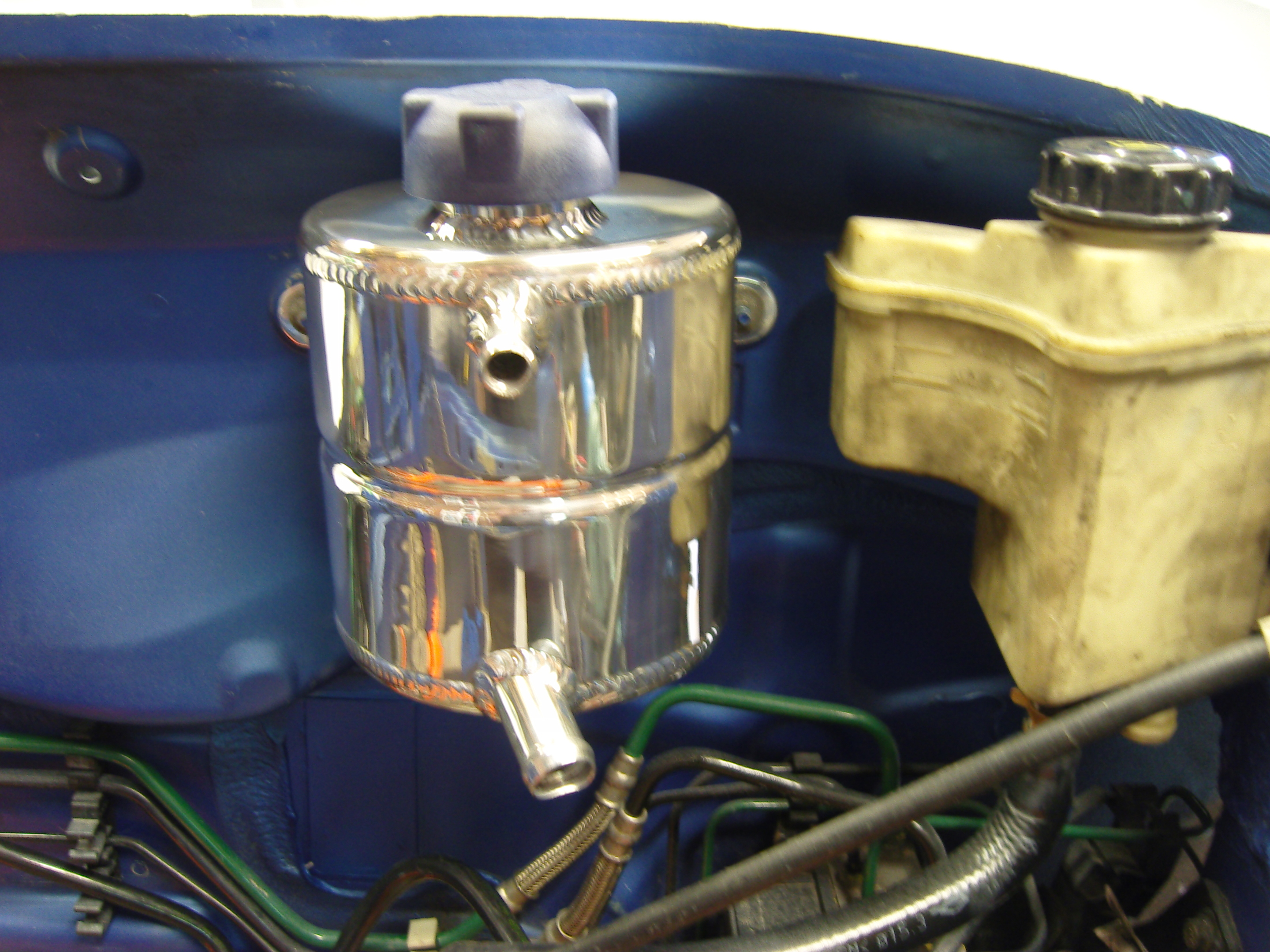

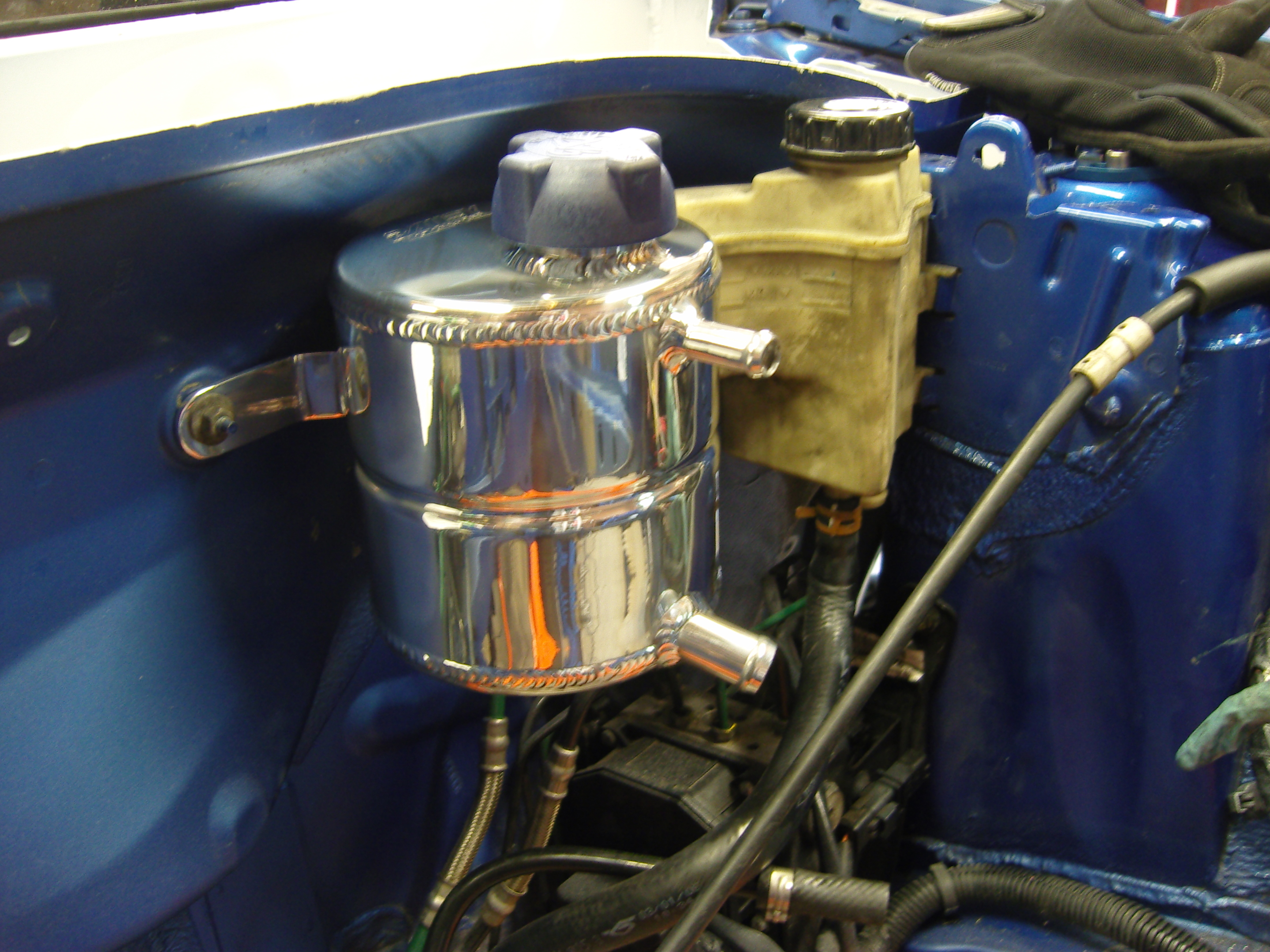

My new Bailey header tank arrived :) Very very nice welds.
I also put on a new matched inlet manifold just for good measure.
So all in all a damned good weekend :) This Saturday I shall put in the engine and finally fit the front discs and then it can go over to Lord Faulks what what

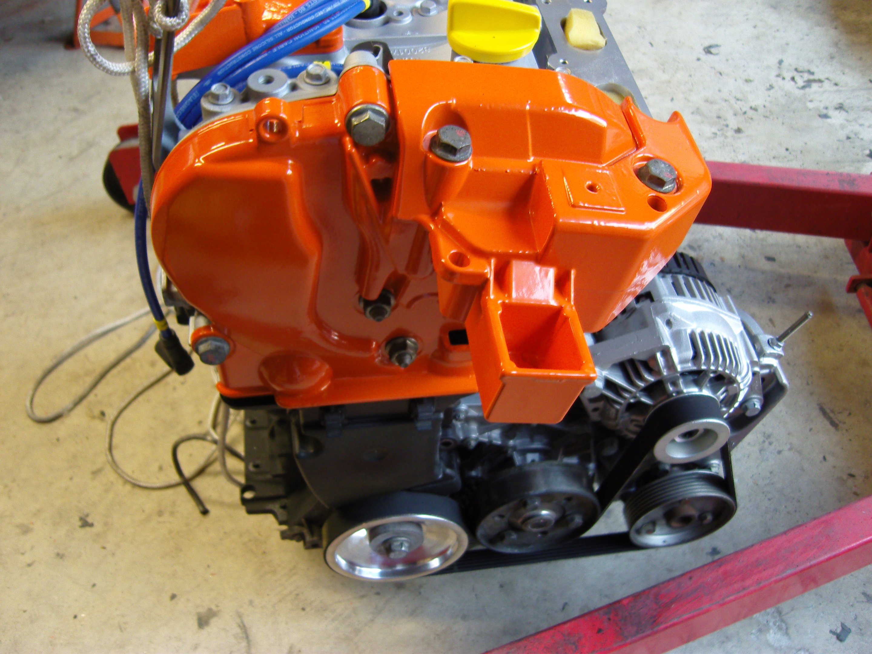

A few more shots:
Thermo housing
Timing belt cover plate
