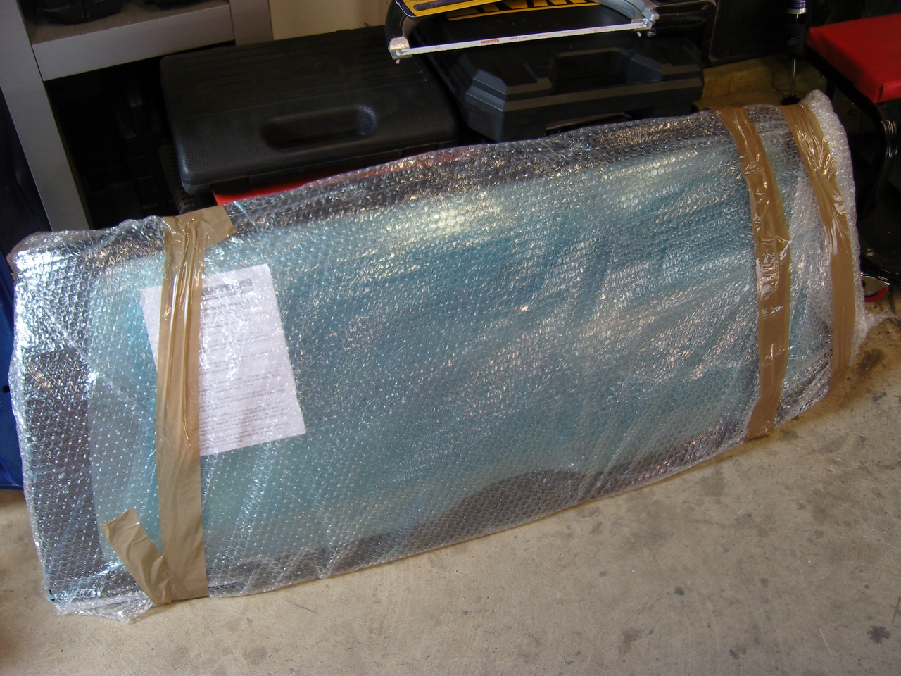

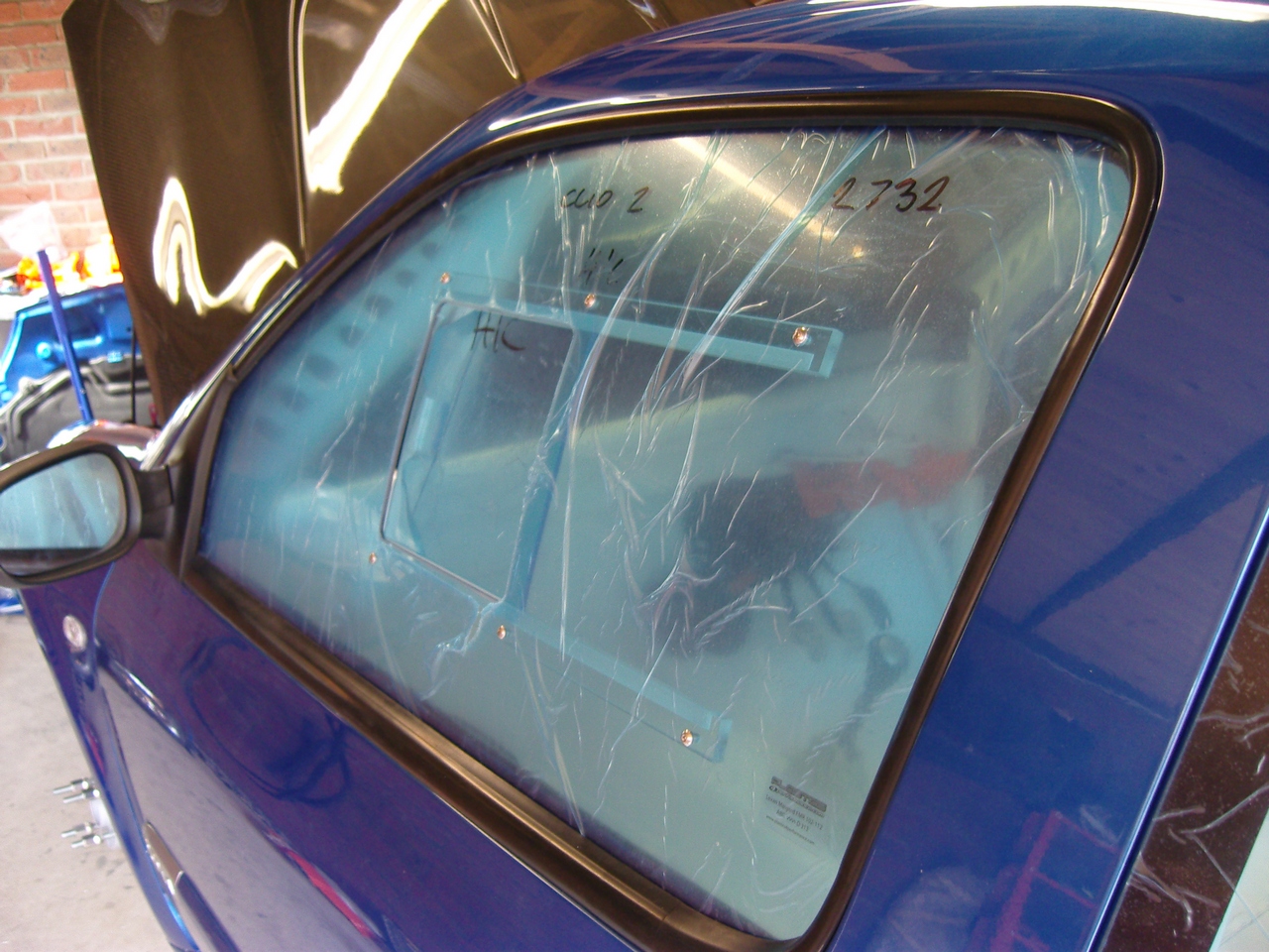

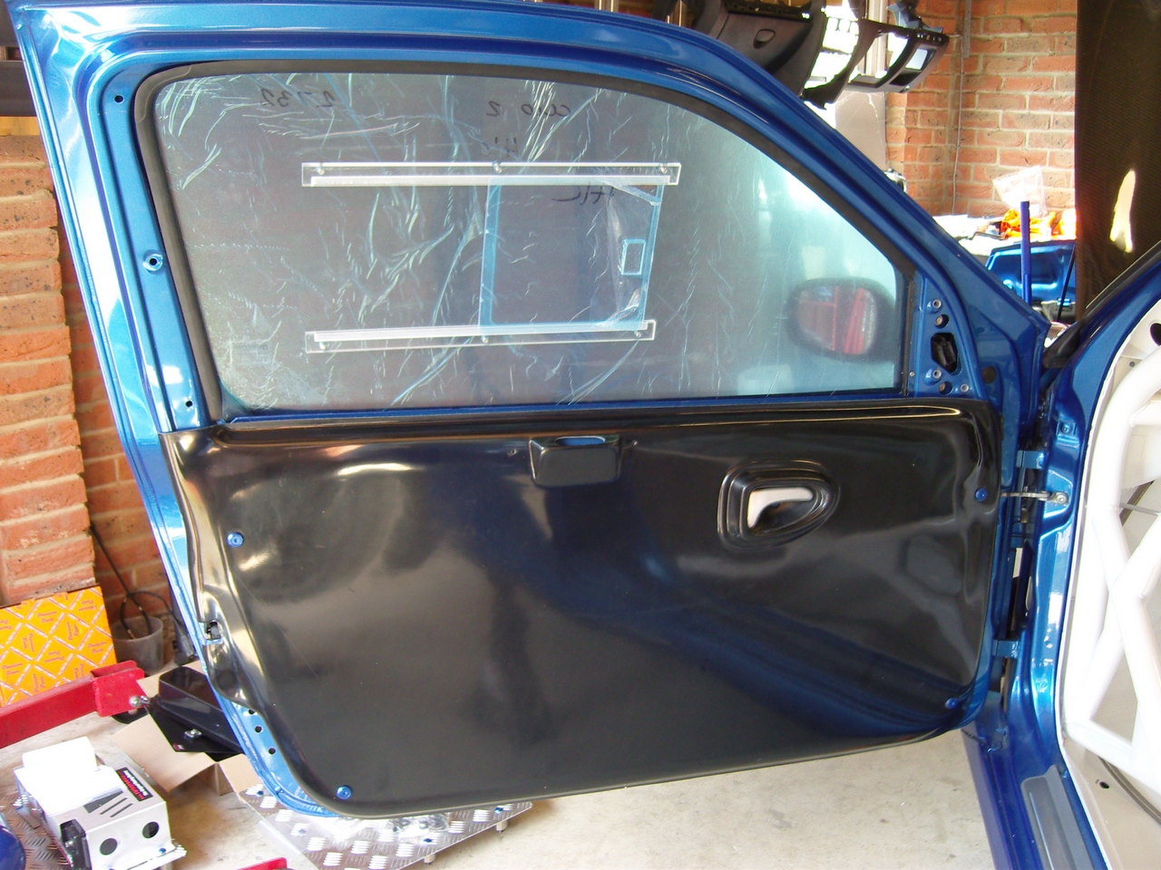

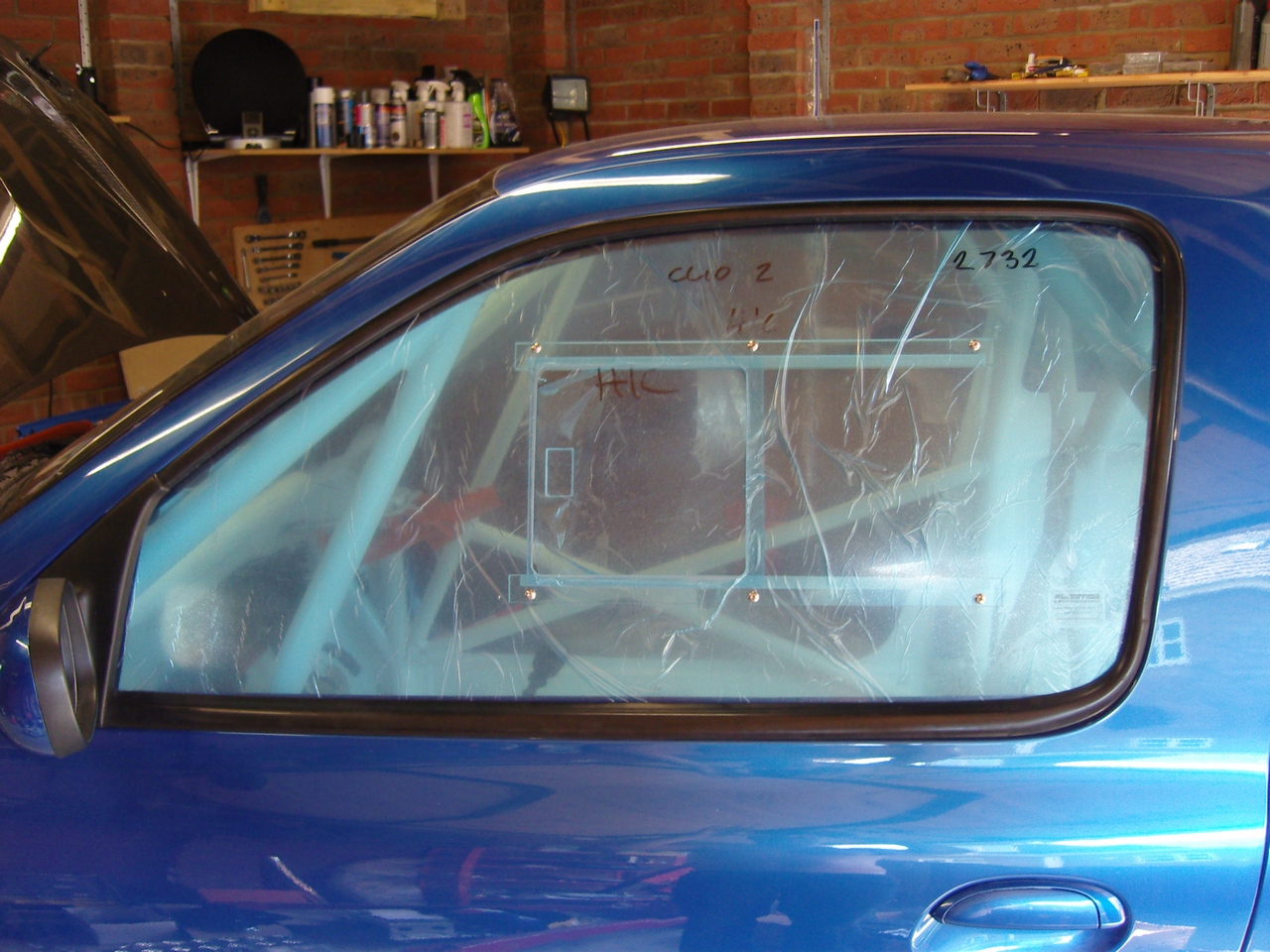

So first up we started to fit the plastic windows. These are the thermoformed ones with the tuff coating and they do fit very well.

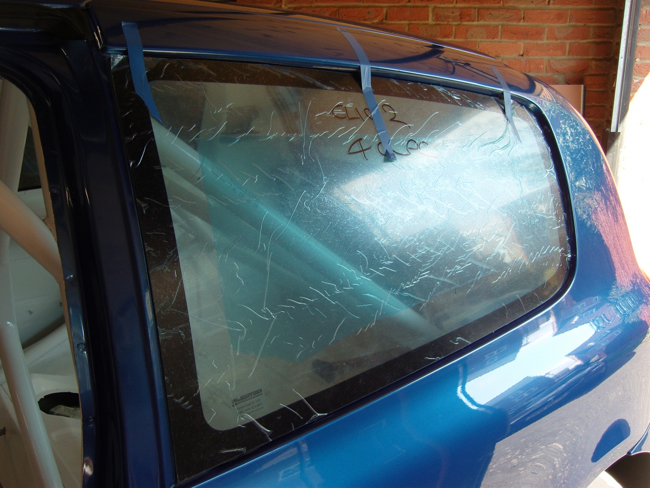

The rear window has to go in next.

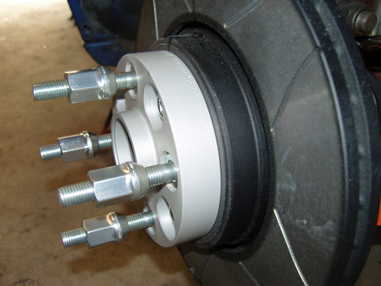

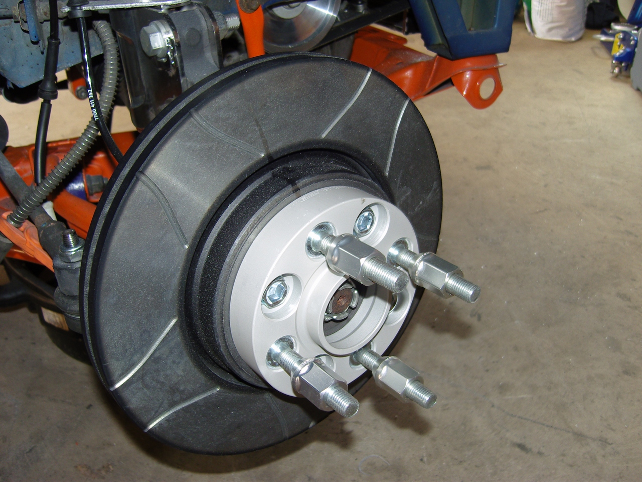

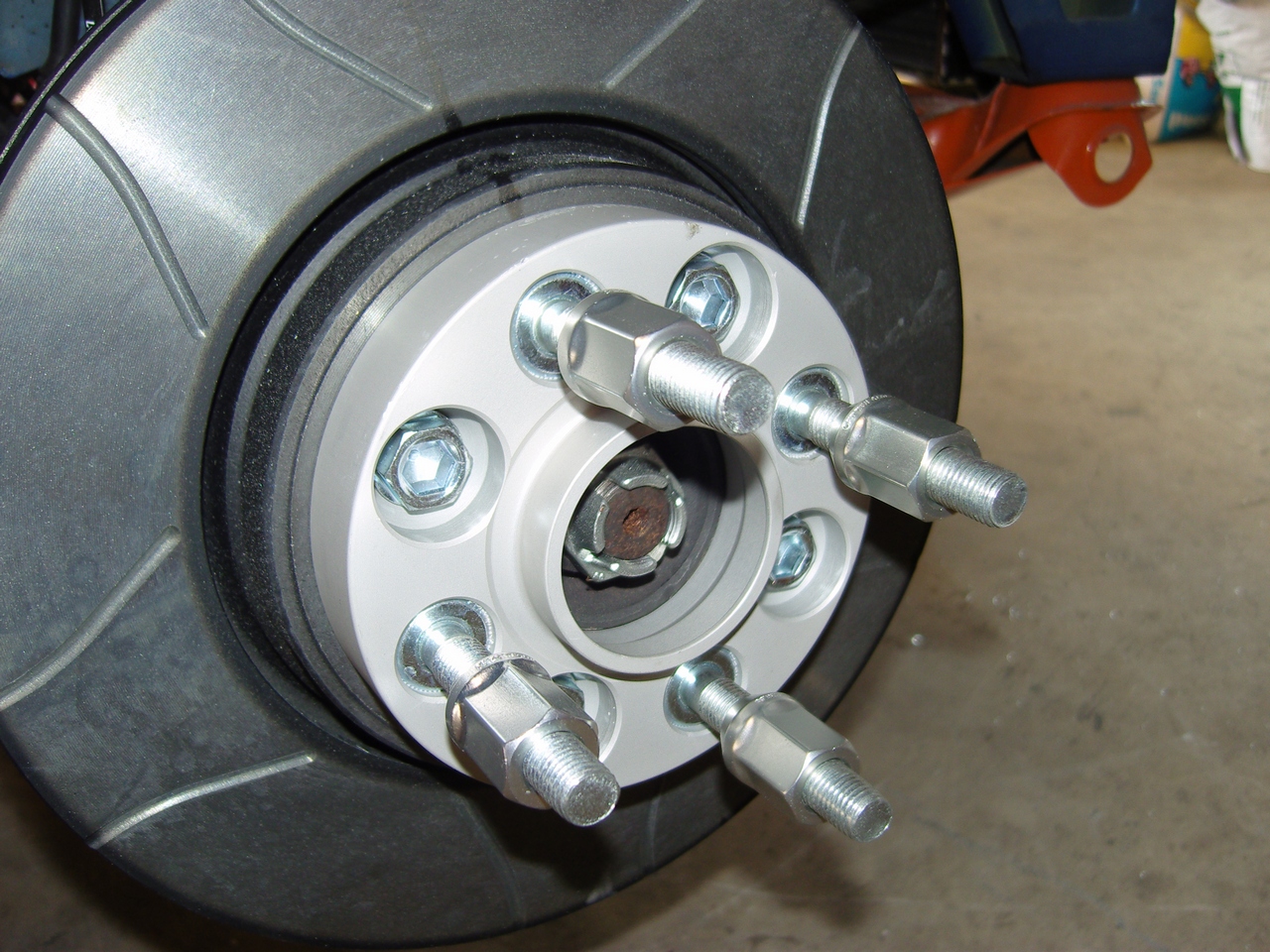

An easy job next. The front 25mm wheel spacers went on.

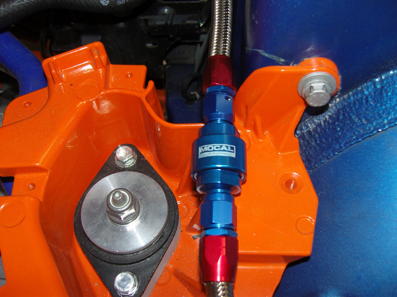

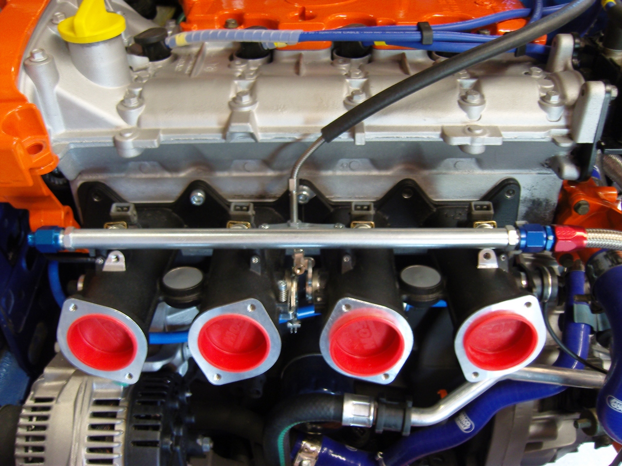

I fitted the new fuel rail and also the fuel filter in place.

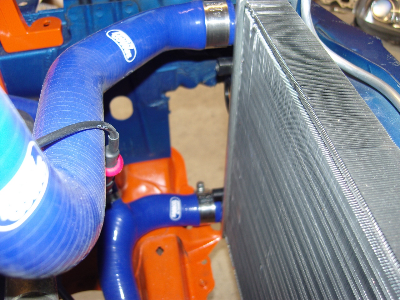

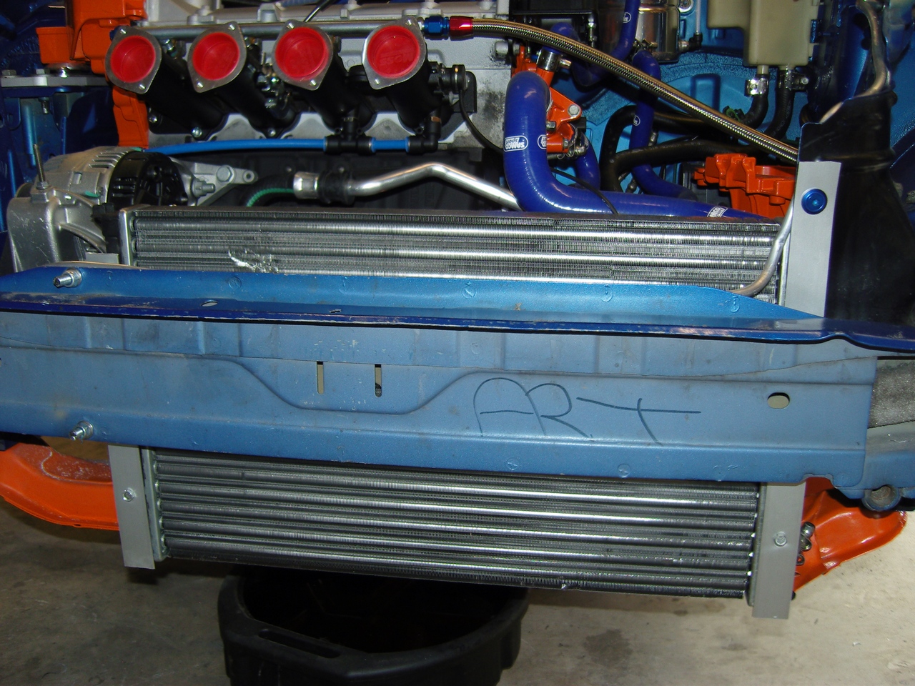

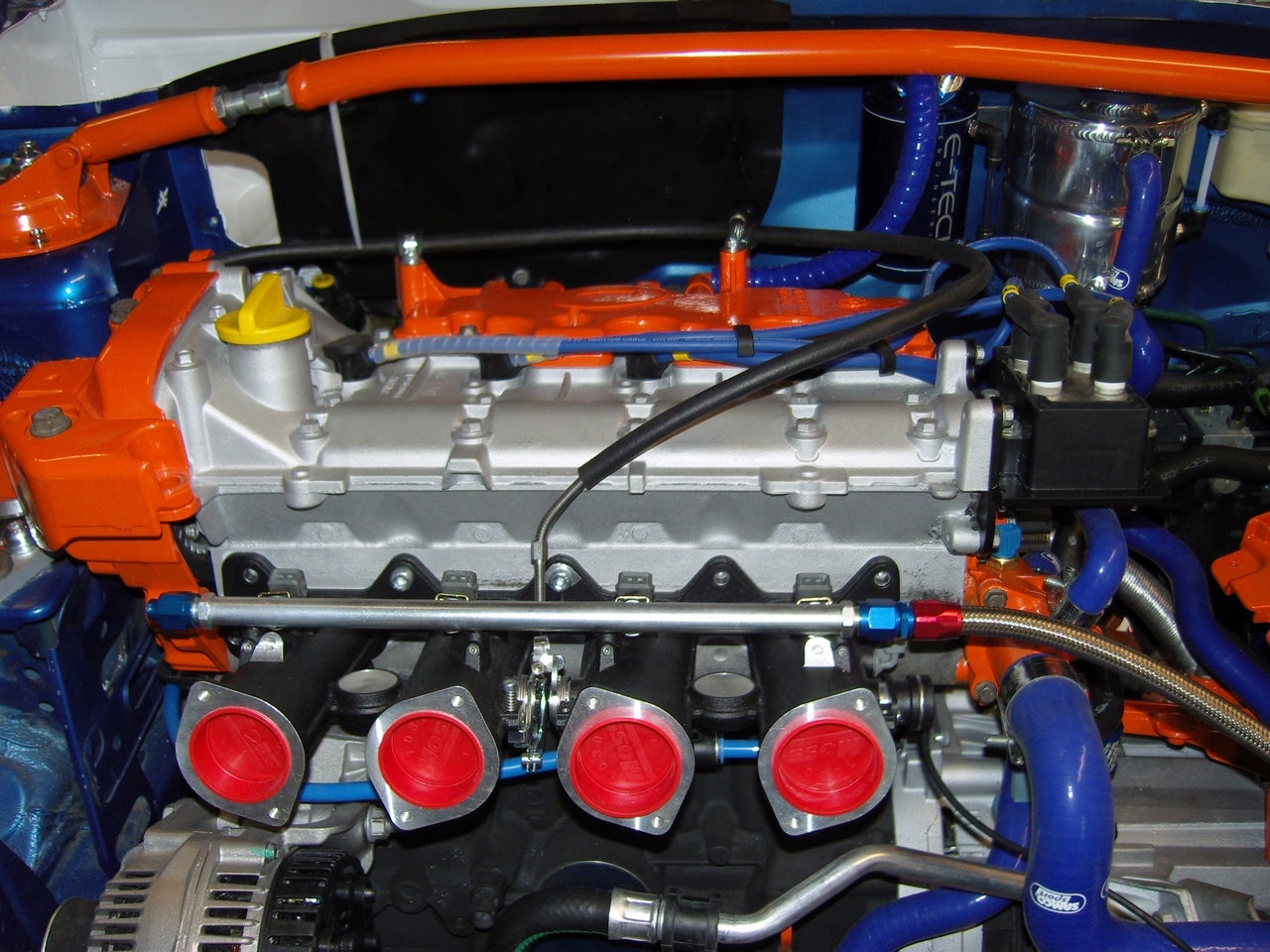

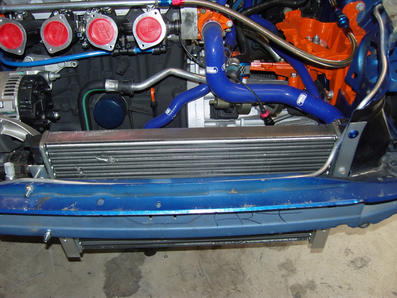

Next up is the new short rad. I was going to get this fabricated but for £40 a pop I can have loads of these as spares instead of a bling one for £500!
This one is for Fred :)

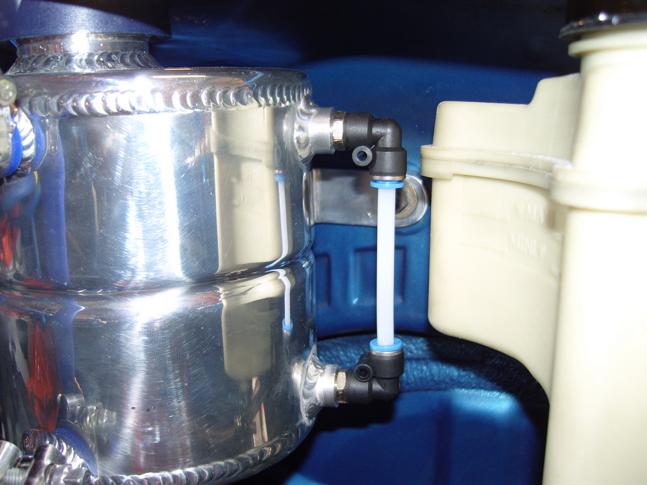

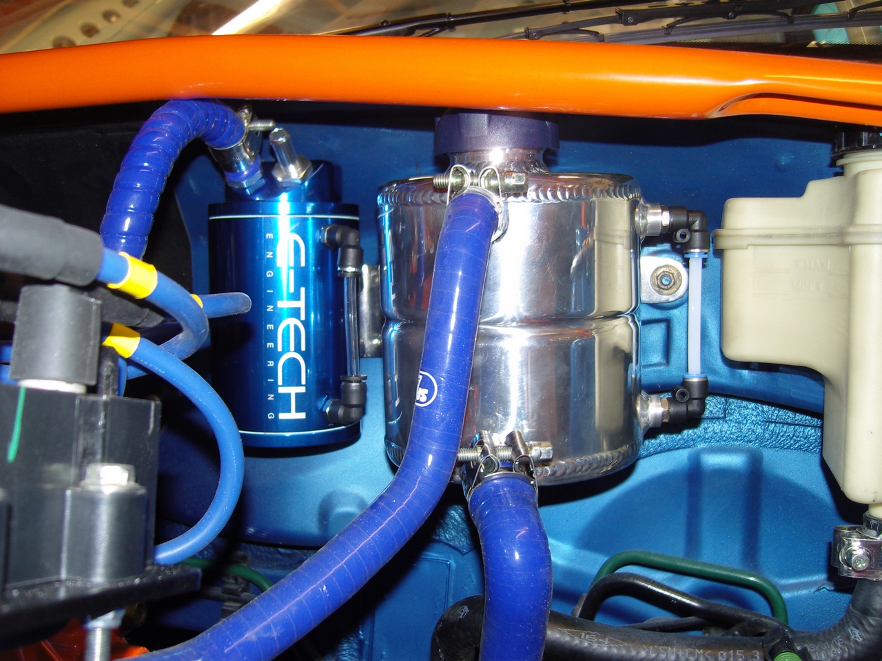

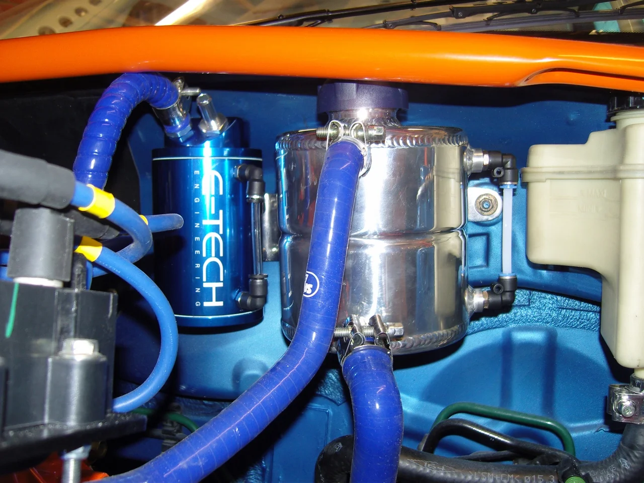

and the oil catch tank
I will change that if asked for a larger one

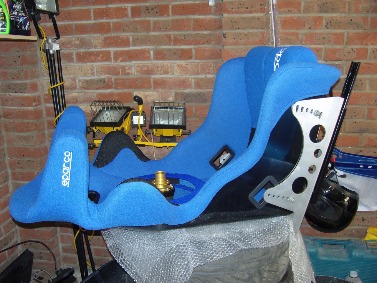

Lastly a pic of the seat with the mount brackets on and adjusters. This will be fitted this weekend.

Isn't TDF supporting you on this? Surprised he allowed you to use that CTS, horrible way to do it! You not seen the CTS they use?
Oil tank will need to be changed, thanks for adding the sight to the header, as delboy would say "you know it makes sense" ;)
You know Fred I did think of removing the standard one and filling that hole with an ally plug and then tapping that, might do that now then to make a better job of it. Yes I Knew you would like my little sight gauge ;)
As for TDF well Chrispy needed some work as he has just graduated so I have employed him to help him out. He has been a great, no MASSIVE help on this build and comes over at the weekends when I am back in the UK. We are trying to get him a job at Radical at the mo which is owned by a good friend of mine.
na WAY to complicated, and the CTS has to be in the head really, you should've bought the M6 CTS from TDF, replaces the stock bleed screw, very clever
  Qashcow
Very sexy looking CTS too if I may say so myself, glad that's what I went for in the end just to keep it neater looking
