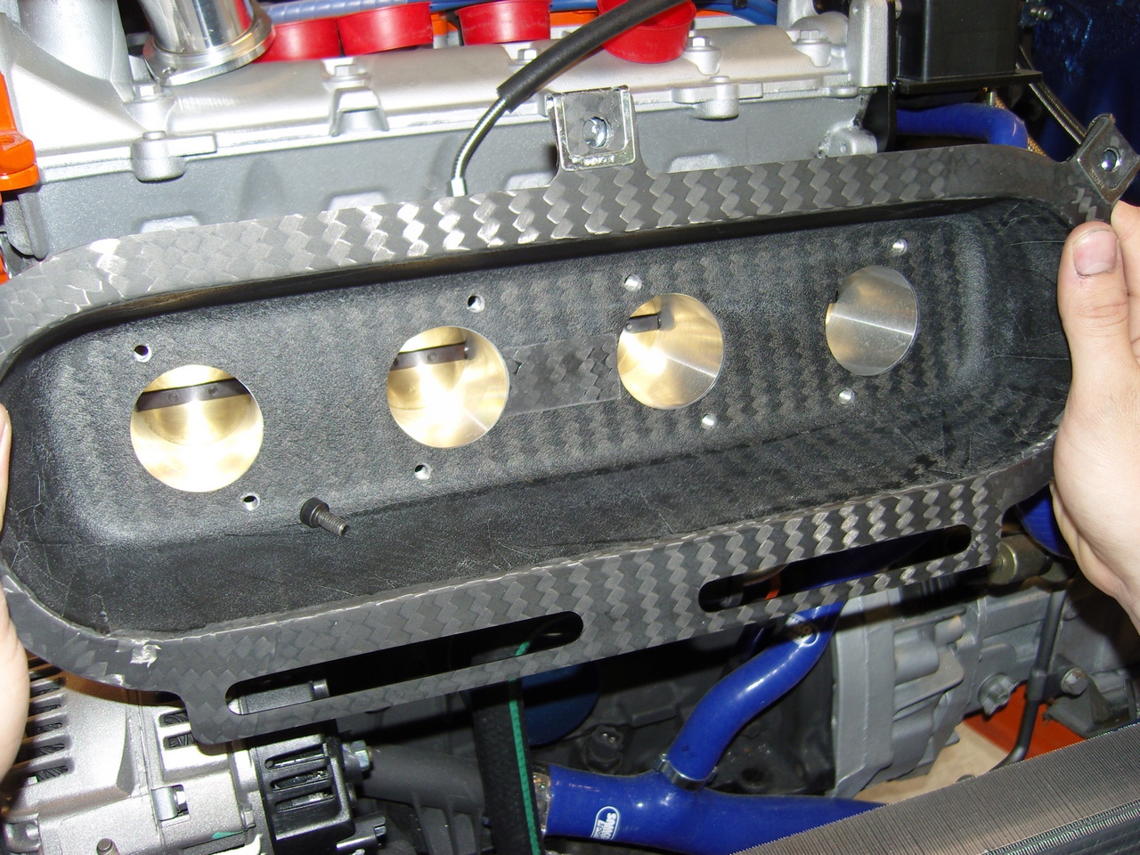

First up we have us fitting the reverie box mmmm. Very nice this is too.

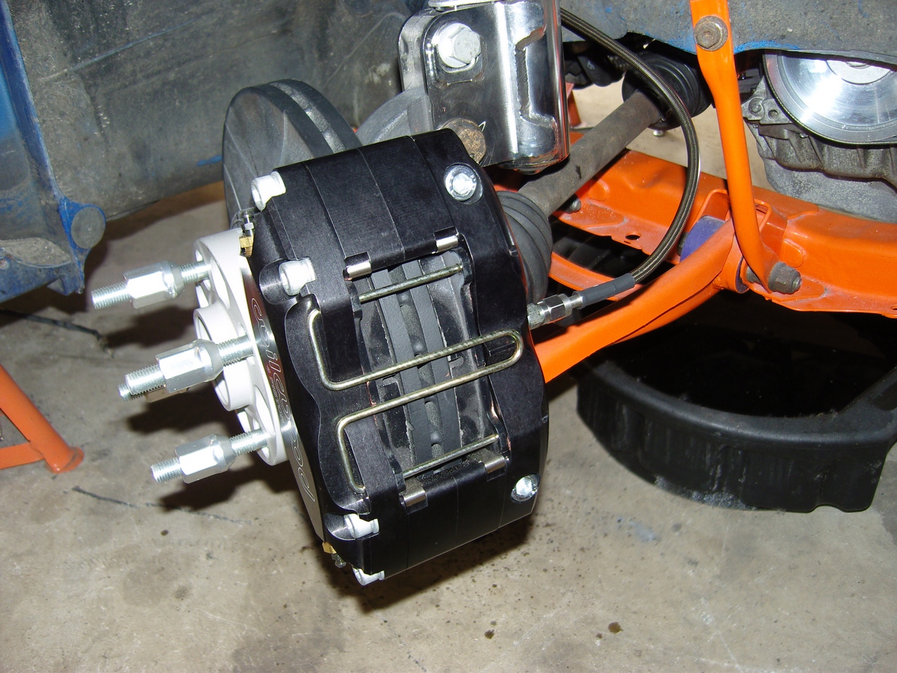

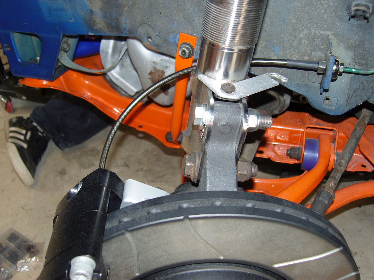

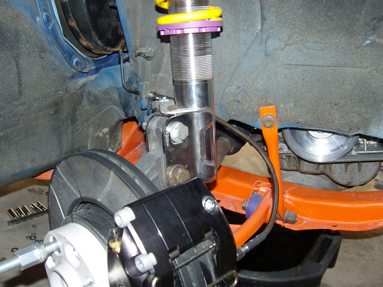

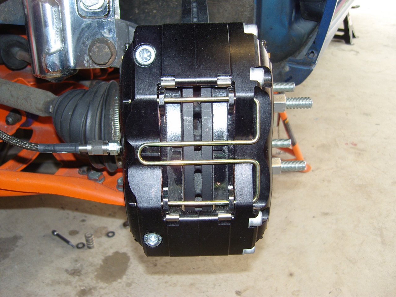

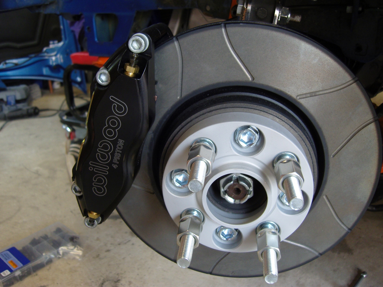

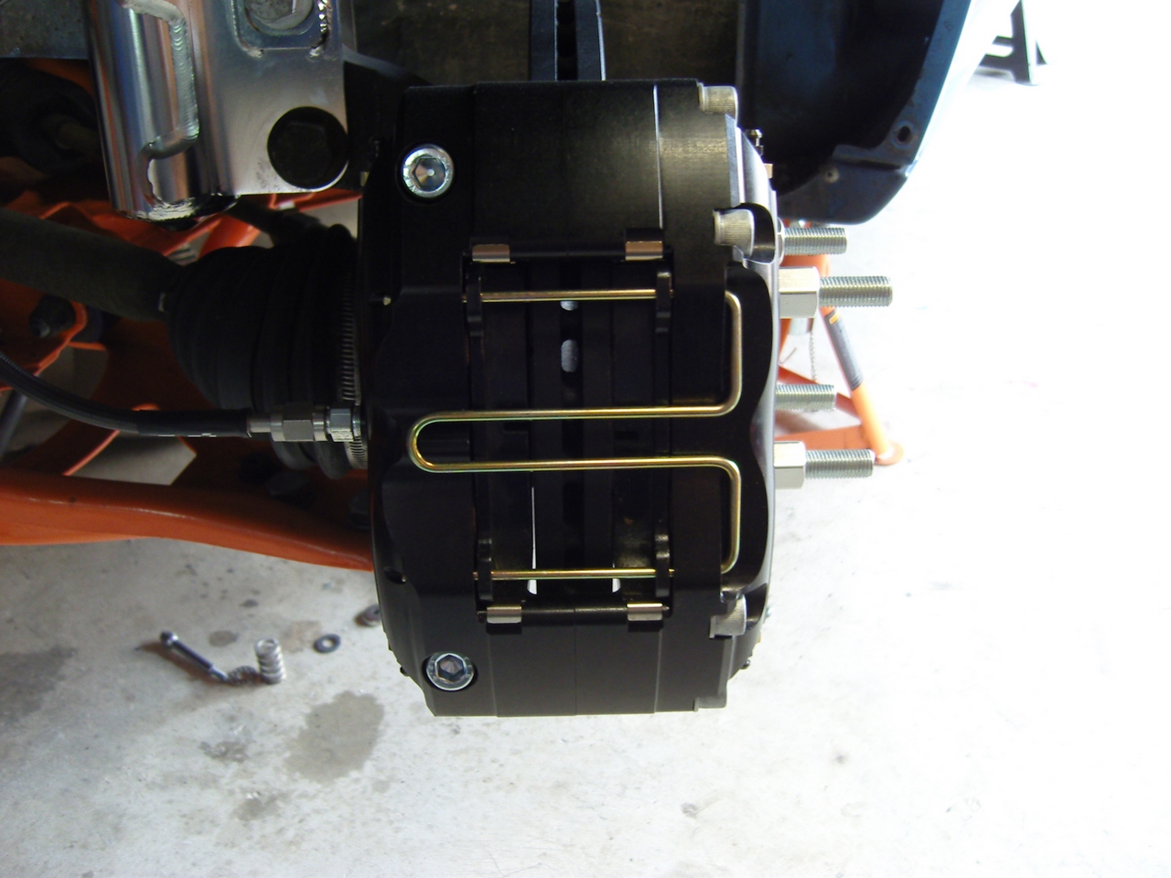

Then we set about fitting the Wilwoods. Very impressed I am with these especially how easy it is to change the pads. The pads I am using initially are Mintex F4R's

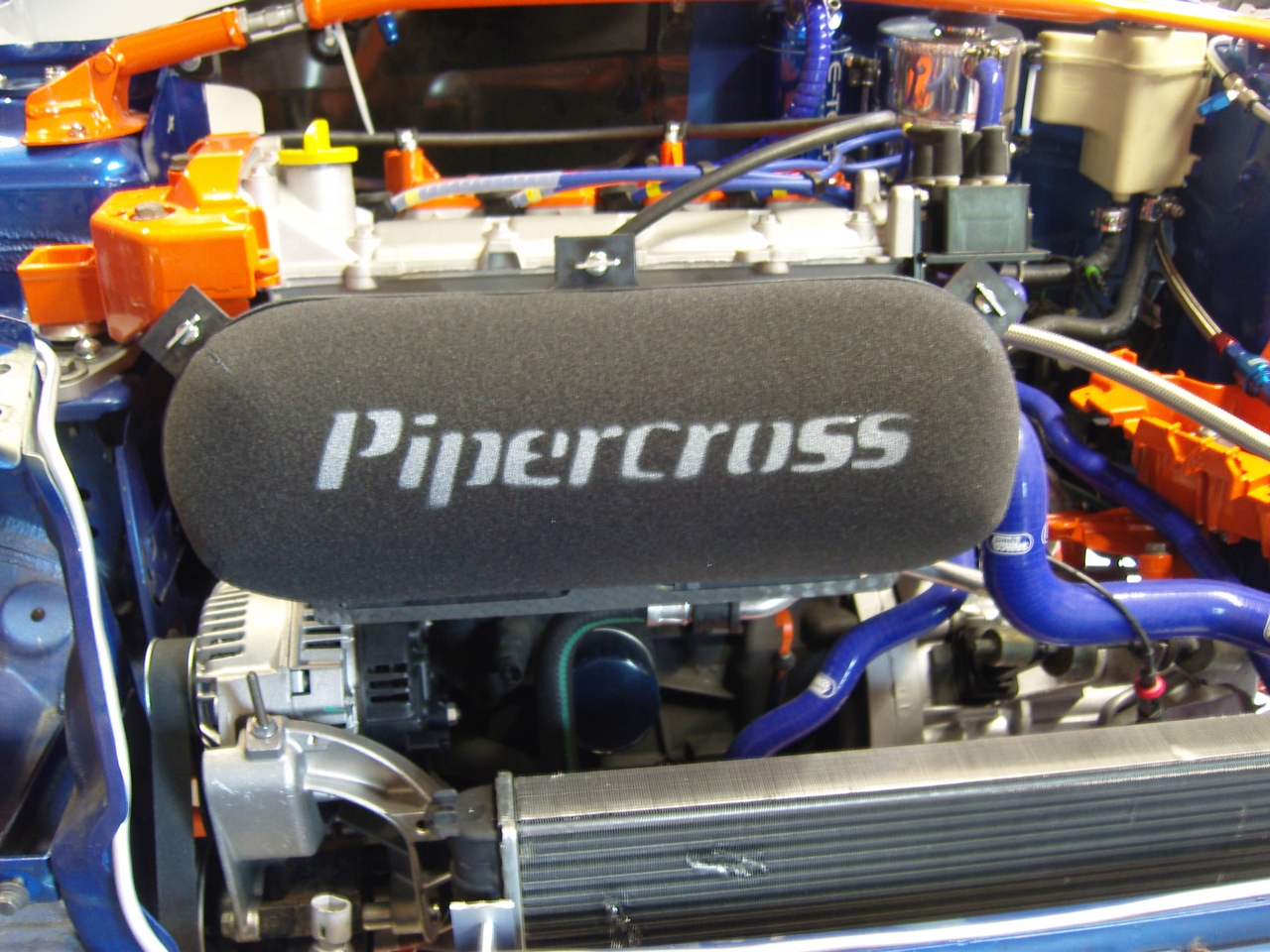

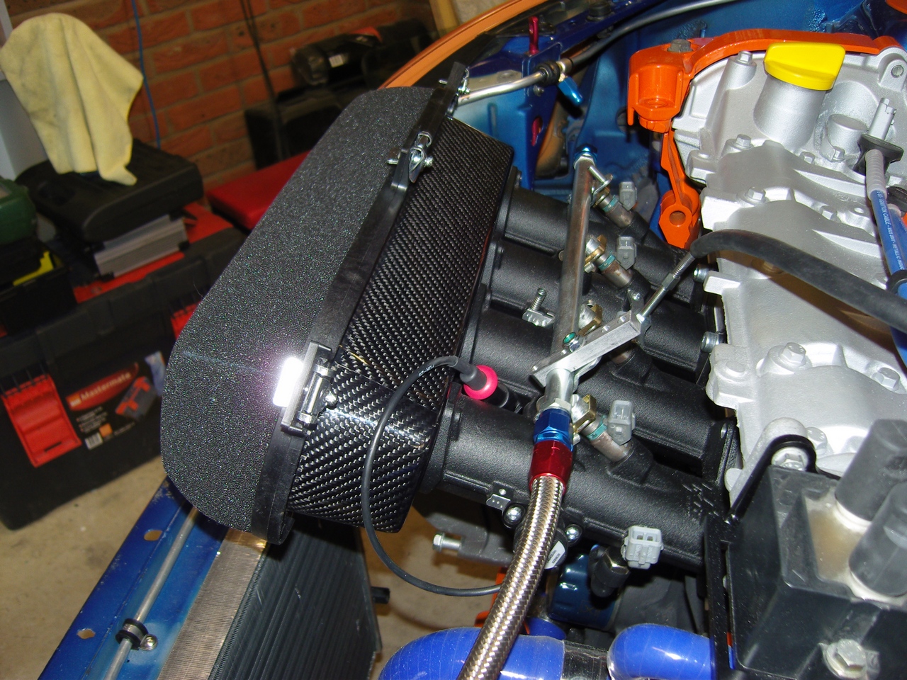

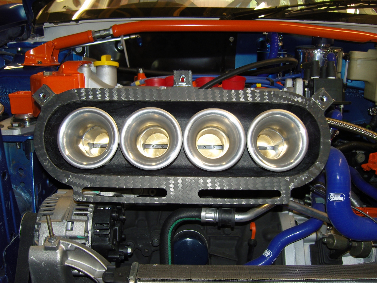

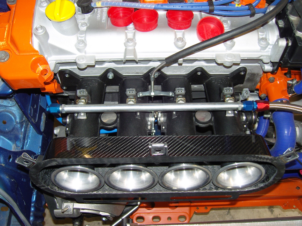

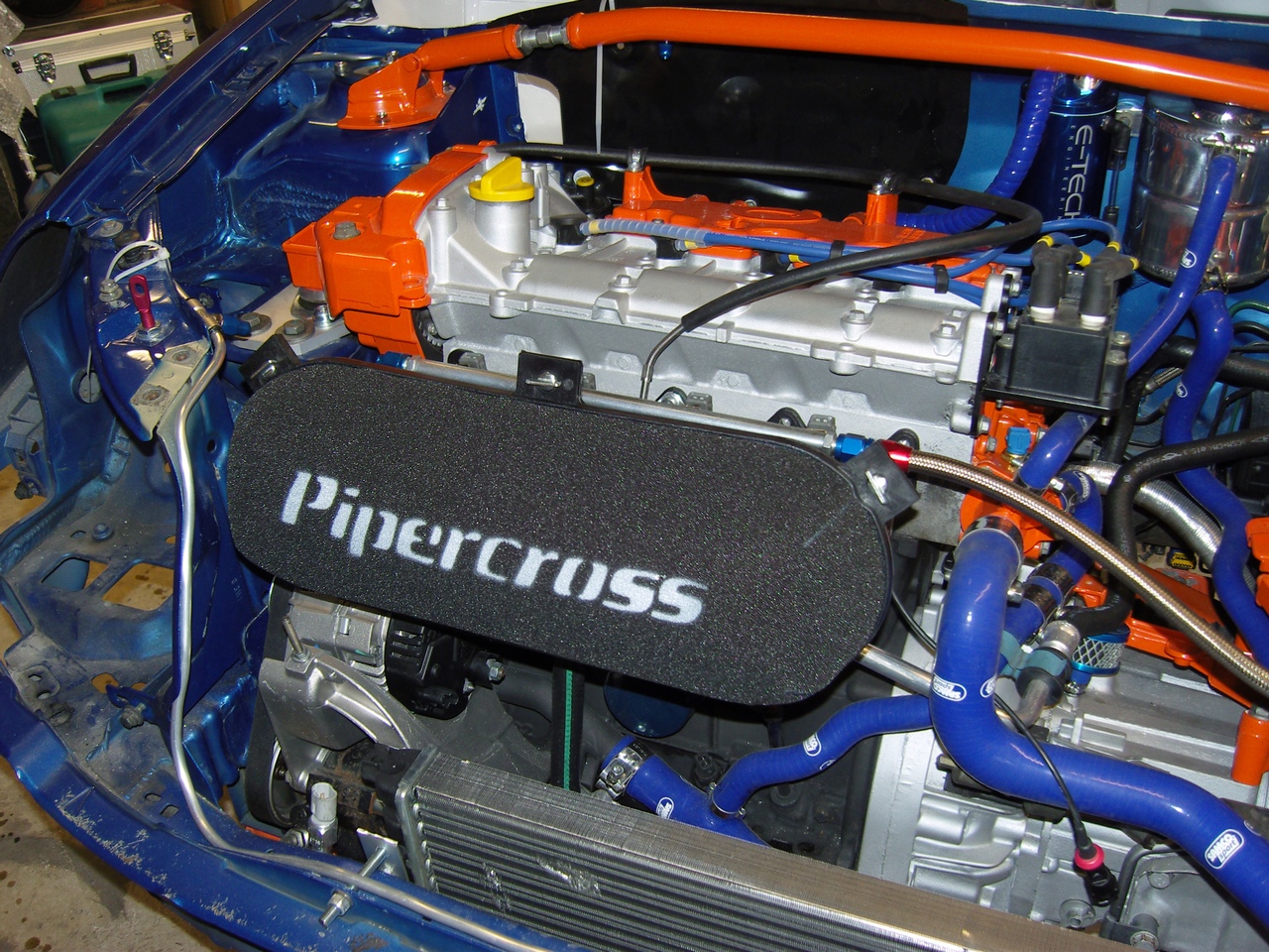

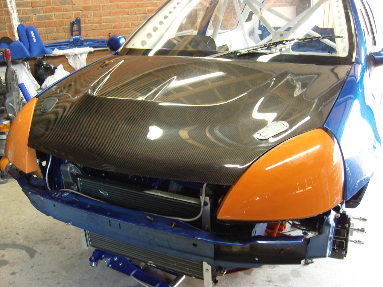

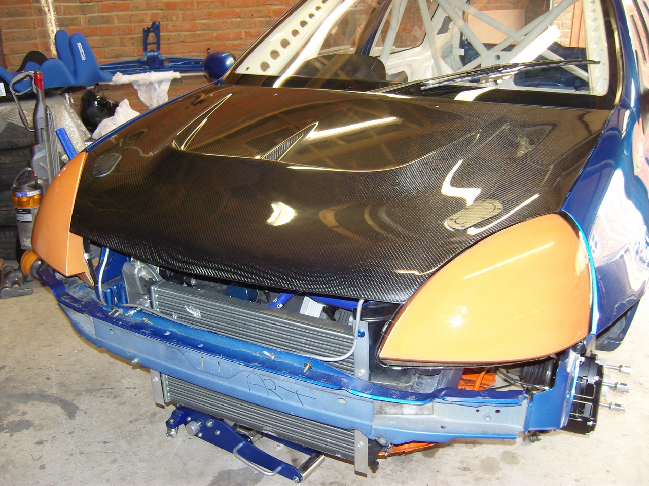

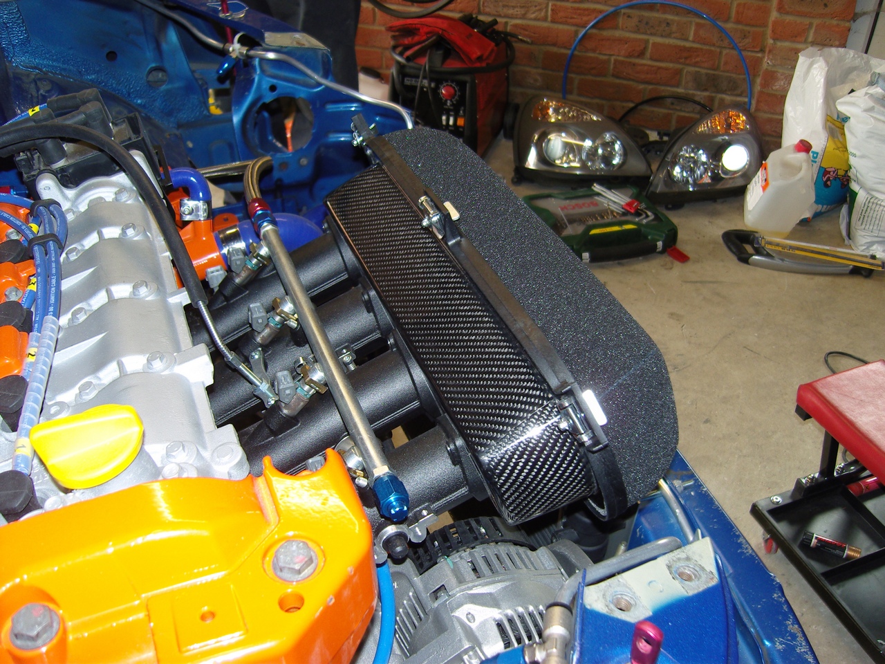

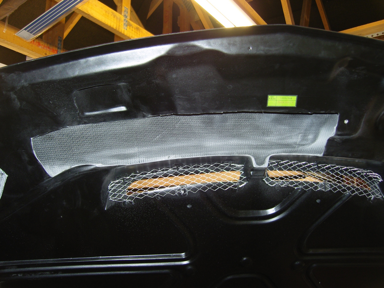

And Chris cut the bonnet out so it will fit over the air filter now.

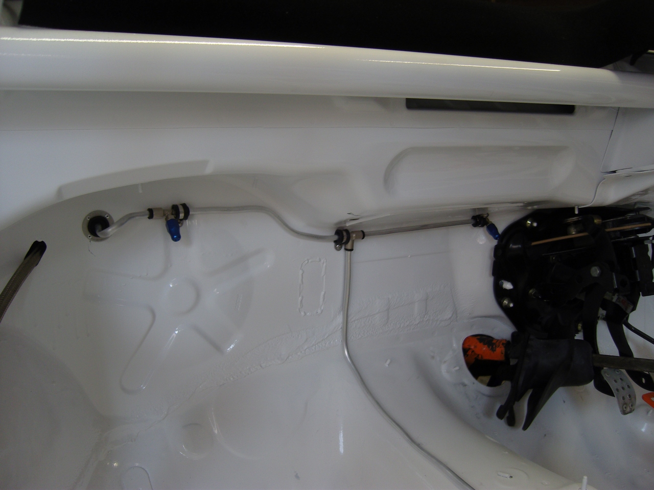

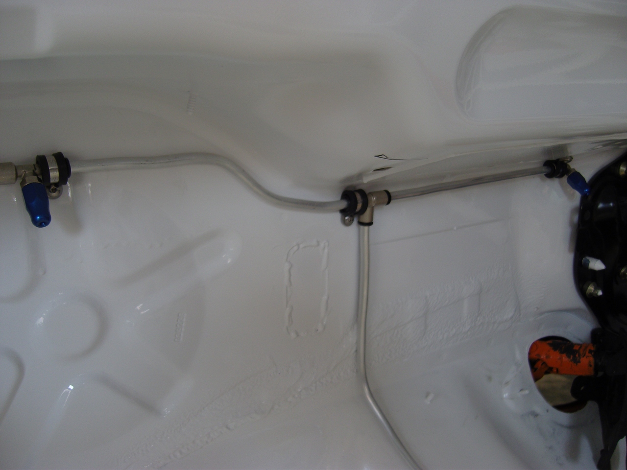

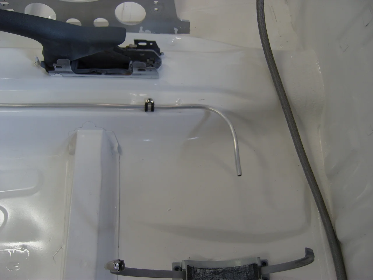

I meanwhile was fitting the P clips to secure my fire system nozzels of which I have 6 in total. 4 are in the engine bay and two in the car.
and then the fire nozzels inside the car
I had bought a pair of headlights so we could cut them out to the shells and we fitted those after painting them orange.

Since it looks like brembo max discs I guess that is K-tec's willwood kit? What pads will you run?

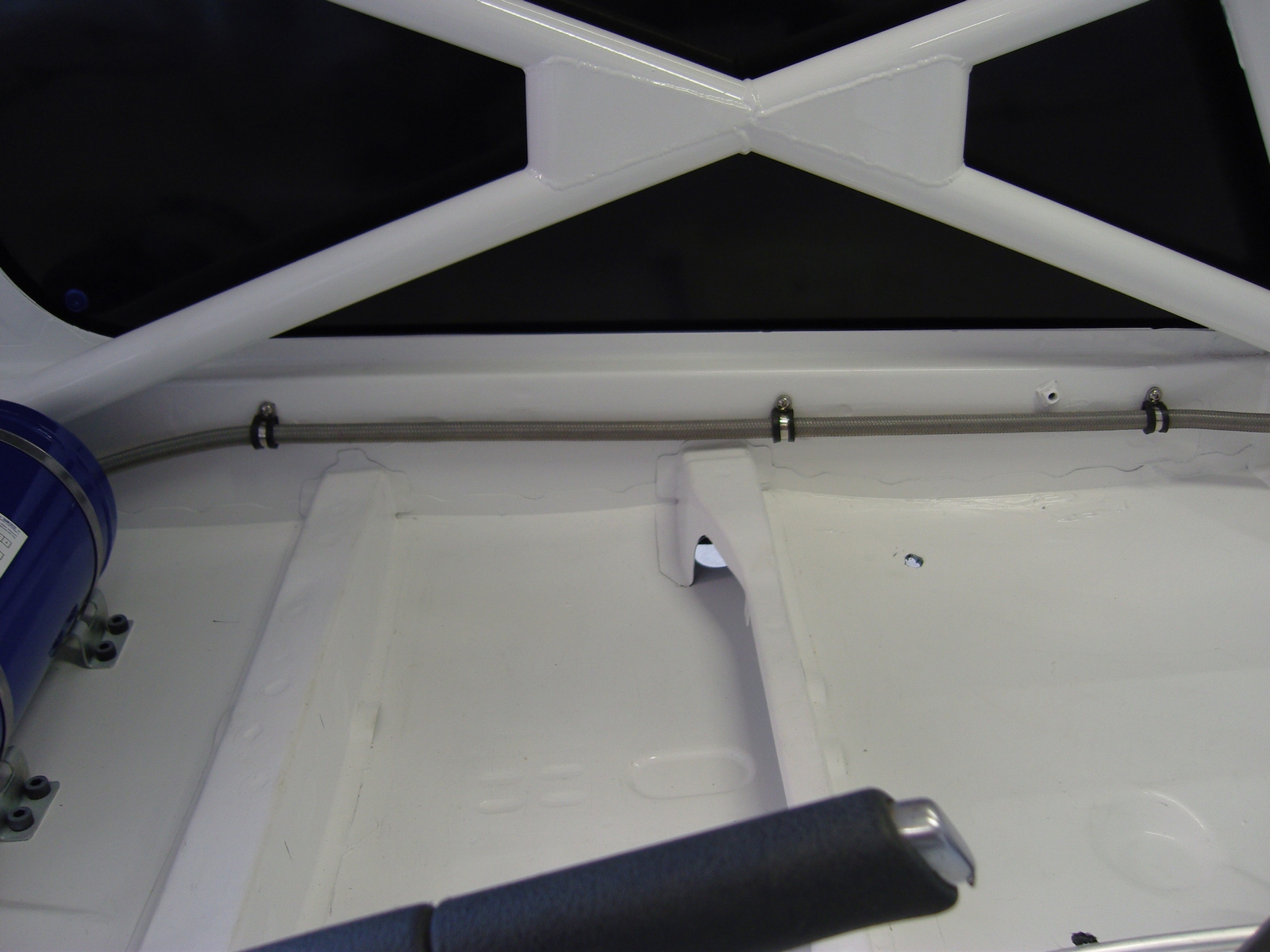

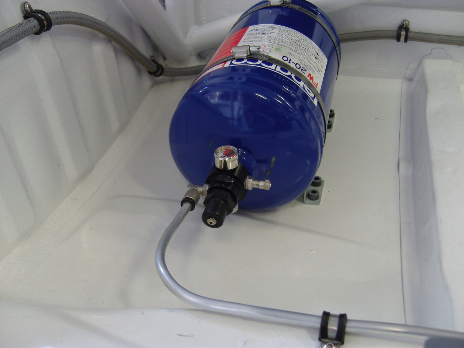

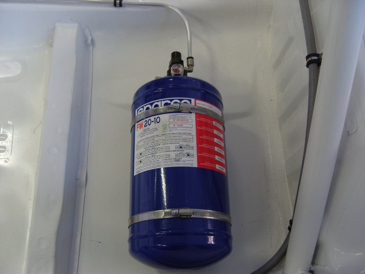

First up I wanted to finish off the fire system and get the bottle in place so I could close that job off (short of wiring at least)

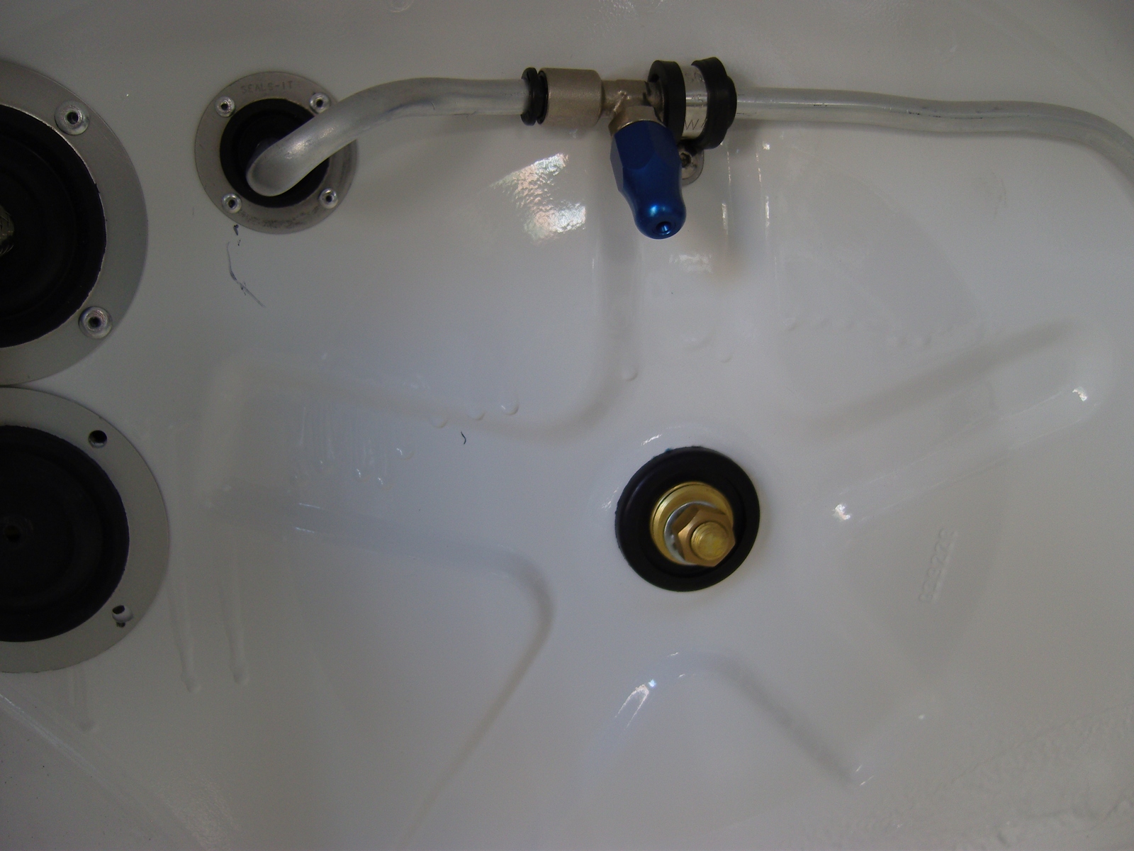

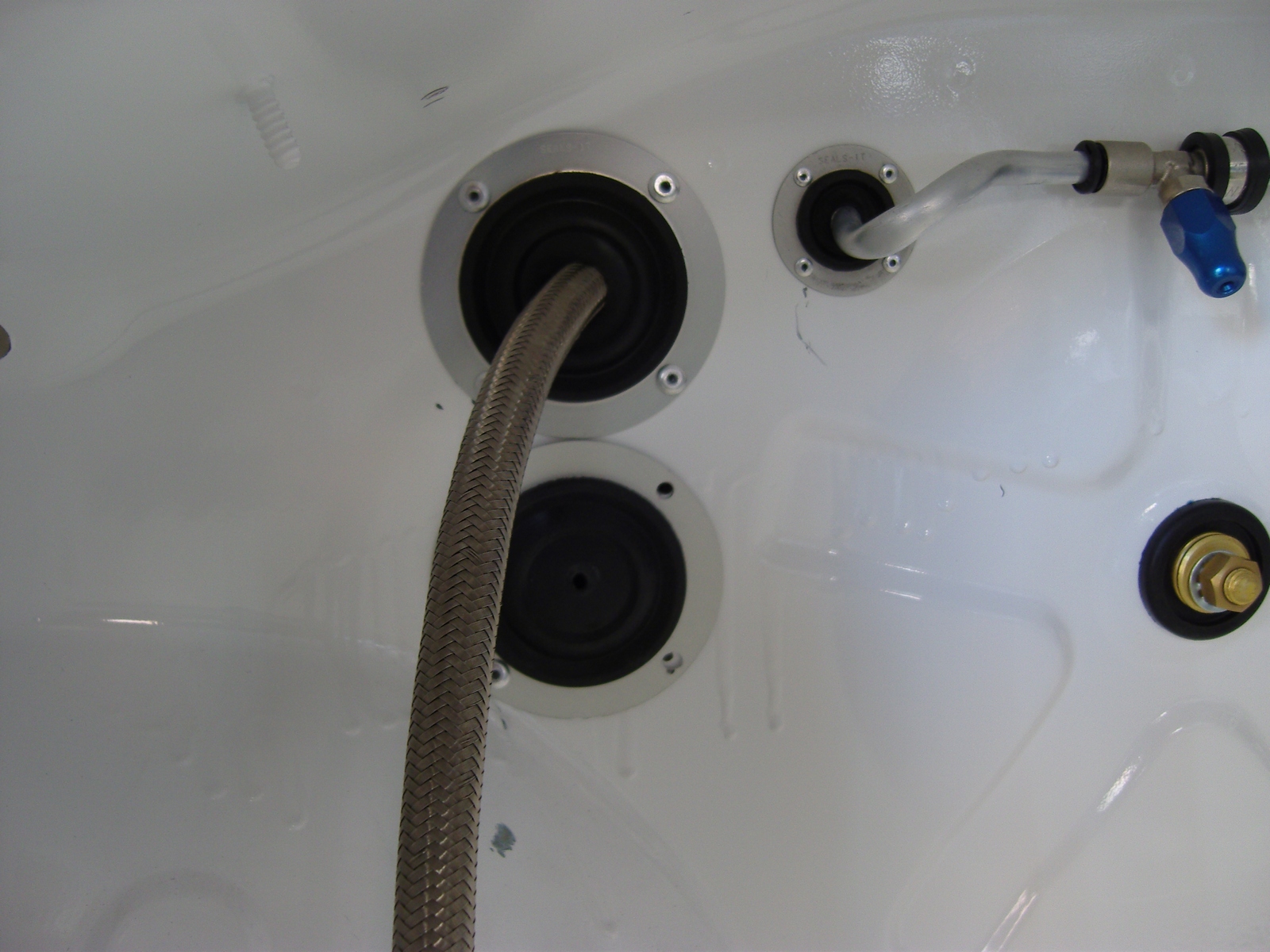

Then I cut the hole for the bulkhead battery connector.

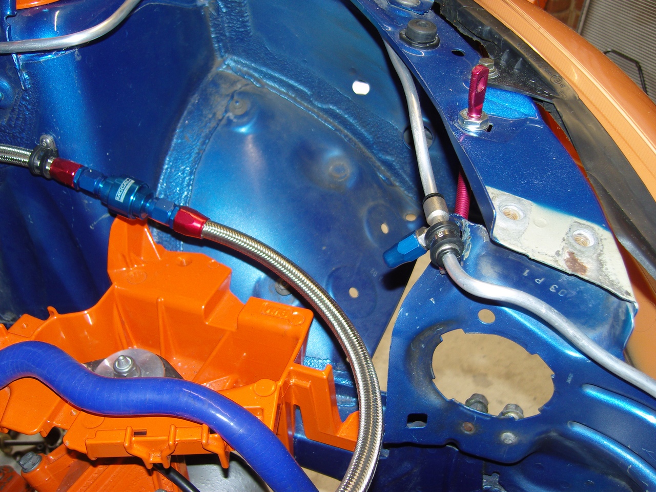

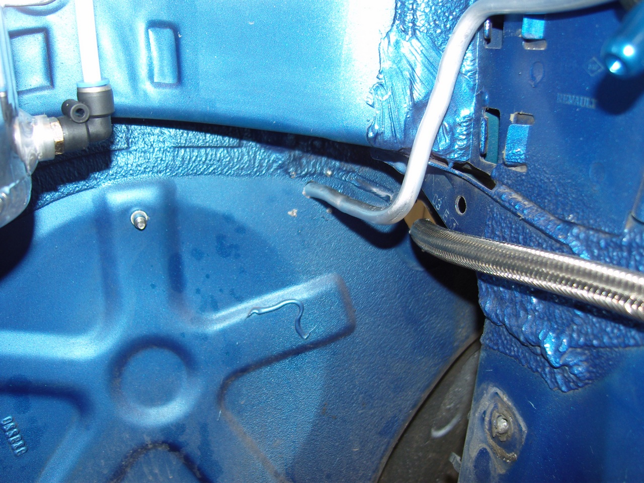

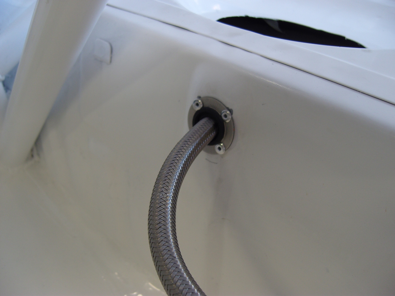

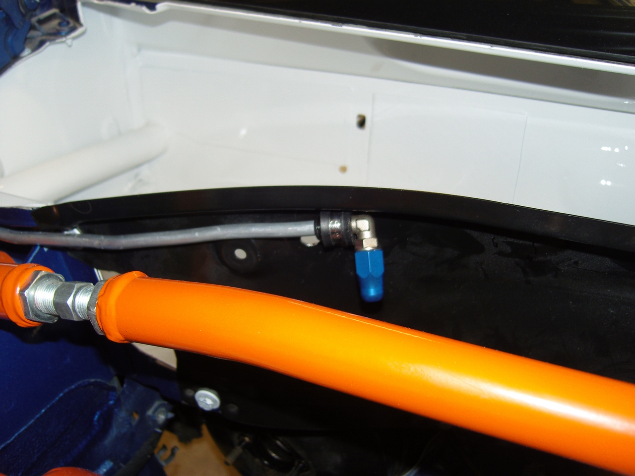

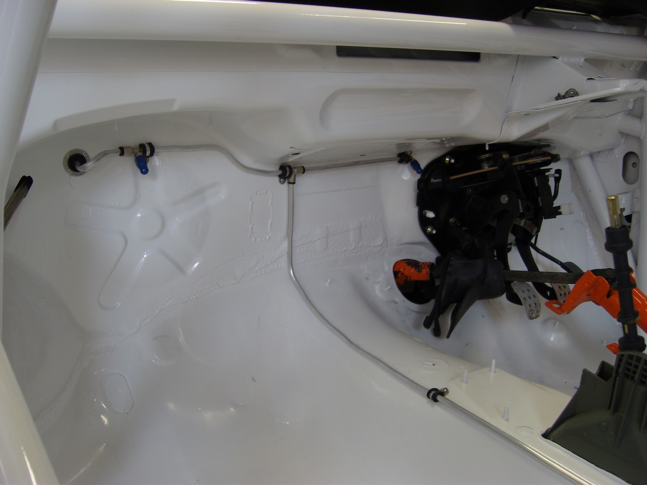

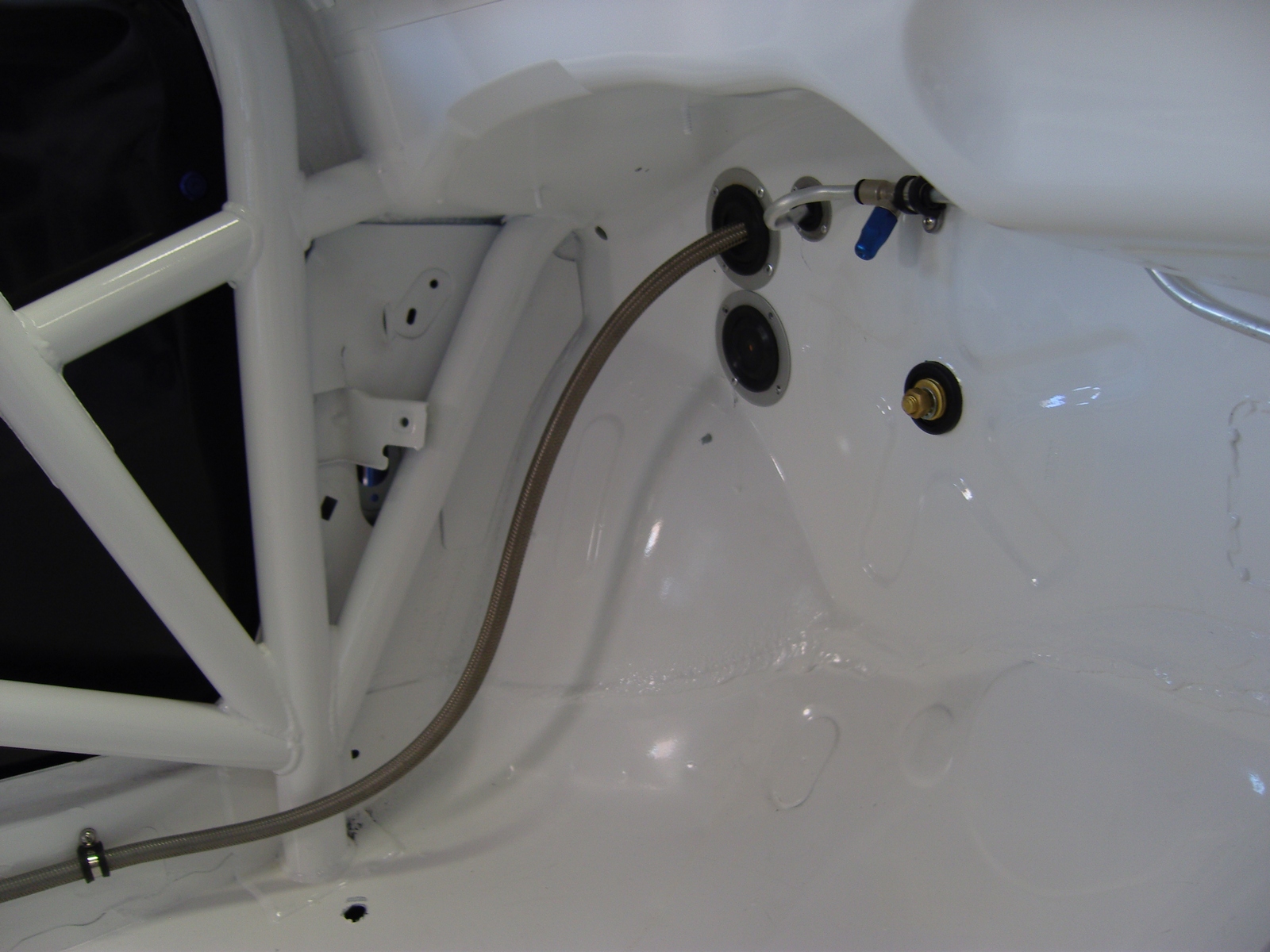

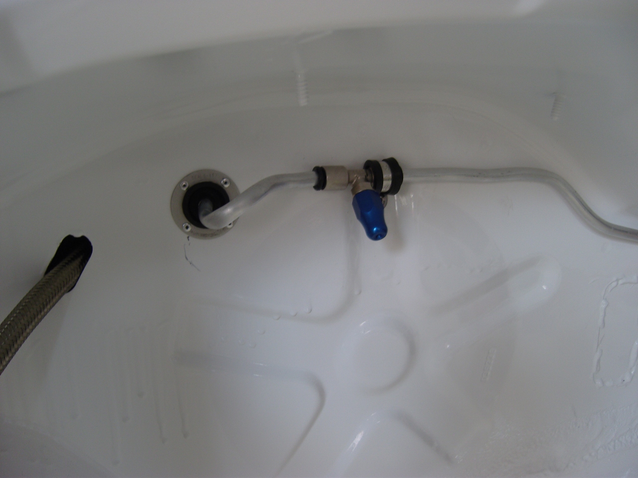

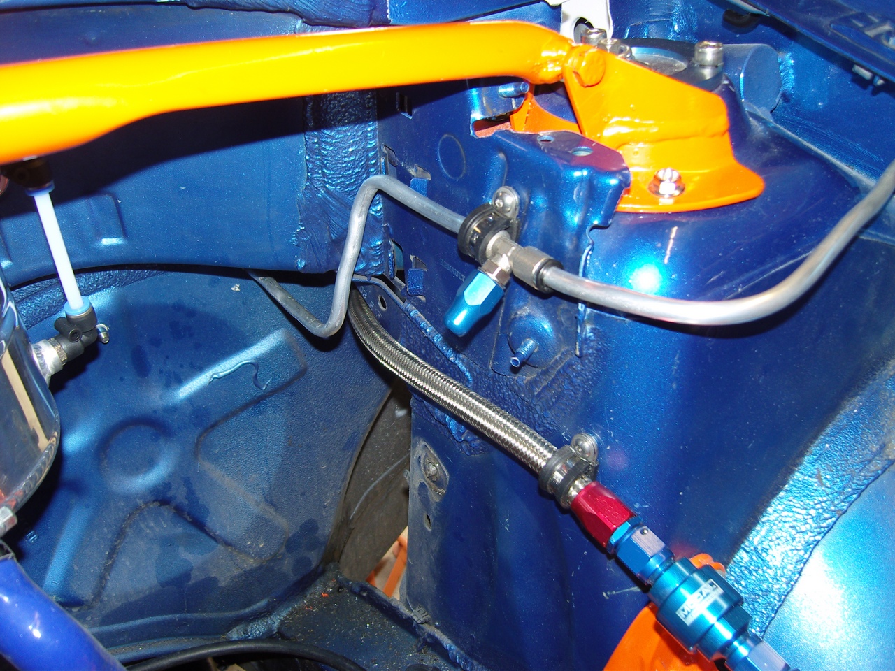

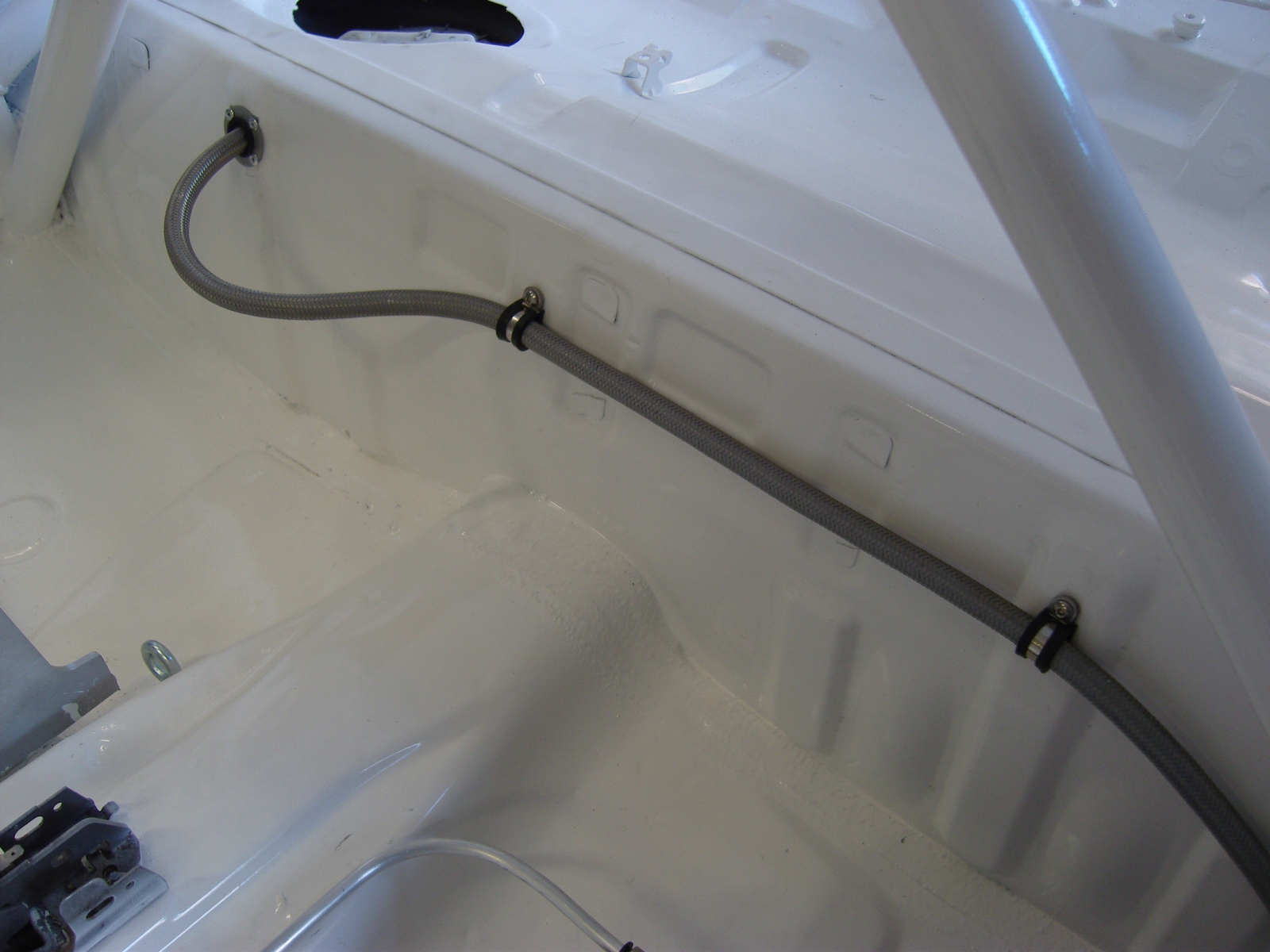

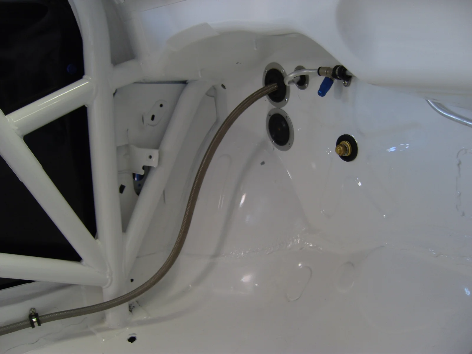

And then set about securing the fuel line inside the car with P clips. As you can see I am using rubber grommets here. The scrut at Britcar told me to use those and so I got a load of them from Deemon Tweeks.

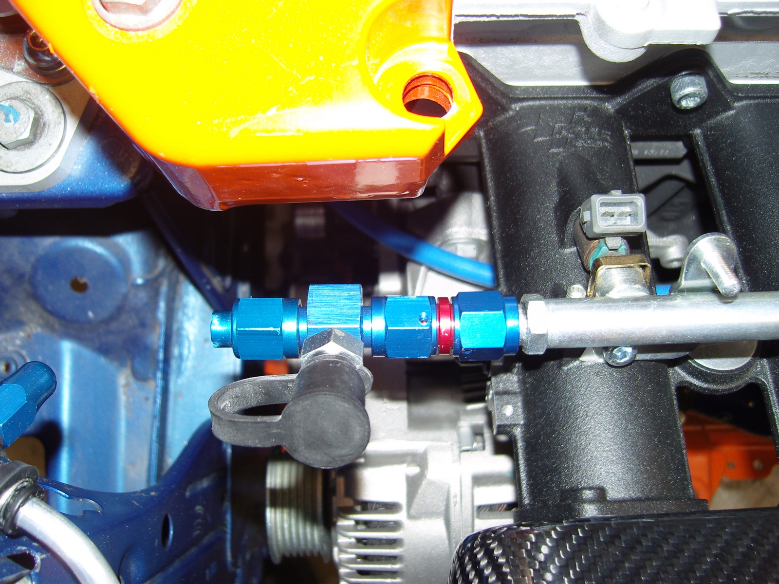

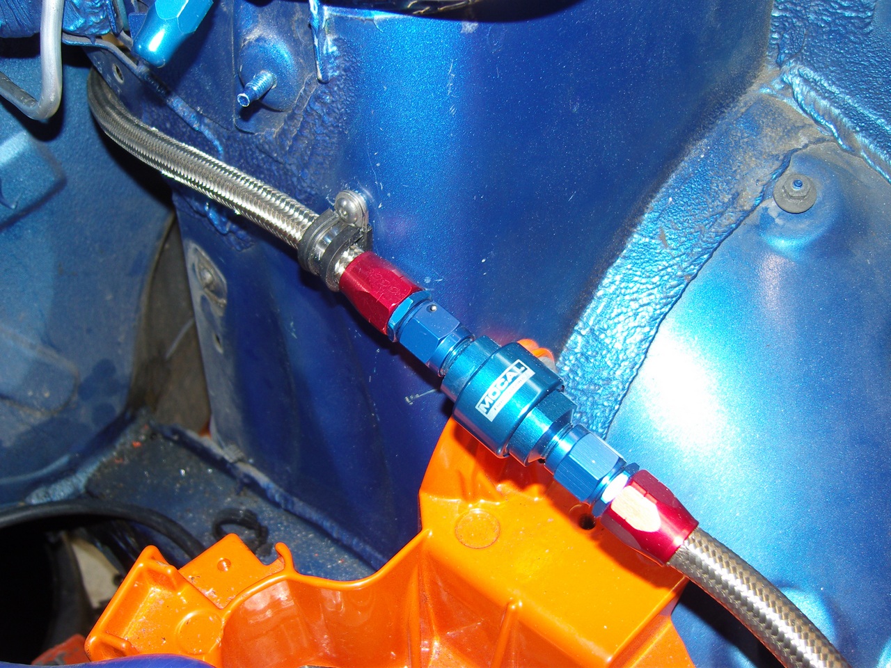

Next I fitted my fuel sample kit to the fuel rail

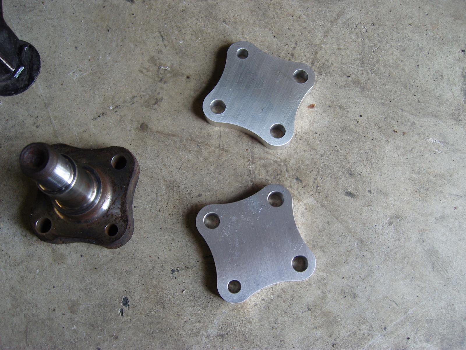

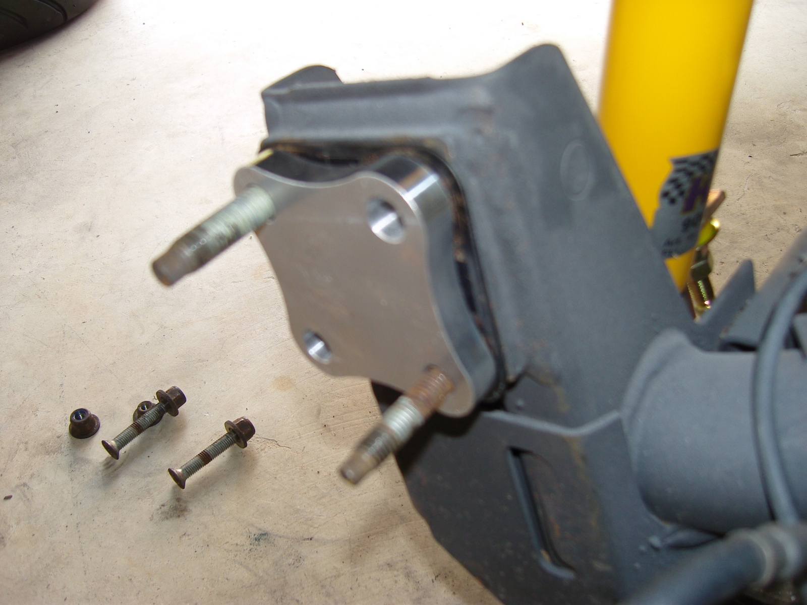

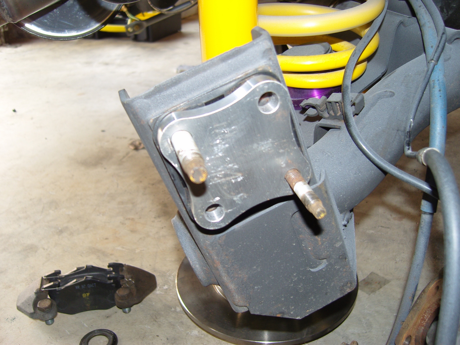

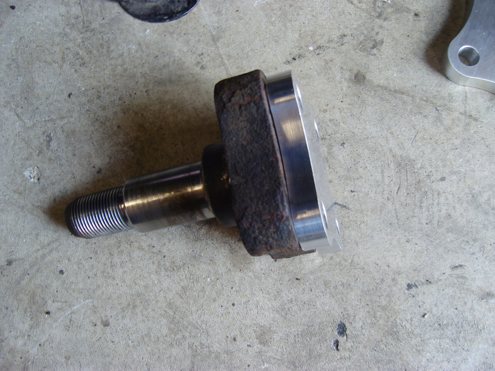

And then put my new 10mm rear spacers that I have had made.

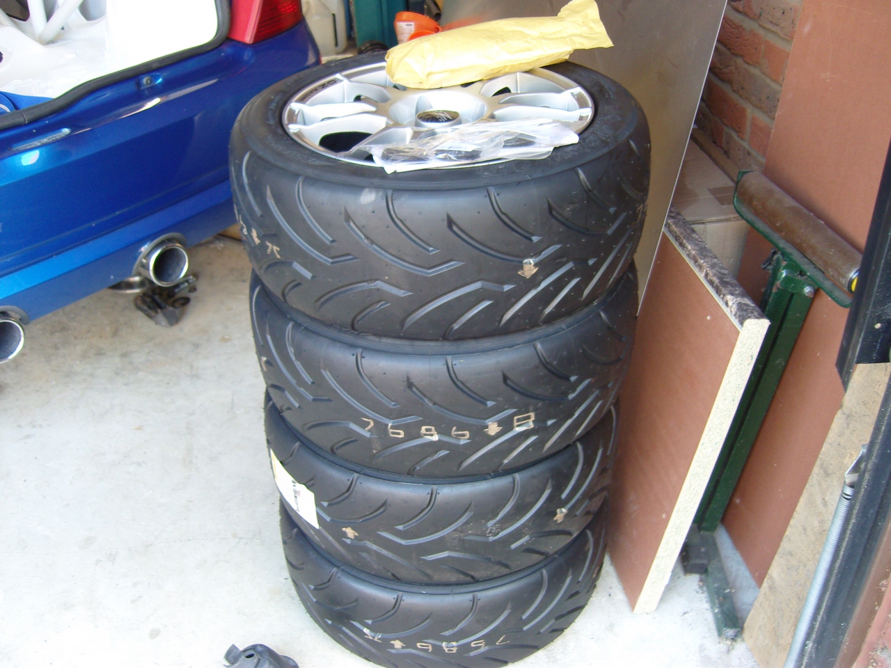

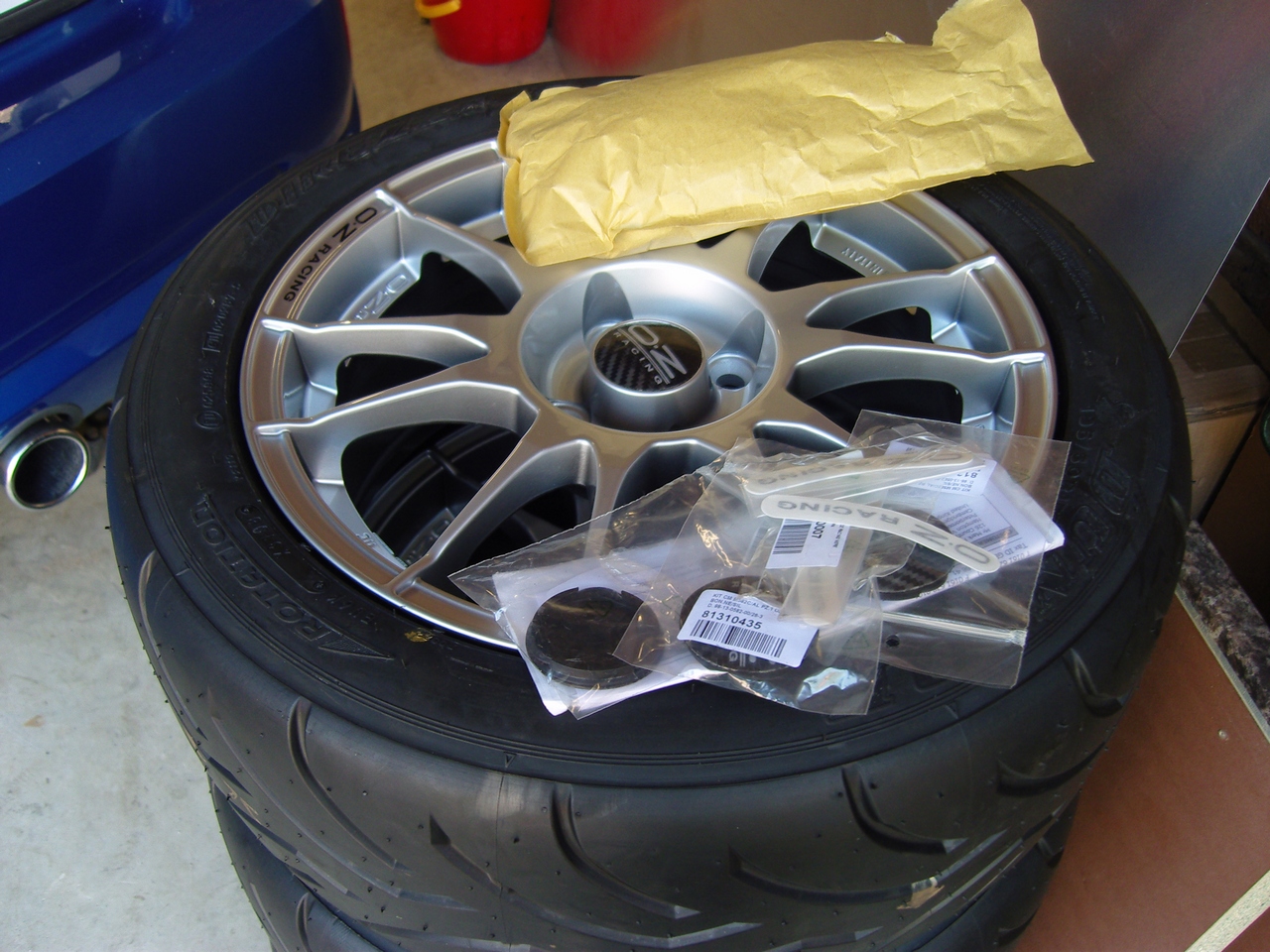

I also managed to get my tyres fitted to my OZ rims.
I guess I need a second set of these. I still can't work out why its ok for a Clio cup to run 17 inch rims but not me.

I dont like the way you have run the fire system. The nozzle you have pointed at the passenger footwell, what it is there for? That nozzle should be pointing at your face/chest. The 2 in the cabin should be at the drivers feet, and the chest as stated above, it is totally redundant in the passenger footwell.
I would also of ran a 2 line system from your T, one goes nearside into the engine bay and the other goes offside to the driver. If you really want the nozzles in those positions, you have effectively got 5 Nozzles running running off 1 side of the T piece (how much fluid/pressure do you think the last nozzle will see?). I would have run 2 lines from the T and ran 3 from one and 3 from the other. The positions are off in the bay as well, the third one around in the bay needs to point at the fuel rail, its not doing a great deal pointing at the cam/aux belts. Did you fit 4 nozzles in the bay because you had 4? You only need 3 really, you have 2 pointing at the gearbox for some reason??? If you dont know what i mean, i will do you a pic of what i would have done.

Finally im not convinced about the Scrutineers judgement on using those grommets for the fuel system, are you sure he said they where ok to use there on the fuel line? You effectively have an open fuel system with that there, the grommet canot seal against fuel getting in, as either vapour or fluid (its not a perfect fit to the line). To create a sealed system, you should have a bulkhead connection with a goodridge (or whatever manufacurers) fittings either side, this is then treated as a sealed system and doesn't require boxing.
the reason for the nozzle in the passenger footwell will be for the electrics and ECU. you should consider using the gas type extinguisher system, its more expensive but if your using the liquid type......that is the race over as everything will be shot. the Time Attack guys used liquid but soon changed to the gas system. but re-think the idea of running 6 off that current system, there is no pressure reducing point on the nozzles, so they get the most pressure at the closest 1.
the gromets for the fuel line look ok to me, i've seen alot of clubman level cars and britcars.

The nozzle in the pax footwell just points at the extinguisher, there are no electrics currently there. If thats there intended location, it makes more sense, but i dont know that. It still needs a second pointing at the driver, removing one of the ones from the engine bay would be the other option then (4 is overkill there anyway).
The way the fire extinguisher is Plummed in is the way the instructions said it should be. All the electrics are on the false floor on the passenger side so the nozzle is for that.

I don't know much about the fuel query so can't really comment on that.

A few issues and observations. I dont like the way you have run the fire system. The nozzle you have pointed at the passenger footwell, what it is there for? That nozzle should be pointing at your face/chest. The 2 in the cabin should be at the drivers feet, and the chest as stated above, it is totally redundant in the passenger footwell. I would also of ran a 2 line system from your T, one goes nearside into the engine bay and the other goes offside to the driver. If you really want the nozzles in those positions, you have effectively got 5 Nozzles running running off 1 side of the T piece (how much fluid/pressure do you think the last nozzle will see?). I would have run 2 lines from the T and ran 3 from one and 3 from the other. The positions are off in the bay as well, the third one around in the bay needs to point at the fuel rail, its not doing a great deal pointing at the cam/aux belts. Did you fit 4 nozzles in the bay because you had 4? You only need 3 really, you have 2 pointing at the gearbox for some reason??? If you dont know what i mean, i will do you a pic of what i would have done. The removal of PAS is a very poor choice on a car your intending to run in endurance events. You may regain 5bhp by removing it, but the extra fatique and effort you will have as a result dont outweigh the weight advantage and power gains. In a sprint car (20min sessions) it makes sense, but on an endurance car it really doesnt. Have a look at the various Lemans/VLN/Britcars etc cars that run for 2hrs plus, see how many of them run without it. Finally im not convinced about the Scrutineers judgement on using those grommets for the fuel system, are you sure he said they where ok to use there on the fuel line? You effectively have an open fuel system with that there, the grommet canot seal against fuel getting in, as either vapour or fluid (its not a perfect fit to the line). To create a sealed system, you should have a bulkhead connection with a goodridge (or whatever manufacurers) fittings either side, this is then treated as a sealed system and doesn't require boxing.
Hi Thanks for taking the time to write such comprehensive comments. Ok firstly: 1. The fire system was fitted exactly according to the instructions that came with it and as it is an FIA approved system I assumed the instructions also meet that FIA approval. This is my first race car build of any kind and I and Chrispy have noticed that most of the comments I recieve are generally negative and more importantly are given after the fact! :) It would be MUCH more helpfull if this information was mentioned before I do something as opposed to the generally English trait of slagging off what others are trying to achieve! But to answer your questions: 2. The nozzle in the passenger bay is to cover all the electrics which will be there on a false floor. Had you taken the time to read the whole thread you would have seen this. 3. The nozzels can easily be altered into any desired position, hardly the end of the world! 4. The removal of the PAS is because I am going to spend no small amount of time racing this car in Track day trophy and tin tops. When I get my A license I shall then look at putting together an endurance team but that is a ways off yet and again it is a very small job to refit the PAS. Again this has been mentioned numerous times now. 5. I have spoken to scruts several times and also emailed the one from Britcar who has been most helpfull and friendly. Those grommets are fireproof. Again if I get asked to change them for some sort of through bulkhead fitting I will and again it will be a simple job. What I have learnt from starting this project is that LOTS of people talk a load of s**t! As such I just ring the scrut and also the series organiser and then compare that with FIA and MSA regs. When I was looking for a roll cage I was told by LOTS of people I would not need any paperwork as it only has to be fitted according to FIA specs. Total Bollox. I rang the organisers of the Dubai 24 hour and was told that without the paperwork I would not be allowed to race, that would have been a costly error eh! Custom cages gave me a folder with paperwork and drawings in it that is 6 pages long. So I have learned to pretty much not listen anymore to all the so called knowledgable ones. As such I will make my own mistakes and learn :) I hope that answers your concerns. Mark.. PS I watched touring car at the weekend and the guy had a fire in the car and did'nt even bother to actuate his fire system LOL.
Try Again :)Hi Thanks for taking the time to write such comprehensive comments. Ok firstly: 1. The fire system was fitted exactly according to the instructions that came with it and as it is an FIA approved system I assumed the instructions also meet that FIA approval. This is my first race car build of any kind and I and Chrispy have noticed that most of the comments I recieve are generally negative and more importantly are given after the fact! It would be MUCH more helpfull if this information was mentioned before I do something as opposed to the generally English trait of slagging off what others are trying to achieve! But to answer your questions: 2. The nozzle in the passenger bay is to cover all the electrics which will be there on a false floor. Had you taken the time to read the whole thread you would have seen this. 3. The nozzels can easily be altered into any desired position, hardly the end of the world! 4. The removal of the PAS is because I am going to spend no small amount of time racing this car in Track day trophy and tin tops. When I get my A license I shall then look at putting together an endurance team but that is a ways off yet and again it is a very small job to refit the PAS. Again this has been mentioned numerous times now. 5. I have spoken to scruts several times and also emailed the one from Britcar who has been most helpfull and friendly. Those grommets are fireproof. Again if I get asked to change them for some sort of through bulkhead fitting I will and again it will be a simple job. What I have learnt from starting this project is that LOTS of people talk a load of s**t! As such I just ring the scrut and also the series organiser and then compare that with FIA and MSA regs. When I was looking for a roll cage I was told by LOTS of people I would not need any paperwork as it only has to be fitted according to FIA specs. Total Bollox. I rang the organisers of the Dubai 24 hour and was told that without the paperwork I would not be allowed to race, that would have been a costly error eh! Custom cages gave me a folder with paperwork and drawings in it that is 6 pages long. So I have learned to pretty much not listen anymore to all the so called knowledgable ones. As such I will make my own mistakes and learn I hope that answers your concerns. Mark.. PS I watched touring car at the weekend and the guy had a fire in the car and did'nt even bother to actuate his fire system LOL.
