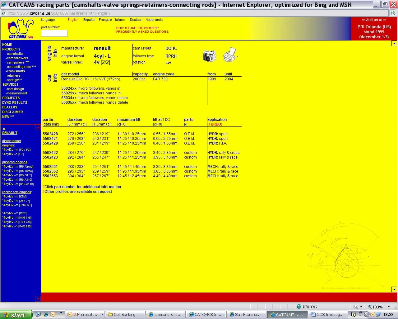

Hmm a Laguna 5th gear eh, I shall bear that in mind. Talking of cams, which ones should I go for when I get them please?
  Golf GTD Mk7
^^ you can yes.
Cam wise, it depends on whether you're sticking with standard internals really mate. I'm running 421's as are Jay and Tony now. Great cams for ITB's. But there are more track focused options out there but you need to mess with lifters, springs.
  Golf GTD Mk7
You'll need uprated springs for those. I believe there is issues with some of the cams causing valve tap on the pistons, but I'm not sure which ones that was. FYI;
There are other companies than catcam though.
  Golf GTD Mk7
In all honesty, i'd try running the car for a bit as is. Get the diff, and see how it goes. At the end of the day it's going to be a new belt kit, cams, and depending what you opt for new springs, valves if you're feeling flush with solid lifters. Head will have to come off as well. Not a quick job really.
