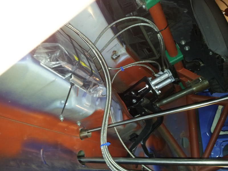

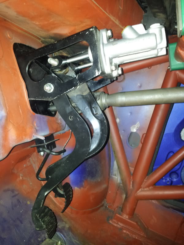

Decided to go the handling route first and am fitting a diff. Can I covert my clutch to hrdraulic so i can fit a pedal box? Anyone done that or is there a kit?

If it is anything like my car a fllor mounted solution couldnt be done due to legroom issues..
is there room to pass the cylinders through the bulkhead and have them sat in the engine bay?? Or is the manifold too close??
If so you may have to look at what i made and position them pointing up towards the back of the clocks...
as for converting to hydrauluc clutch, some of the 106 boys use an aftermarket wilwood slave cylinder then bespoke brackets to strap it on to the original cable linkage arms on the box...
