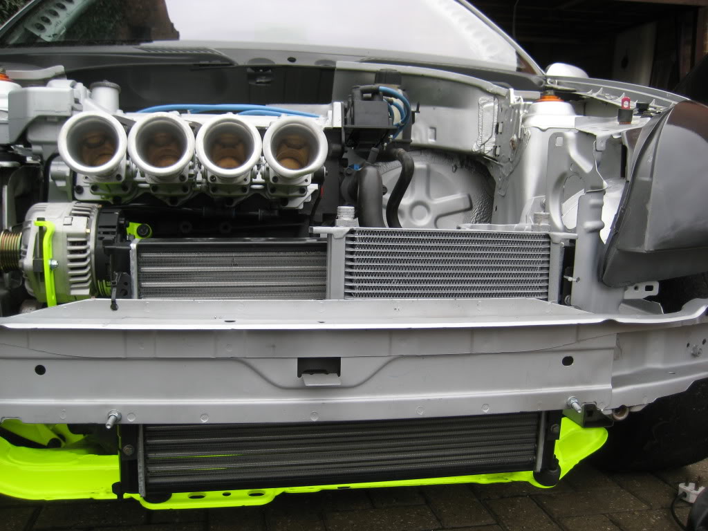

Just wondering about endurance racing. I usually take my car out for 25-30 minute sessions on a trackday then let it cool.
What have you chosen for brake pads, brake discs and also engine cooling (radiator, oil cooler) for endurance racing.
If the car gets used for endurance racing then lots more will be changed. At the moment it has been devloped for TDT with 45 min races. After the shakedown we have decided to add an oil cooler and I will also now get some softer tires as we struggled to get heat into the Direzzas on such a cold damp day. I am also adding back in the mirror adjuster on the switch panel.Mark
Did you even consider going without an oilcooler?
Yes based on early advice, but now we have run it we can see it's needed. How many rows do you think is optimum?
I can imagen, did first trackday without and temperatures went up to over 140c... not good.

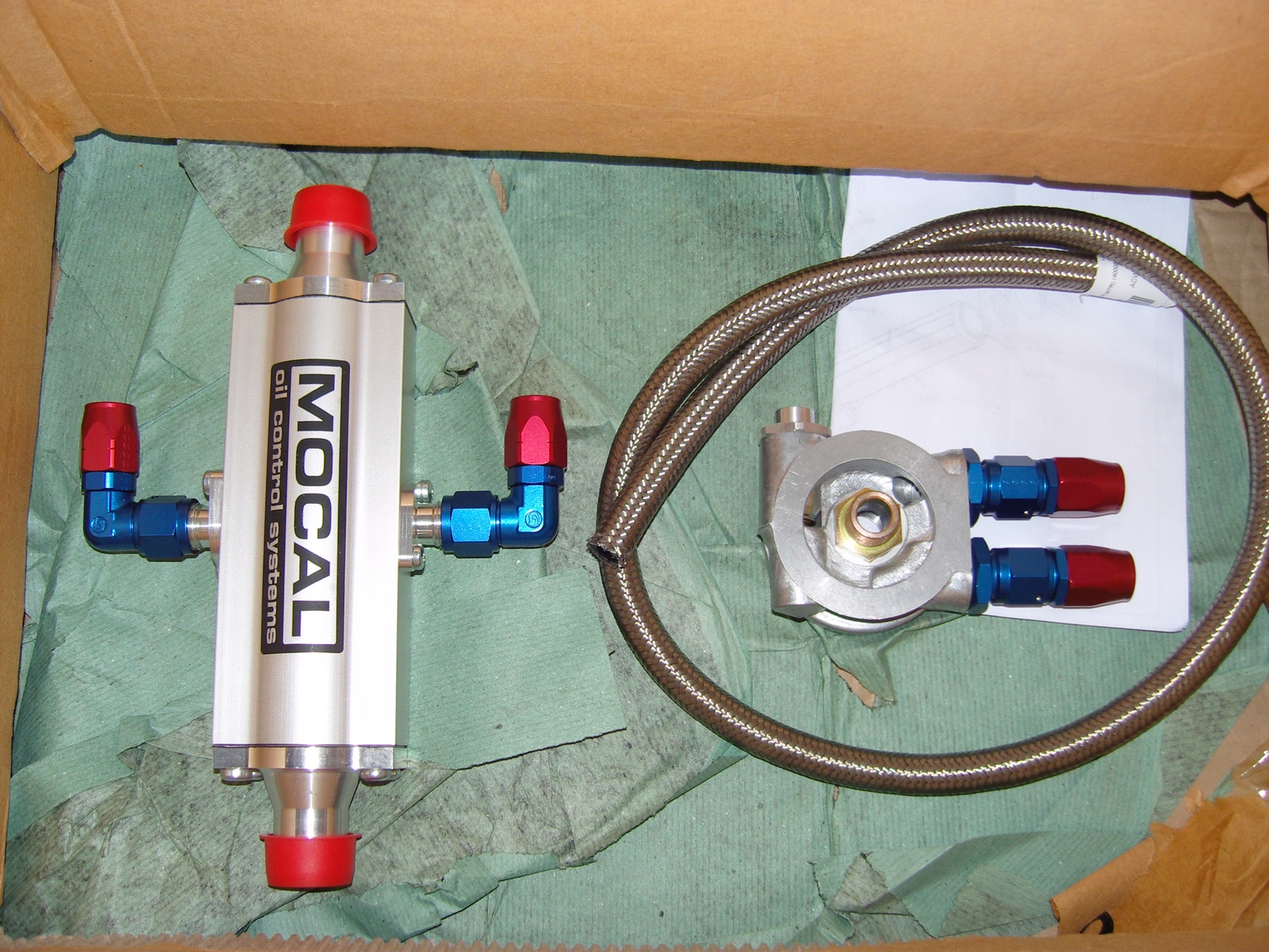

At first I went for a Mocal 10row 235mm wide (same as Ktec sells in their kit) but the car was still a bit on the hot side so I upgradet to a 13row and I think its perfect now. Never over 100c even at a very hot day. May need to tejp it over on a cold day though even with a thermostat.
And I measure temp in the sump. So 100 degrees is before the cooler so oil in is a fair bit cooler than that.
And a final tip... I went for a steel braided hose at first but after a year they looked like sh*t, a lot of sharp metal pieces sticking out and they may well have punctured the tubing. They also rubb a lot on everything they get in contact with.
I had a local workshop press custom hyduralic hoses of same quality as in excavators and such. They are cheap payed about £15 for both. These have rubber cover, and several layers of metal inside, not as flexibe as a single layer braided hose but bulletproof and wount eat everything away in the enginebay.
Have you thought about water cooling the oil? Im considering doing this on my rally car. Just need a small electric pump with a small rad and a heat exchanger oil filter housing. Advantages are you can turn it on/off whenever you want and unlike and oil cooler if it get damaged all your going to spill is water and not all your oil so it wont put you out of a race.
No one does, but you can get the oil filter housing from renault. Then all you need is a small rad some hose and a pump. Will probably work out a bit more expensive but for me its worth it as it means the cars not gonna empty its sump onto the road when the cooler gets wacked.

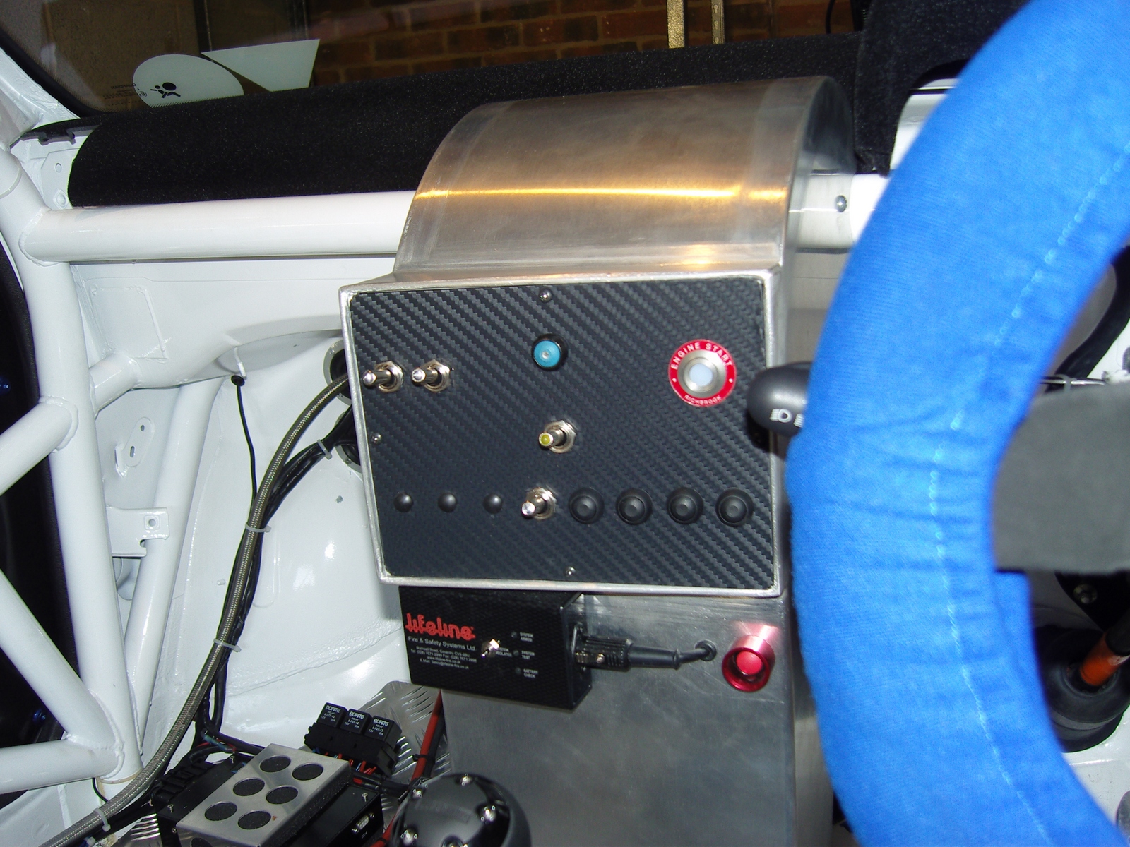

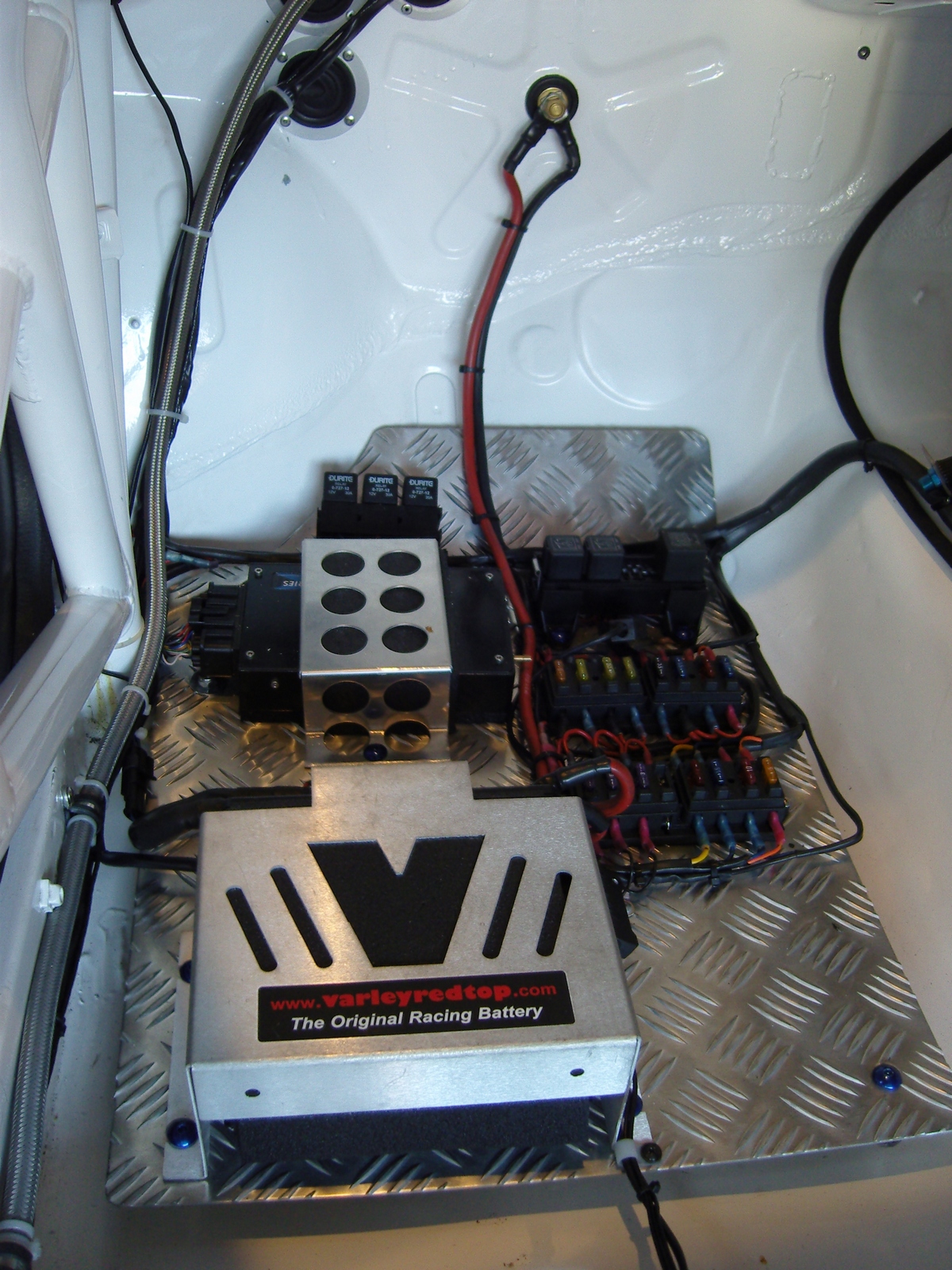

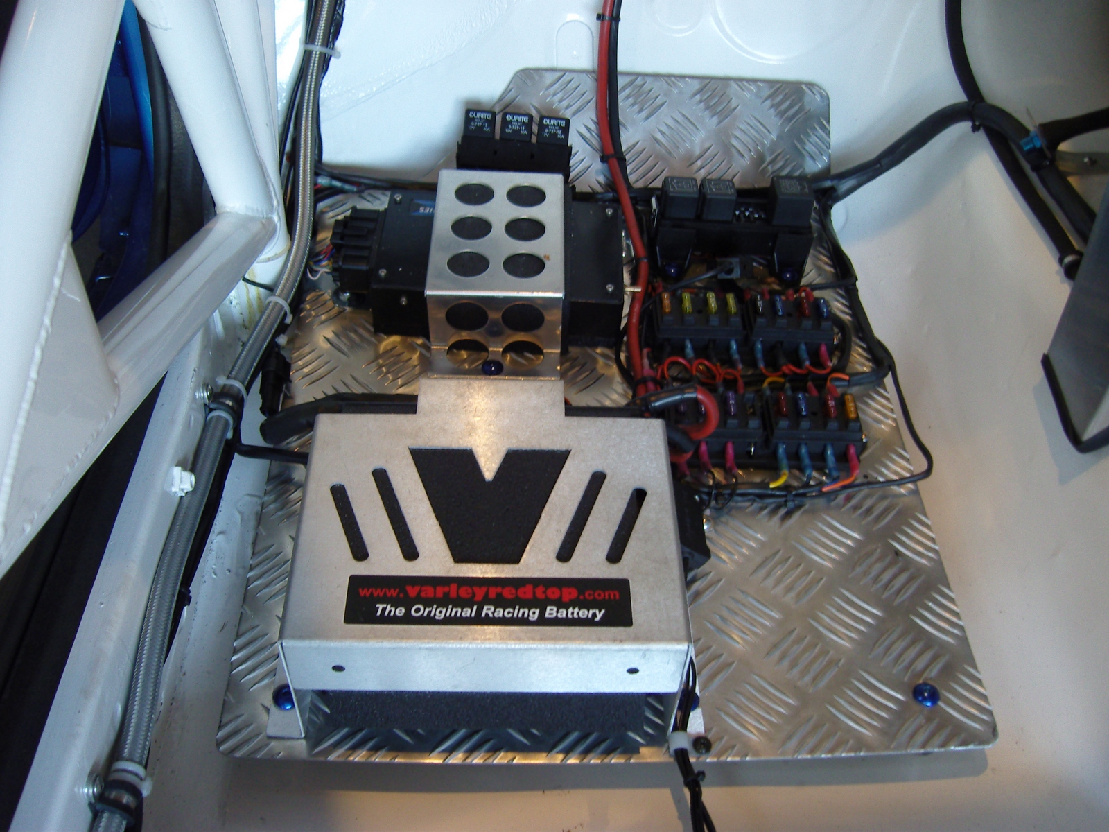

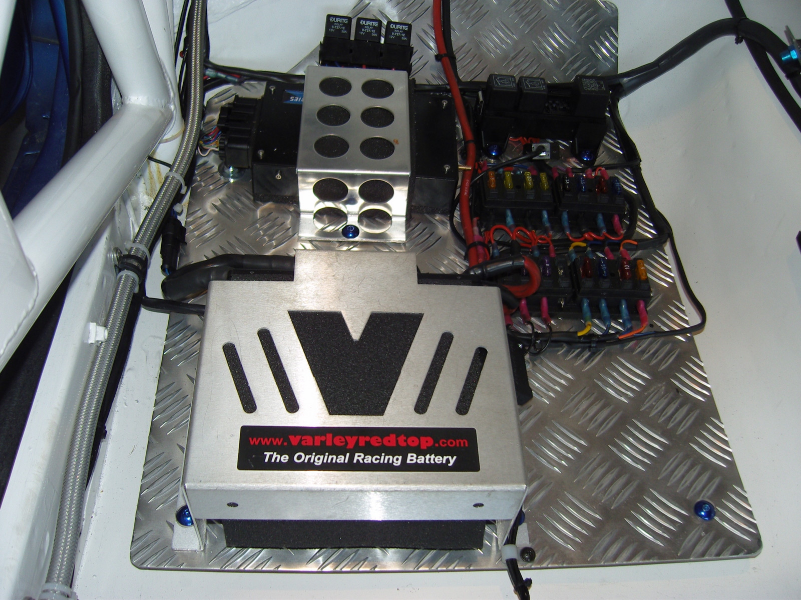

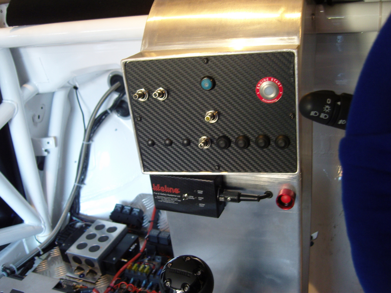

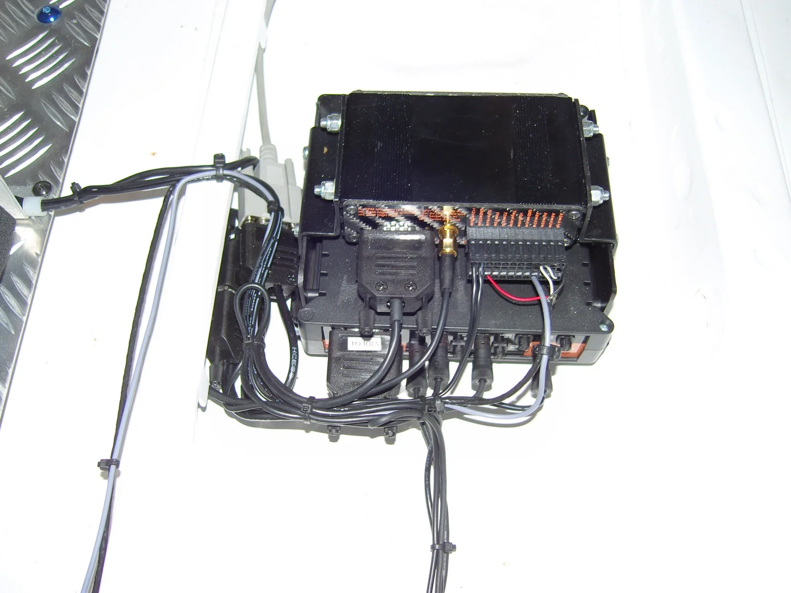

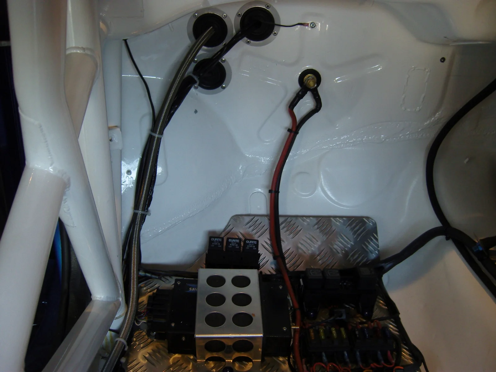

So a short update. Not much going on over winter for me but here are some pictures of the finished electronics and also my new oil cooler (yet to fit)

nice chap. i like that set-up,
i plan to keep all my electronics like that up in the scuttle panel but it does look extremely neat how you have approached it
Looks nice Mark,a true single seater now, with all that on the floor.
Yeh makes it easy to work on being there, I am VERY impressed with Northampton Motorsports neatness on the wiring. Am I gonna see you at a track day this year?
