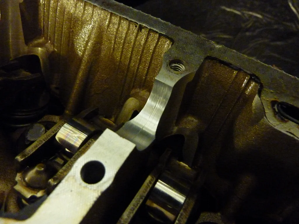

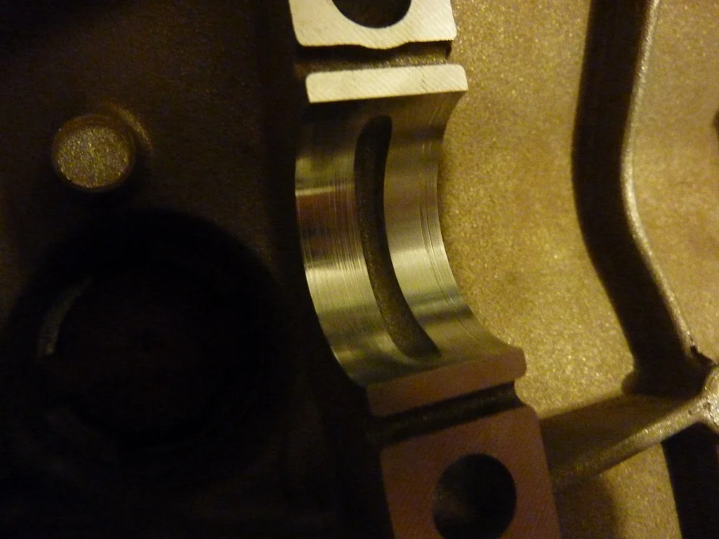

Hi Guys
Just had the top cover off and cams out for inspection.
Cams scored
Head scored where the cams run
Top cover scored where the cams run
is that new head, top cover and cams required?

From what I heard that is a normal Clio sickness and nothing to worry about. My top and cams where just the same. Just smoothed the worst out with 2000 grit paper and put it back together again. If you just post an image of it It will be easier to judge.
EDIT; Is the engine head untouched stock cams etc?
It depends on how bad the scoring is, but in terms of it being a race engine I'd say yes. You can always get the cam cover/head line bored, but that's gonna cost some serious wedge. Plus you've got to find a machine shop that can do it.
Failing that you need to polish the cam journals to remove the roughest parts and refit them, but I wouldn't advise this unless it was a very last resort.
Get some pictures up of it. Can you feel the scores with your finger nail? How deep are they? It really all depends on how bad the scoring is though as Godspeed says.
I remember you saying your oil pressure was low in a previous post. This could have helped to cause this as well.
Mine was rather bad I guess, the worst scratches could easily be felt with your fingernail. I polished the worst out smoothening the edges and put it together with new cams. The engine have been going 2½ years and 24000km since then, most of them under racing conditions and it is still going strong.
This is how mine looked.
Yes top end is all standard. Now I have it all off I shall put cams in it with solid verniers. Where can you get a head and top cover from?
