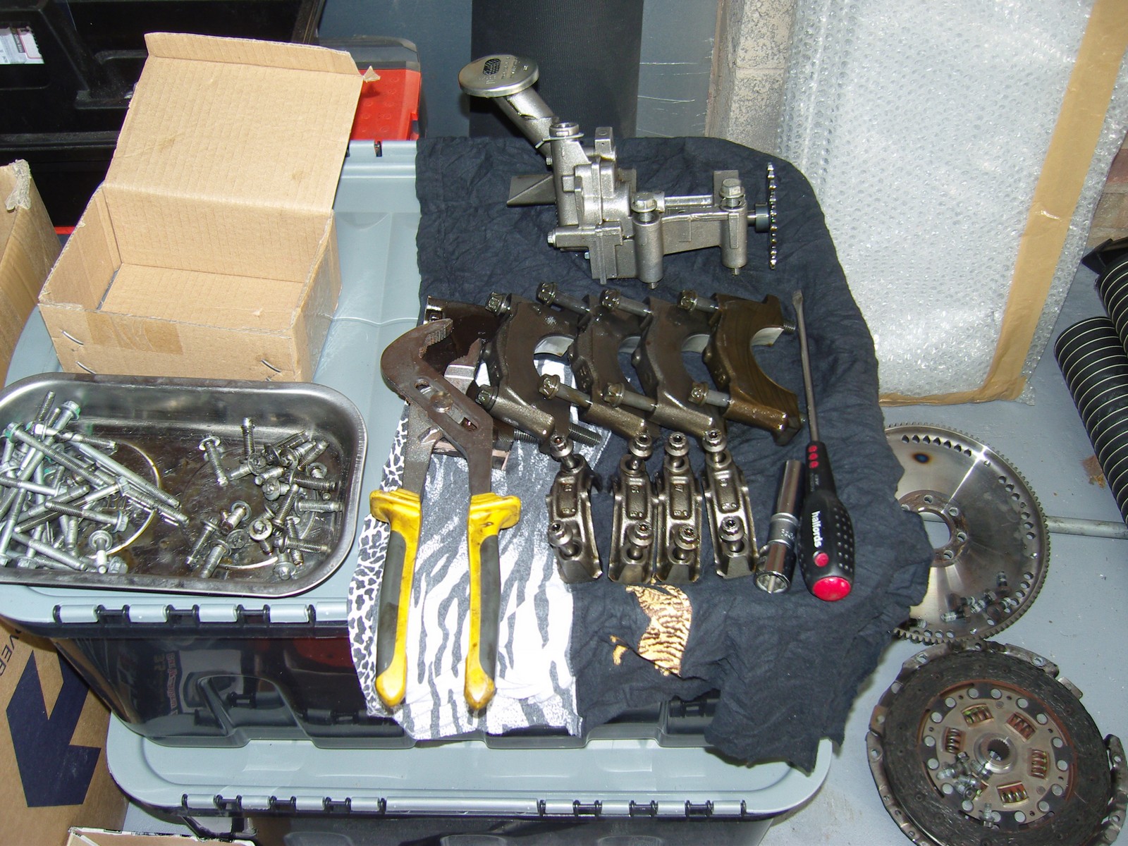

Just so its perfect is all. Just a light skim should do it then. I will probably get the valves re cut to whilst at it.
I got carried away and have decided to get the block rebored as number one and 3 bore have slight scuffs in them. The crank and shells look fine mind you. Can I put oversized rings on the standard pistons?

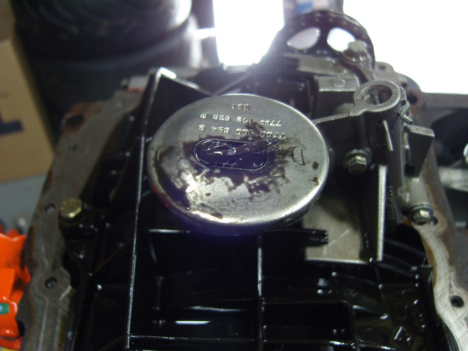

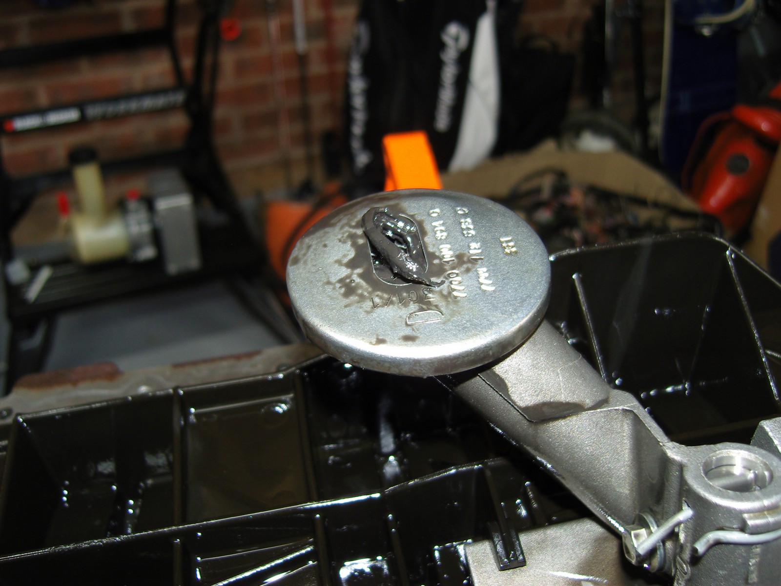

I have scrapped my idea of open verniers after finding this wedged near the timing belt under the cover LOL
This is why you dont put silicone anywhere near your engine when sealing covers etc, or if you do just a very fine smudge of the stuff.

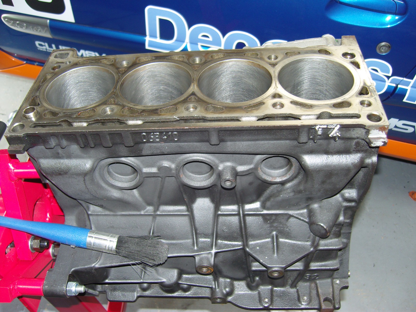

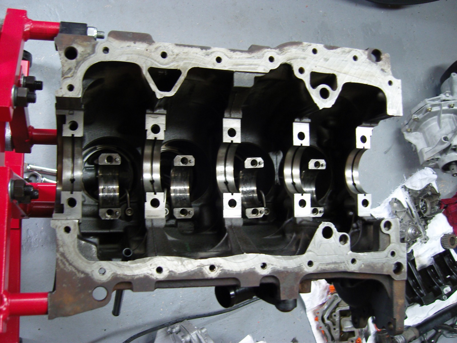

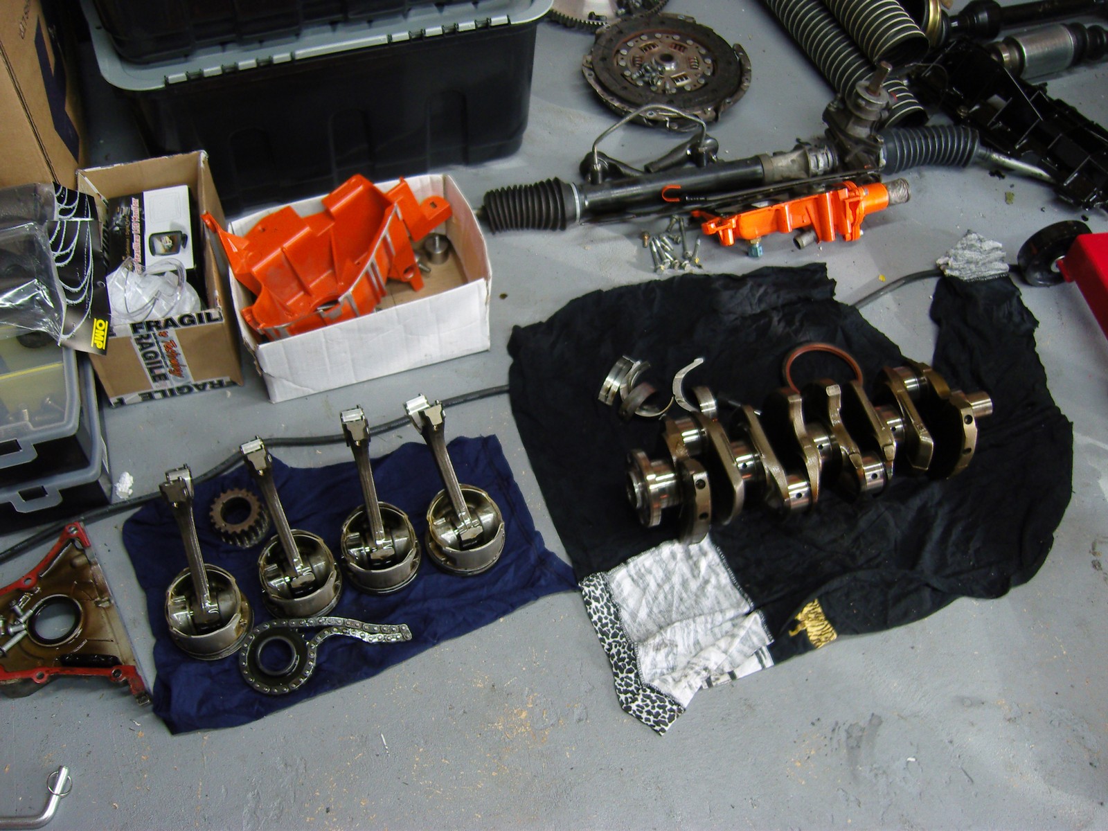

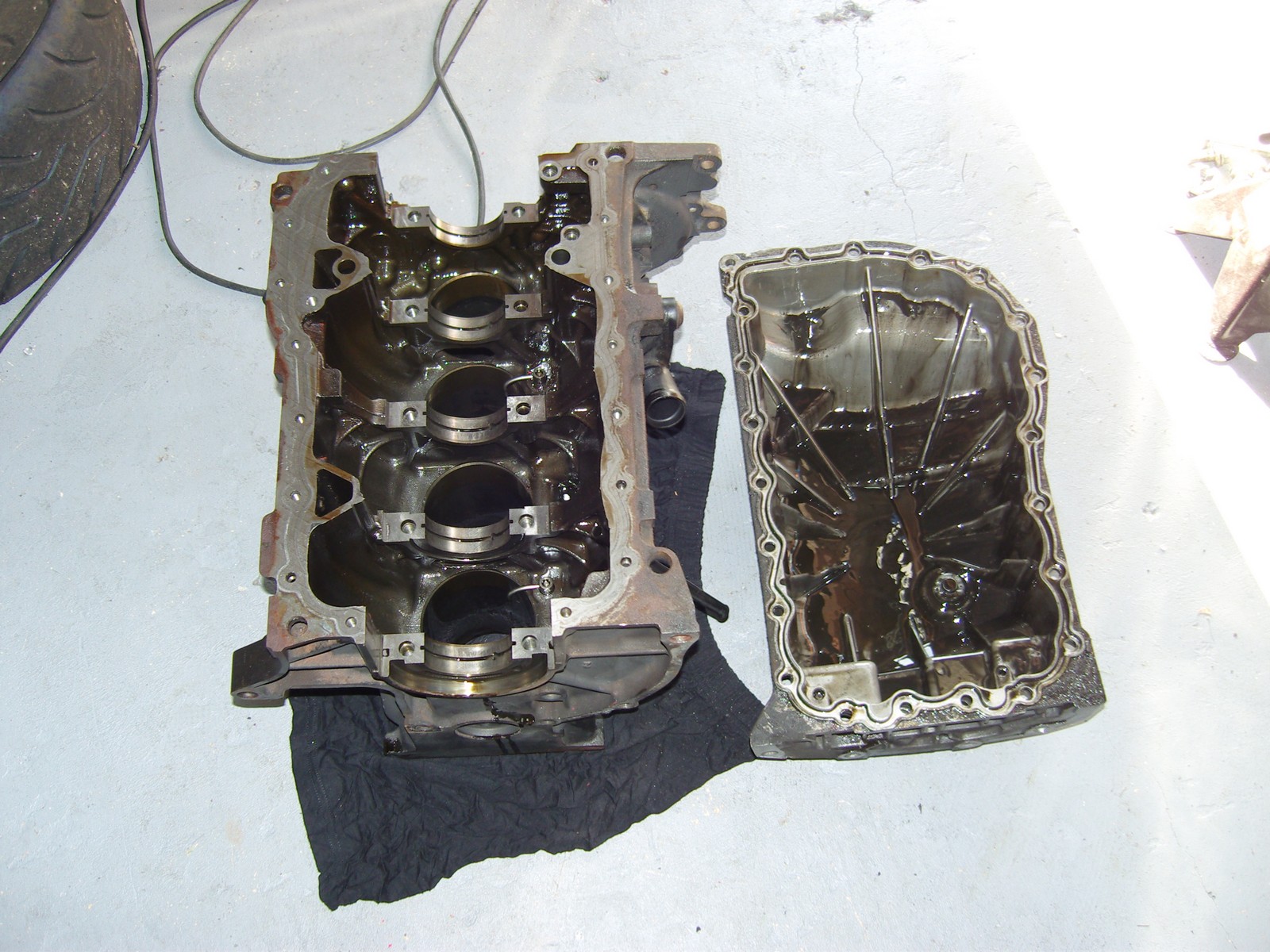

Block ready to go to be cleaned and rebored, plus sump cleaned
Can not see the first picture!
I had a small piece of sealant stuck in my pump as well. Was that white kind that seals the "bearing" closest to the flywheel. They seem to use to much sealant from the factory.

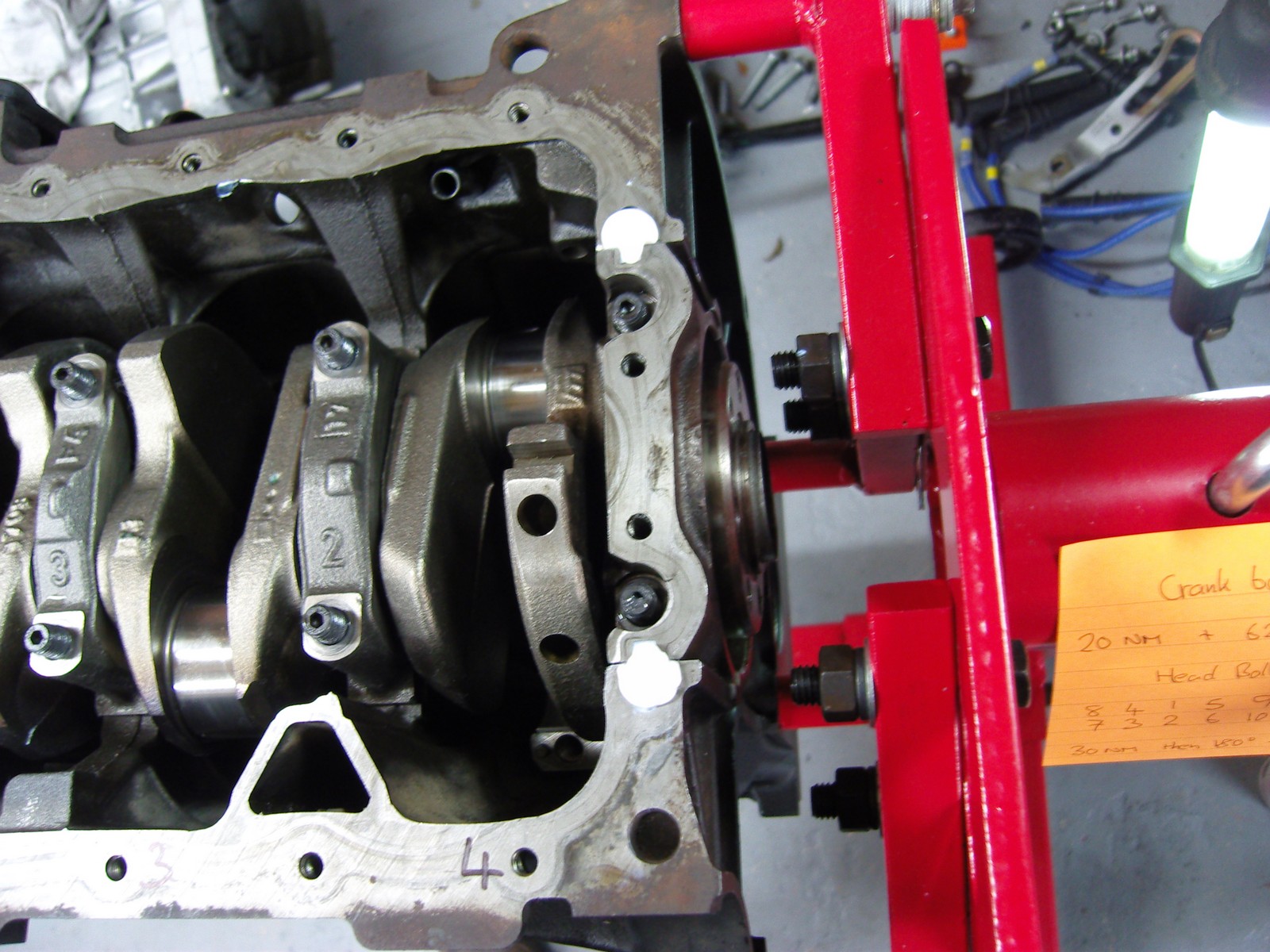

Mains are: 20Nm + 62 degrees -+4degrees
(Only use new bolts, if you use plastiguage torque up with clean old bolts first, if ok torque up with your new ones)
STANDARD rod bolts are: 25Nm + 110degrees +-6degrees
(If you use ARP its just Nm, see their website)

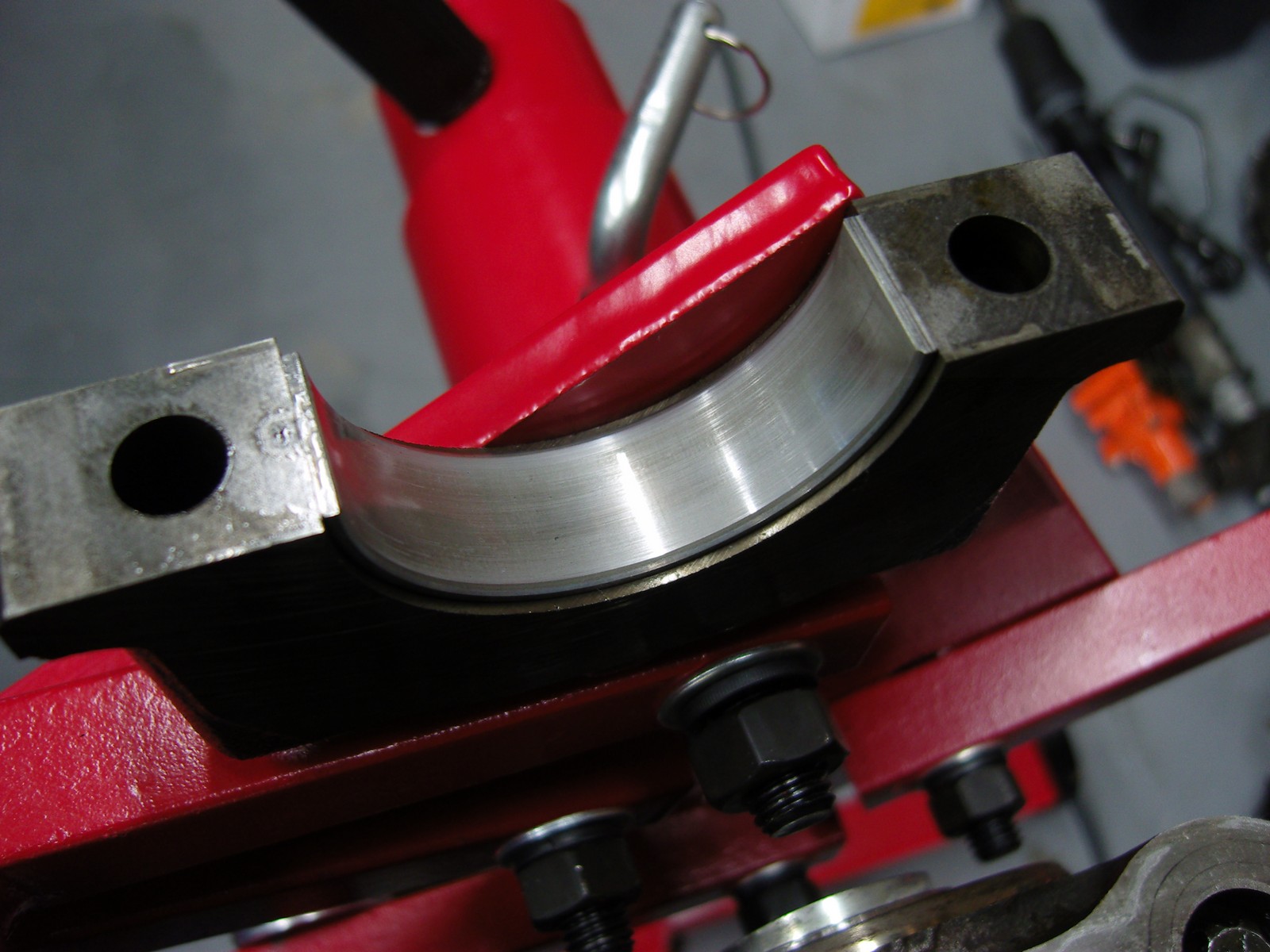

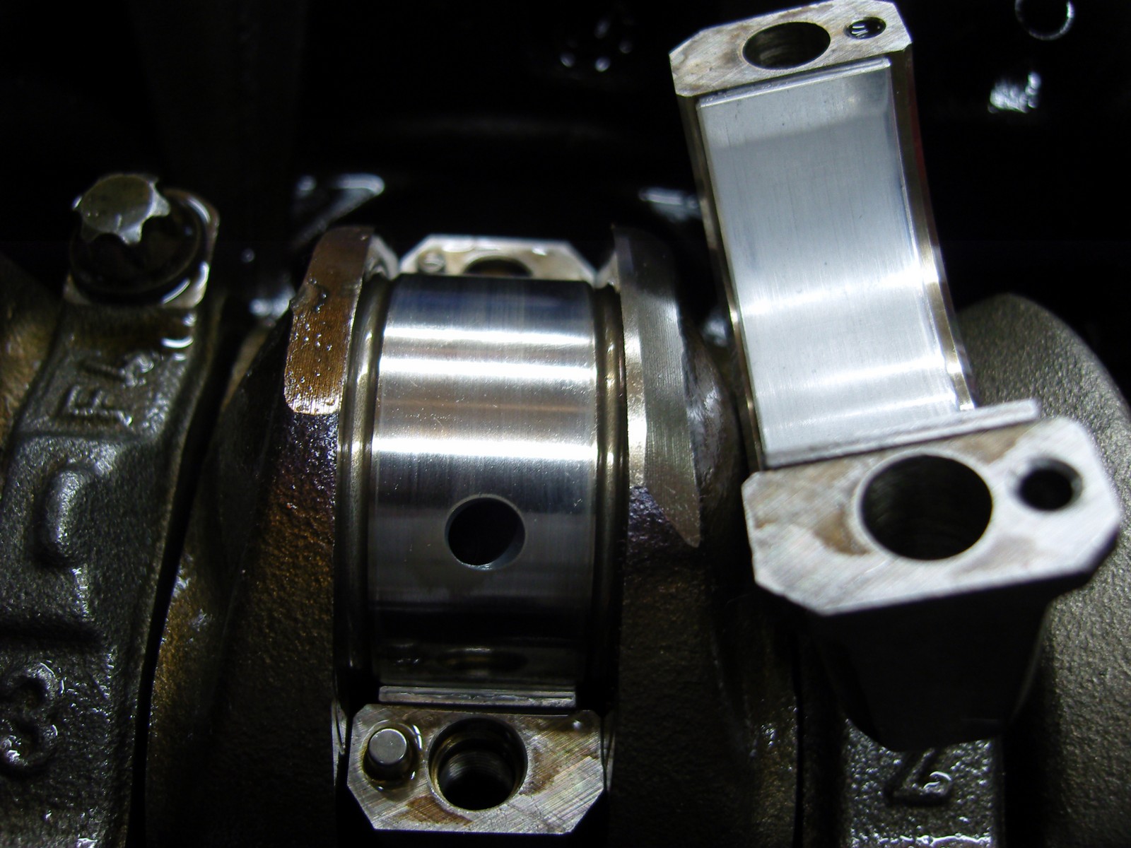

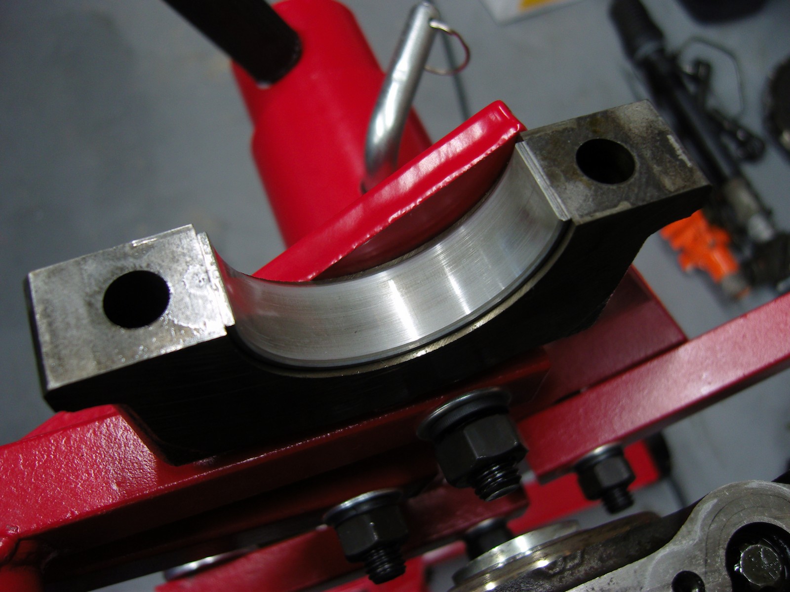

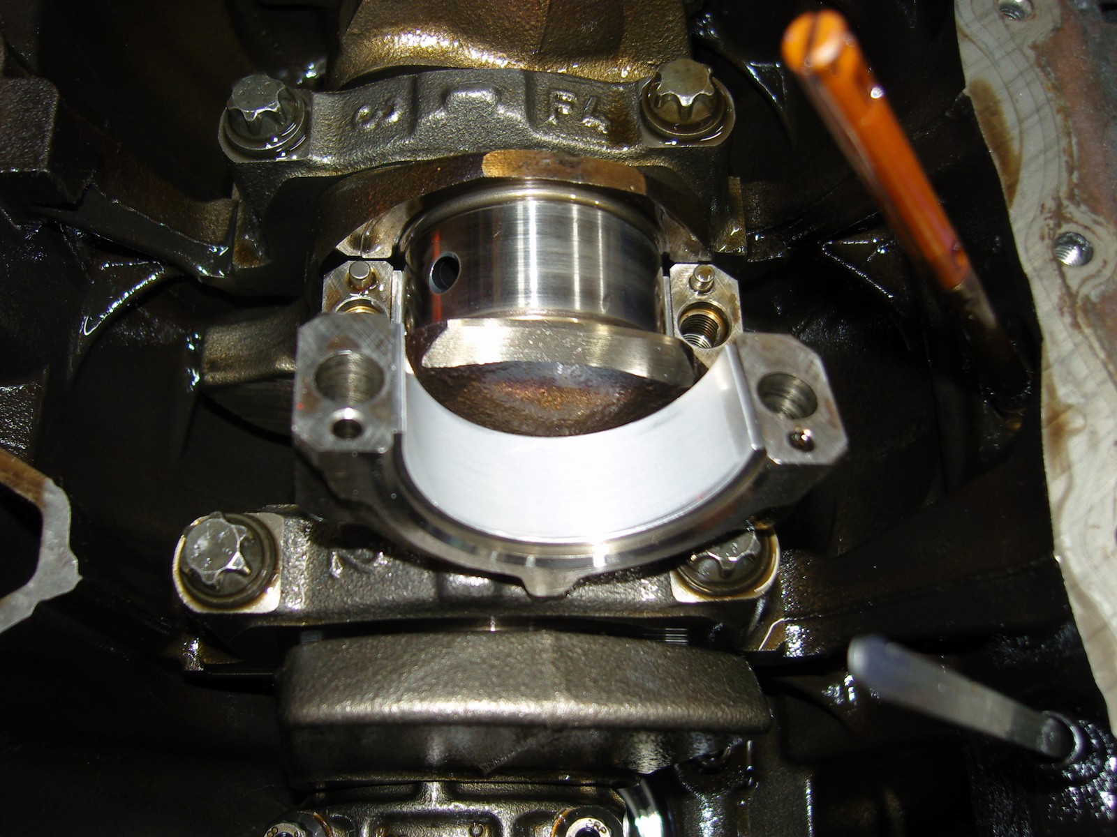

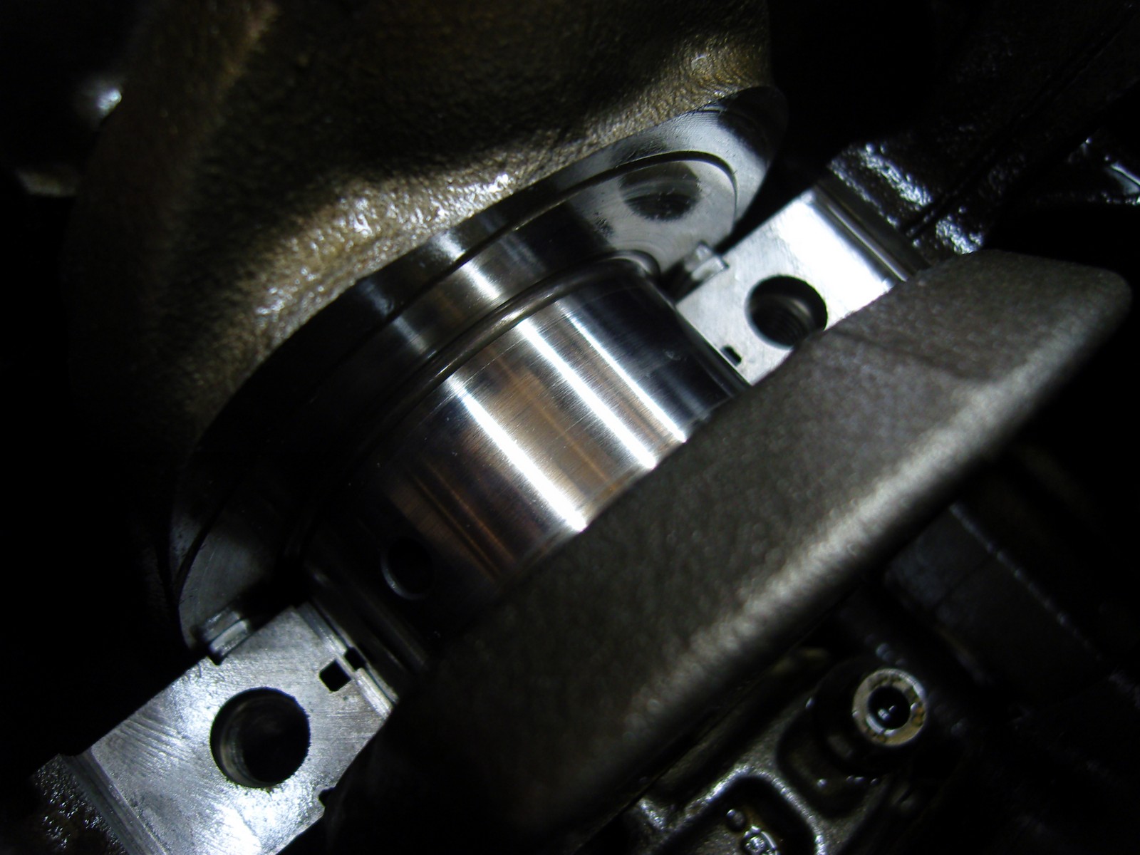

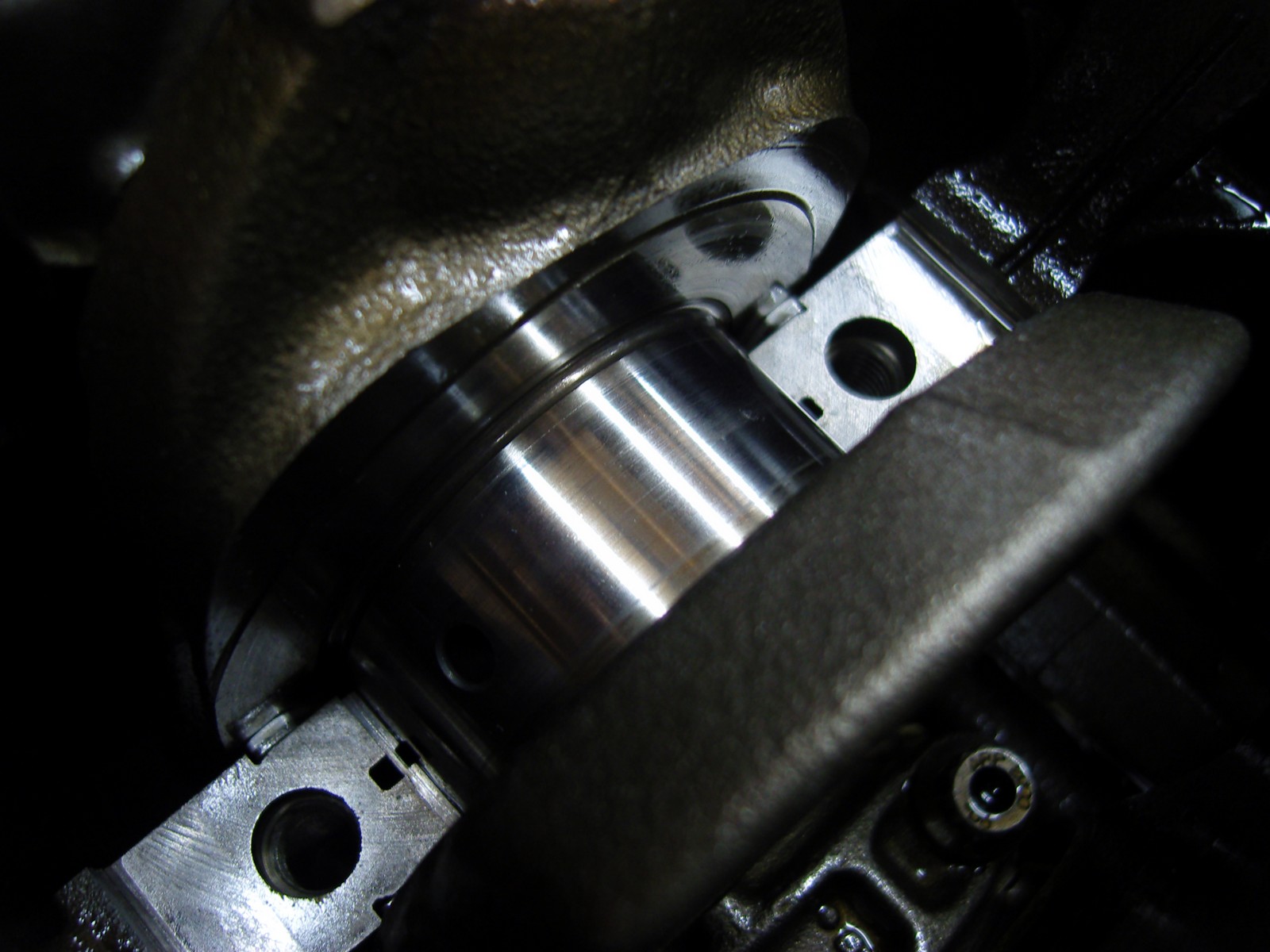

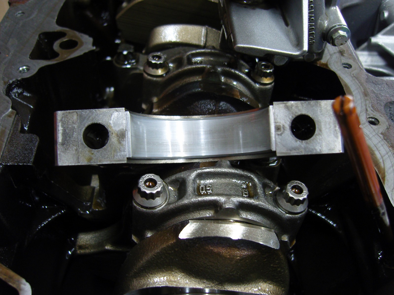

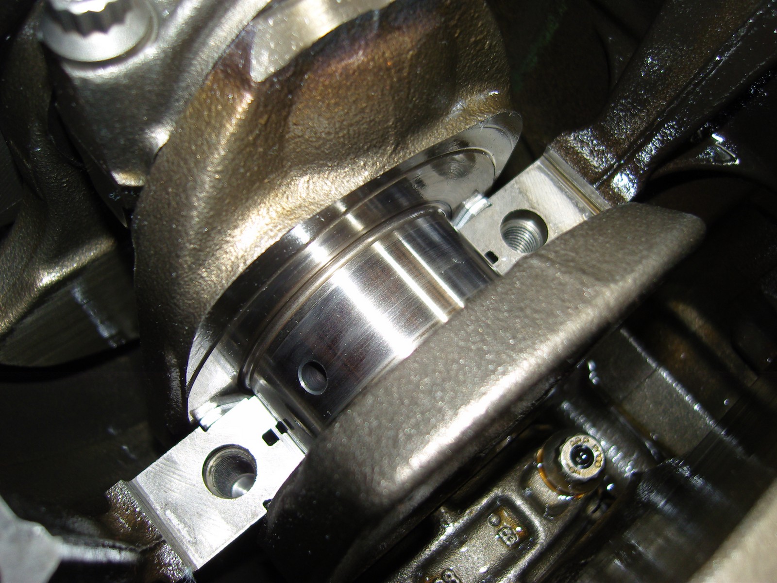

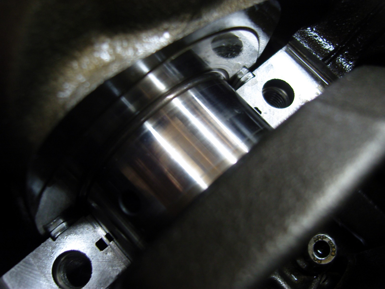

Well I have started to put it back together. Platiguage readings are in tolerance to the tight side which you would expect I guess. I have noticed though that two of the big end bearings have a couple of small dints in them, don't know how that happened as I cleaned the crank in my parts washer twice and then cleaned it with cloth. All the others are ok. Not fitted that rod yet.
I have also fitted an ARP crank stud kit. Do you bother with loctite on the nuts or just torque to 60 as ARP says?
Mark
Ok cool. I did rod bolts to 42nm and mains to 60nm as per ARP instructions (with no thread lock on them just the ARP lube) I am getting new shells from Ktech for my dinted ones so will do that this Saturday along with the rest of the engine rebuild. Also I finally found my small oil leak too! The bottom timing belt ally cover had a bolt sheared on it next to the sump. It's all booked in now with Troy for dyno run in and map :)

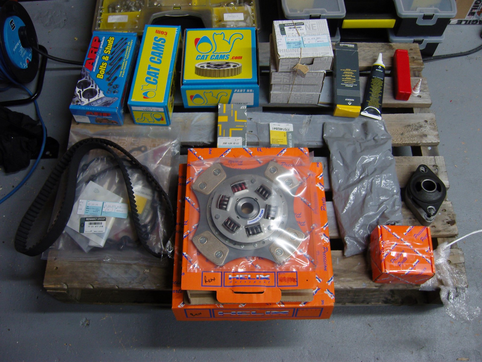

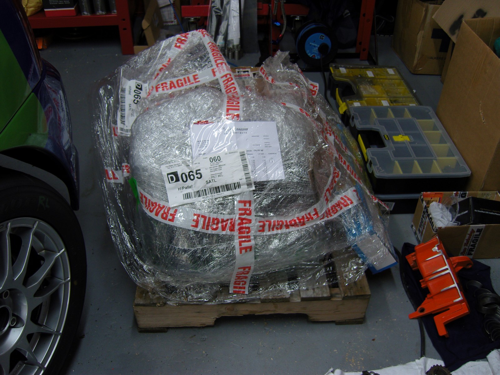

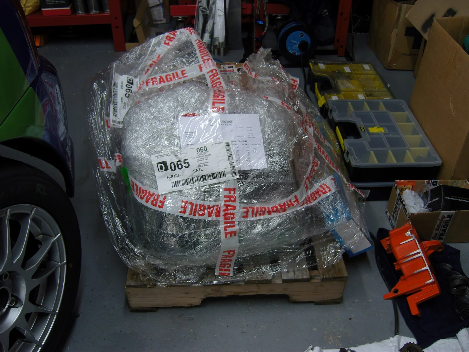

A big pallet of bits arrived and also my new gearbox (pics of that later)
So let's make a start as I have to ge this done ASAP as Cadwell is in 3 weeks now Ooerr.
A big pallet of parts
My nice new Helix paddle clutch

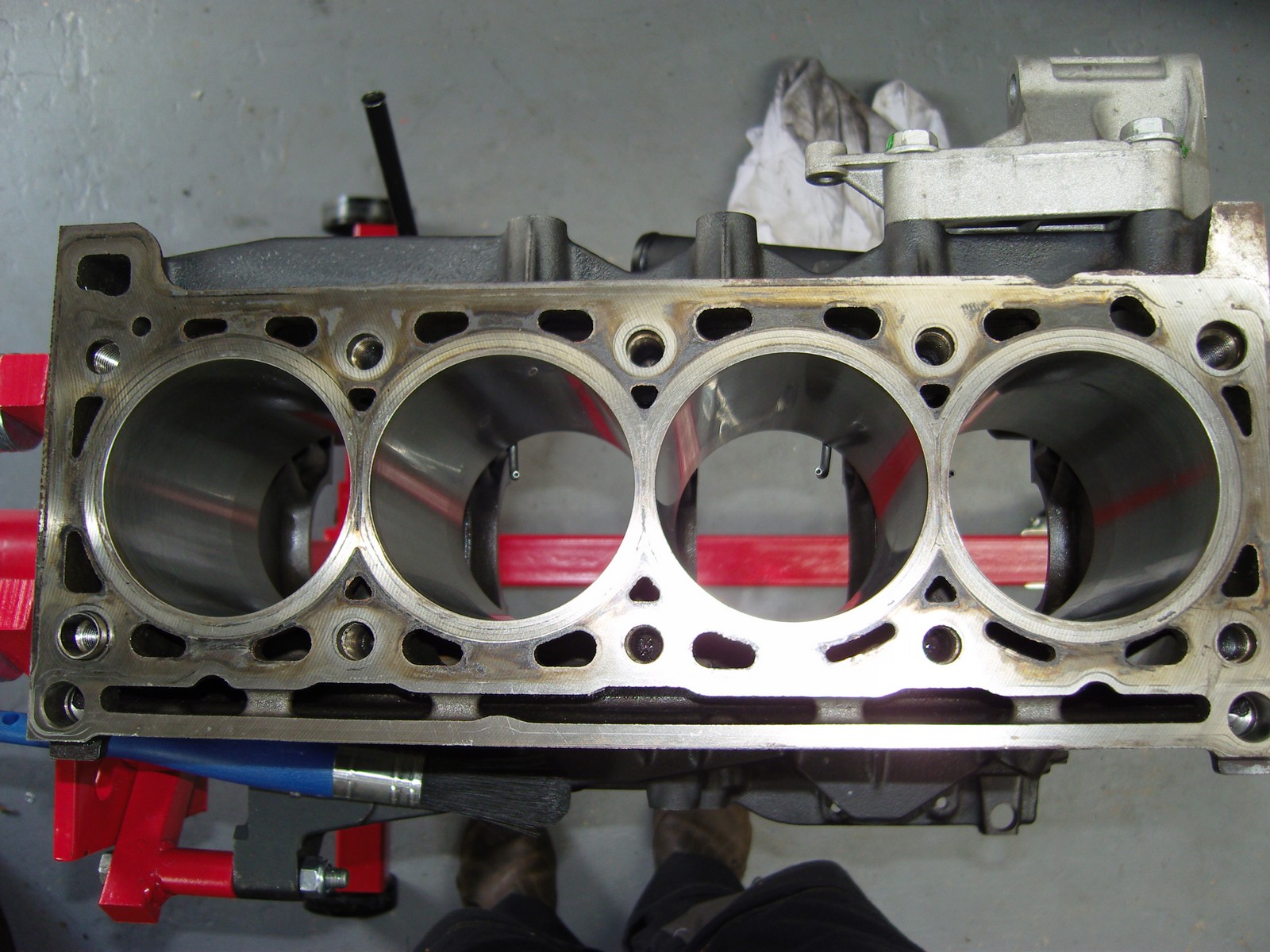

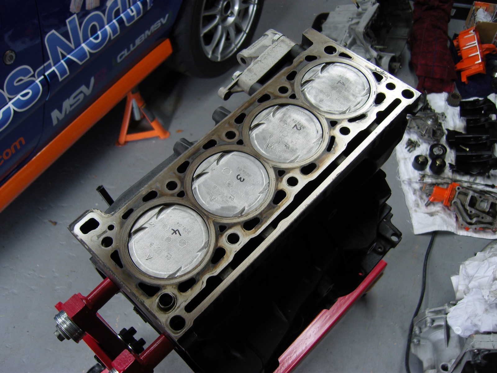

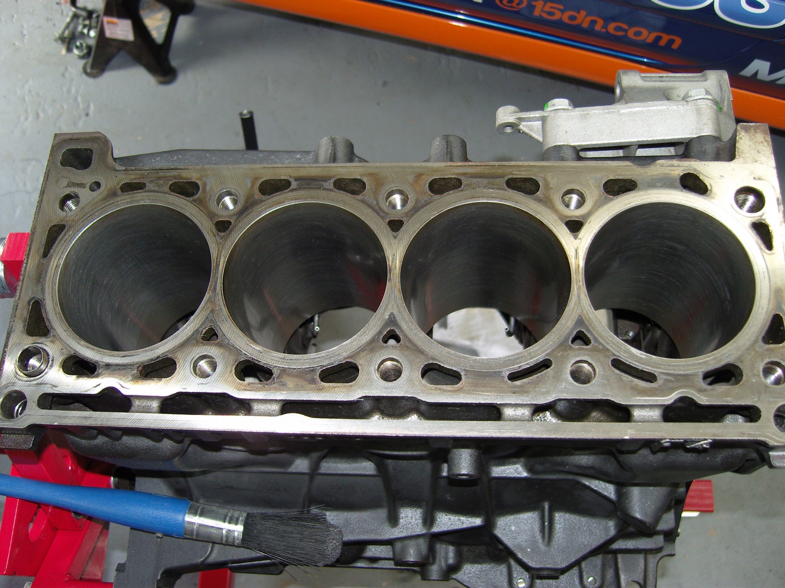

Ok let's get the block mounted to my engine stand and give it a damned good clean
Nice honed bores

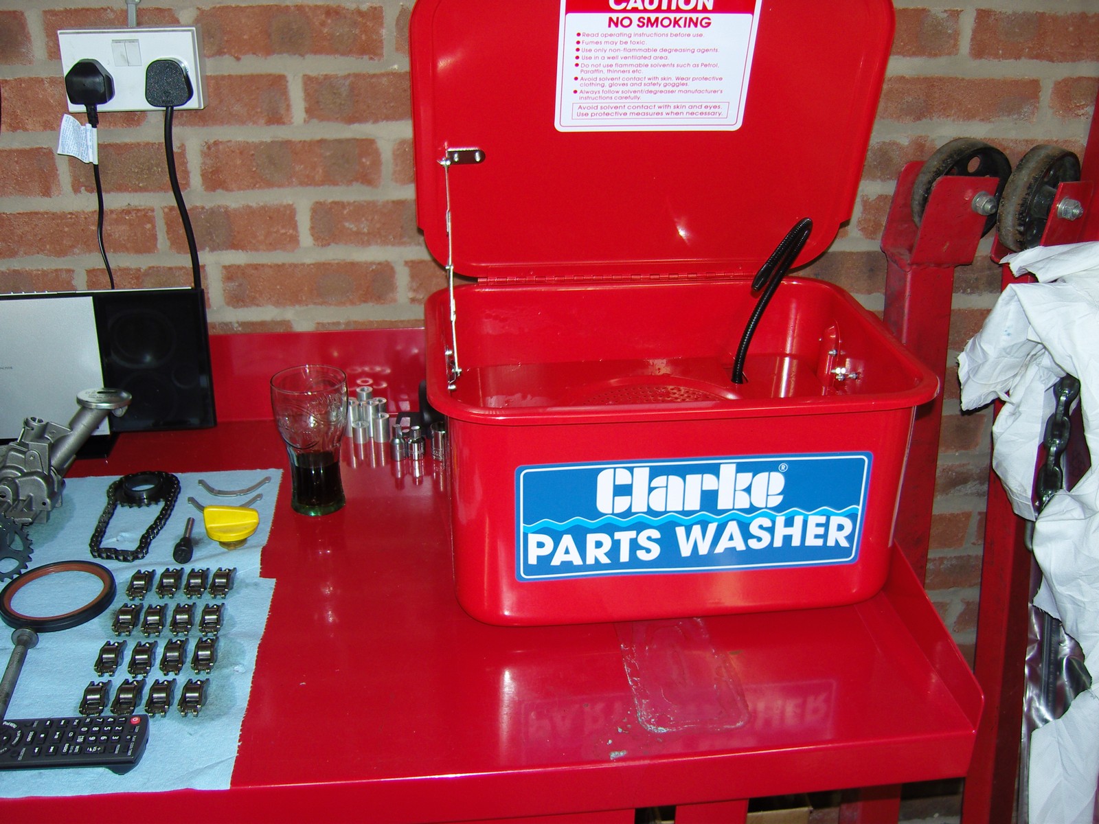

My new little parts washer, to be honest I should have bought the bigger one

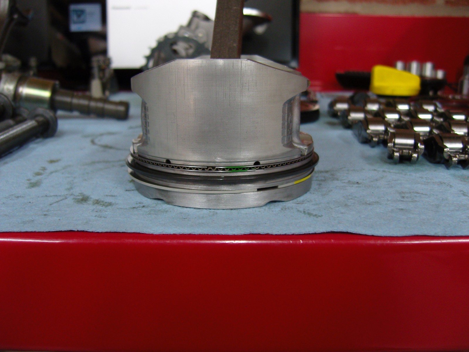

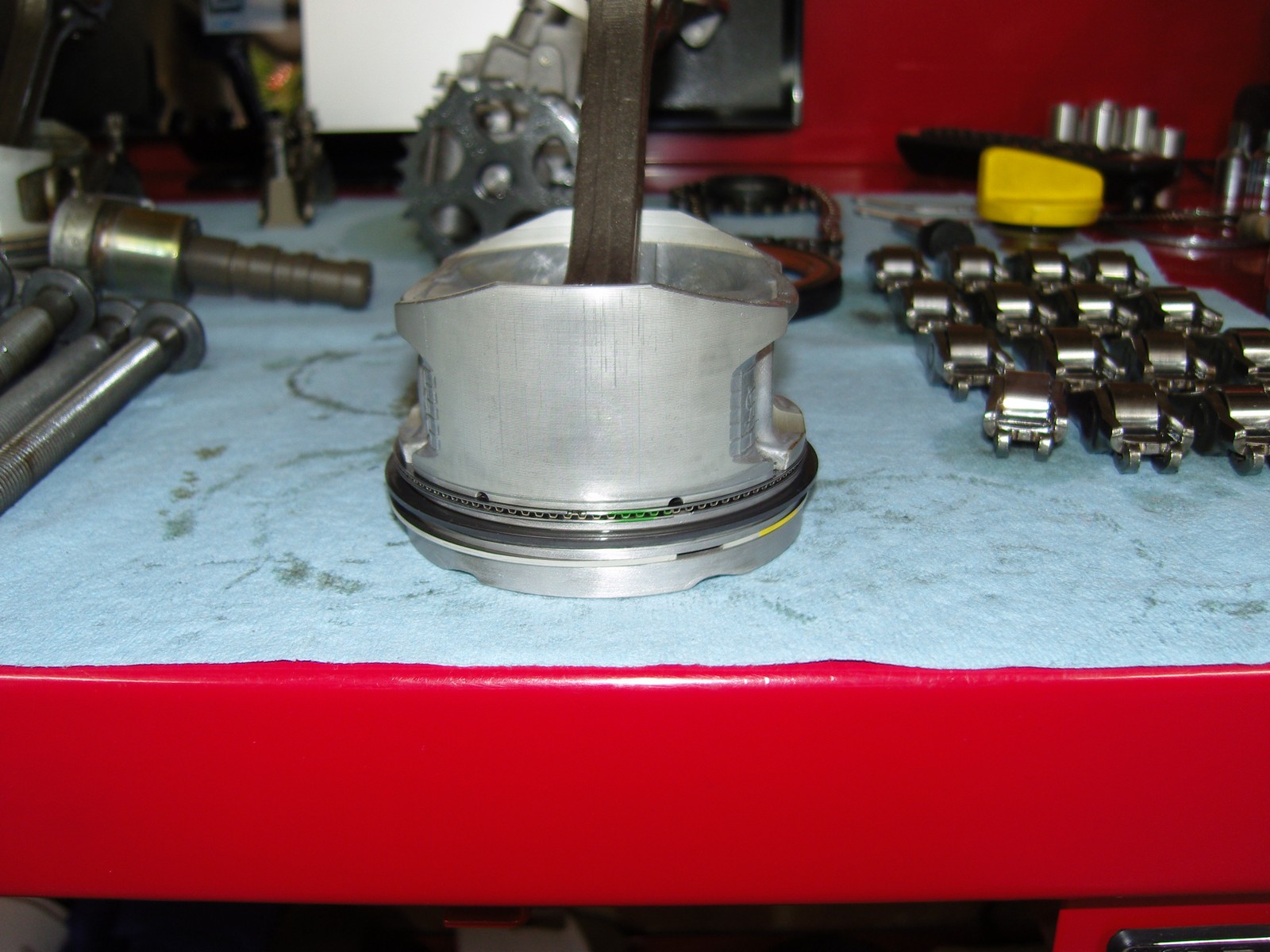

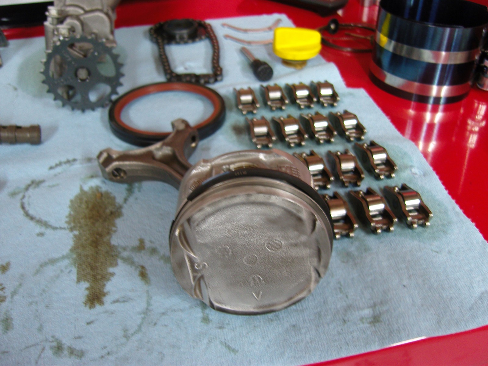

Cleaned the pistons and put the new rings on them
making sure to get the rings top the right way around

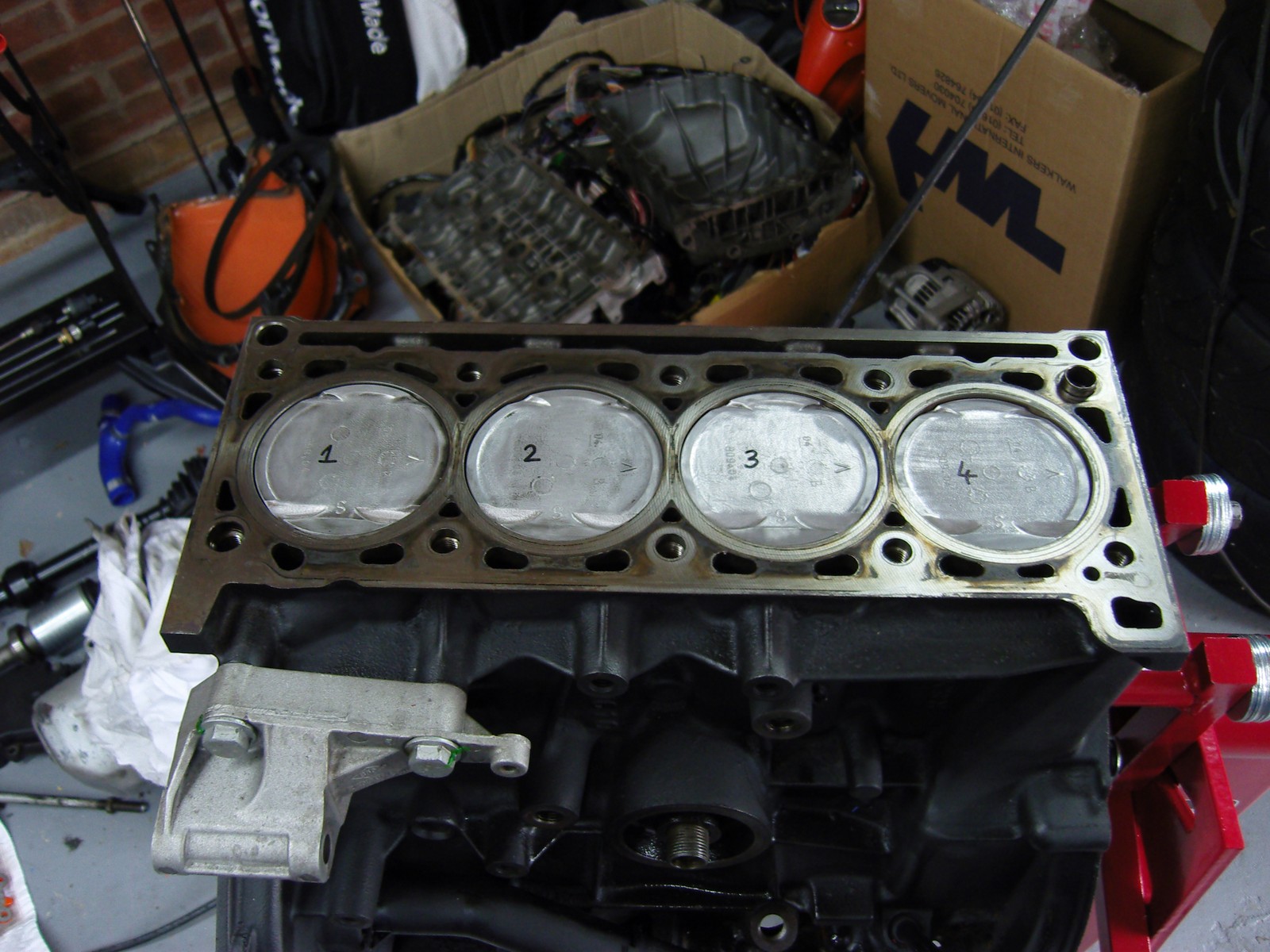

Pistons fitted into block

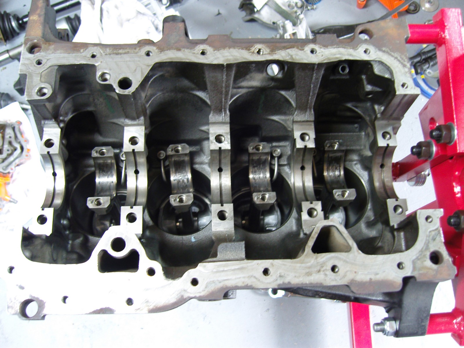

Showing the bottom of the rods

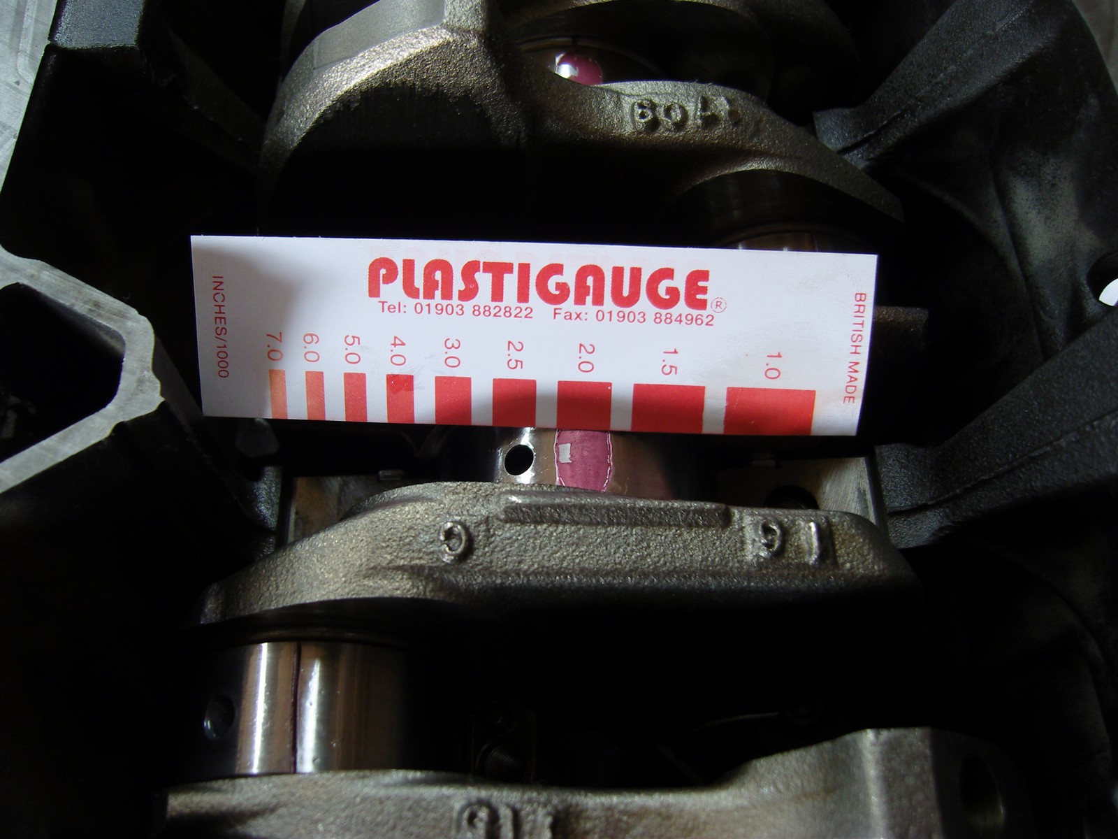

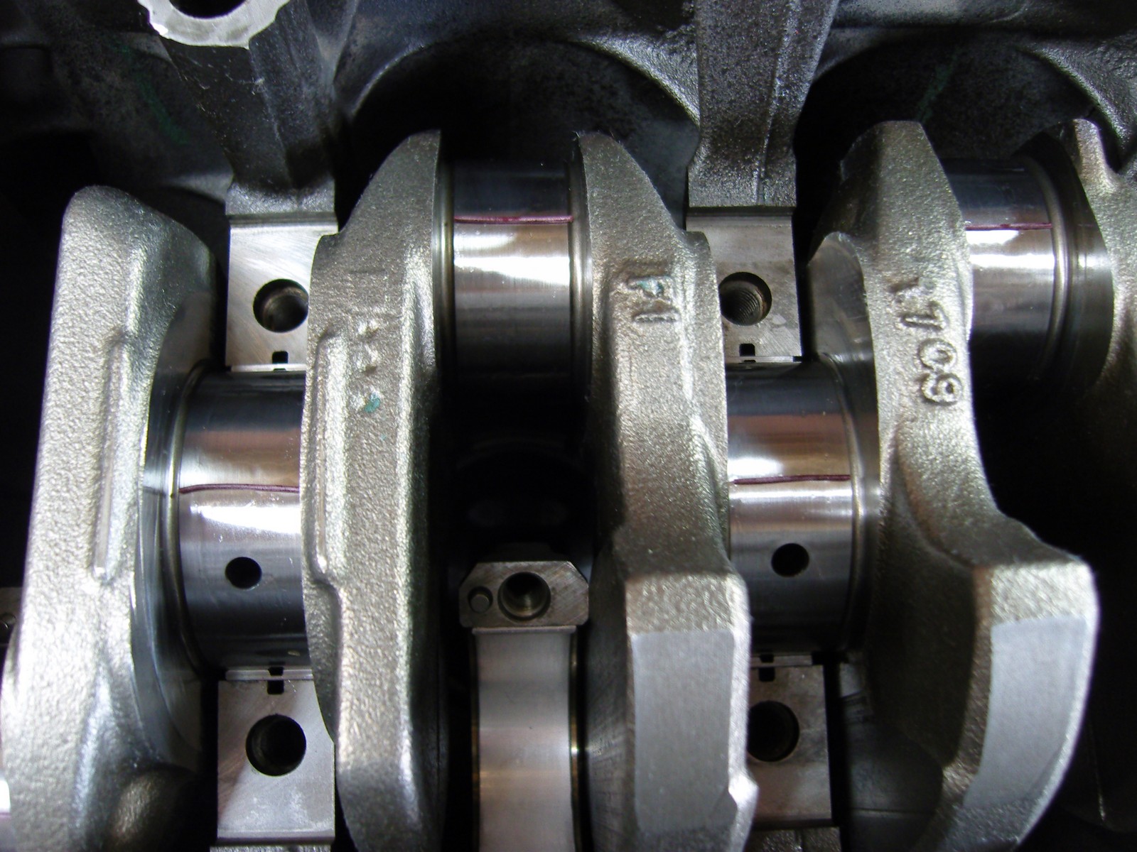

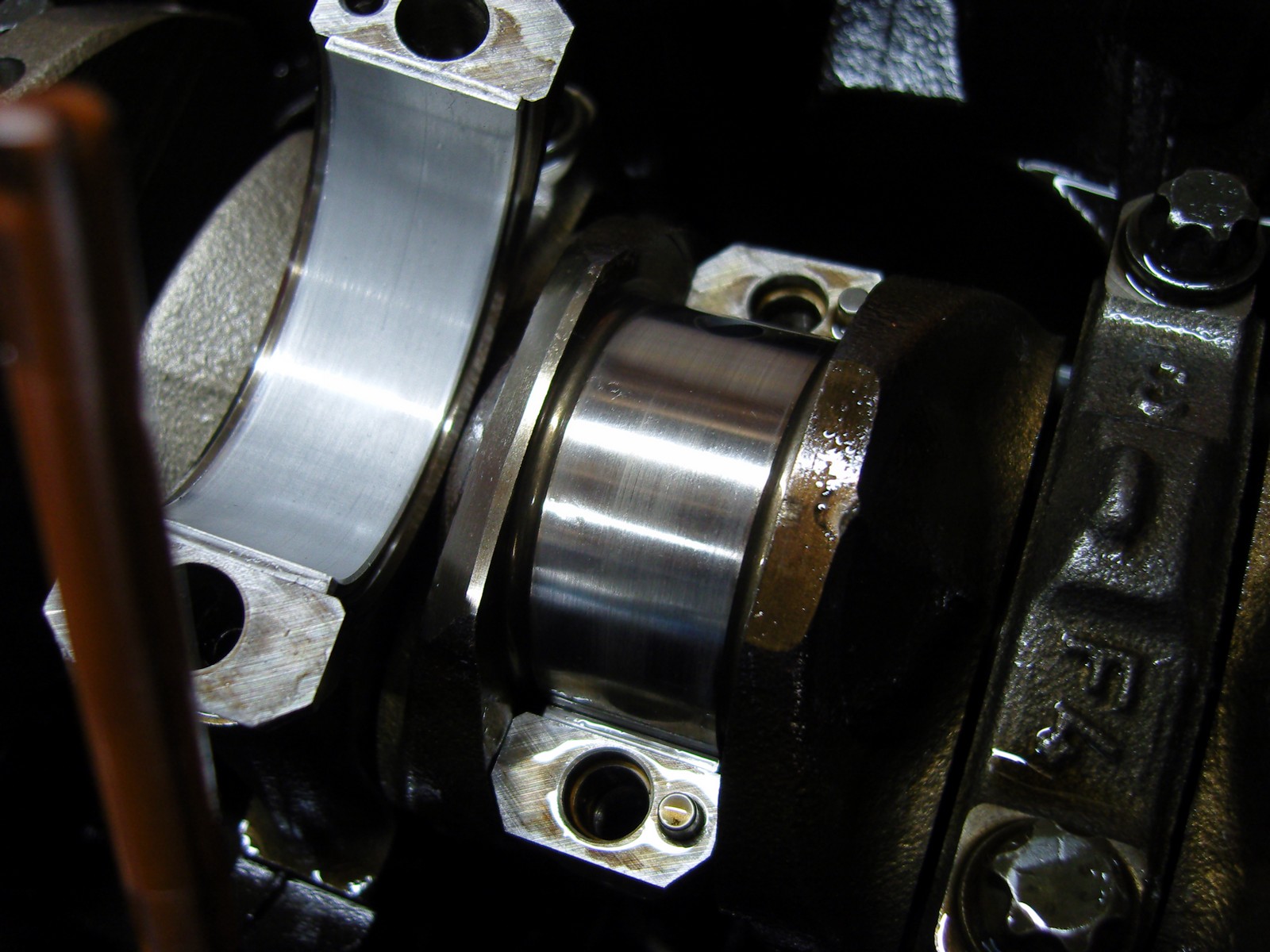

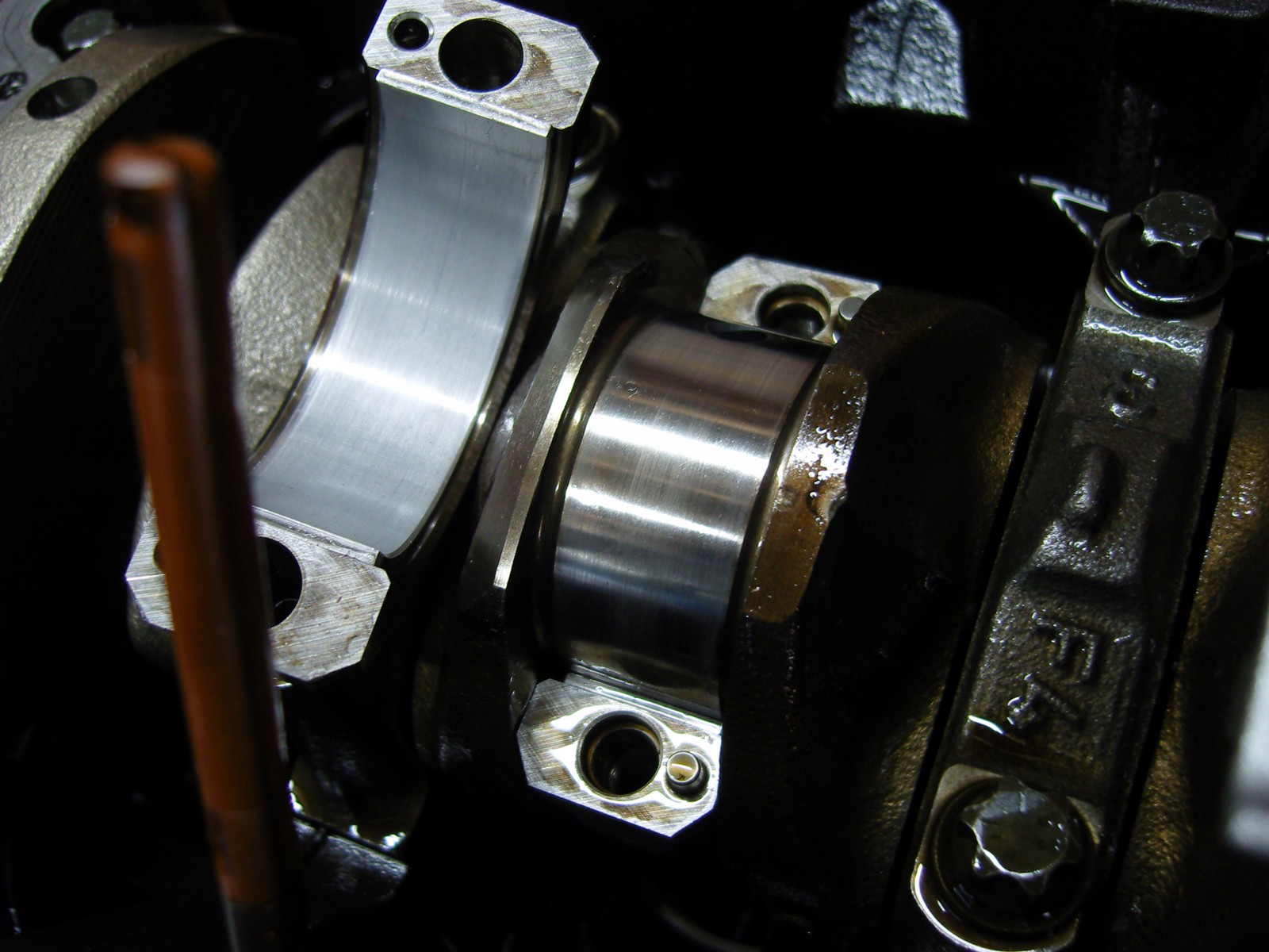

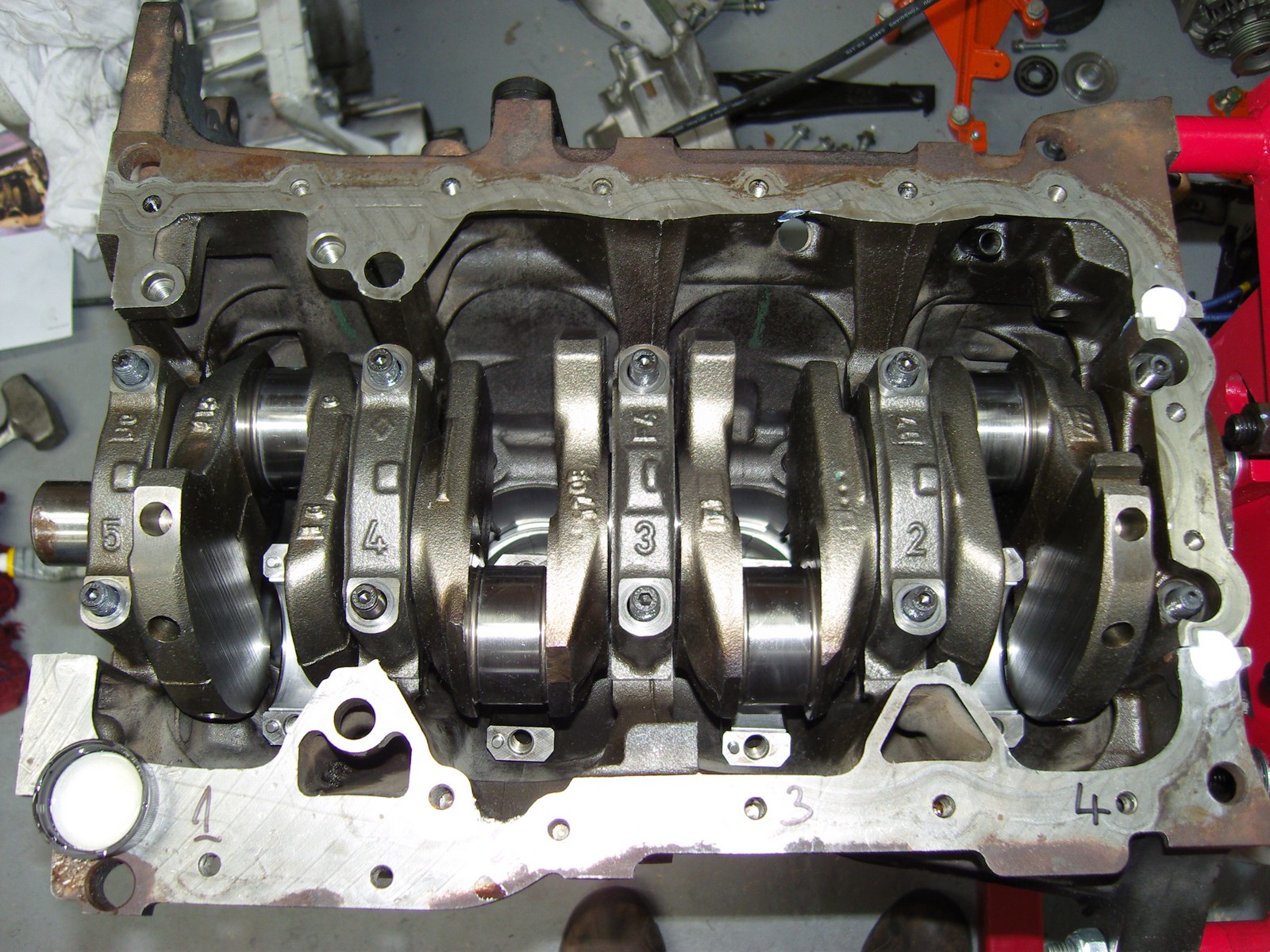

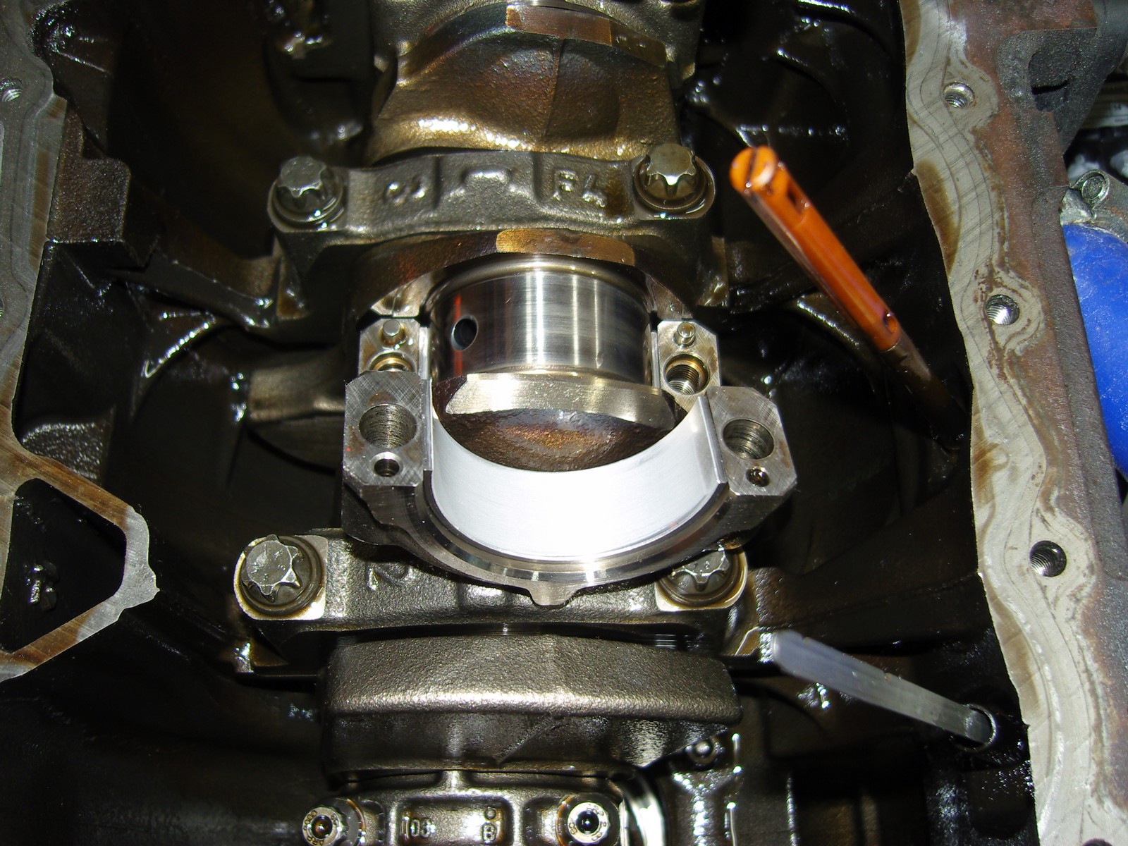

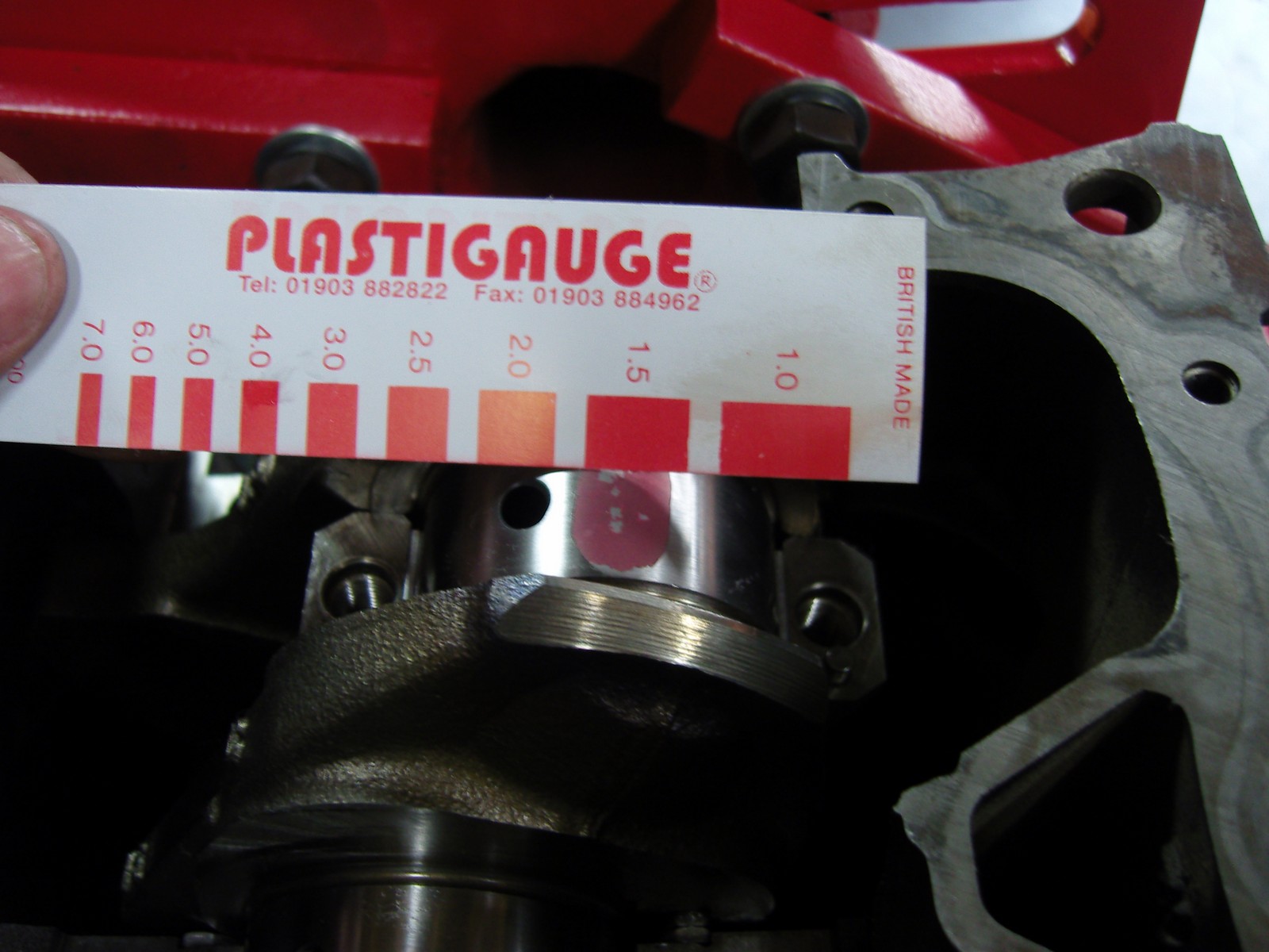

Crank in place with plastiguage in place ready for clamping up. I did the mains first and the big ends next
Nice tolerance on the mains, perfect to the tight side
Nice tolerance on the big ends also perfect to the tight side
ARP bottom stud kit in place ready for 60Nm of torque
Plenty of Renault Goo

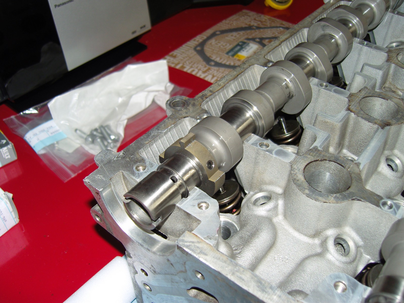

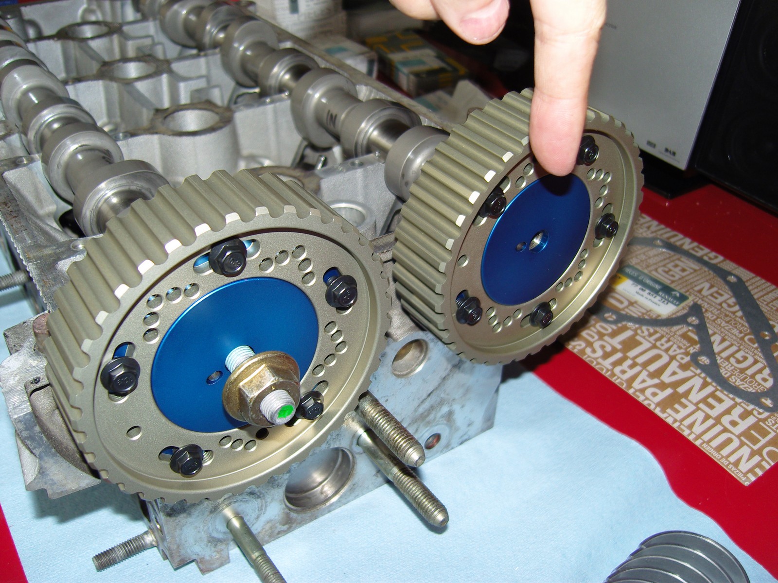

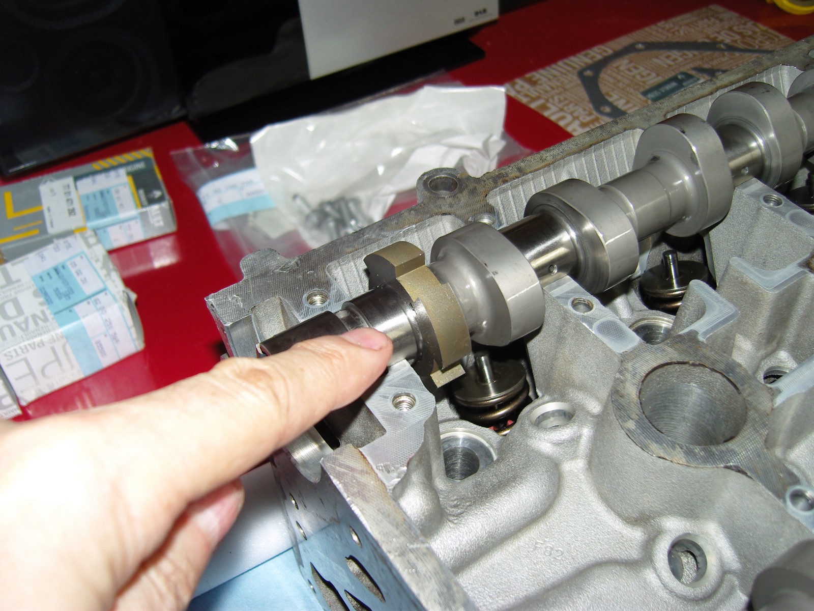

On one of these cams its got a wheel on it with cutouts that does nothing much that I can see. Any ideas? Pic to follow..

I guess the thing for the cam's is to help time them up because they are the non-vvt ones they dont have the ability to use the normal timing tools do they?

Here are the pics.
What is this?
Verniers with annoying missing stud
I would say thats for a cam phase sensor.
I'm not 100% sure, but would assume these cams can be used in the F4R 830 which, iirc has a cam sensor, easier for Cat to make cams that fit both, in your case it's not needed.
I'm going to be using a cam phase sensor on my car so this might be quite useful.
That sits underneath a solid piece of cam cover though? Does the other engines cam cover have a hole there in that place? I'm guessing I can either leave it there or slide it off.
Mark
Yeah, the 830 engine has a different cam cover with a hole for the sensor. It's up to you, if it comes off with just that wee grub screw then I dont see any harm removing it.
Mark have you checked the numbers on the cams are the one's you ordered? The number normally scored into the timing end of the cams. Cat sent us the inlet from a 421 and the exhaust from a 438! They really are useless so I wouldn't put it past them that they have sent you something they shouldn't have
Engine is all done and car is now at NMS for mapping and running in on the dyno. It seems the cams are ok. They put that sensor on all of them now so they can use the same blanks. I removed it.
