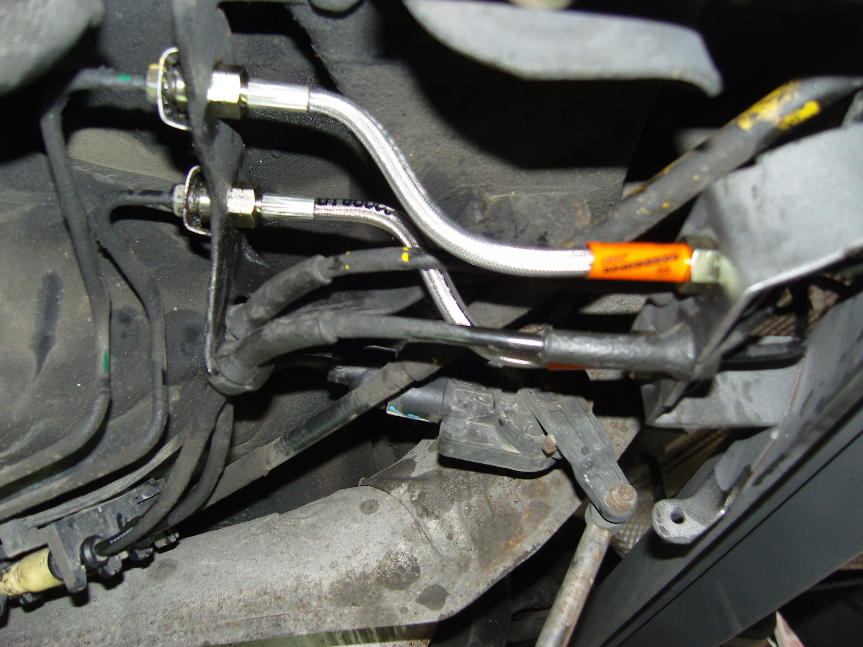

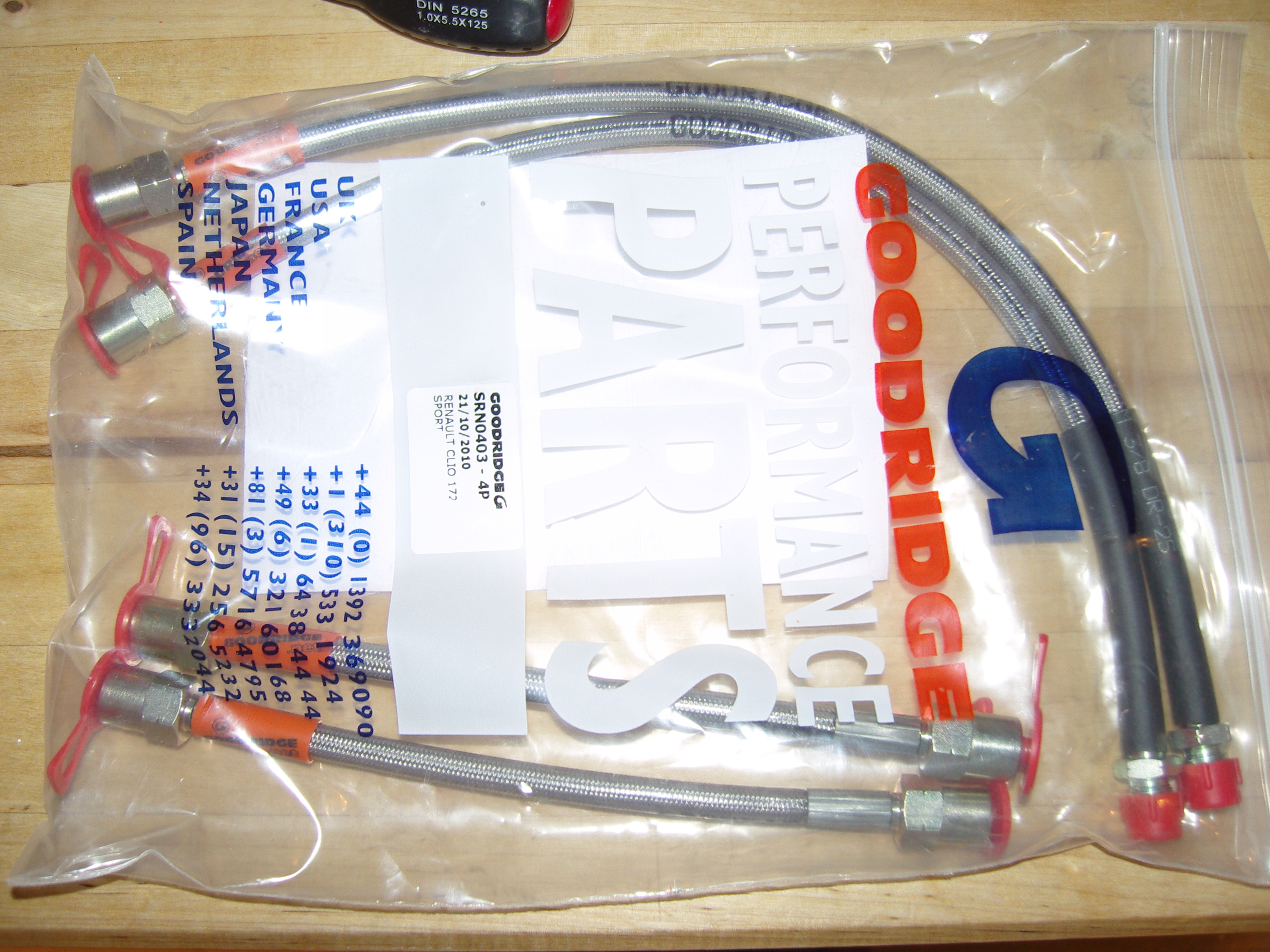

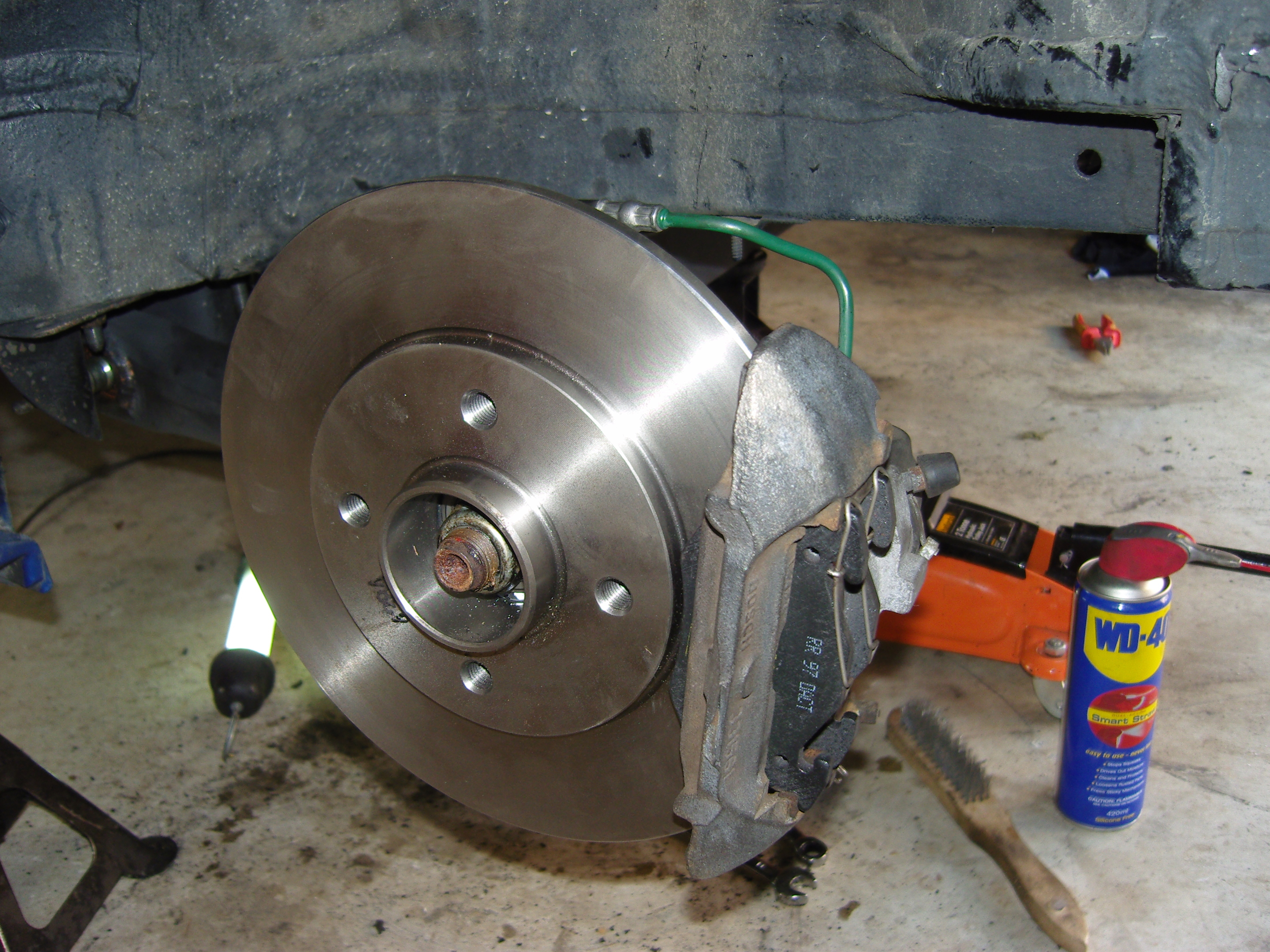

My nice new brake lines

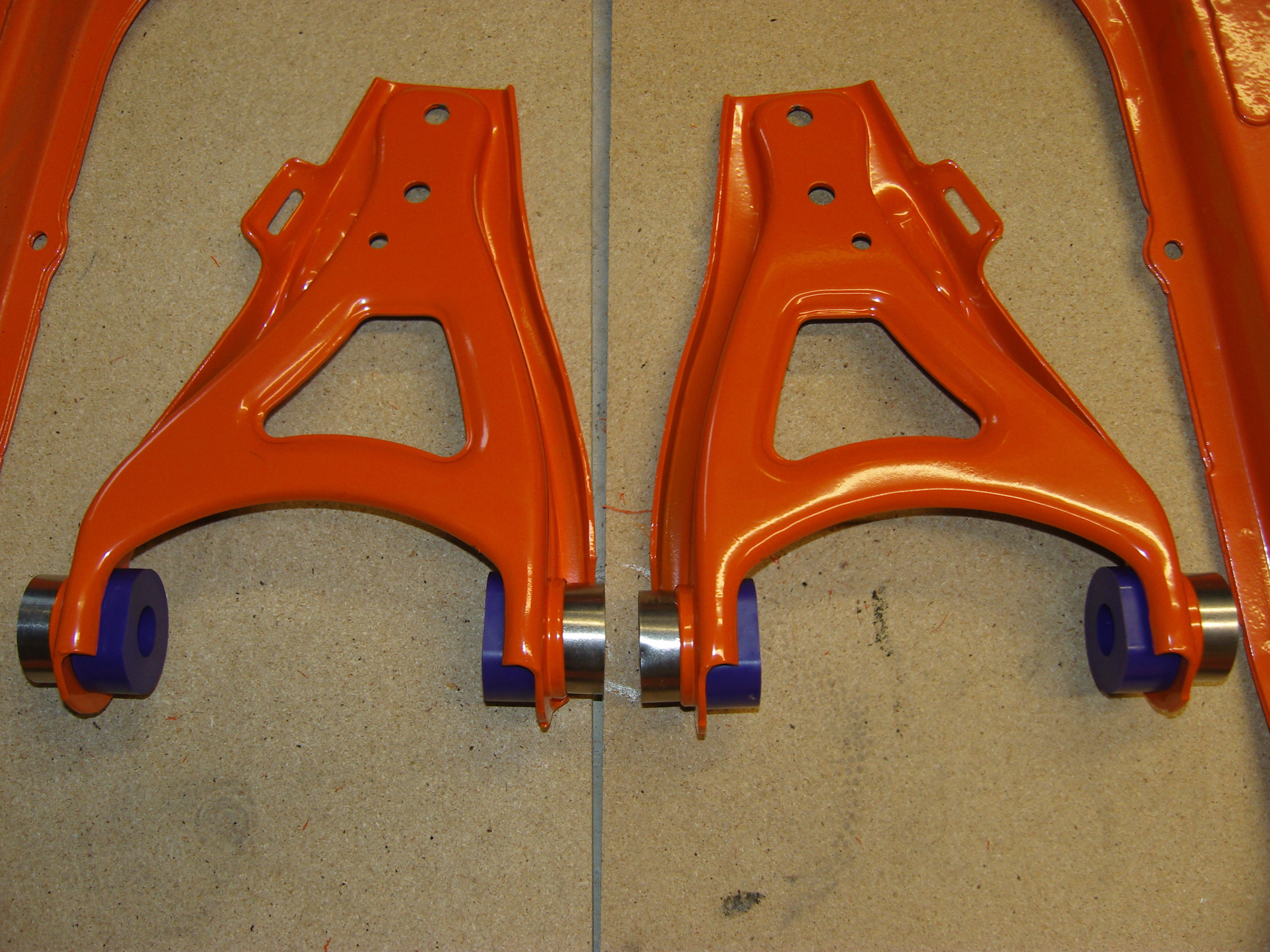

And my new powerflex bushes

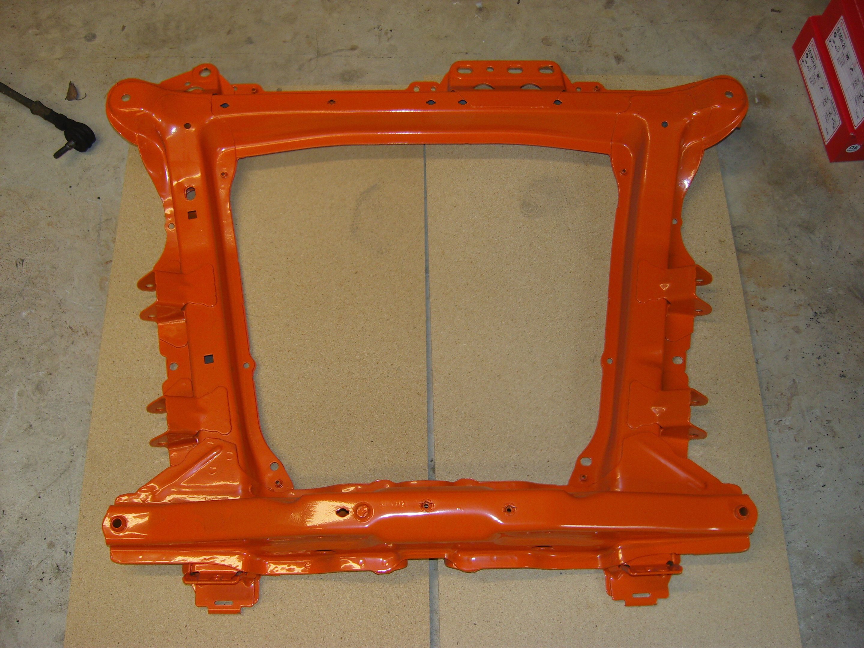

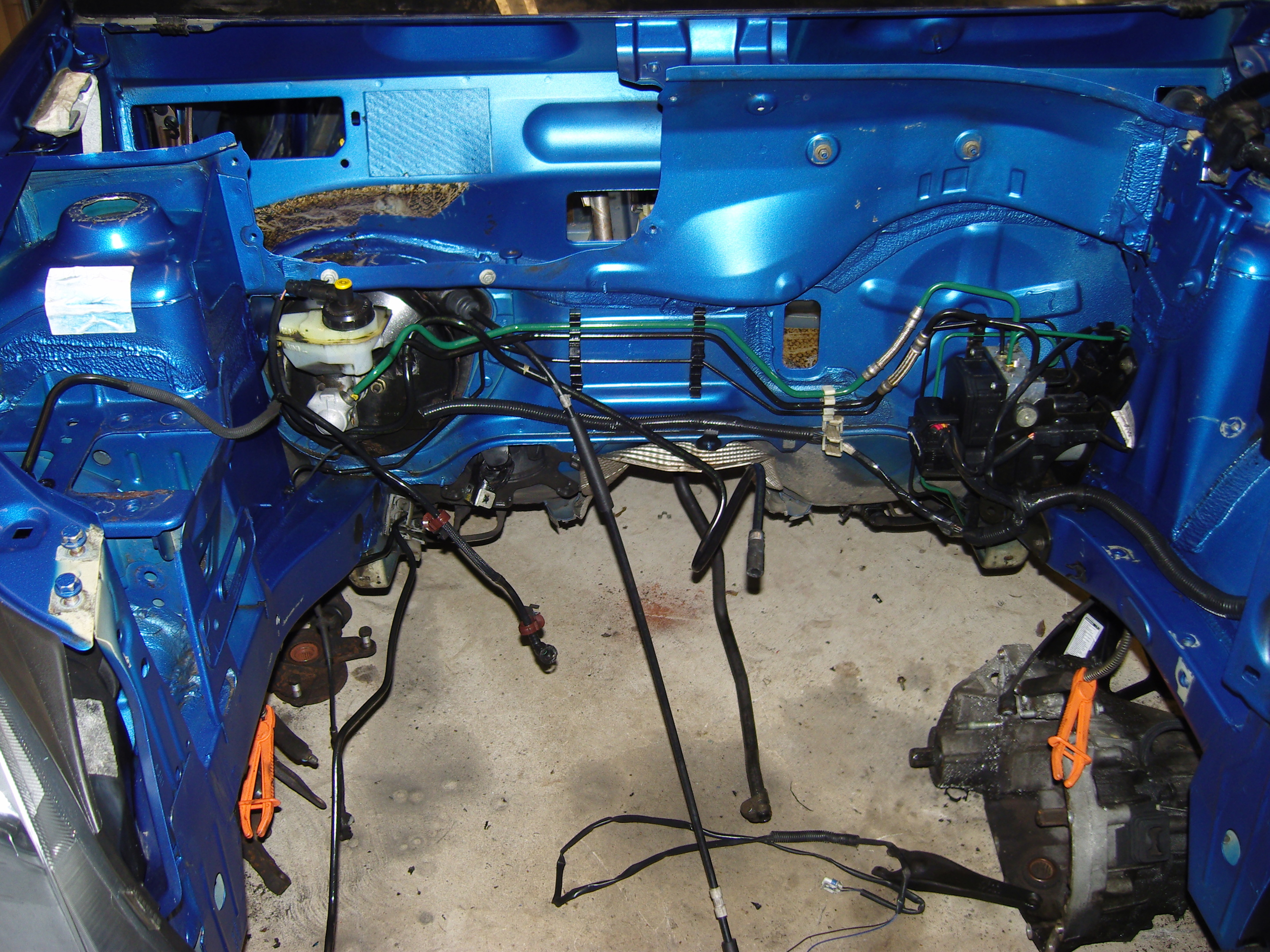

I cleaned the engine bay ready for the new subframe to go back in

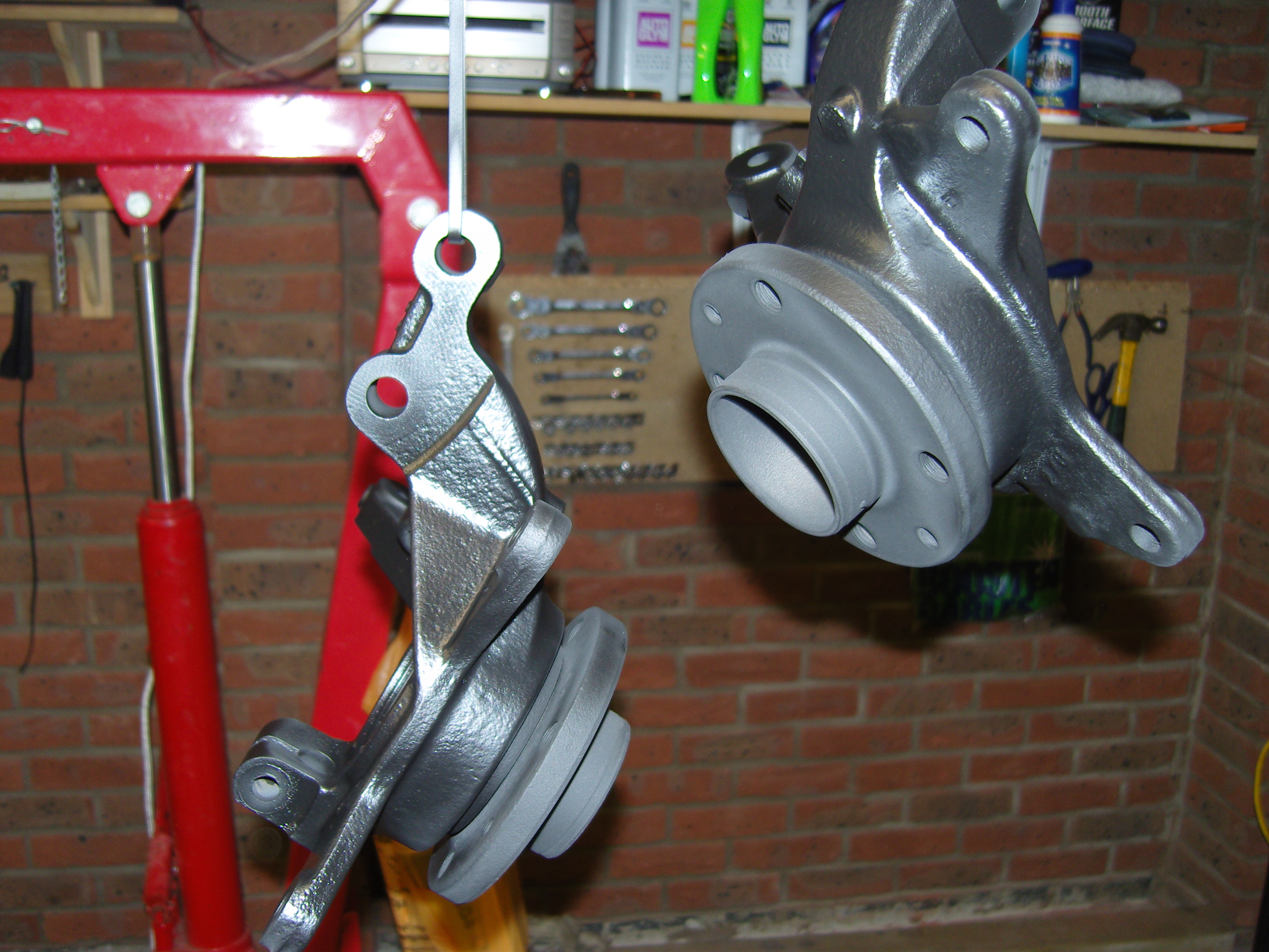

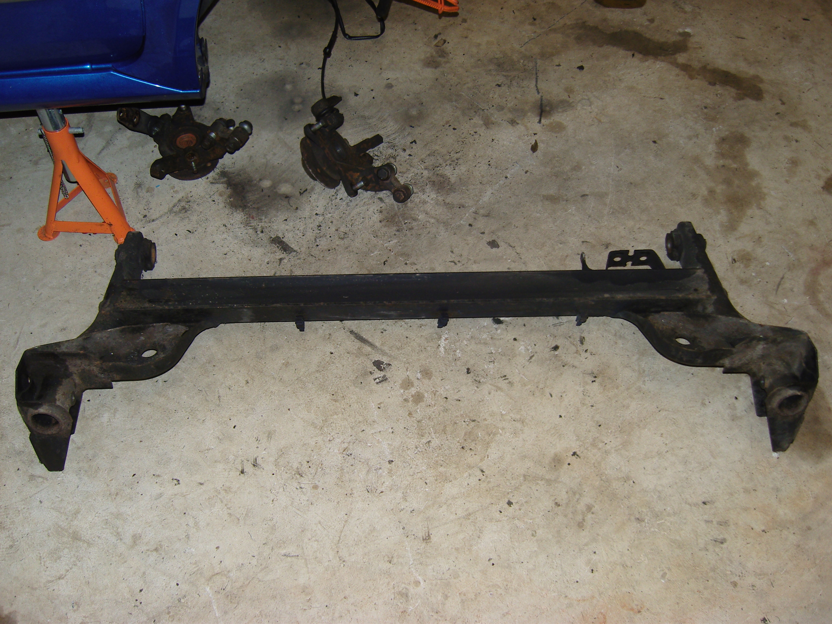

And also blasted and painted the front hubs and the rear axle as they were very rusty

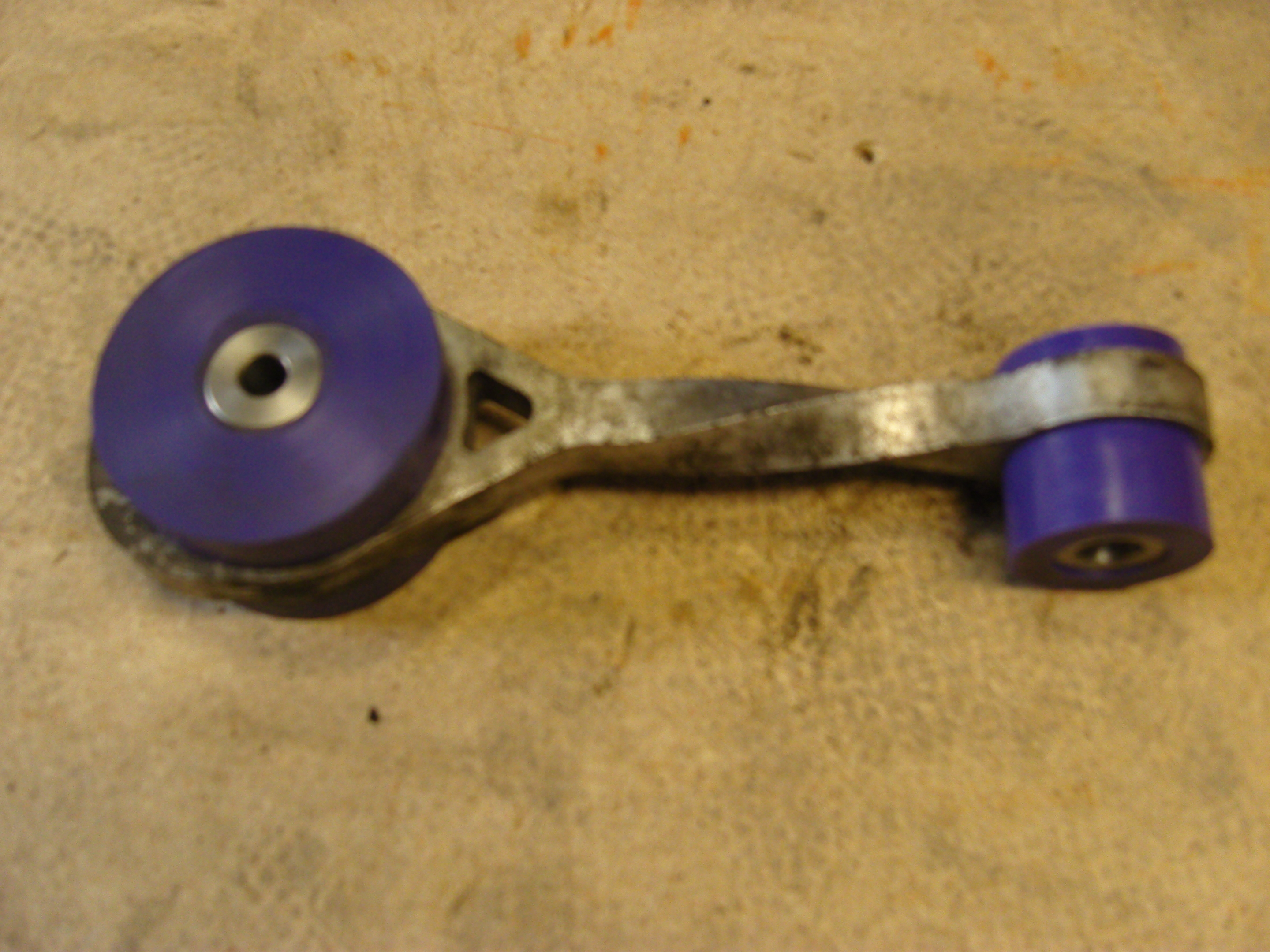

Assembled the dogbone, going to run two of these by the way, one at the front aswell.

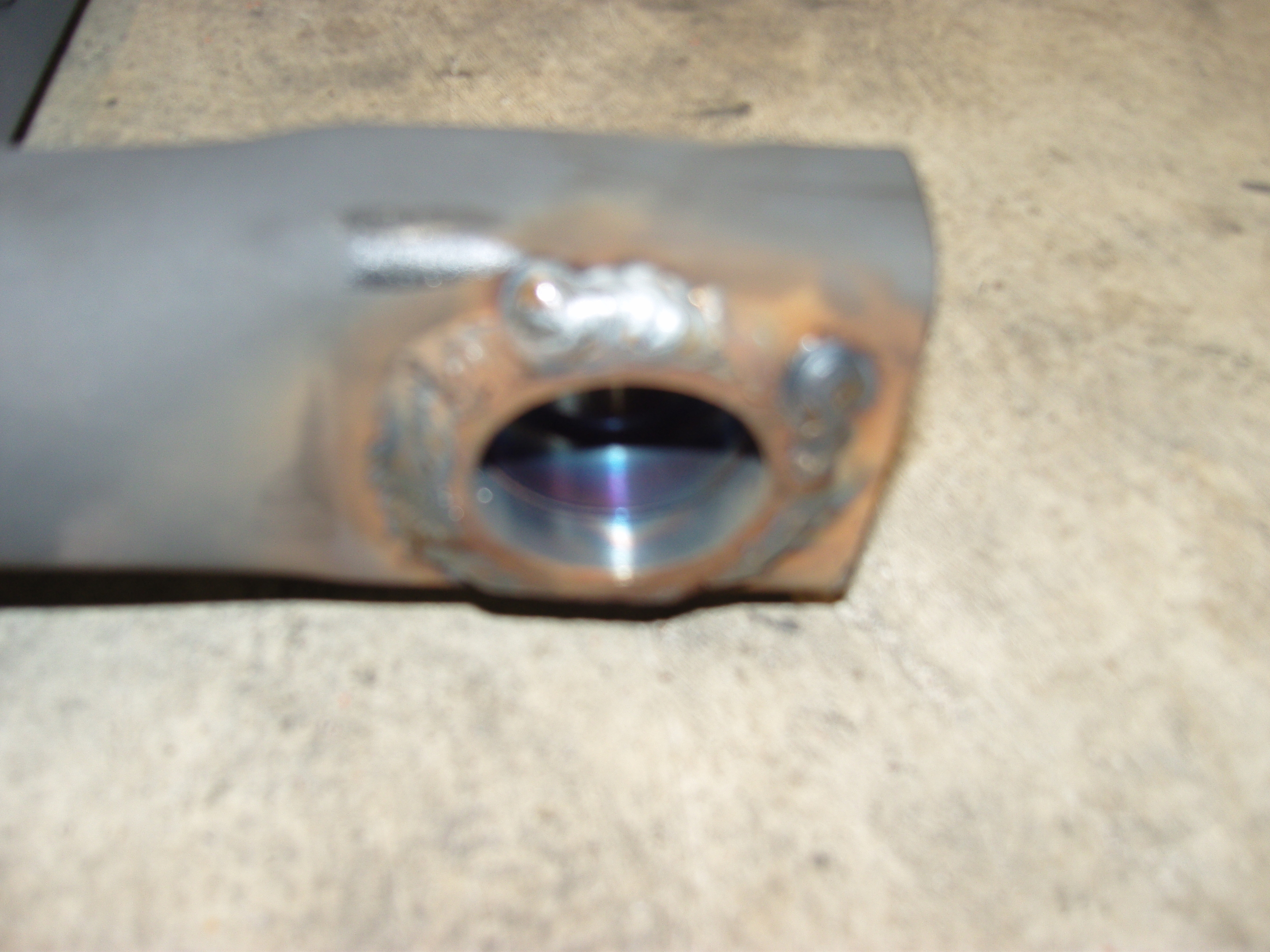

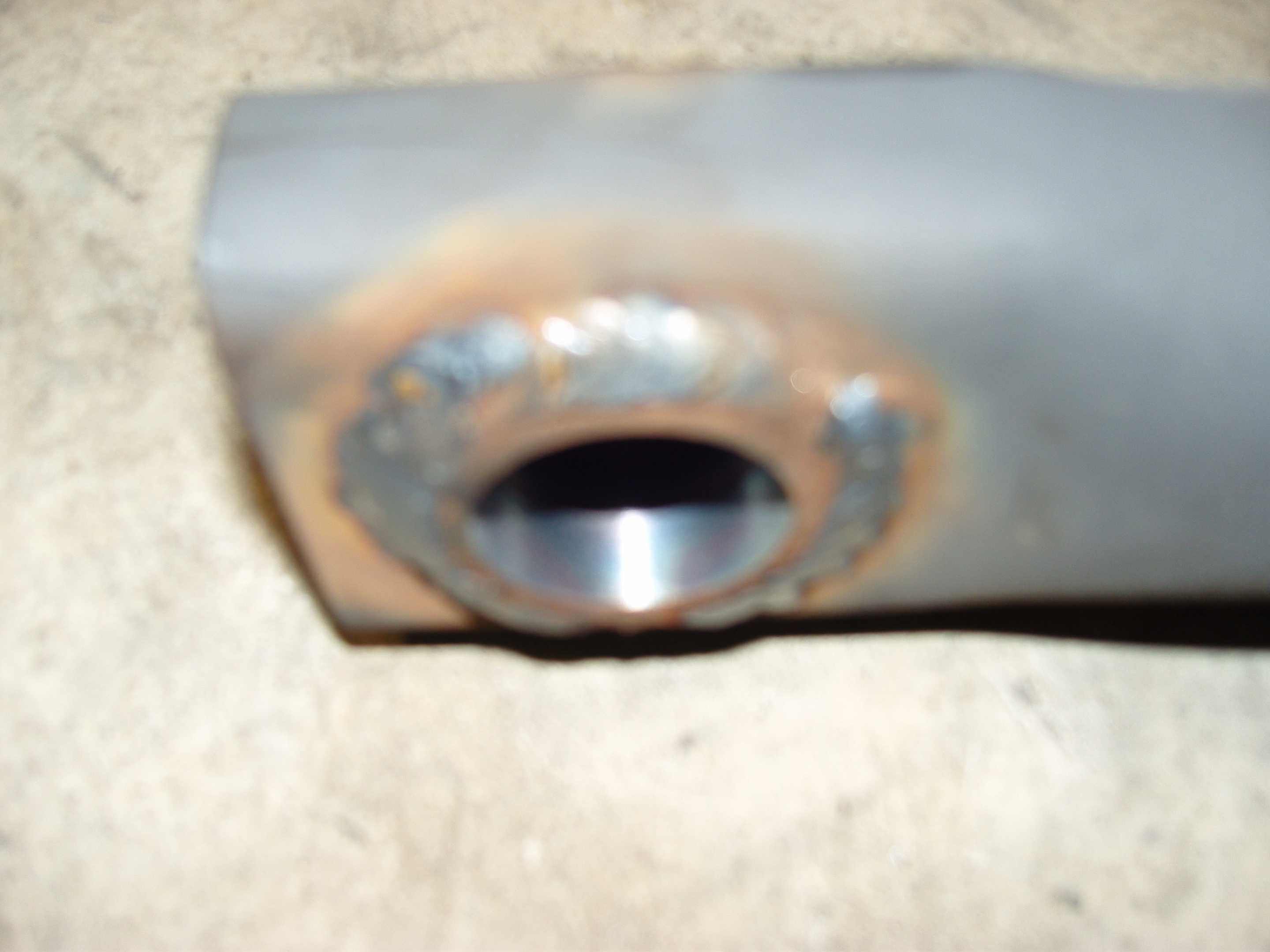

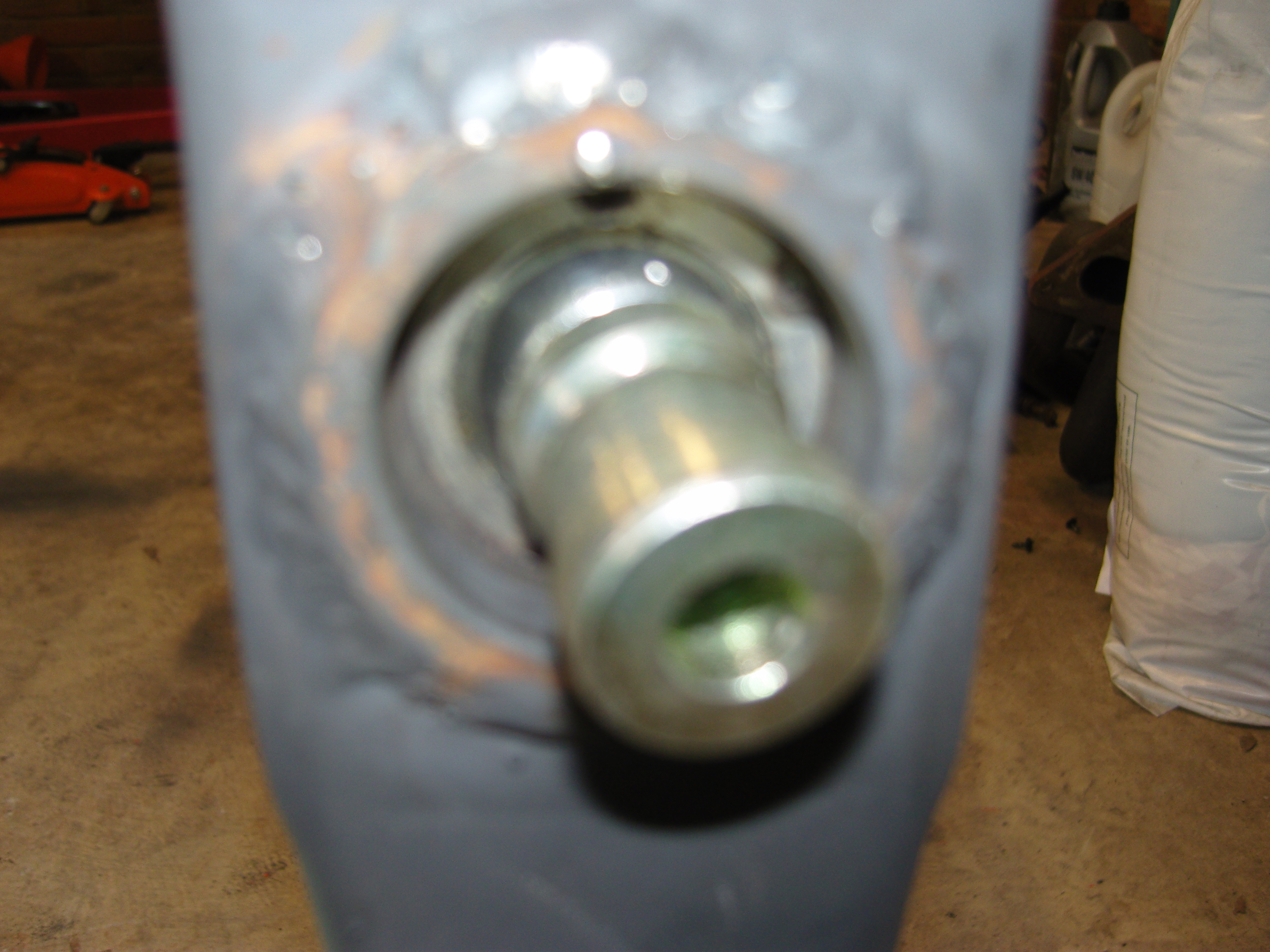

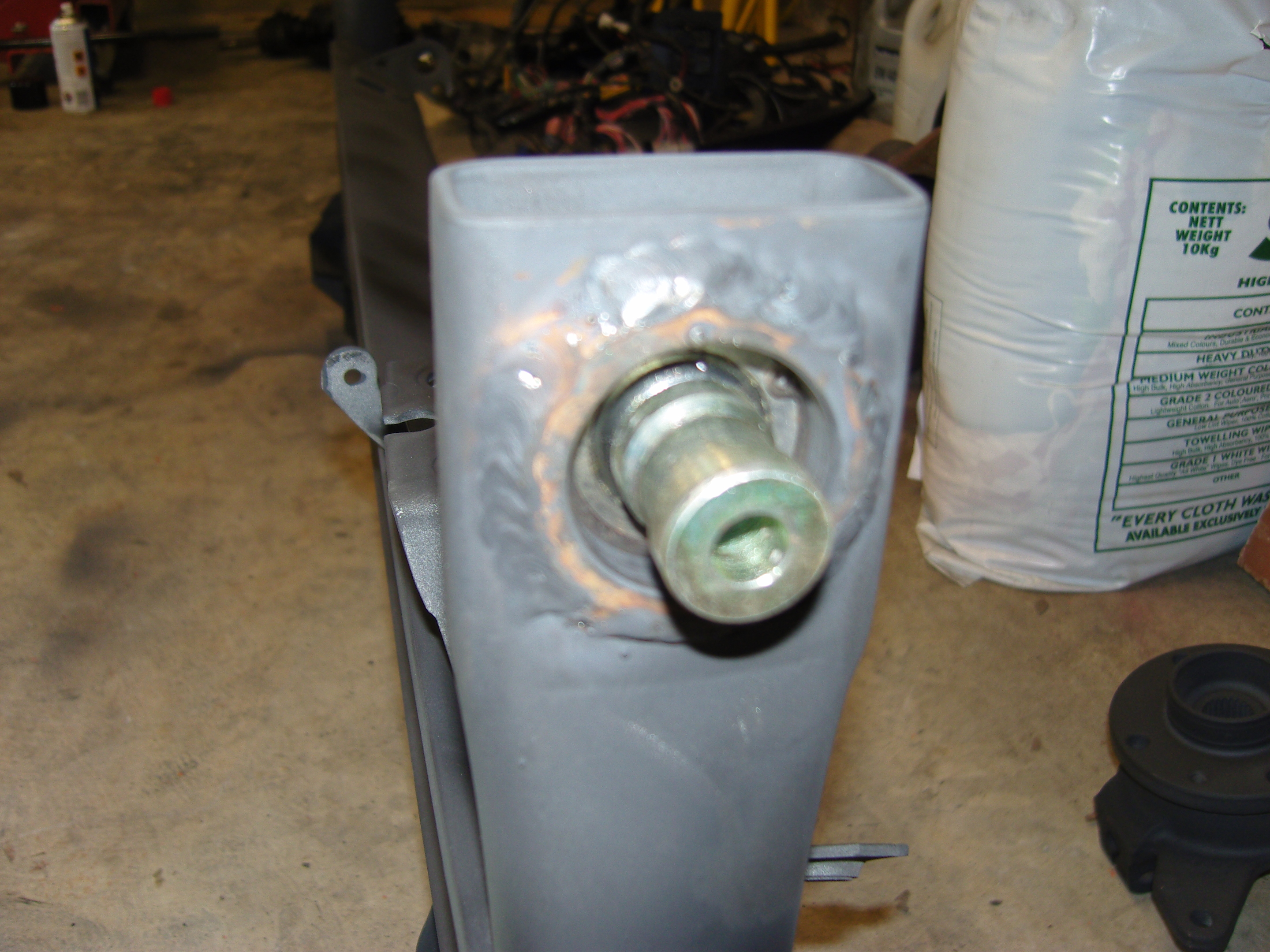

So First I welded in the solid bushes to the rear axle
And then fitted the bearings in them

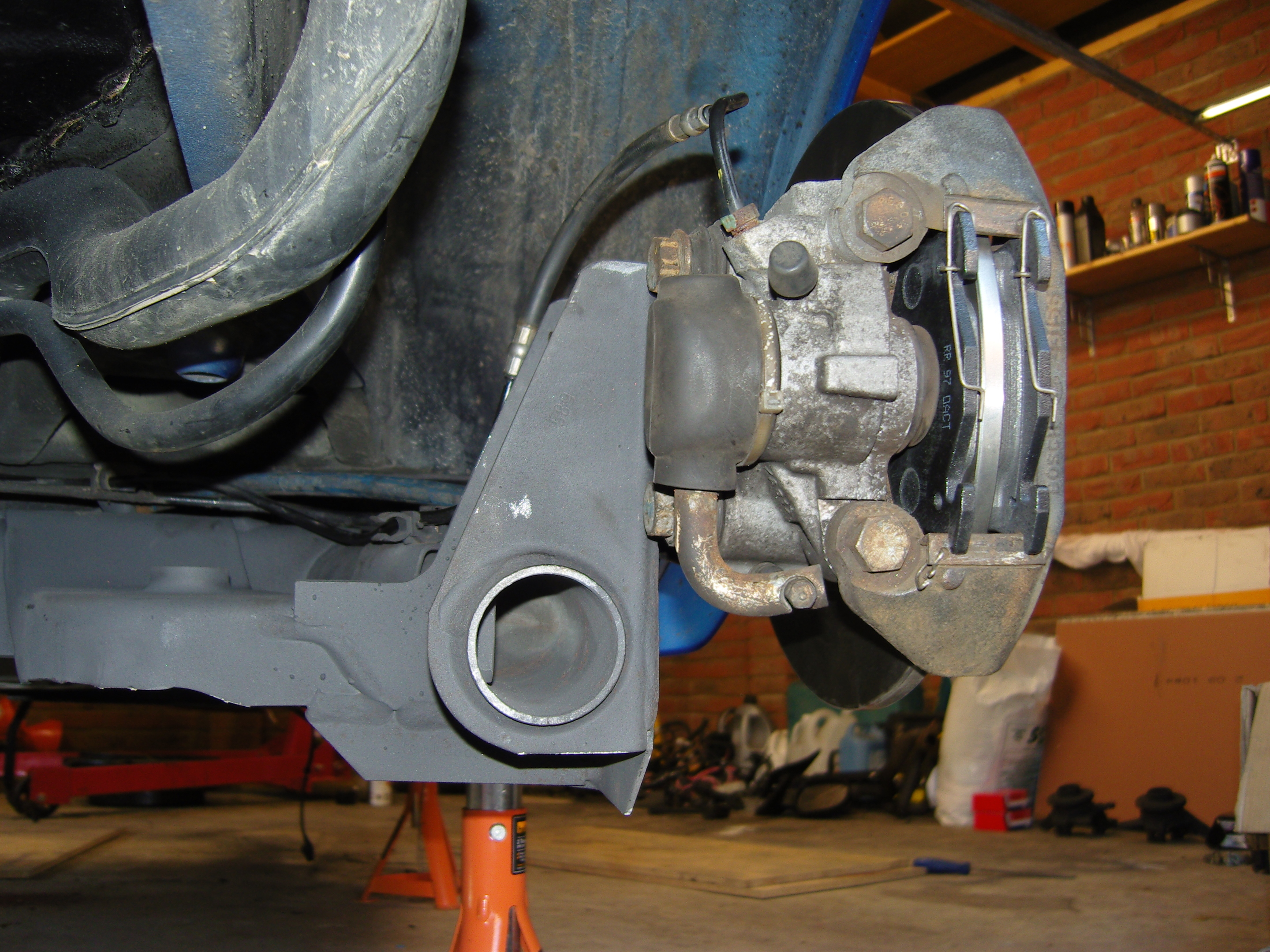

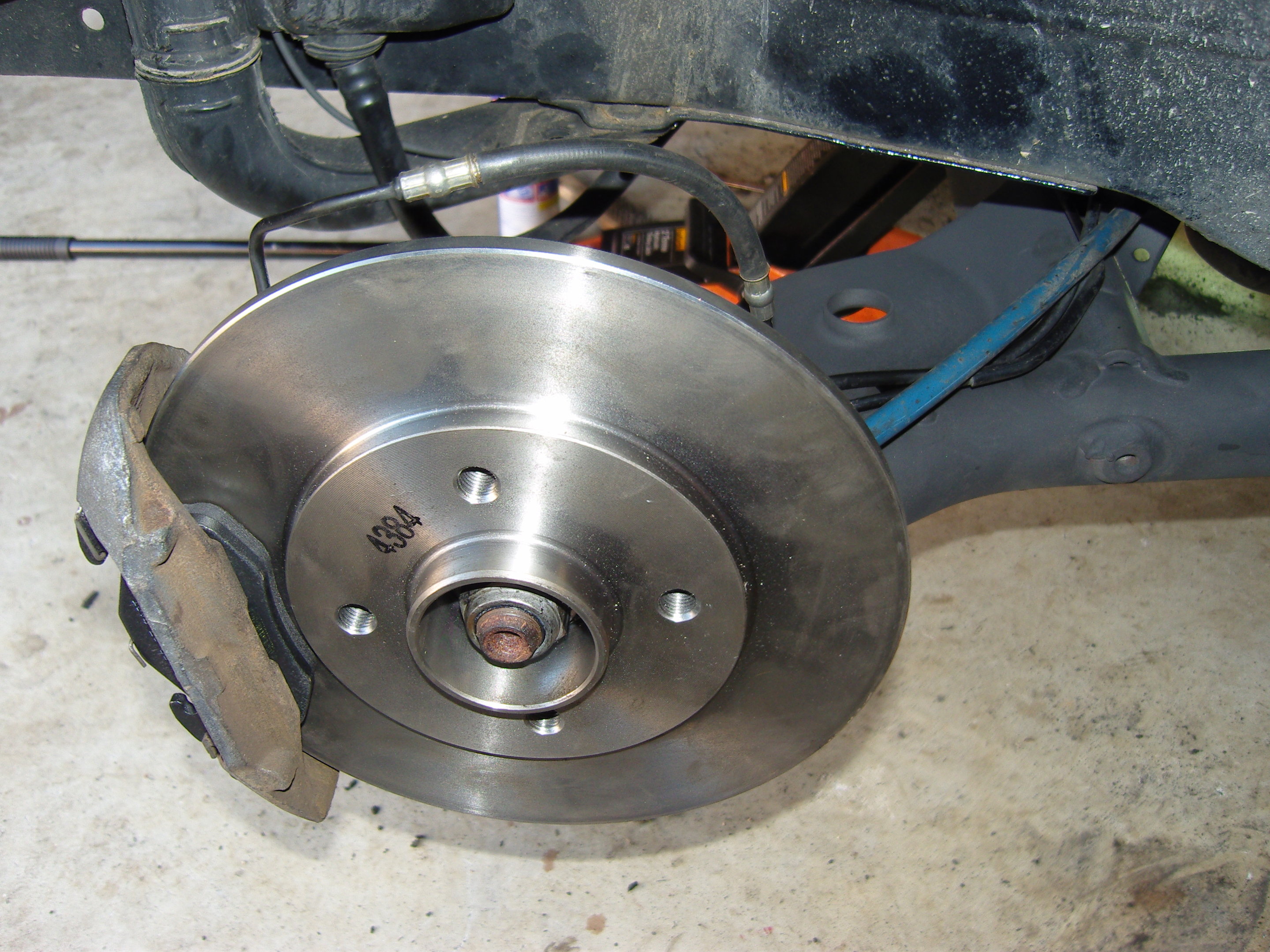

Then fitted the rear axle and put the rear brake lines on
And fitted the rear Brembo discs and callipers not forgetting the pads of course

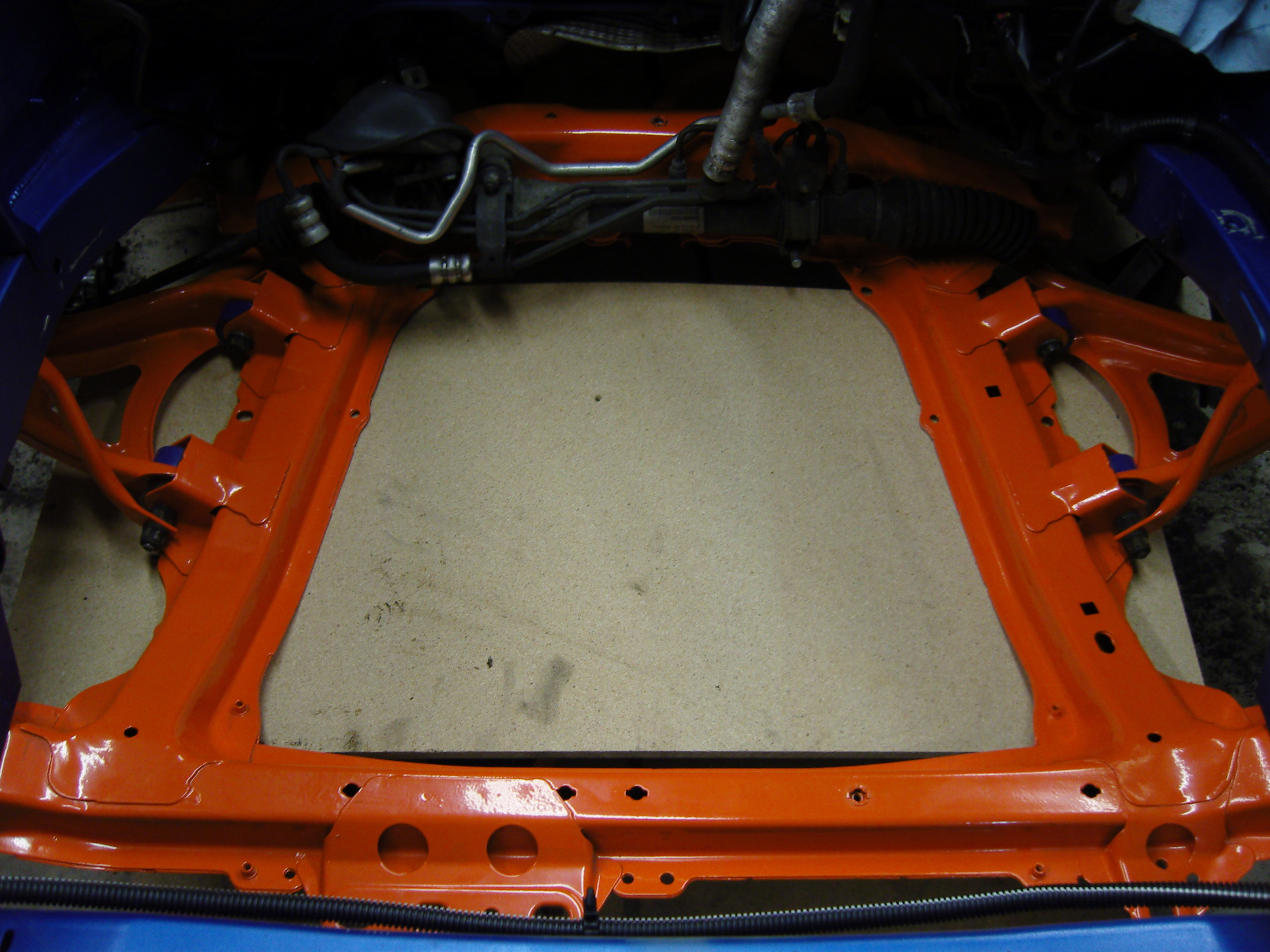

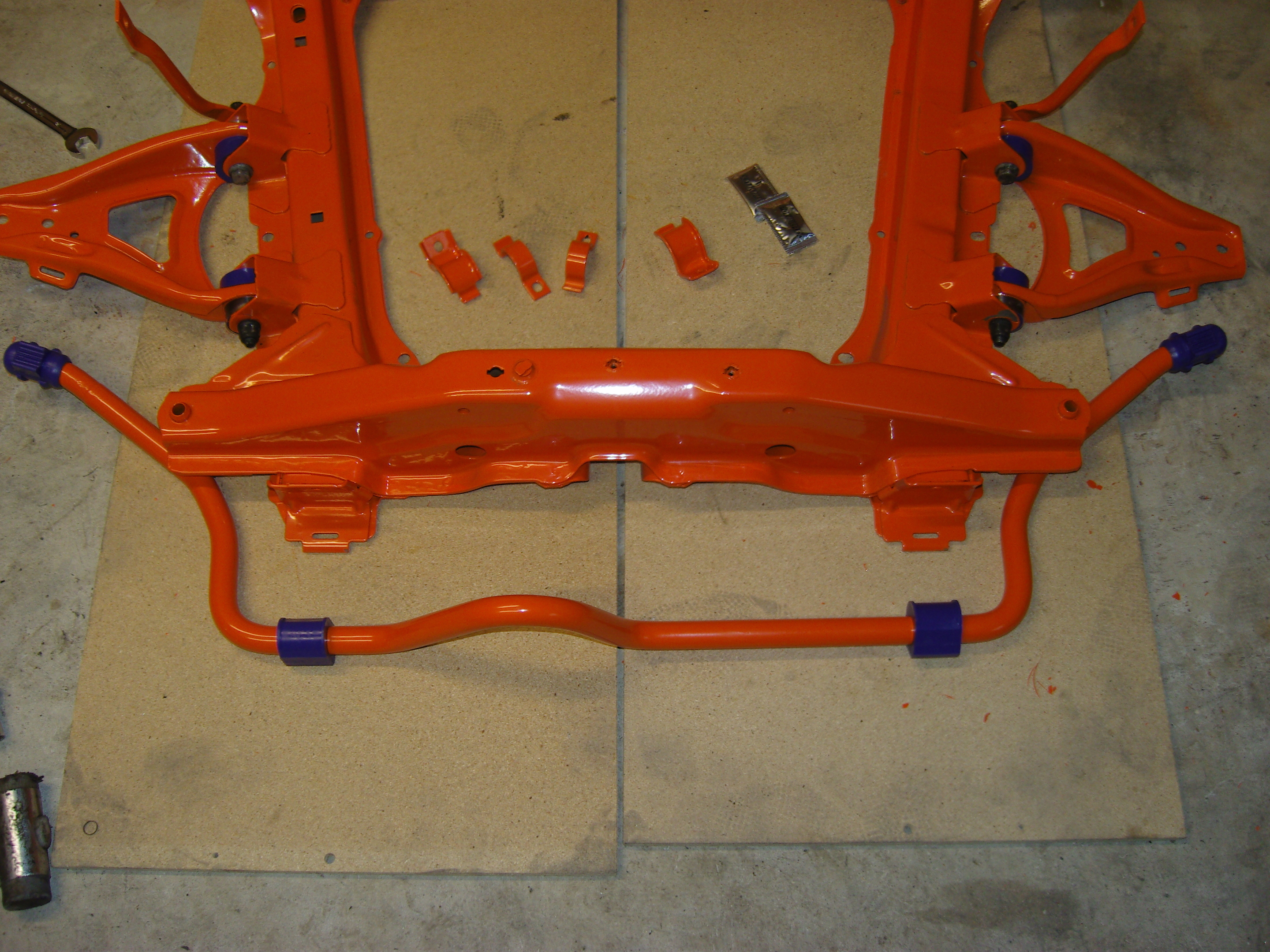

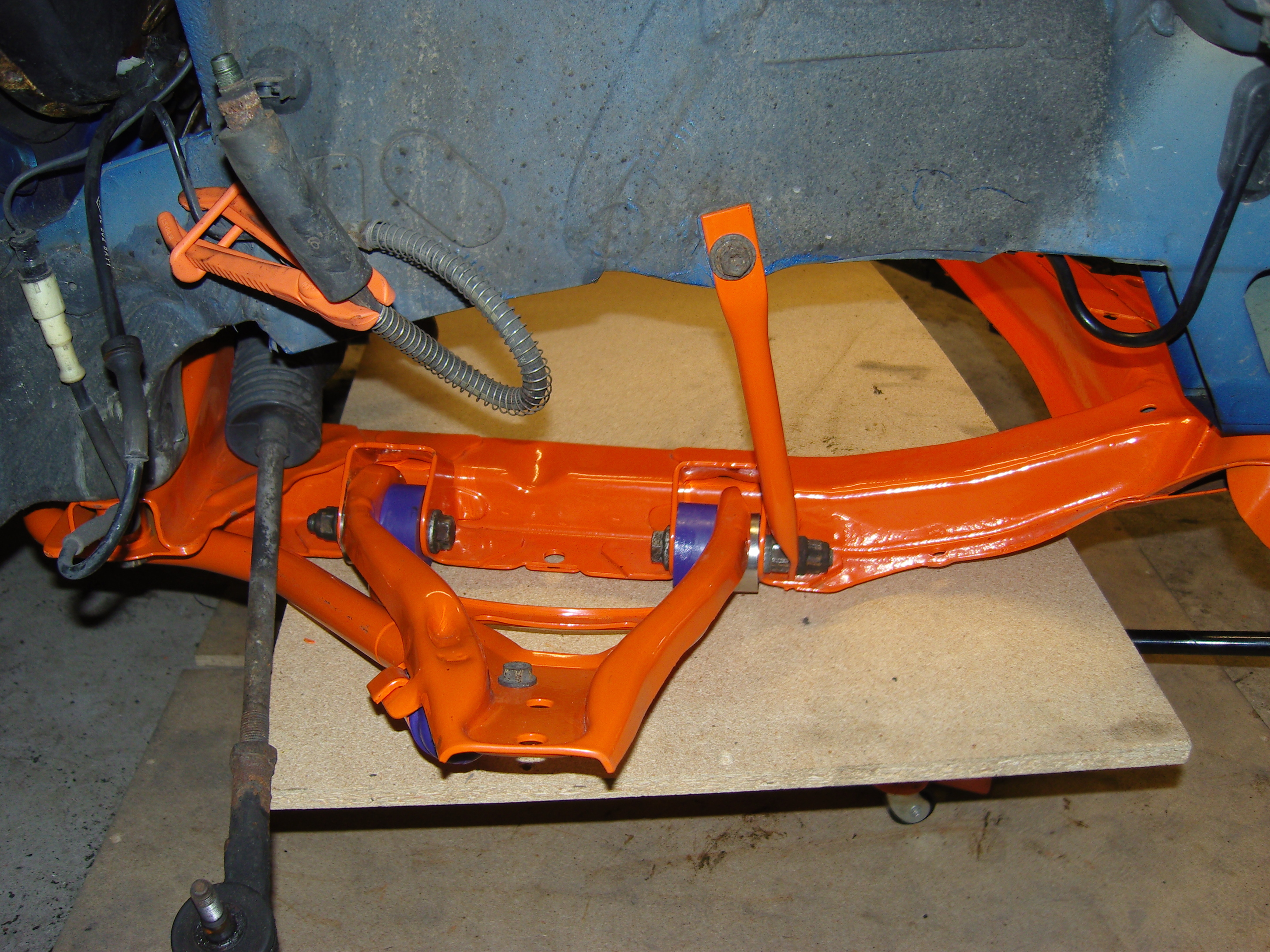

Now onto assembling the subframe

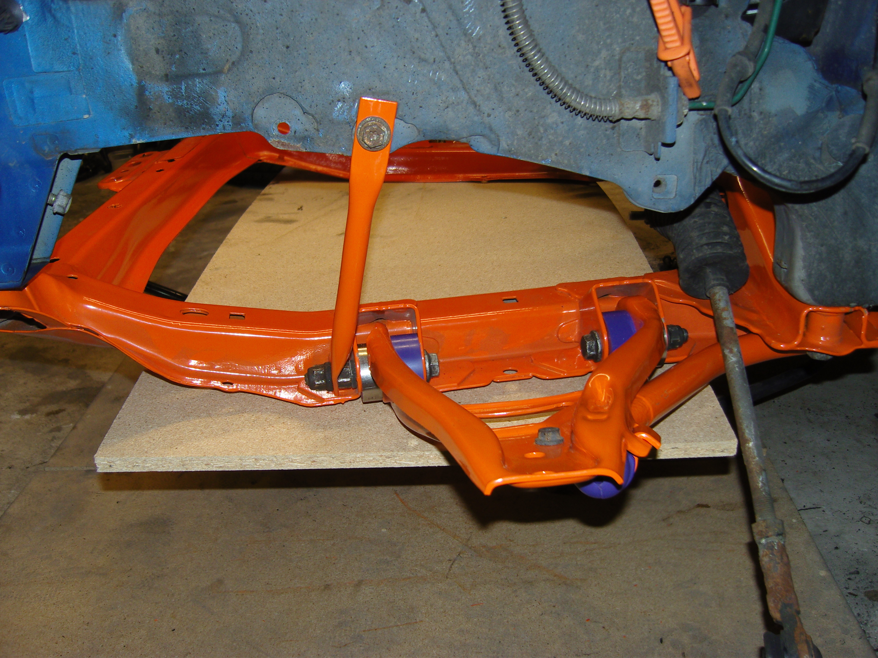

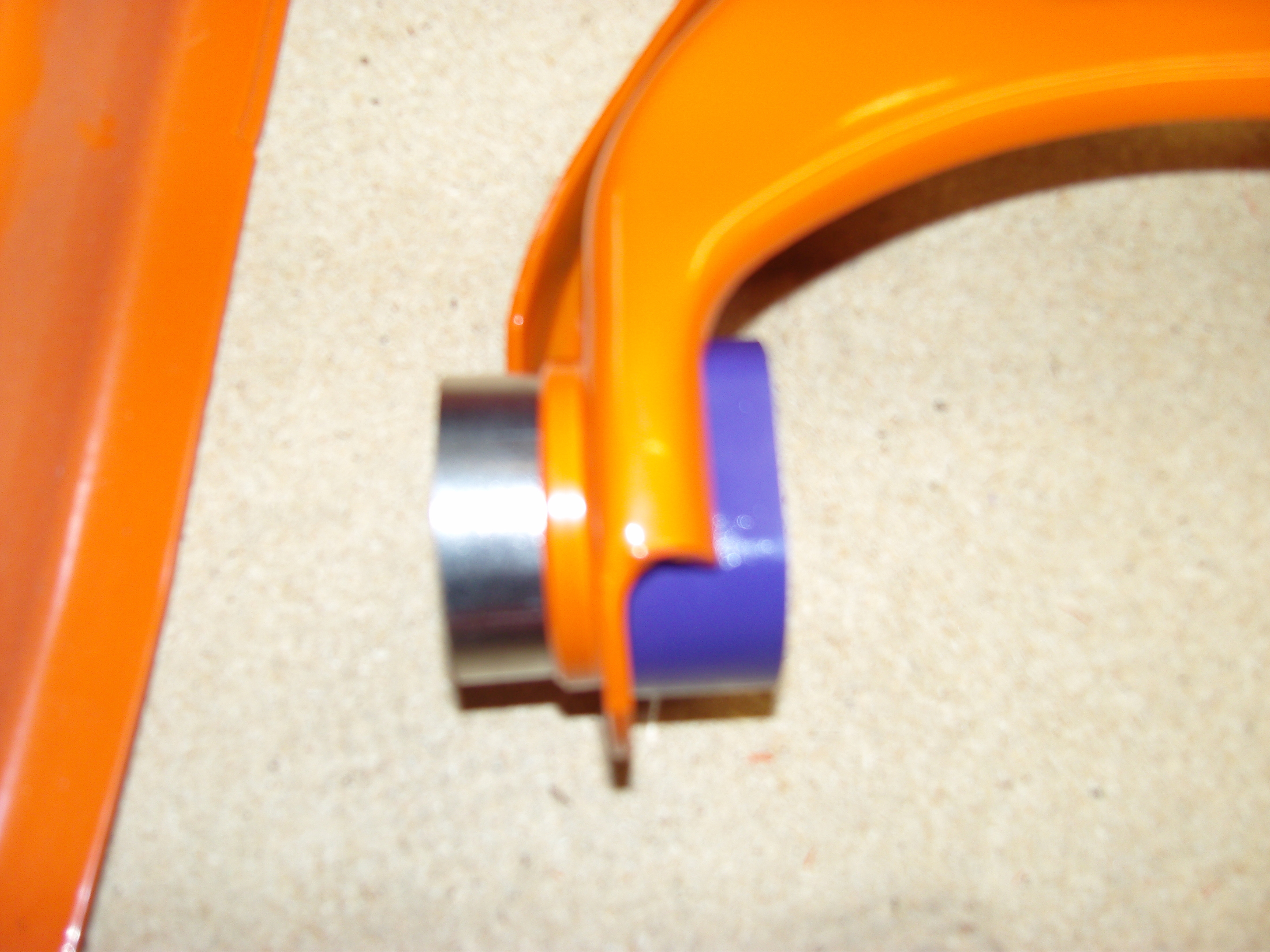

Assemble the wishbones with the new bushes in them. Of course I put them together on purpose without welding them in because im a tw*t and just f**king love doing jobs twice

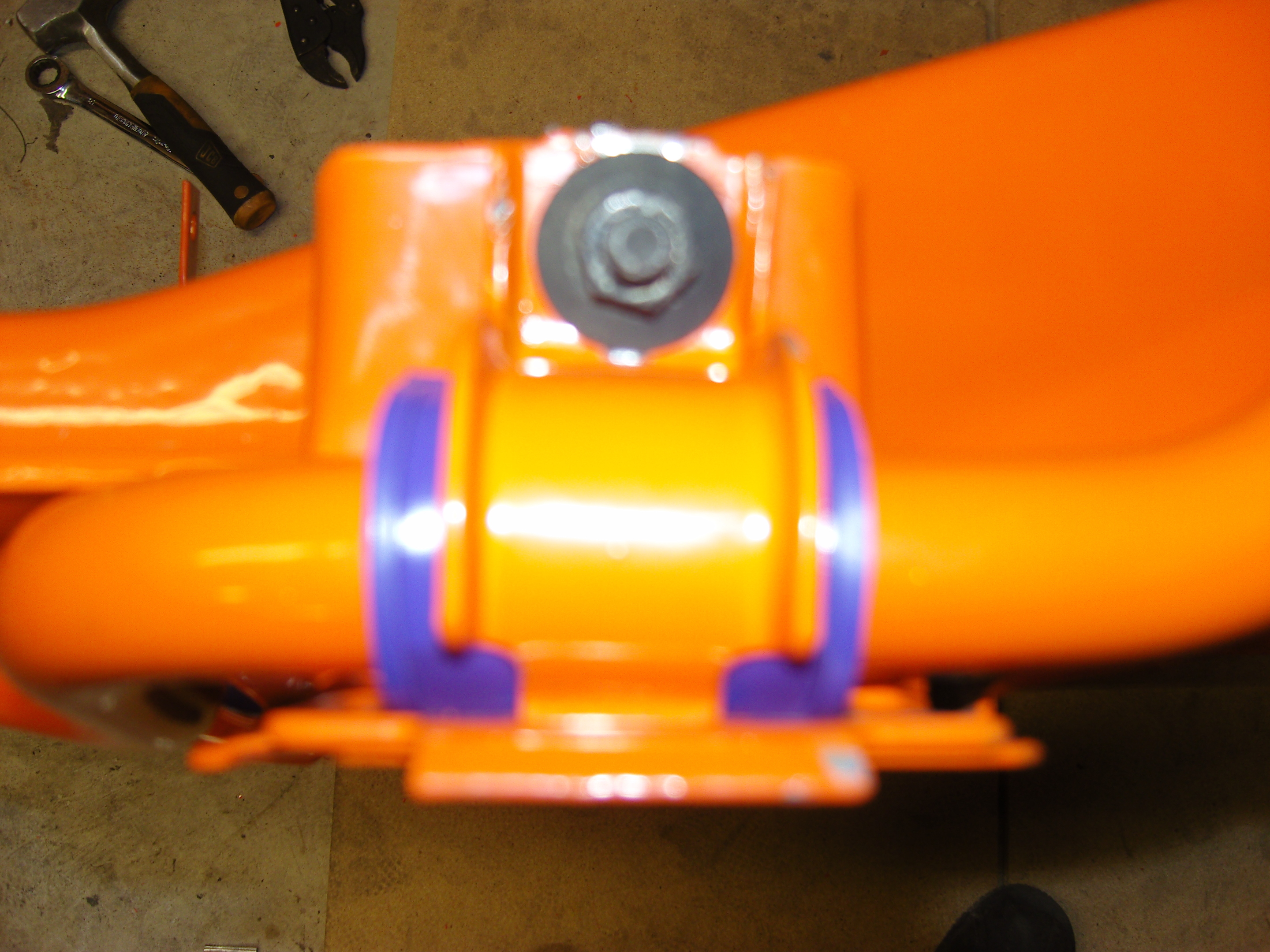

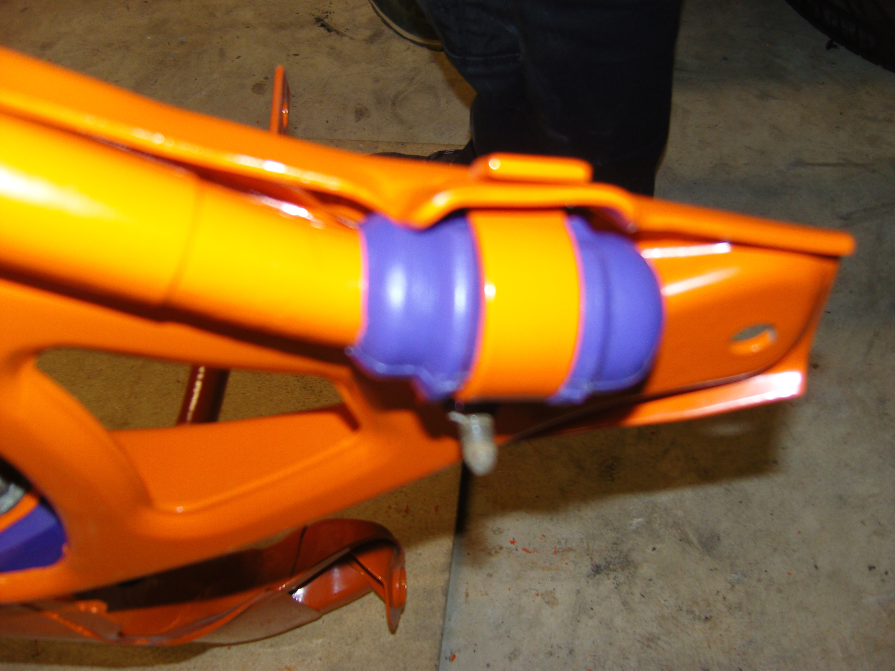

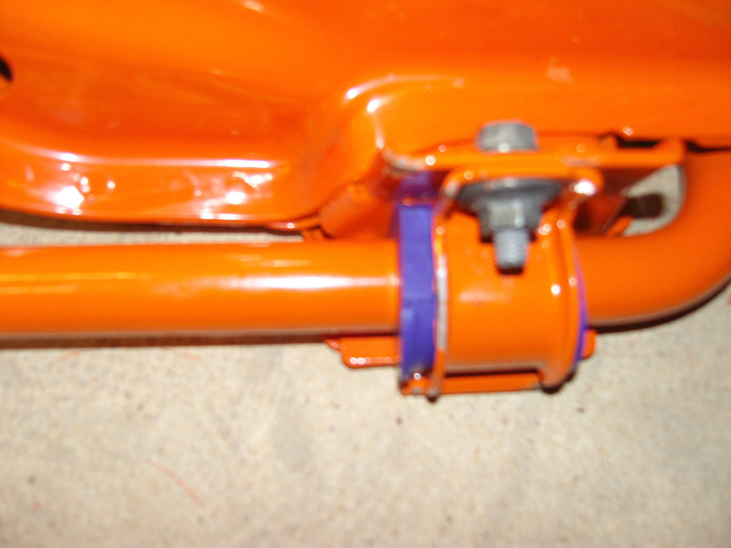

Put the front ARB on. Nifty trick here. Grip the Clamp in large grippers in the centre and then nip the corner of it with mole grips, then put the bolt through. 2 mins a side doing it this way

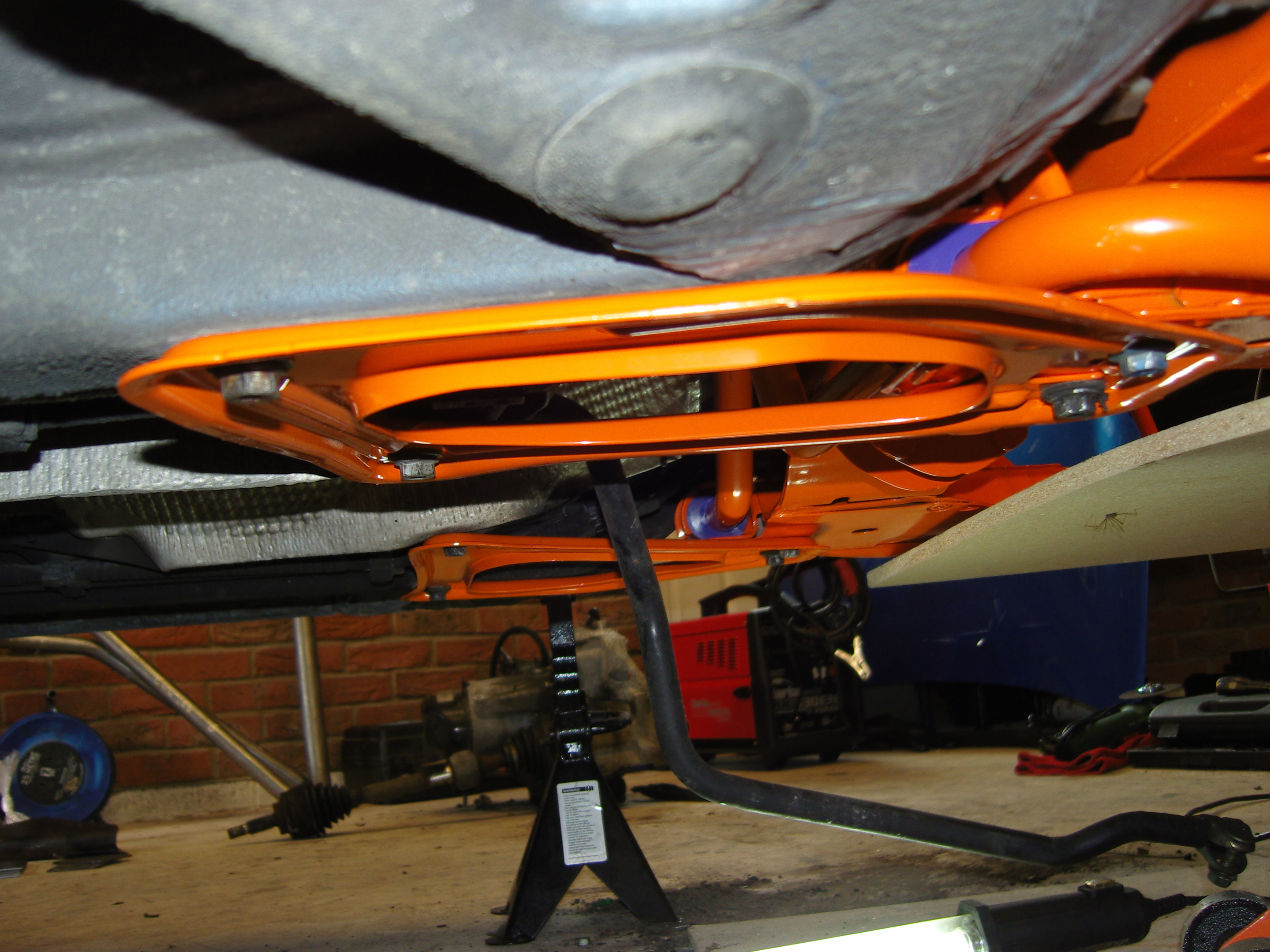

Now take the whole thing and put it back in the car
Left side
Right Side
And underneath
