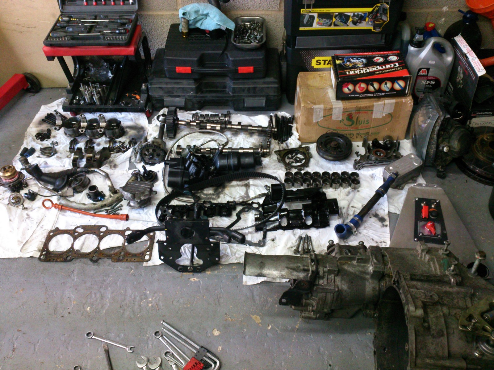

So the big strip continues with a nasty surprise.
Engine out then

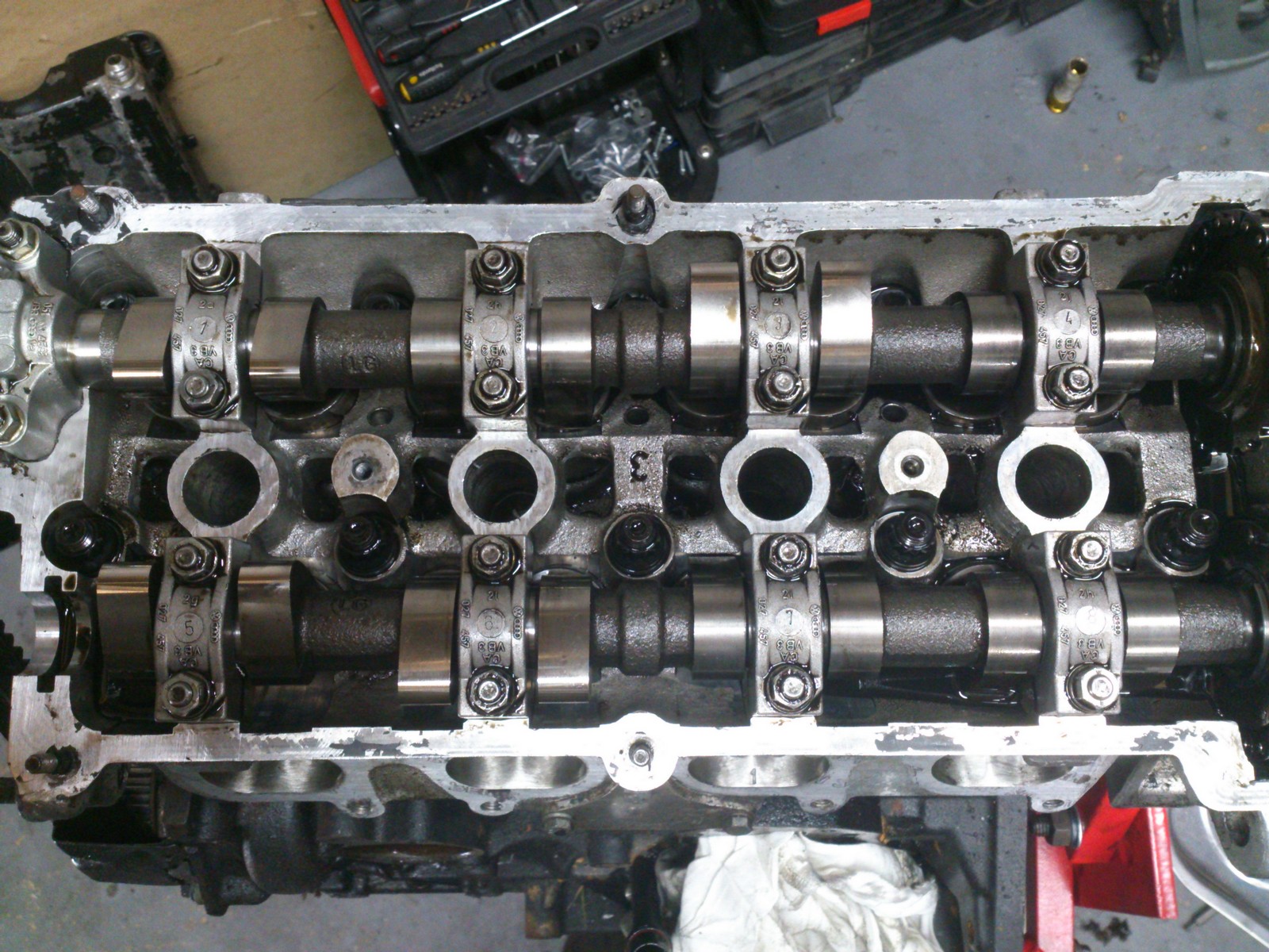

Nice set of cams and solid bucket lifters

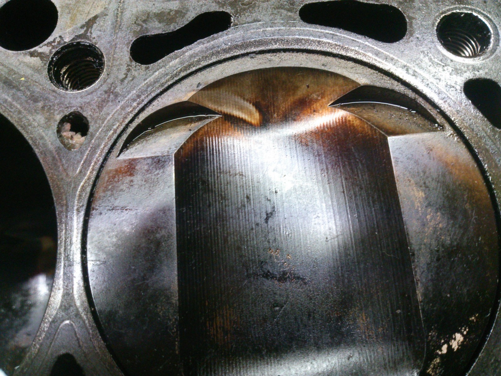

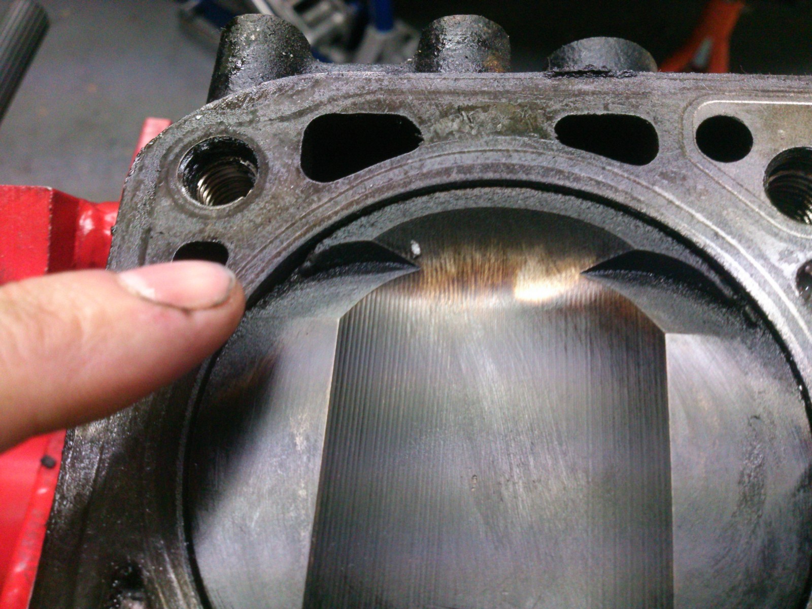

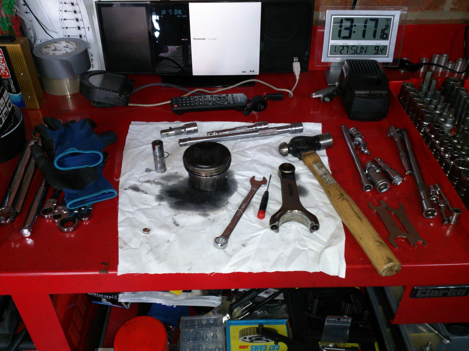

Oh Poooo, wrong fuel used here methinks!!
That's what it should look like.
This rebuild just increased in costs by £600 Pooo
  BMW Z4
Looks more like an injector to me as its only the one piston but hard to tell from pics Fred can't even see it lol
I do know it was mapped for V power and run on 95 but that it also was running very rich too. Either way it needs a new set of spitons now and then a good map and setup.

That's seen some pretty severe detonation! The other piston looks like its showing some signs of detonation too. What do the plugs look like? What ecu is it running? Obviously not been monitoring knock.
  BMW Z4

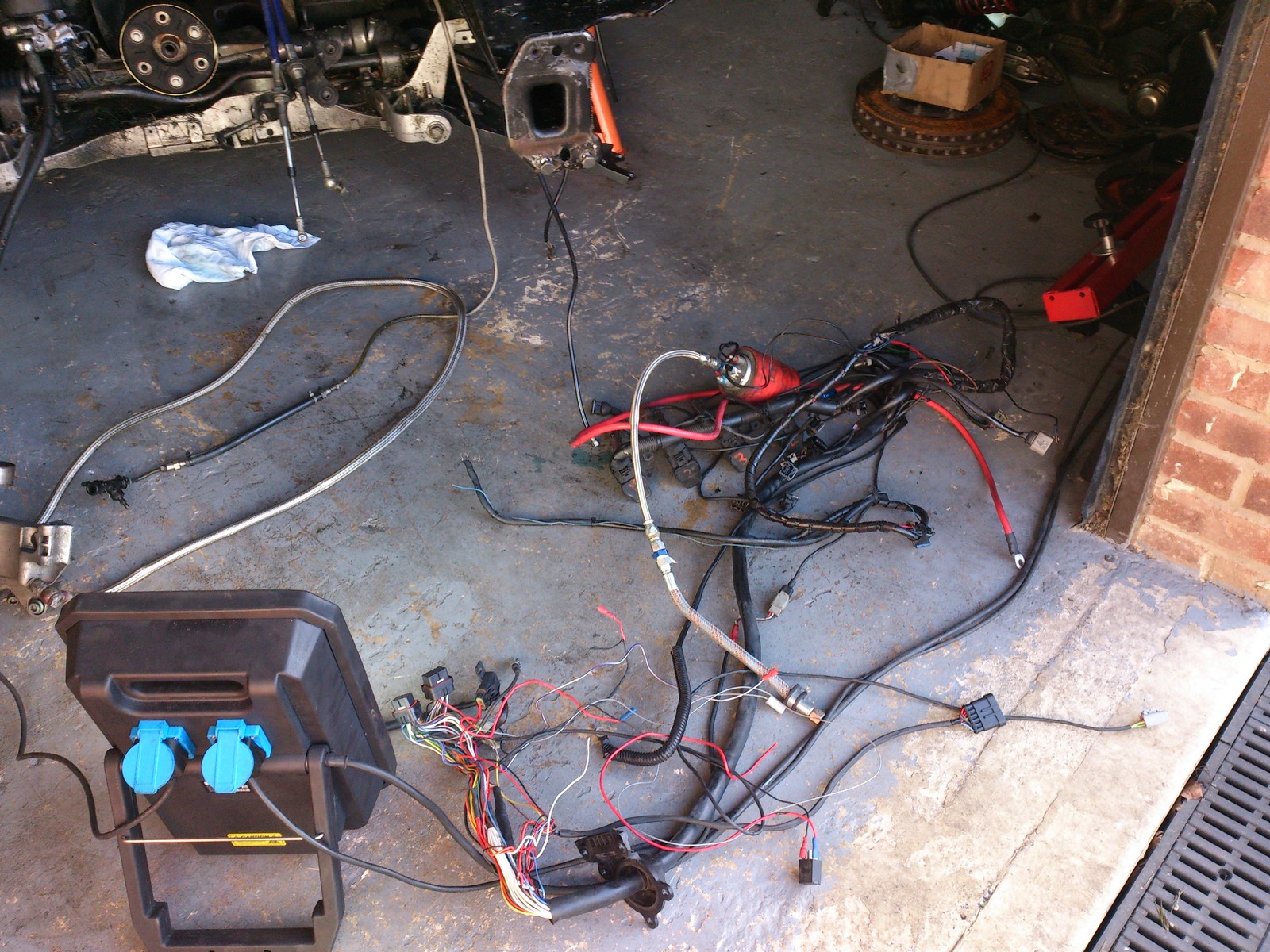

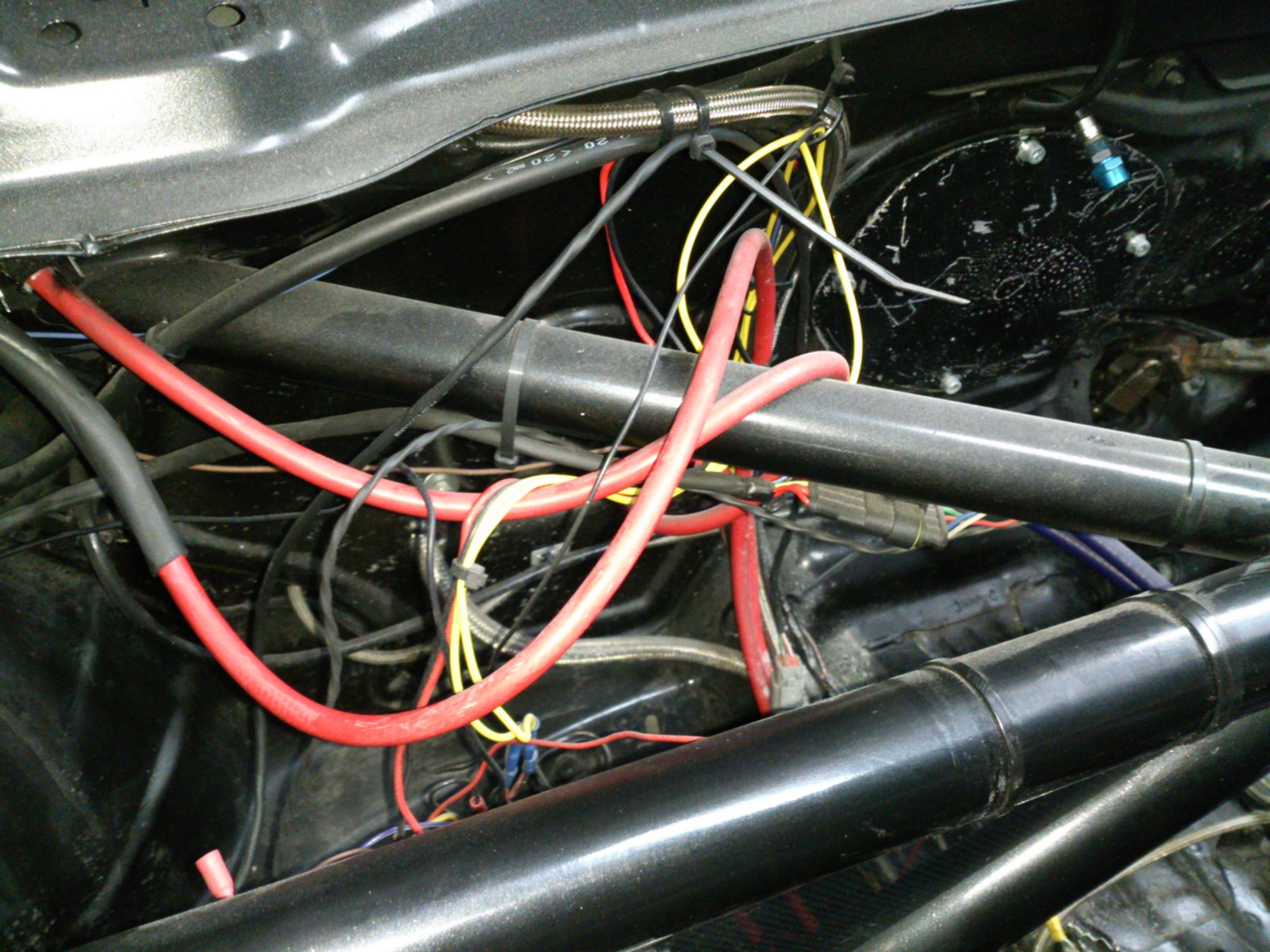

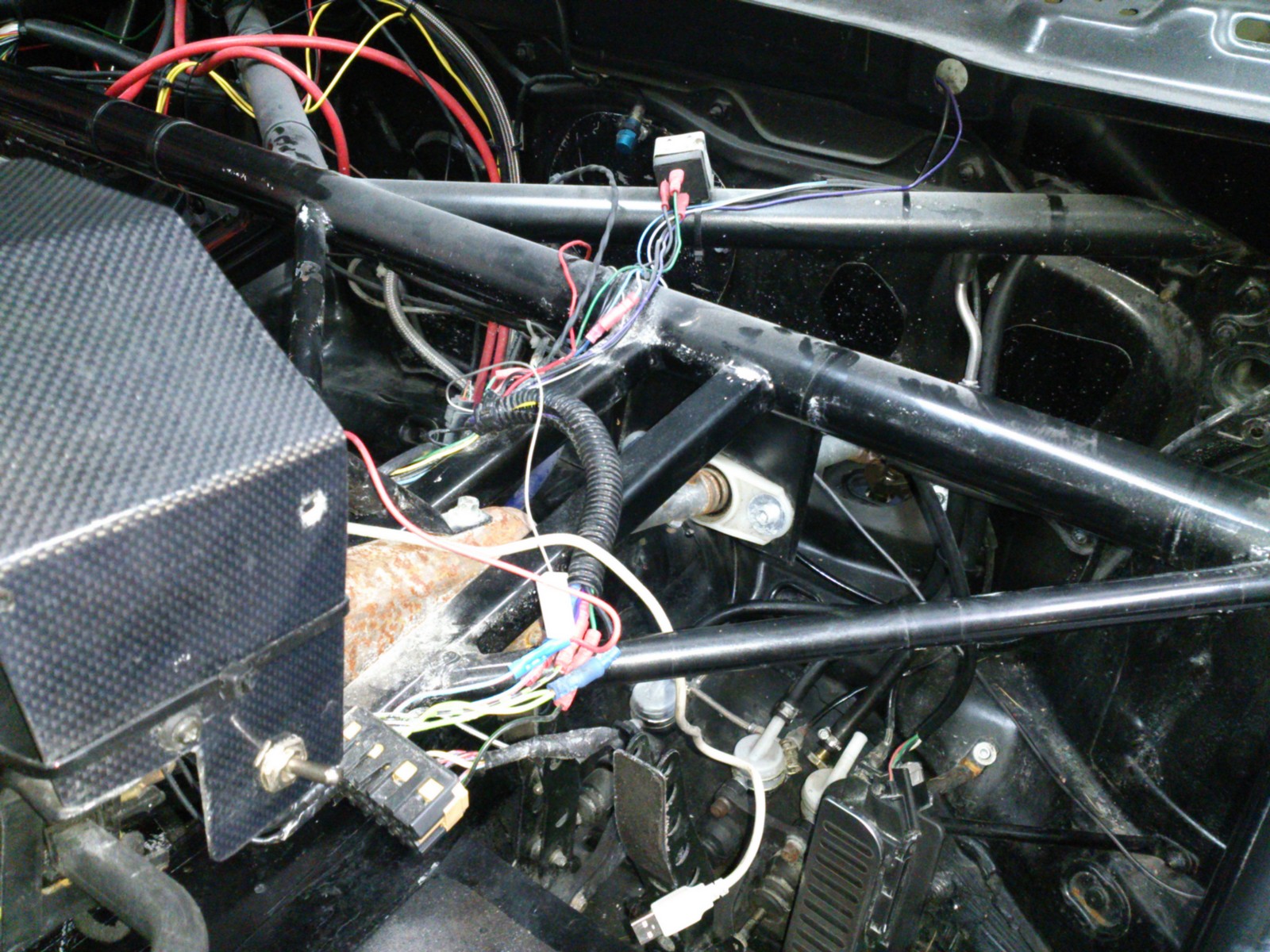

Yes I agree, one plug lost a prong and its on a MOTEC. Troy will map it for me at NMS like the Clio, he is also doing the interior loom for me again. More pics for you.

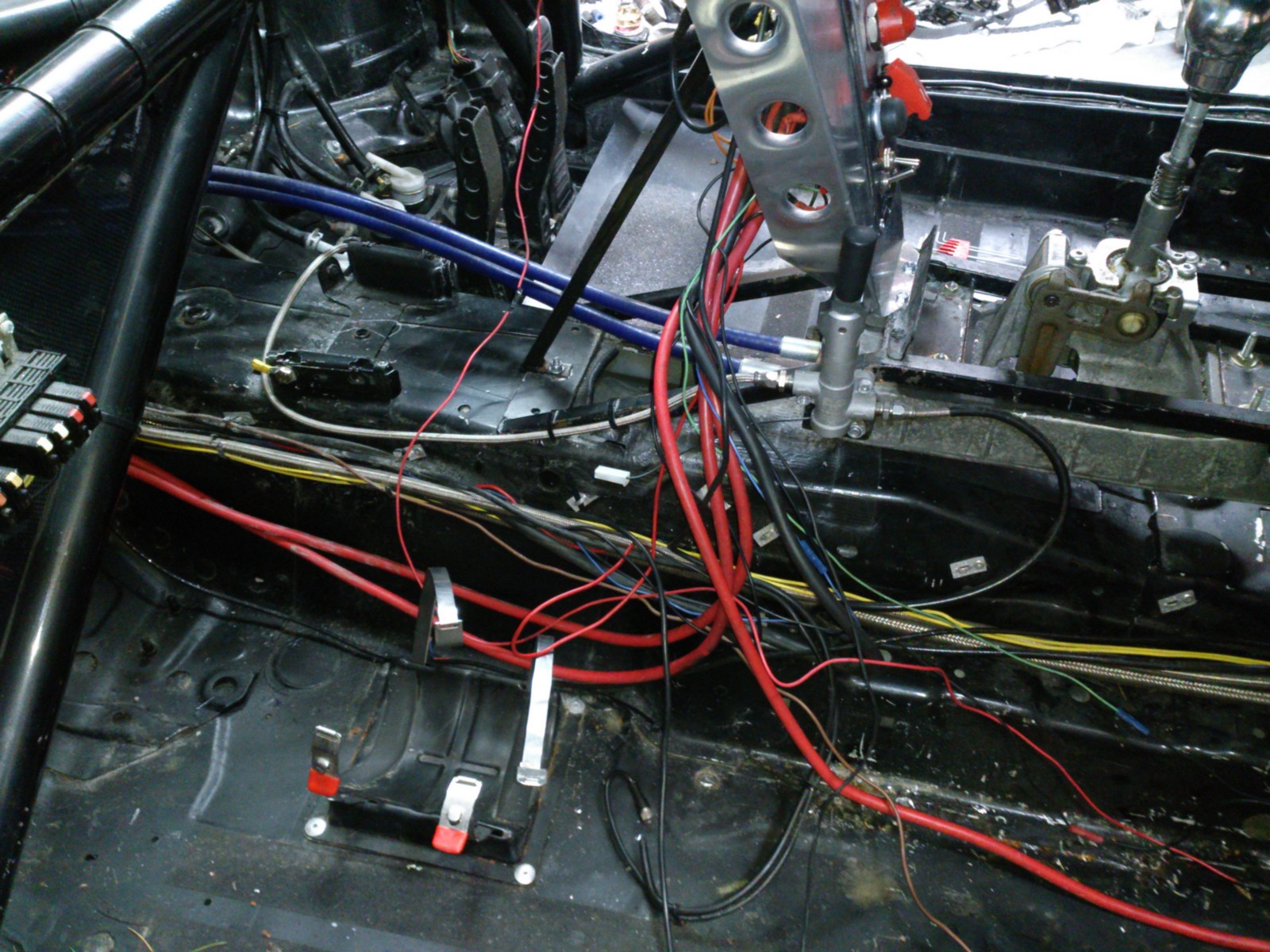

Very messy wiring

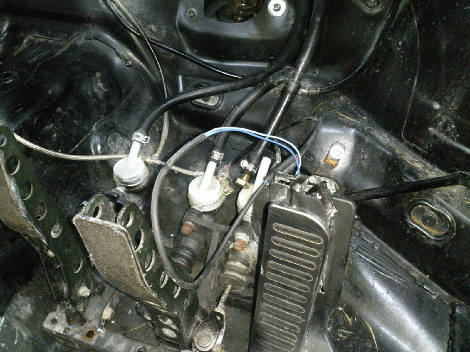

Nice pedal box

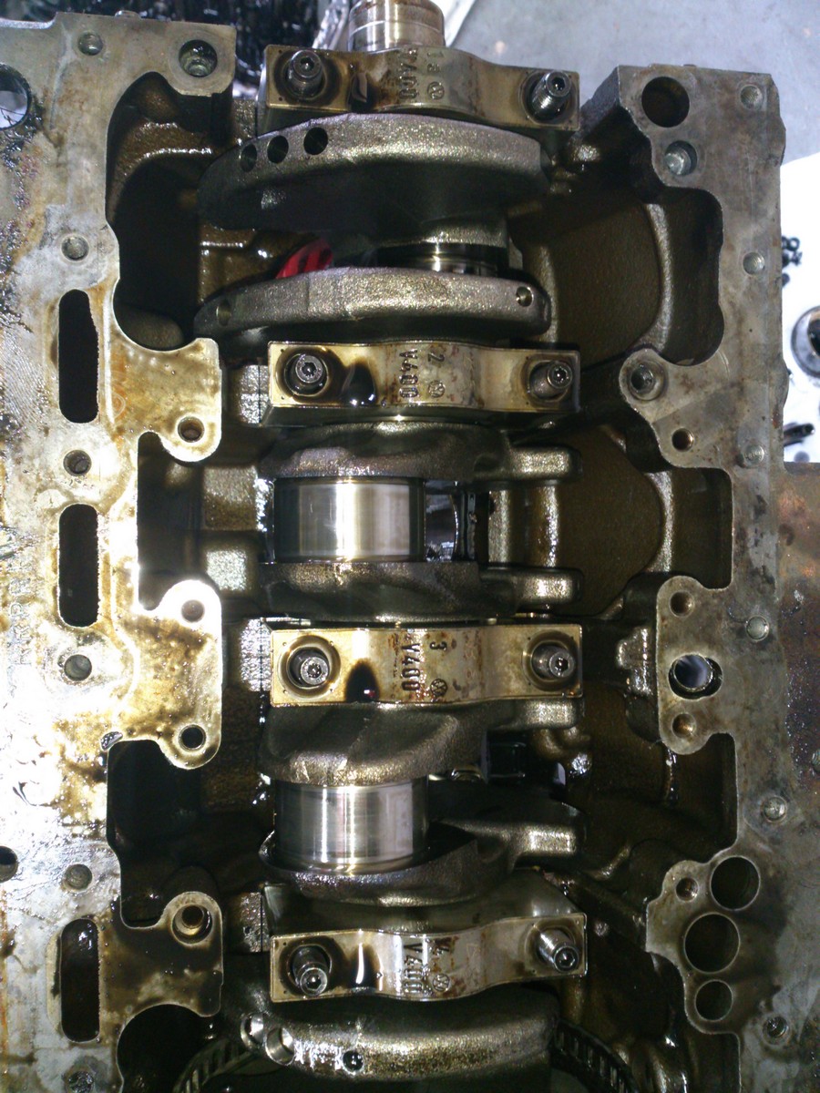

Engine in bits ready for putting back together after a good clean

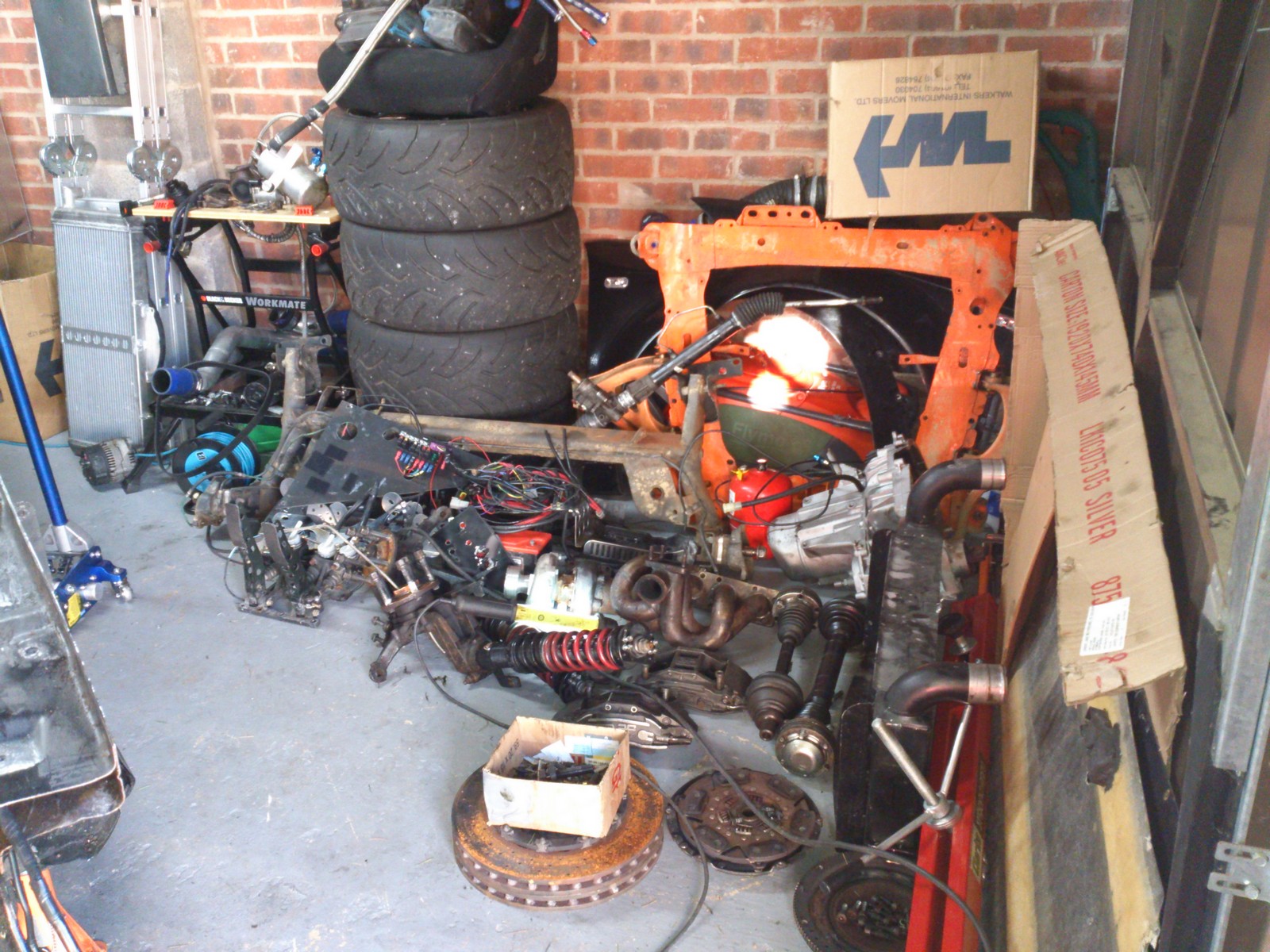

An Audi and some Clio. I am running out of space LOL

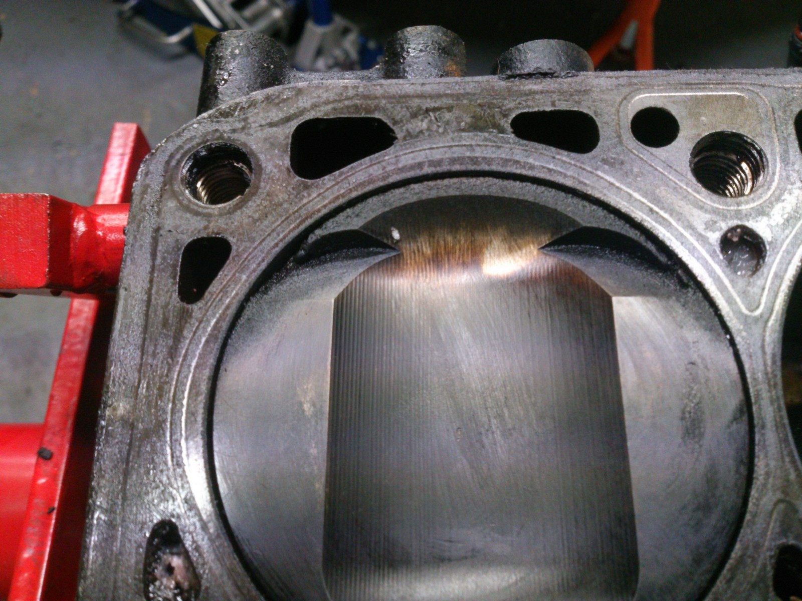

The offender, nice Arrow rods though and nice dash in background

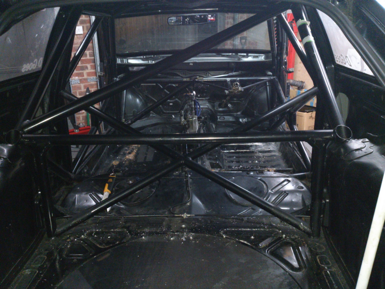

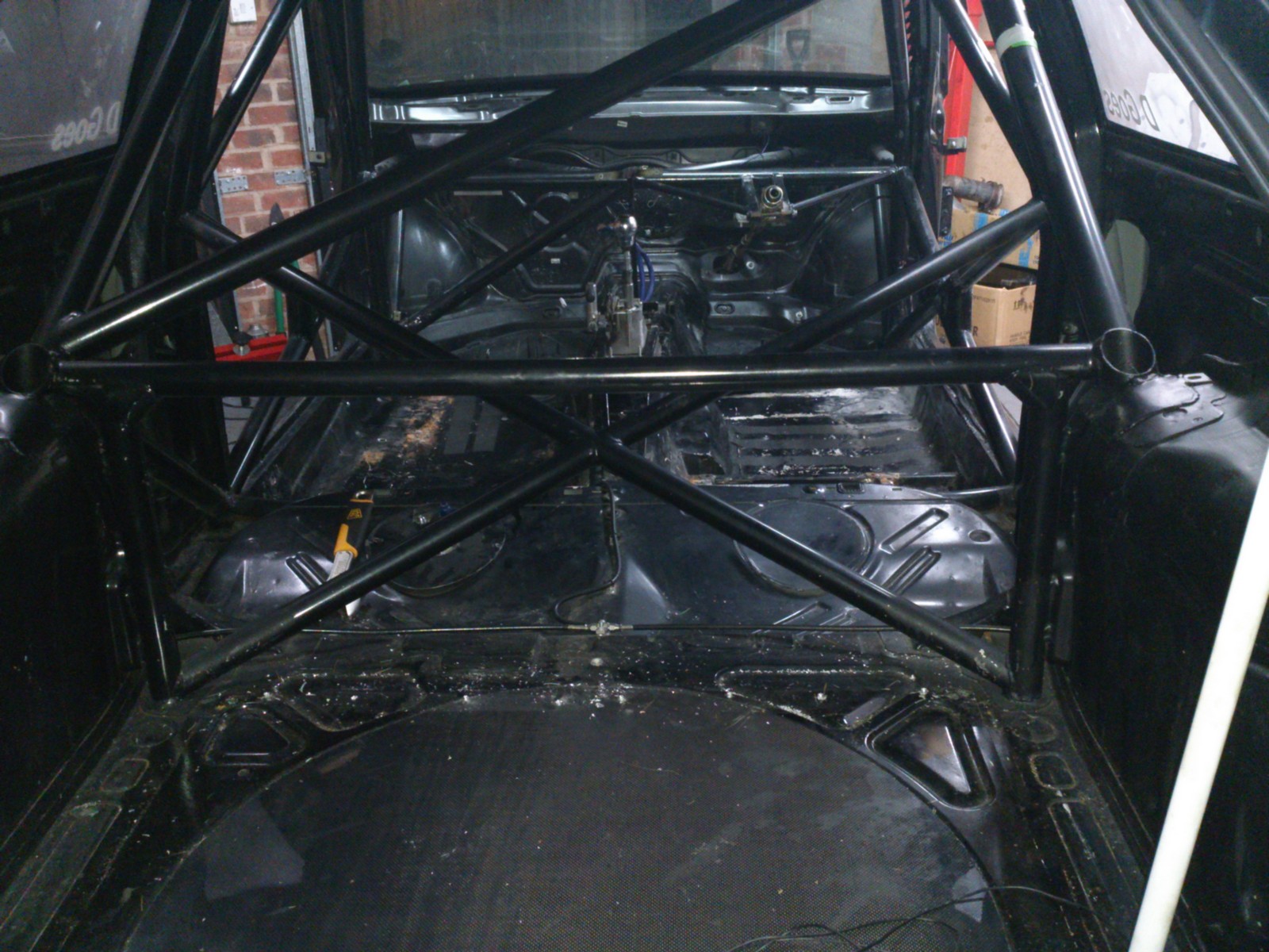

Stripped ready for paint prep

Good progress though, are you taking the windows out before you paint the inside? Make life a whole lot easier.
  BMW Z4
Just a thought but is this not worthy of its own thread?
I have masked them all up now :)
As for its own thread I guess it sort of is. Be a ball ache to move it all now.
  Audi A6 & 172 Cup
Hmm, it is of course entirely up to you but for all the time it takes I would get them taken out, a window company will do remove and refit for a reasonable fee. Another point to note, the tubes directly behind the windows are the bits your going to see when you look in said window, if you don't get a decent finish on them everyone will see it.
The guy who did mine said it was one of the trickier cages he's done and there's no way he could have done it with the windows in.

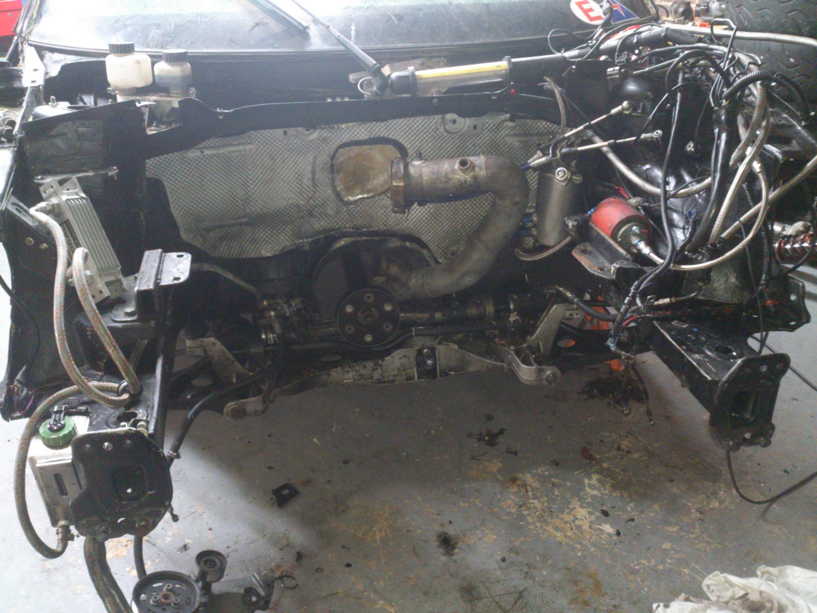

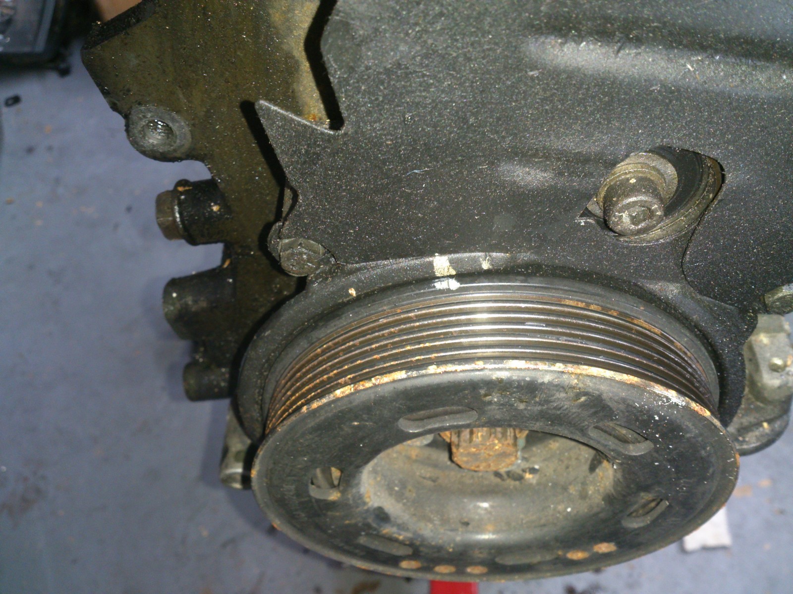

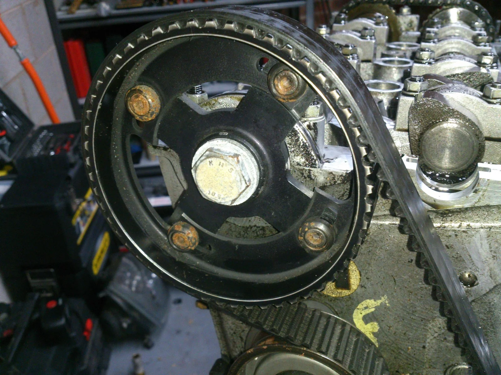

Nope, further to the corner than that, it looks like a clutched pulley to me, usually fitted to AC.
That's a little oil cooler for the power steering system.

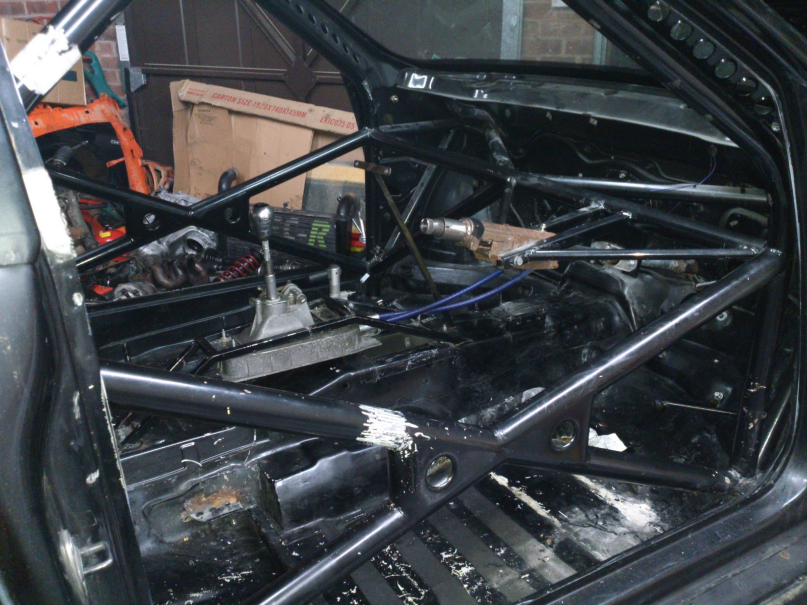

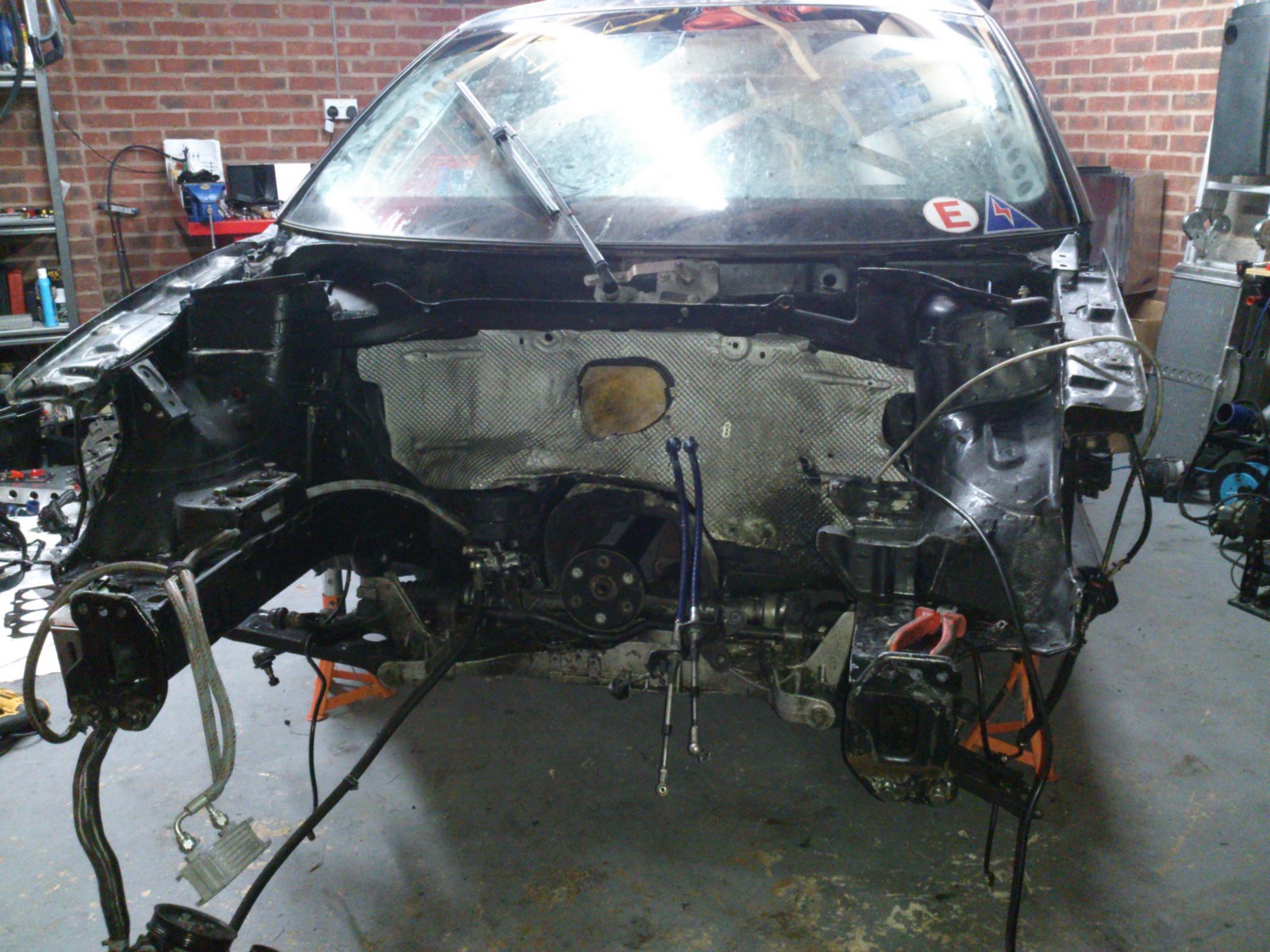

I spoke to the bodyshop in peterborough and they will collect it for me so just have to put the front shox back in and wheels on and they can have it. What do you thk about me getting them to do the engine bay white and also the outside of the car too?
As for thread title I dont think I should change it as most of this thread is my Clio. Hmmm what to do what to do.

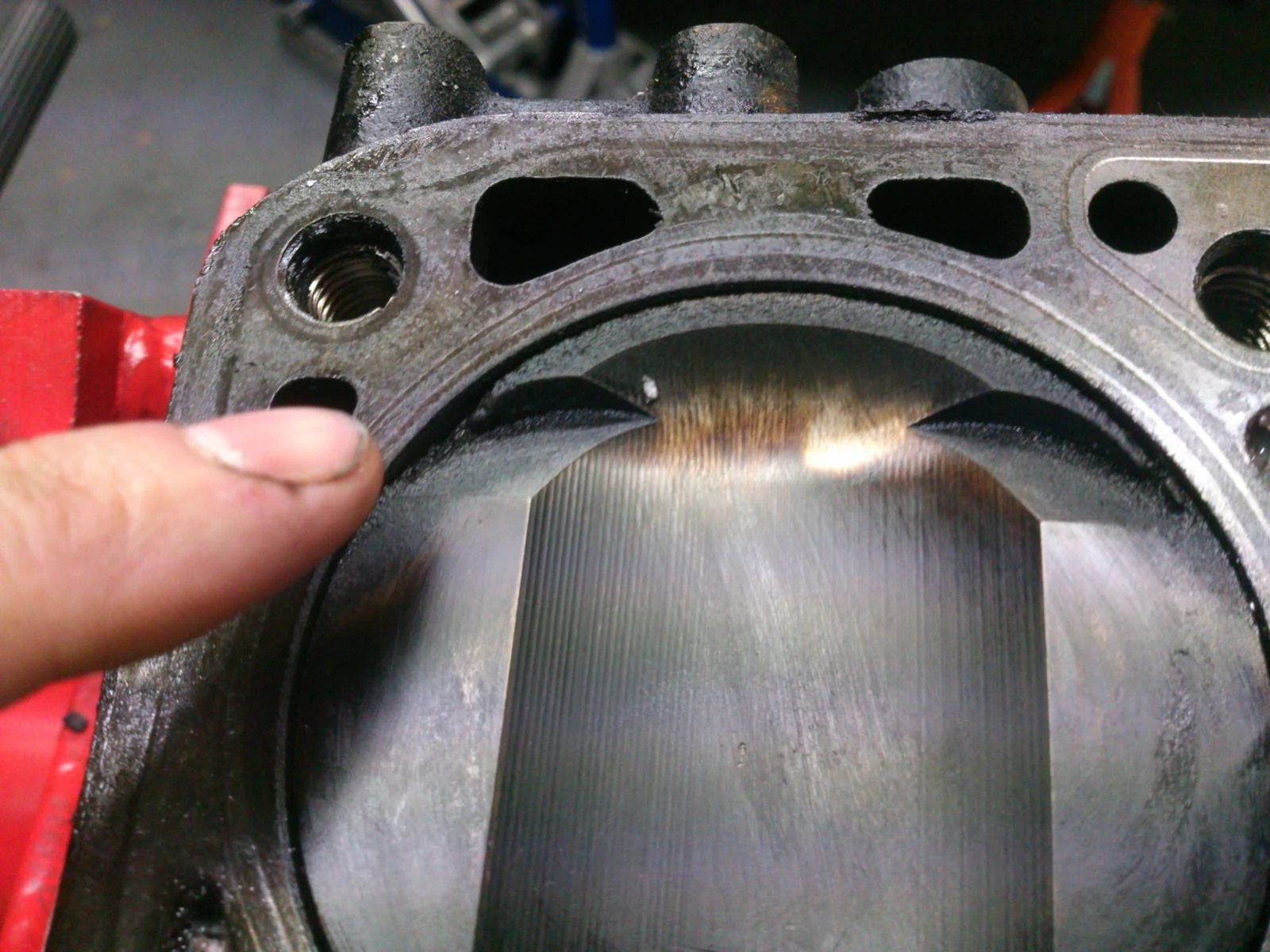

Fred follow the finger ;)
  Cup In bits
Wrong spy, further down.
Throwing white over it is easy to do all at once/cheaper and easier to touch/patch in when you bash it. Shows off sponsors good too.
Mine will go white when/if it gets some gravel/race petina.

Are there any ID letters on the head? Just out of curiosity for what it actually is more than anything. Should stamped into a machined surface somewhere usually the timing end cover gasket face.
Would imagine its a 1.8t 16v head of some variety.
