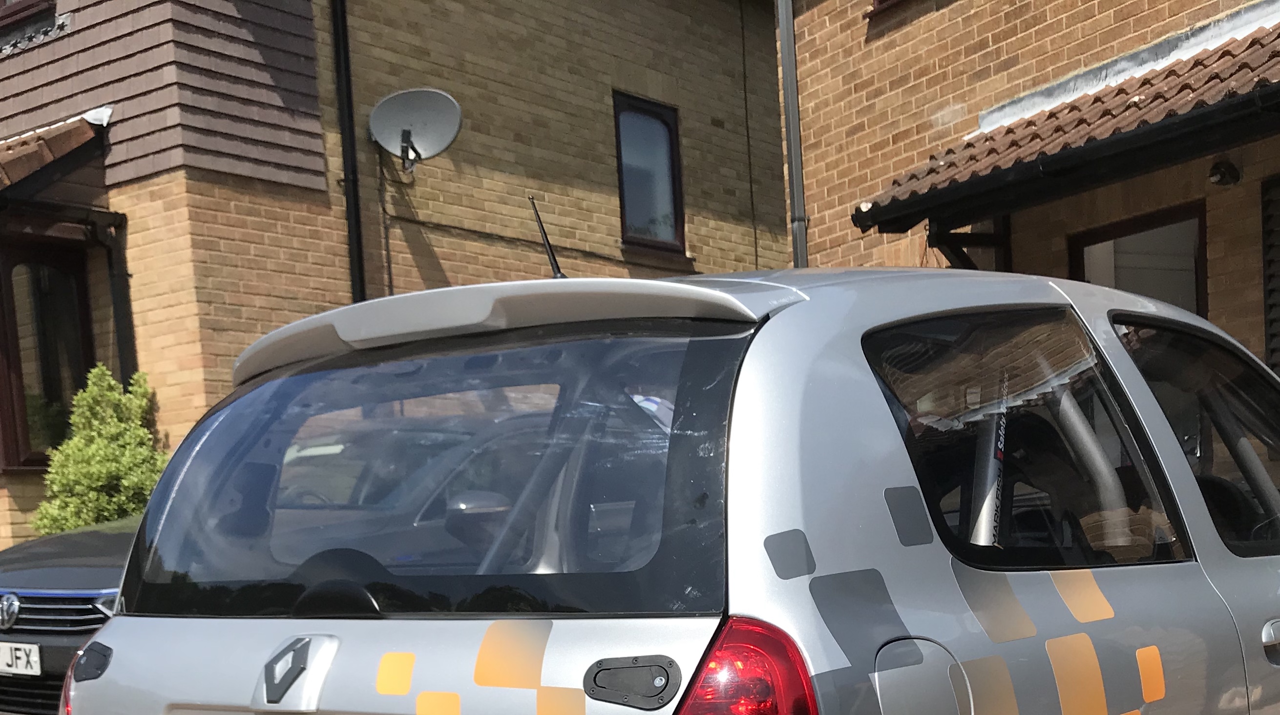

CMcomposites fibreglass replica. Problem goes away! ?
