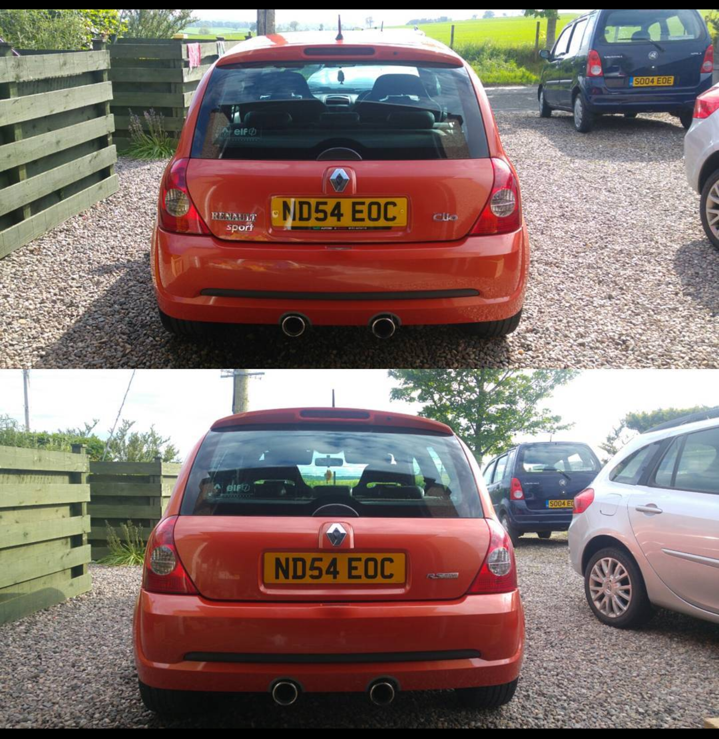

So previously i was a fairly active member on here with my build on one of my old 1.2s long story short, The car ended up getting scrapped after being rear ended at a roundabout, then I was given false details from the driver who crashed into me. Was pretty gutted but cars are replaceable.

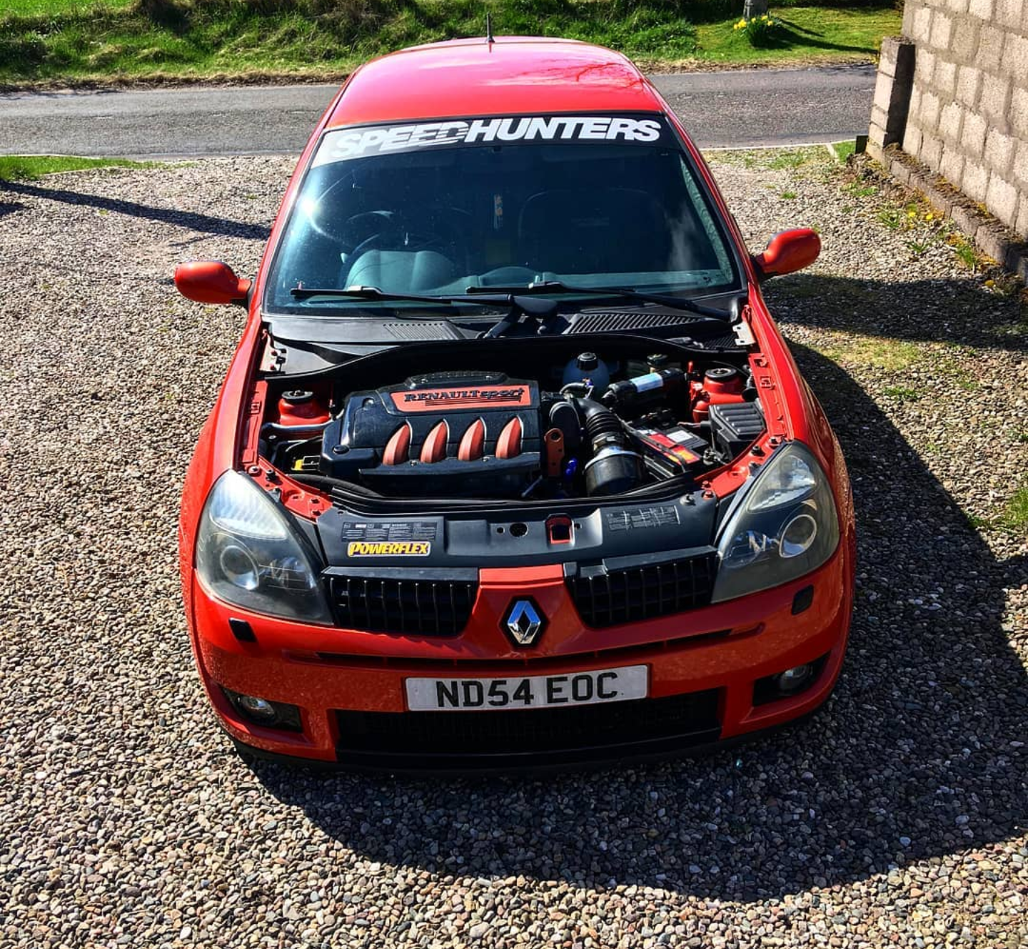

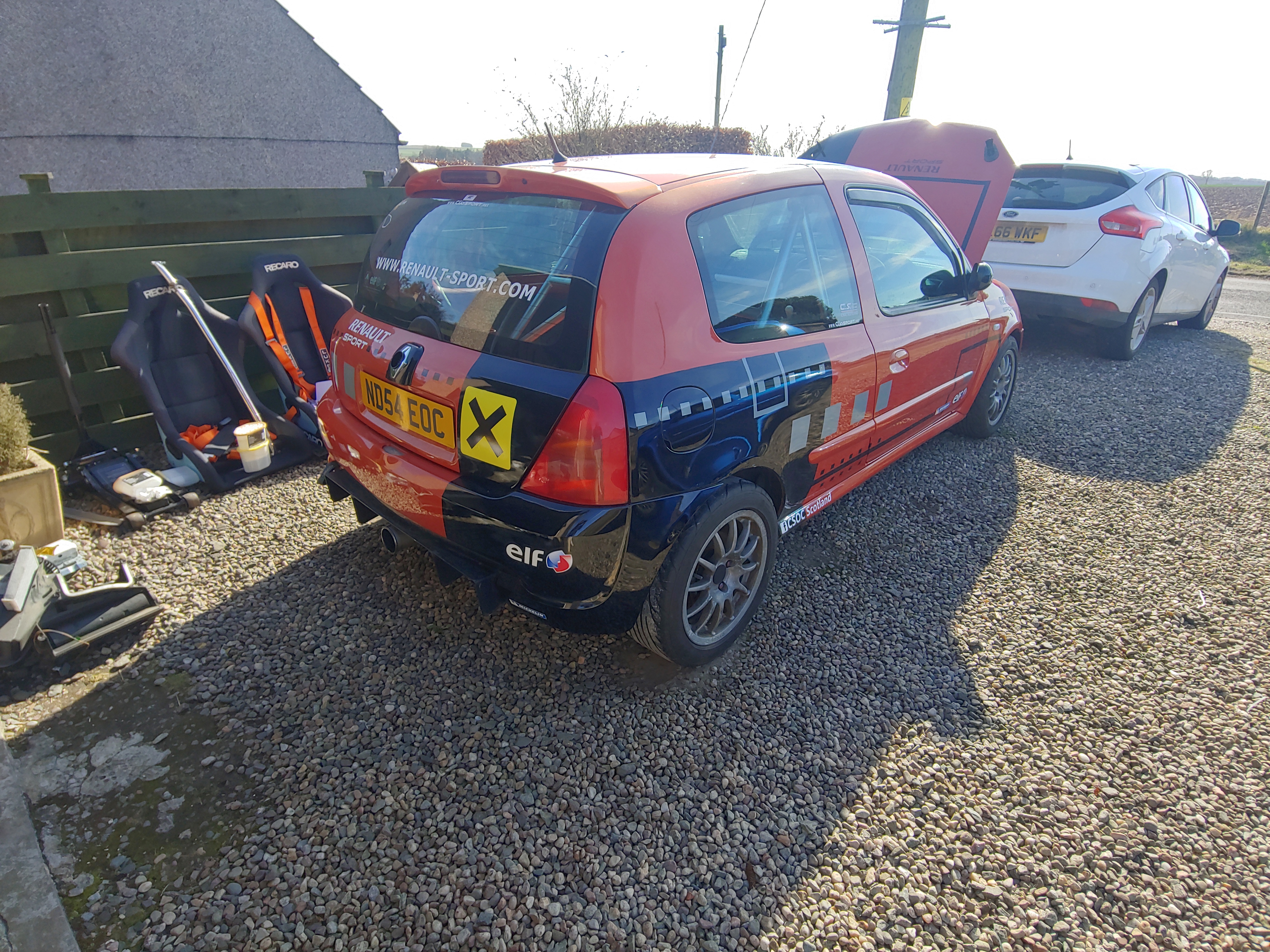

A couple of quick pics of the car in question then its replacement then onto the inferno the reason im making this thread.

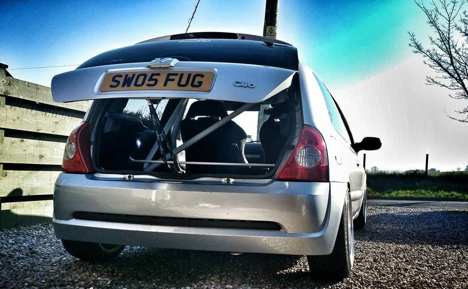

Once written off I had loads of spare 1.2 parts so ended up driving my, shall we say "clean" build

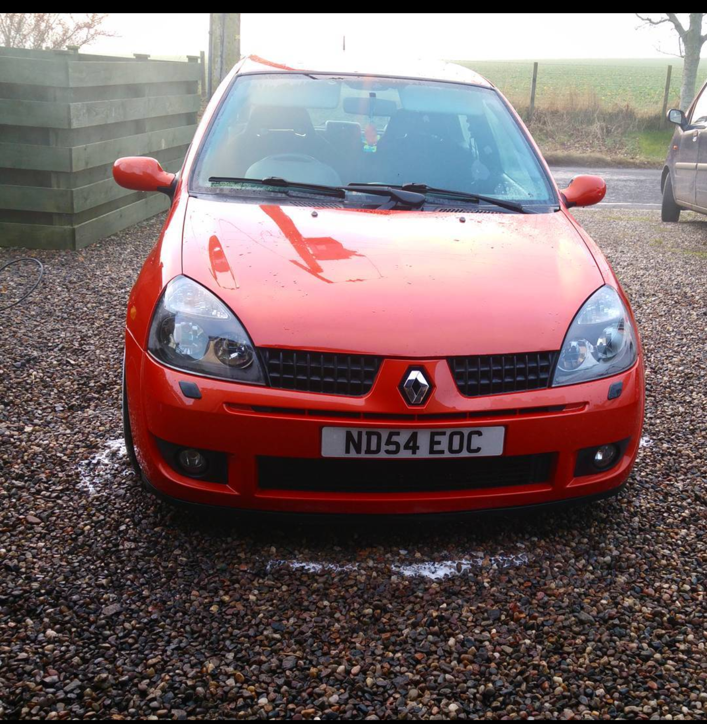

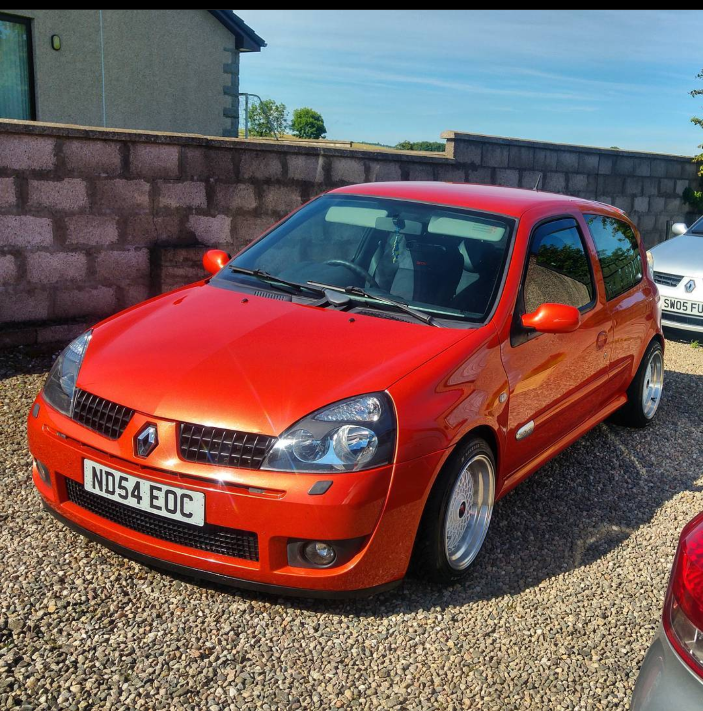

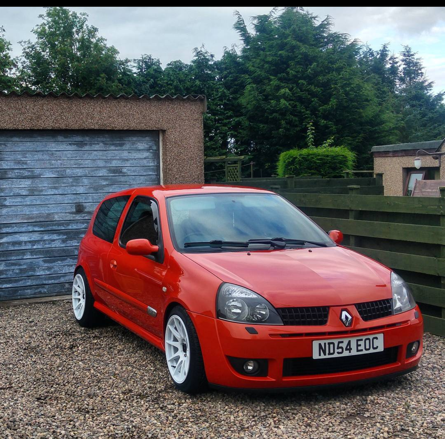

Was driving the silver car for a while untill i saved up for a good example of what i really wanted, a sport.

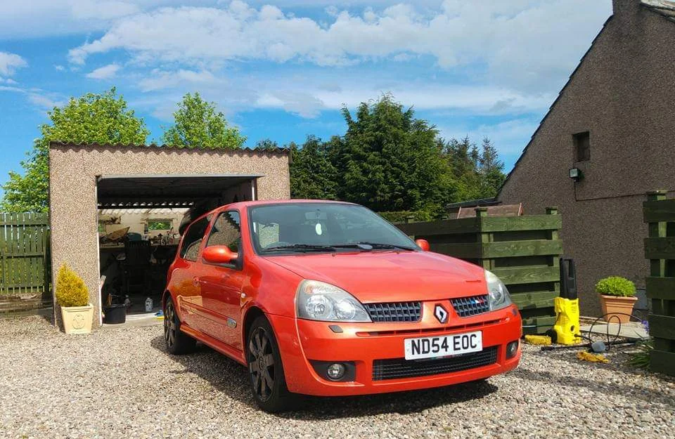

Eventually a nice low mile clean example of an inferno 182 cup appeared up for sale local to me, so I went to view and ended up coming home with it.

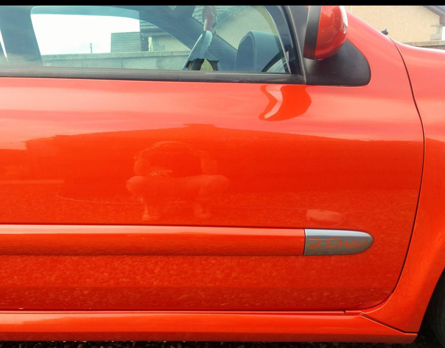

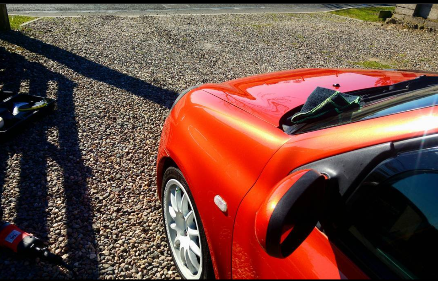

Instantly got the urge to get the polish and the d/a out and gave it a good once over.

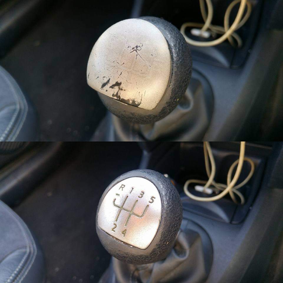

First to change was the gear stick insert due to it being totally worn

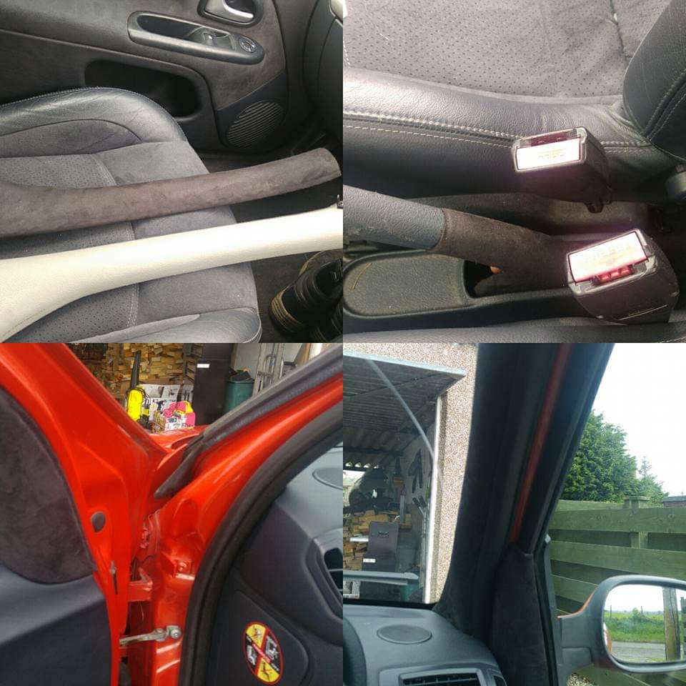

Now in the 1.2 I alcantara wrapped a good few interior trim pieces so swapped all them in too
Bought a matching footrest to go in aswell

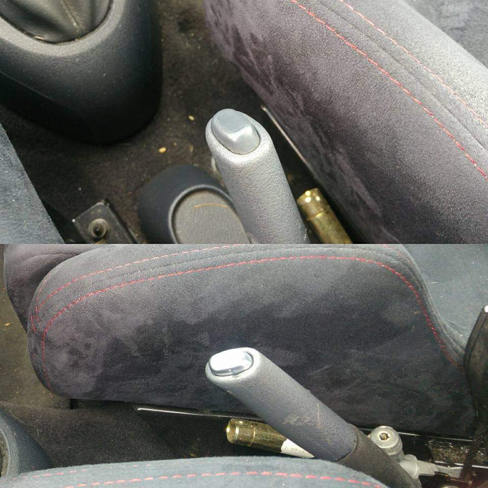

Also took the shinier handbrake button from the 1.2

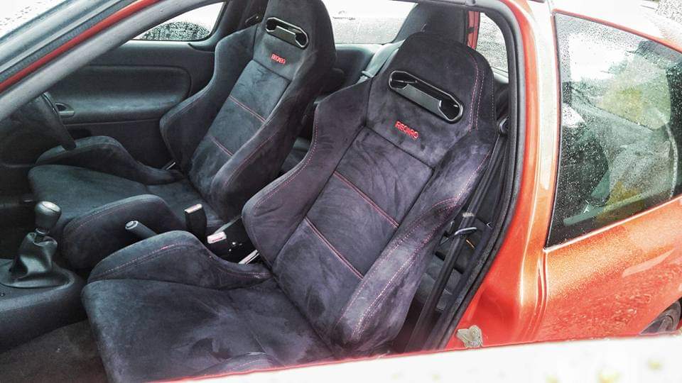

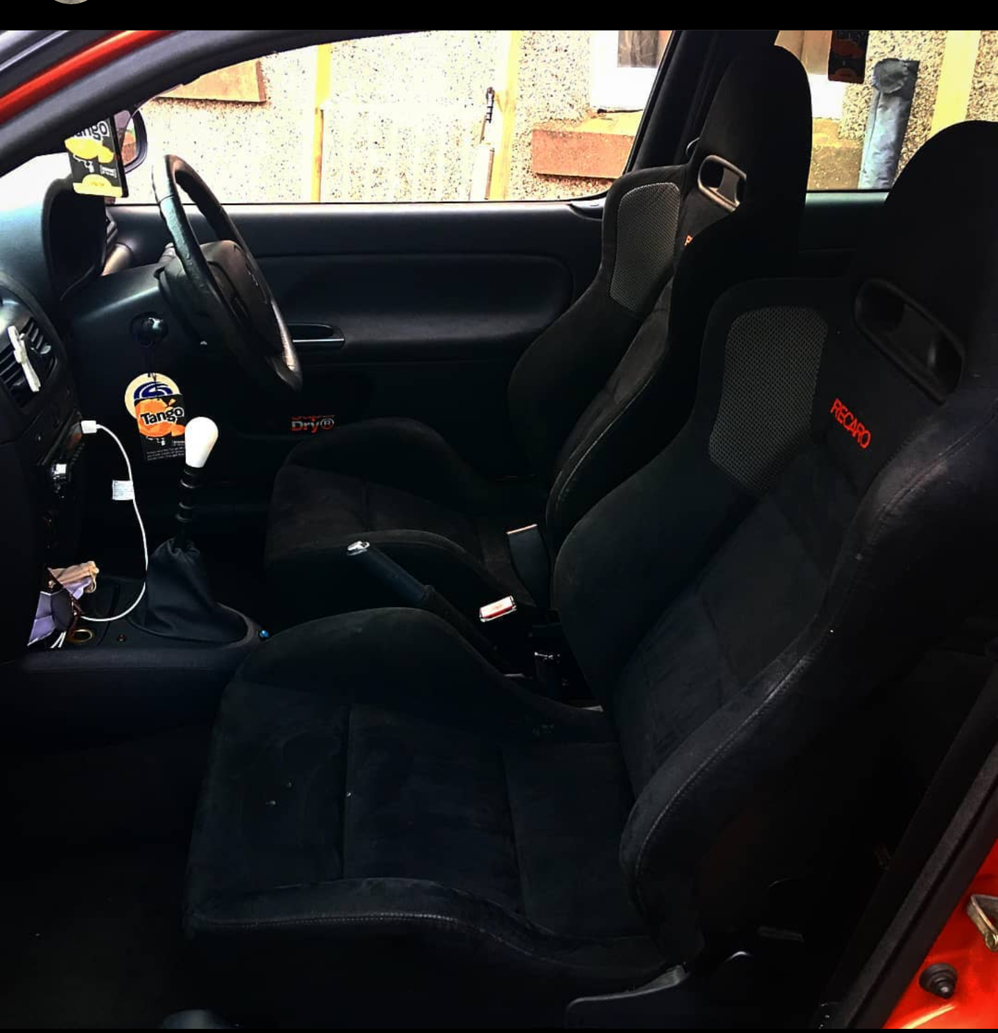

And the main thing i couldnt wait to fit from the 1.2. A pair of dc2 recaros 👌

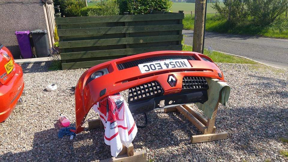

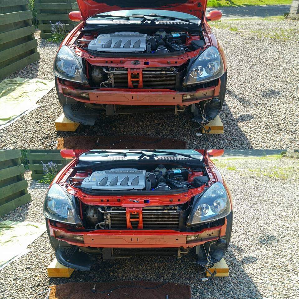

Cleaned the bay and noticed some dirt under the grill etc so whipped the bunper off and clean all the slam panel and the support bracket and since the bumper was off i thought may as well spray the grills as well

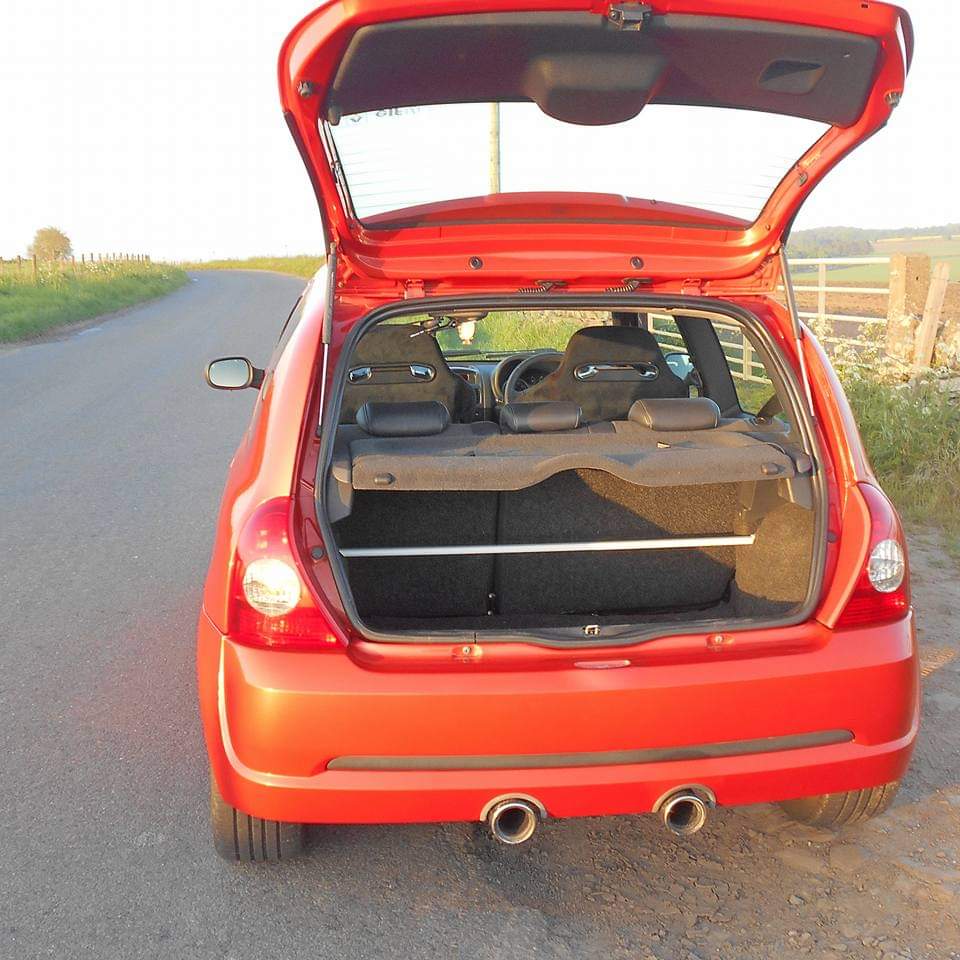

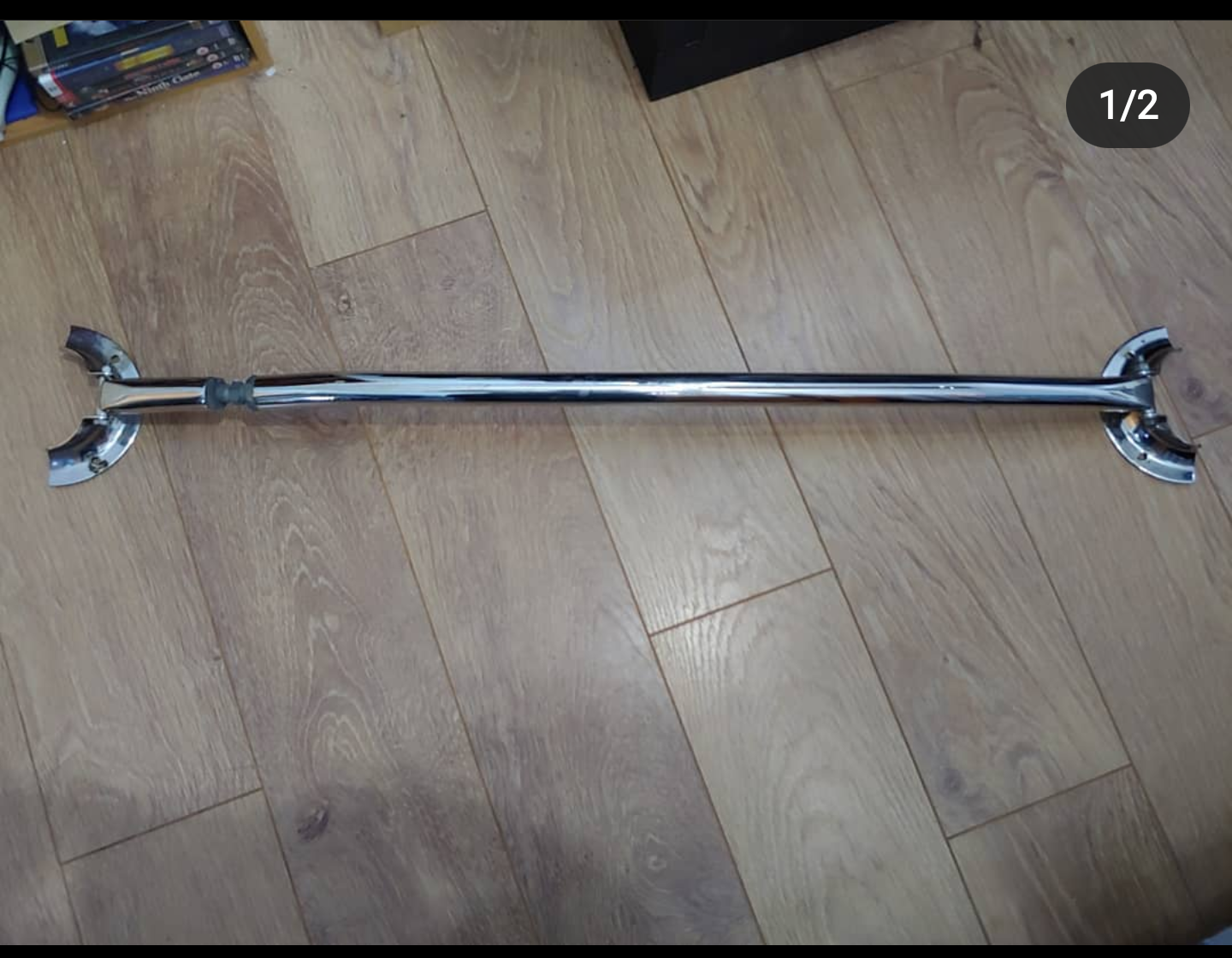

So onto a few more mods to come were the addition. Of the rear brace from the old car

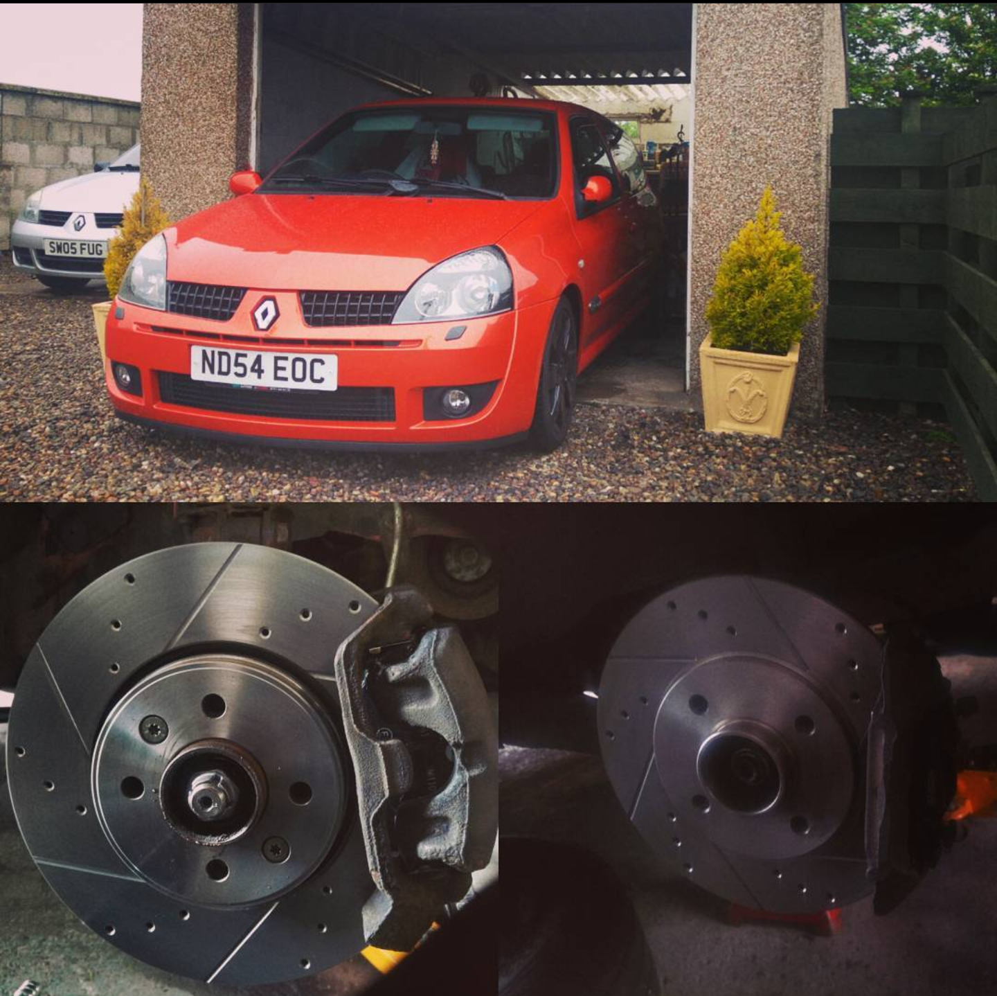

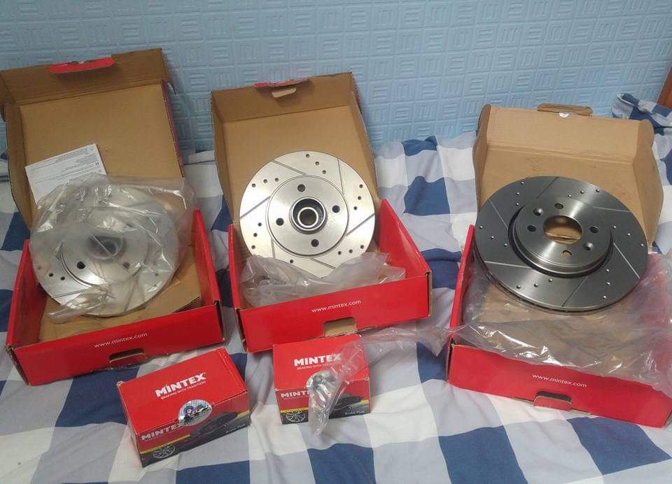

Then a delivery came in the post. A new set of drilled and grooved brakes and new pads. So got the car backed into the garage and got them fitted

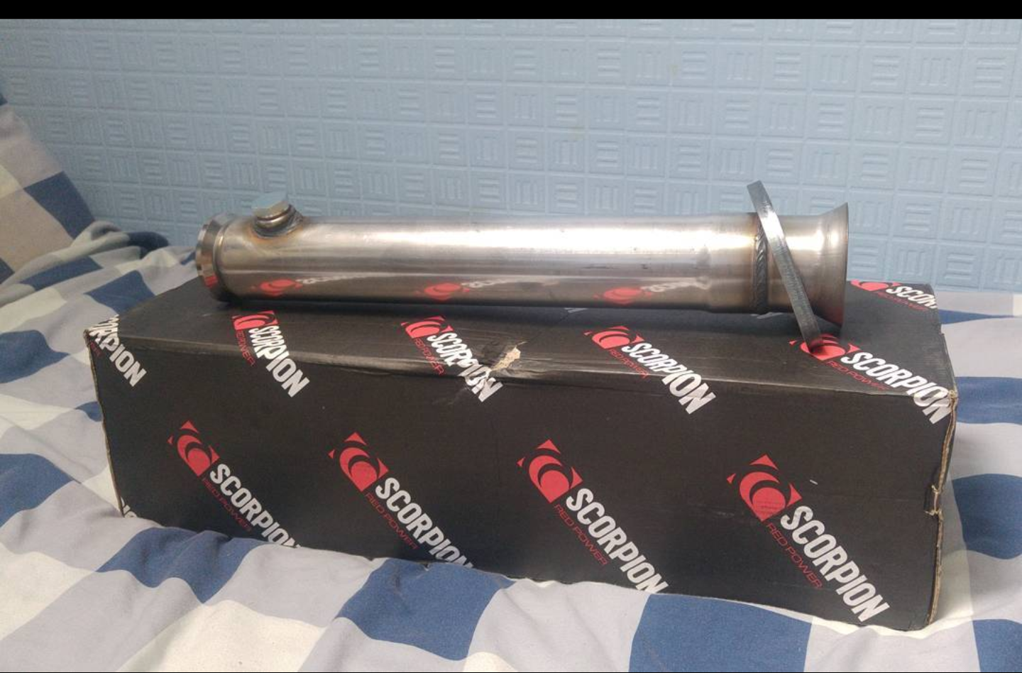

A scorpion decat pipe
Id attatch a video of how it sounded but the car has had different systems from this one.

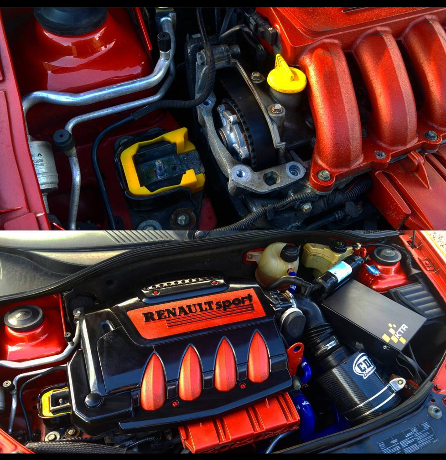

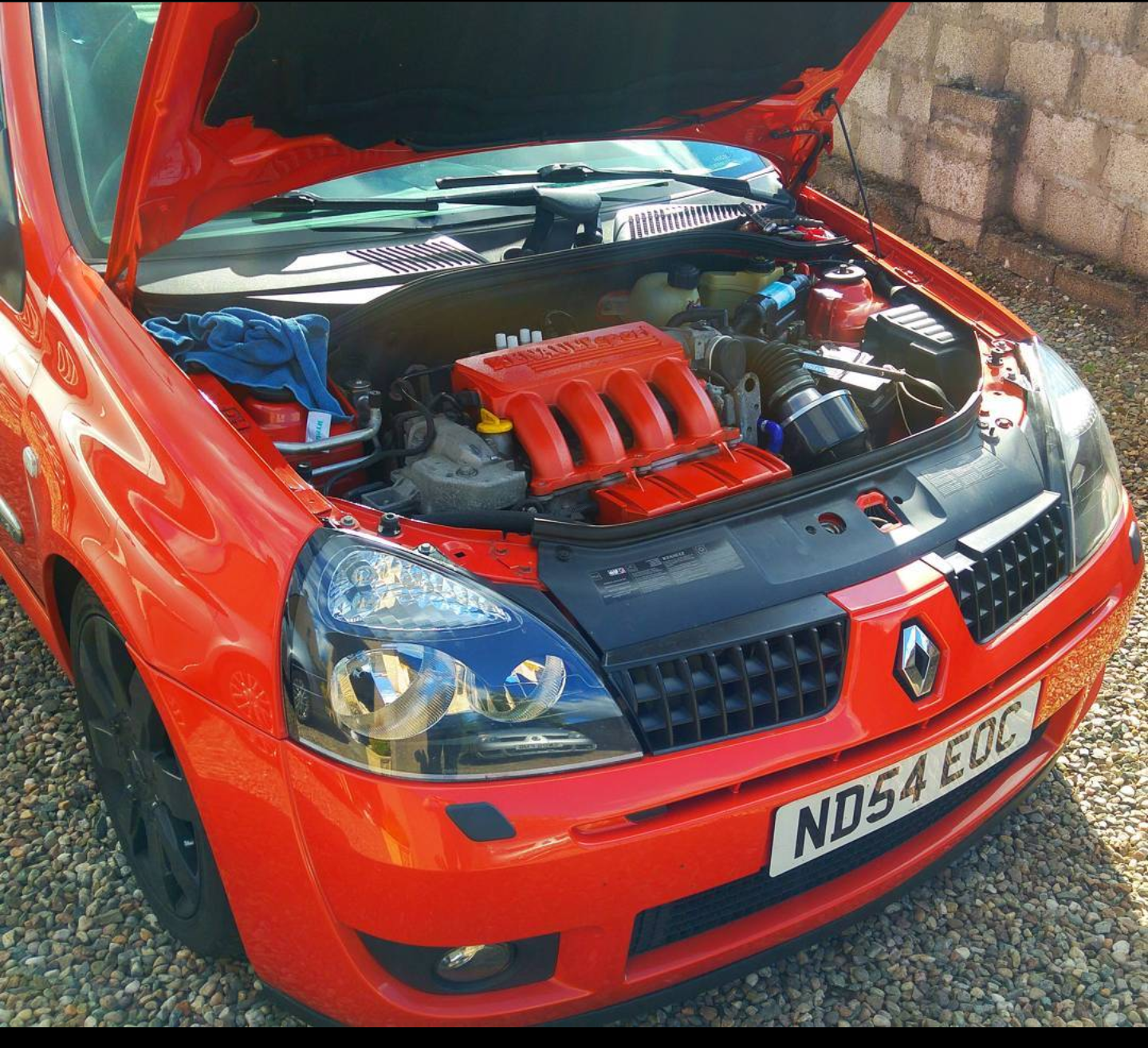

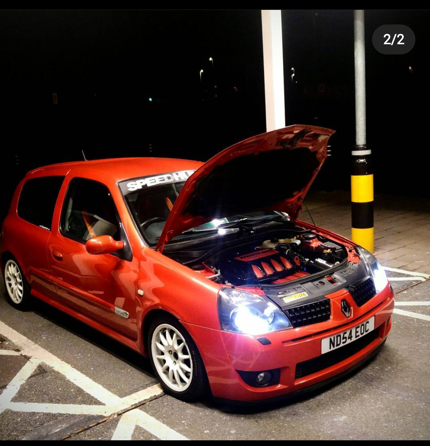

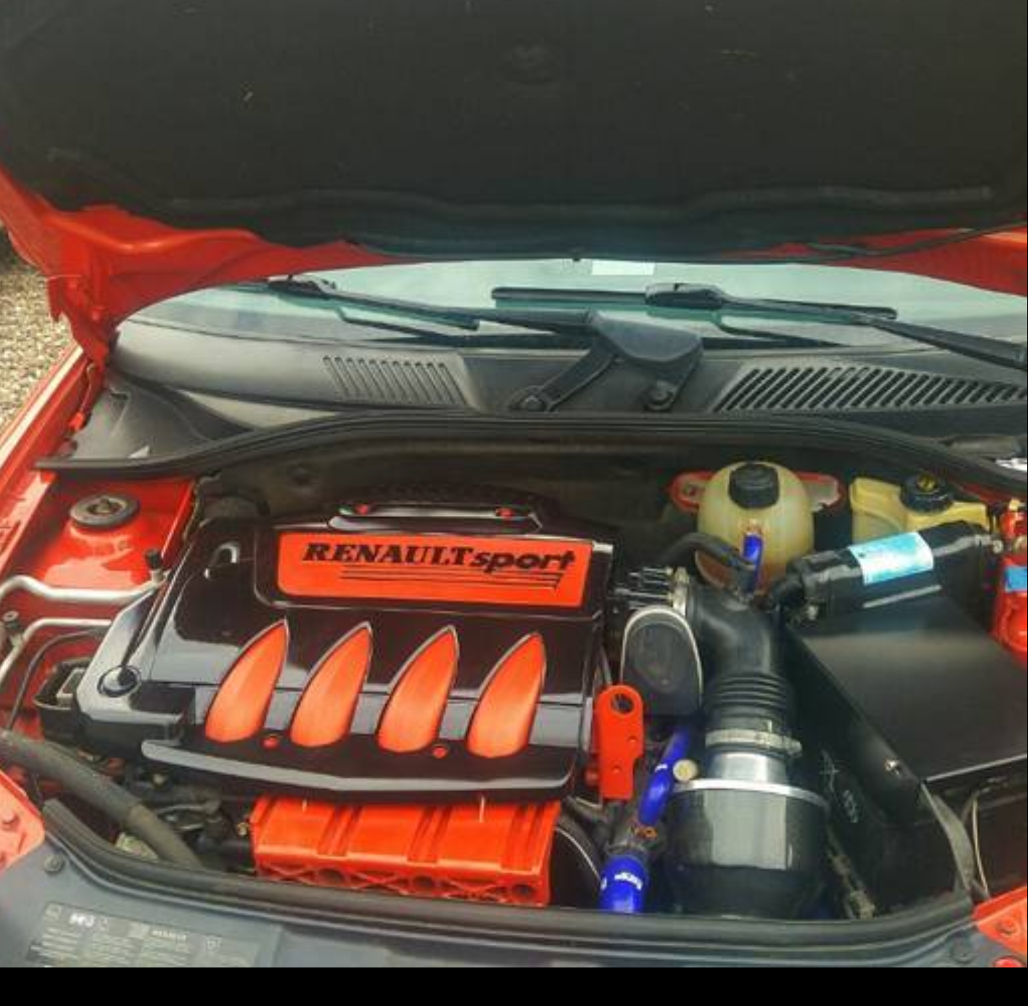

Now the engine bay looked a bit too plain and seen some photos on here of others so decided to give it a go on mine.

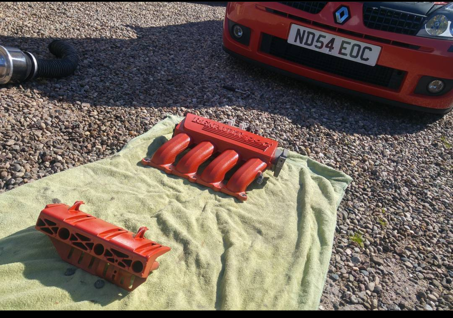

Sprayed the inlet and fuel rail cover inferno

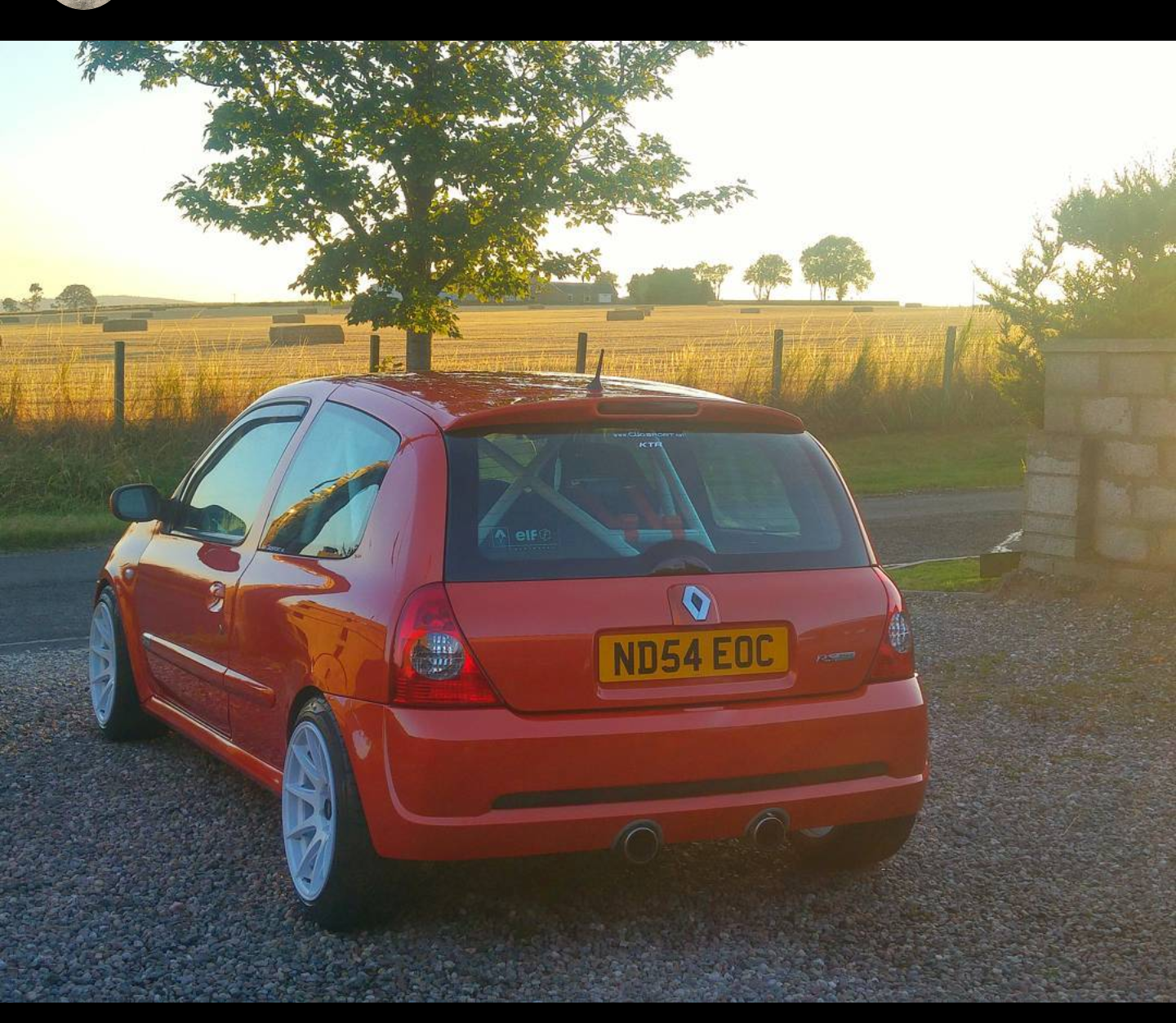

The tyres came for the new wheels so got them mounted and the new wheels were fitted. White really contrasted with the orange!

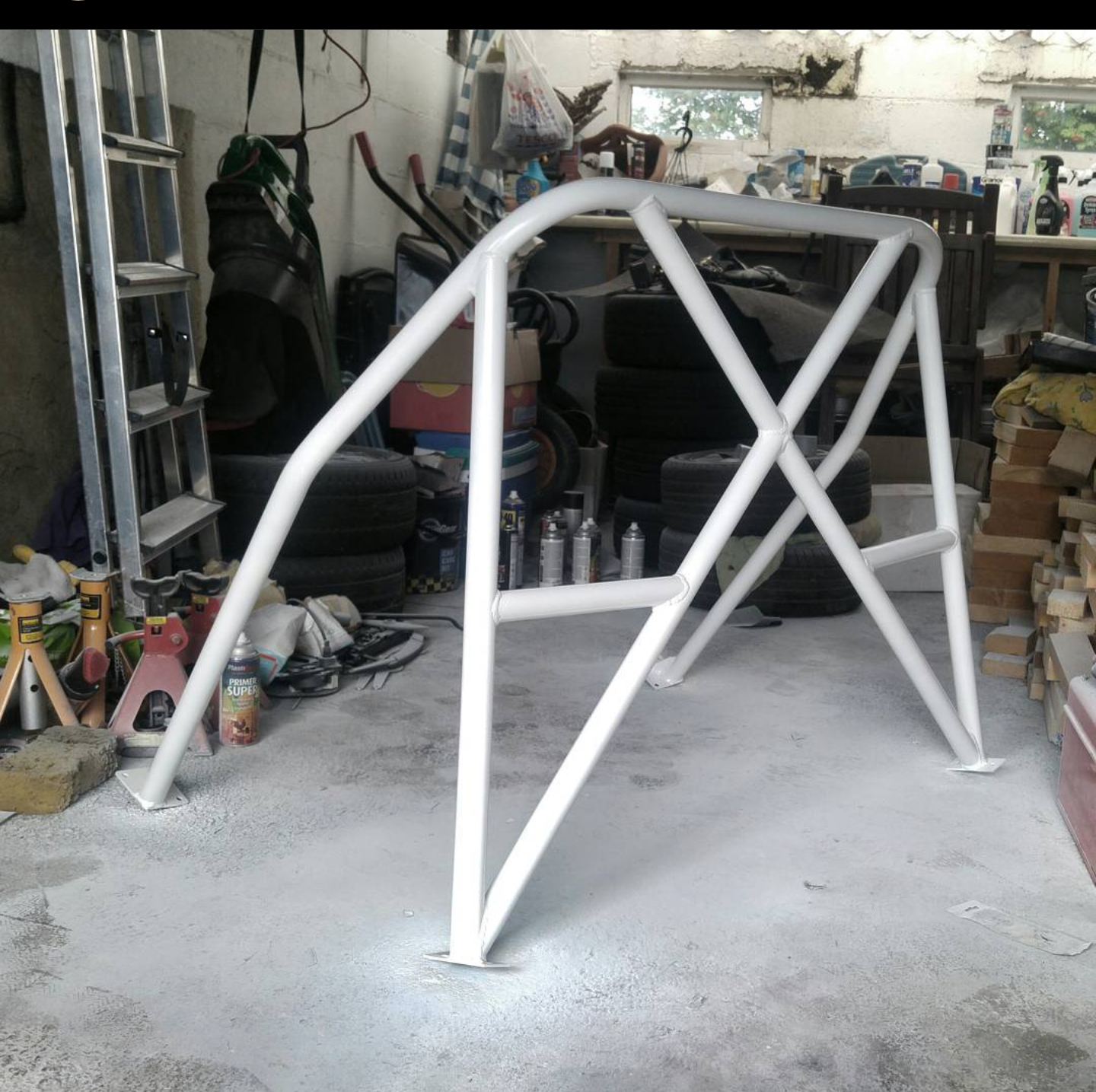

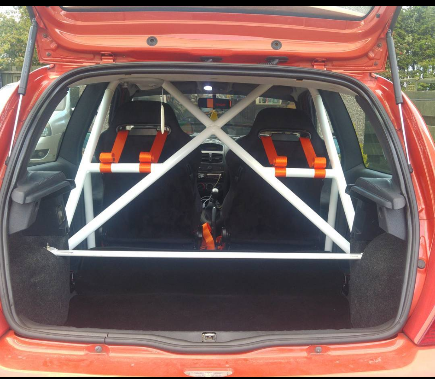

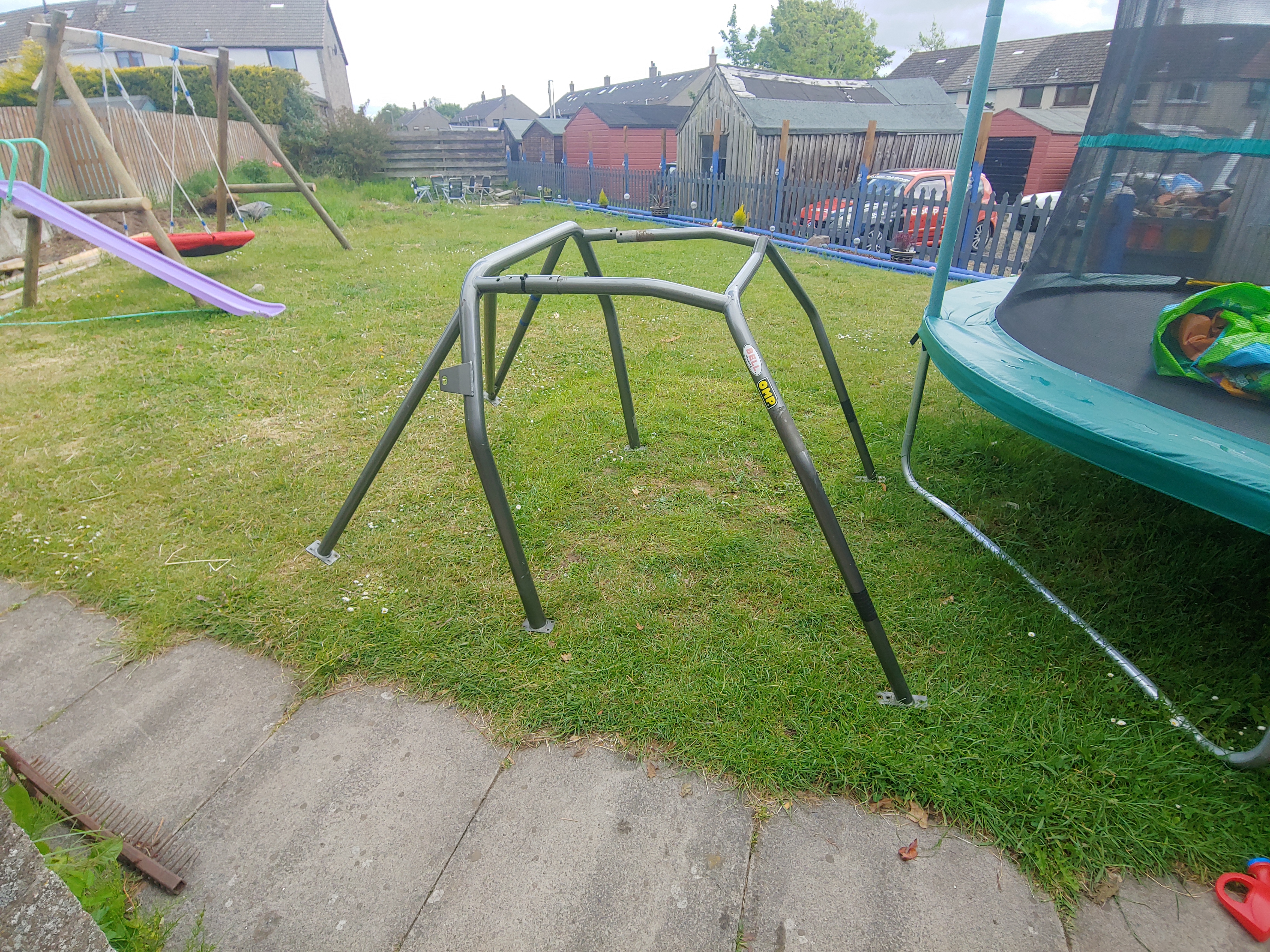

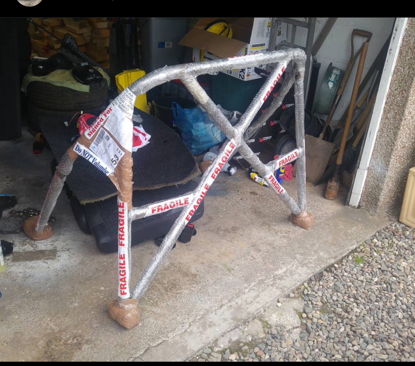

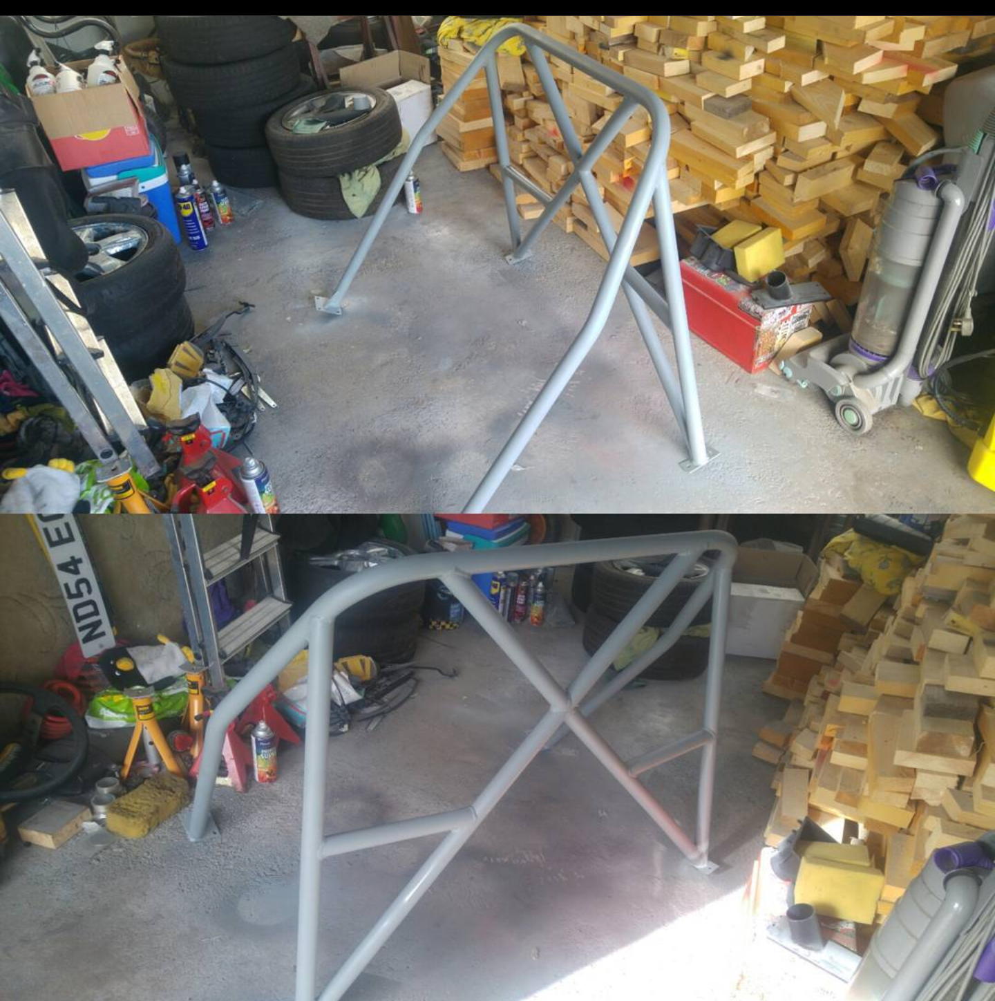

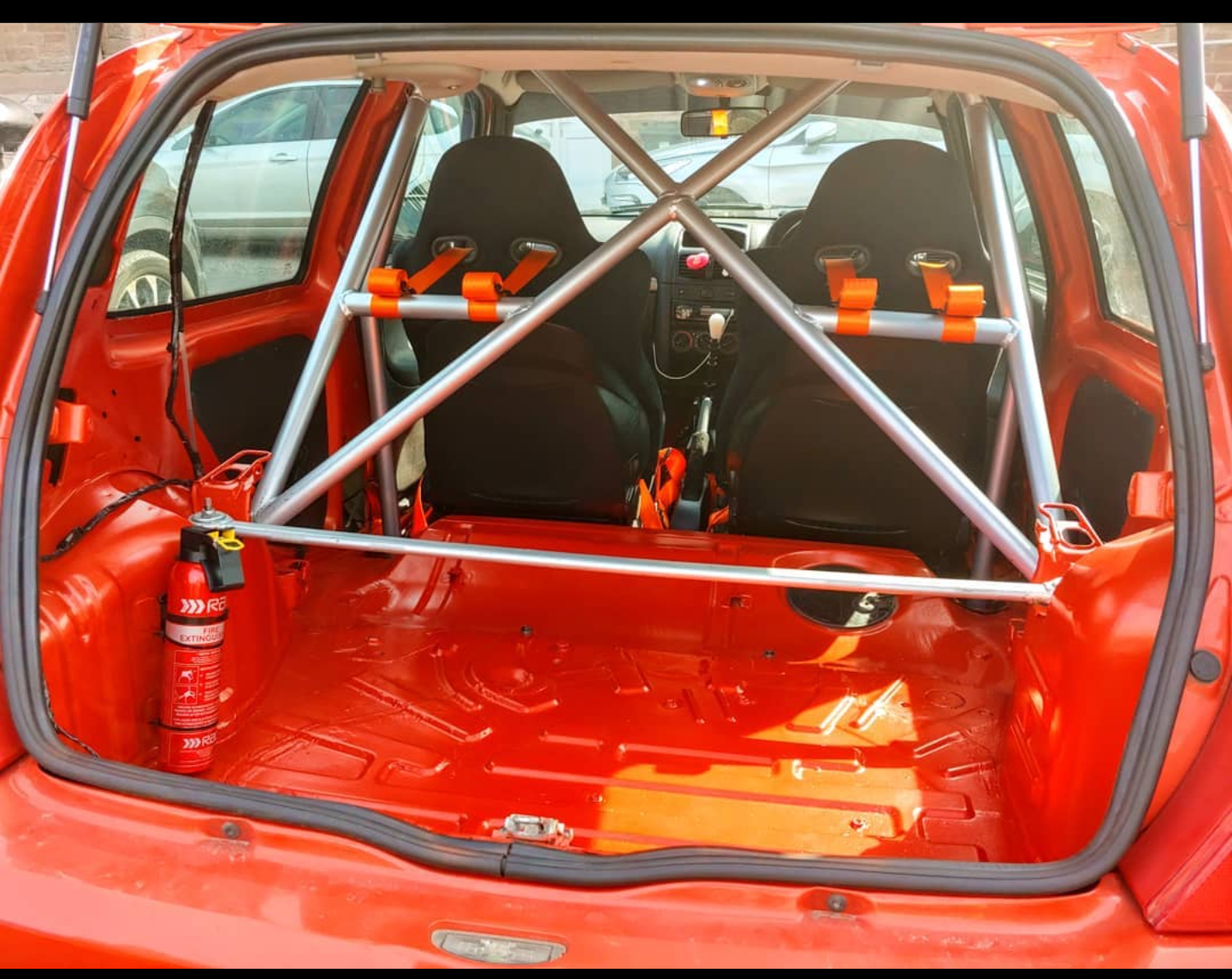

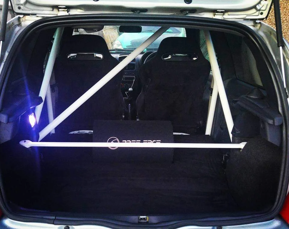

Now iv always been a fan of a roll cage so that was next to be bought, painted and fitted along with some orange luke 4 point harnesses
Here's how its looking now with the addition of a subtle sunstrip

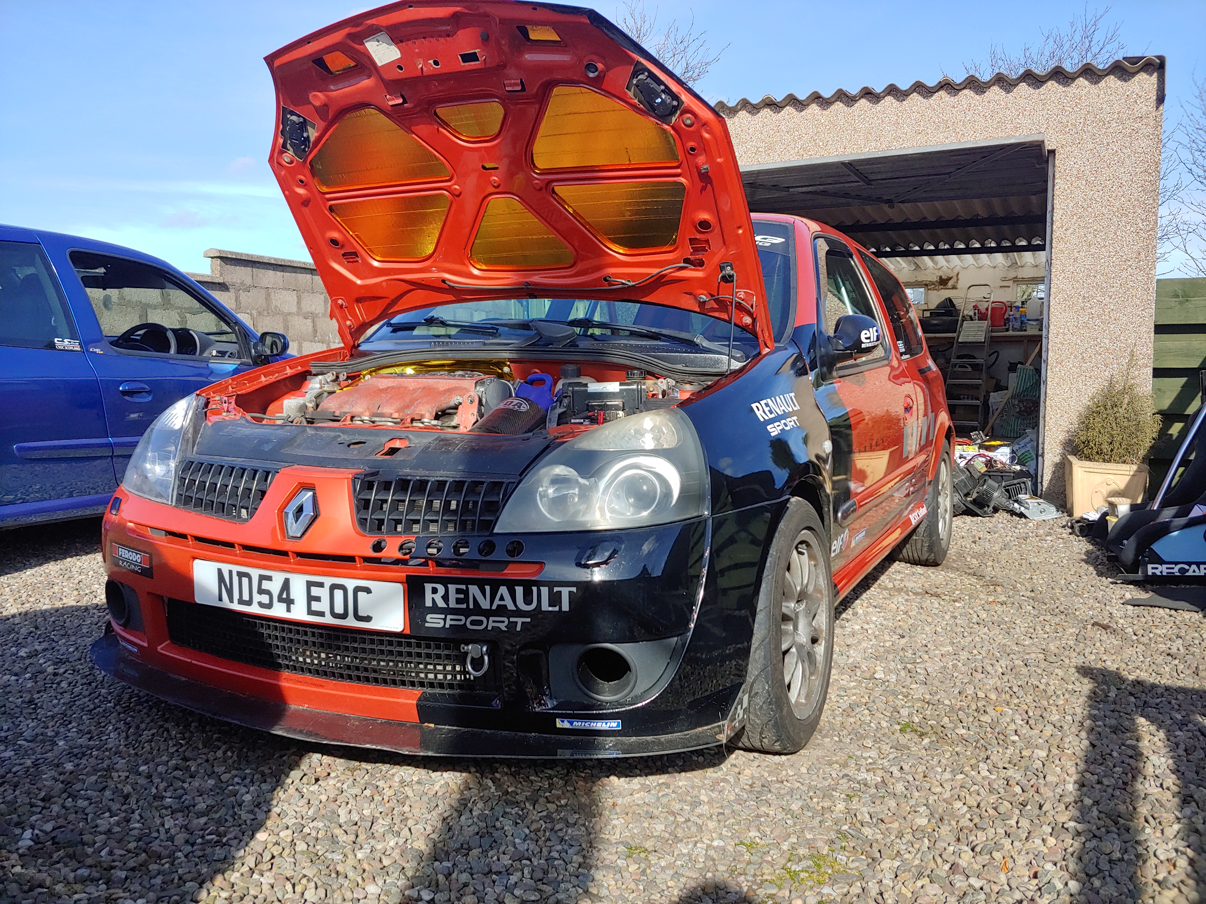

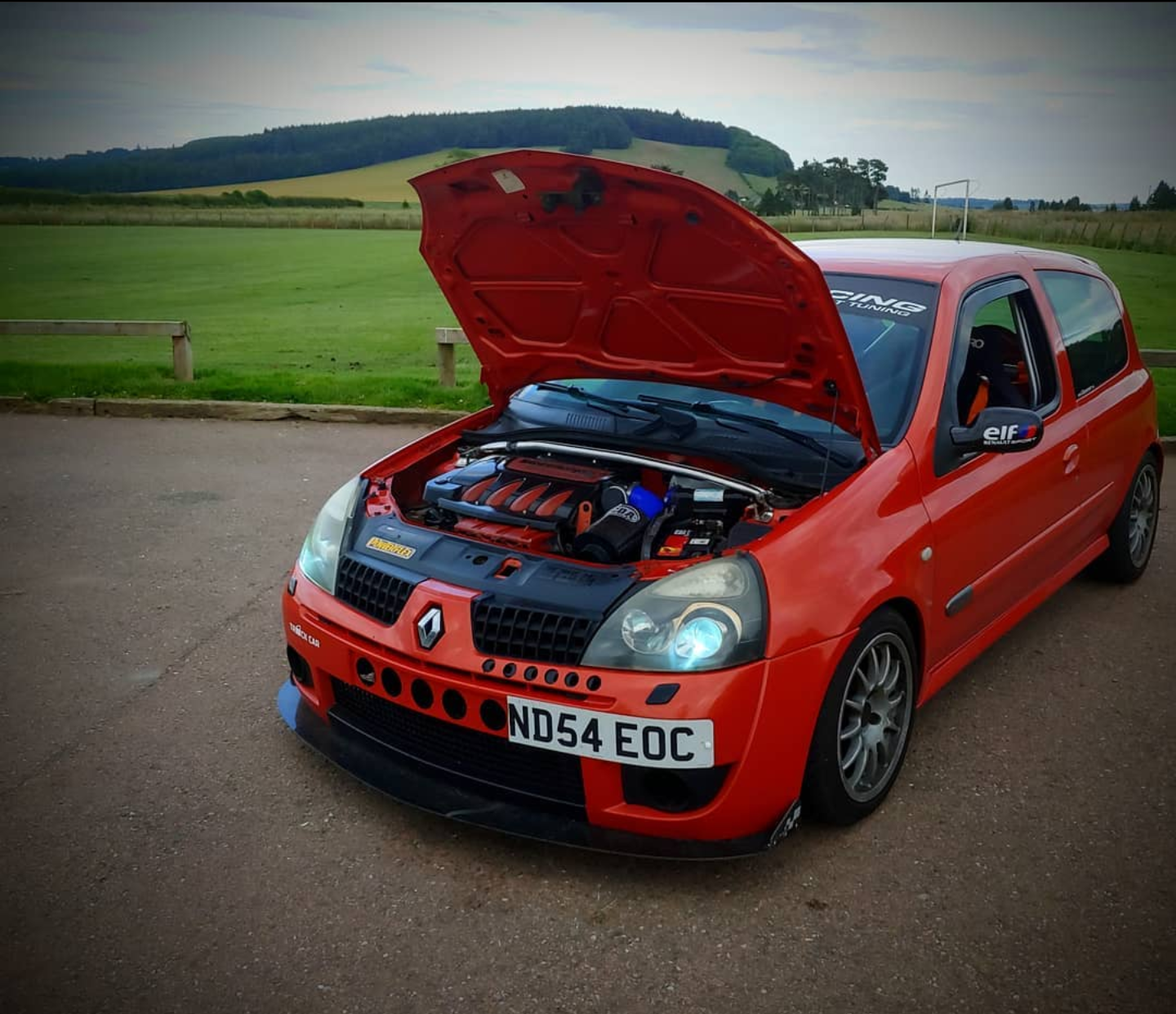

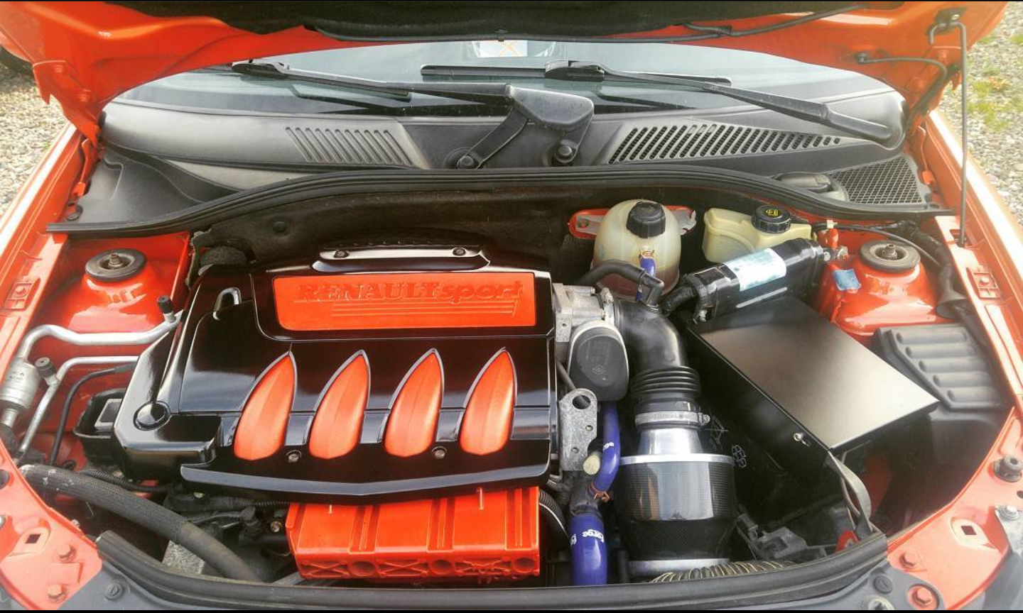

Thought id get round to finishing the engine bay off painted the engine cover black along with the throttle body and the renault sport lettering and addwd a nice little battery cover.
Then car got another wash and off for a picture

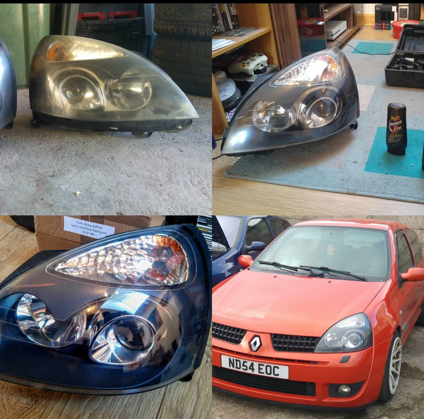

Then sourced myself a nice set of black insert xenons. Lenses were fogged up like but i soon sorted them with a light sand and maxhine polish etc.

Back to the engine bay and i fitted a piwerflex mount and a bmc cda induction kit.

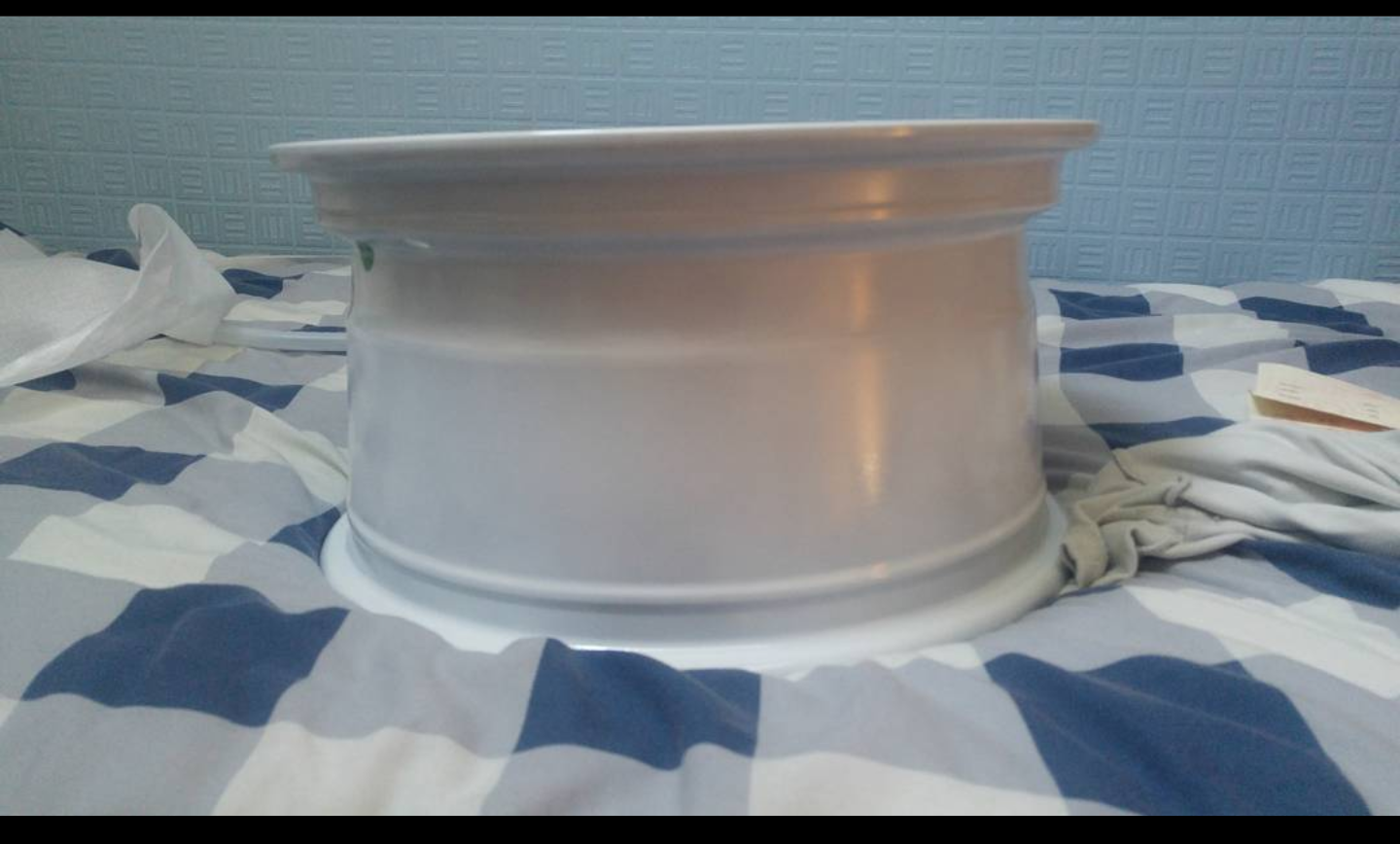

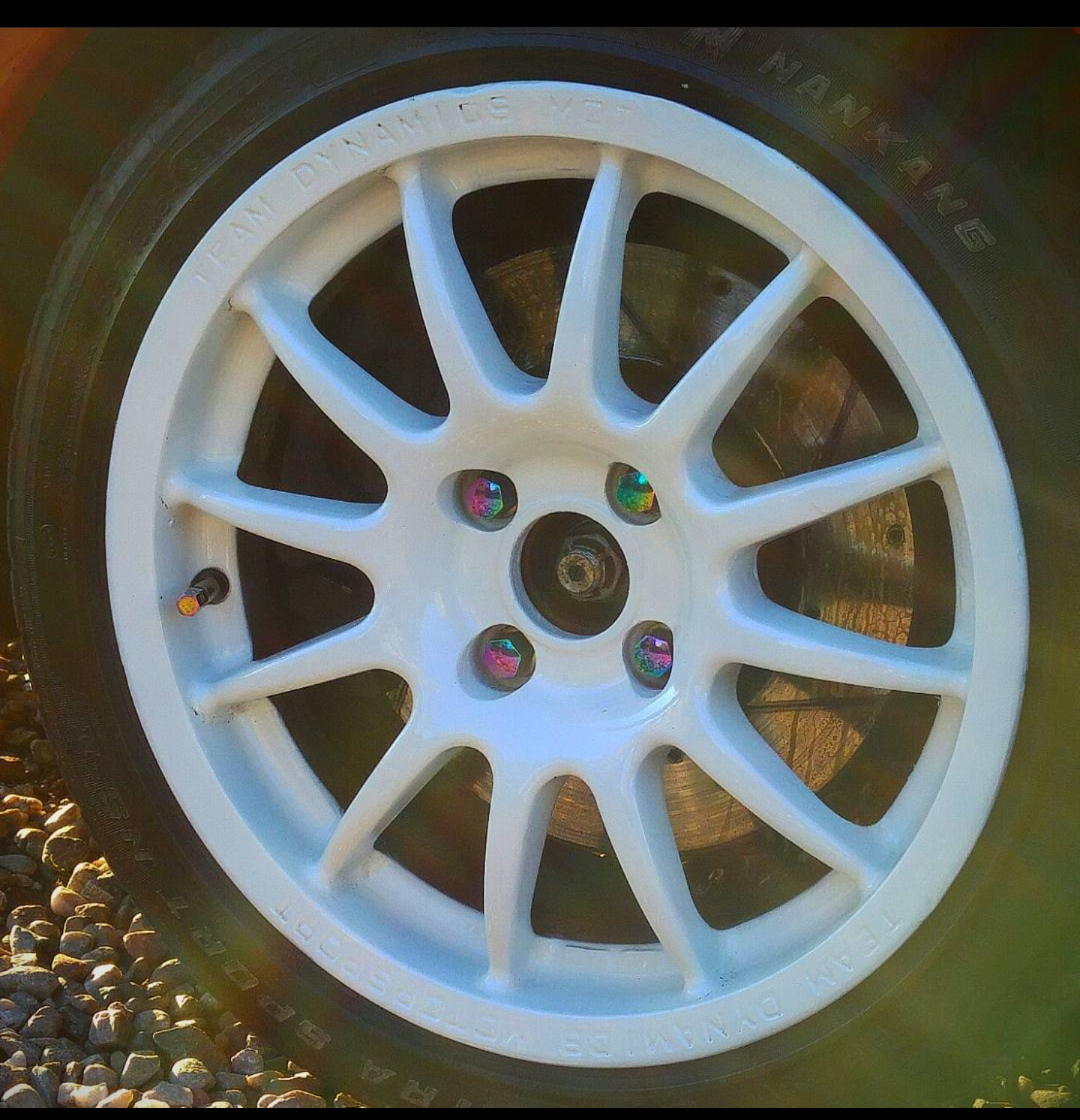

Then i was beginning to think the Japan racing wheels were a bit on the wide side and opted for a set of team dynamics pro race 1.2s that i got for an absolute steal.
Fancy wheel nuts and a lick of white paint

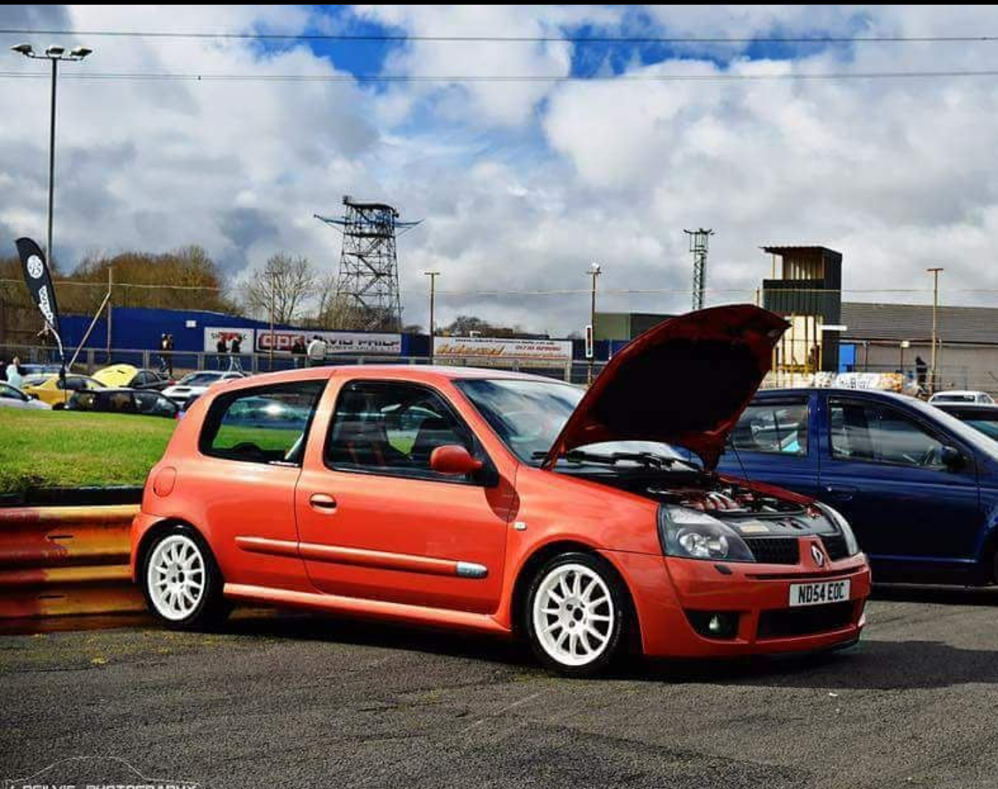

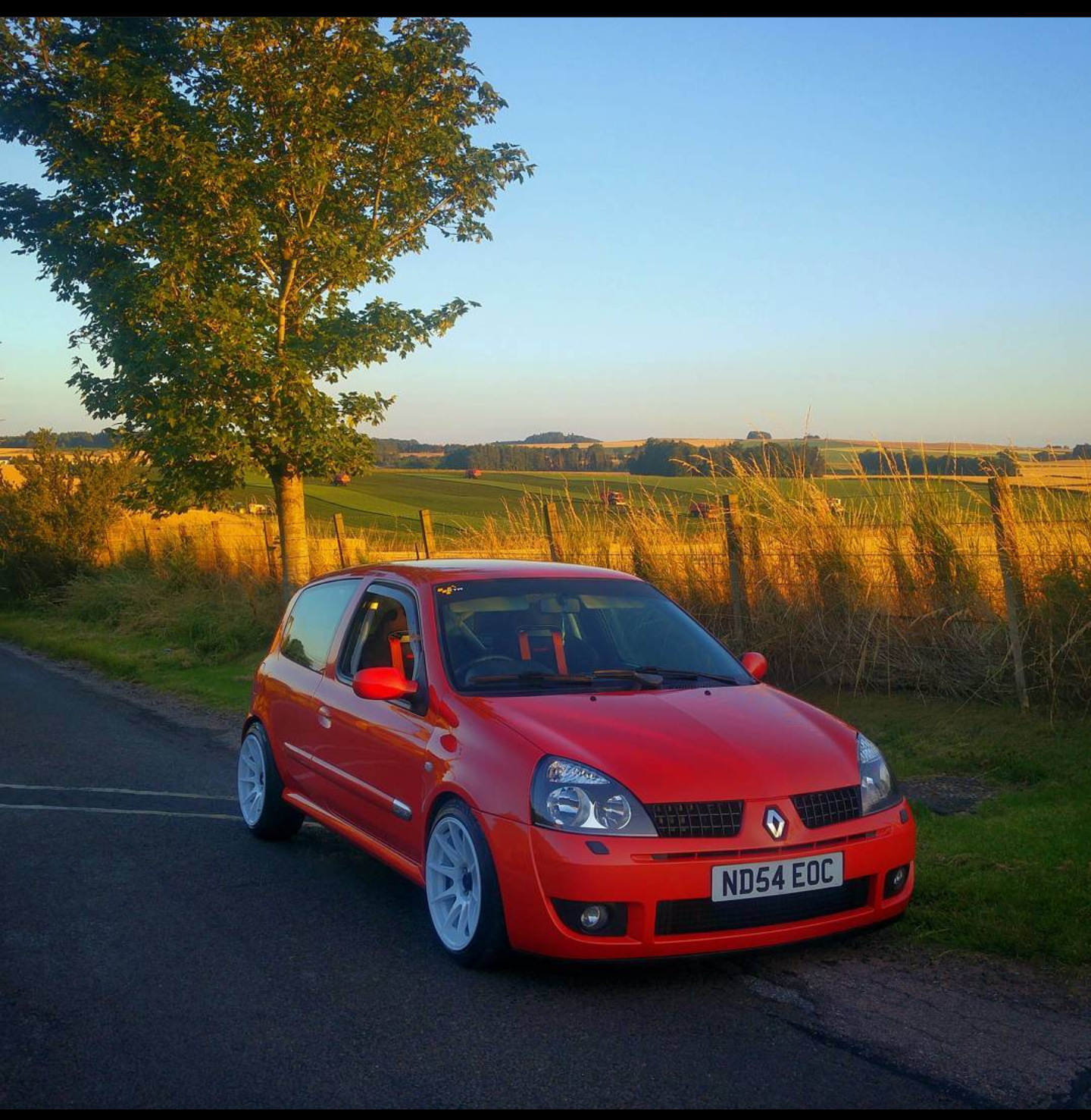

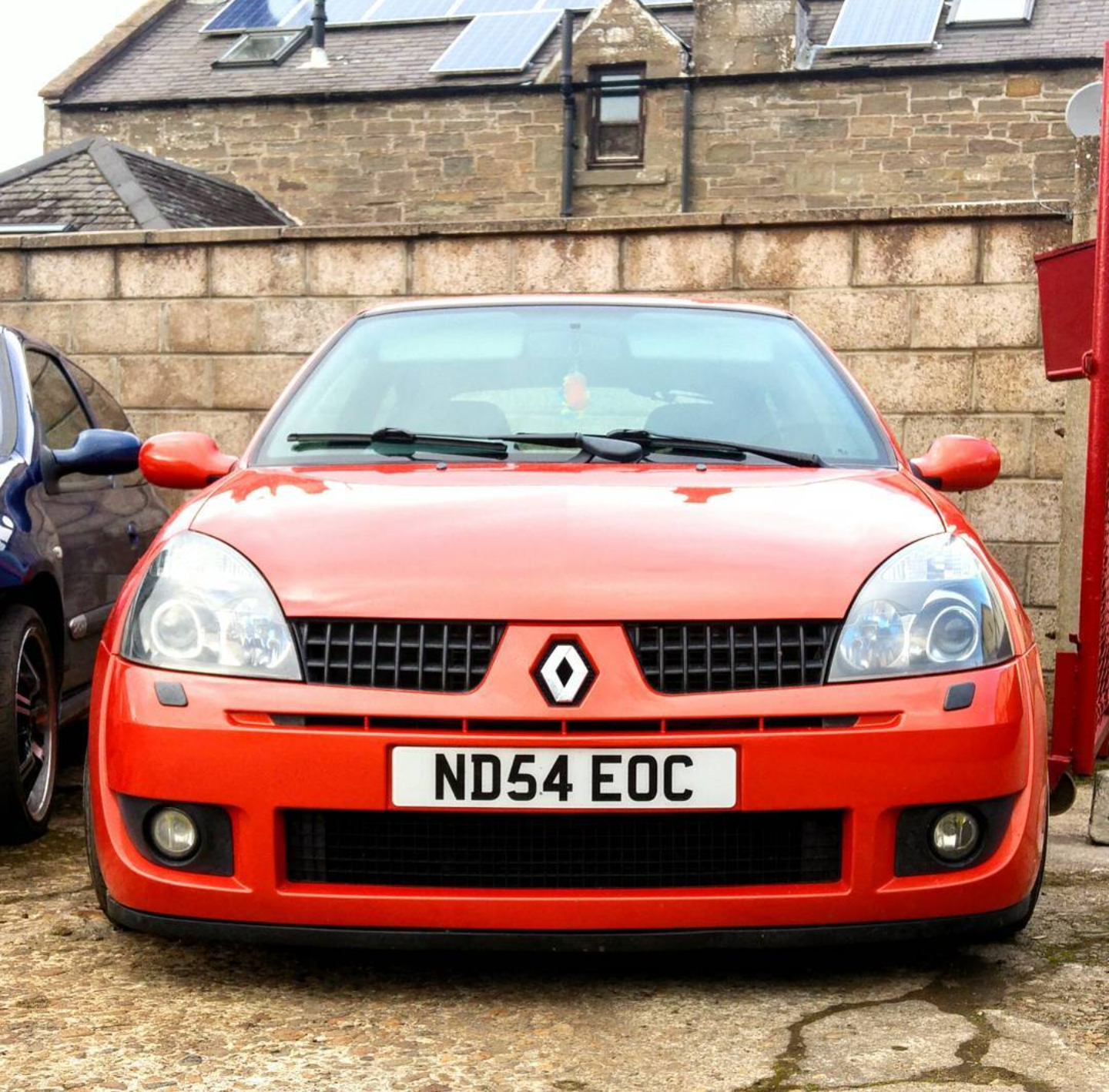

Back for another polish and to date my favourite picture of the inferno paint 😍

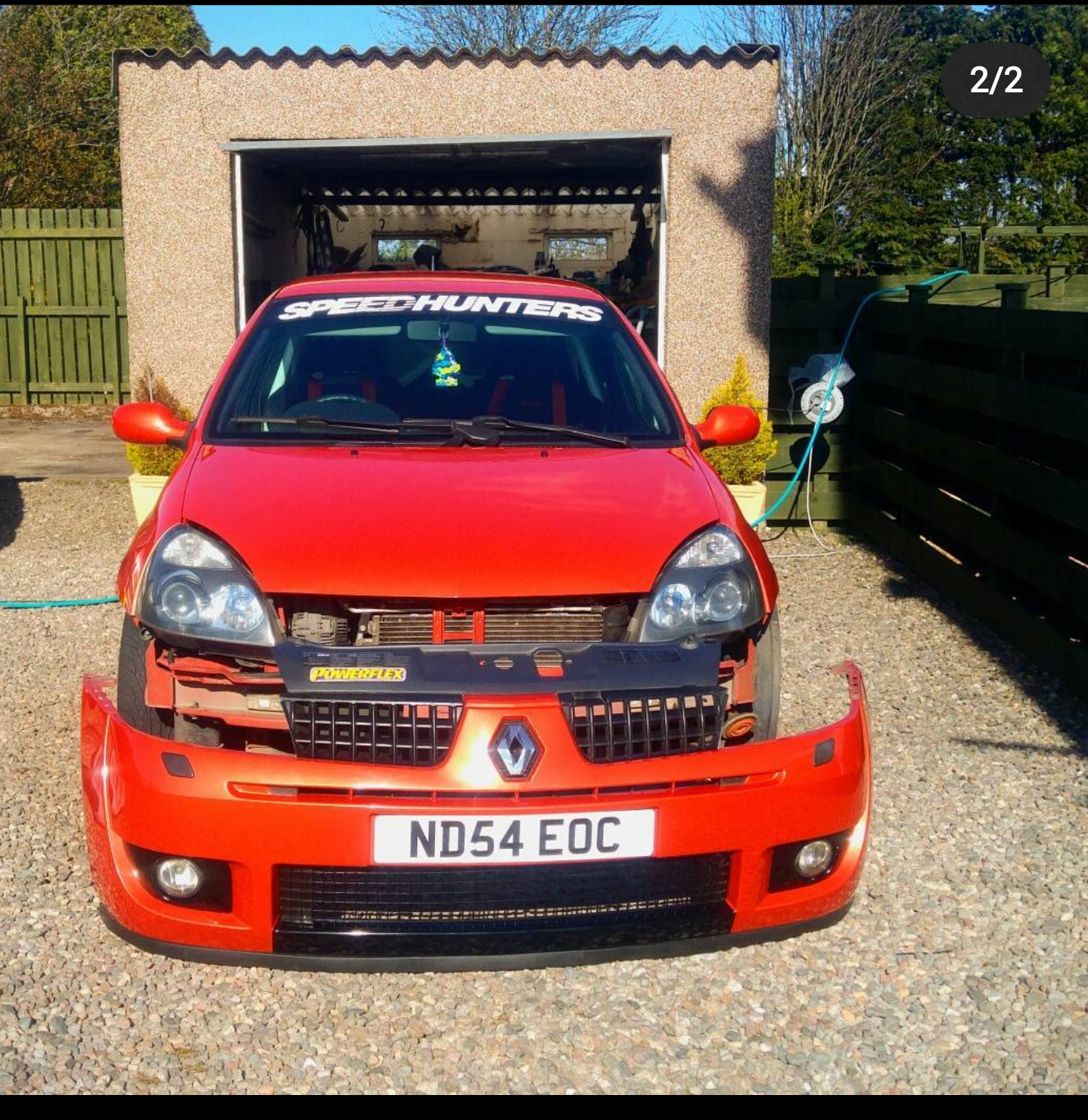

Now i had kept seeing the bit below the lower grill either wrapped or painted black so decided to jump on the trend. Also wrapped the foglight surrounds and the washer jet blanks
Then these popped up on ebay and couldnt say no really 🙊

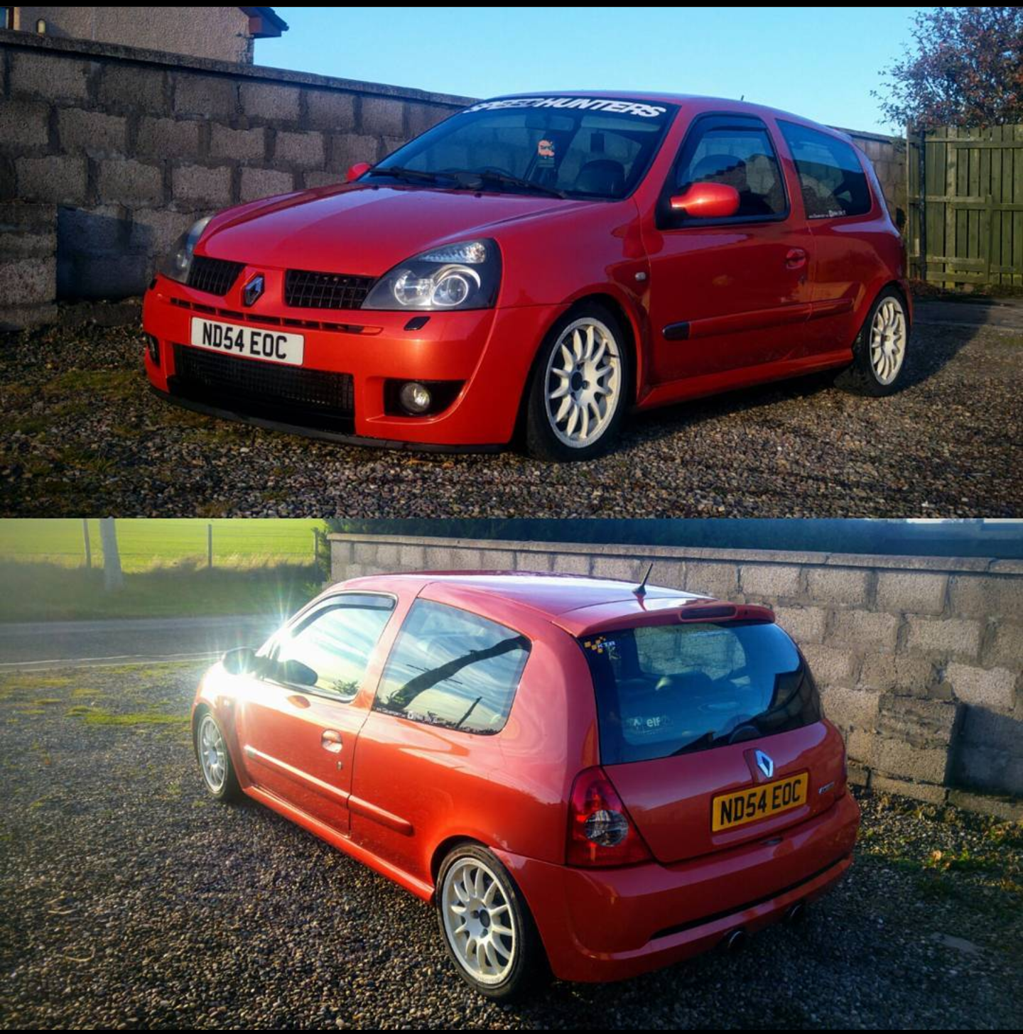

Luckily as I say it was short lived and before i knew it it was back like this. With a refresh of some goodies
Much better !

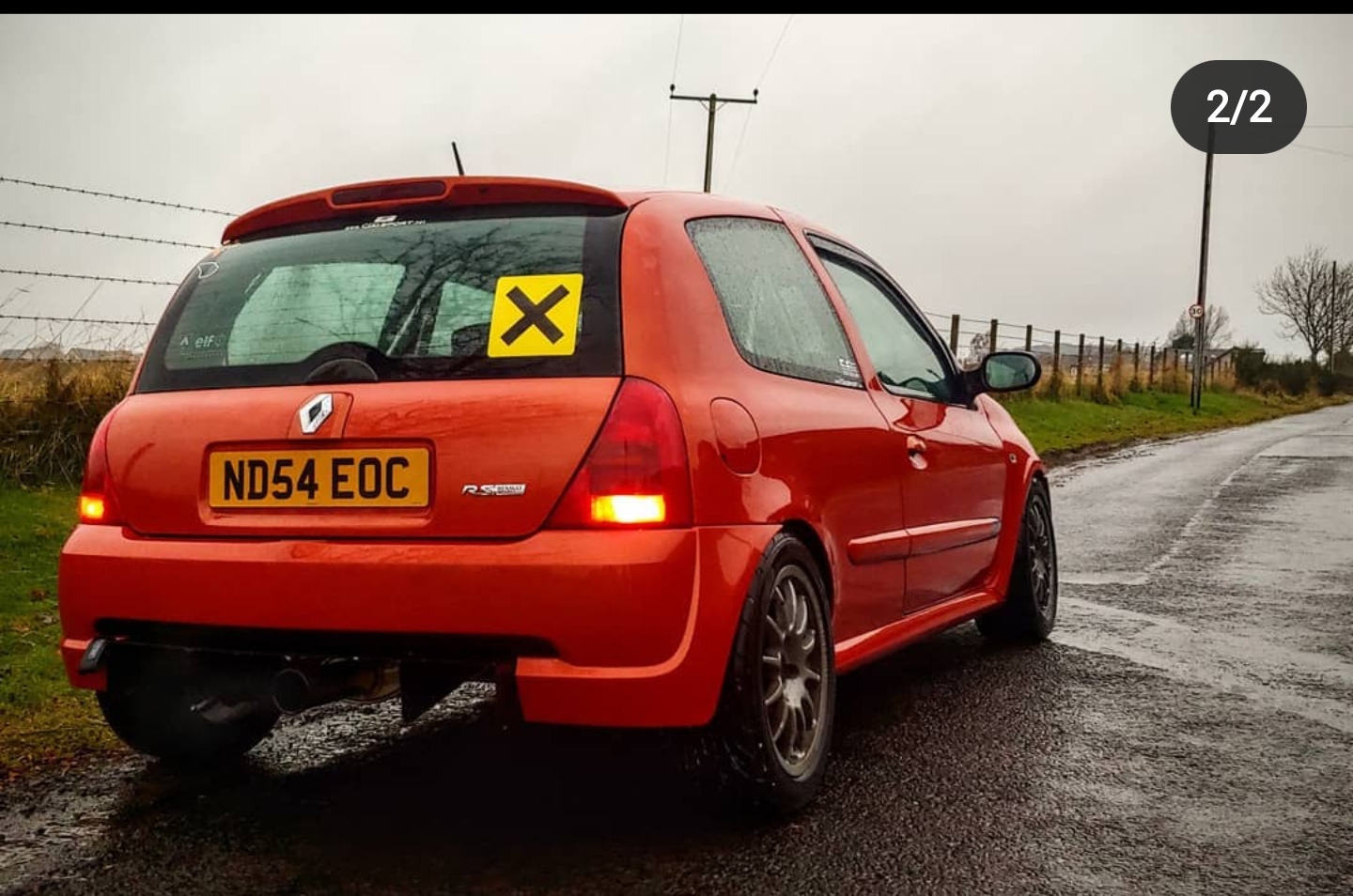

So moving on from the "scrape on everything and broken suspension look"
The mrs at this point ended up pregnant so that was the cage to be removed and back seats put back in :(

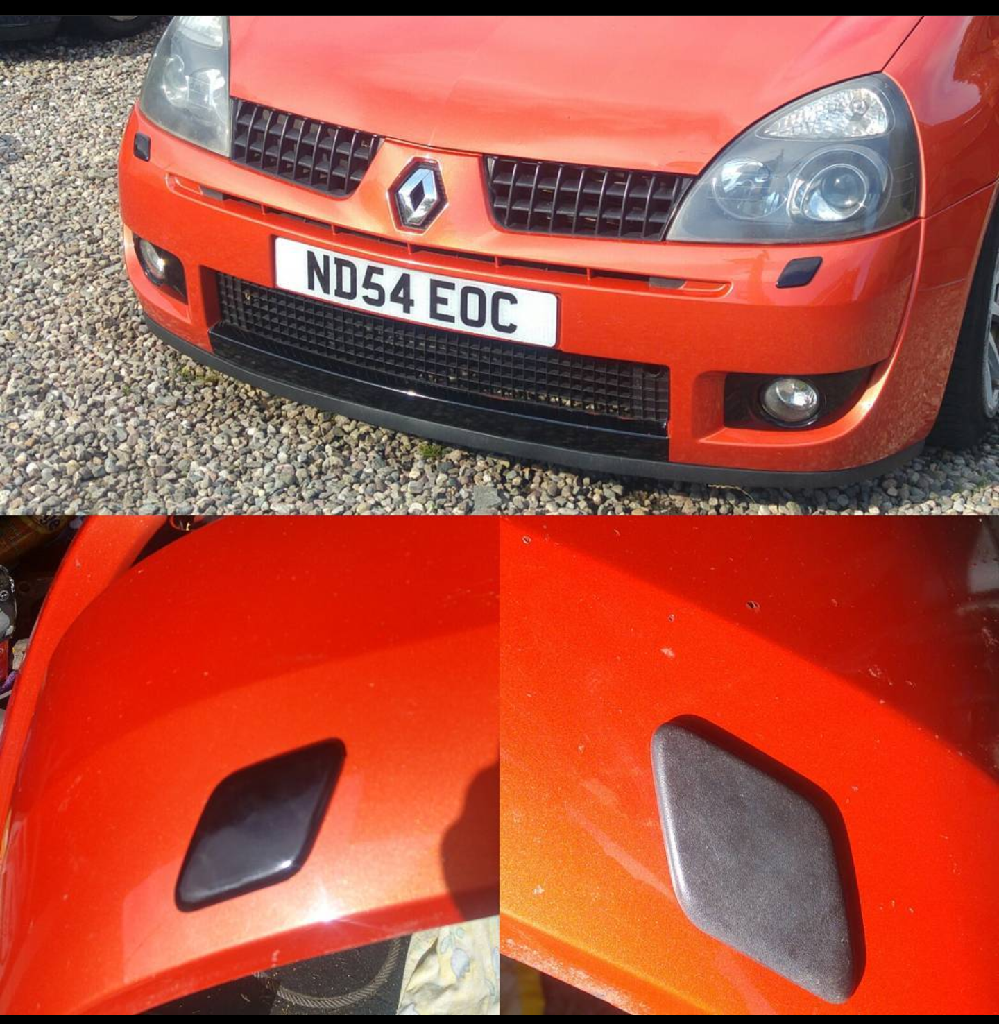

Now the old bonnet had a small dent in the front of it, not very noticable but i knew it was there. Also had some faded stripe marks on it which also annoyed me so bonnet off and new one on. The mrs also said that her car was going to be the family car.... So we all know what that meant. Back to the mods!
Ph1 rear lights made an appearance quite like how they blend in with the car colour

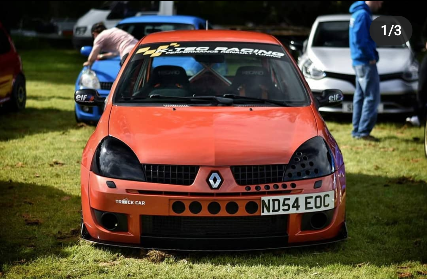

The front got some holes drilled, more for looks than anything tbh

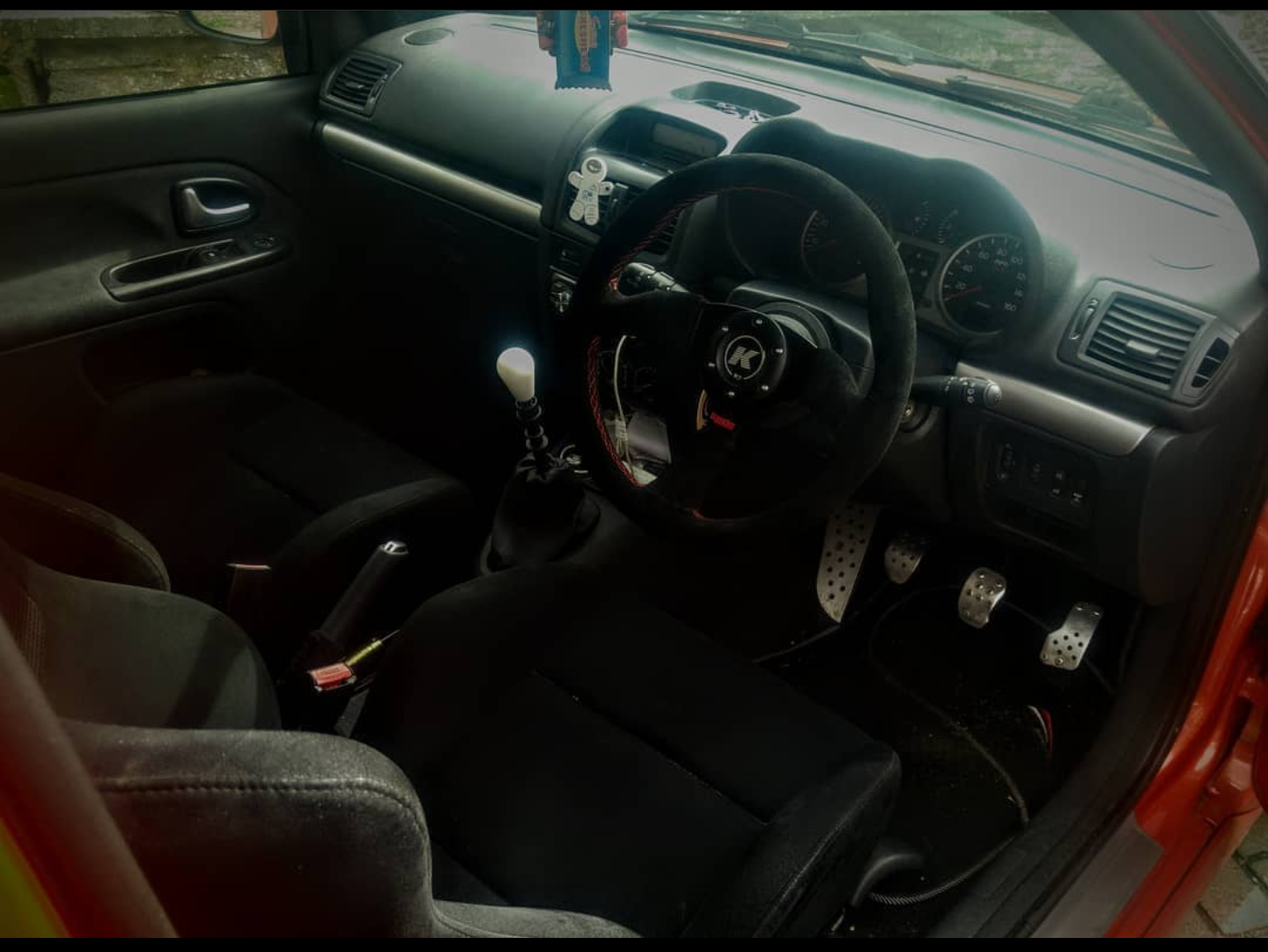

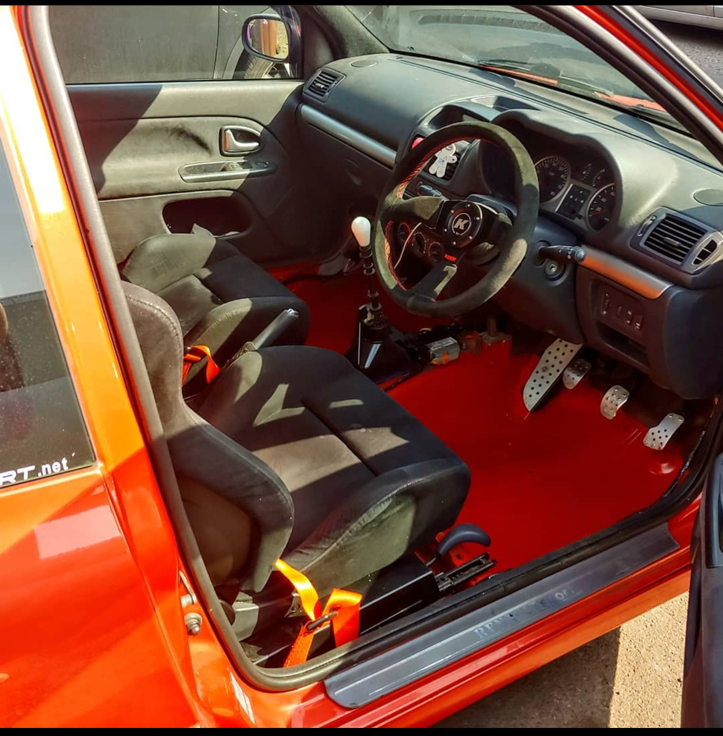

And the interior got treated with some Evo mr recaros a bms shifter and a kode wheel.
Made the car feel so much better!

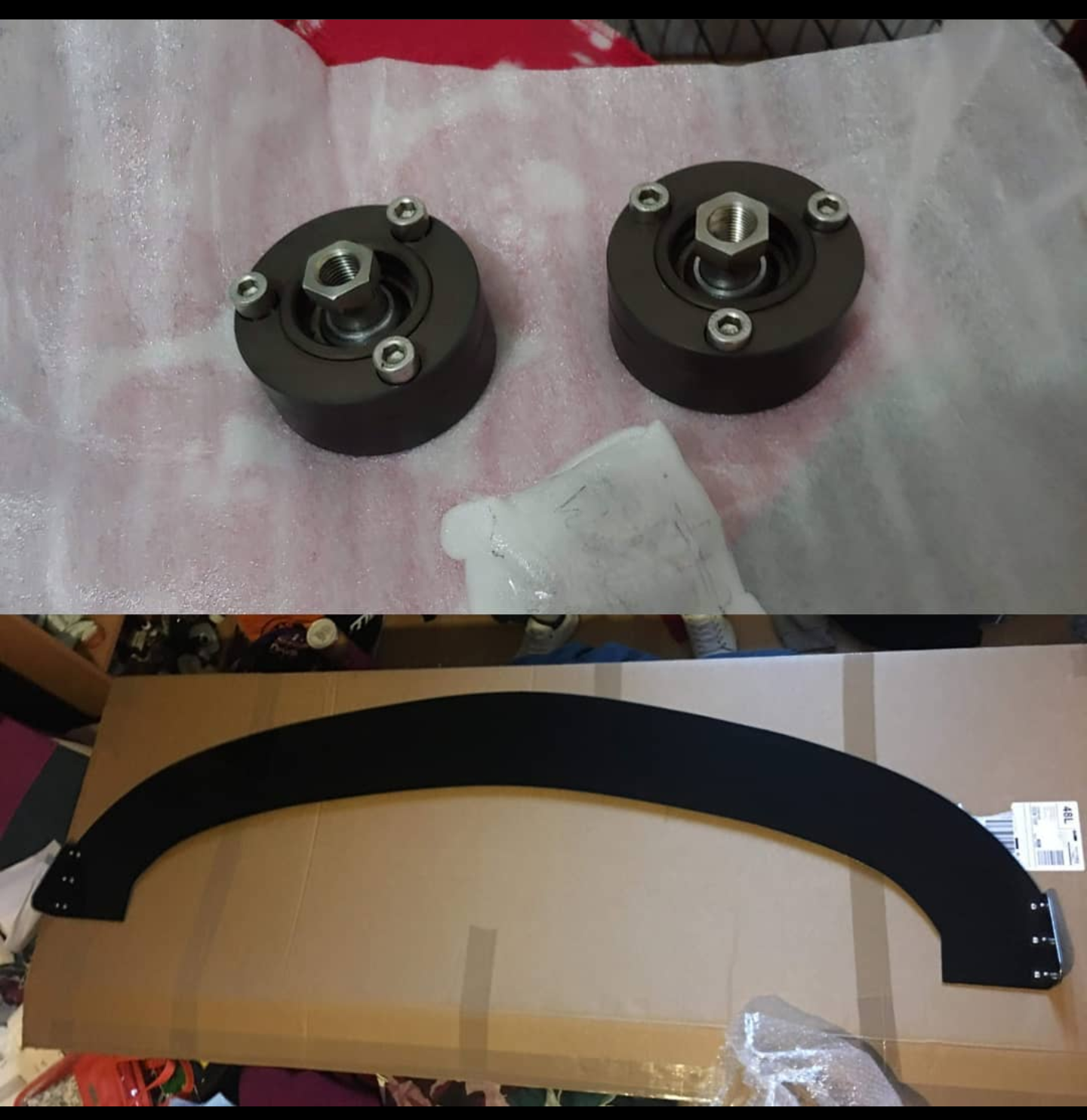

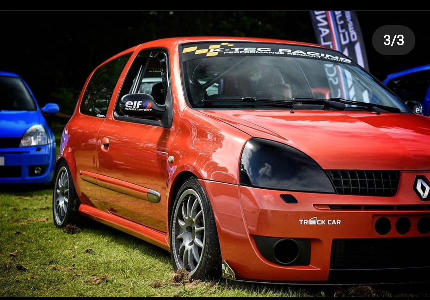

Ktec front brace, solid top mounts and a cm composites splitter 👌💪
The fitted a new sunstrip and removed the foglights. Pretty sure by this point i had also removed the carbon cannister and acoustic valve
Got the brace fitted

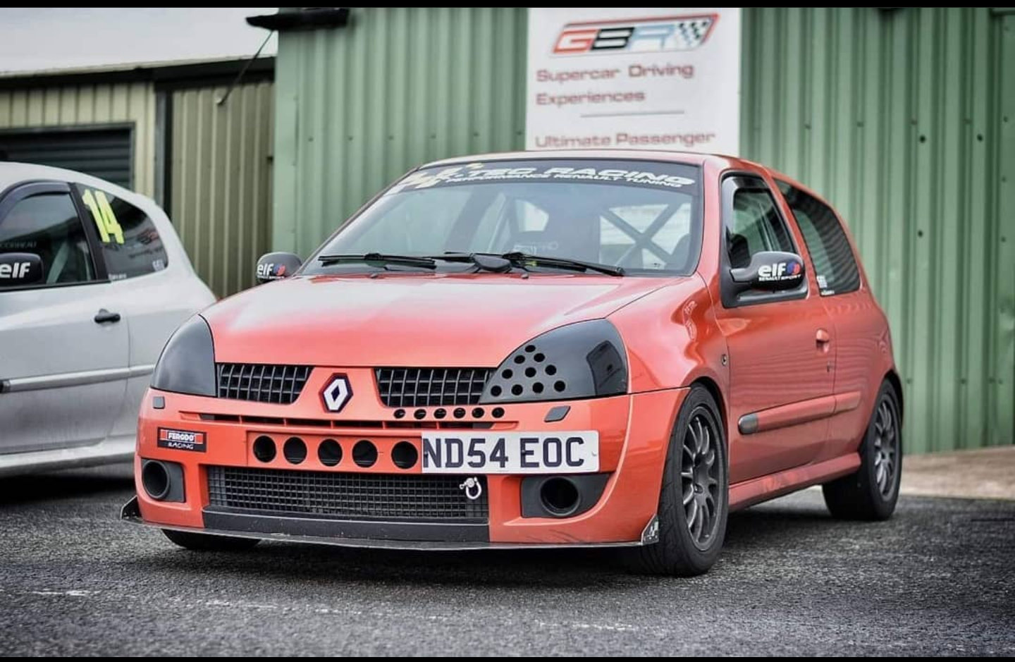

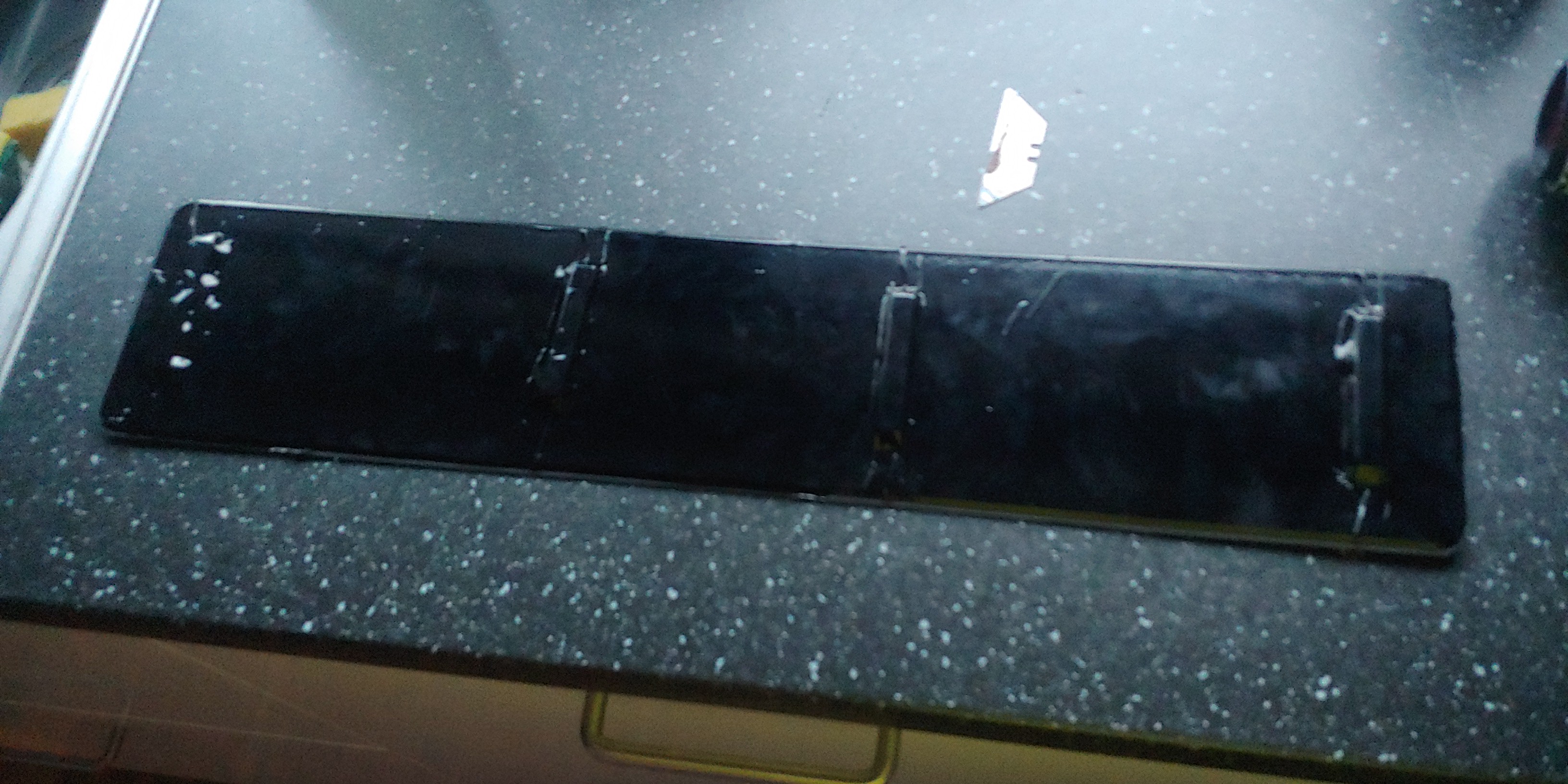

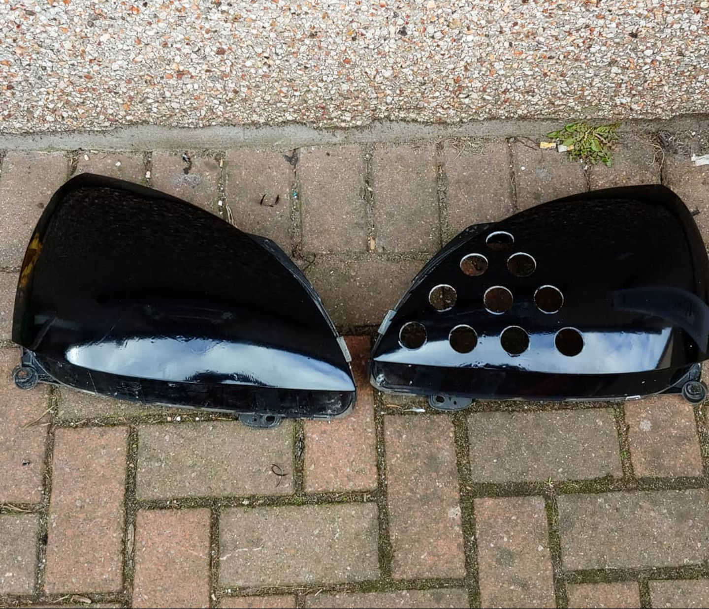

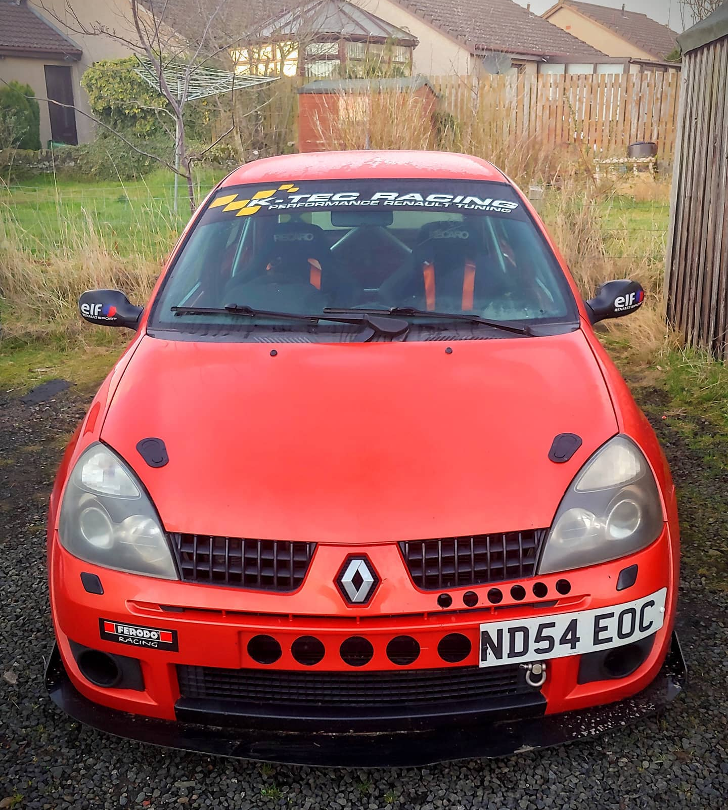

Then went about making my own headlight blanks. Gutted a ruined set of old headlights i had lying around. I think they look pretty mean when fitted
Now by this point i was getting tired of Crail raceway and turnedmy attention more to knockhill racing circuit. Everytime i went i was itching more and more to finally get the bottle to go out on track.

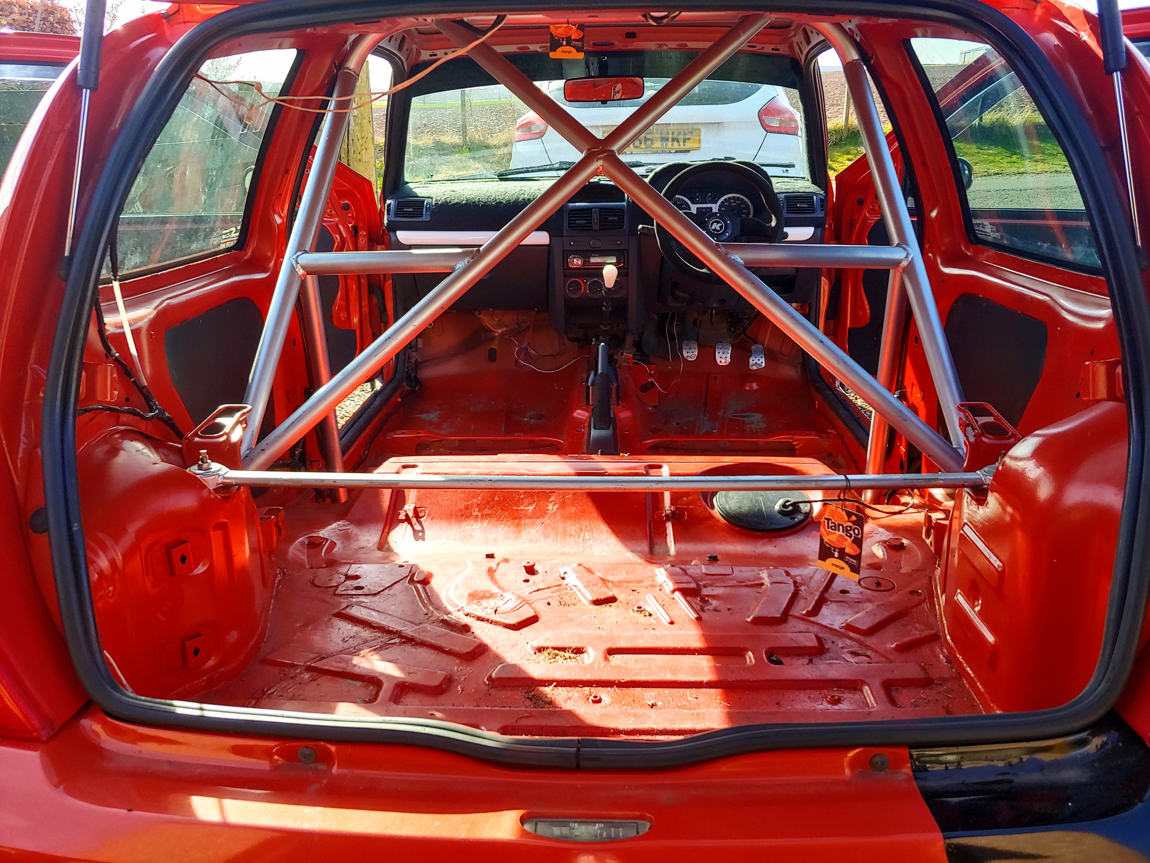

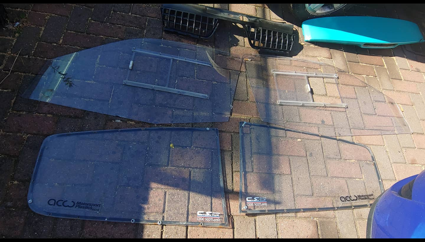

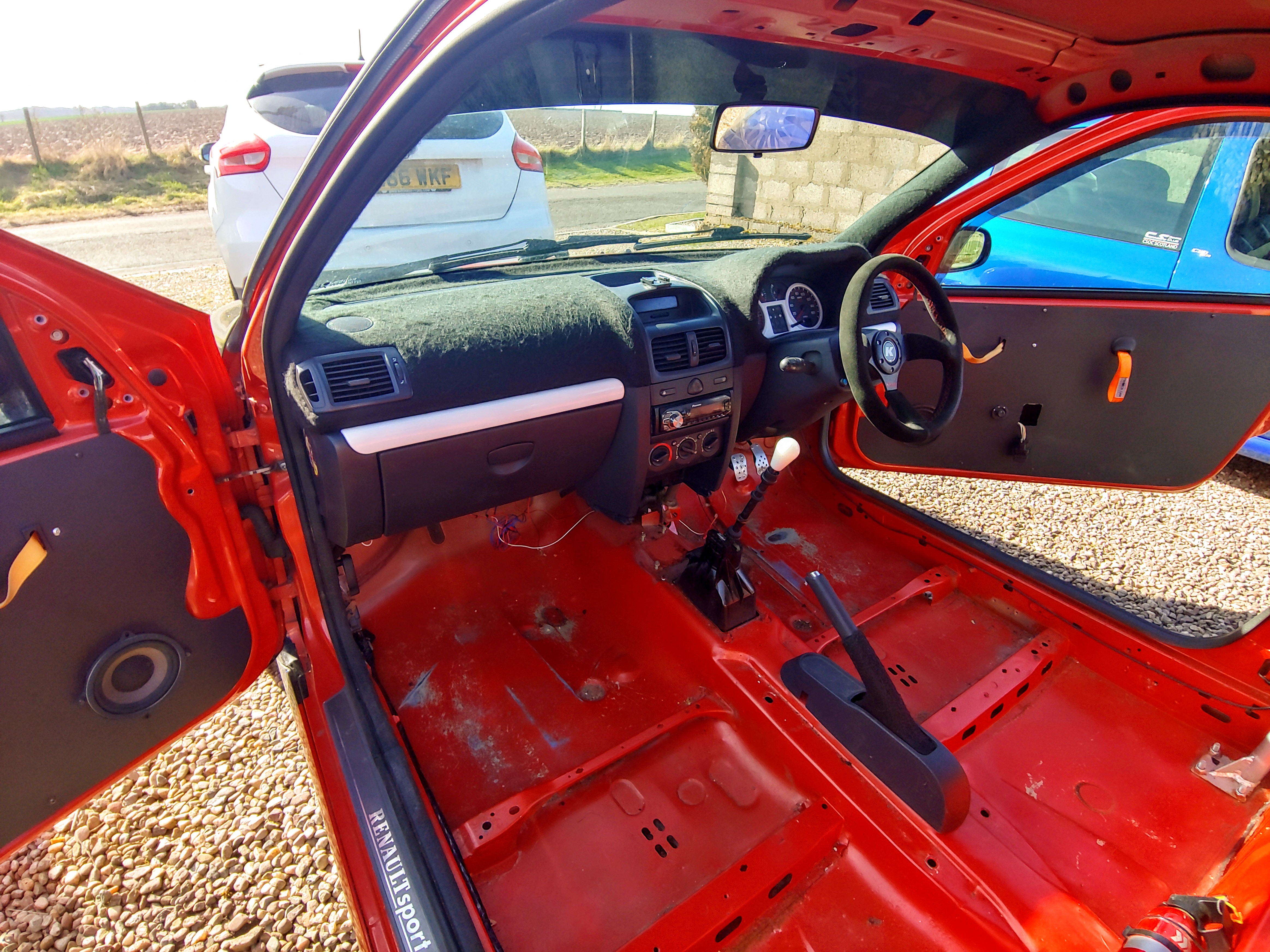

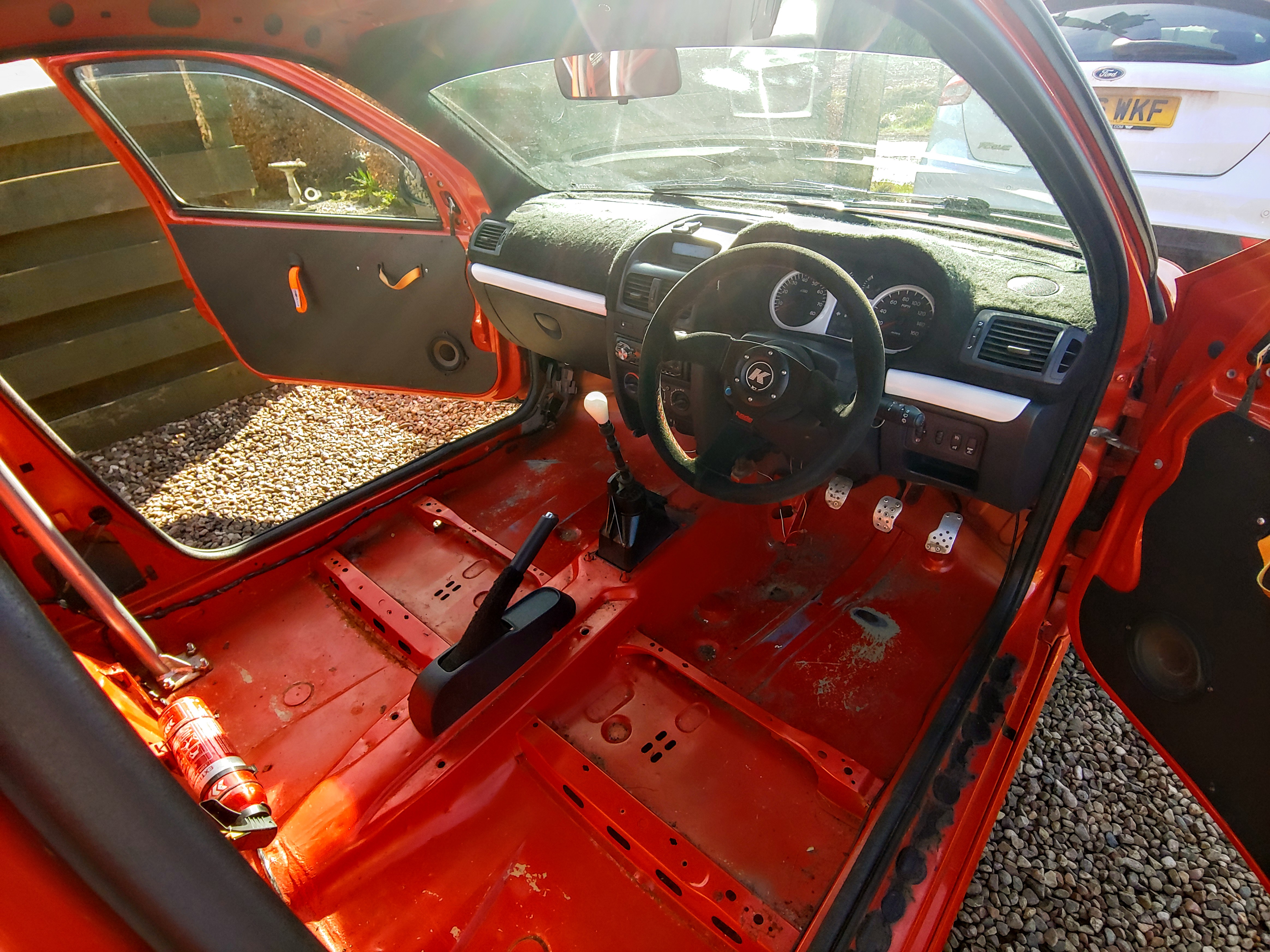

So set about making the car more of a track car

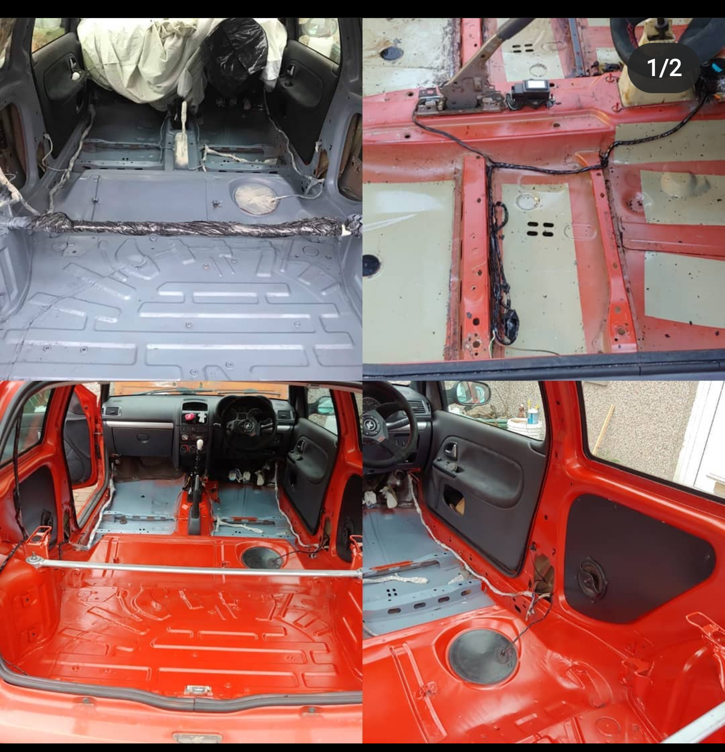

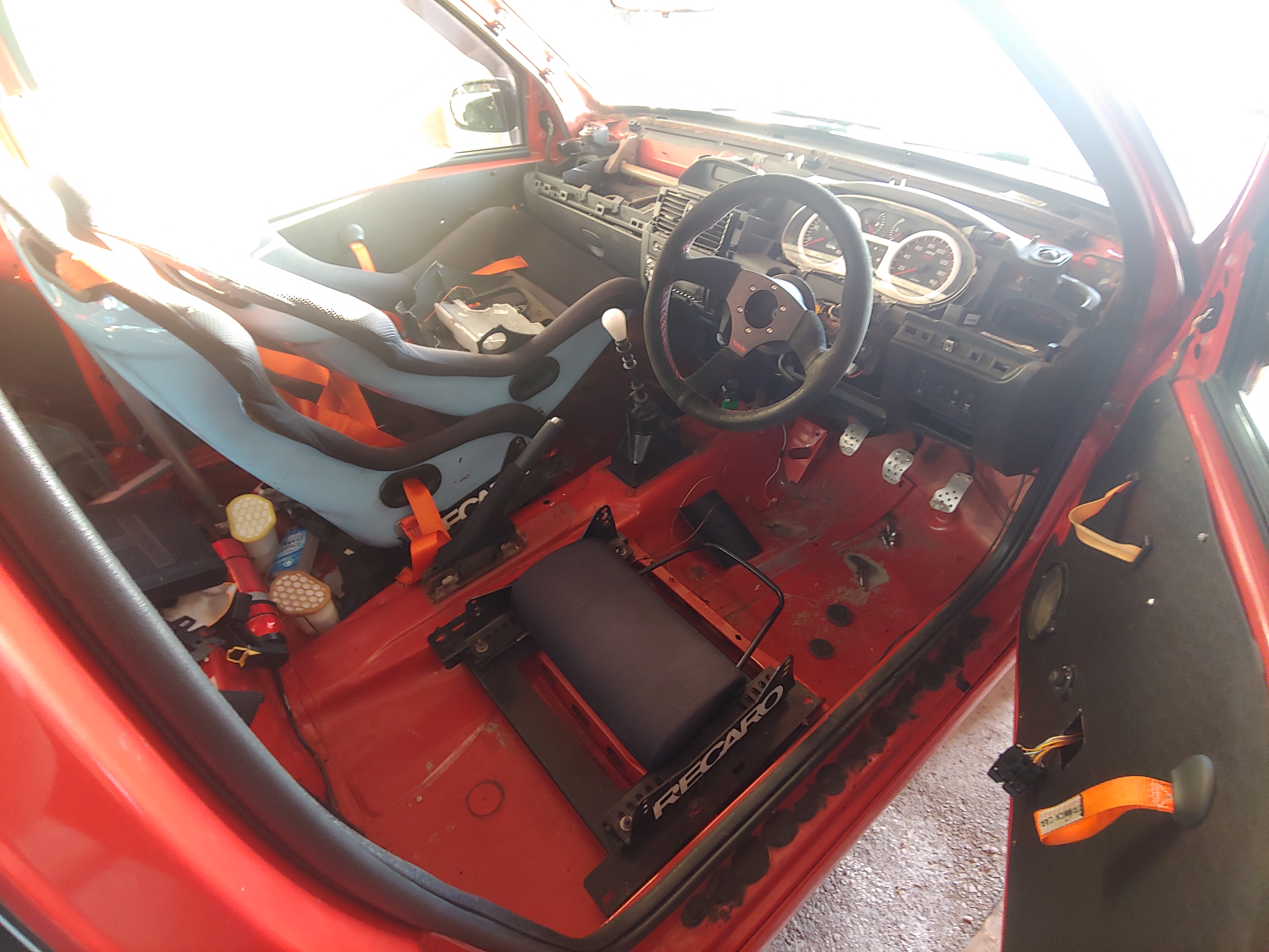

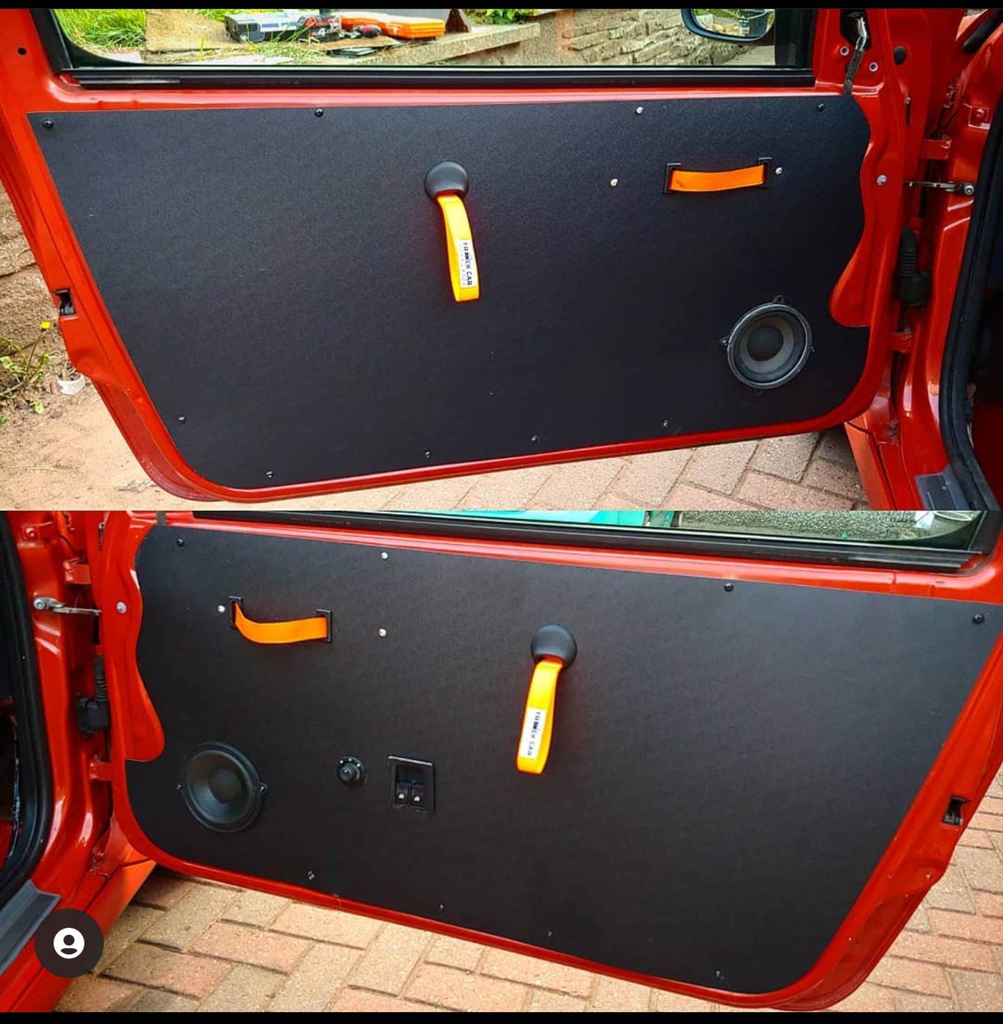

Full interior strip, sound deadening removal, flat door cards all round and a fresh lick of inferno orange paint

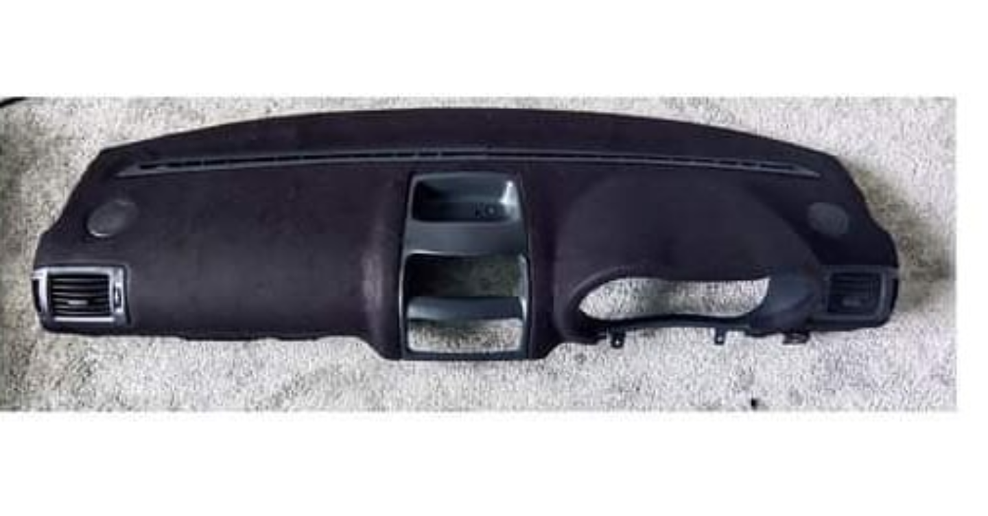

Got the dash back out the car and fabric wrapped it to avoid glare

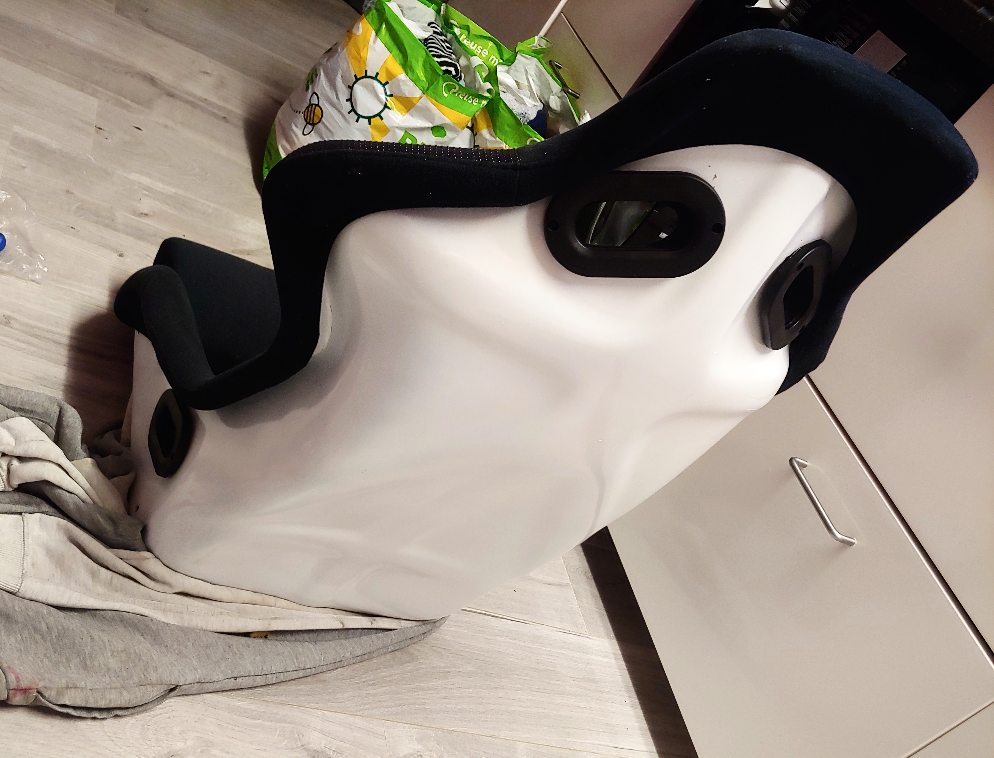

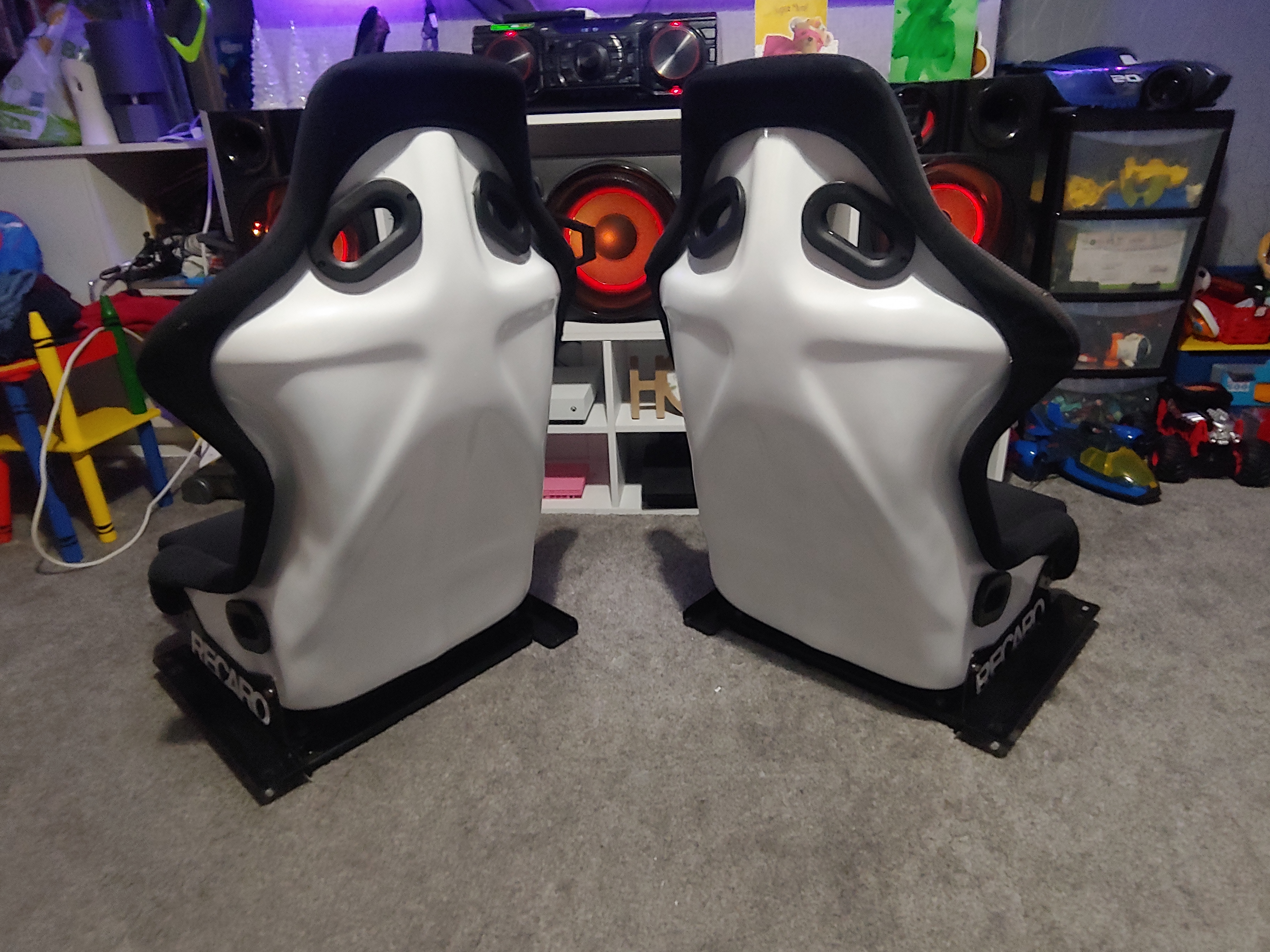

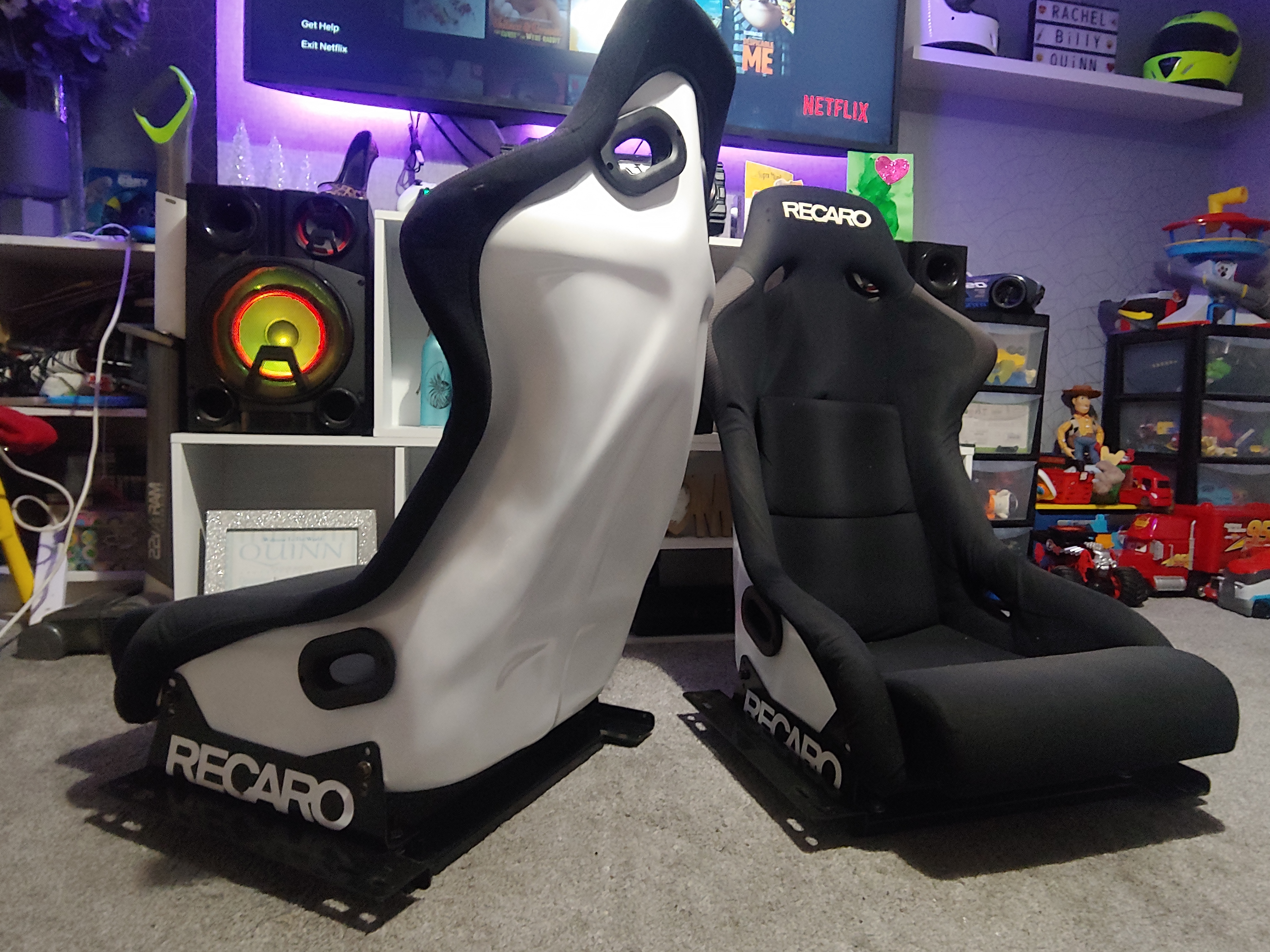

Now as much as i loved the evo recaros. I thought safety would be a better option , reclinable seats in a track car etc... So sold them and bought some recaro spg's

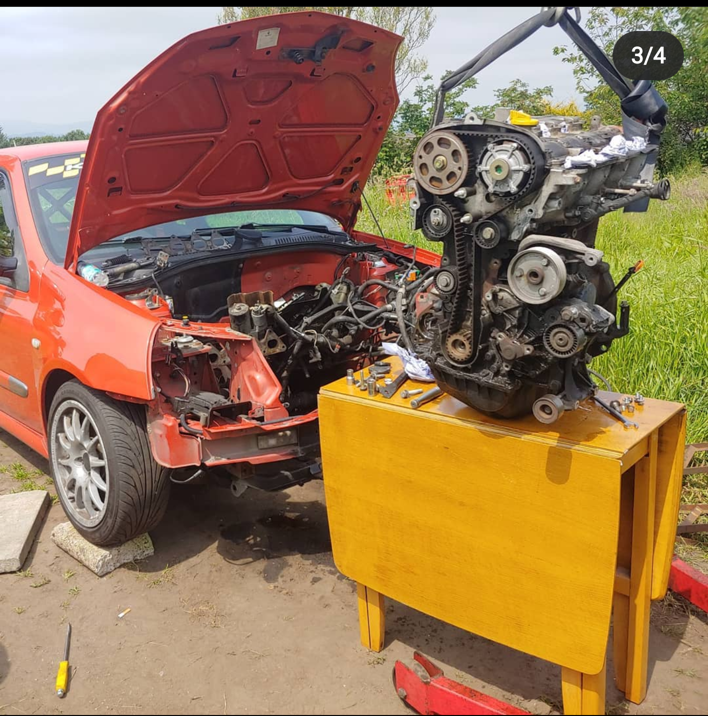

A couple of weeks later the clutch started to go :( now the timing and dephaser was also due at this point. So got the engine out and with help we managed to get it all sorted and also done a diy aircon delete which free'd up some room and weight 👌 unfortunately i dont have any pics but its the Saab pulley
version.
Ignore the table had to use what was at hand 😂
Then all back in and tidied up

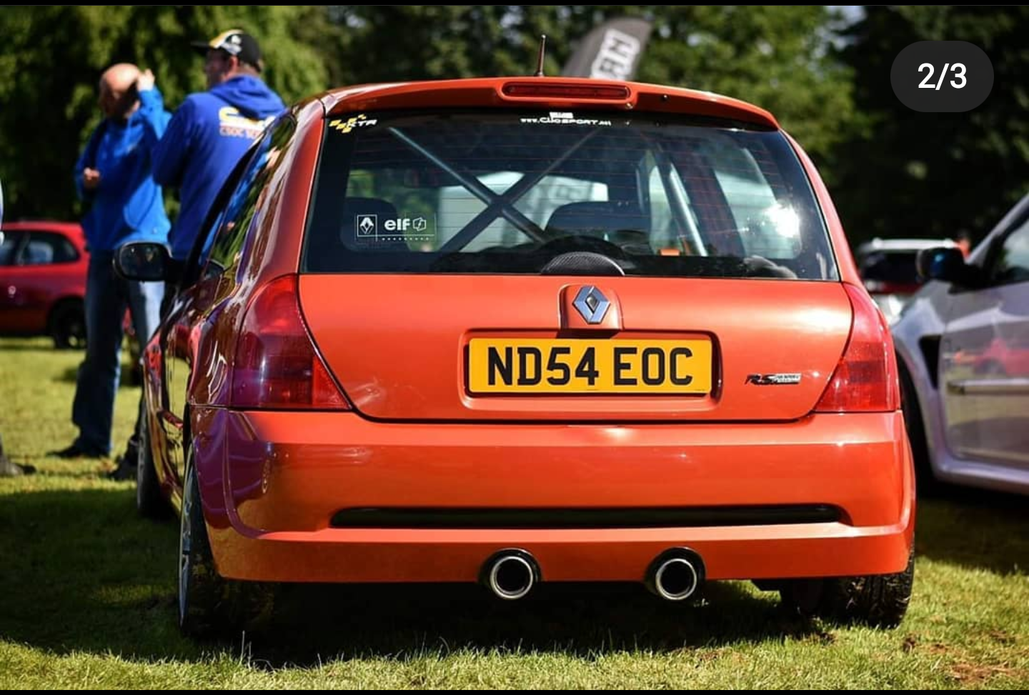

Now a working progress here... Dont worry it gets better.

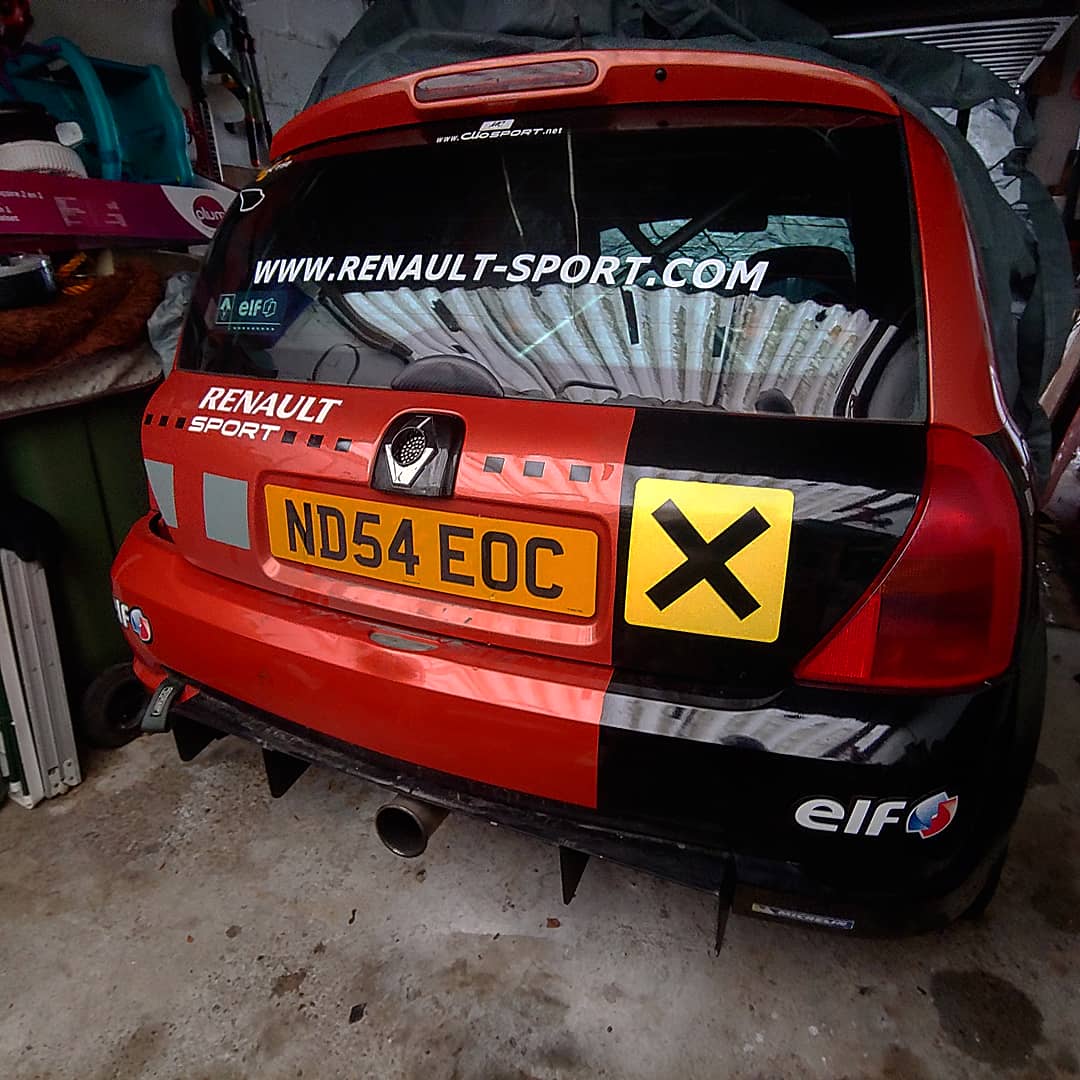

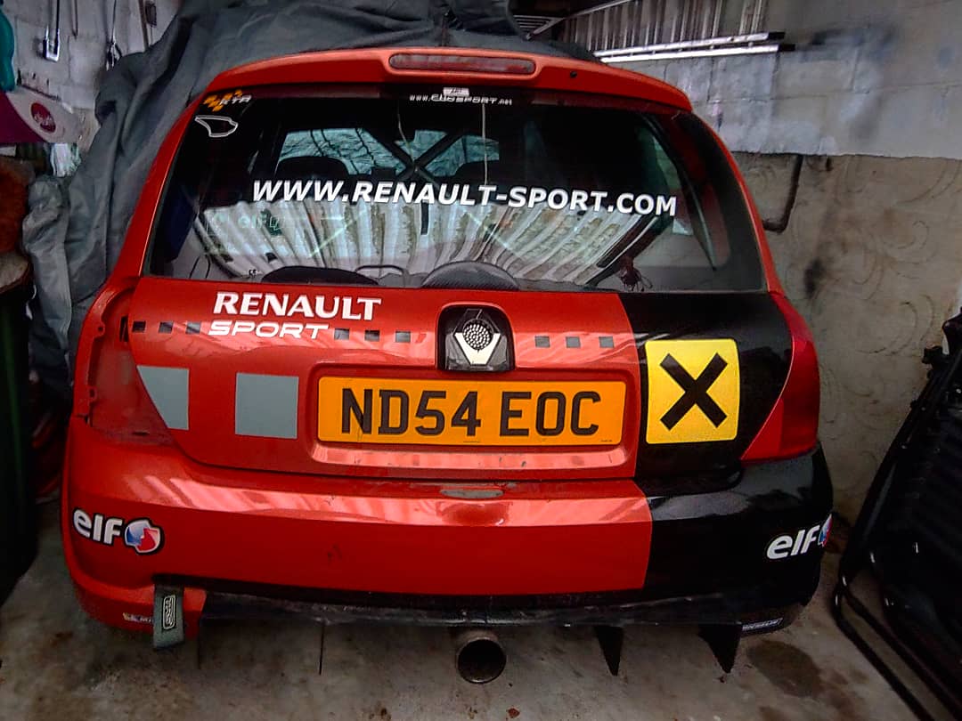

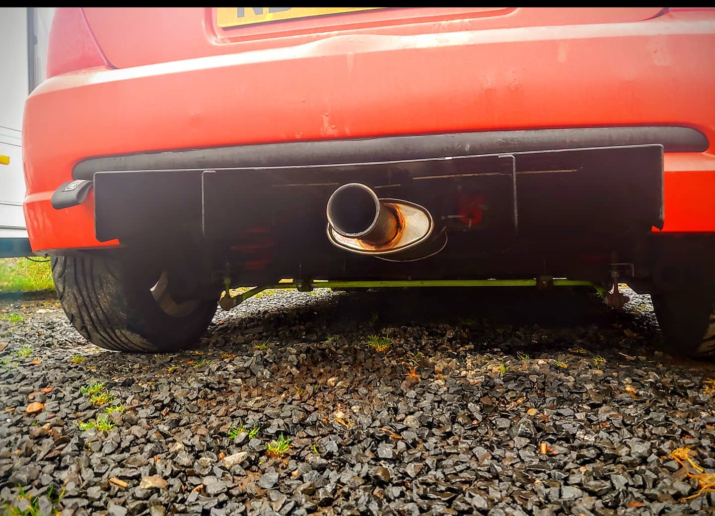

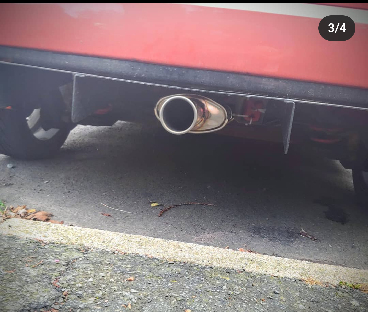

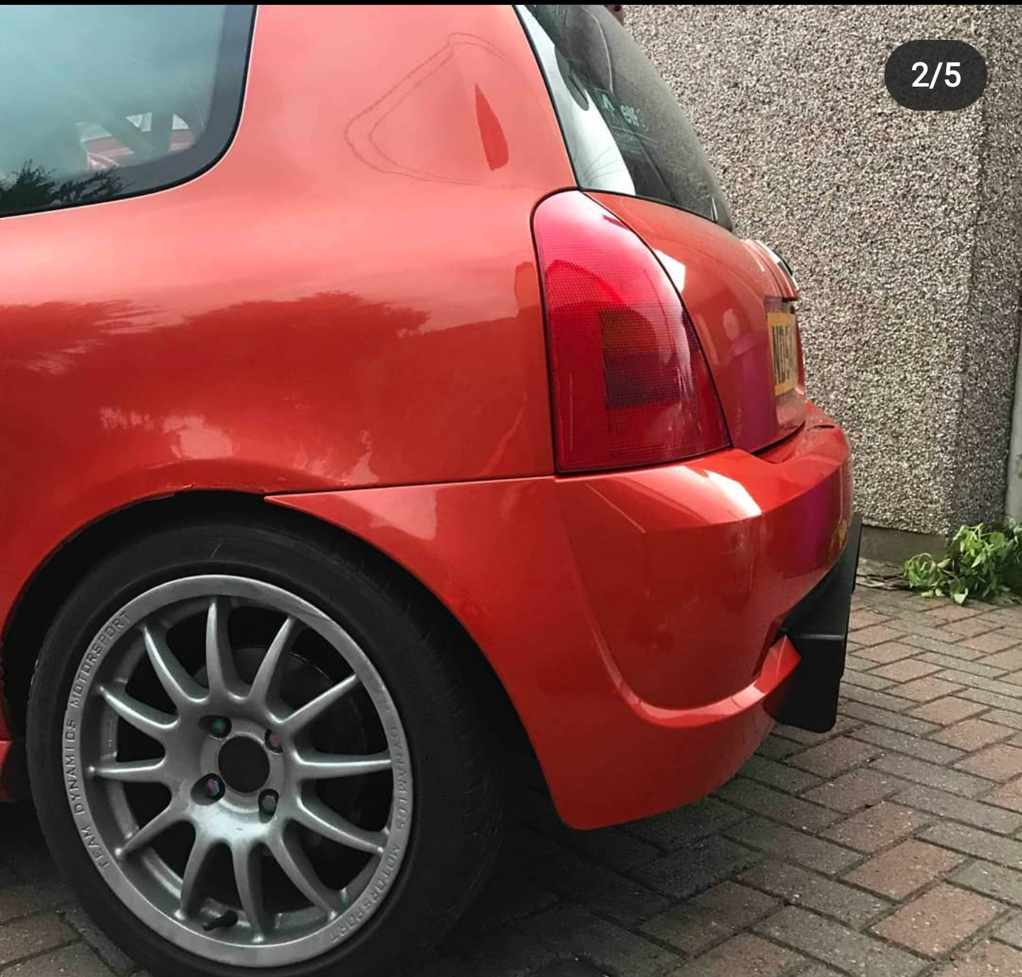

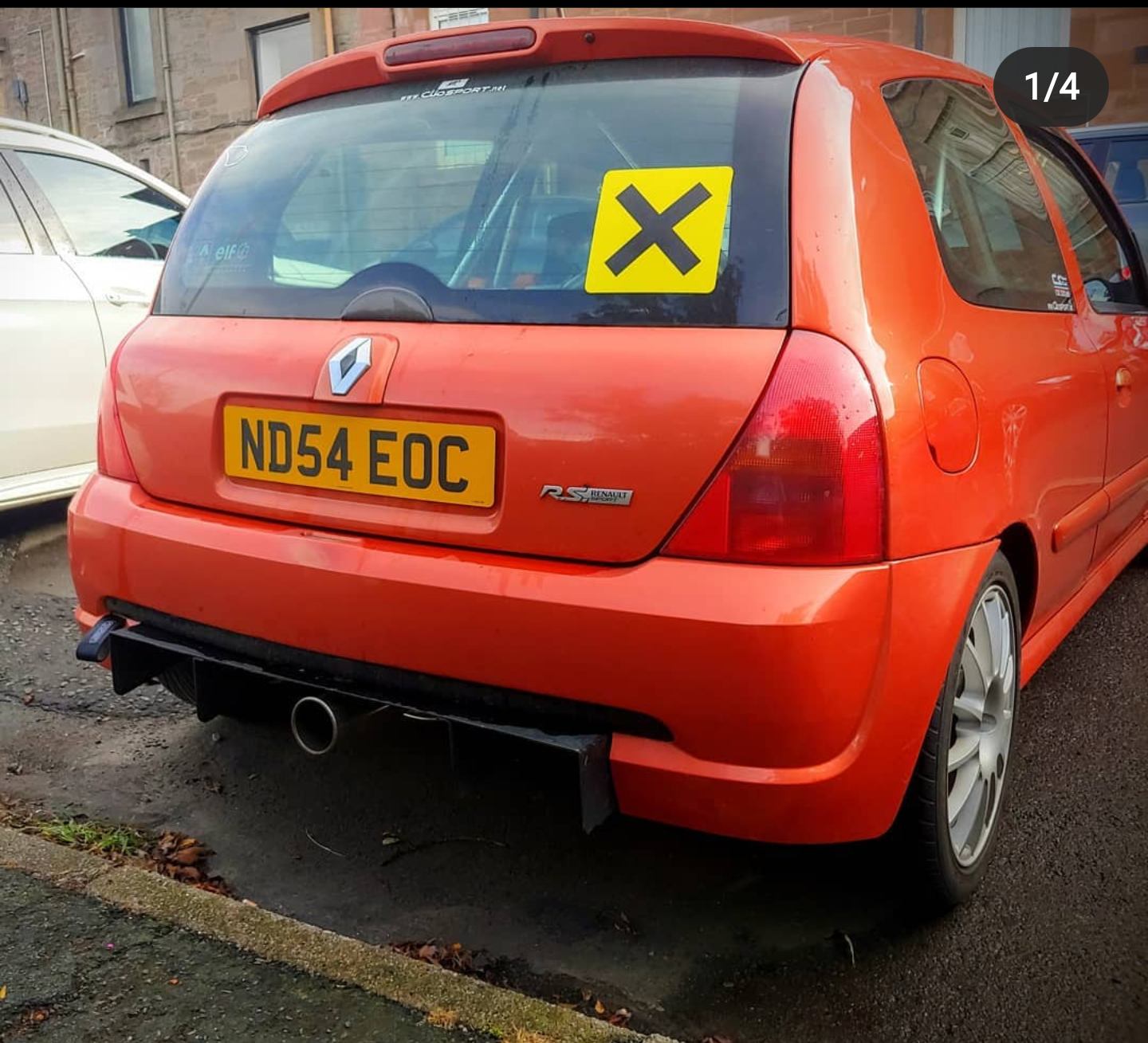

Decided i wanted something to match the more aggressive front end as the rear looks a bit tame.

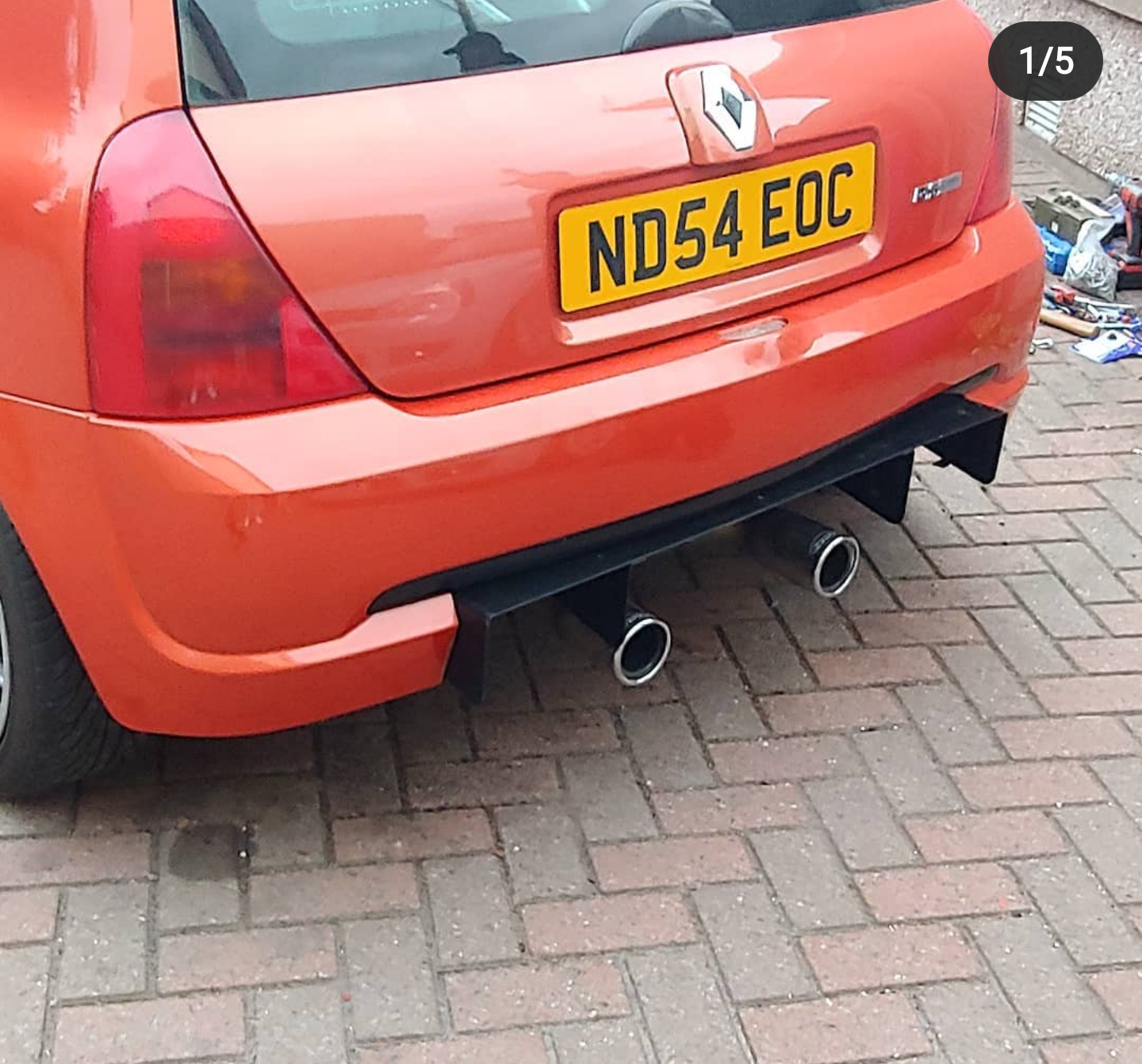

So decided a custom diffuser was the answer
Now this is fitted through the exhaust mounting brackets through the 182 boot floor. Basically removed the original bolts and replaced with longer to go through the diffuser, mounts and hanger. I now know an exhaust change is definitely due. But more on that later.

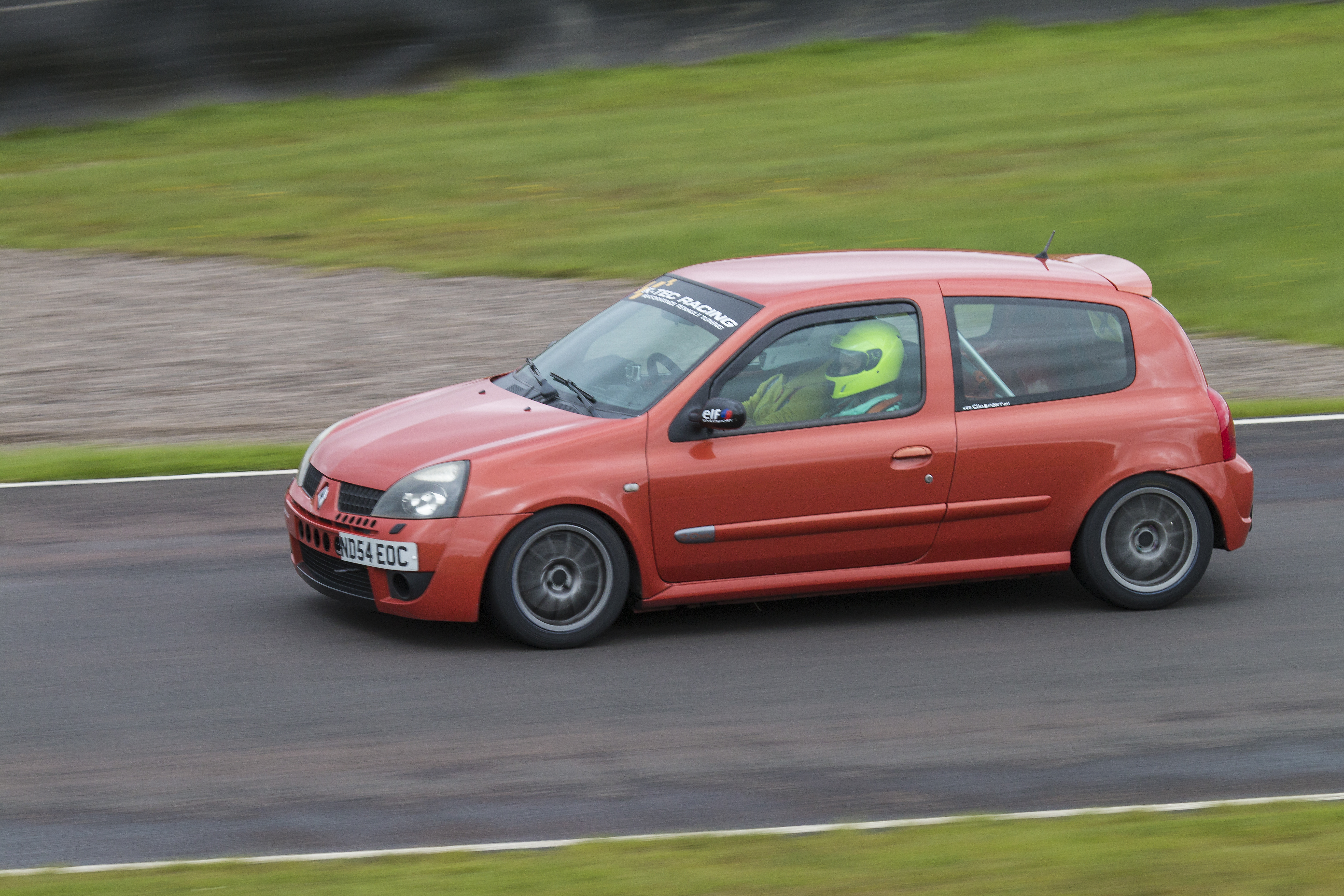

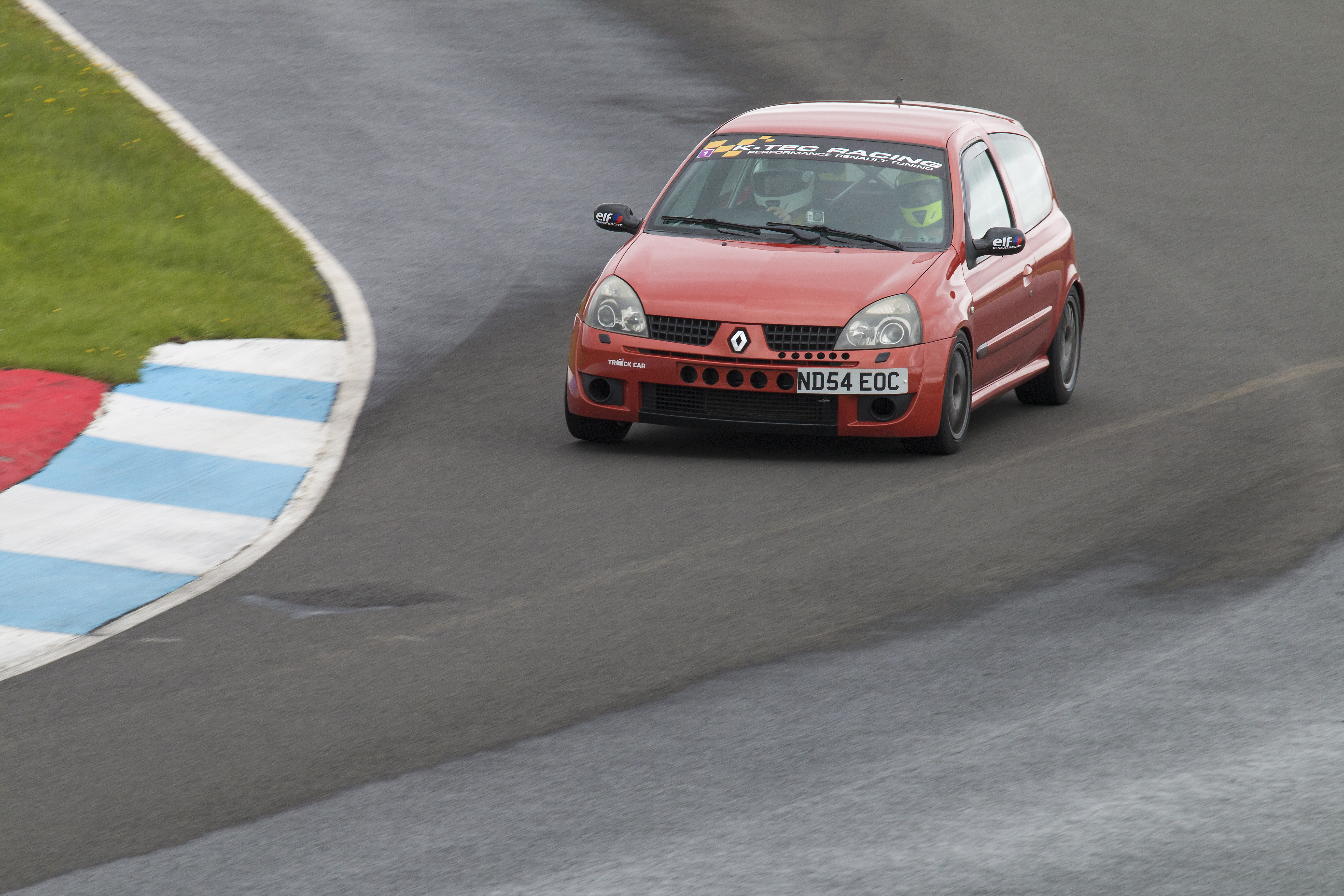

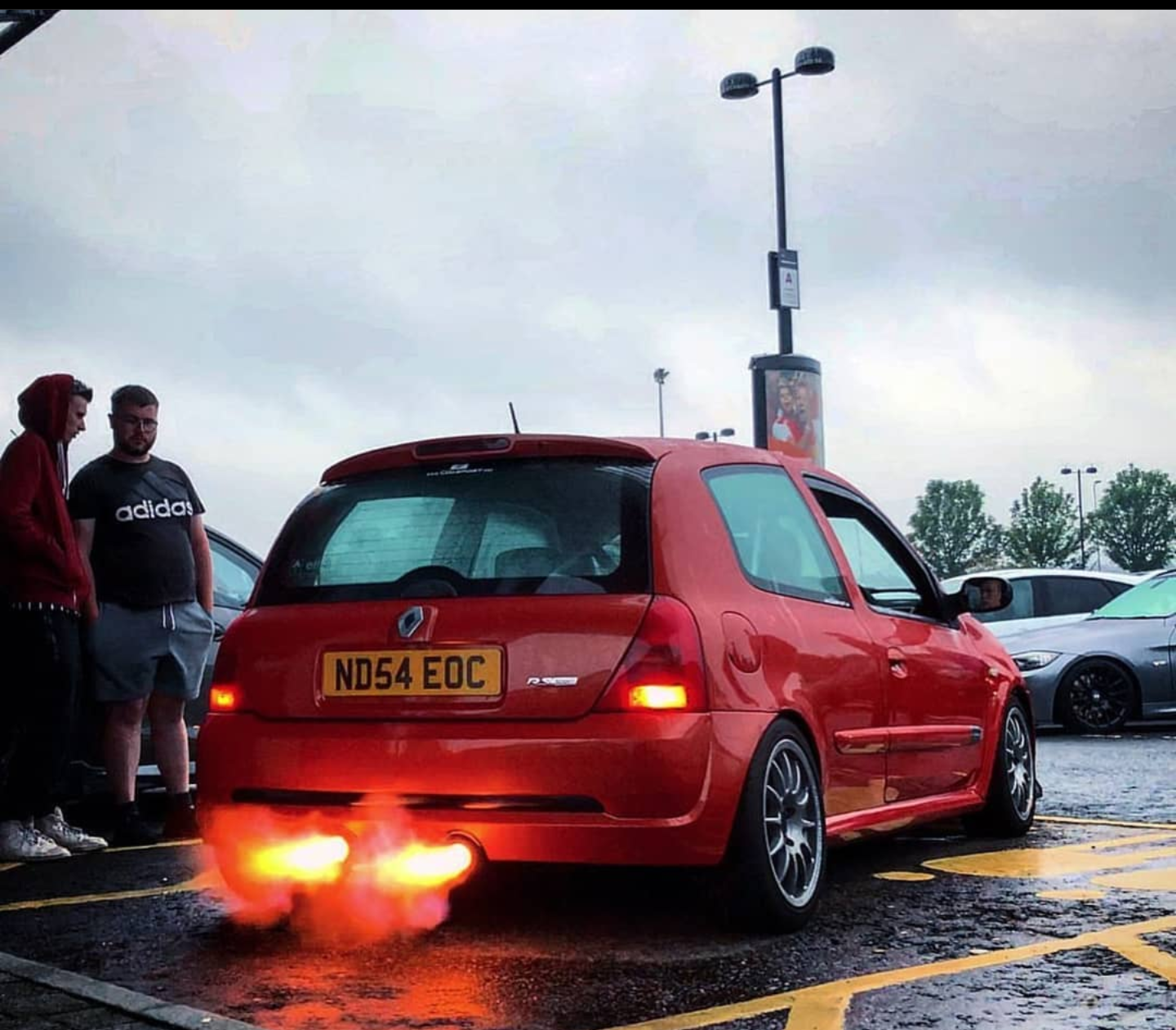

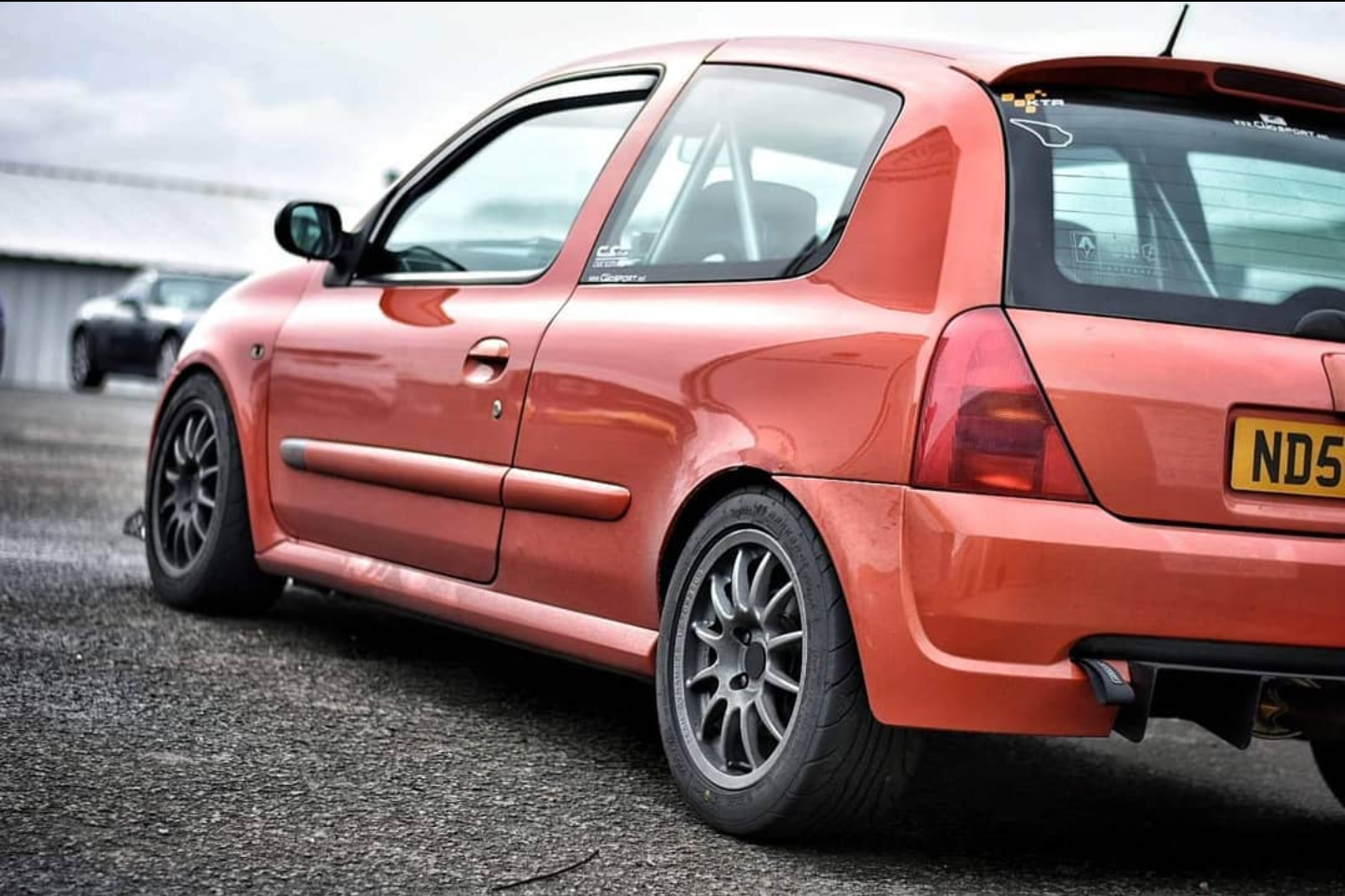

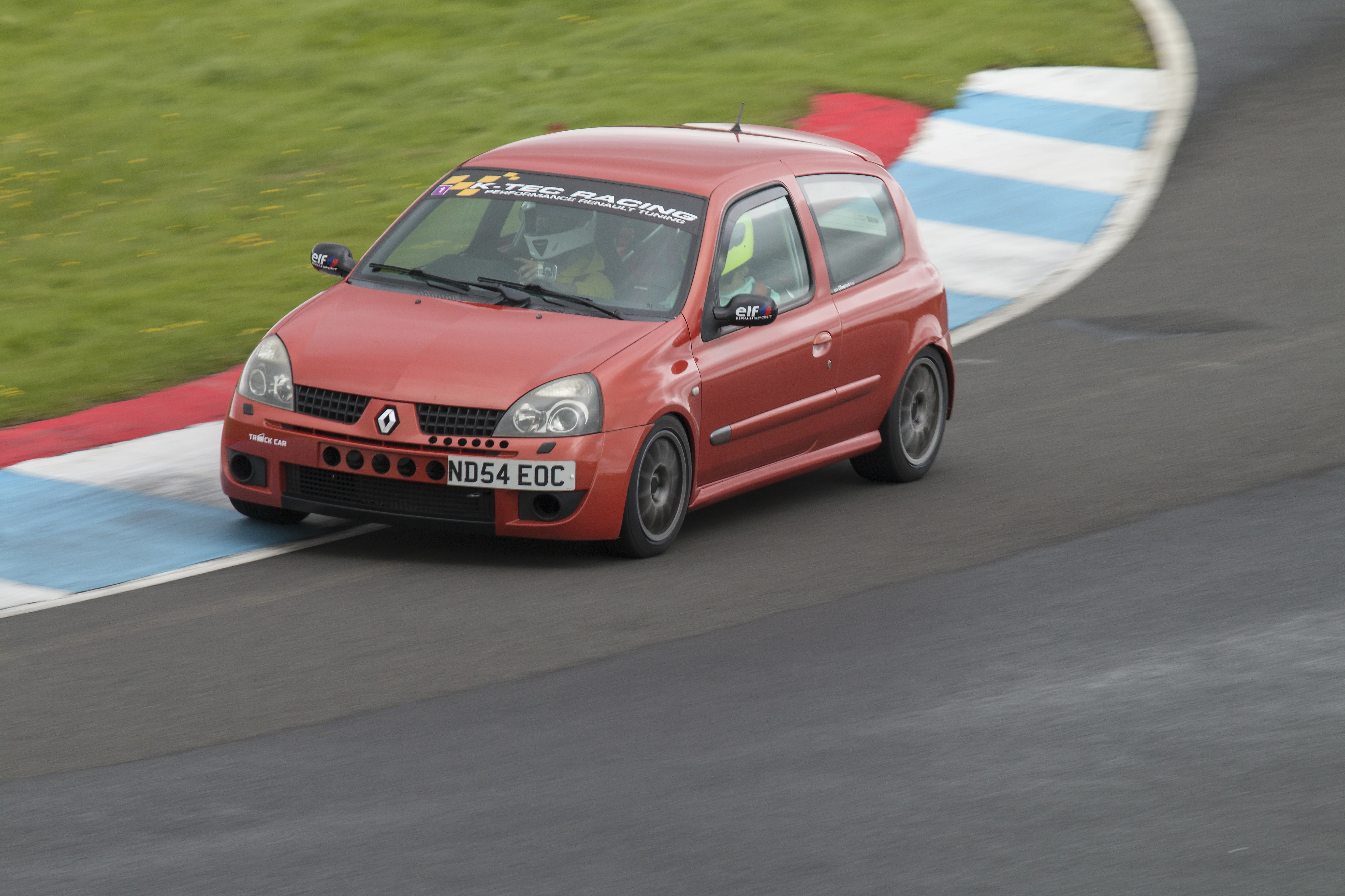

1st couple of track days 💪 finally got the bottle to go out on track. Car permormed great and reallynenjoyednthe experience!

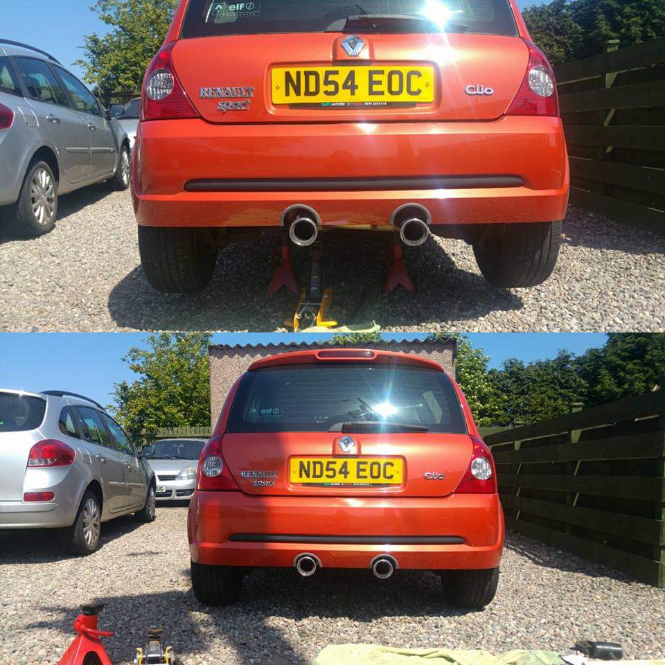

Now the dual exhaust with the diffuser looked gash so it was now time for a custom exhaust.
Massive weight saving and looks 100x better!!

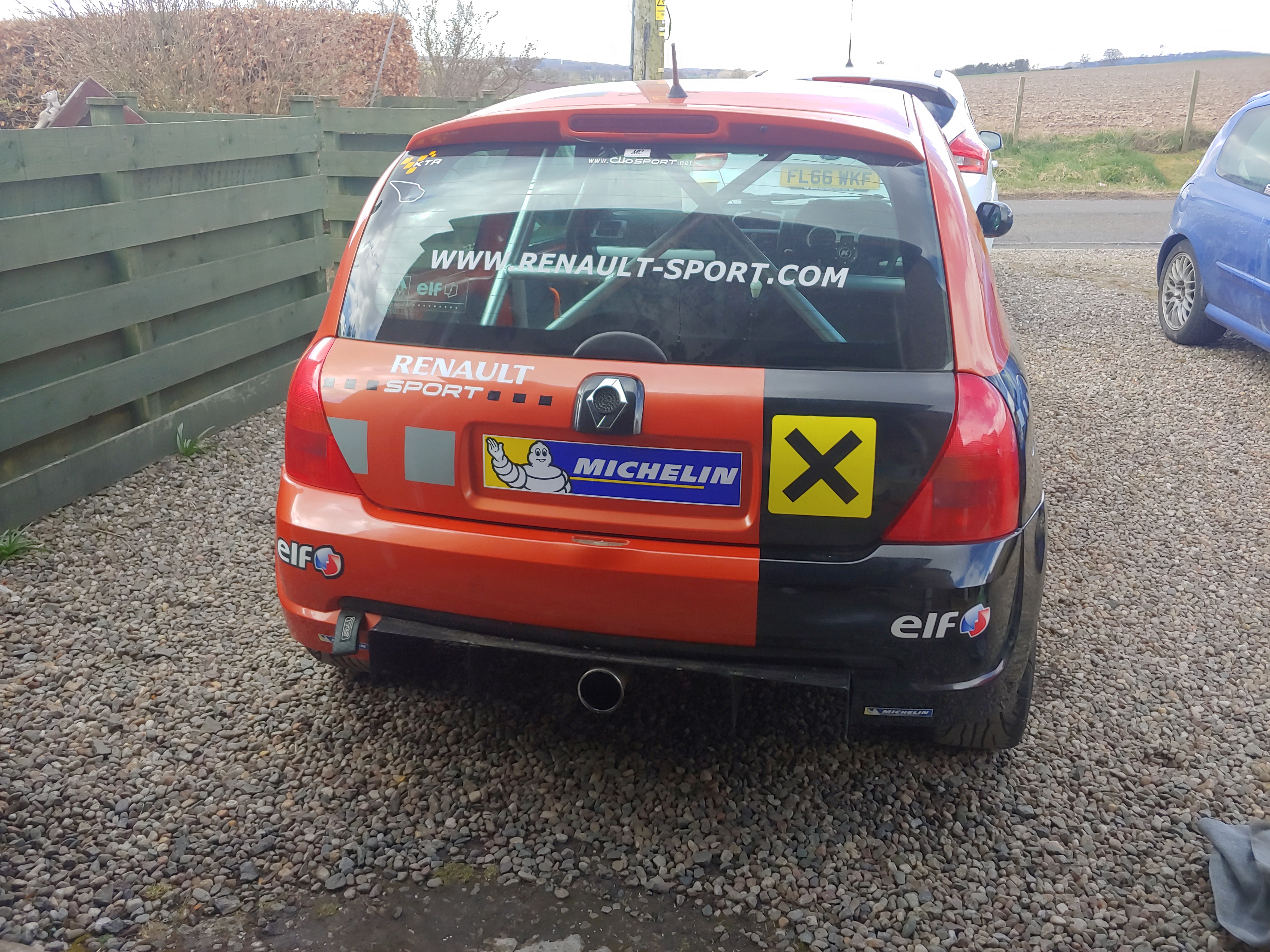

And went and got some aero catches fitted 💪

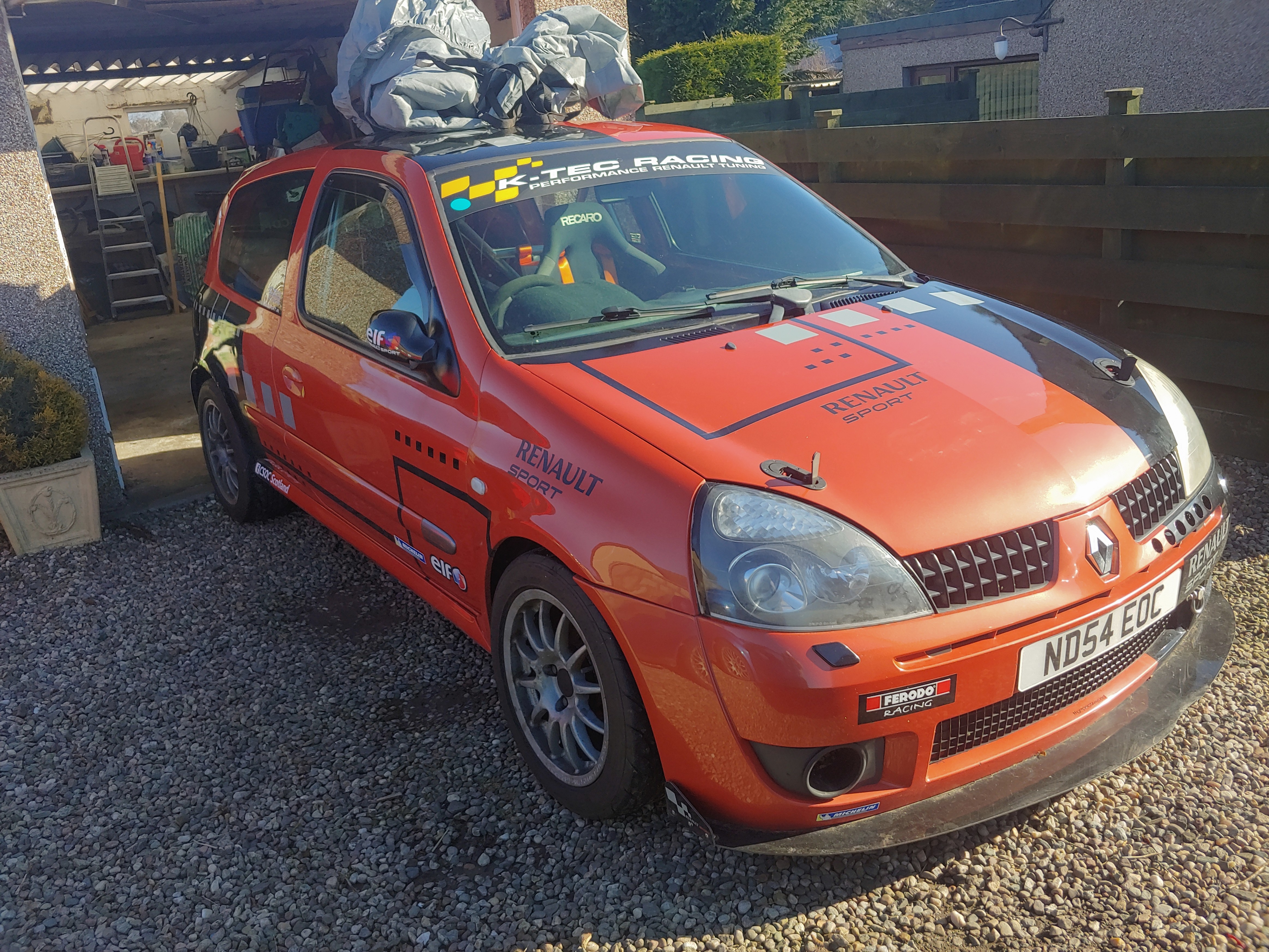

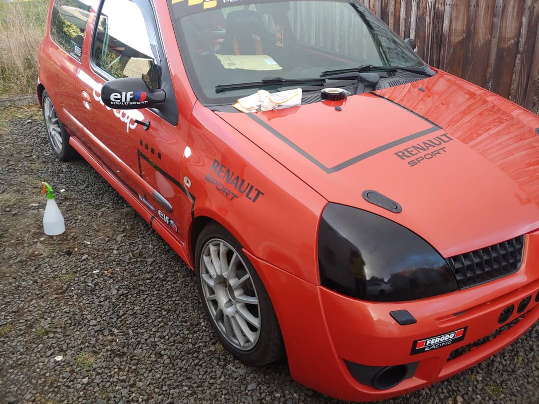

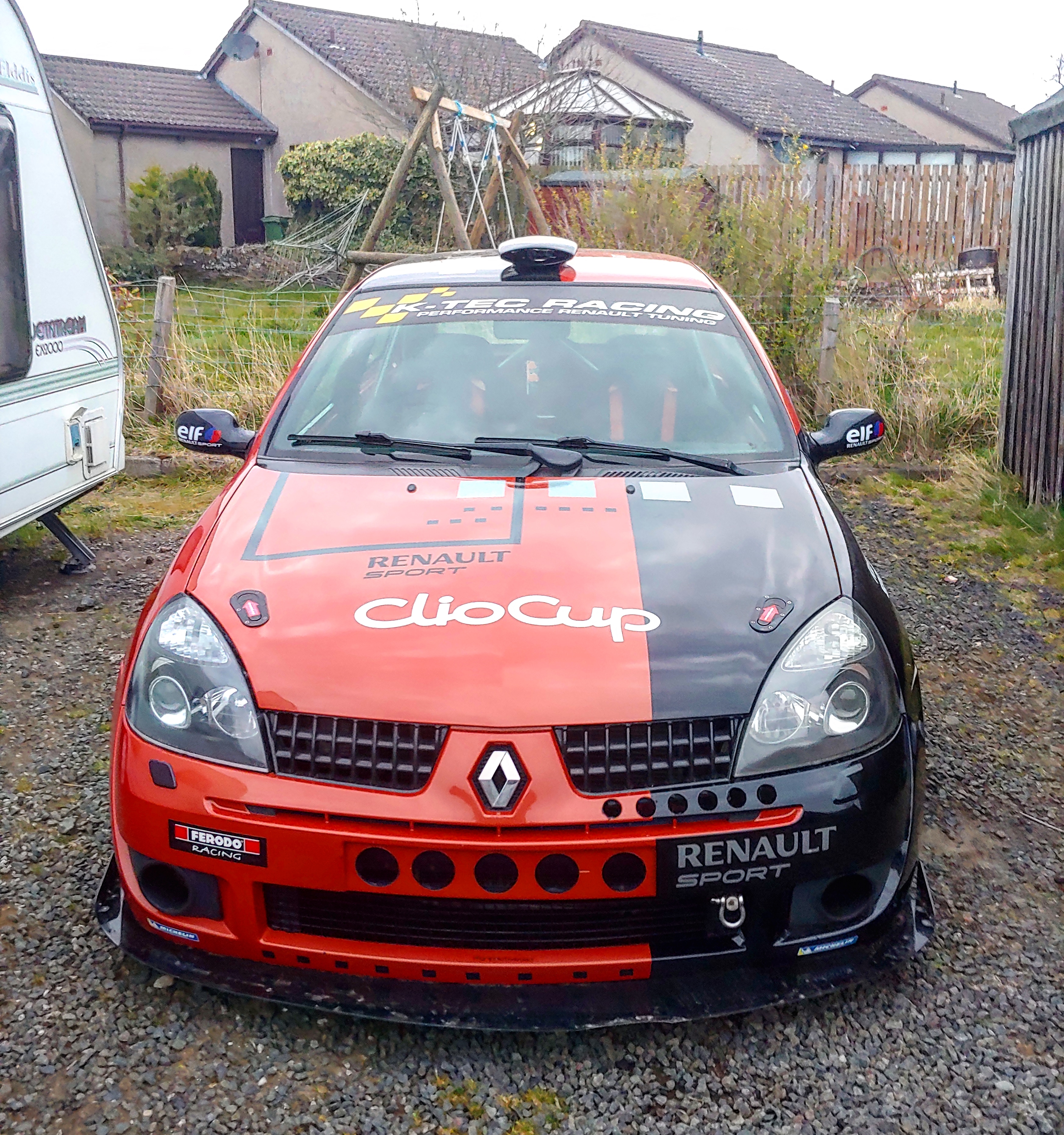

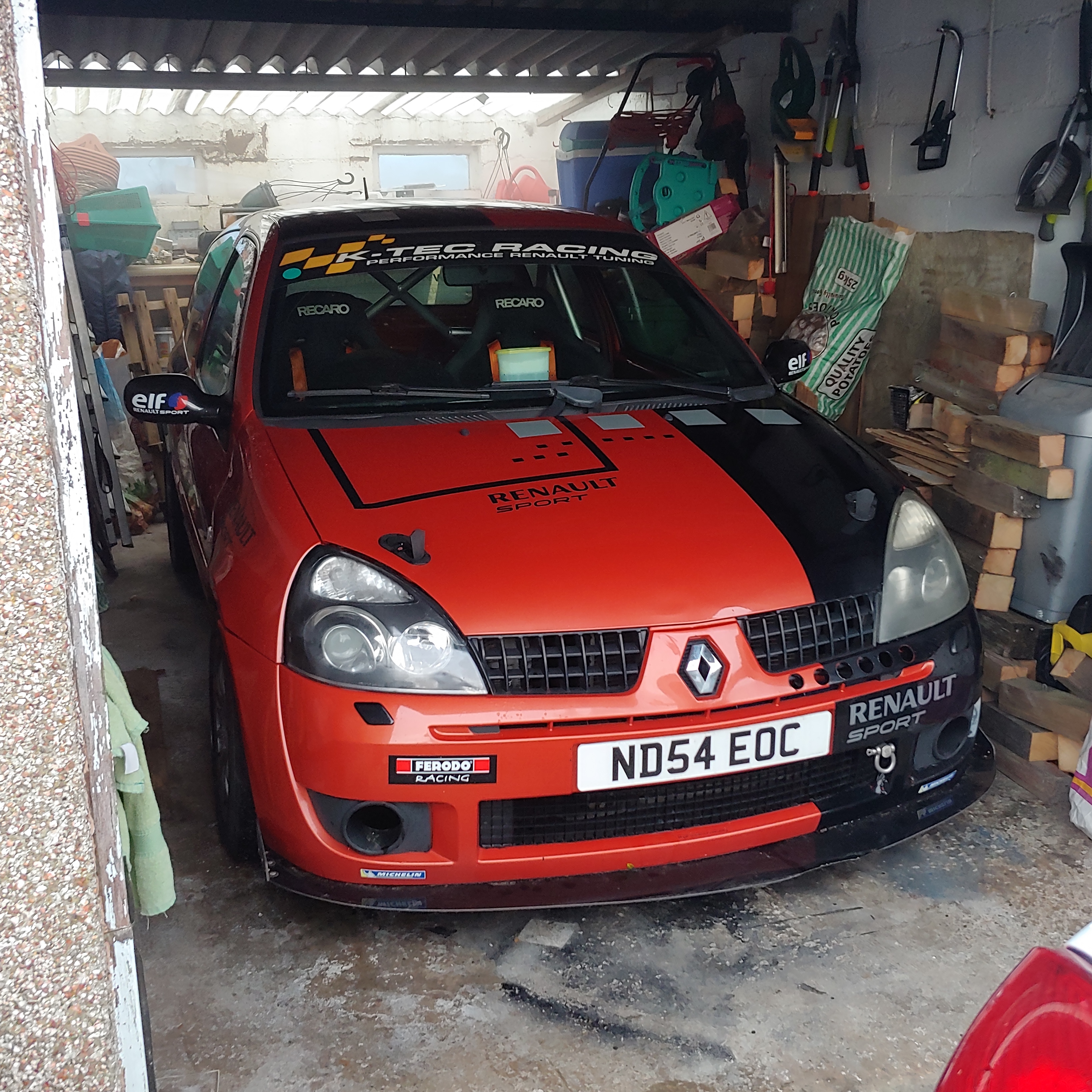

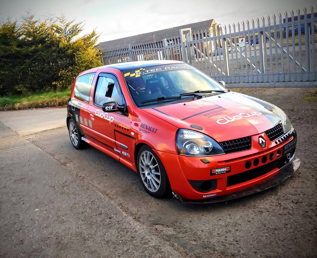

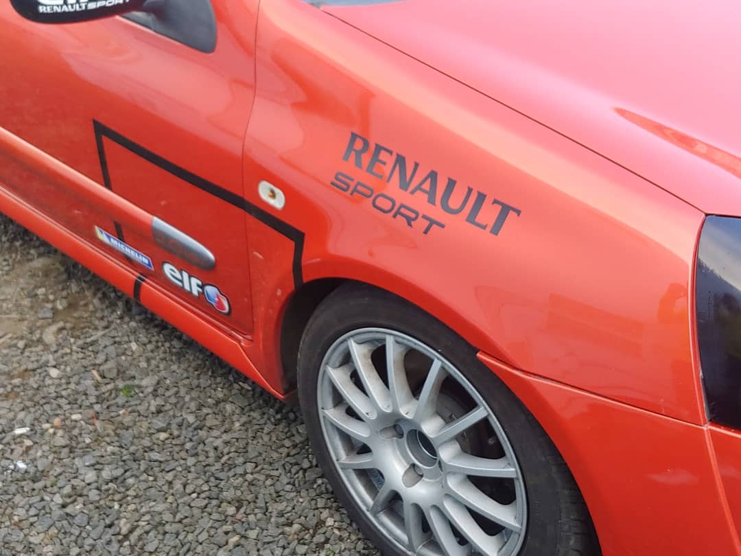

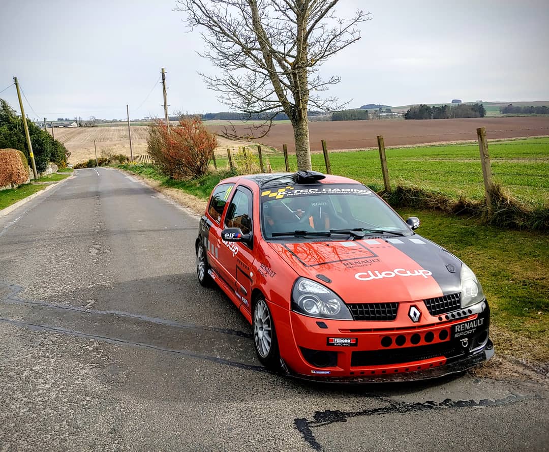

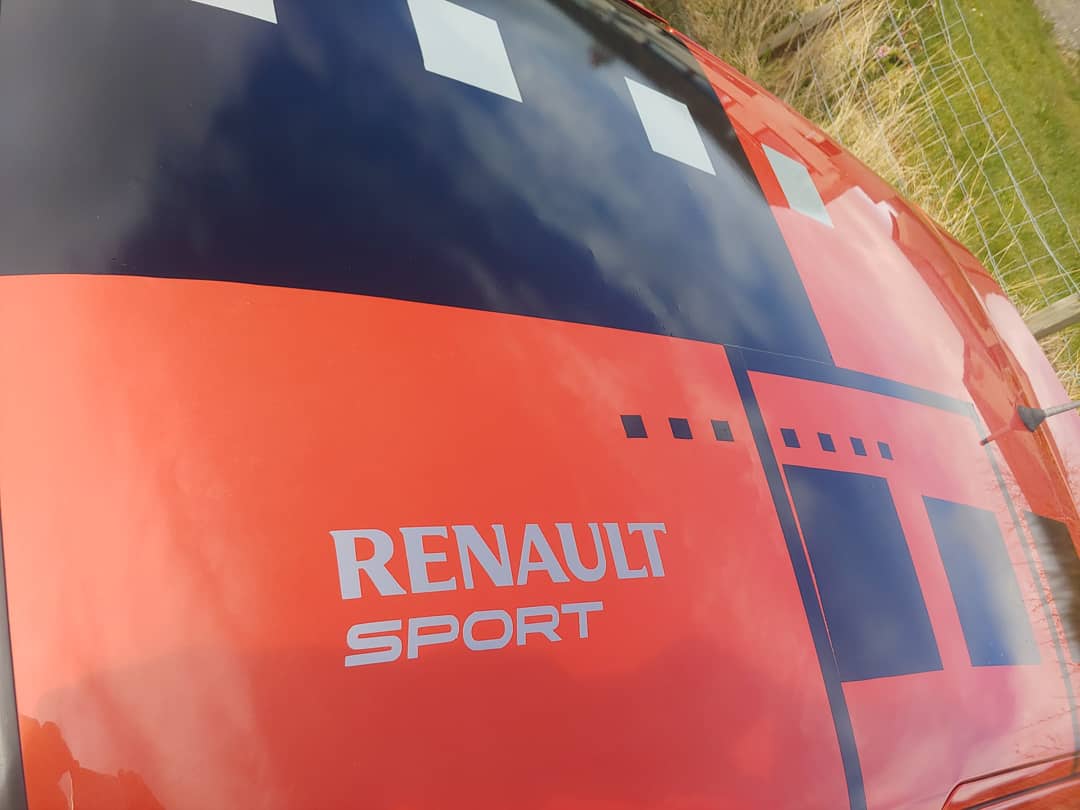

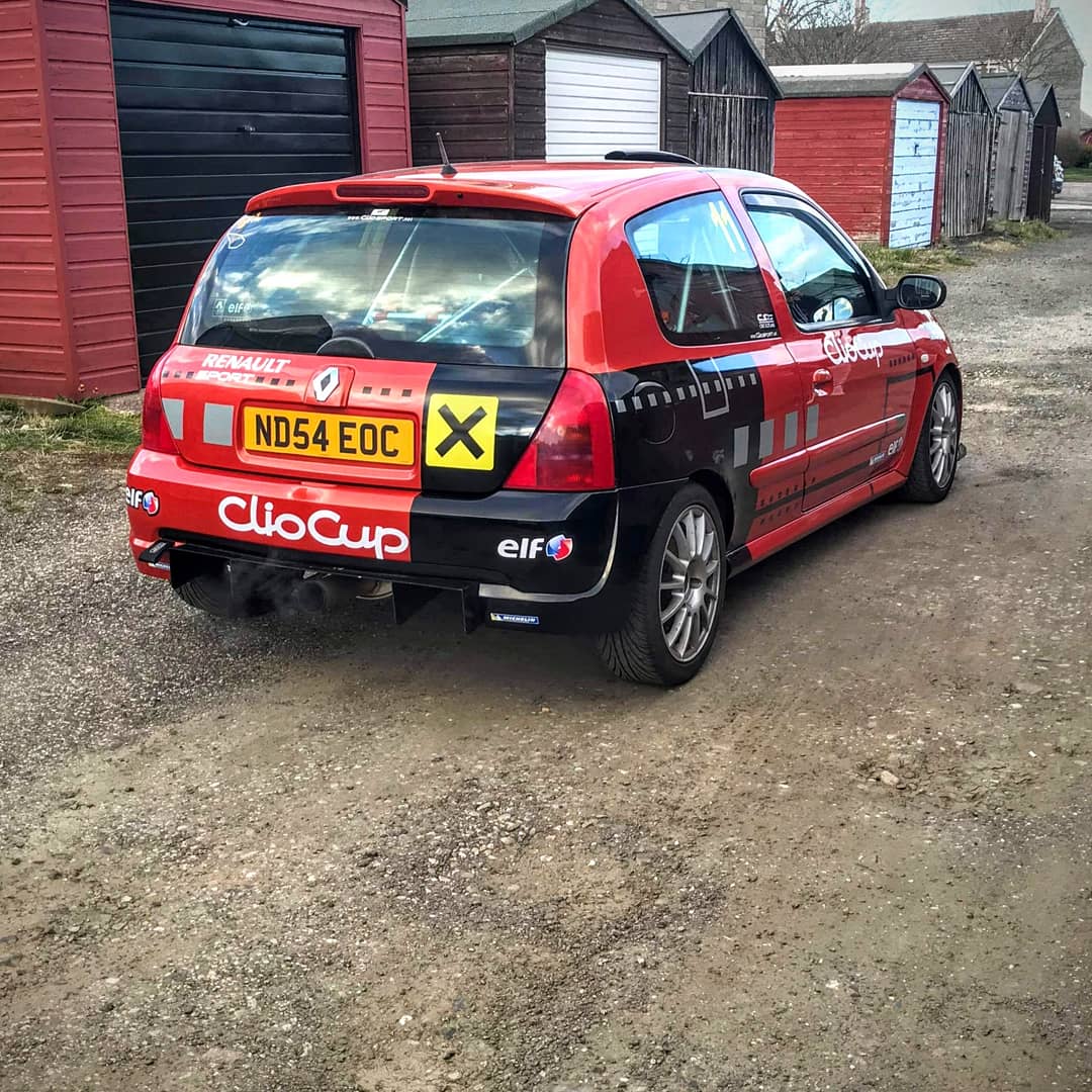

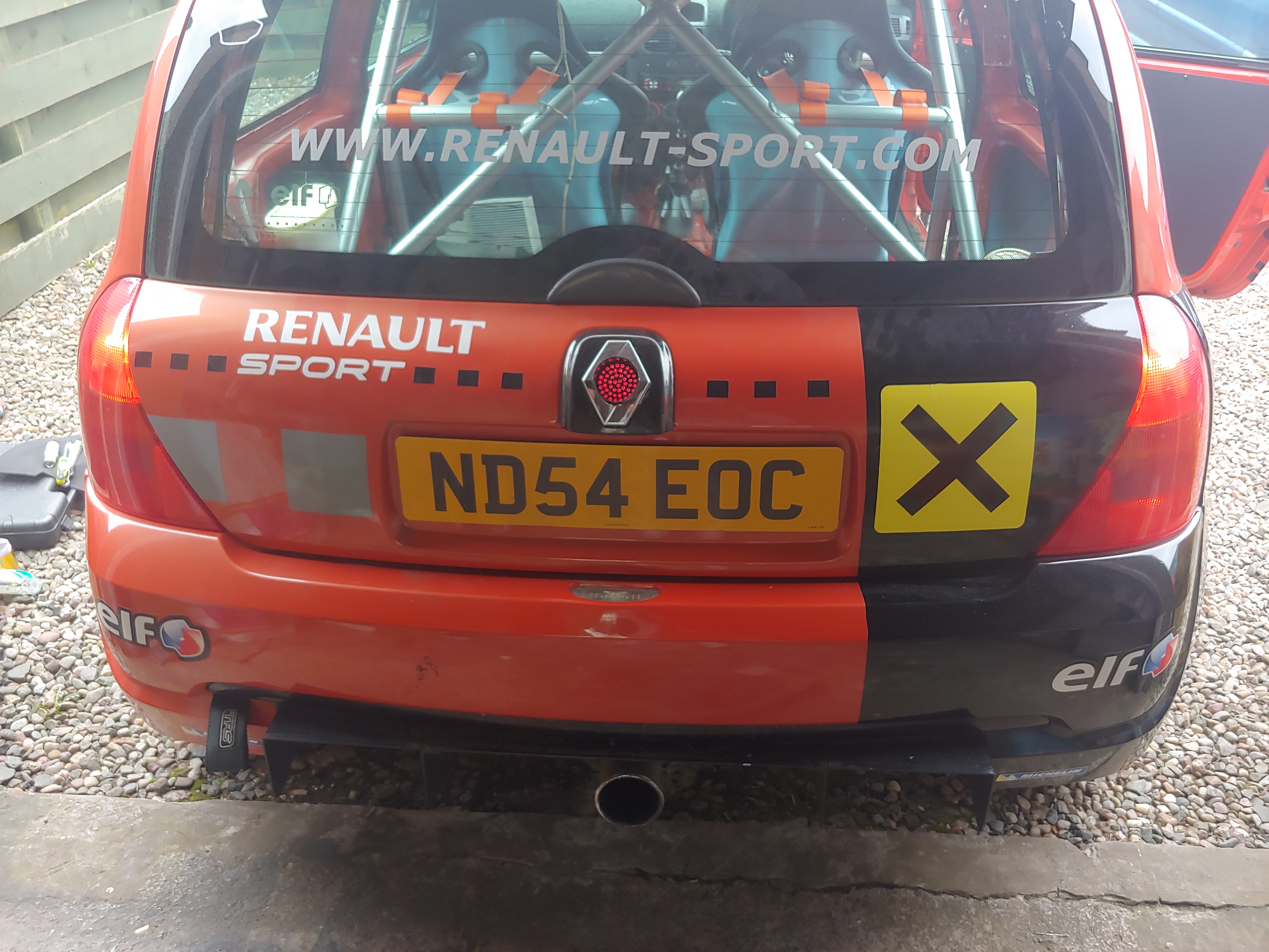

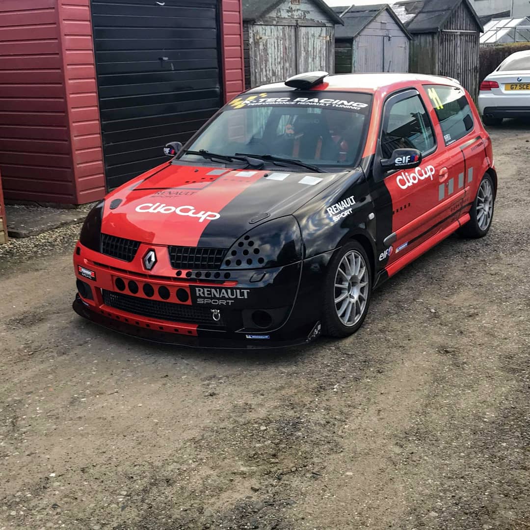

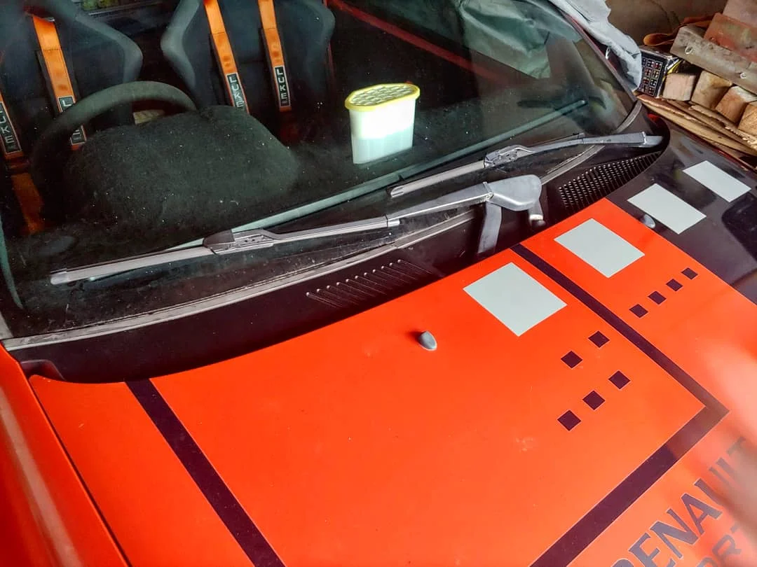

Now seei g as its going to be a track car i decided a livery was a good idea. Now i spenr ages trying to pick a design i liked. Also one od ne capable of doing. I like to do things on a budget.
So I seen pictures online of the old x65 cup racers and i absolutely loved the design!
So gave it a bash... Took around 3 days and even afterwards bits got redone etc.

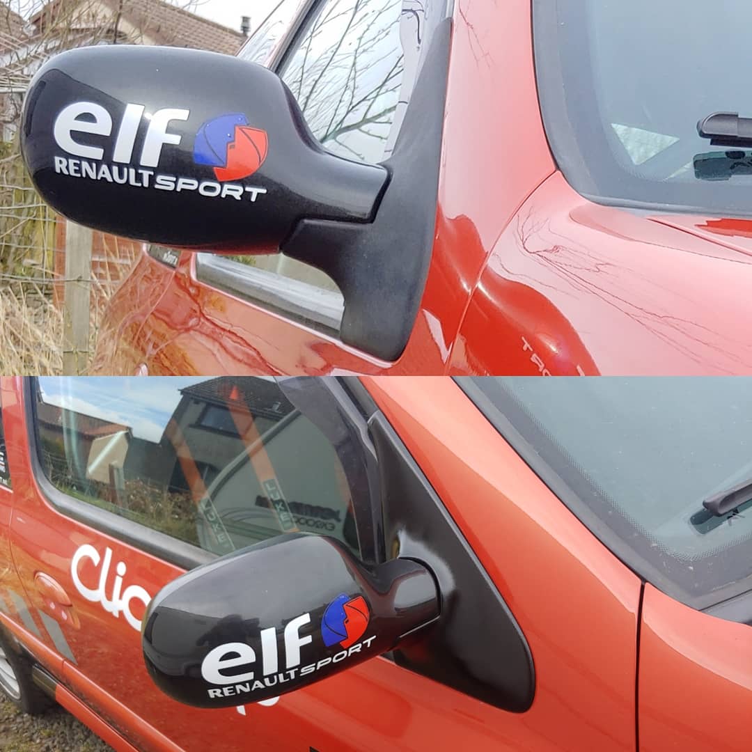

Since the livery was done I sprayed the mirror surrounds gloss black as they were faded same with the grills

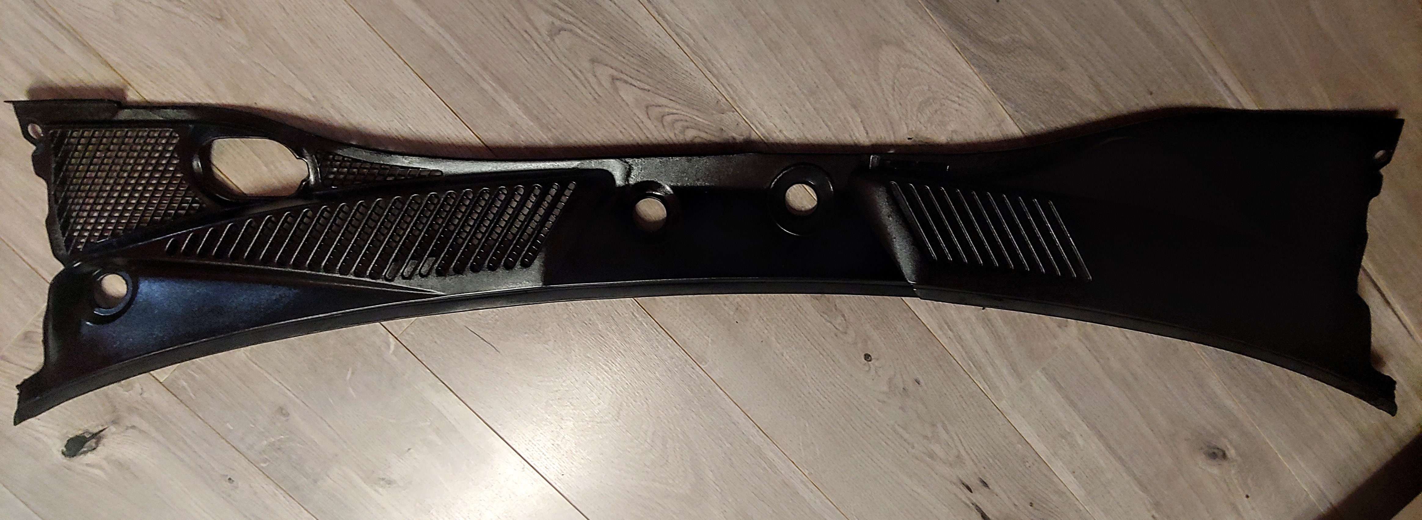

Ar the moment i have a few things off for spraying including the scuttle panel. I have this off just now as iv swapped for a smaller heater box with non aircon from a 1.2. Gets rid of the pipes and also used a non aircon bulkhead panel as well

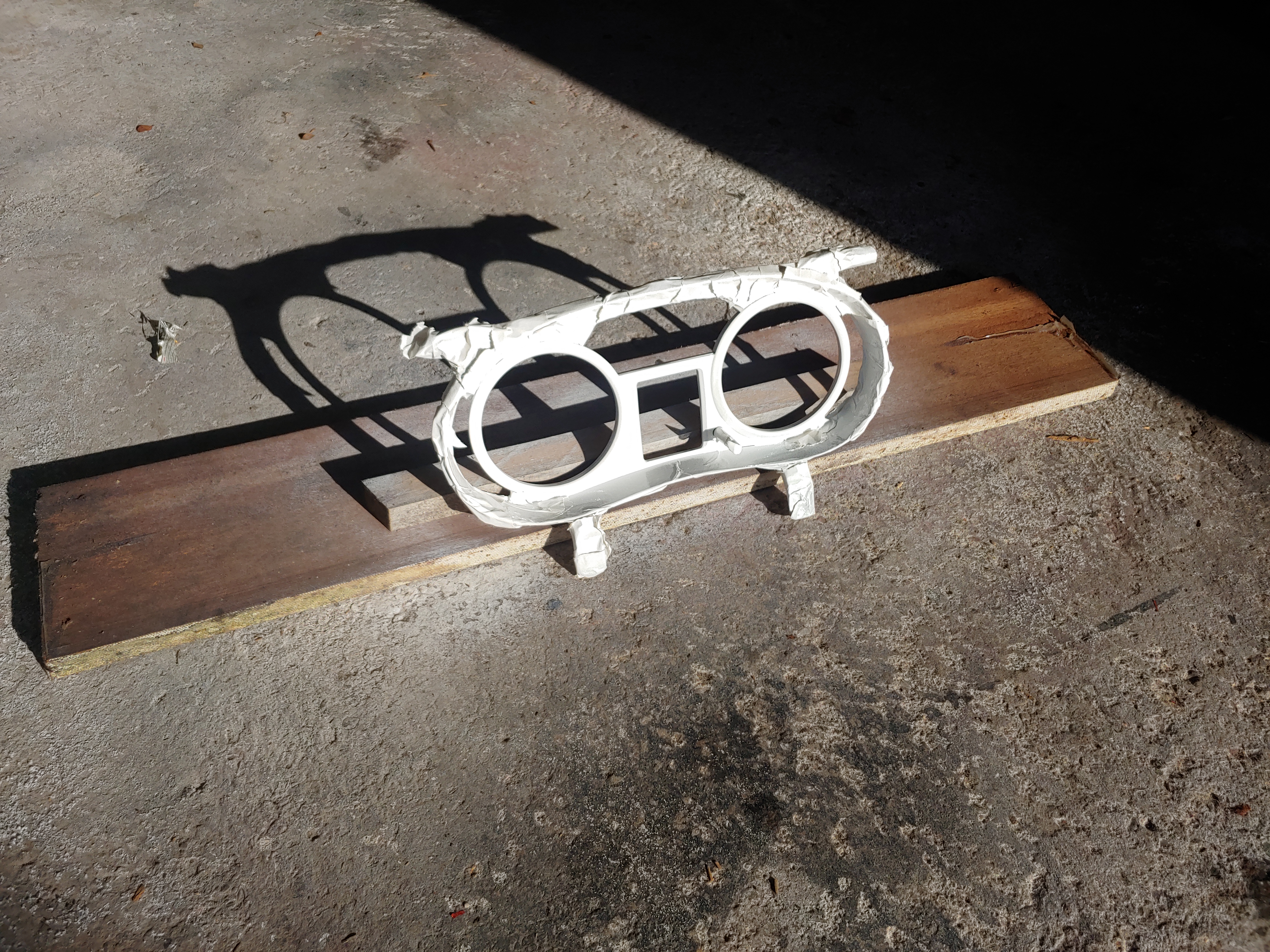

Going to be changing the interior up a bit and giving it a general tidy up. Made a start with the dash trims. Thought seeing as the shift knob is white and so are the recaro emblems and stickers on the side mounts. White will be the colour to go for. Annoyingly the cage and brace were already white until i took them out to spray silver but ach well. Another lick of paint wont be much hassle.

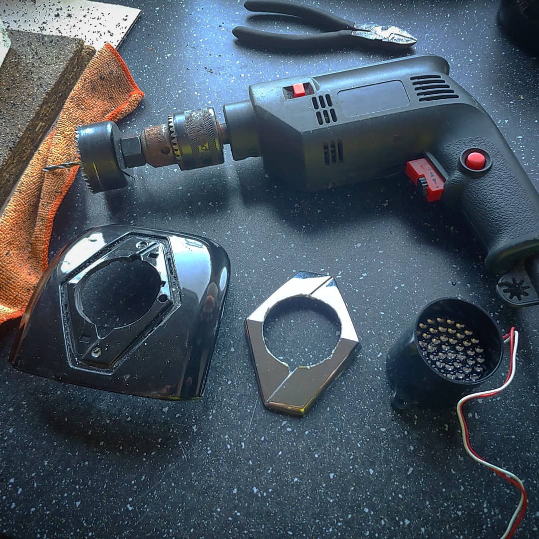

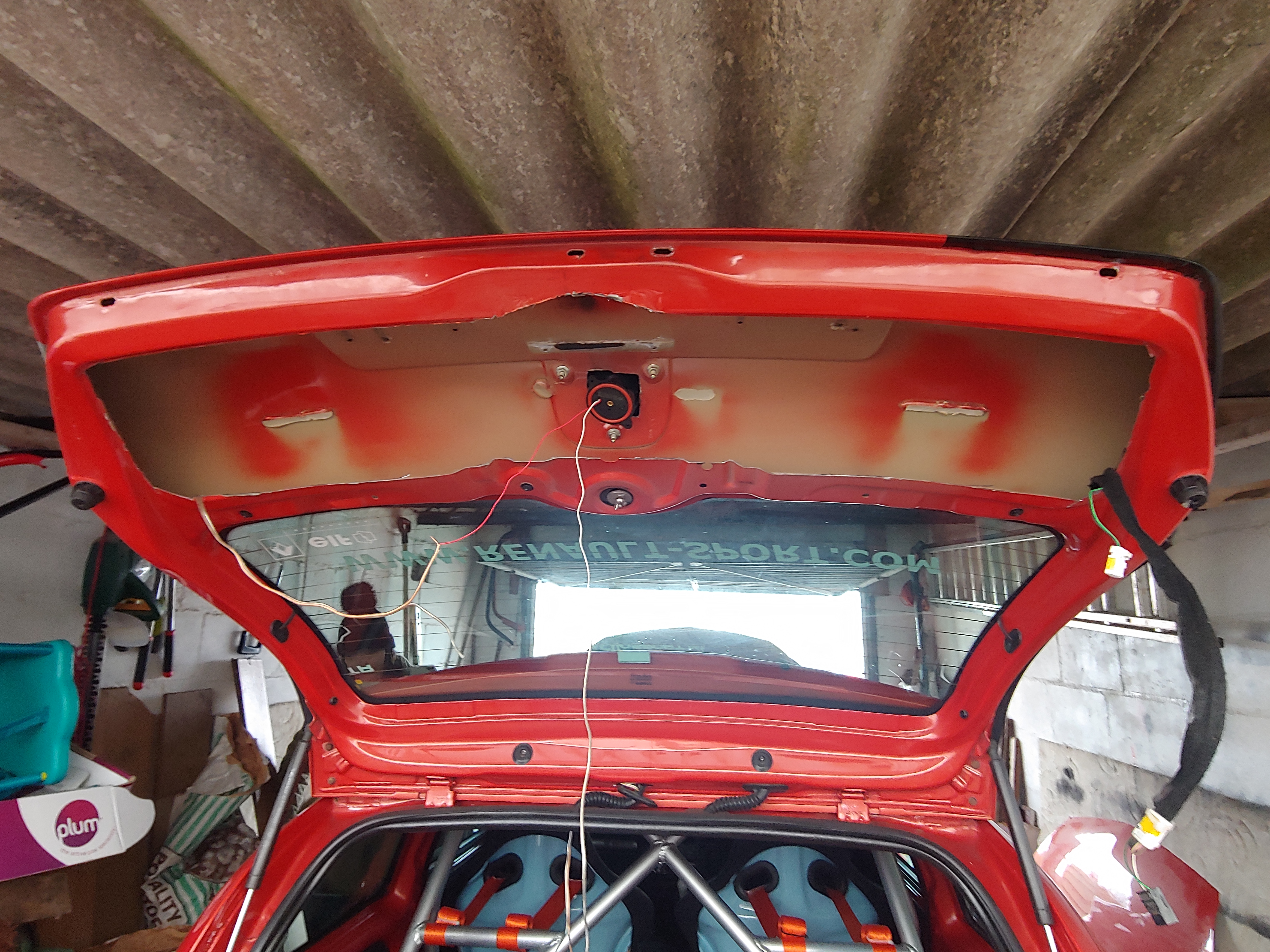

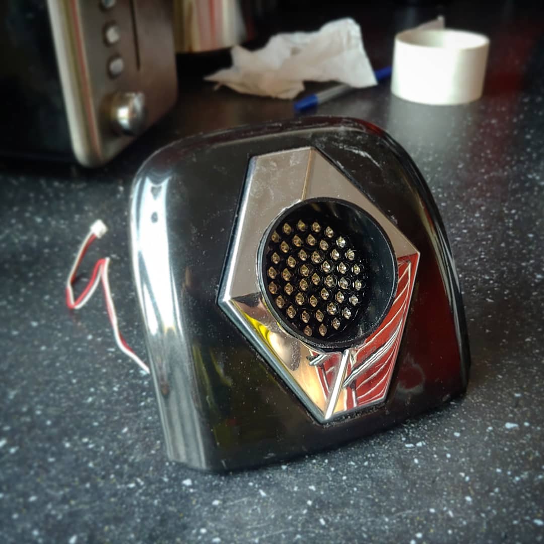

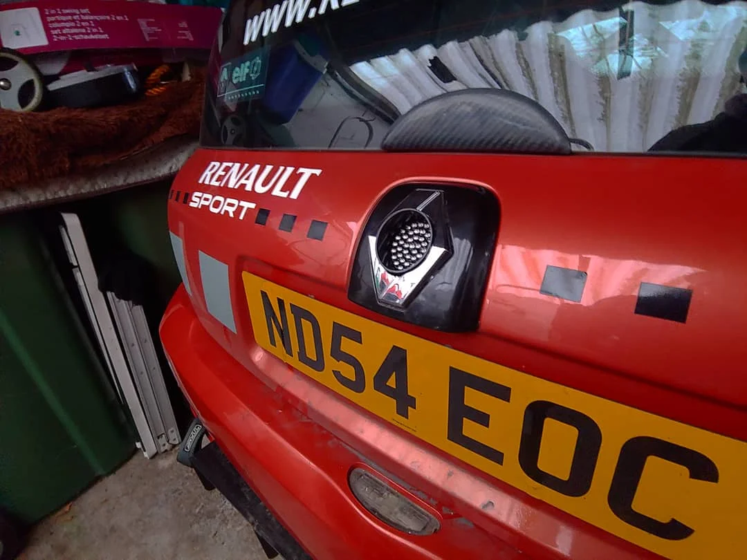

Had my rain light for a good while now and never really had anywhere to fit it. So after a quick search on google a clio popped up with the same one. Made this quick mock up before i butcher the inferno one. Think its turned out quite well 👌🏁
Just a prototype mock up, The one that will be fitted to the car i will take a lot more time with till its looks perfect
So got a chance today to fit the rain light. Quite pleased with how its turned out. Also might keep it in the black plastic. Seems to contrast well and tie in with the livery.
Had to cut some metal away from the bootlid to get the actual light to fit through. Next step is now to spend a life time trying to fiddle about getting cables down the inside of the bootlid 🙄. Never mind progress is progress

So small bit of progress made today on the Clio. Finally managed to find the time to go round to the garage and get the car outside for a change.
Unfortunatly the battery was basically dead, so car had to be pushed. Also has a flat tyre but no biggie got that re inflated.
With the car outside i now had more light to actually see what im doing and get around the car. So got back to sorting out the rain light, With a bit or perseverance and a whole amount of stress i got the cables down the inside of the bootlid, through the loom cover and into the car. For just now the rain light is just tapped into the rear foglights and unfortunatly due to the battery nearly being dead the light is a bit dim but this is pretty much the finished product. Im hoping to find some sort of resistor to make flash.

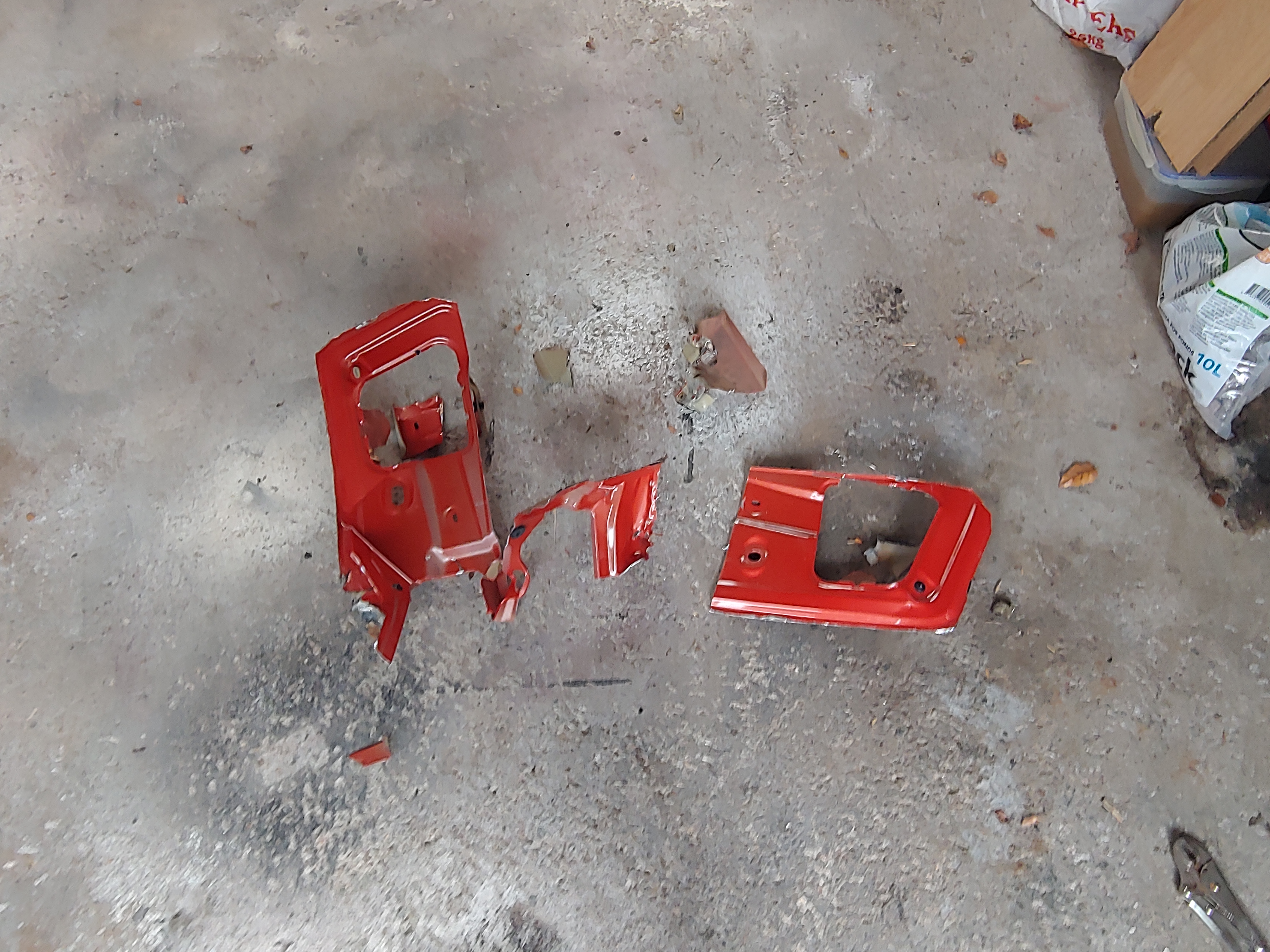

I also bought my self a new grinder and thought why not put it to use and do some gutting!
Wiring in the pic is just for it to be tested. It will all be tidied up properly so none are visible. Now for all the rough edges to be smoothed and painted.

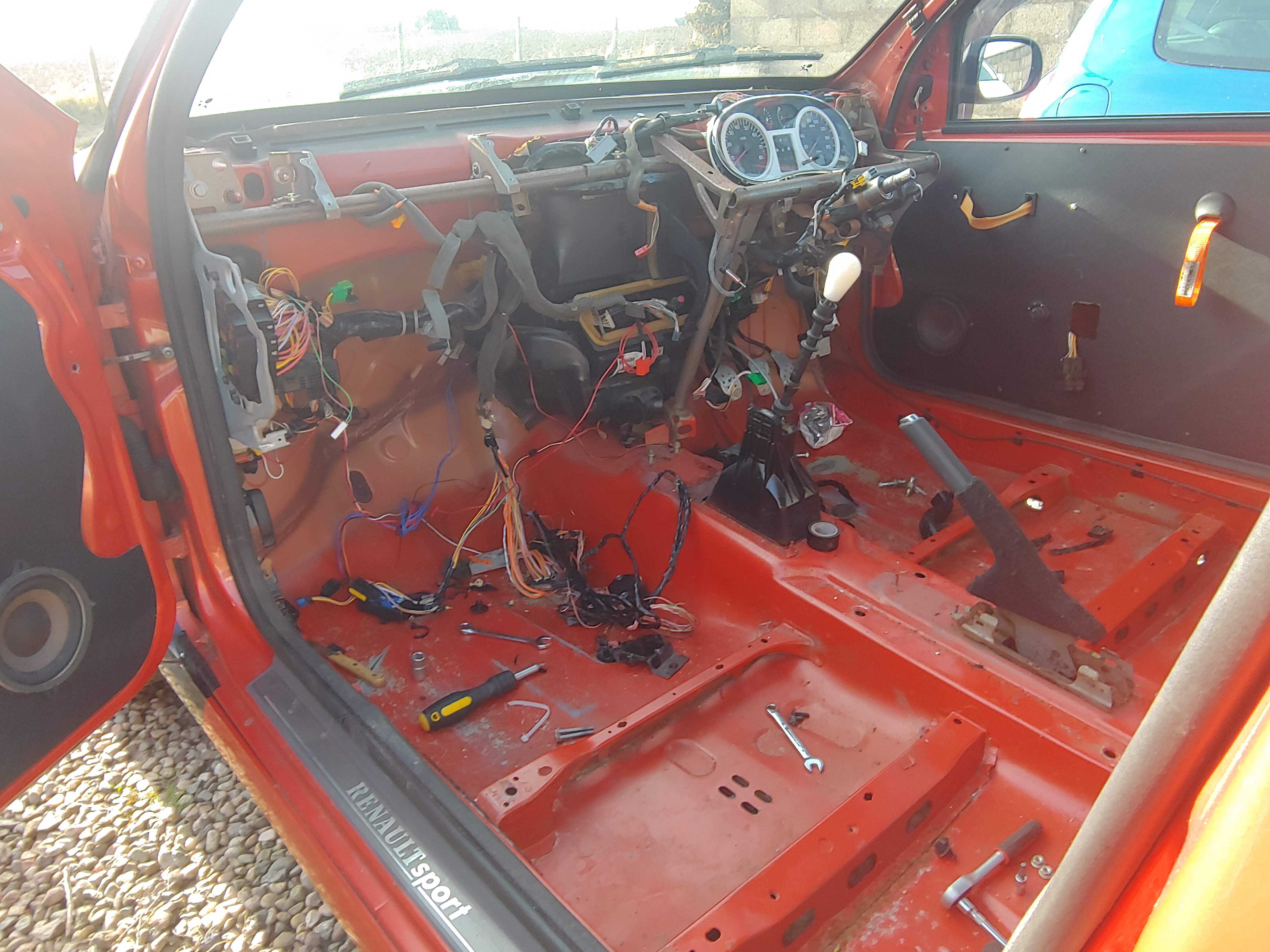

Spent a bit of time on the car today mostly wasted trying to solve an issue with the rain light which is currently unresolved 🙈 Put the recharged battery back on and started the car. Turned on the rain light and was nice and bright, working brilliantly.
So decided to tidy up the rear wiring, earthed off the rear lights earthing point and powered by bridging into the passenger side rear foglight. Now the rain light only partly lights up 🙄 So yeah, lost the head with that and moved onto removing the top of the dash to get access to removing the airbag.

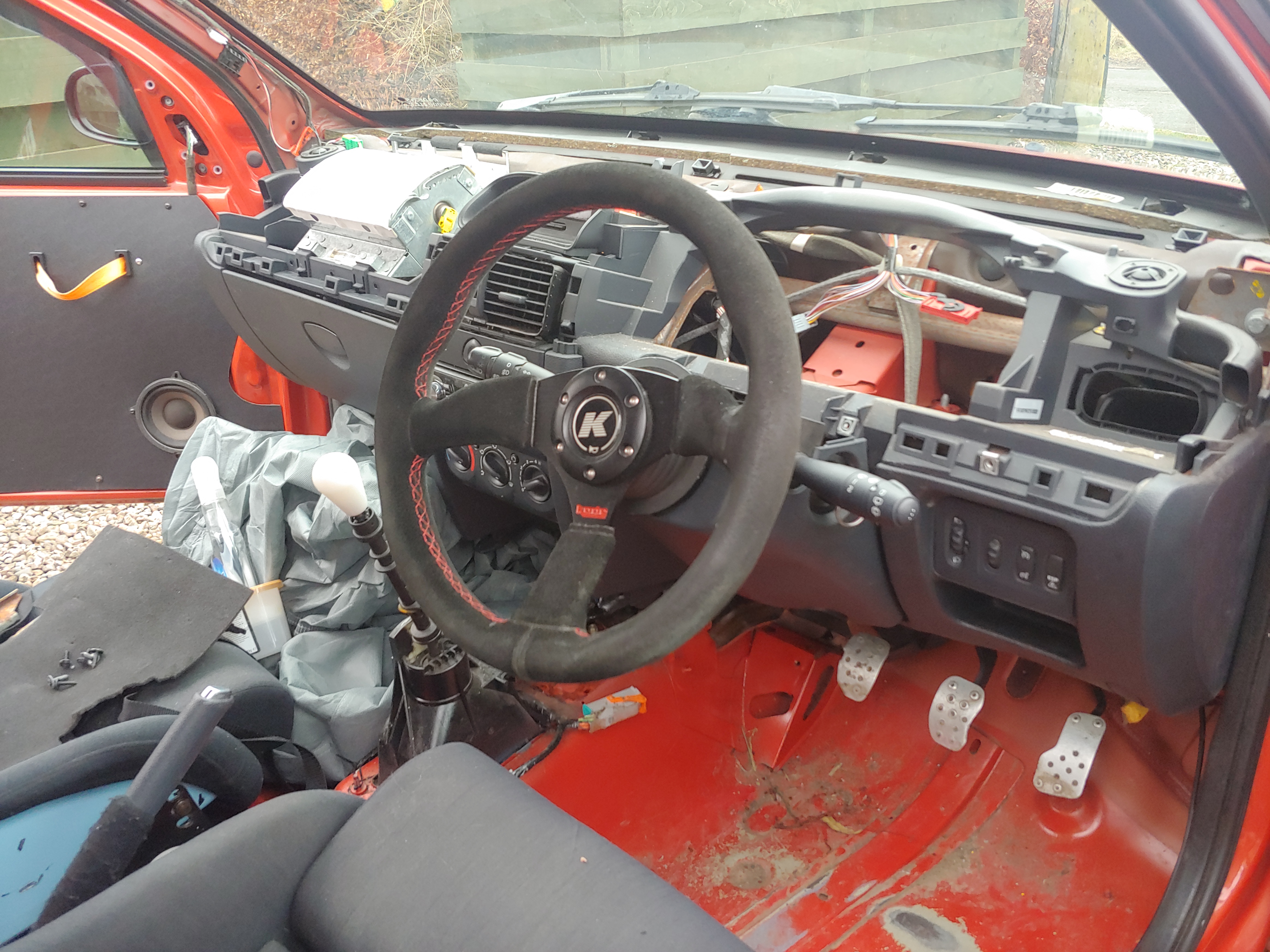

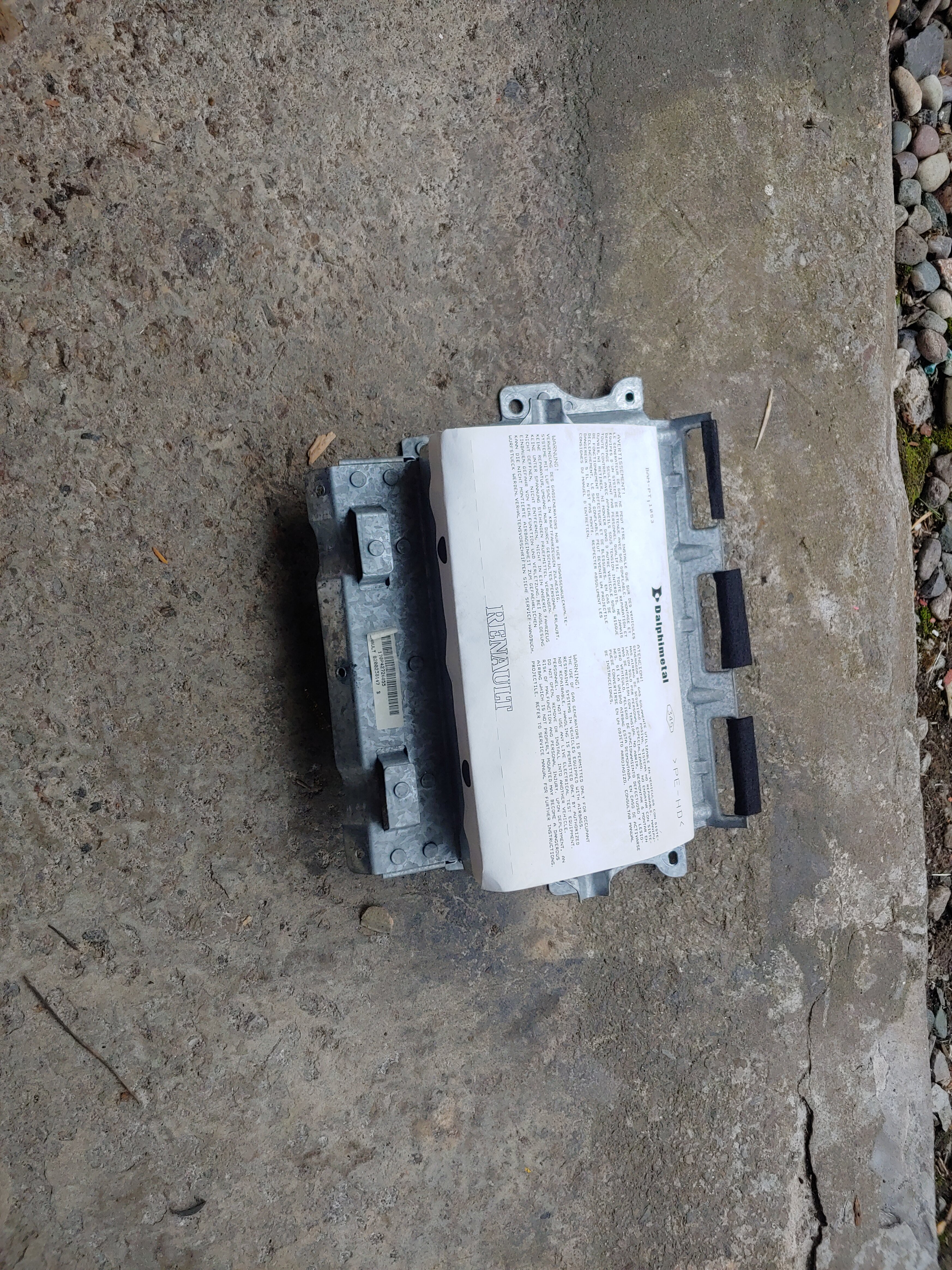

Now after disconnecting the battery and waiting 20mins so the airbag doesnt explode in my face. Decided to get the dials out and give them a bit of a spray to match the freshly painted dash trims.

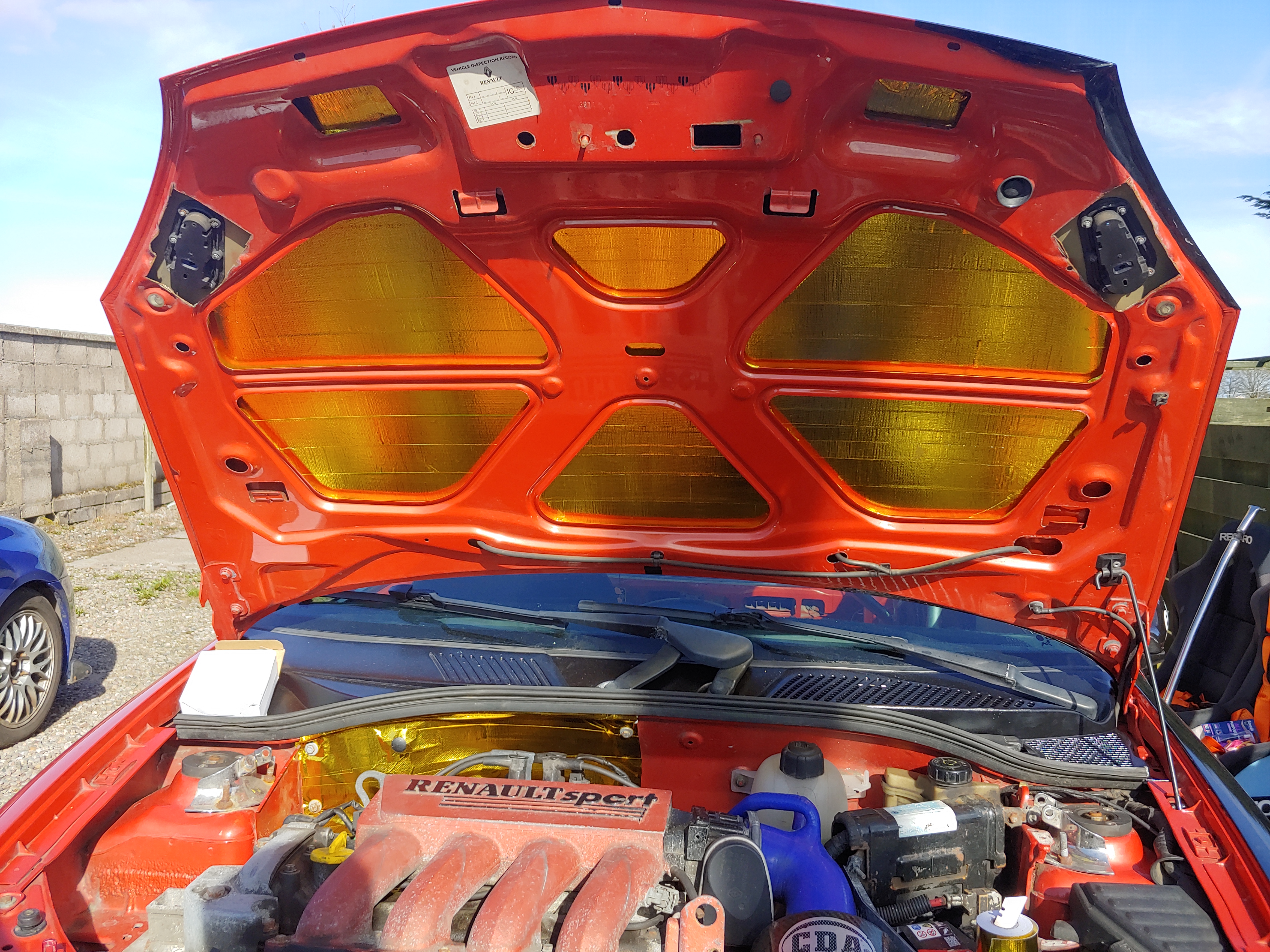

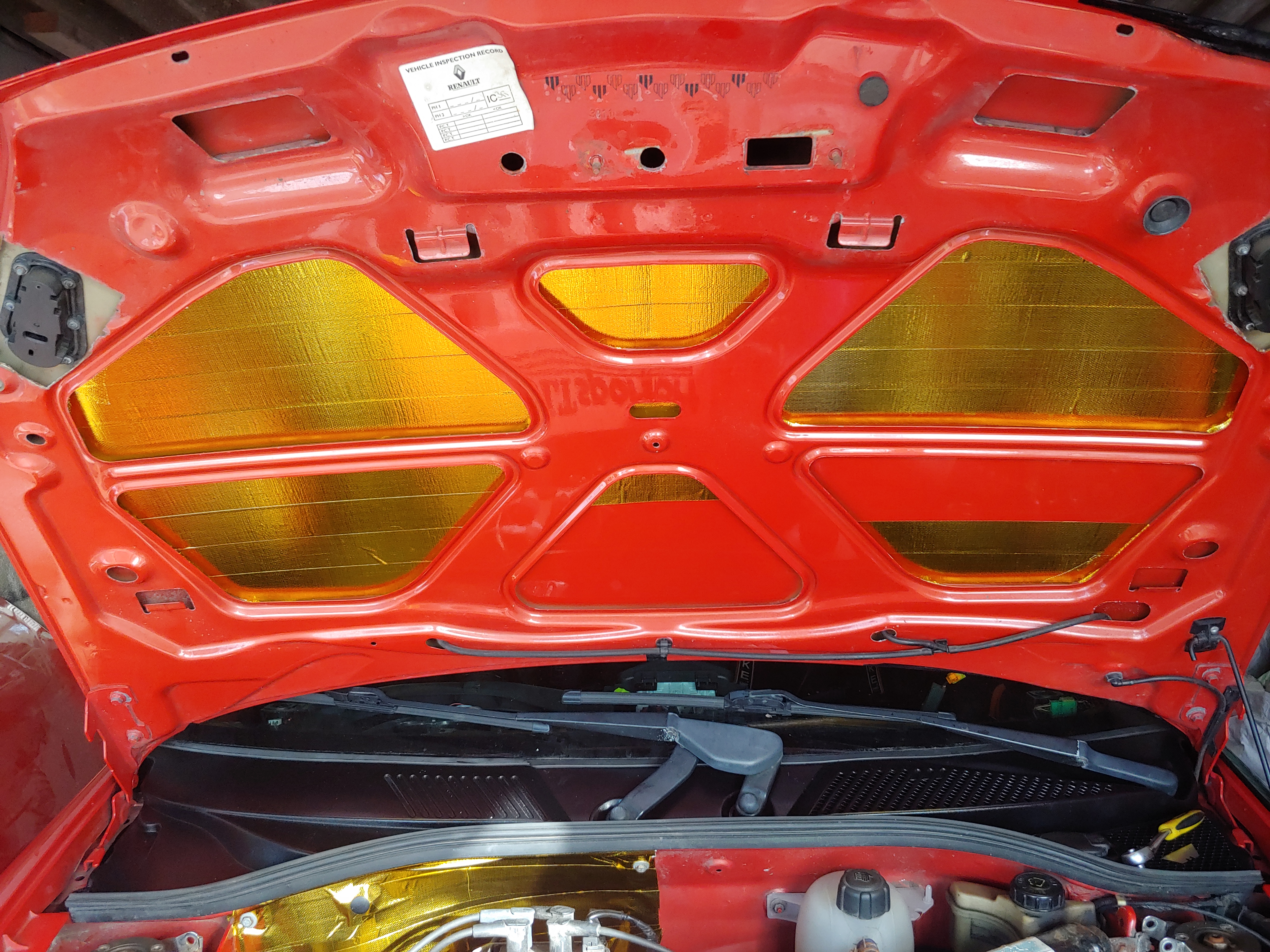

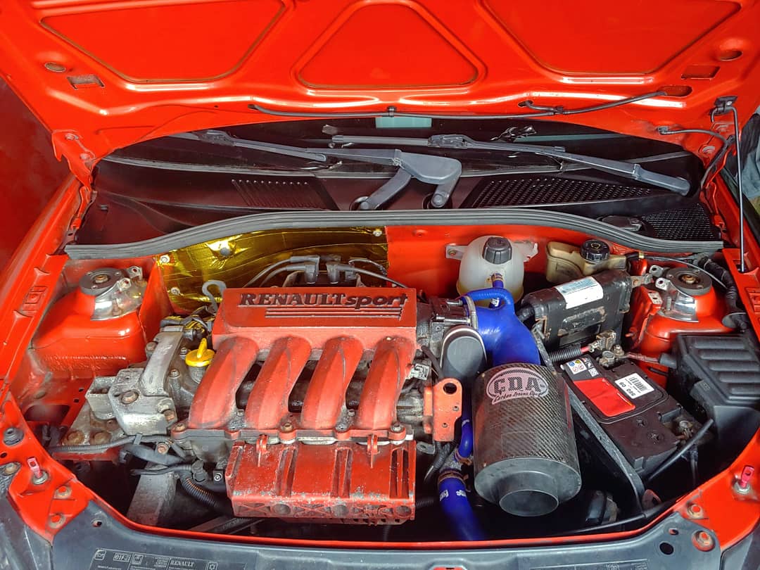

Also made more progress with the heat tape under the bonnet... Unfortunately ran out of tape before i finished though 😂😂. Never mind more on order 👌
So anyway. Got the airbag removed, Also removed the airbag ecu and made a start to sorting some wiring out. Got some of the bolts out for removing the lower dash also so i get all the airbag wiring out and the horrid sticky sound deadening.
Thats about it for today. Also are the side impact sensors removable without causing issue? Or will they need to be kept in. Same with the cable that runs to the handbrake. Im guessing thats just for the light on the dash to luminate. Im guessing this can also be removed?

Why do you put the heat tape in the bonnet? You want to keep the heat inside the engine bay?
In all honesty i was questioning my self the same thing whilst doing it. But to be honest I have seen it done on other cars and thought it was quite smart looking. I will however be heat taping the underside of the intake plenum and also round the air filter area once i change my set up.

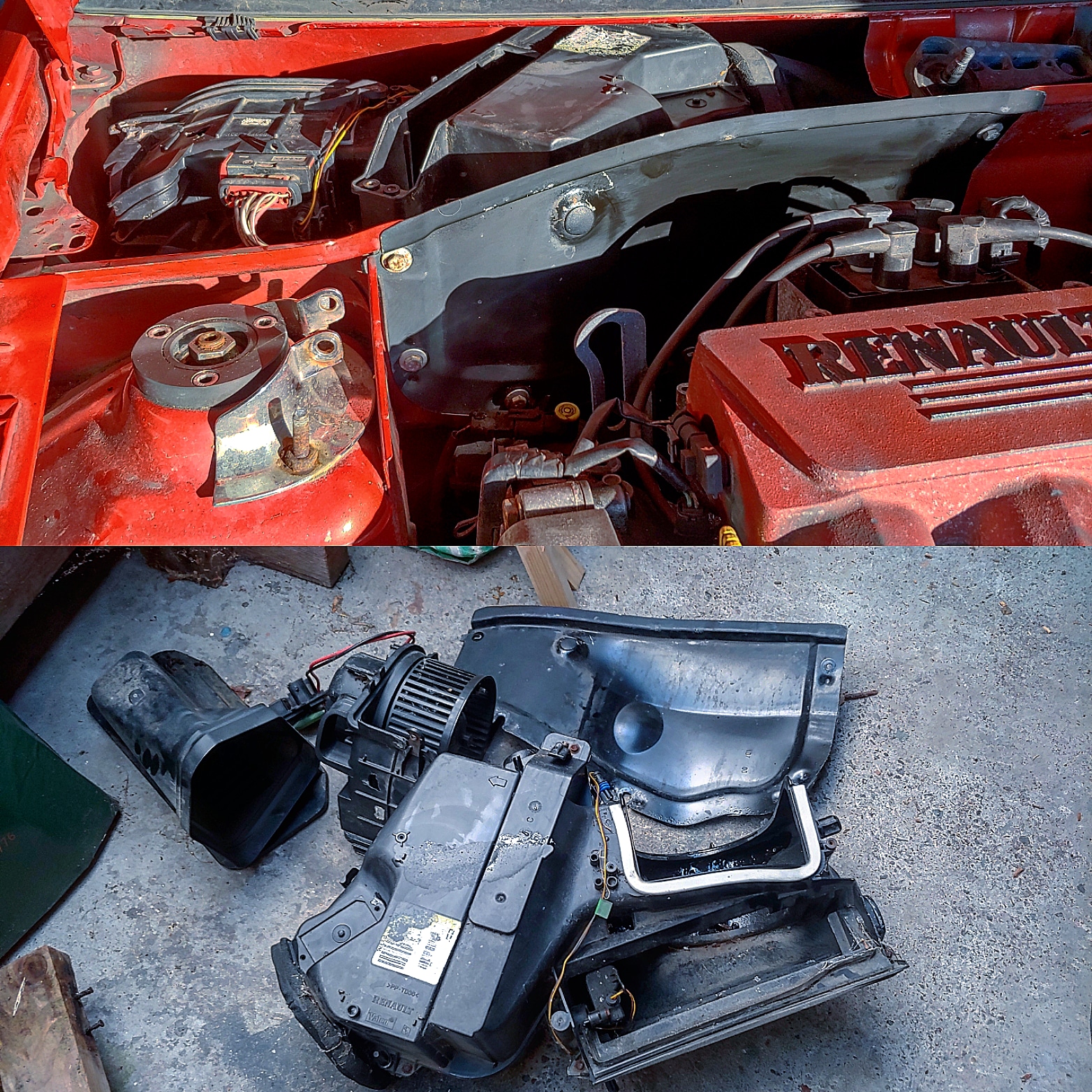

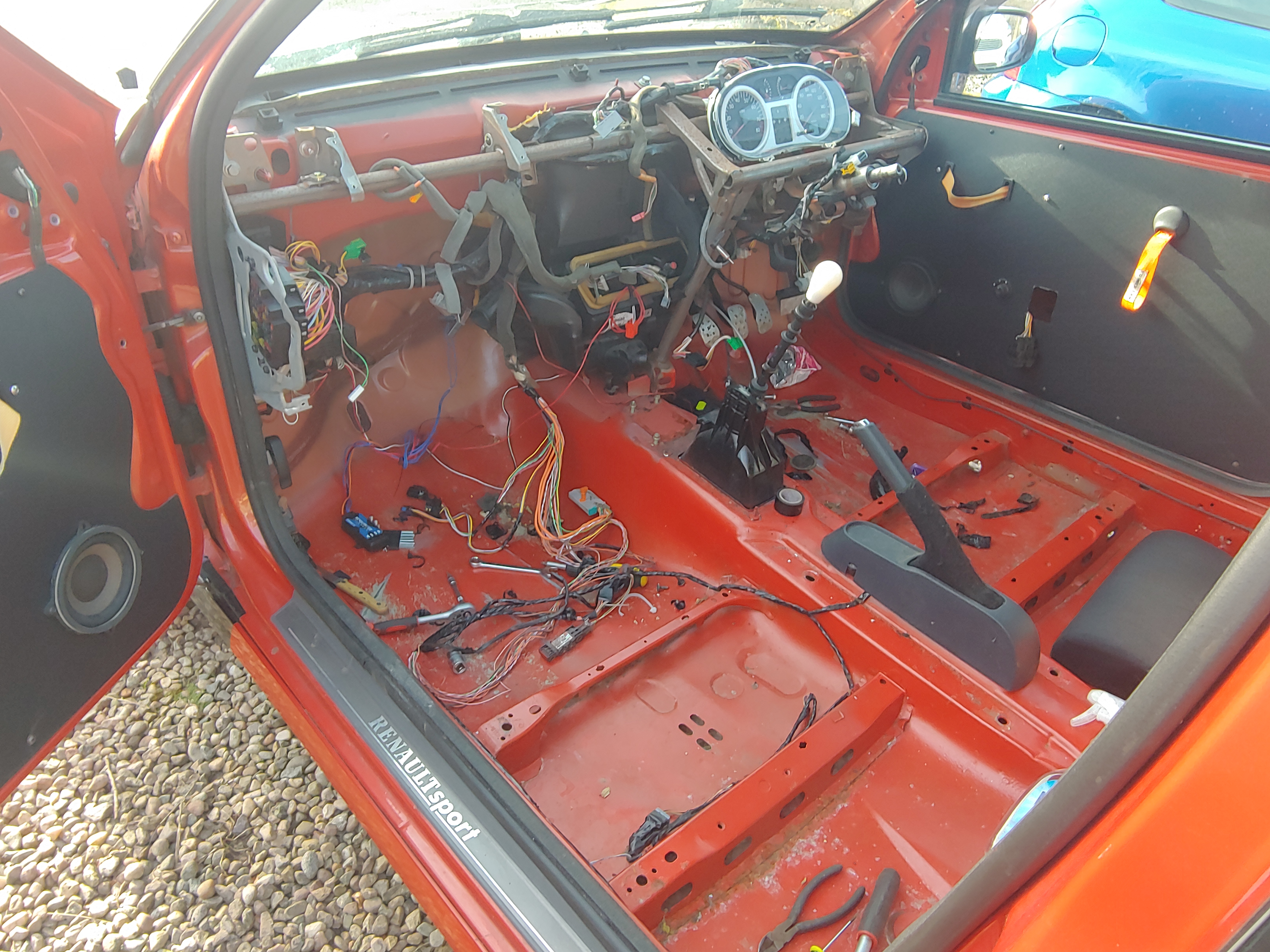

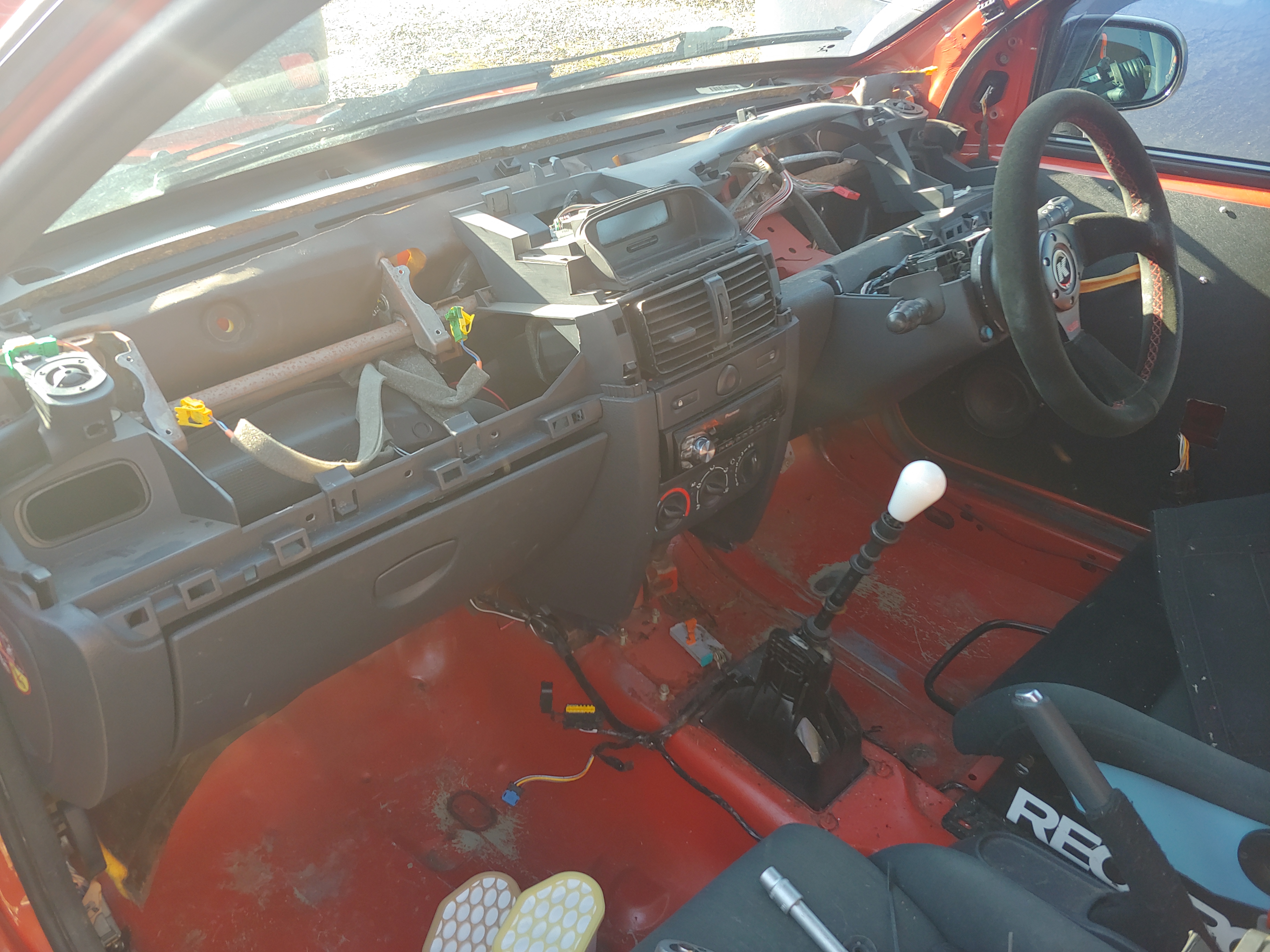

A bit more work been done to the clio over the past few days, safe to say i never want to go through the bother of removing that foam padded sound deadening behind the dash 😂 What a mare that was getting the lower dash out and then re fitted.
Whilst i was under there though i tidied up the wiring and removed the airbag. Imo its looking much neater and tidier.
Set about getting the lower dash back in. A bit fiddly but eventually for there after a while of shouting and swearing at it 😂
Then was onto the top half... After about half an hour of trying to get the heater controls to sit back in properly. All back together and all the freshly painted dials and dash trims fitted. Really liking the white accents. Next to do white will be the backs of the recaros and the cage and brace.
Git round to completing the gold tape on the underside of the bonnet too. (Just for looks really) i will be gold taping some bits in the bay though so the tape will be used purposefully.
And heres how she now stands.

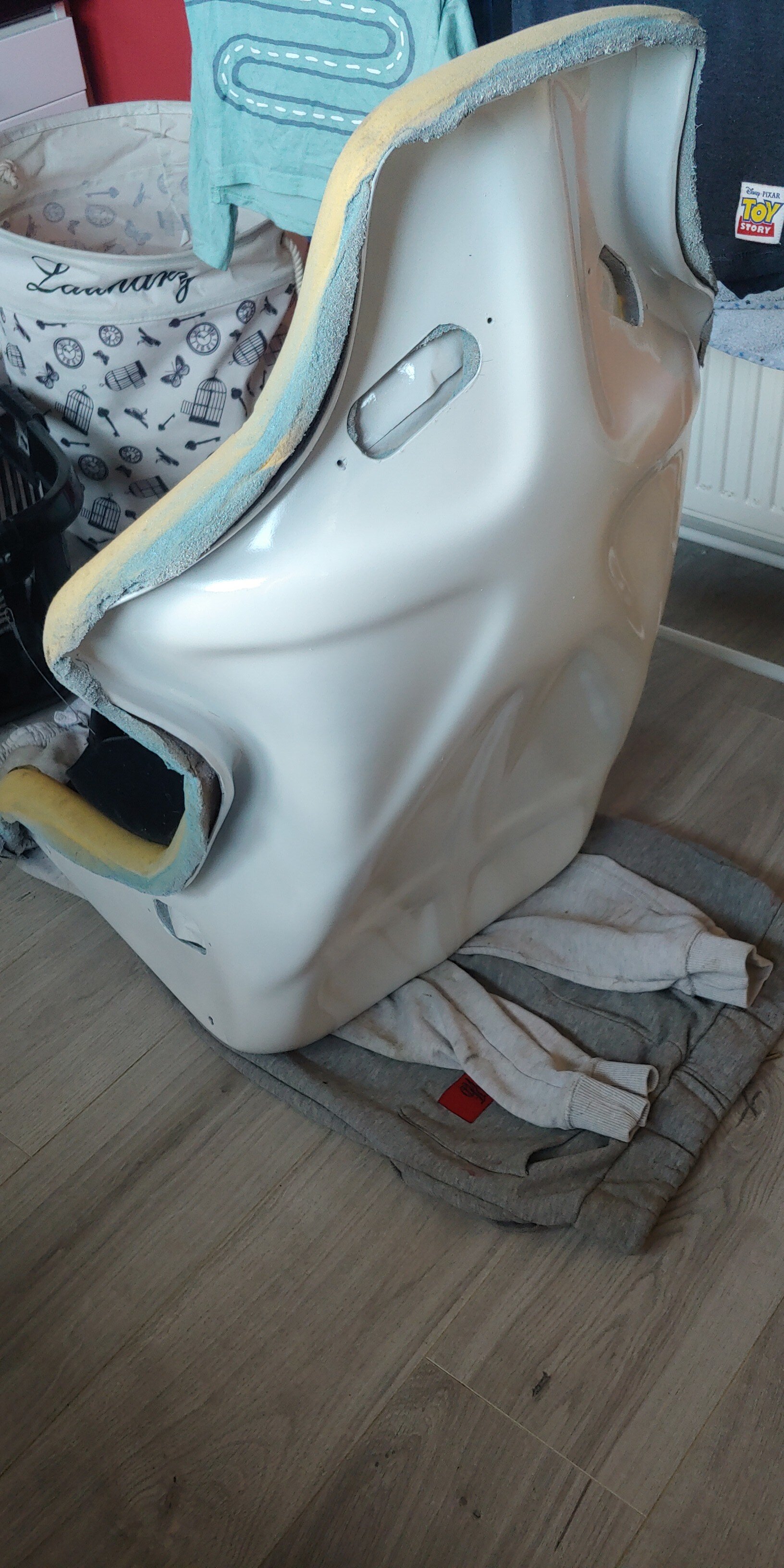

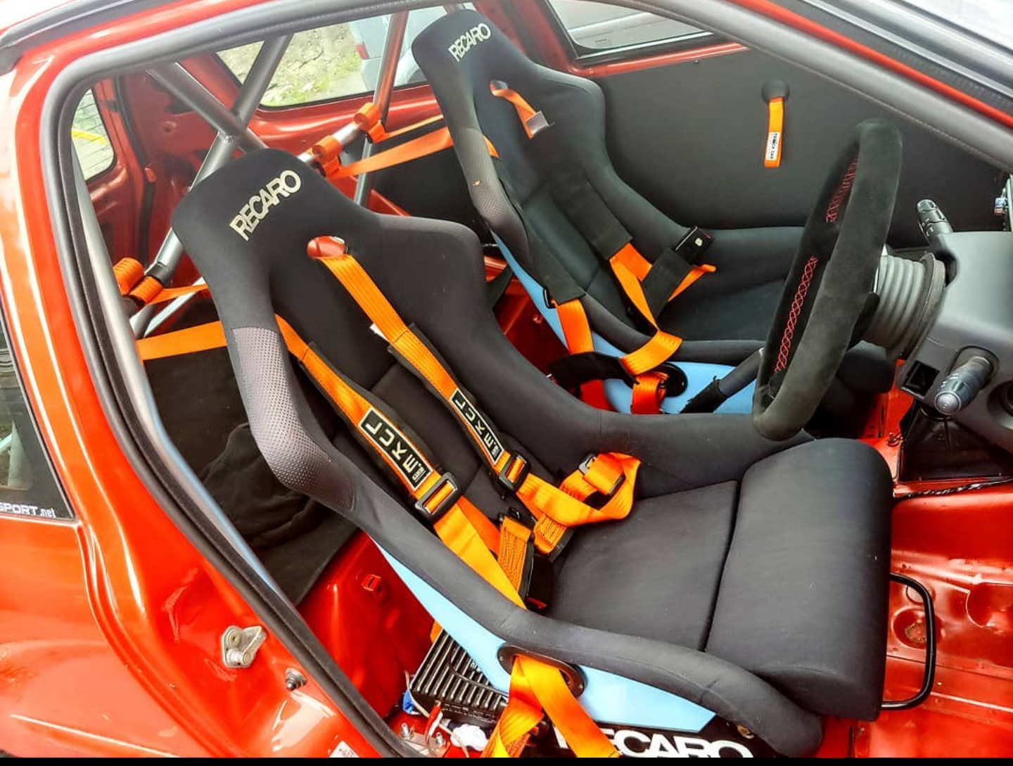

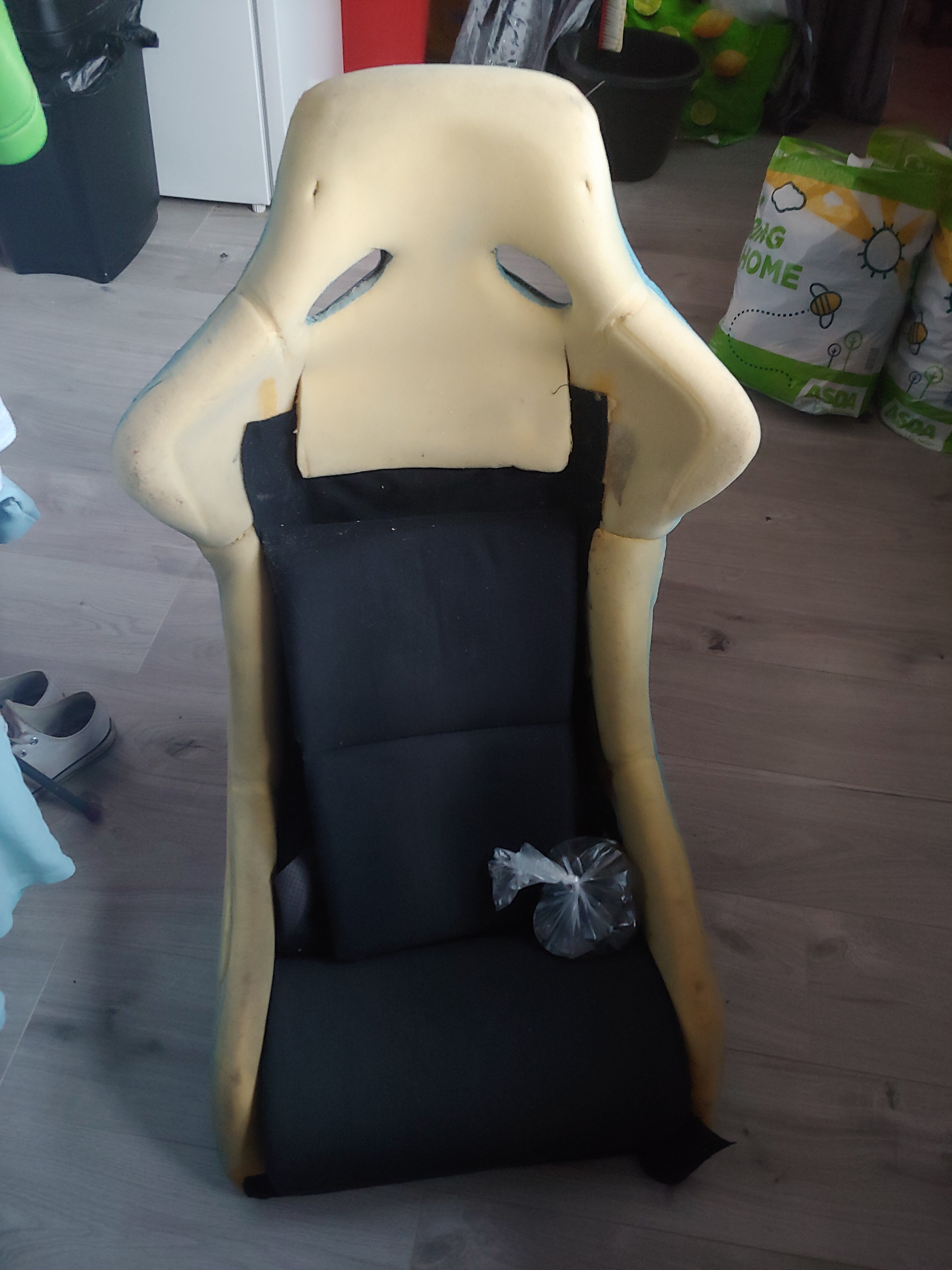

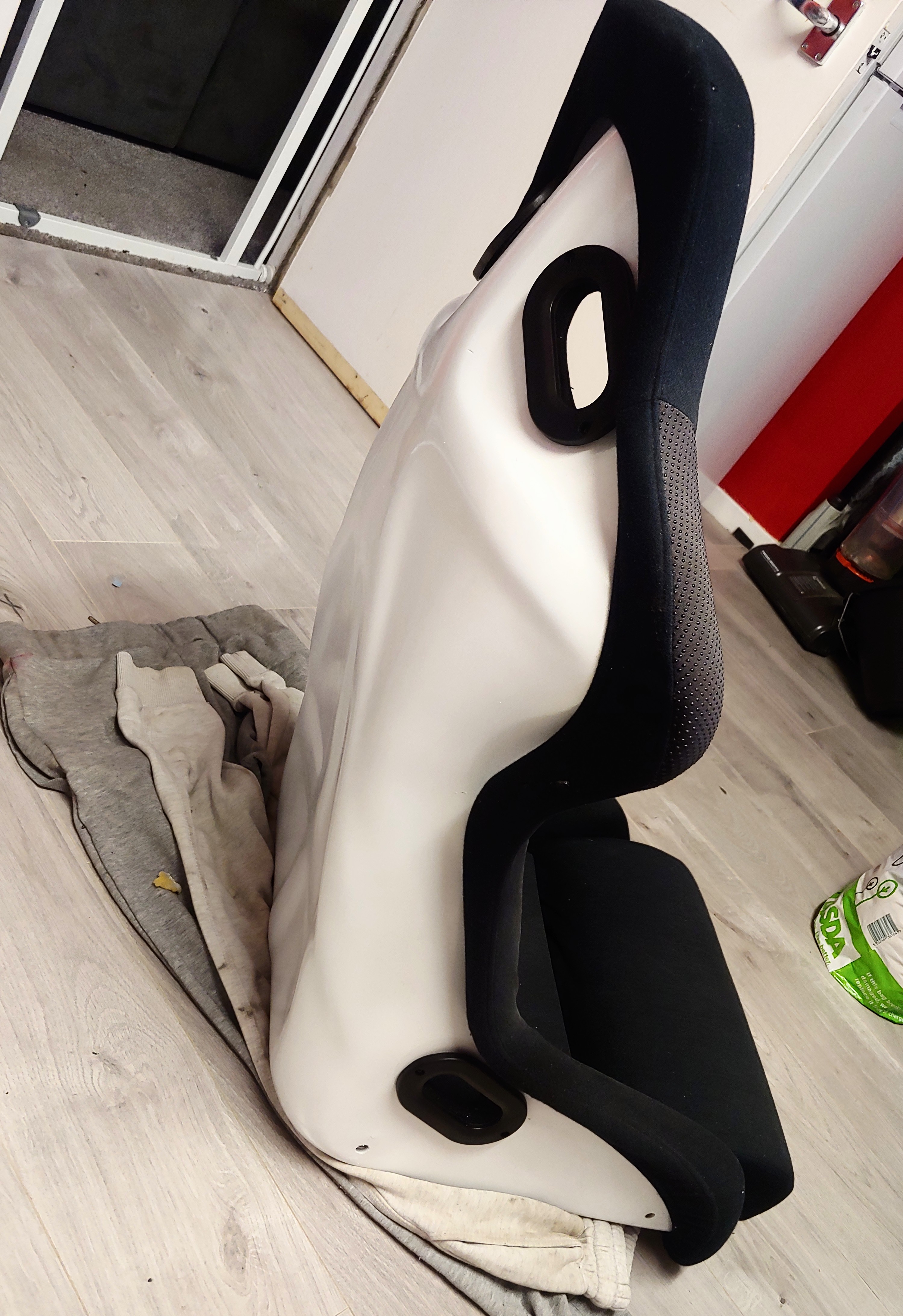

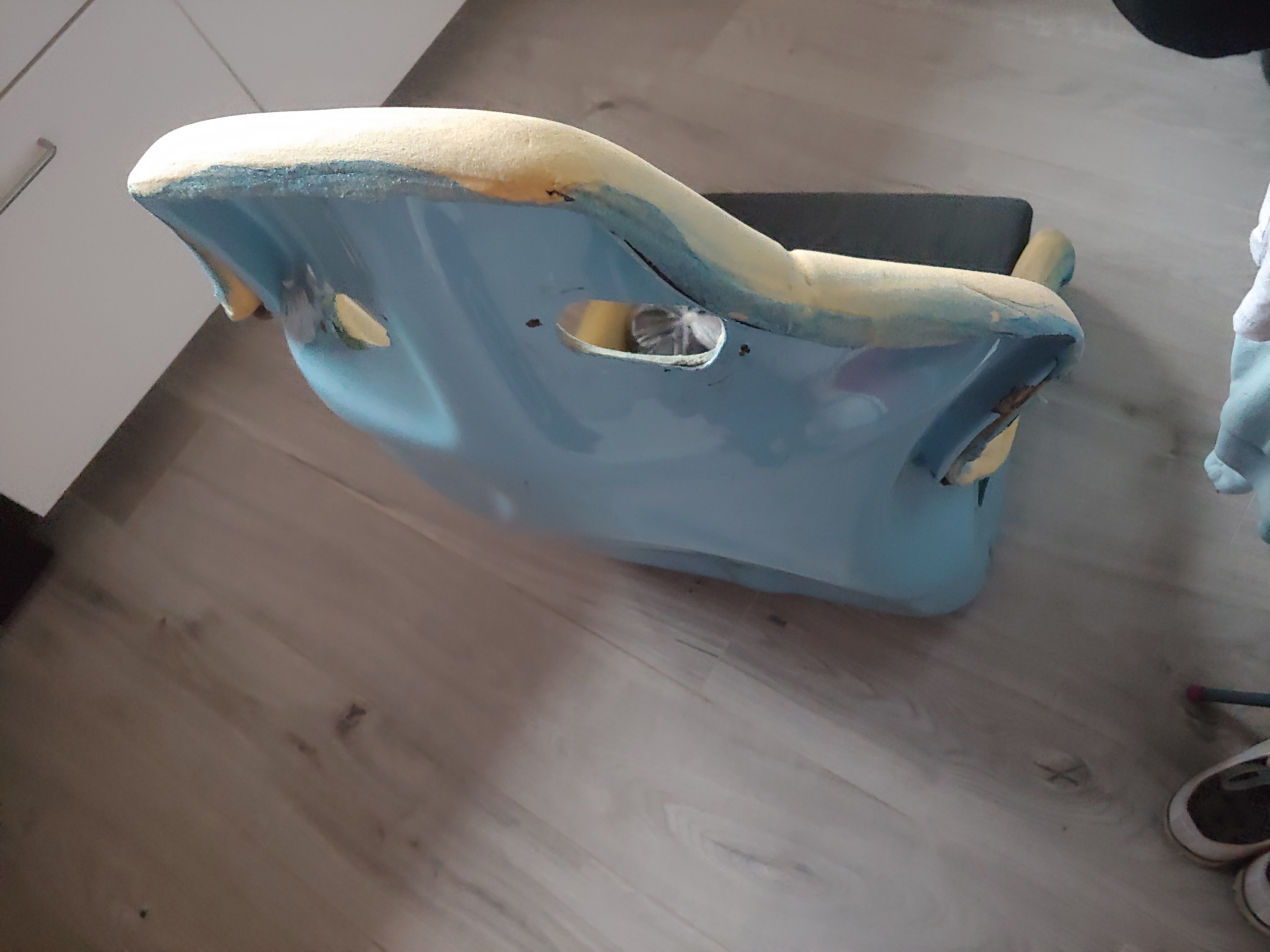

The seats were always doing my head in in the clio, The blue just did not tie in with anything at all.

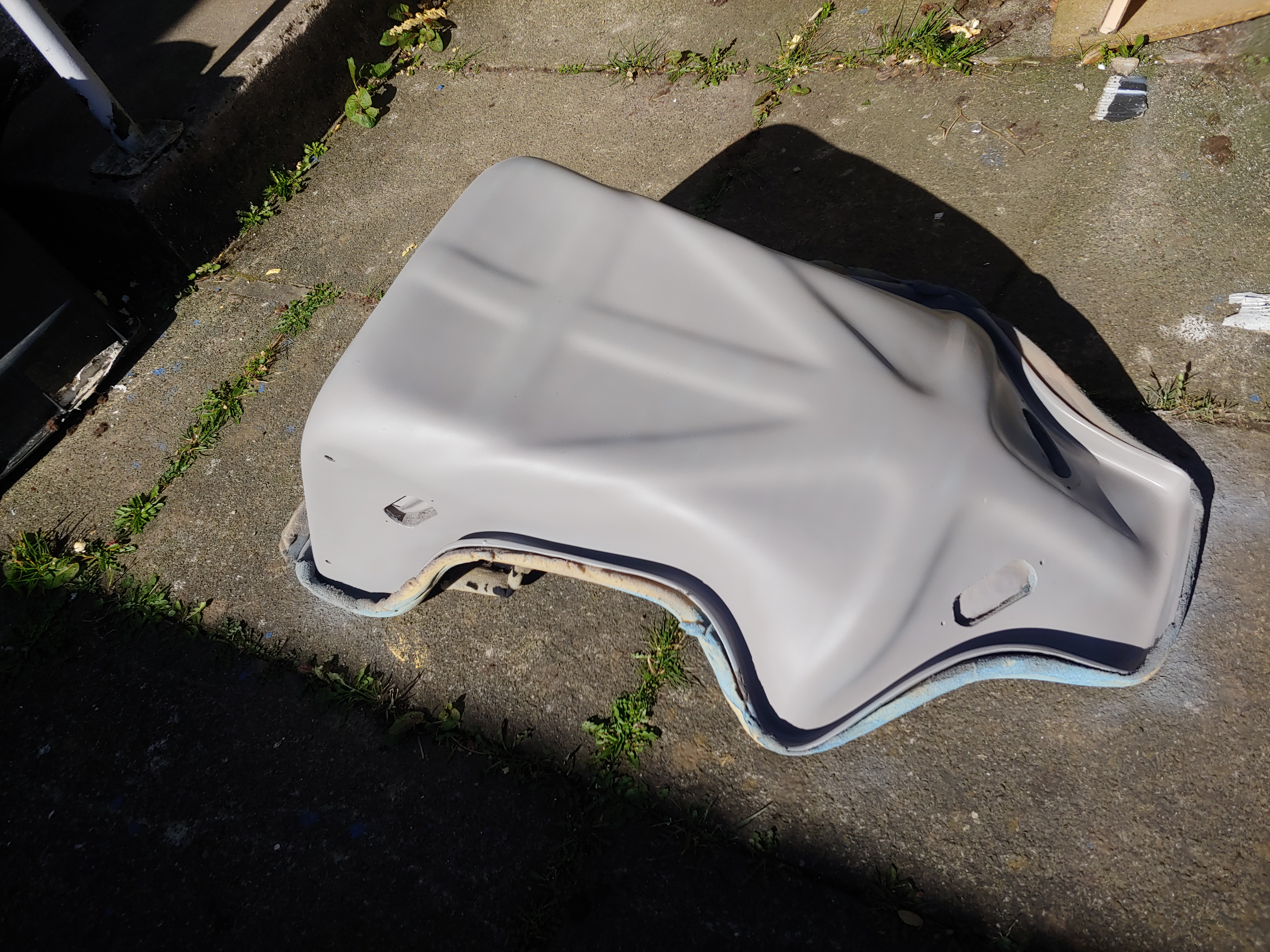

So enough is enough, got the seats out and stripped down at the weekend and got the backs lightly sanded.
Then a fresh lick of primer
And then paint
So after another coat and left to dry and cure. Same with the passenger. I gave all the cushions amd fabrics a good going over and a well deserved clean! The pics do the talking.
Much better looking!
Time to sort out the next step of the puzzle.
Seeing as the interior is getting an overhaul. The half cage will be getting taken out, then out of the 2 cages a full one will be getting made.
The rear cage in just now has harness bars which I need for running the harnesses. So I'm now in the process of getting bits fabricated on my rear cage out if the same tubing which will alloy me to join the front section of the new omp cage to it.
Then once done it will all be removed for a fresh lick on the interior shell and cage.

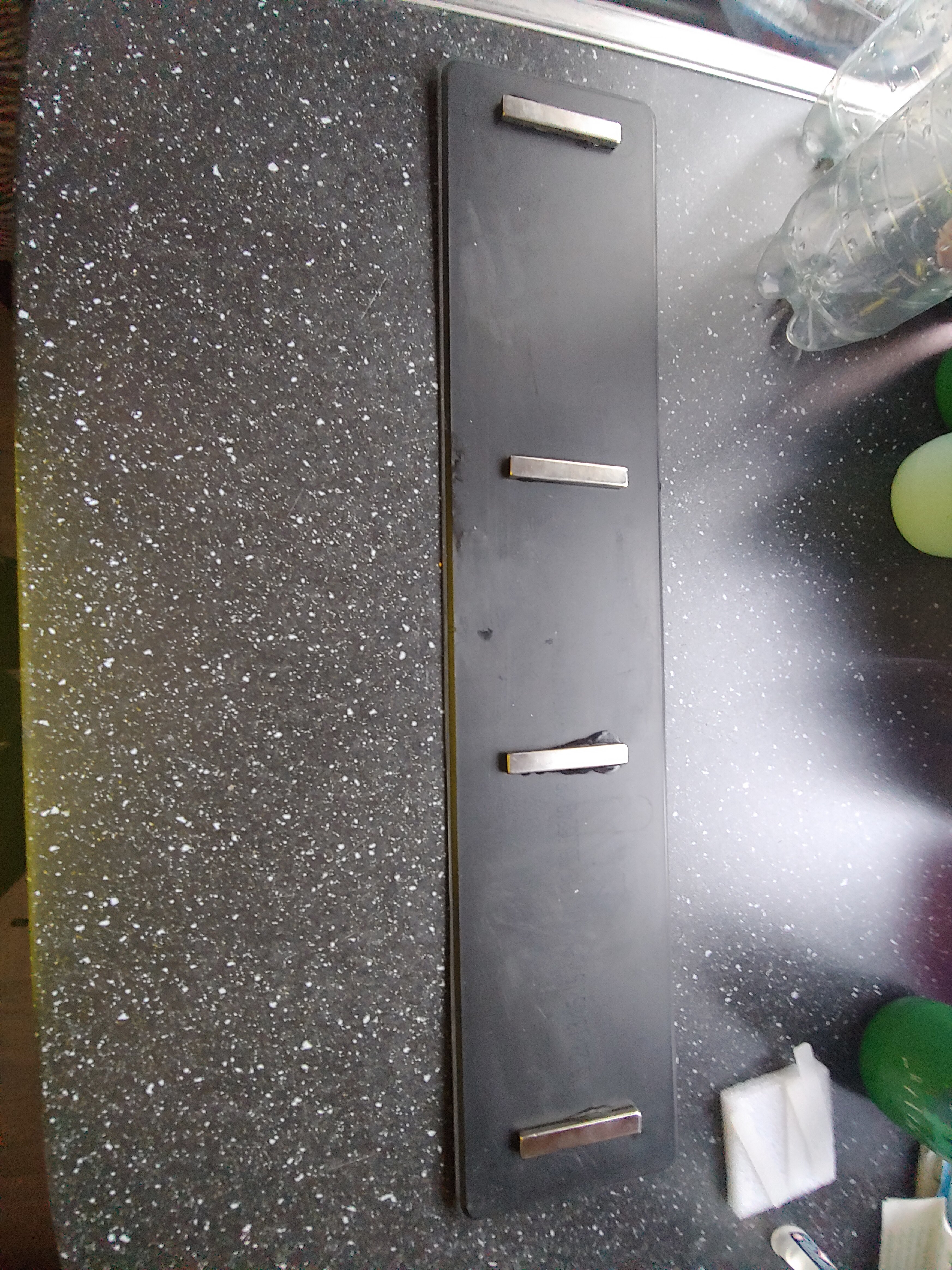

Recently I have been toying with the idea of adding a sticker in the plate recess (like on race cars) but obviously removing a plate every trackday/car show would be a pain plus all the sticky tabs or screw holes will be an issue.
More so for the front with having the holes in the bumper. Now this can possibly be helpful for anyone that has had the same thought or for people that run sponsor plates or have fancy plates made up for shows etc.
So came up with this.
First I ordered a set of magnets off eBay but unfortuantly they were tiny and no use what so ever. So back to the drawing board
Eventually after searching a bit more i got these
They have 15kg of pull and are extremely strong. They came with 3m tape but i didn't bother using that. Instead i used loctite super glue and stuck 4 of them on the numberplate
Now i began to think to my self what if the force of me pulling the plate off the car and the strength of the magnets was too much for the glue. So i decided to vinyl wrap over the whole lot.
With this done i decoded to test it on the fridge door they stuck brilliantly.
Now onto the car... I went round to the Clio and removed all the glye and residue off the bootlid from where the plate was and set about fitting the sticker.
Then the finished product! Another plus side of this is even if you out the plate on and its slightly squint you can easily adjust the placement by moving it about slightly.
Extremely impressed with how it has turned out.
