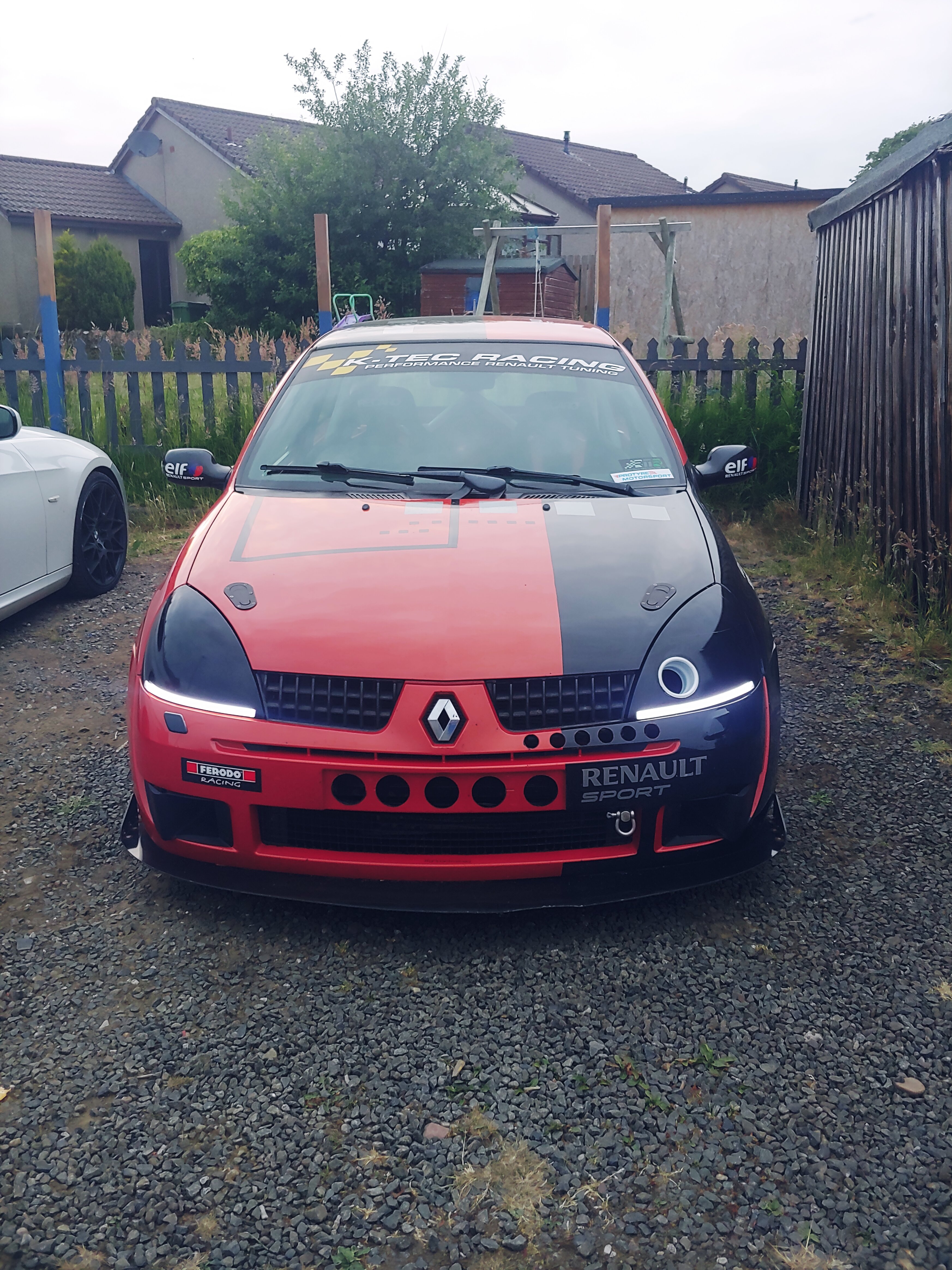

Next part of the update. I was beginning to feel like theyre was a bit too much going on with the livery on the car so decided to tone it down a bit. I also fitted a new rain light on the rear as the one i was running shorted and half the l.e.ds stopped working.
I also stuck one of the bucket seats back in the car. Love how its looking with the white backs now.

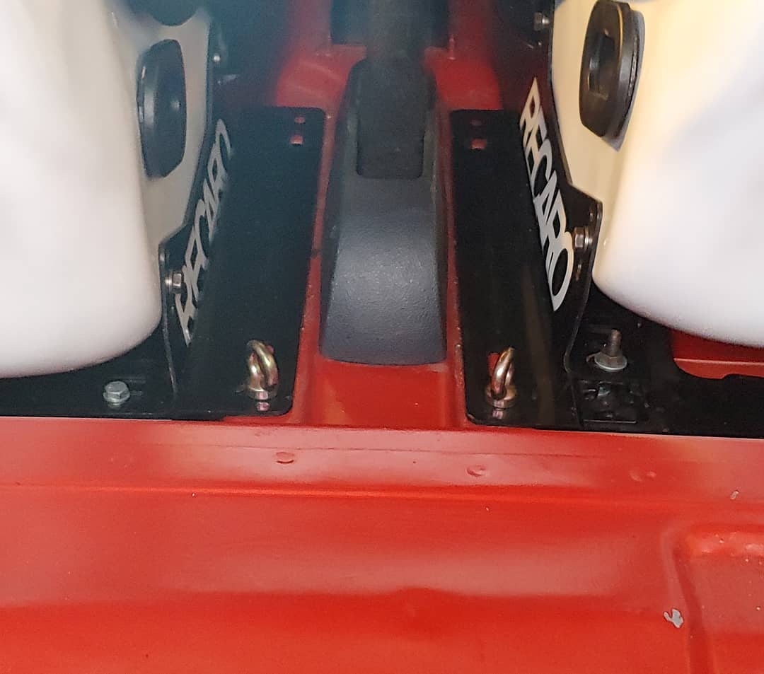

Got round to drilling out the seat mounts for the the harness lap belts. Replaced the inner rear bolts for eyelet anchor bolts for the harnesses to hook onto. Feel as if this is a much safer solution to what i was running before.

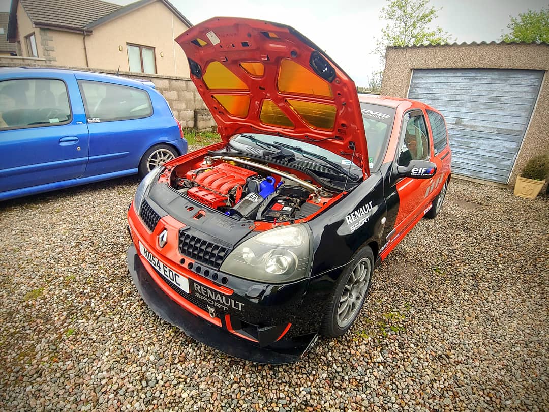

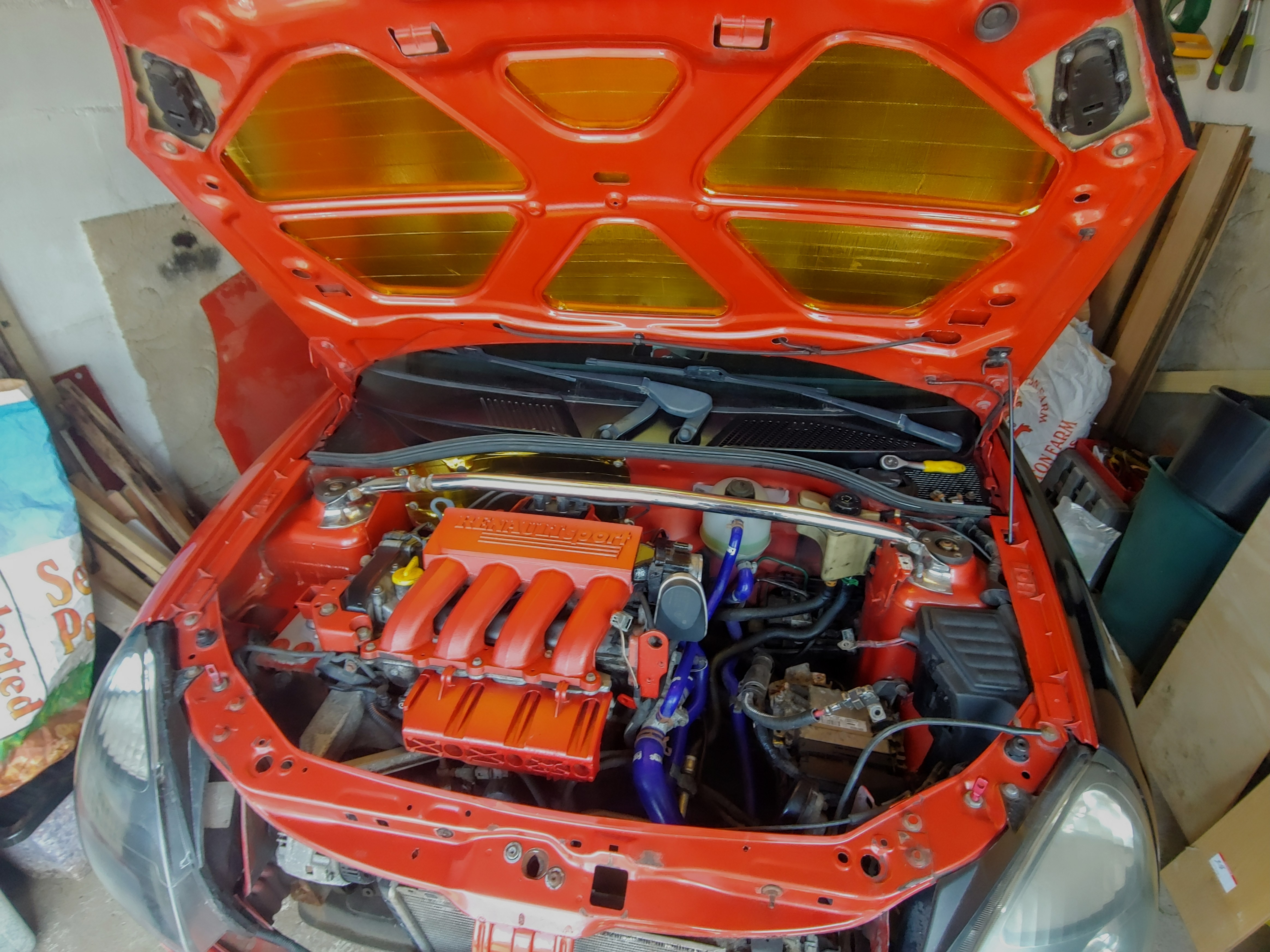

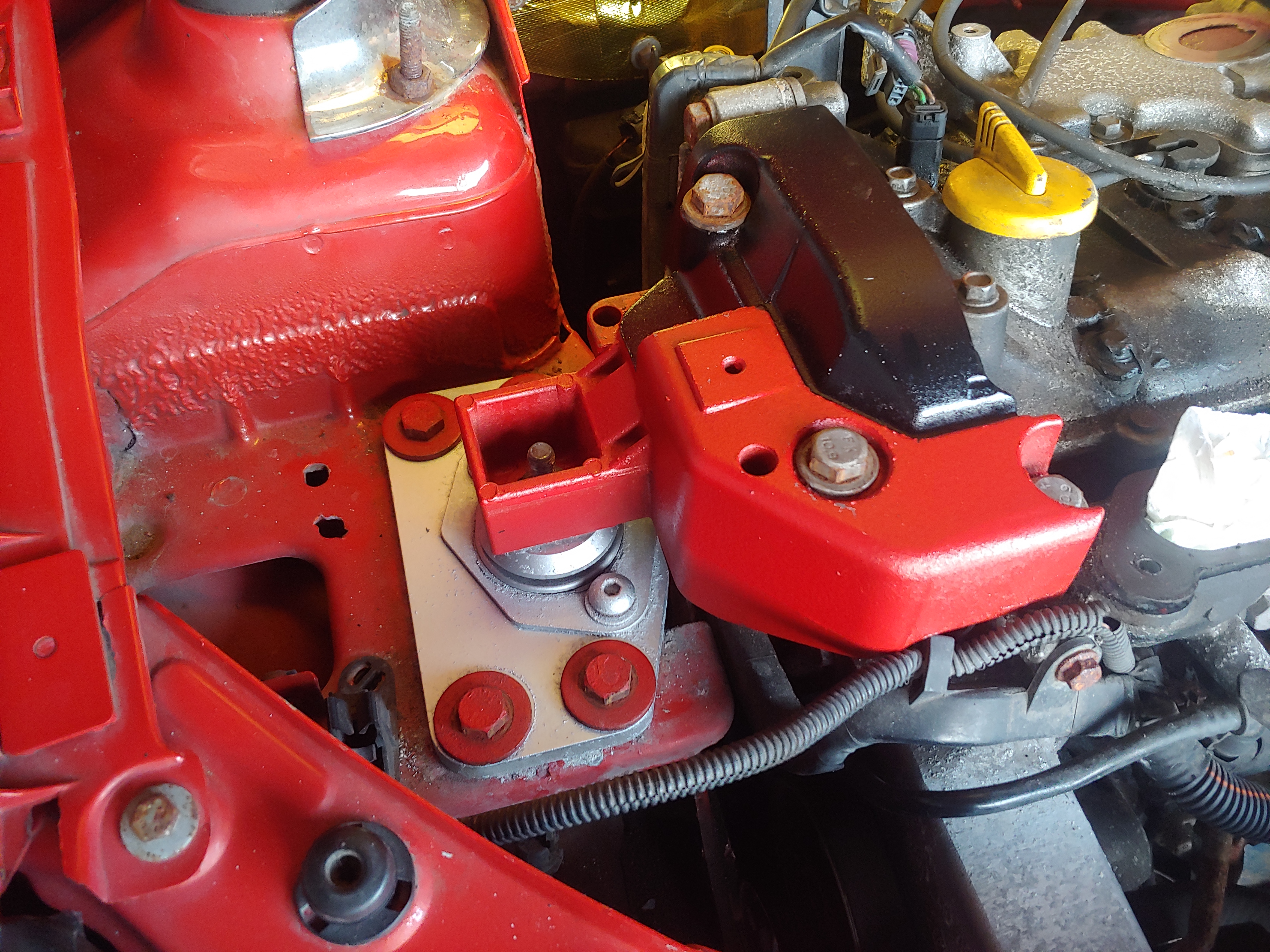

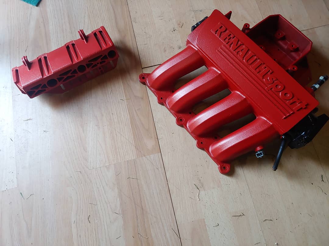

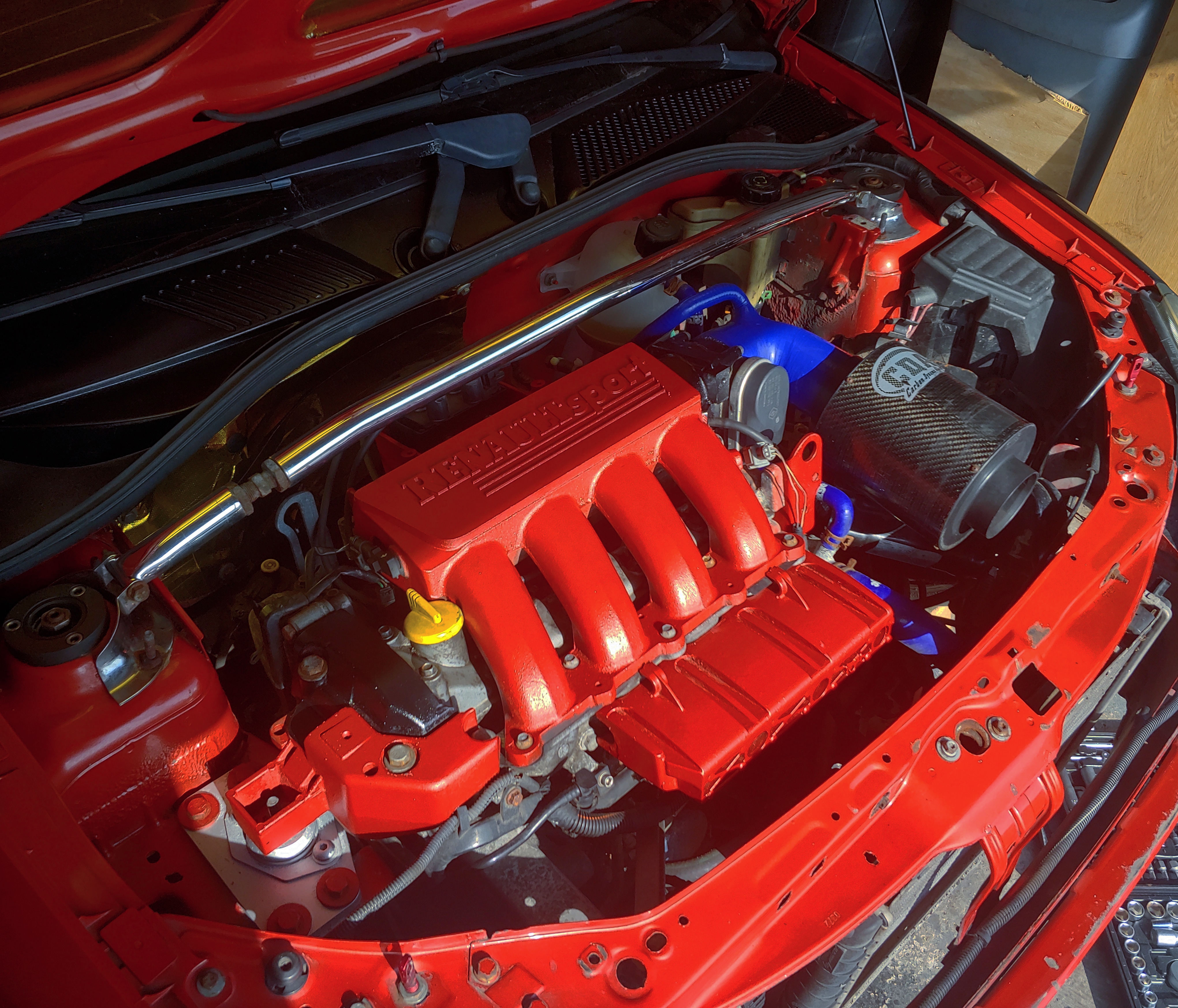

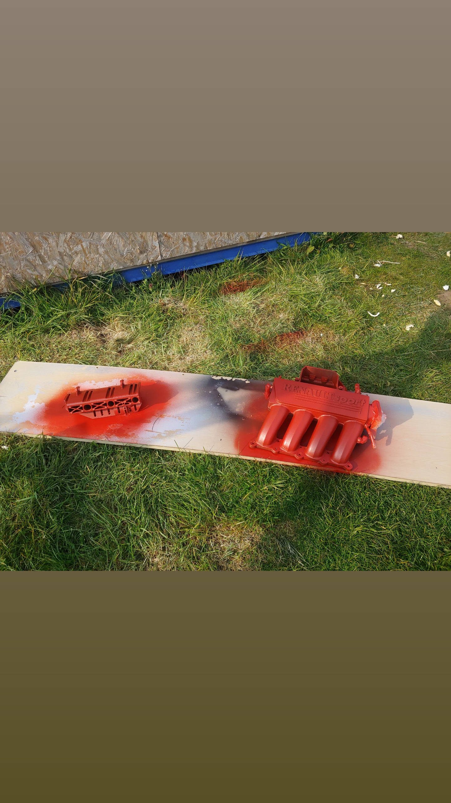

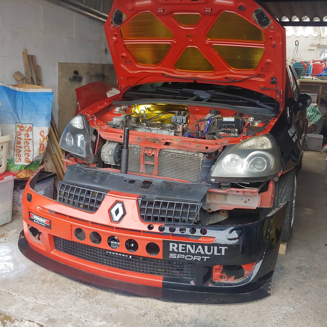

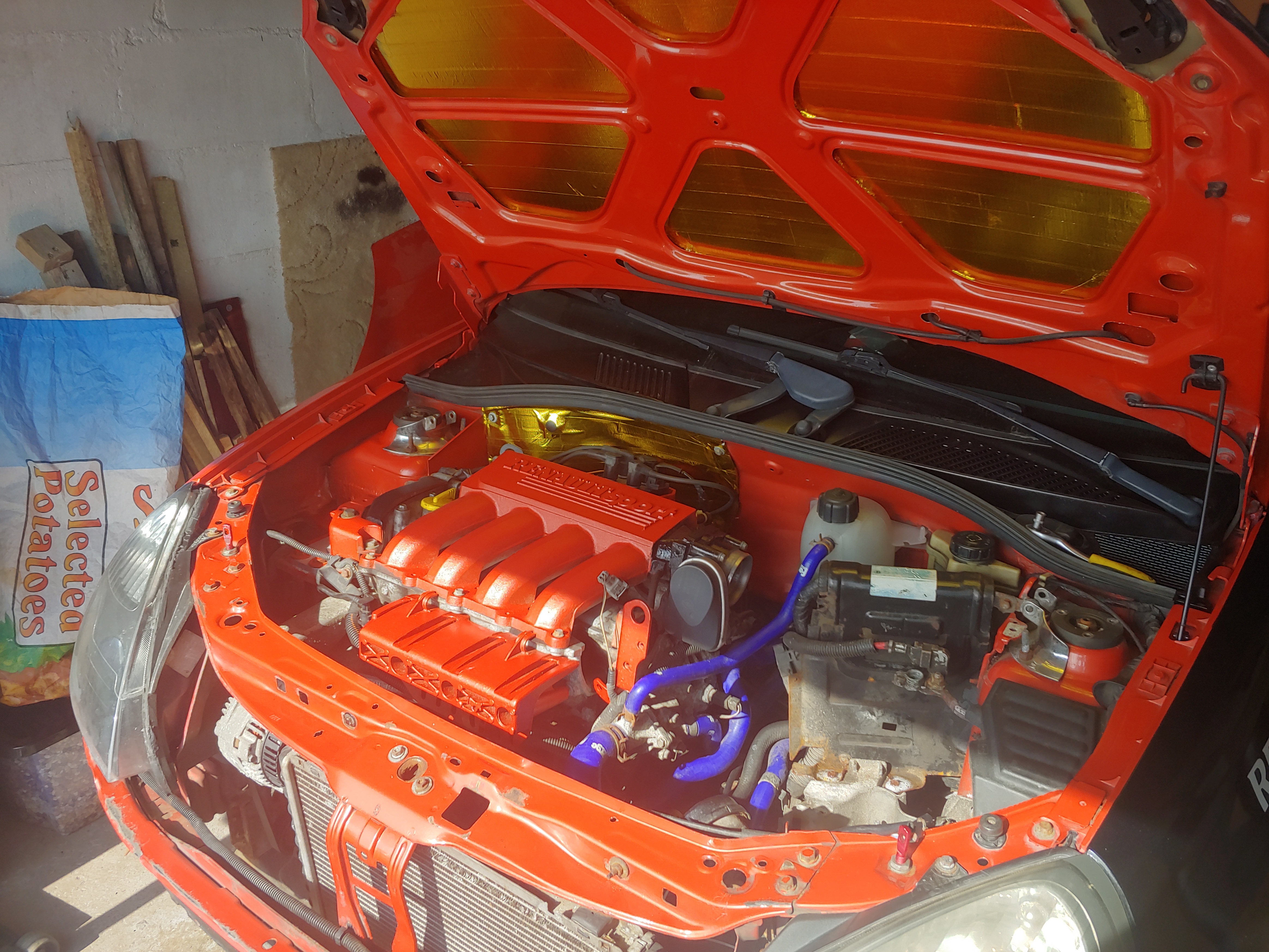

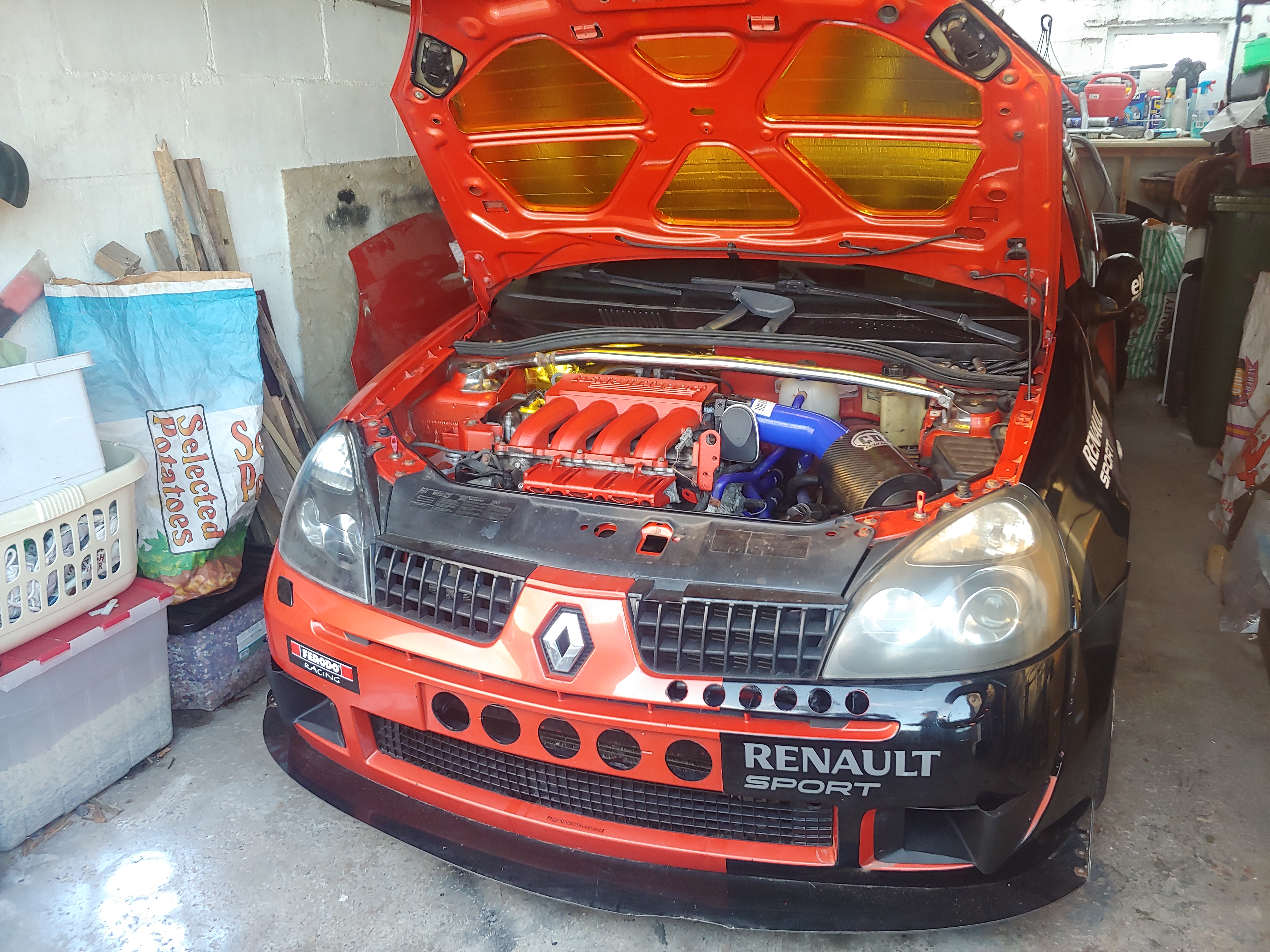

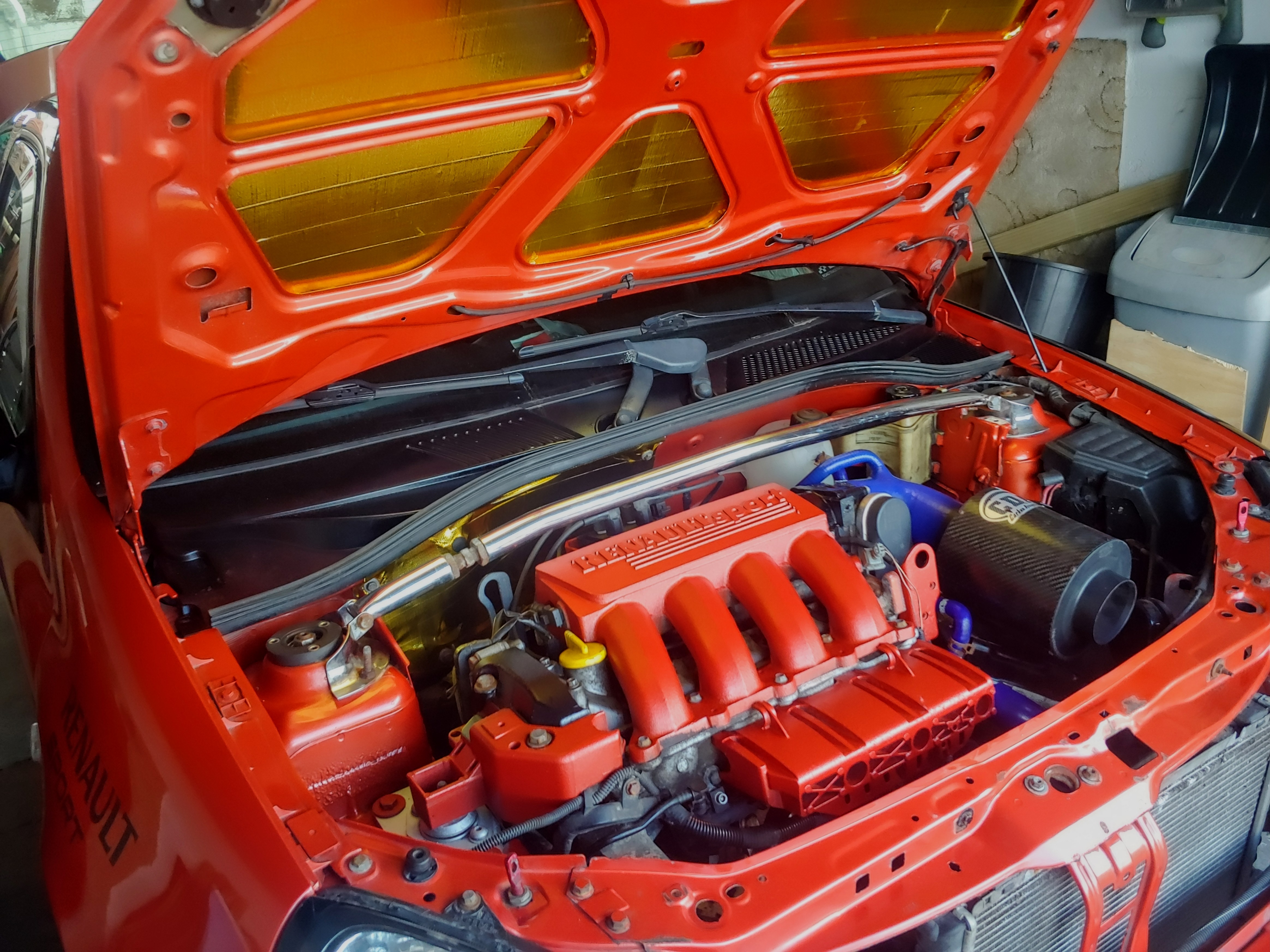

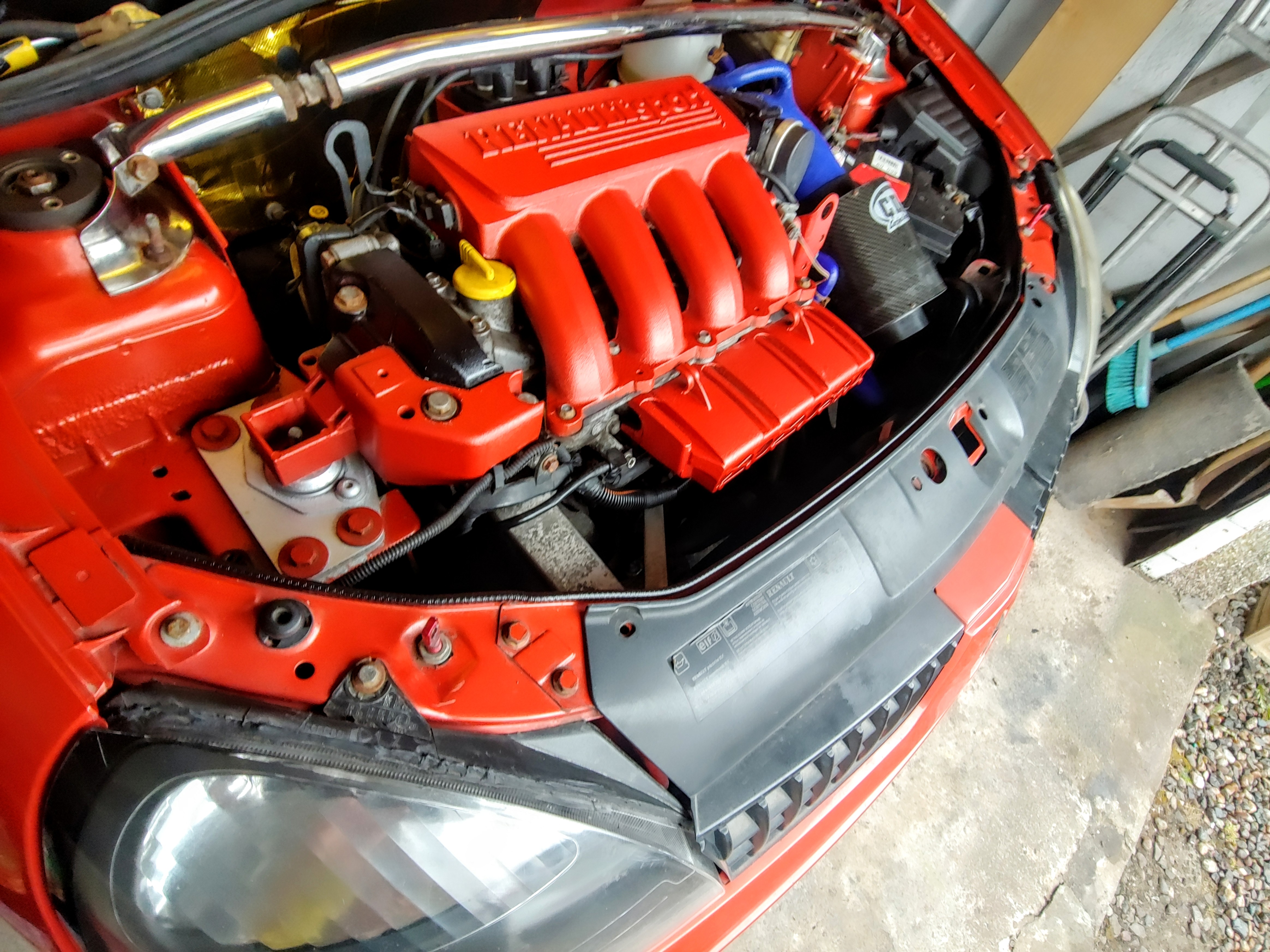

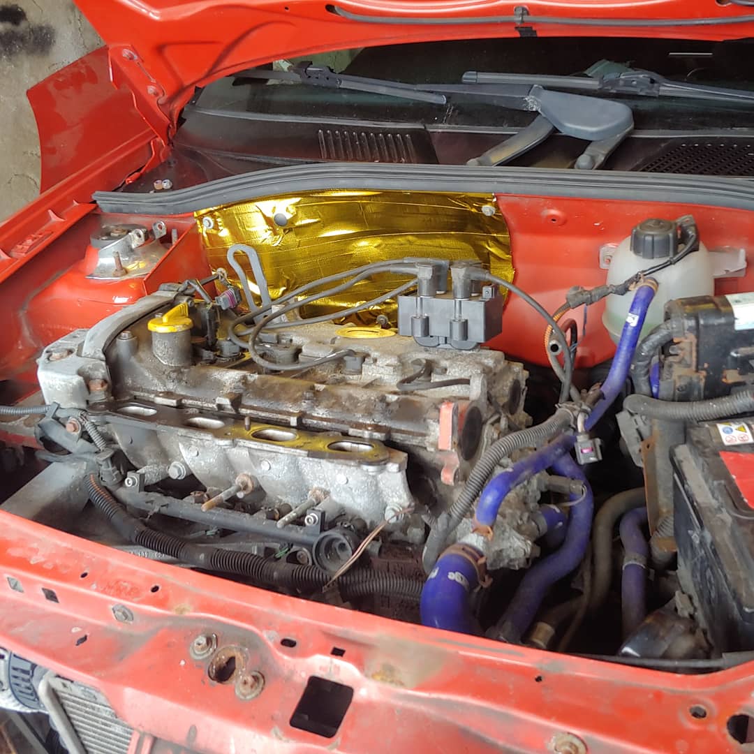

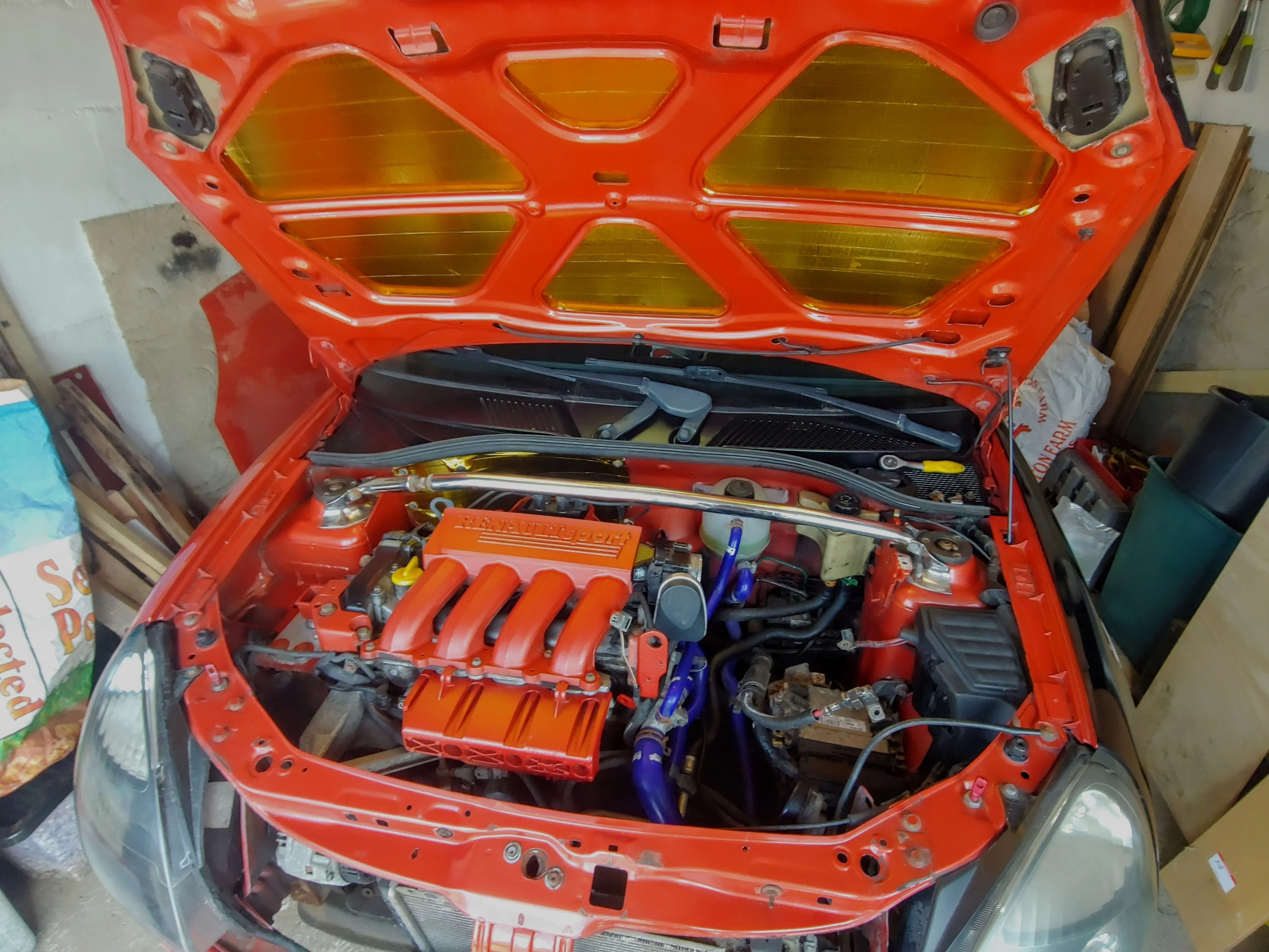

So i have turned my attention to the engine bay. You may also notice I have removed my foglight surrounds and ducts... More on that later 🙊🙊

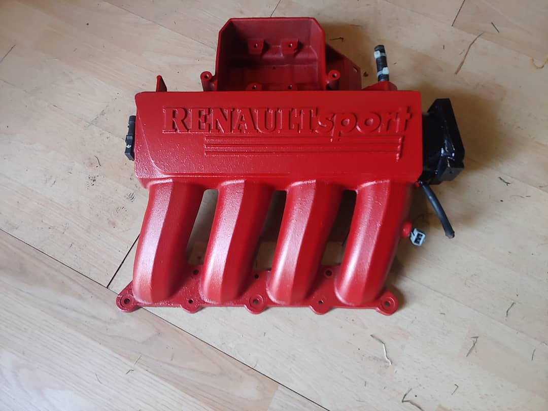

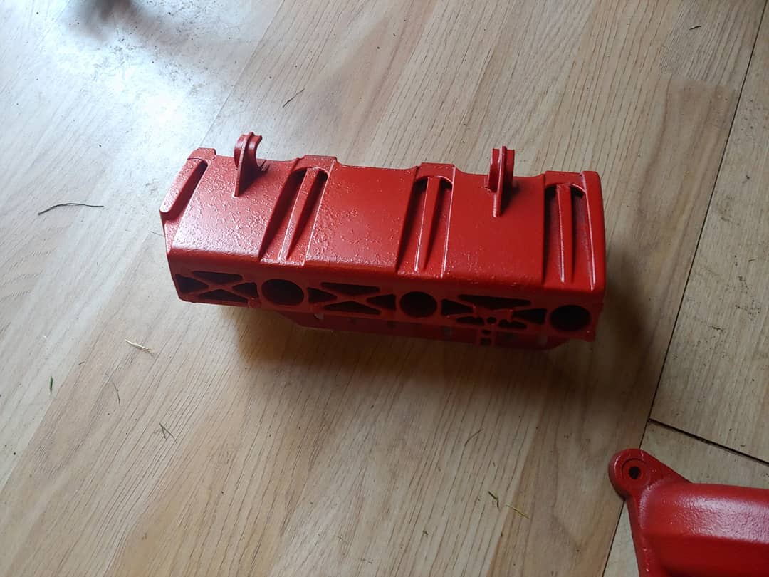

The bay Its self is in dire need of some tidying up so at the moment I have removed the inlet and fuel rail cover for spraying.
Pretty happy with hpw these have turned out.
Next will be respray the rocker cover (not looking forward to this, gotna feeling it will be a nightmare to mask up) also going to be painting the engine mount, engine mount bracket, throttle body, alternator bracket and the engine lifting eyelet.
Well was expecting a delivery for the clio yesterday after work so headed round and set about doing a few bits. De greased the bay and got most of the crap off the rocker cover. Got all the painted engine bits refitted, unfortunatly not the best pictures due to the glare of the sun but ill get some better ones tomorrow no doubt.

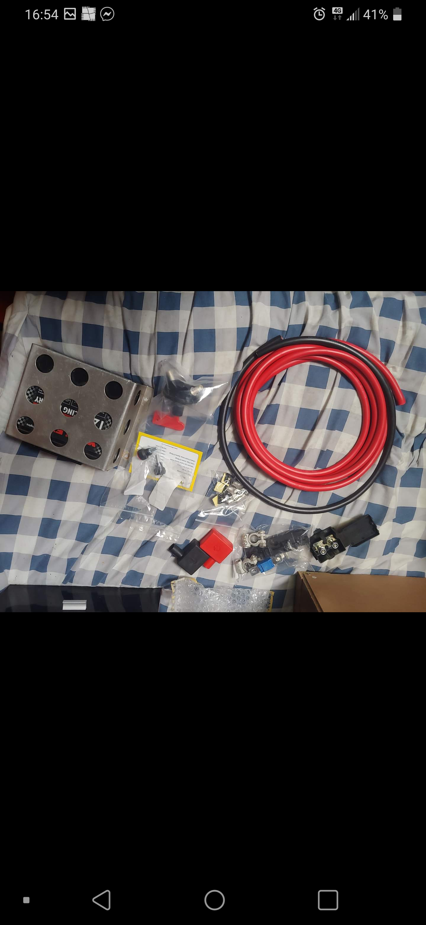

Next to tackle is this, a Varley redtop battery and cage with a relocation kit and cut off switch to be fitted also

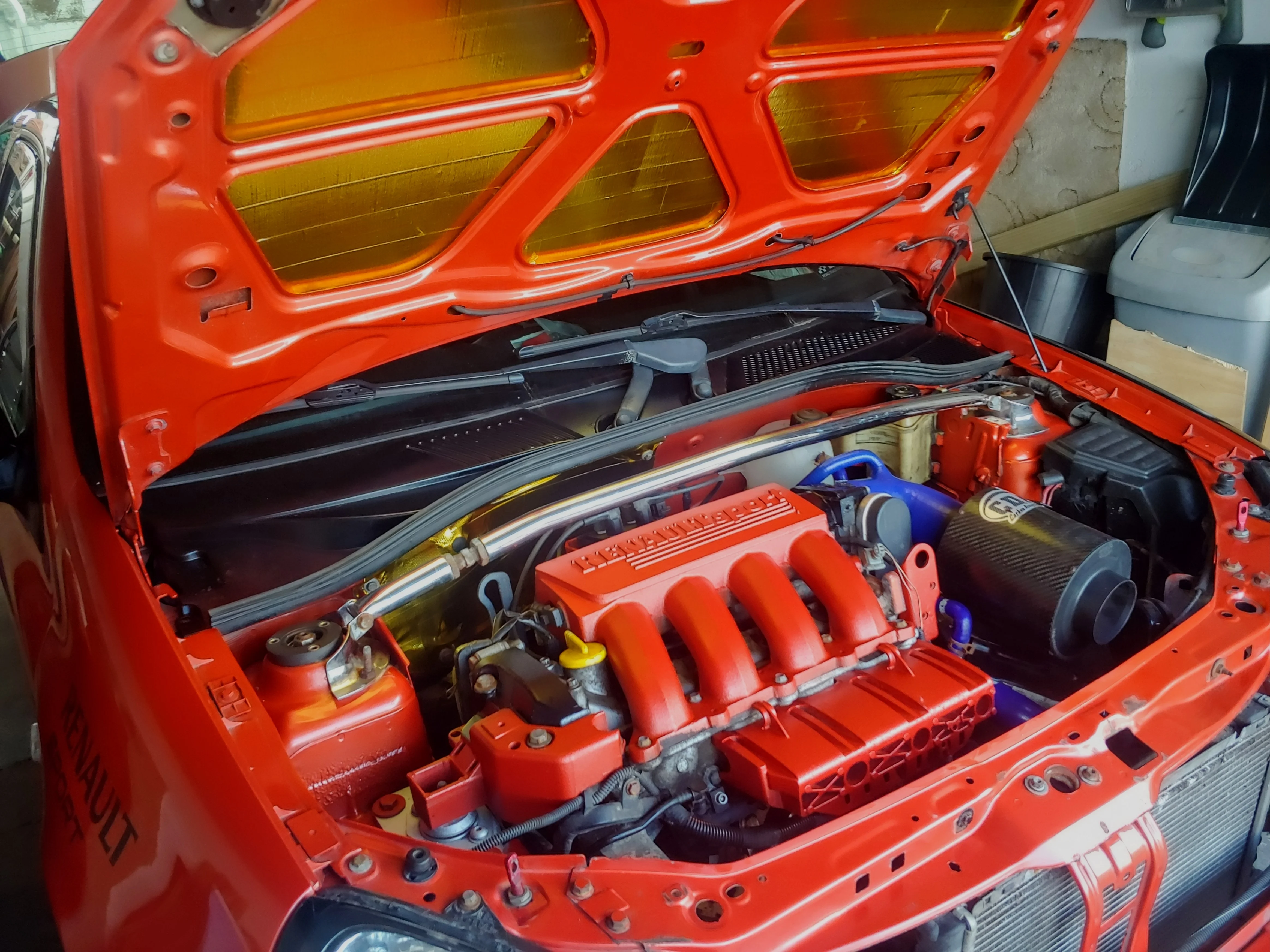

Then.... That should be the bay done once i change my induction set up from a 90 degree to a 45 degree behind the headlight
Got a couple more pics of the bay today whilst removing the battery and ecu housing.
Attempted to lay my ecu flat on top of the gearbox mount but there seemed to be loads of tension on the cables 🤷 Any suggestions?

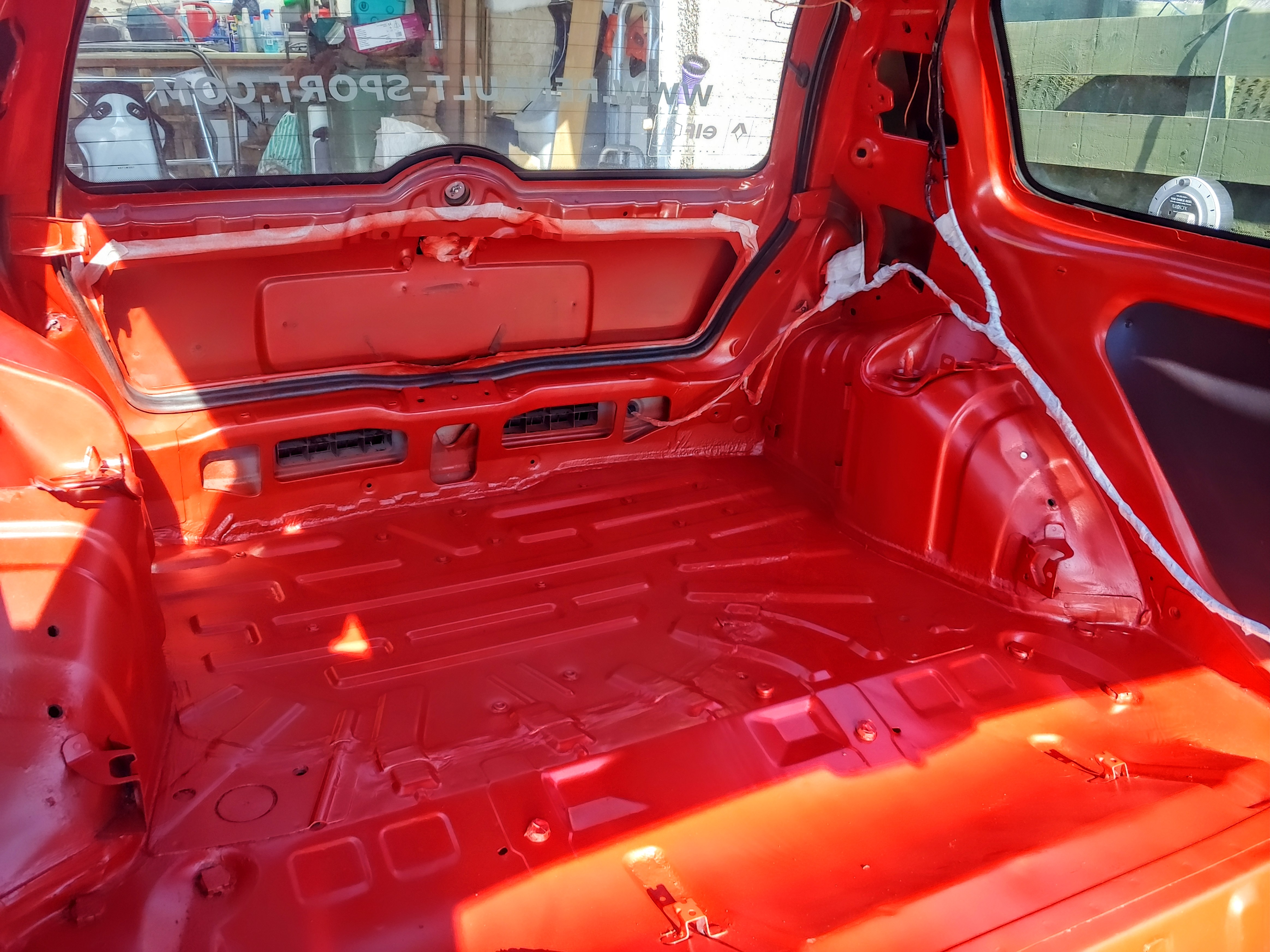

Then set about removing the cage, brace and seats and given the rear another fresh lick of paint!

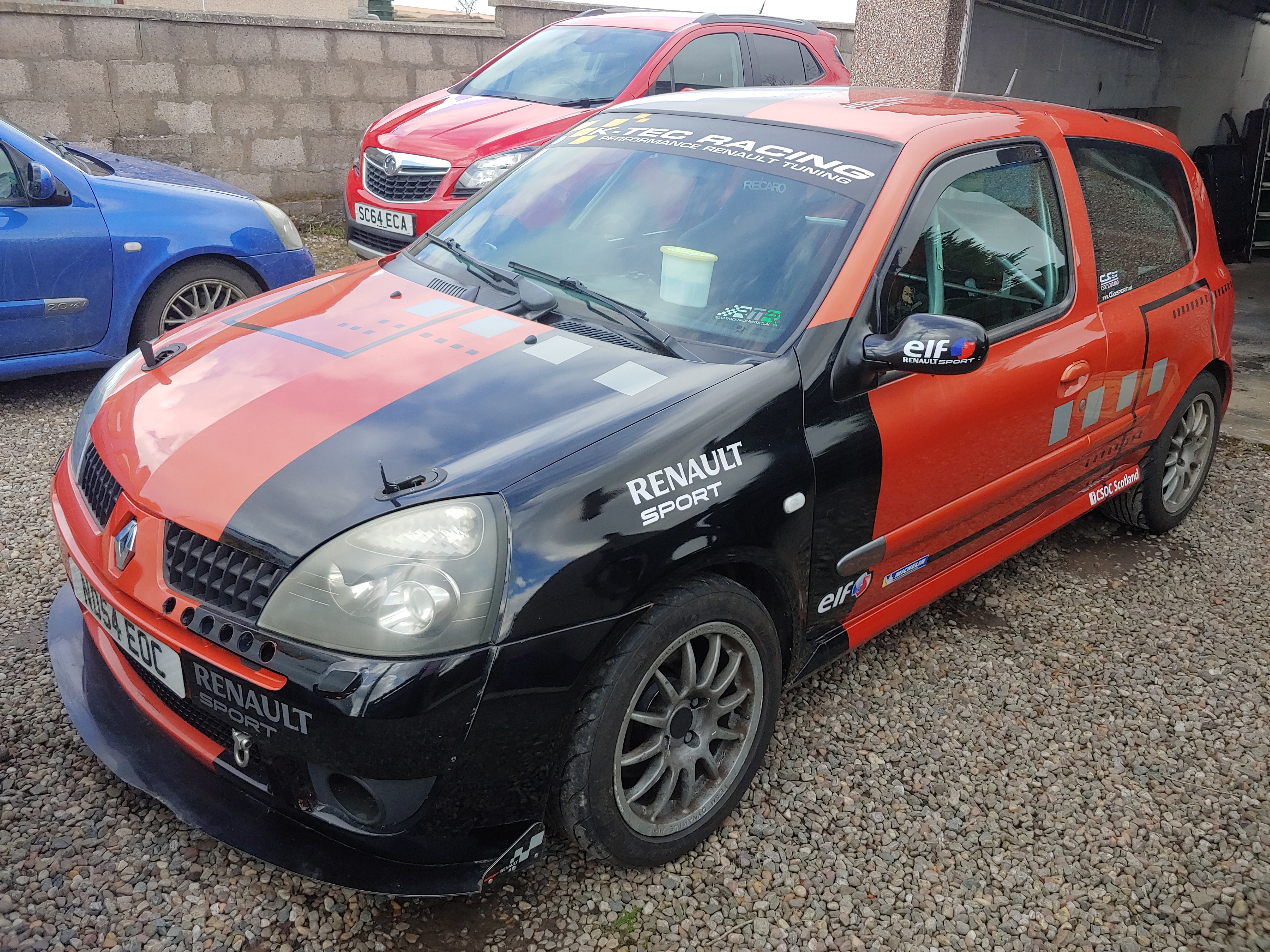

With the rear end painted i set about getting front painted also along with the roof. Just need to get the cage sorted out and that will be the interior done and ready to bolt everything back in!
To tidy things up a bit, I had bought some rubber edging. So fitted this to the edge round the gutted bootlid, the edge round the aero catches and on the edge on the front crewmember. For something so simple its made a nice subtle improvement.
Got round to doing the front numberplate as well so it was also quick removal.
£5 strip of aluminum from B&Q, some strong as f*** glue and some vinyl on the bumper.
3 magnets on the back of the plate and voila!

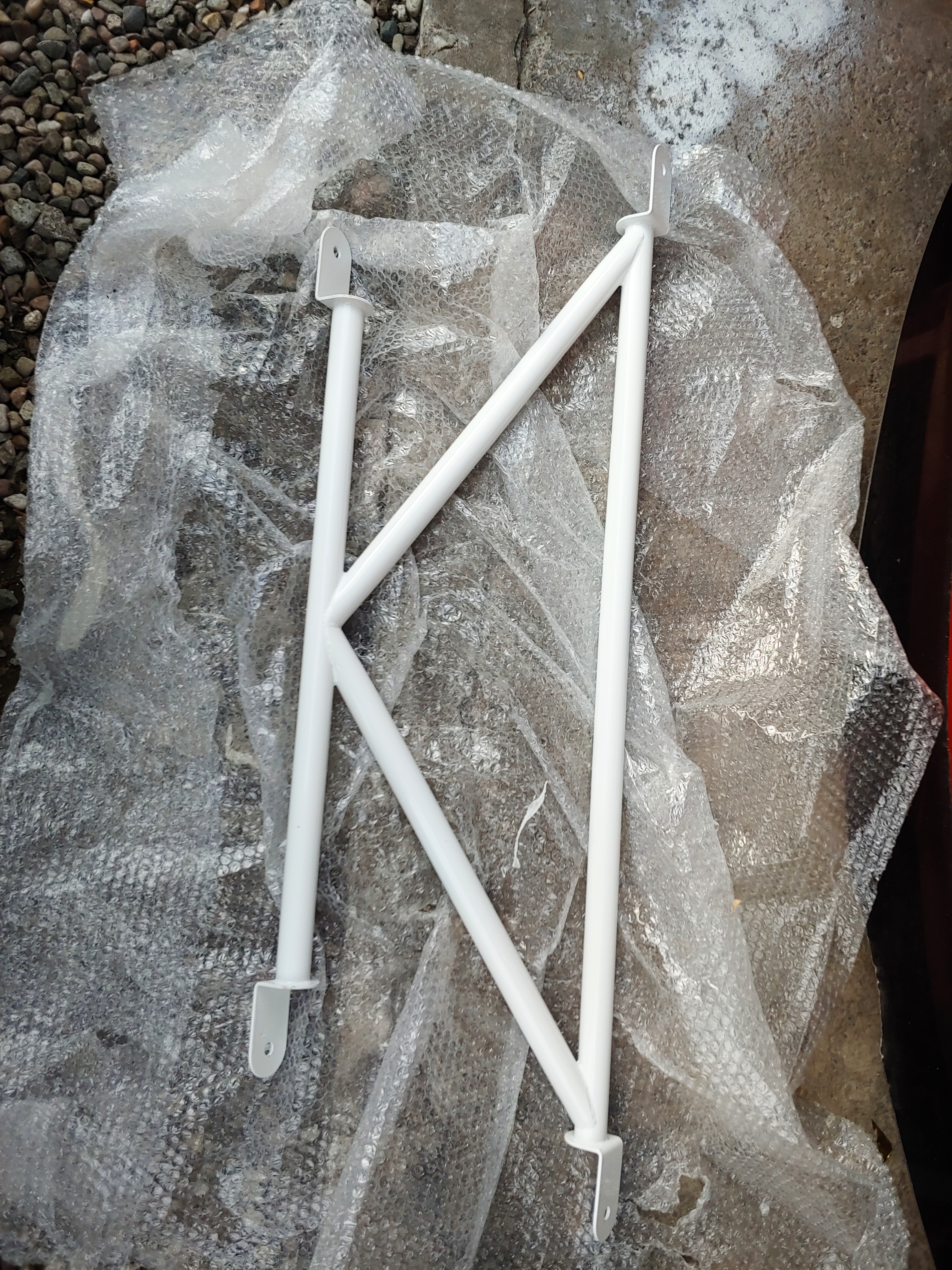

BAF Motorsport K brace.
And a quick mock up
I would have fitted it there and then but.... I seem to have misplaced the isofix bolts that i took out a couple of year back. Have other somewhere so will be bolted in at the weekend.

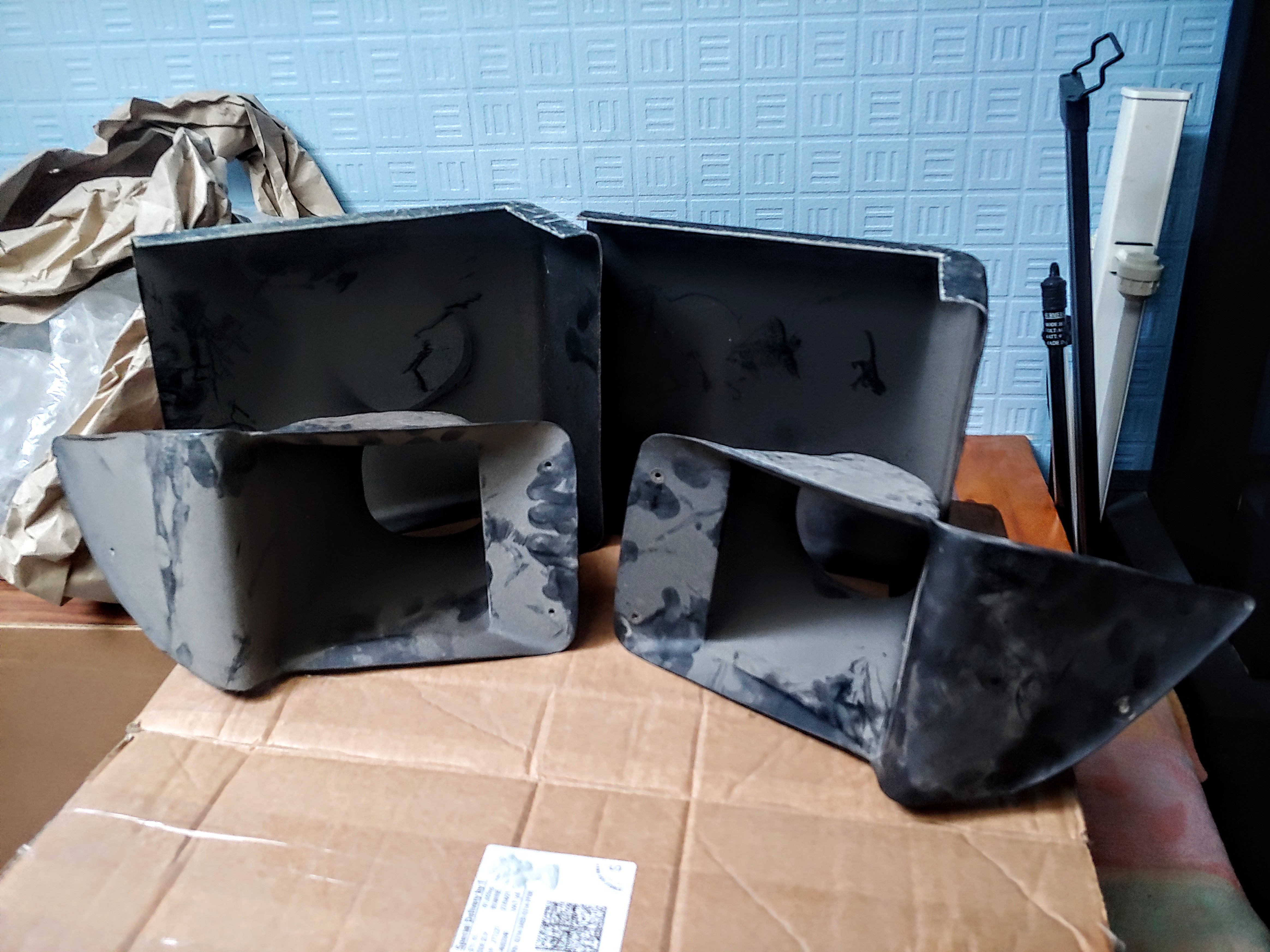

2nd parcel. Was buzzing for this one!
Cup racer brake ducts and deflector plates! I know i could have atleast cleaned the dust off them before taking photos 😂 but yeah will need to get the dremel out and get these fitted at the weekend also

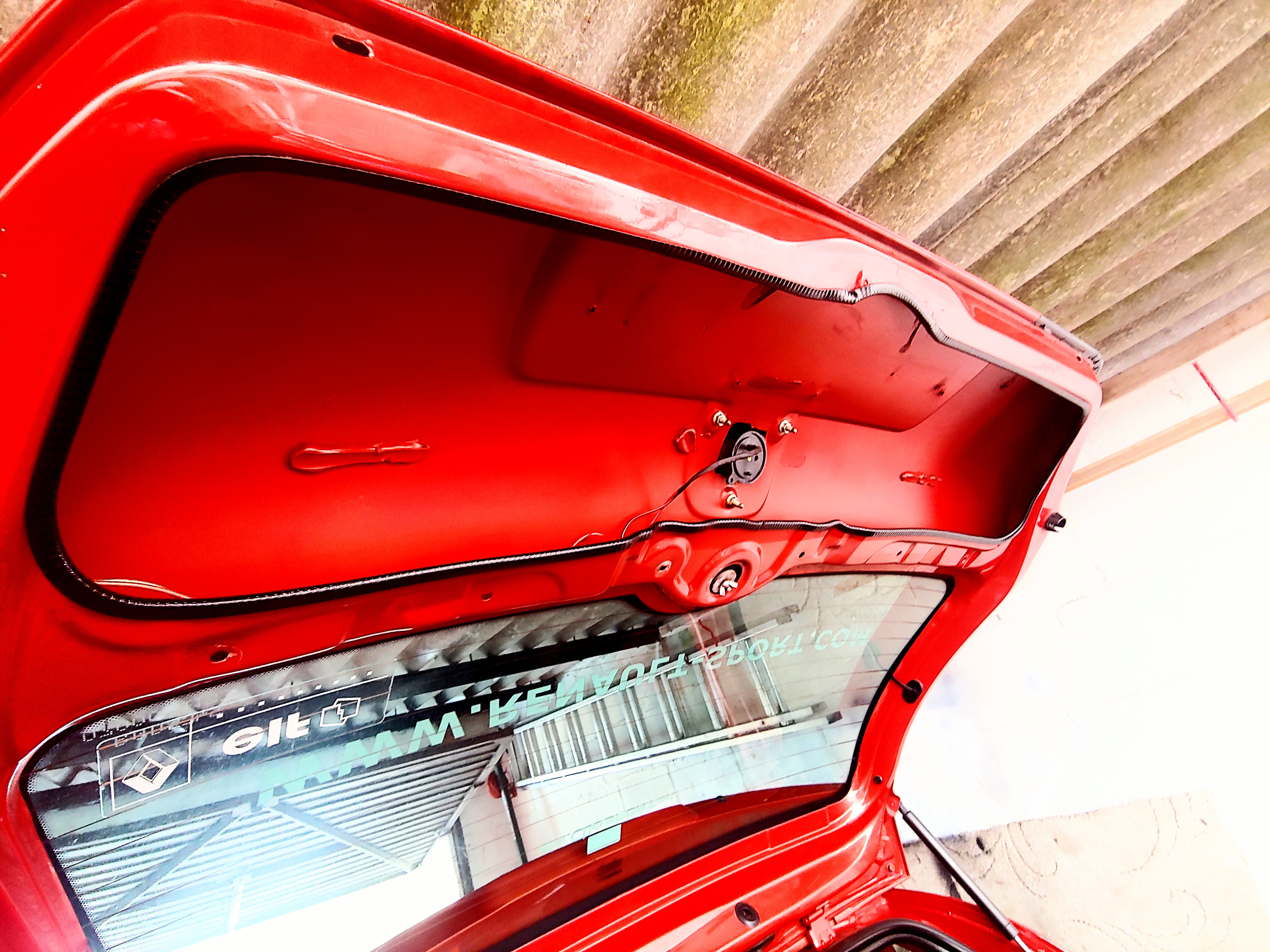

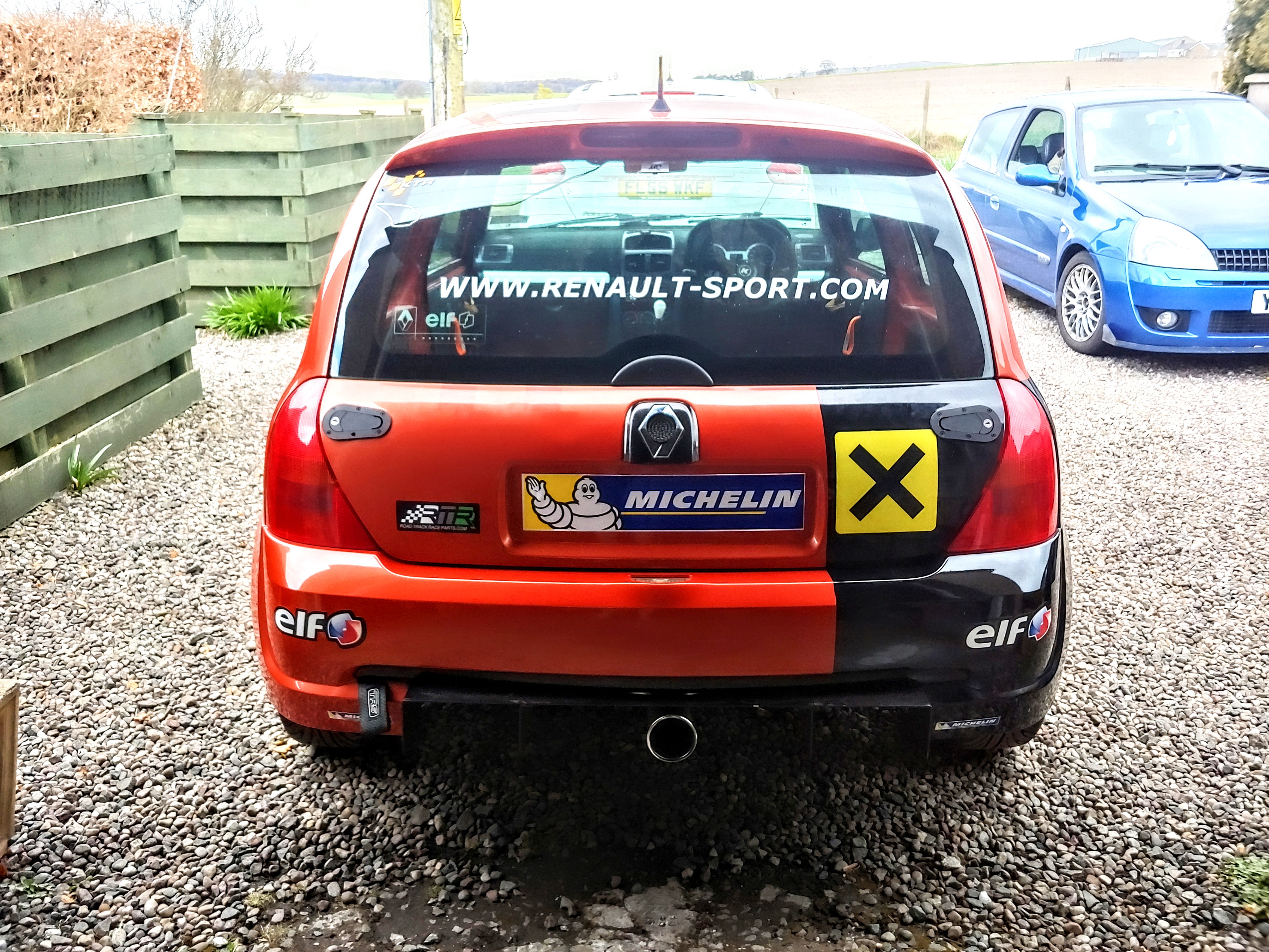

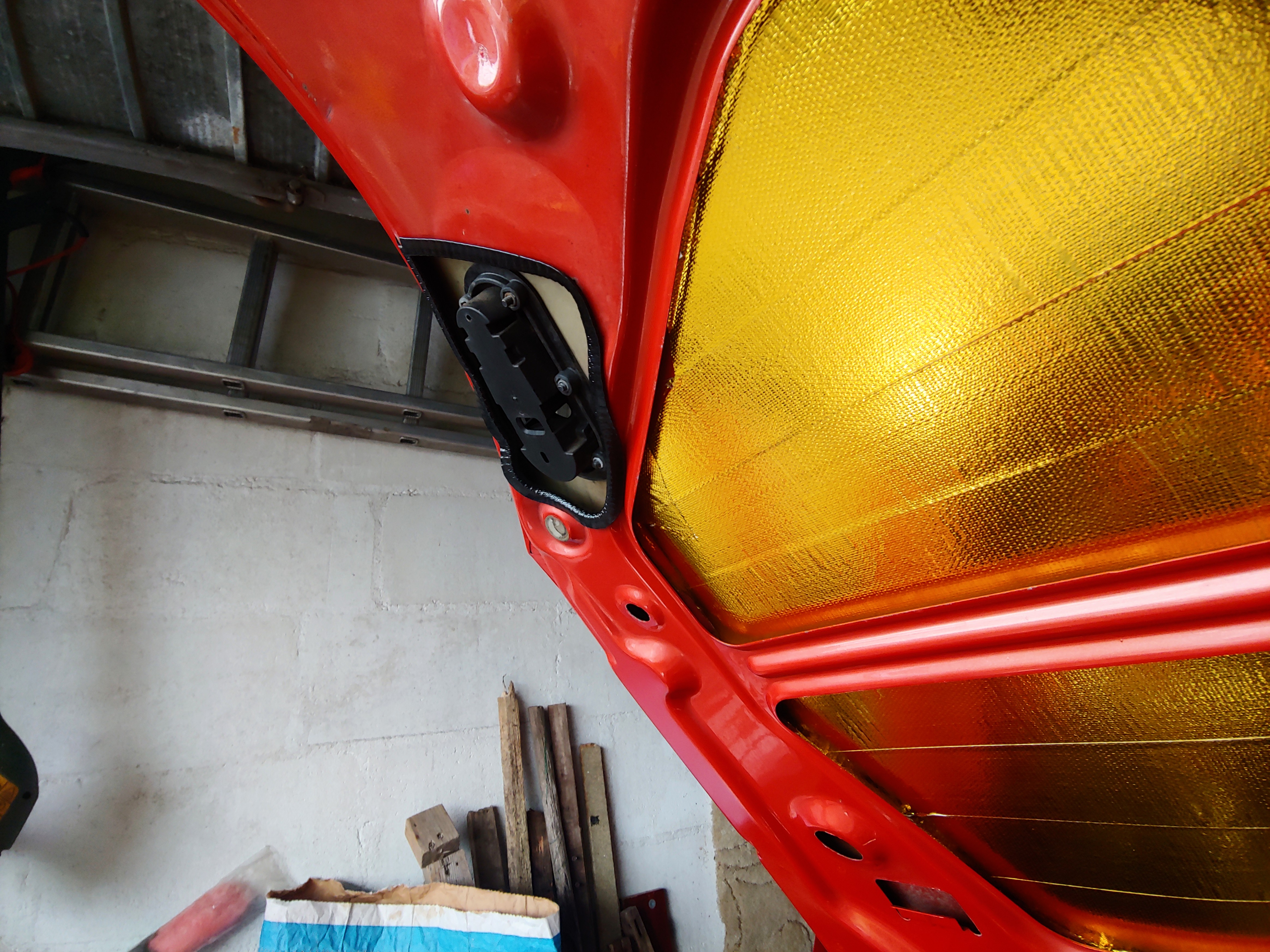

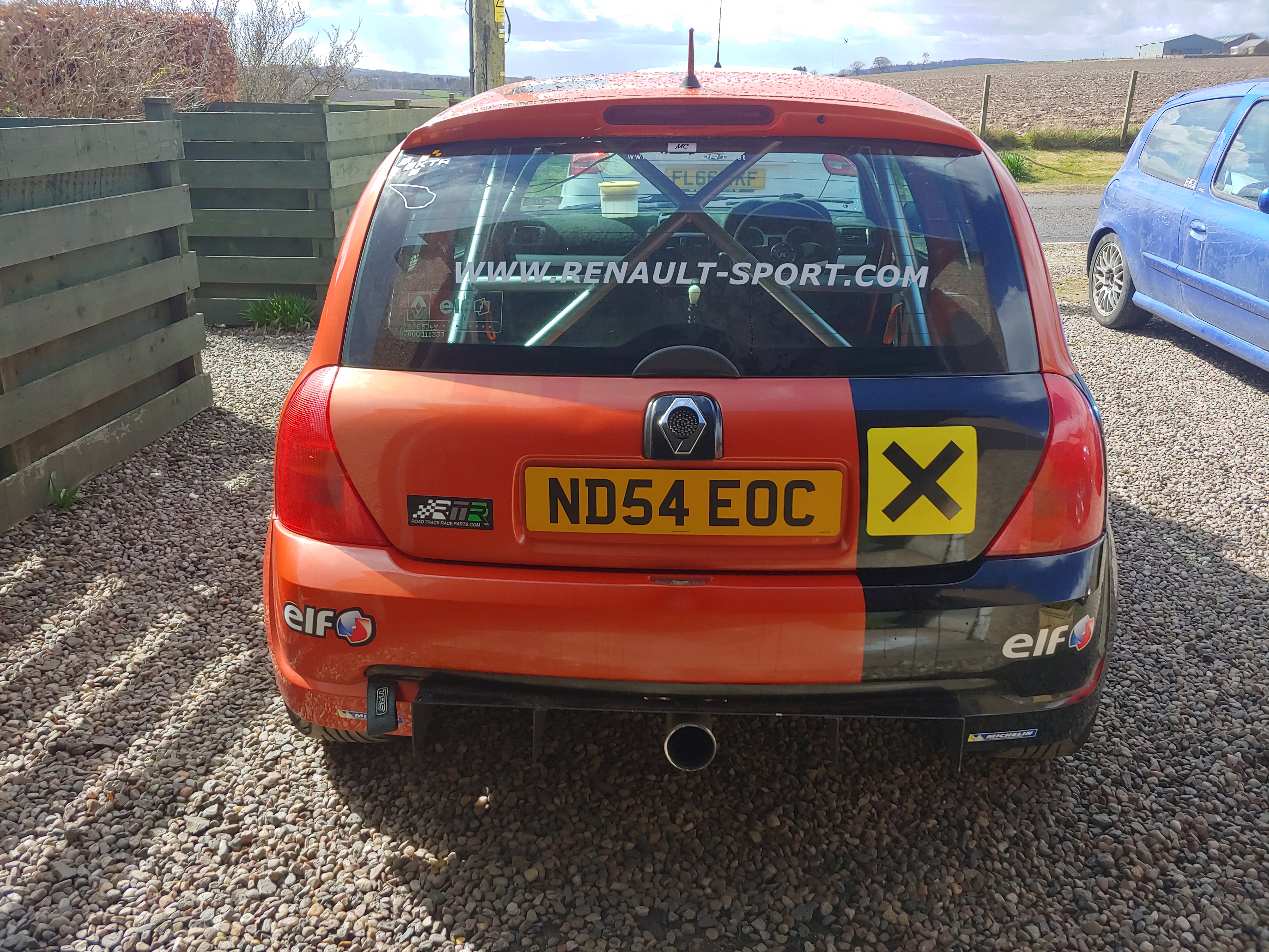

The bootlid got the finishing touches today. With the addition of the locking aero catches. Glad i went for these as due to the car possibly being taken to work some days its always good to have that bit of safety.
Really chuffed with how these have turned out.

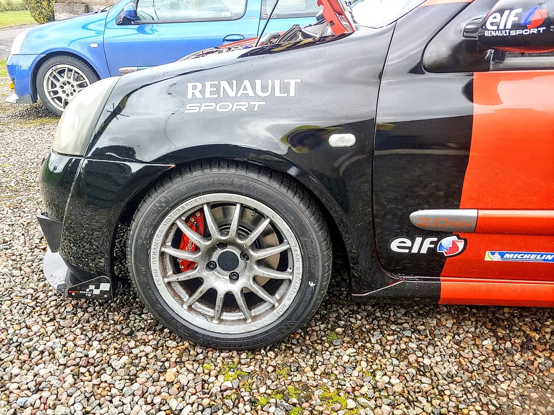

Now onto the front, Gave the cup racer brake ducts a good clean and started to cut awaybat the bumper to get them fitted. Then screwed them in place with some black screws to keep it subtle.
Imo these look brilliant!

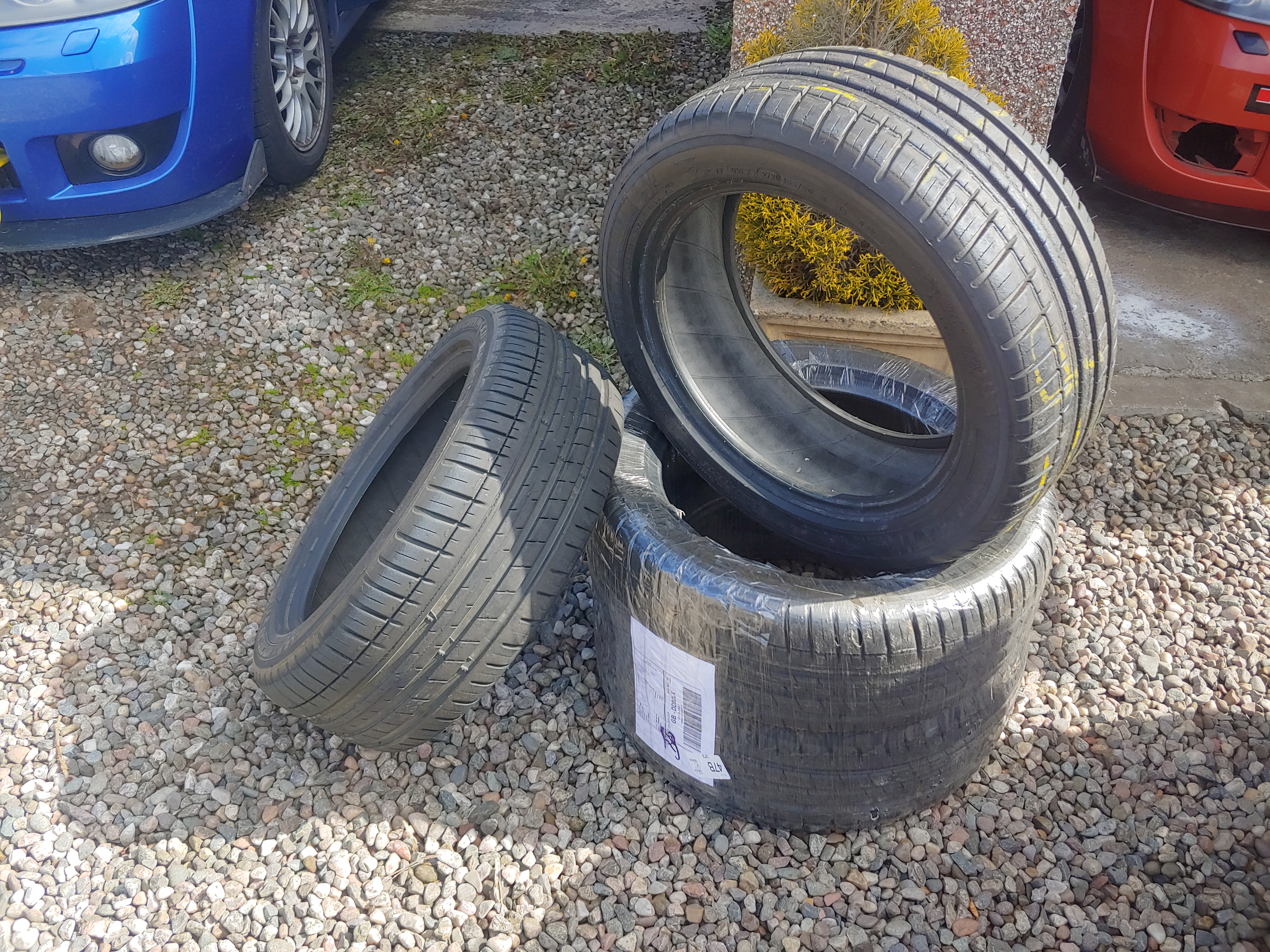

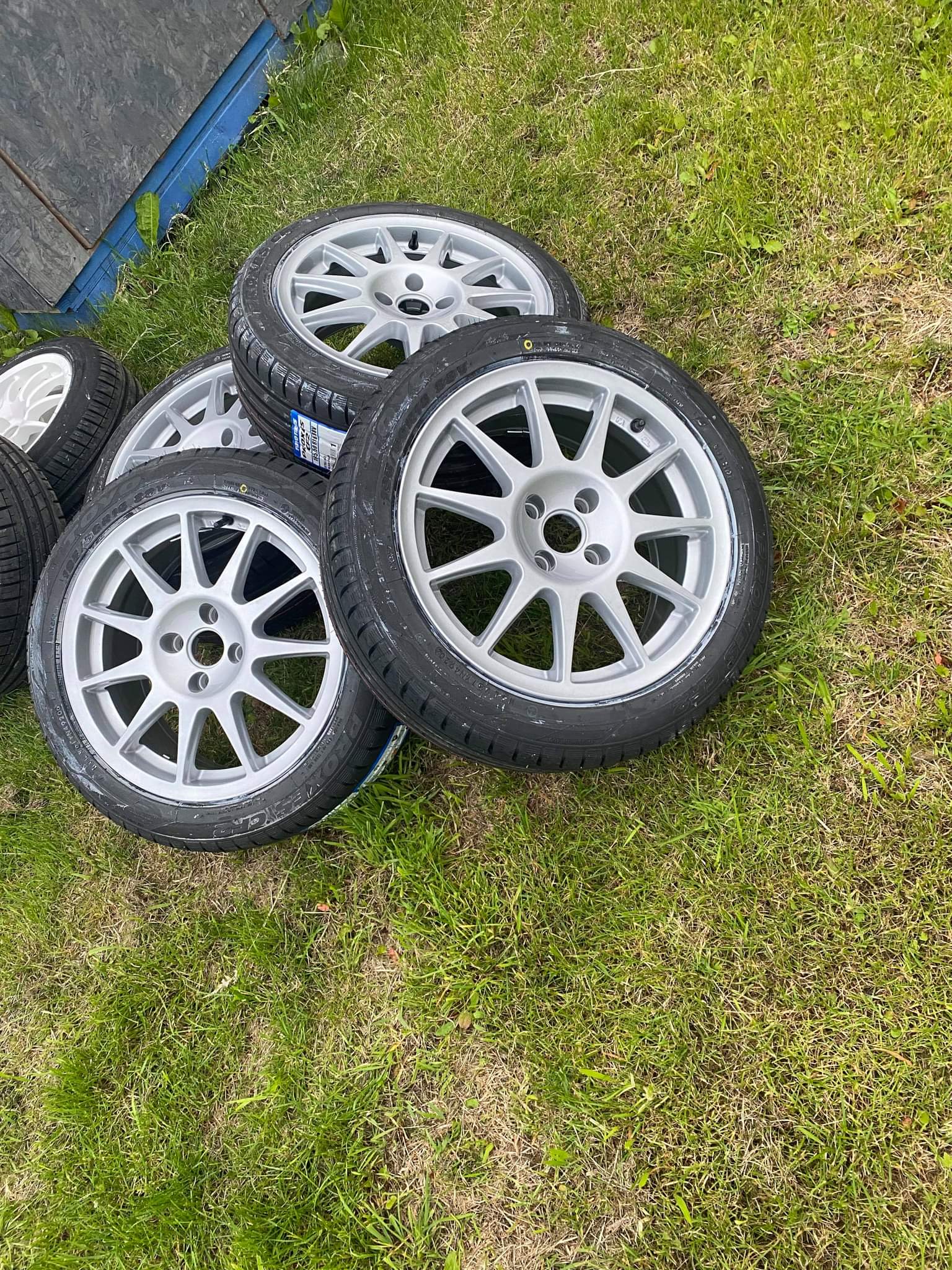

Then also took delivery of some michelin pilot sport 3s so they will be fitted to one of the sets of wheels.

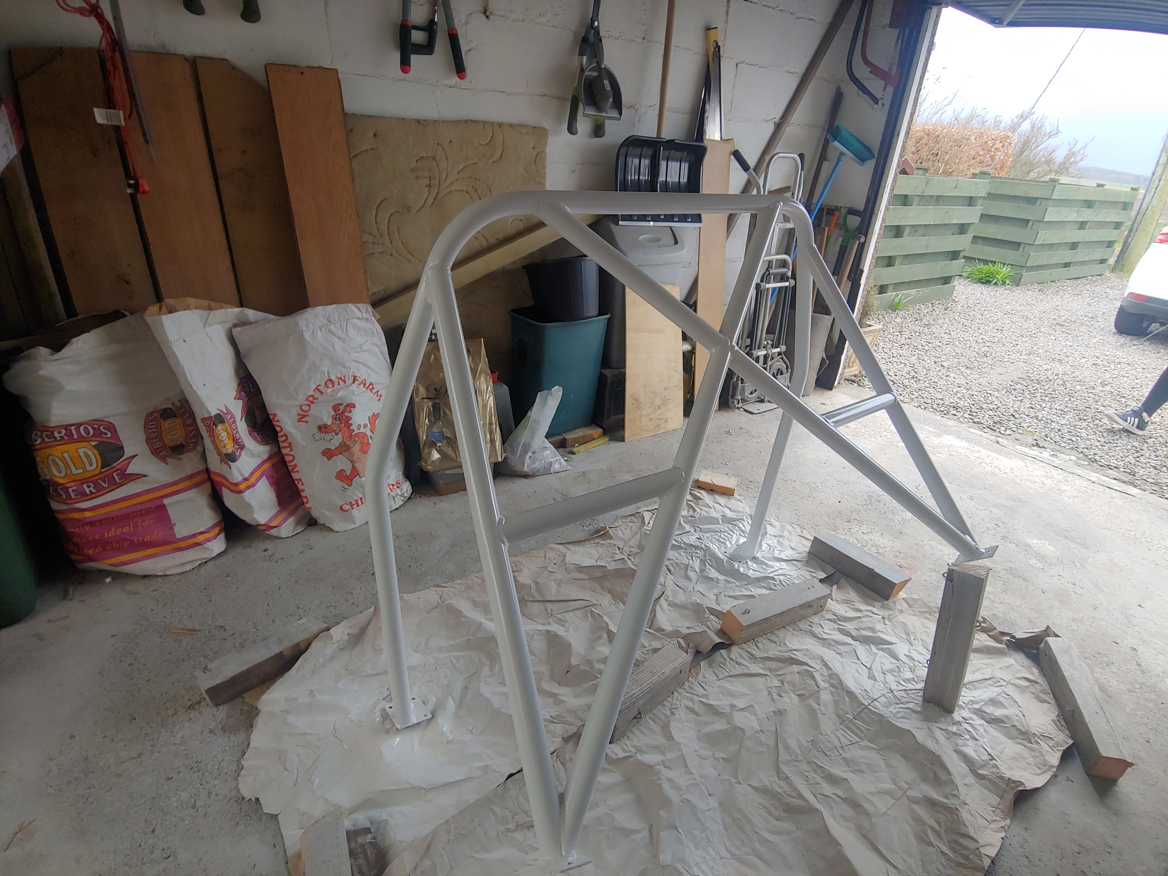

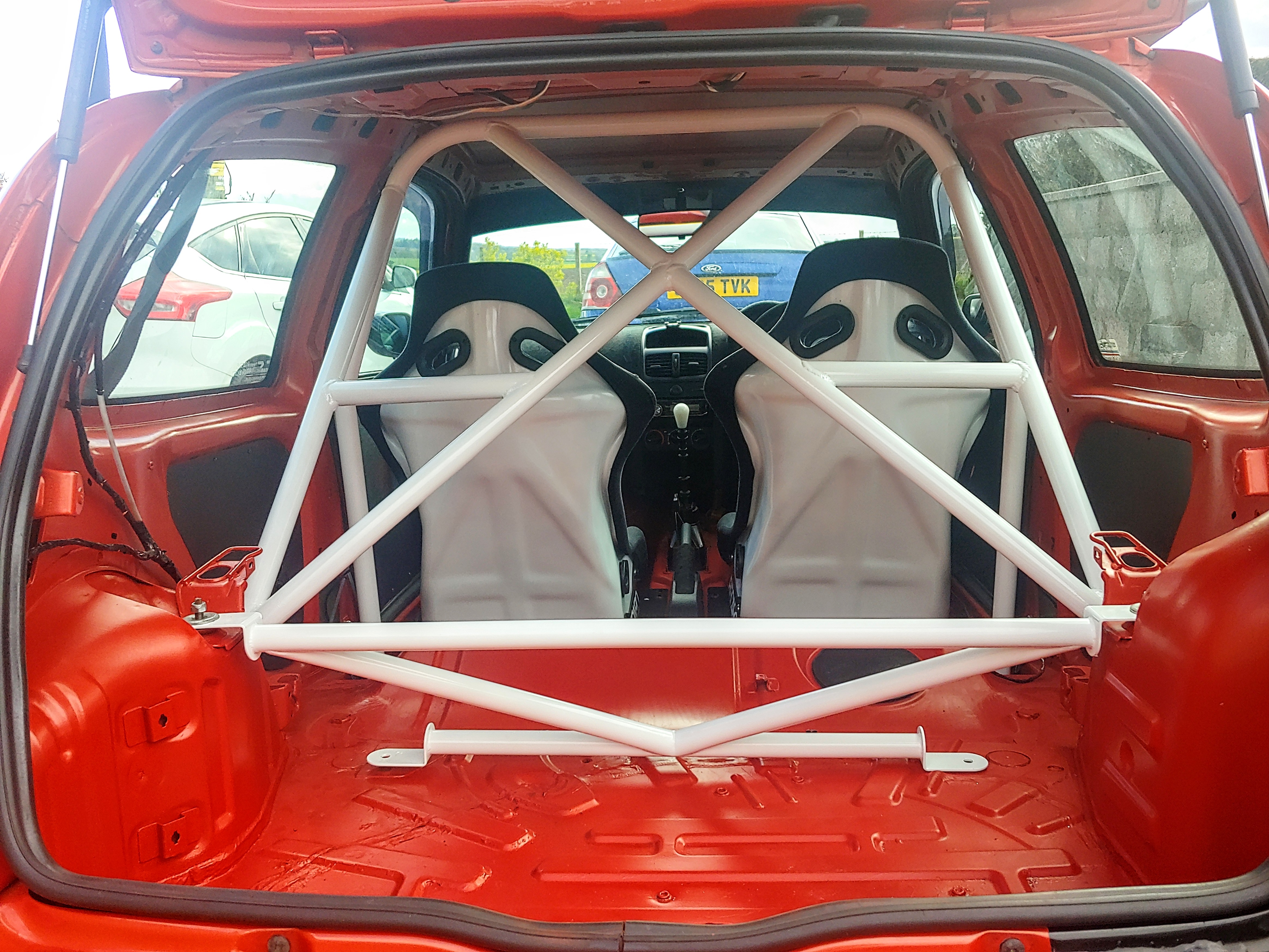

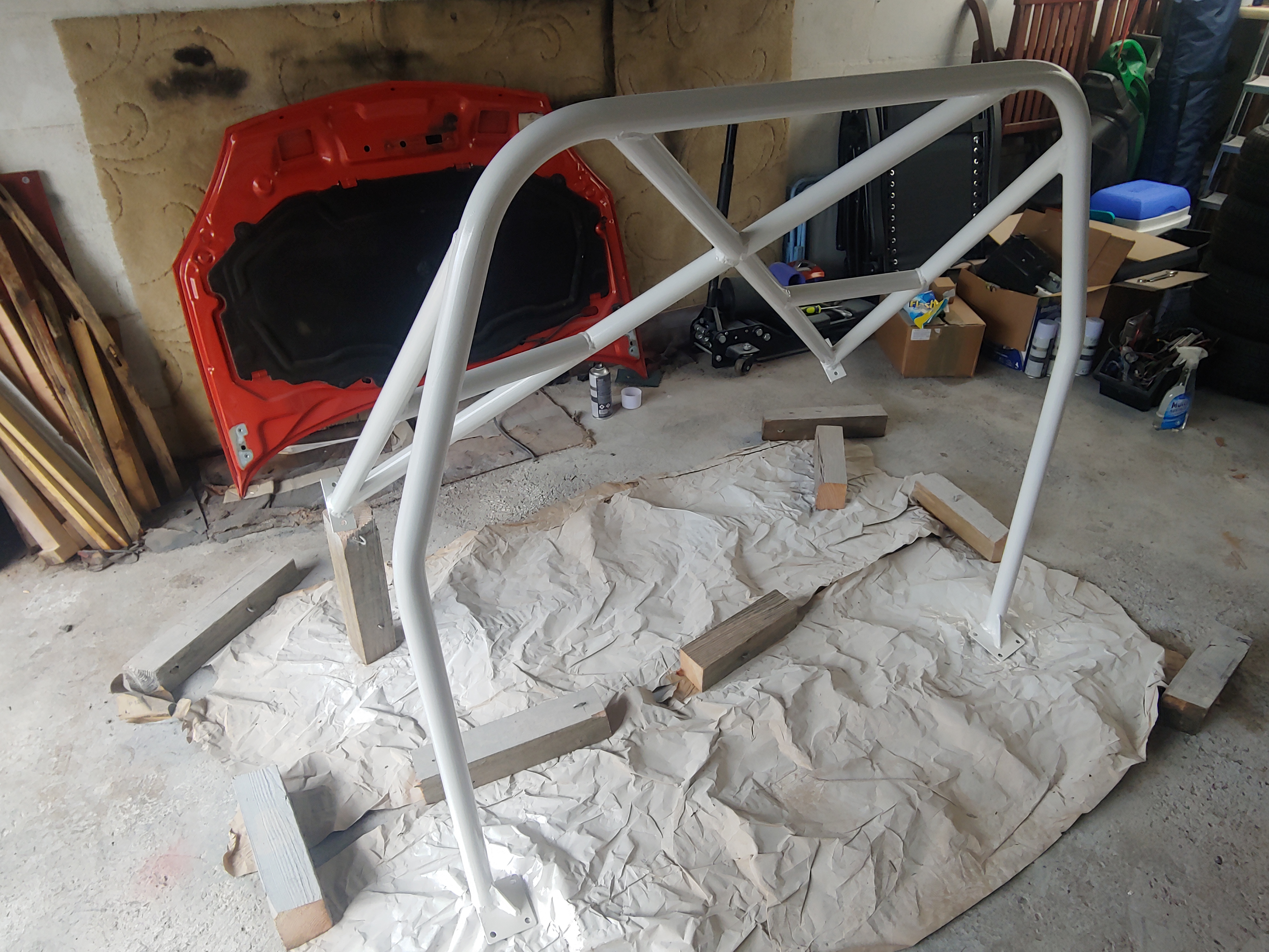

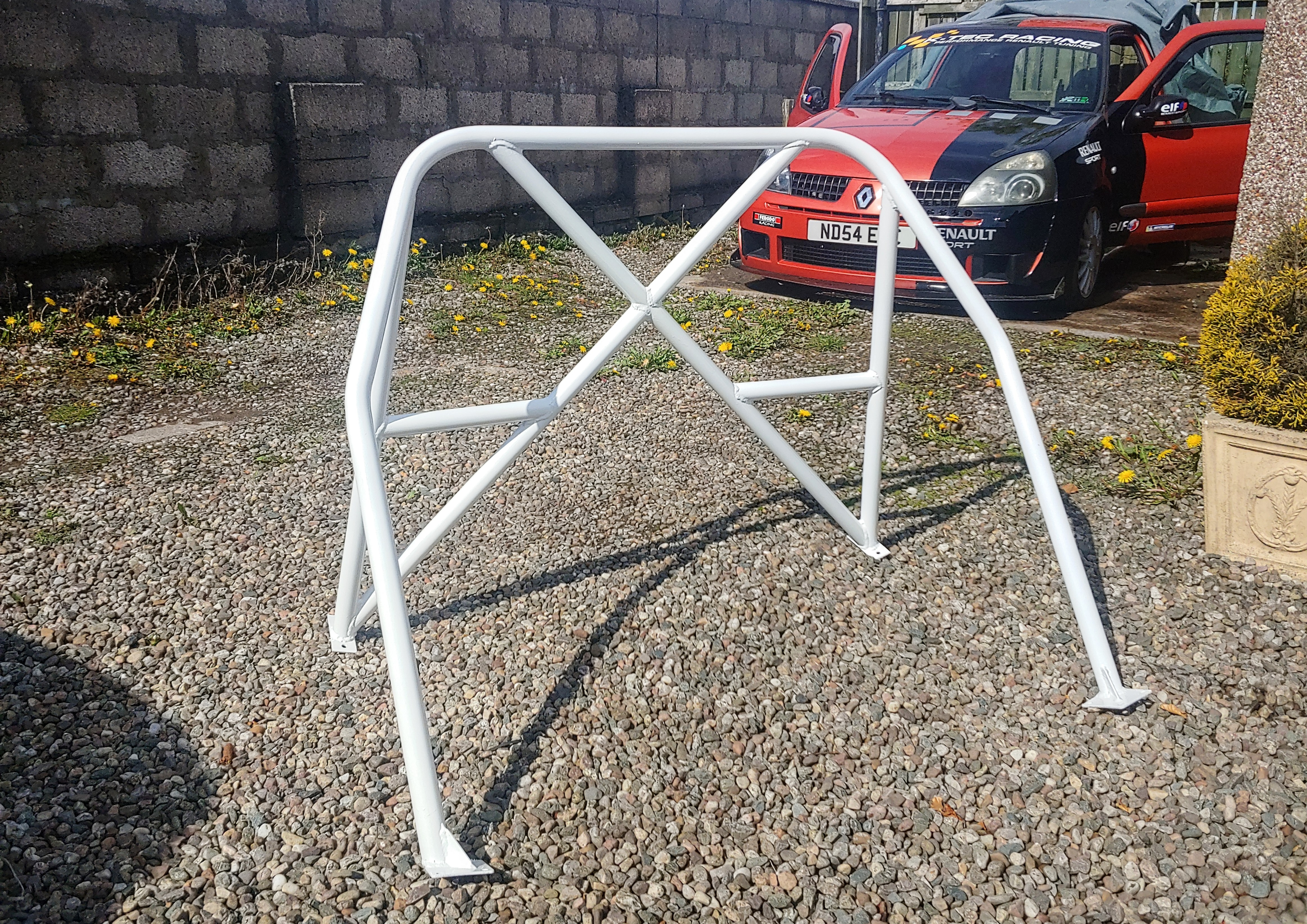

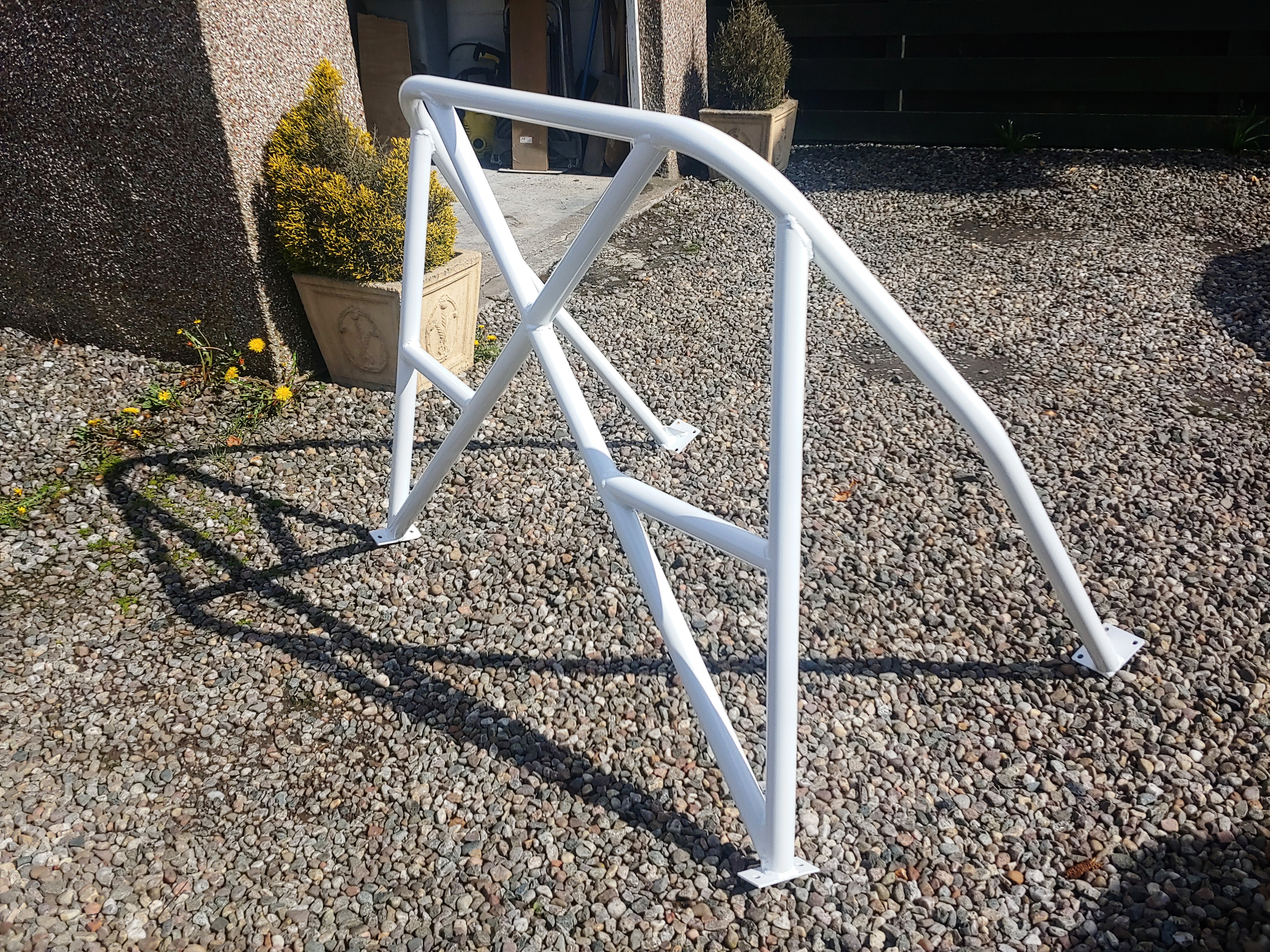

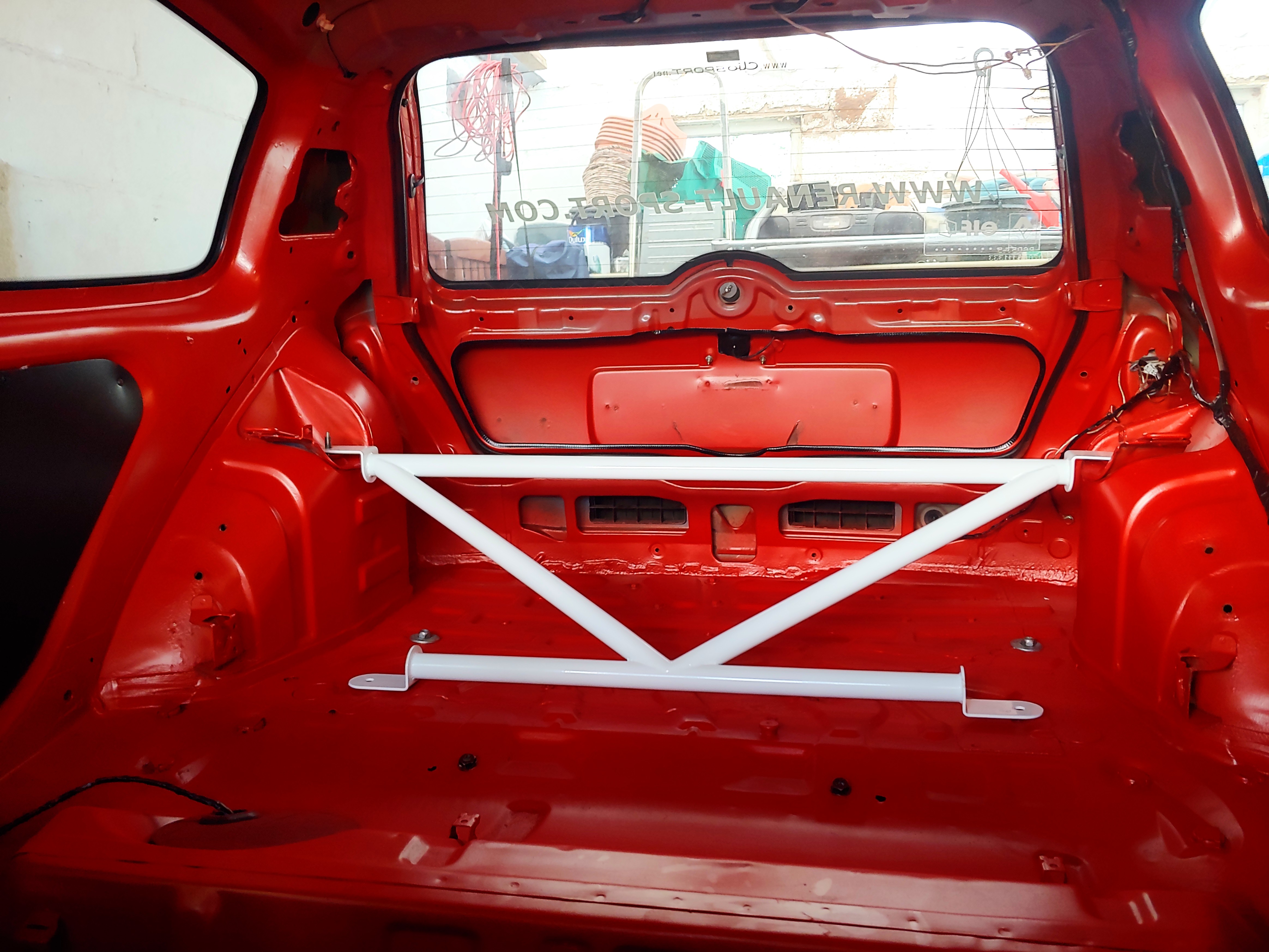

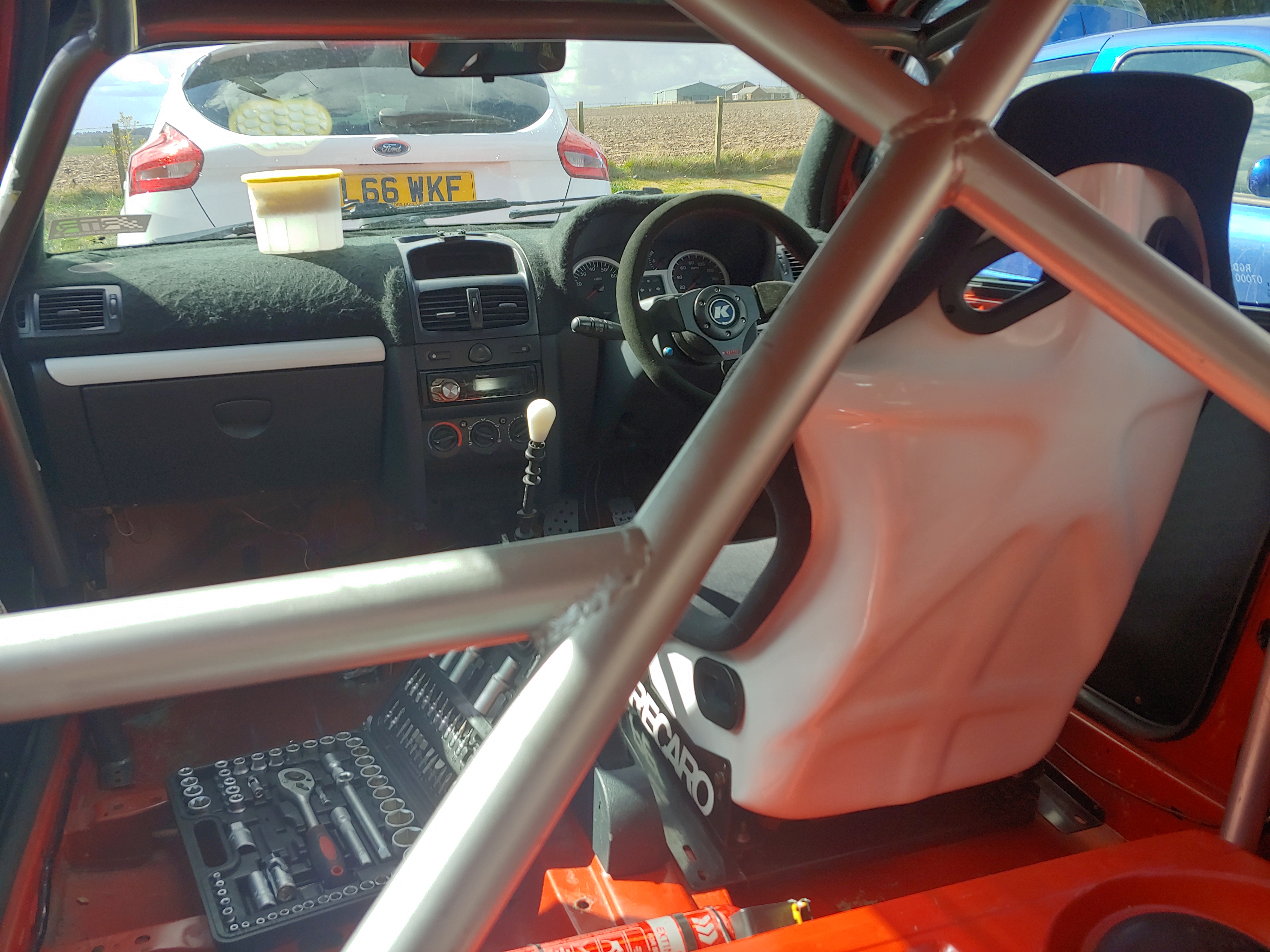

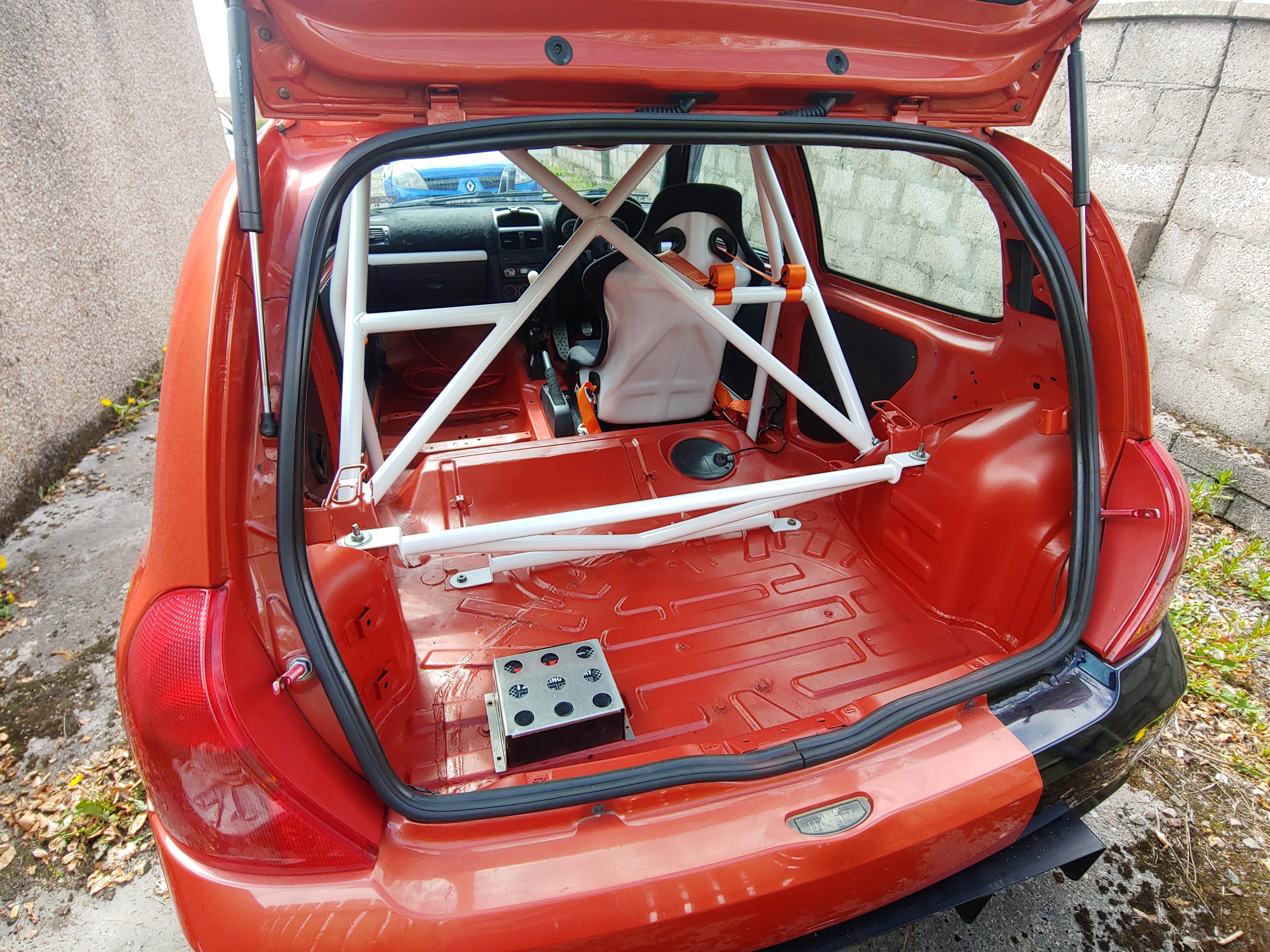

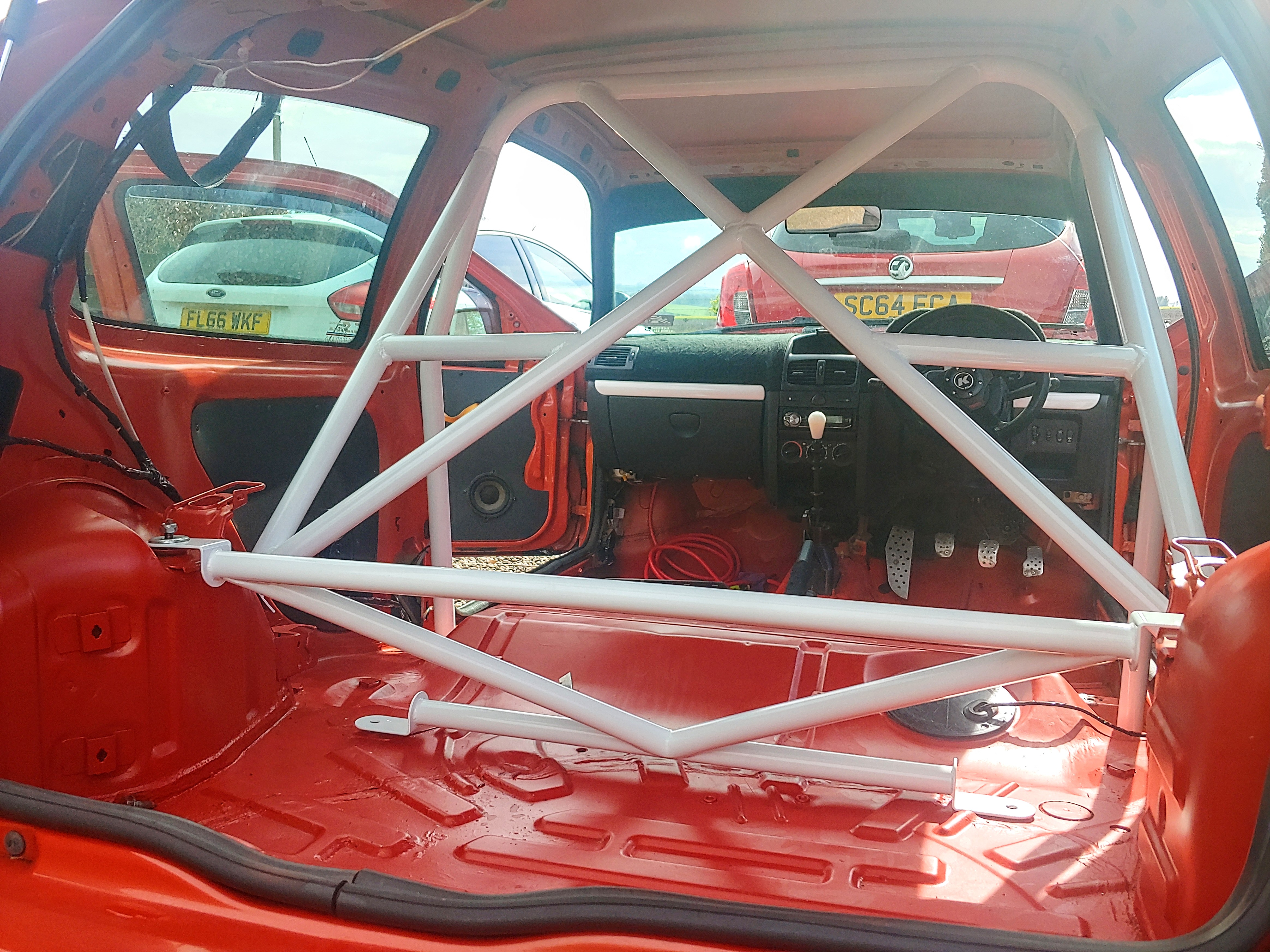

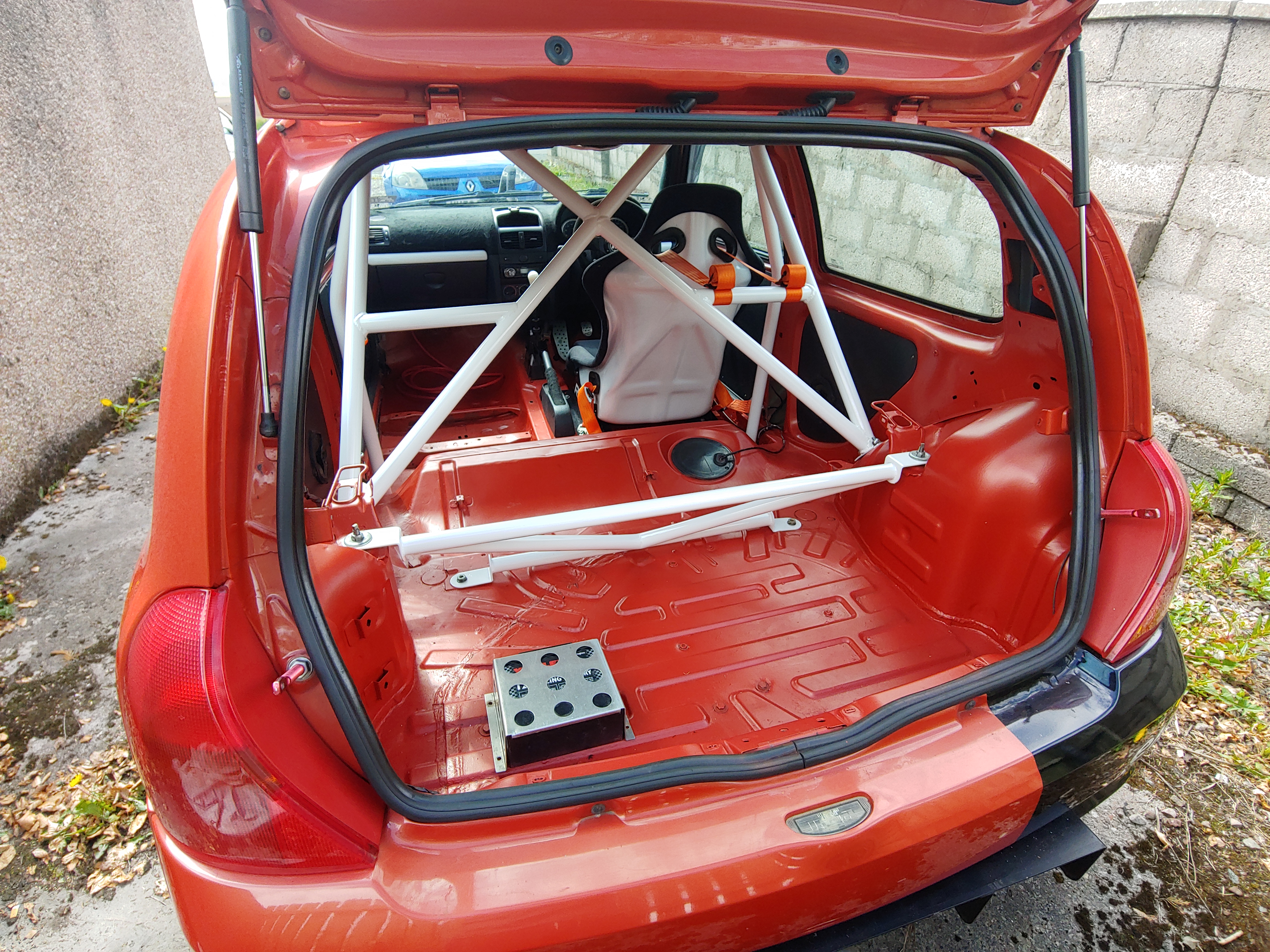

Well thats the cage painted now. All white and ready to be fitted. Took it out the garage to see how it looks in the day light.
Happy with the outcome.
Was time to get it in the car.
Luckily enough the paint i used was a decent match to the powdercoat used on the baf motorsport k brace.
Then with that sitting in i bolted it up and then placed my seats in situ. Just to get an idea of how the interior will look with all the white accents fitted. Absolutely loving the orange white colour scheme and contrast now.
Just a few more bite here and there and the interior will be complete!

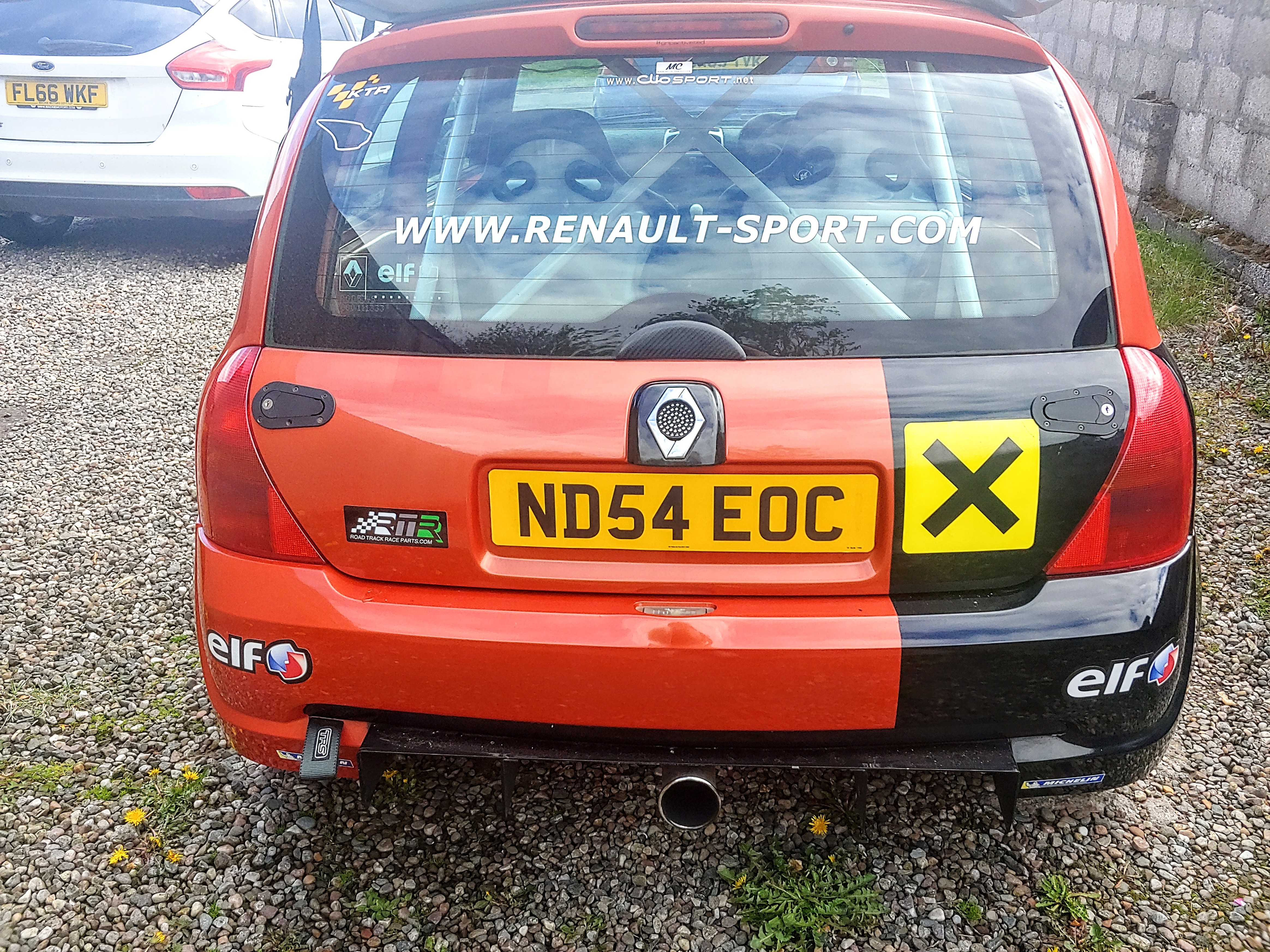

And may aswell throw in a rear end shot too.

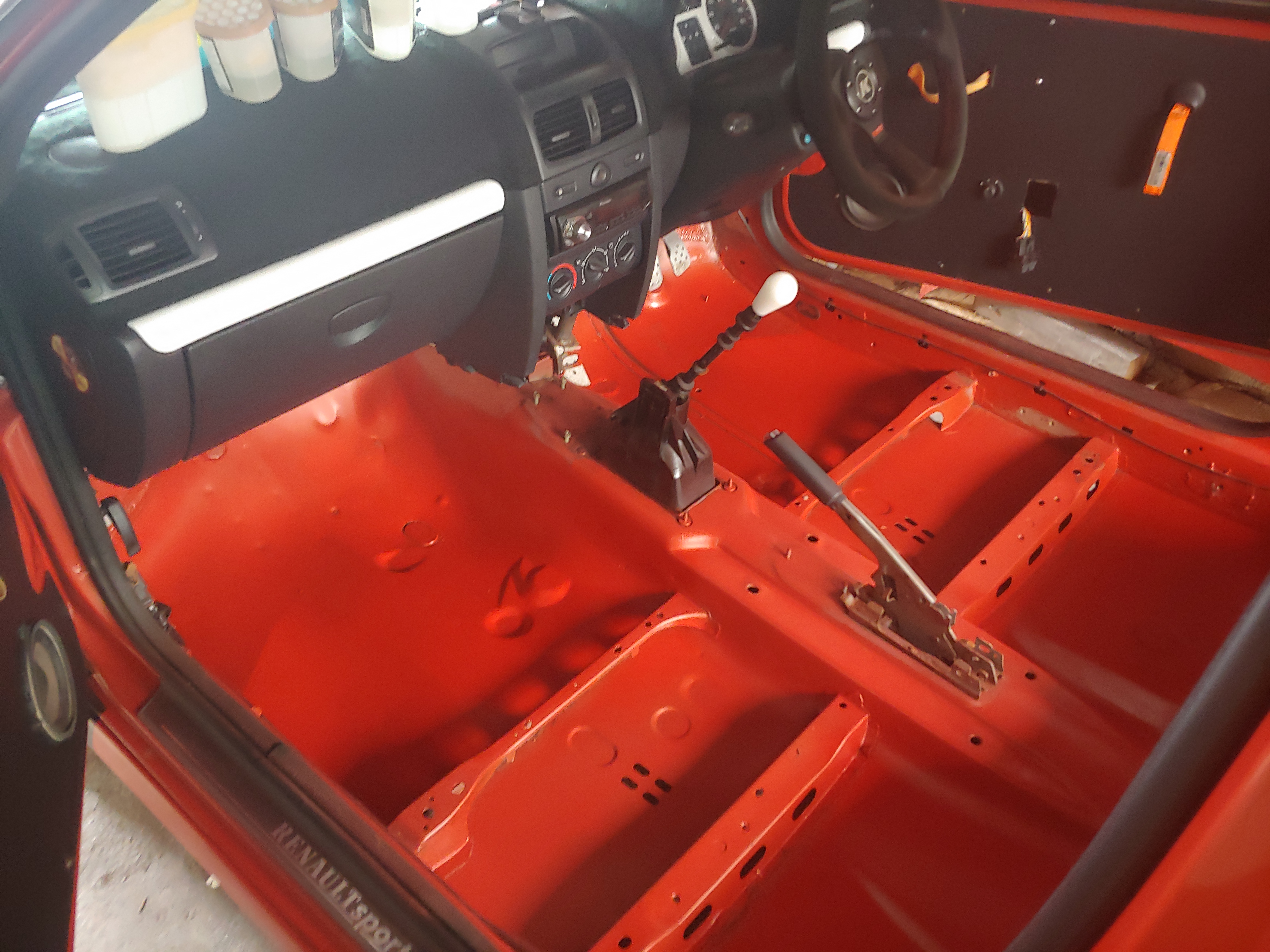

Wee bit of an update. Got round to re tapping the holes in the floor from the old isofix bar resulting in finally getting my rear brace fitted properly. Also got round to lowering the rear of the car to match the front and got the driver seat bolted in and harness fitted.
Before fitting the passenger seat i still need to work out where im sticking the battery.
Torn between where it is in the pic or behind the passenger seat. Behind the passenger seat seems to be the flattest place for it but when it rains I tend to get puddles there coming from someplace. So thats putting me off. 🤷

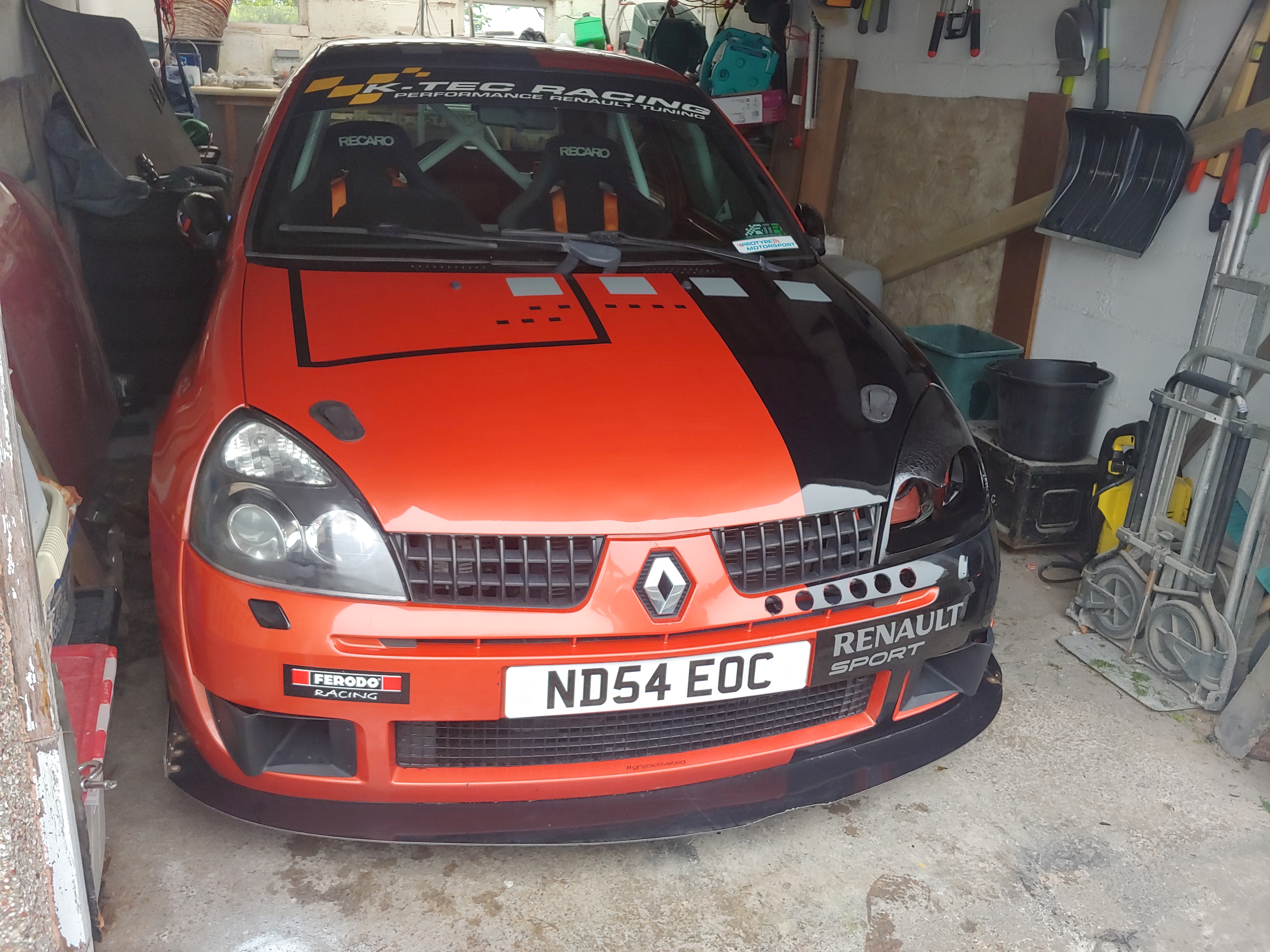

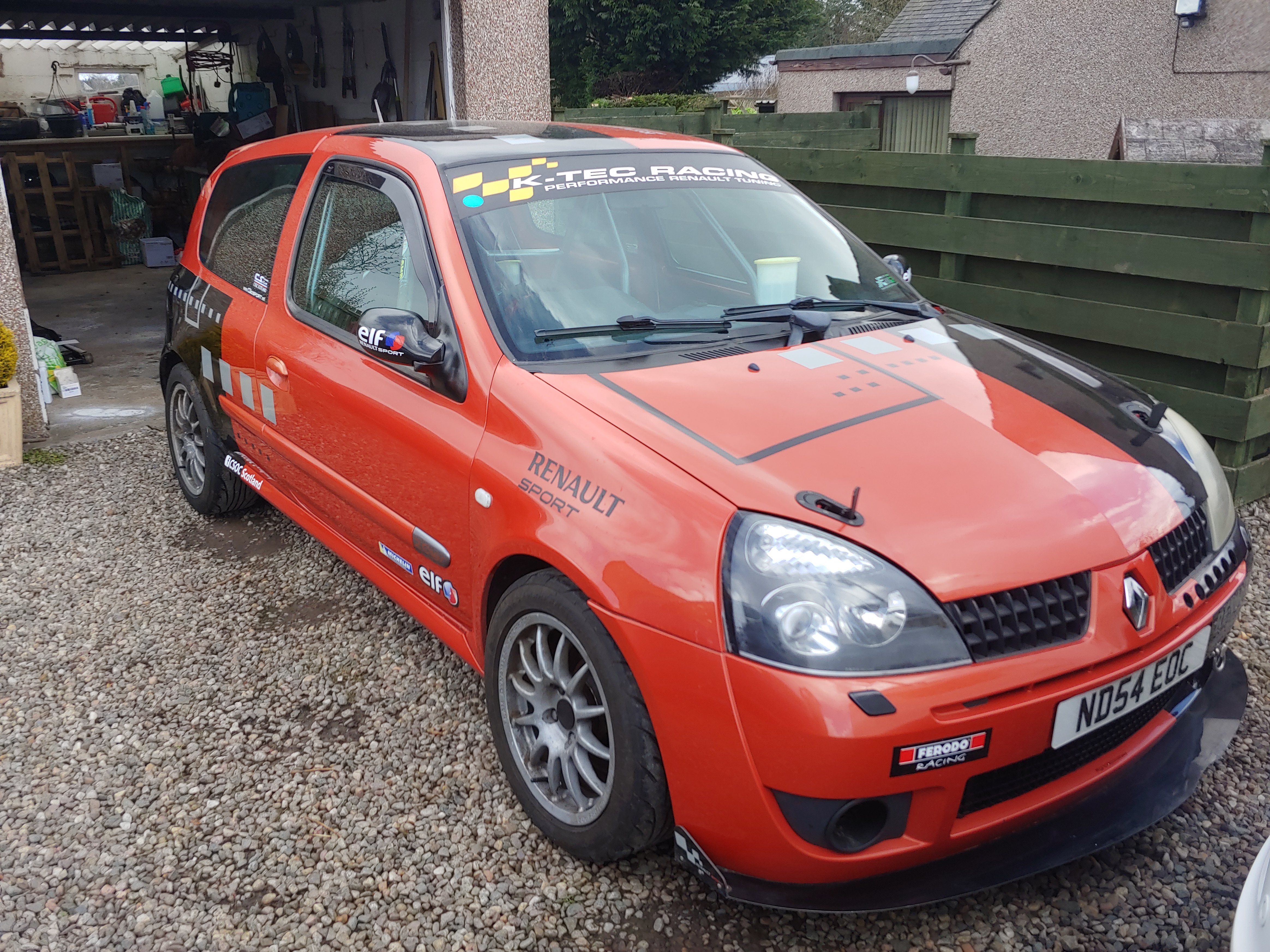

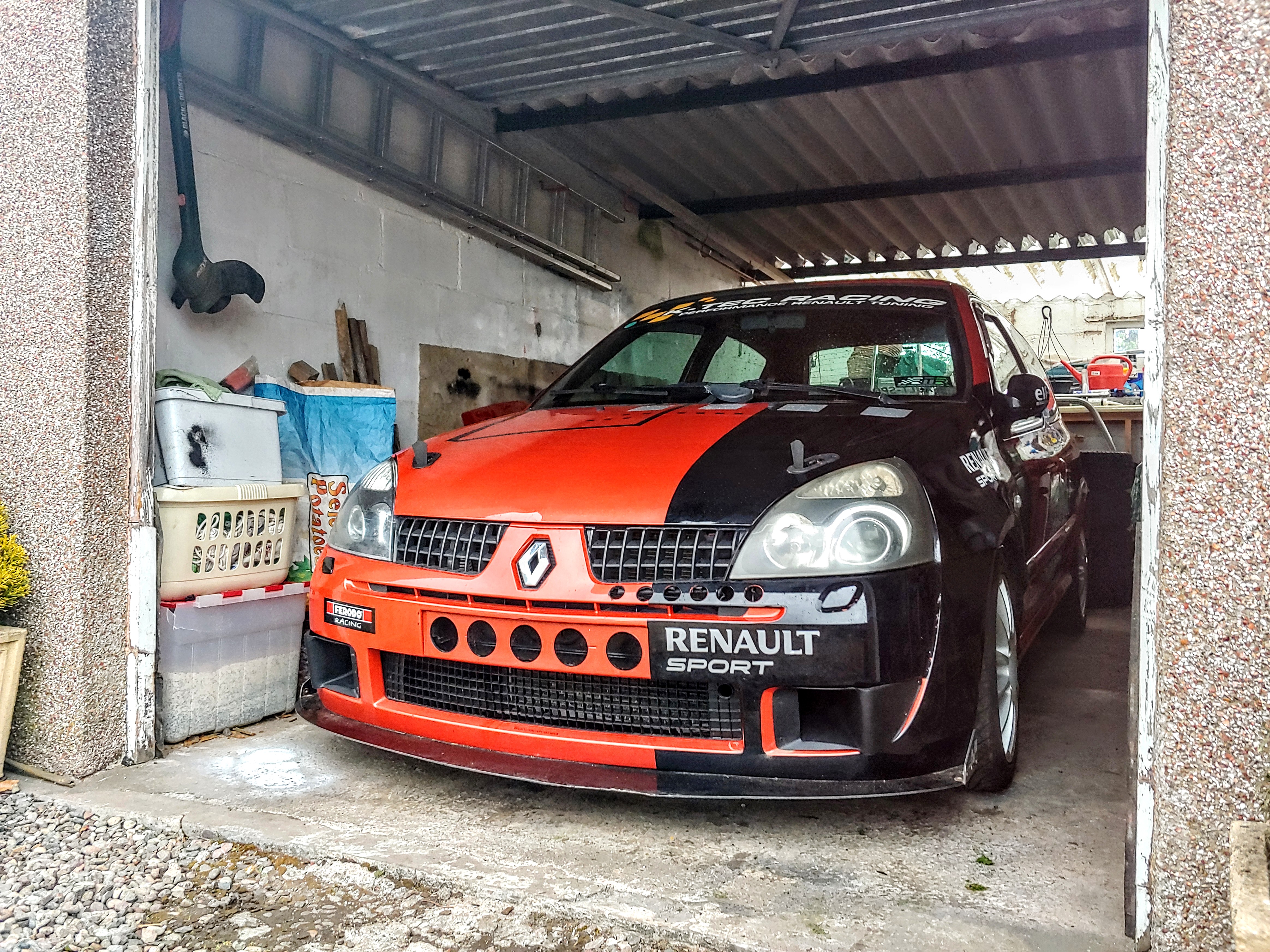

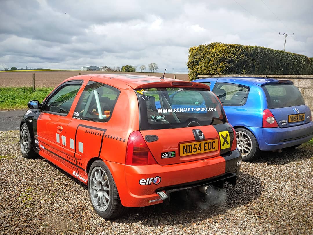

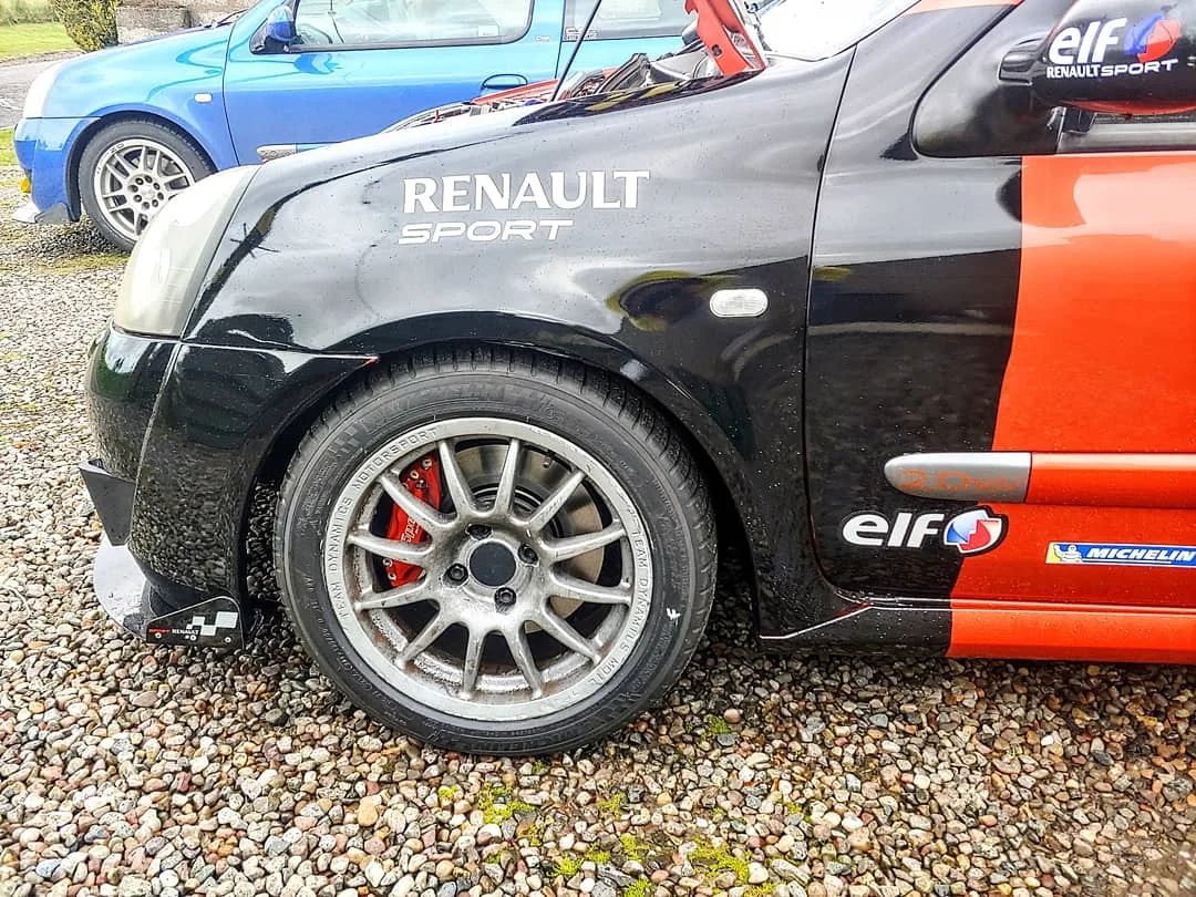

So the clio finally seen the road today! 1st time in about 6 months.

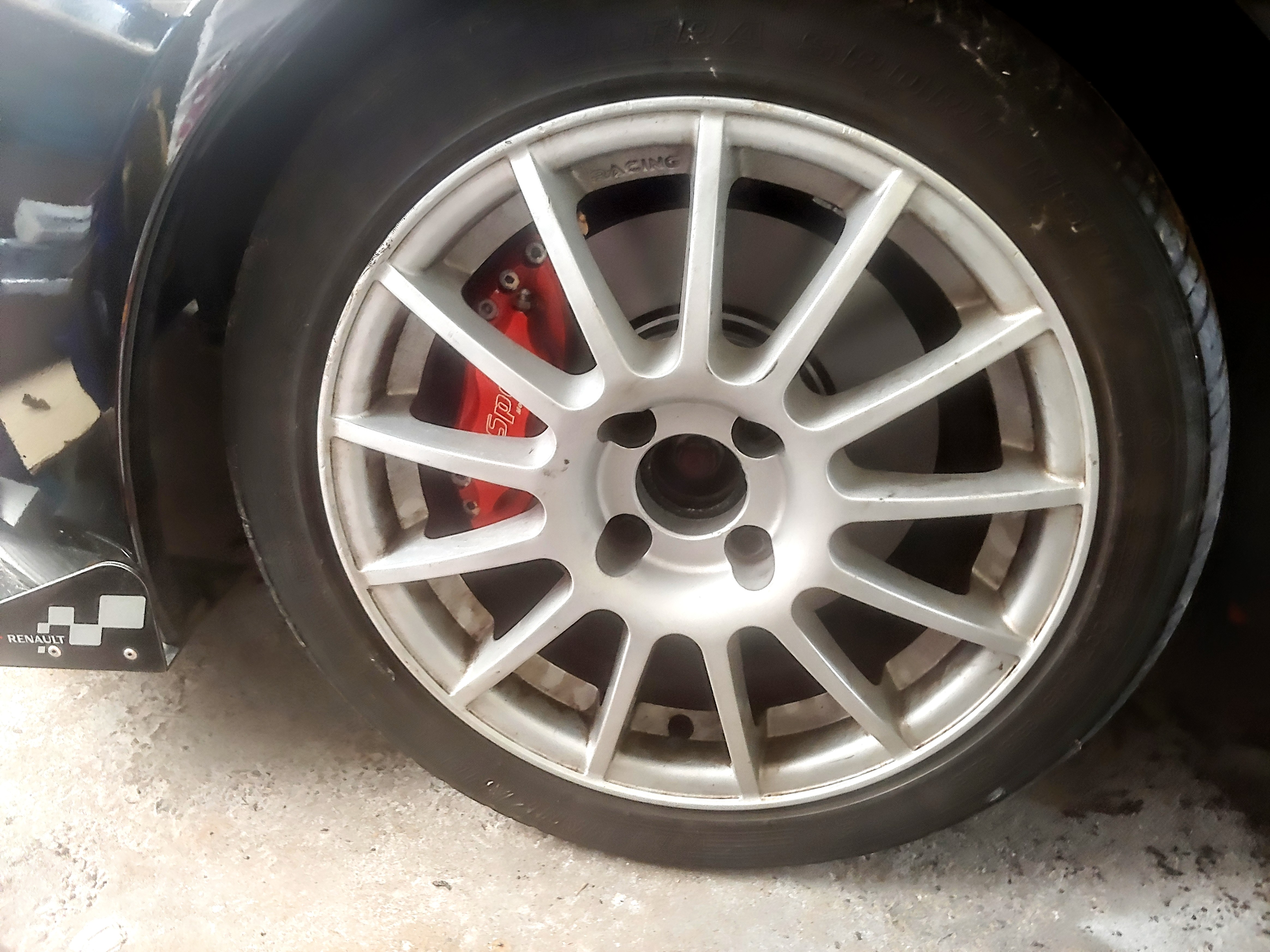

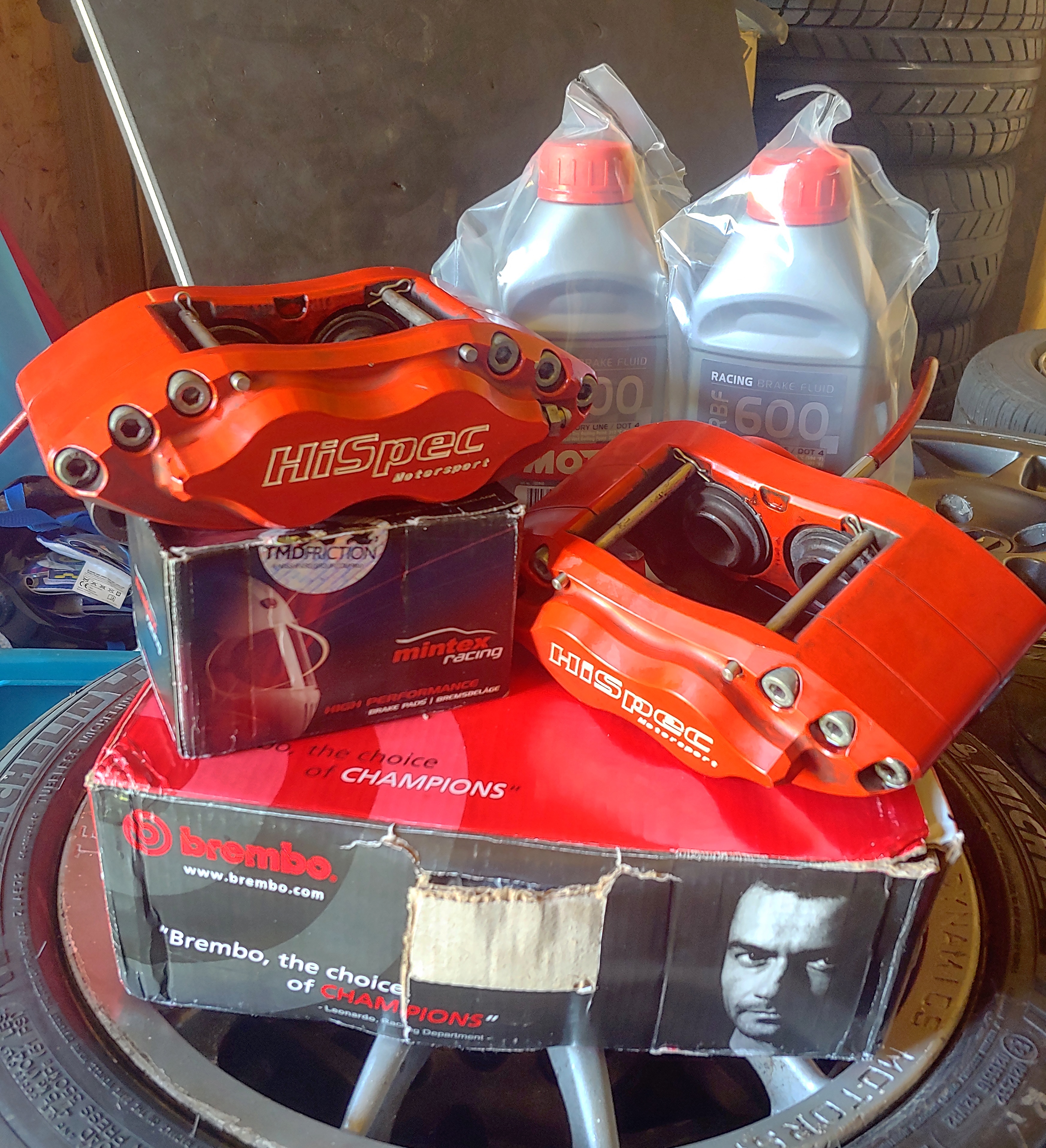

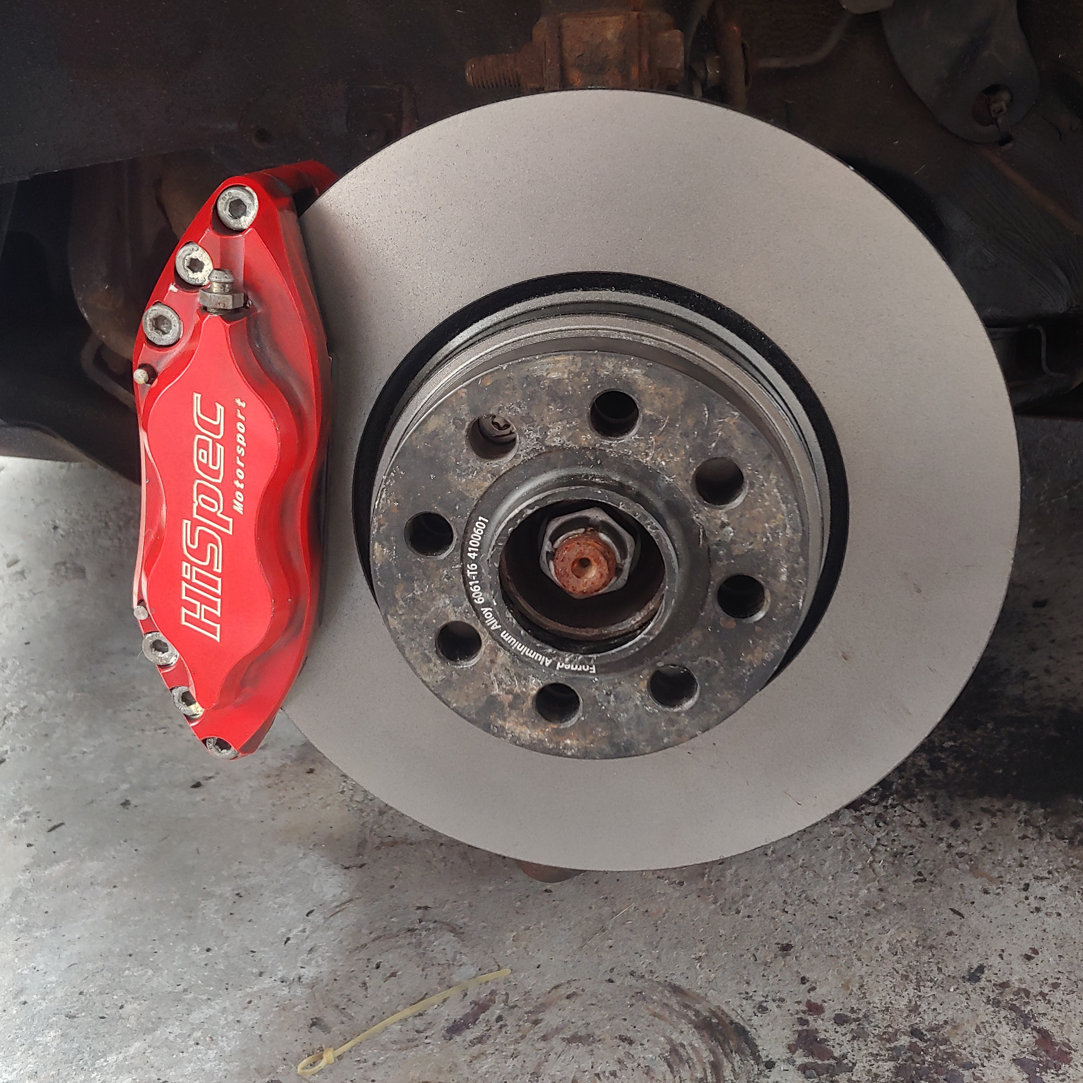

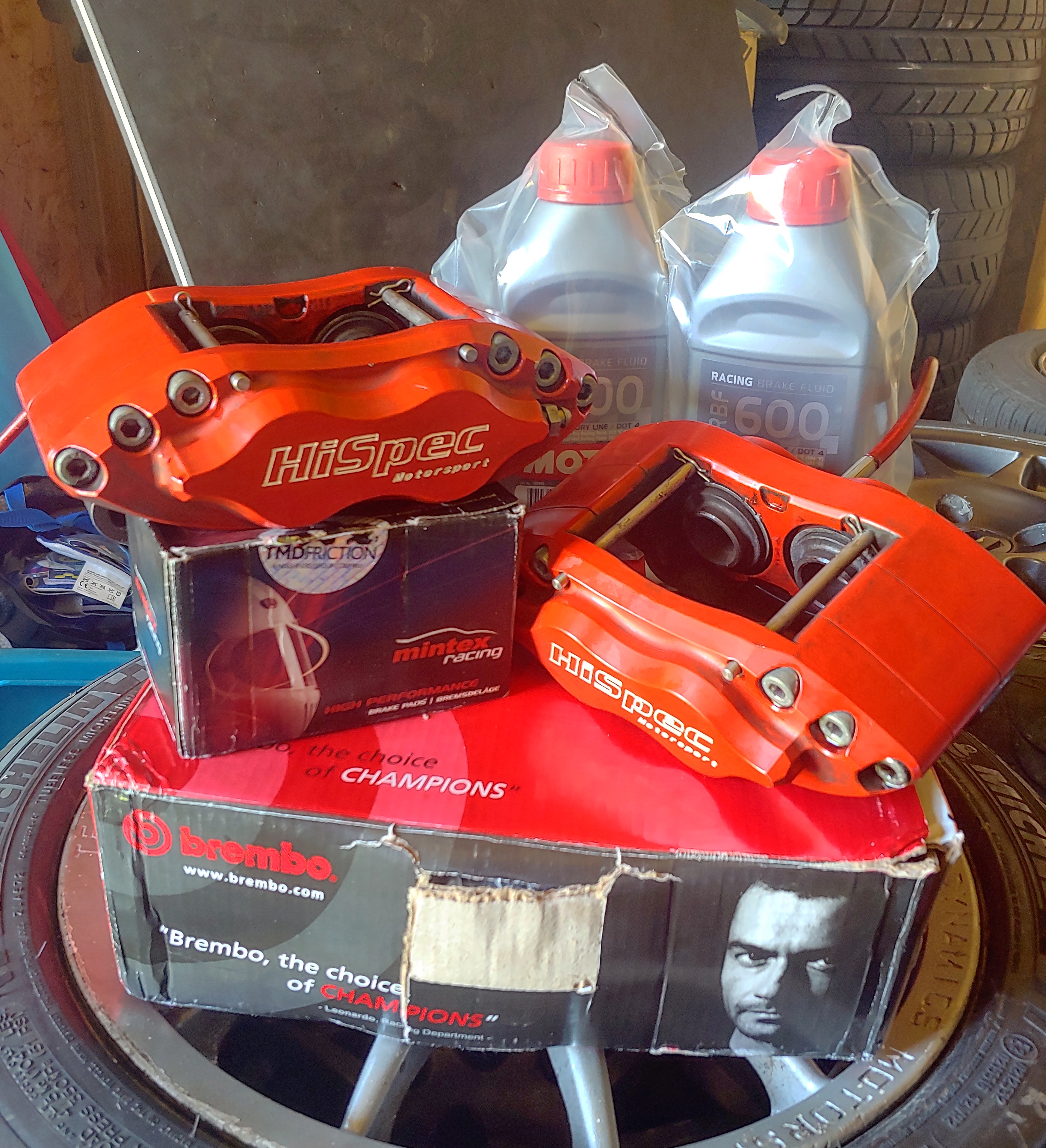

Got the calipers bled all round with the new fluid bled through and also tested the team dynamics back on to check for scrubbing issues. The road from my house to the nearest petrol station is full of twists, turns, bumps and dips was only really bedding the car in but at 60 there was no issues what so ever which is a relief!
As for the brakes, The feel brilliant! Noisy. To begin with the 1st to junctions i came too but after that they were fine. Alot more sensitive compared to standard but definitely stop the car!
Full tank of Vpower later and then back home, All fluids are fine and no noises to worry about.
Now a waiting game for next Monday when the Clio will have its first outing of the year at Knockhill!
Now i never got any pictures when it was out as it was raining but did get a couple before i left. Inc one with the mrs Cup

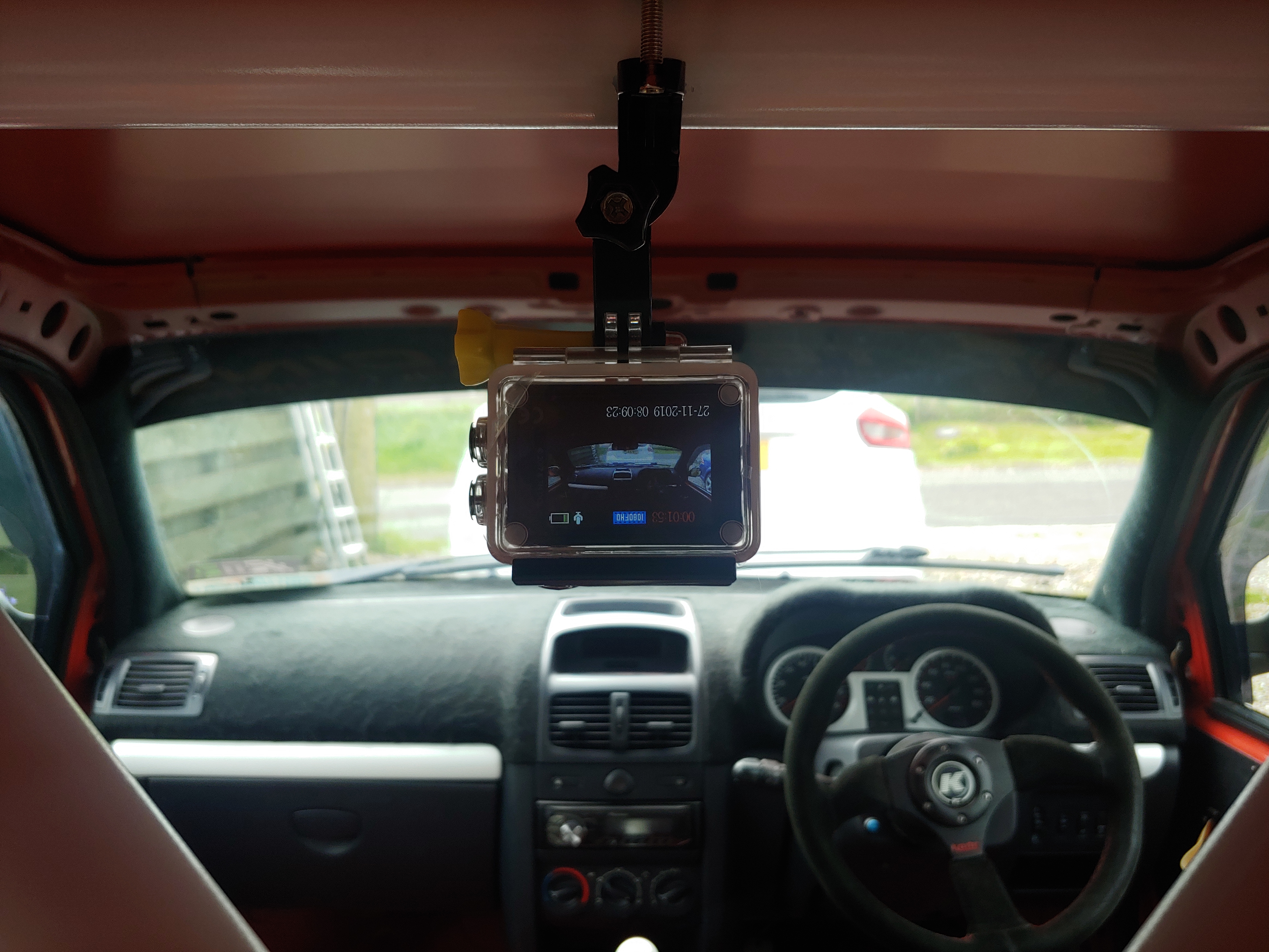

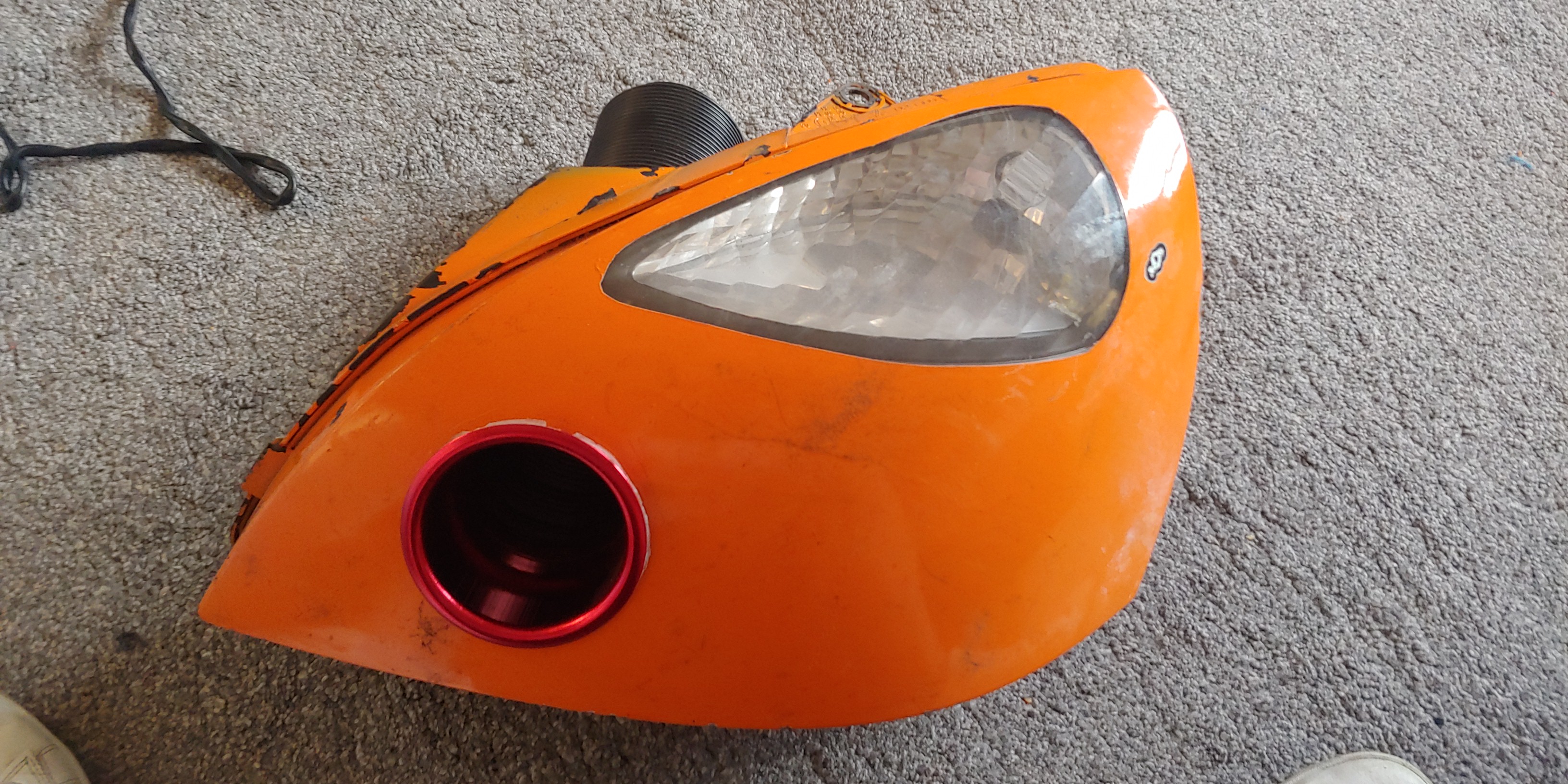

So with not much time to do anything before track time at Knockhill on monday evening. I have fitted a new action camera mount to my rollcage to hopefully get better footage.

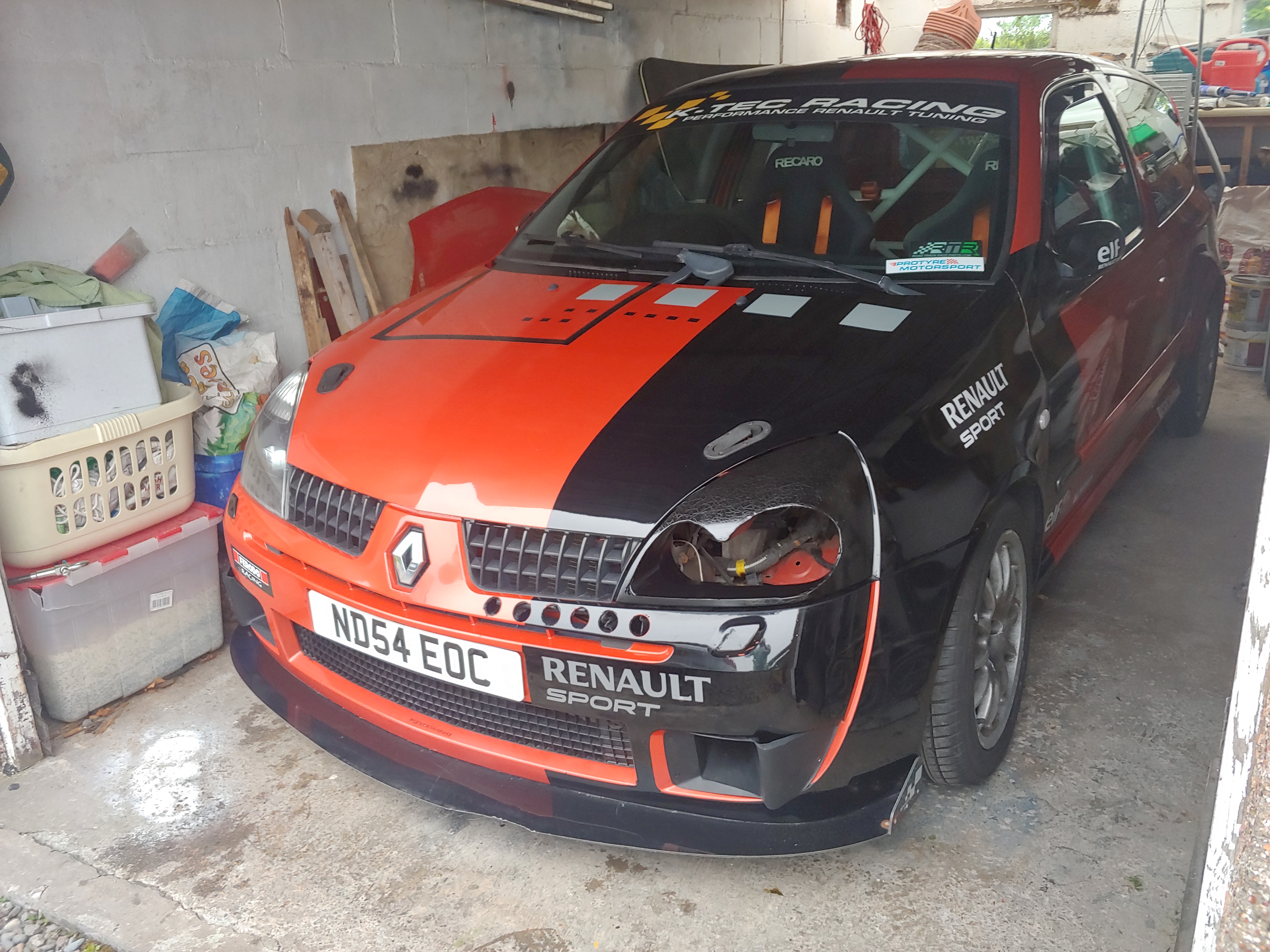

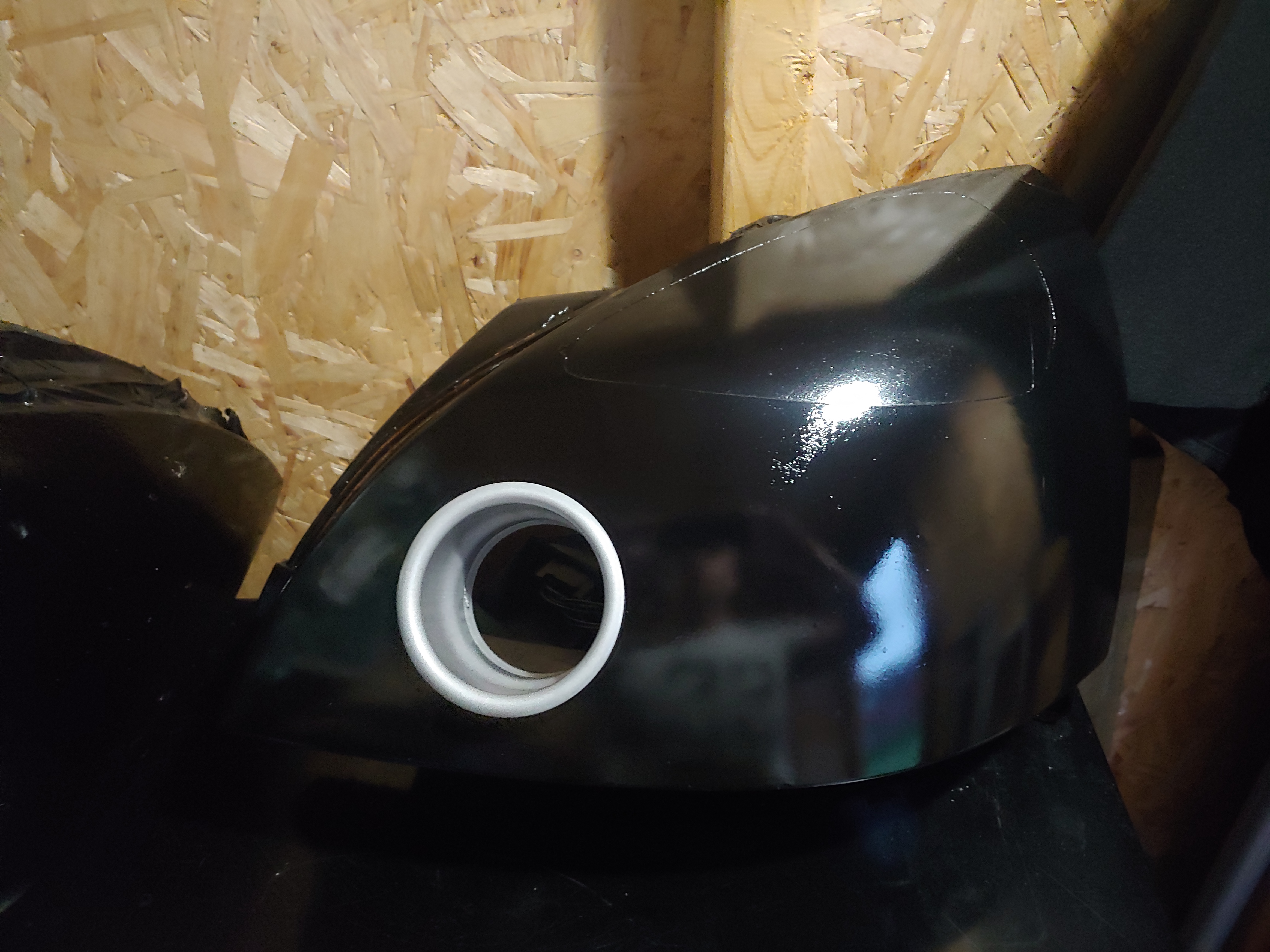

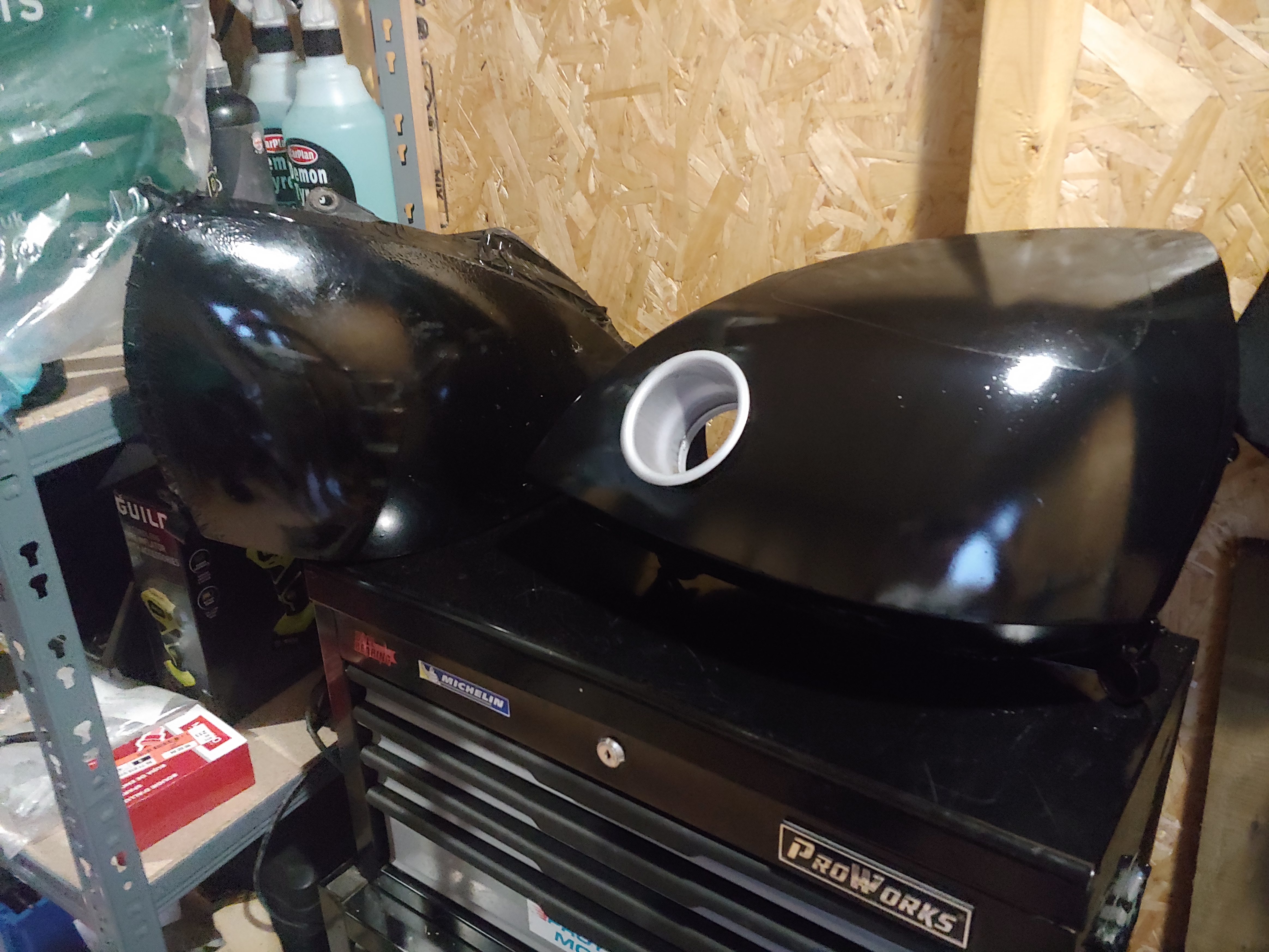

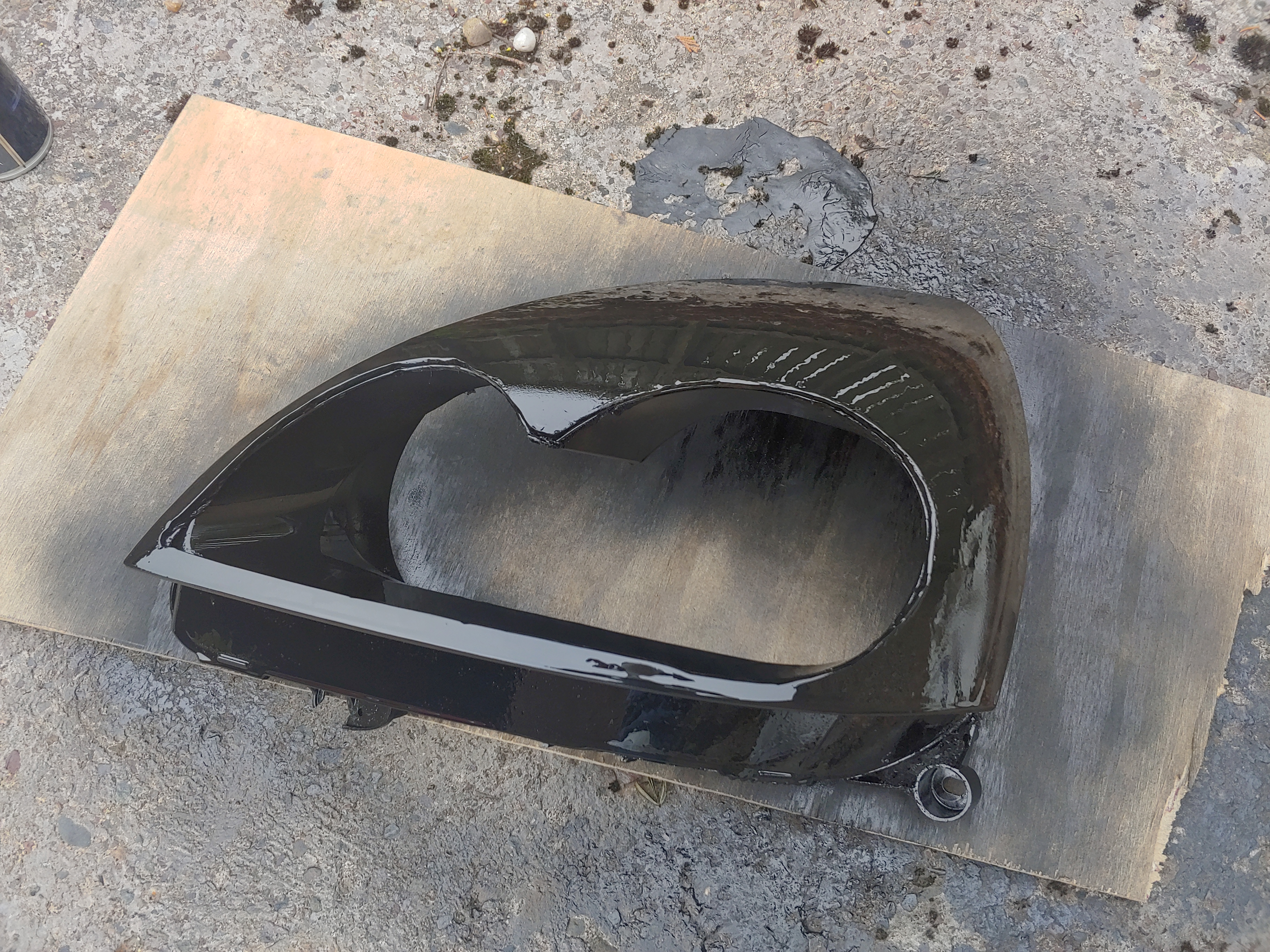

And also been toying with a different headlight intake design for my track day blanks.
Endless searching of different styles and looks I came accross one on instagram that someone else had made. So i take no credit for this idea but i have to say i do really like the look!

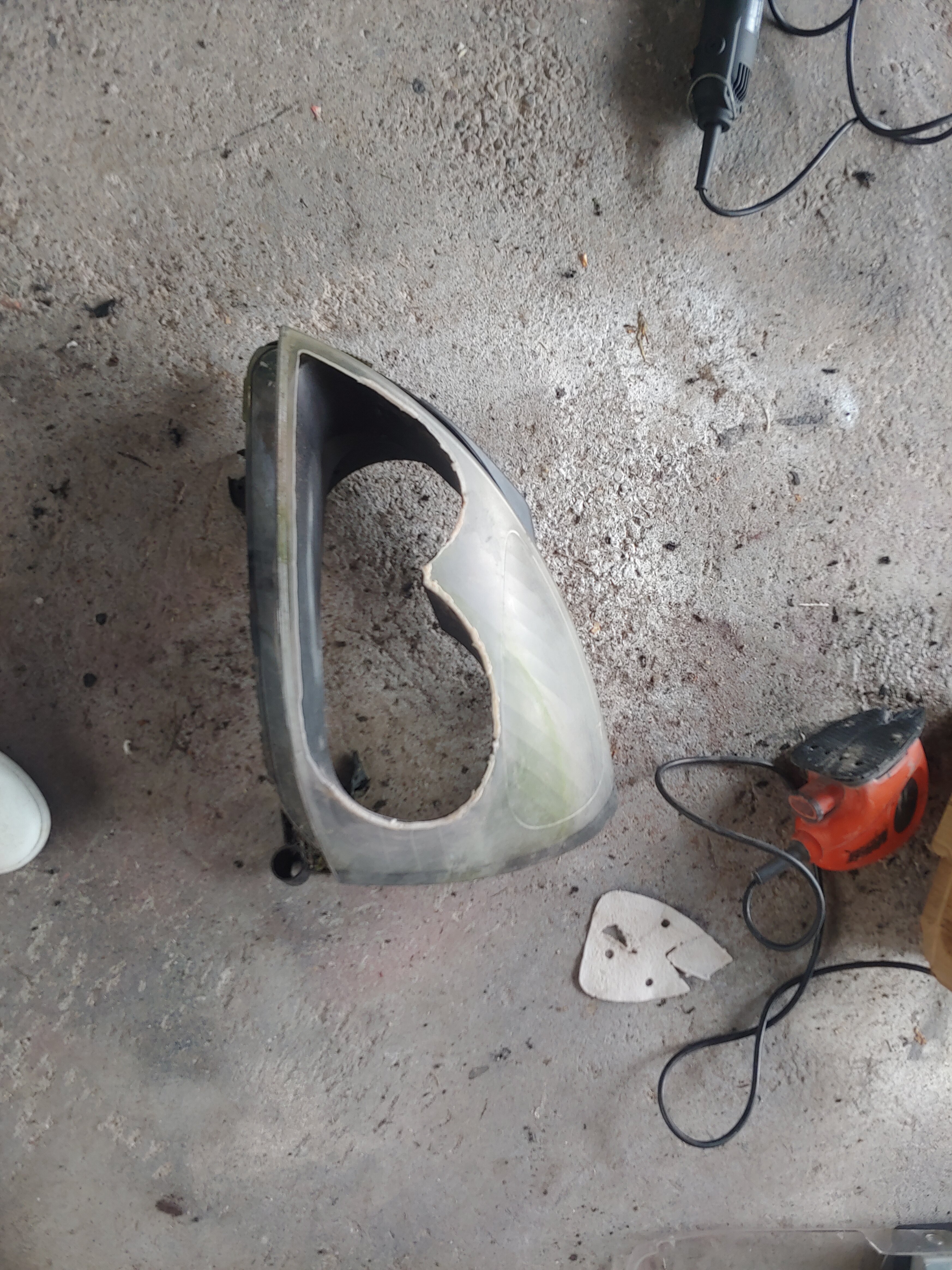

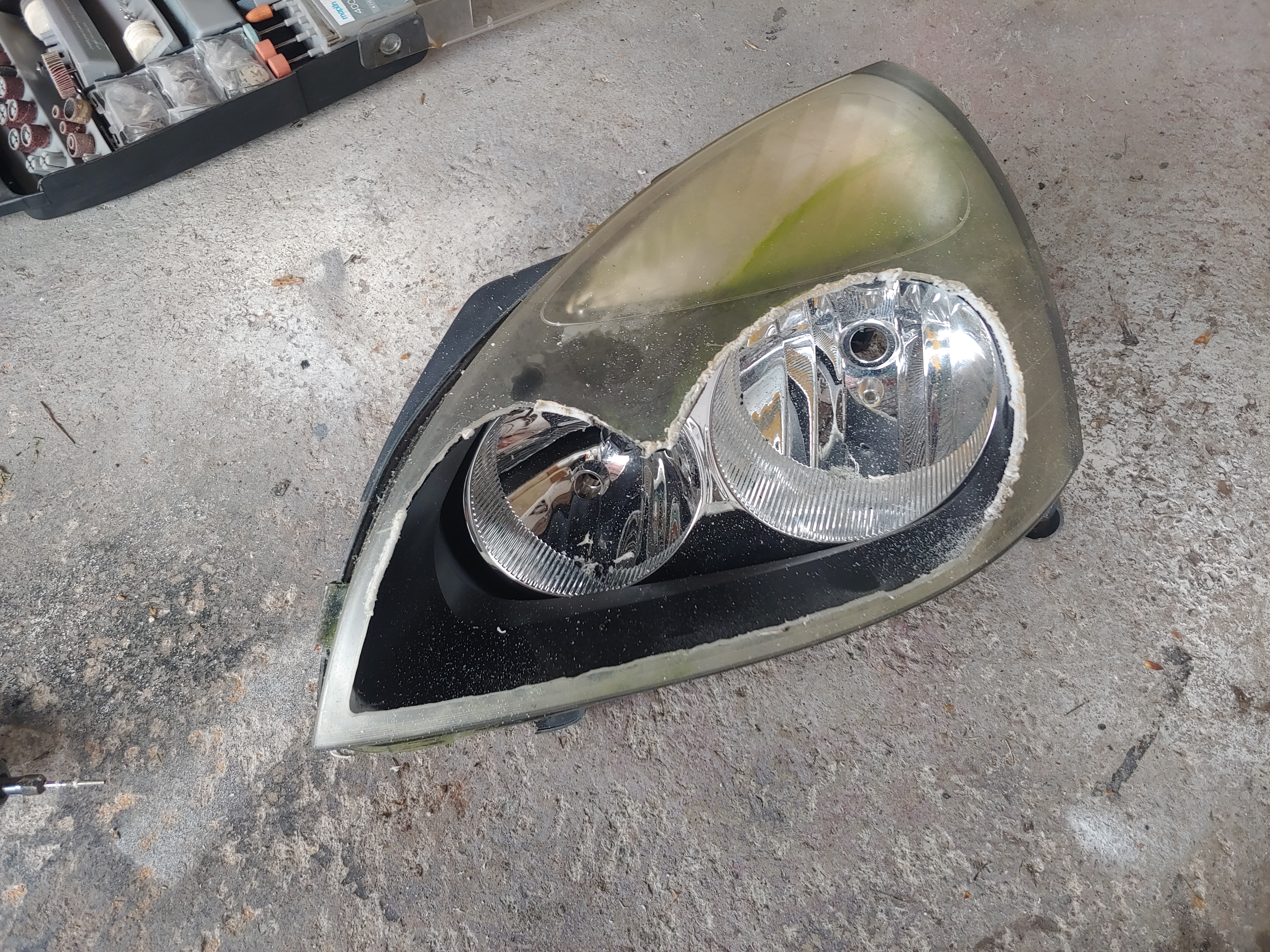

So basically i got an old absolutely knackered headlight off a scrap 1.2. The headlight had been left outside the car upside down and the inside of it was like a swamp. So cleaned it out a bit and got the Dremel out and cut out the headlight and main beam shape.
Its a little rough round the edges etc so i sanded it all back and got it as smooth as I can. I then started to gut the back of the headlight and removed everything possible but kept the black insert inside to act as a sort of deflector.
With that done I then gave it a coat of paint
Then onto a trial fit. Now unfortuantly the paint reacted like God knows what but I'm not fussed cause I'll probable just wrap it like my other ones.
So heres the result. Im happy with the look of the blank. Im not happy with whole outcome though.
As you can see you can see far too much through the blank and it looks a bit naff.
I do belive that once the filters behind there it will look better but im trying to work out a sort of plastic welded duct to the back so all you see is a black duct directing the air directly to the filter once I refit my 45 degree elbow and have the filter facing towards the passenger headlight.

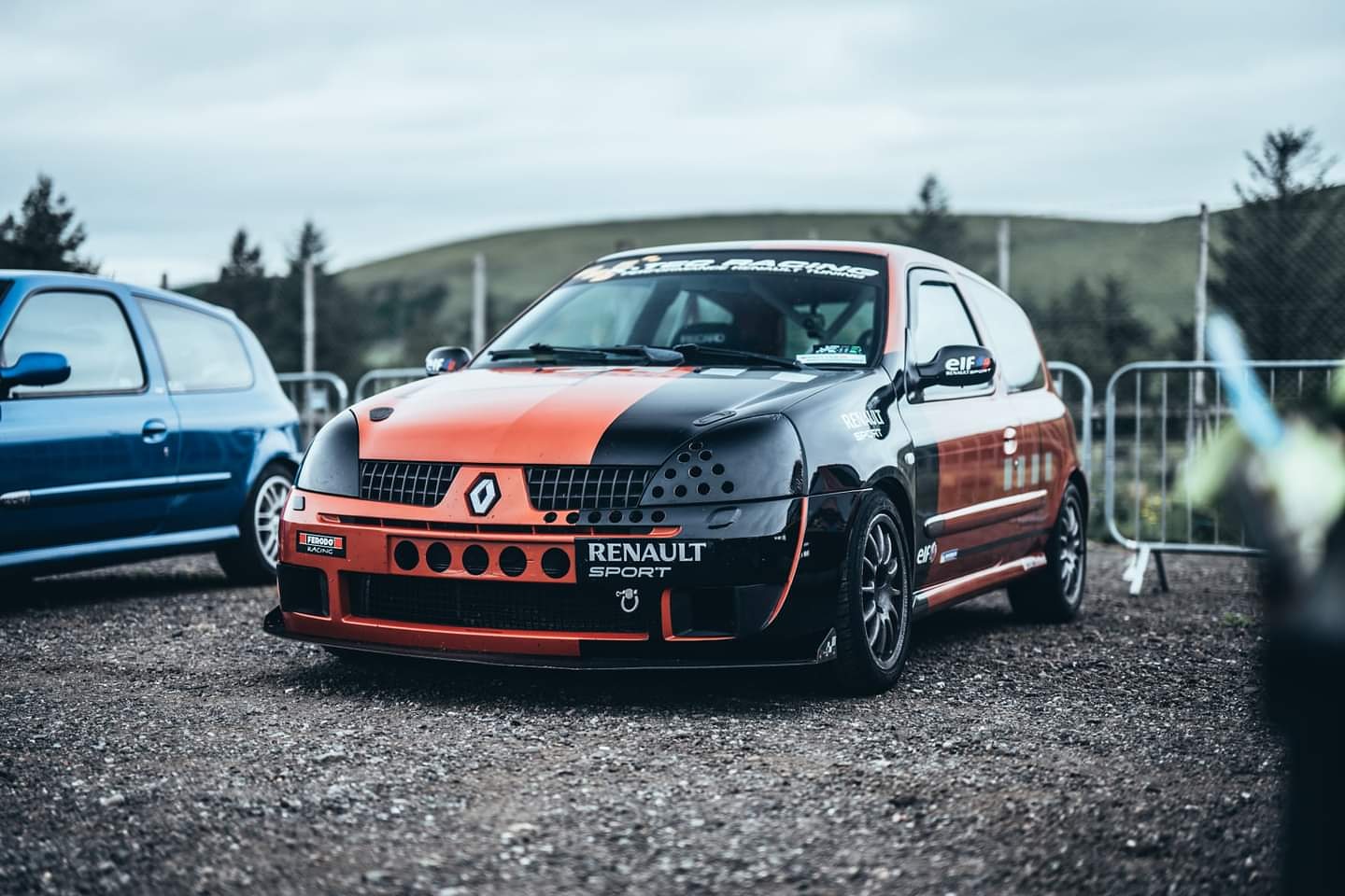

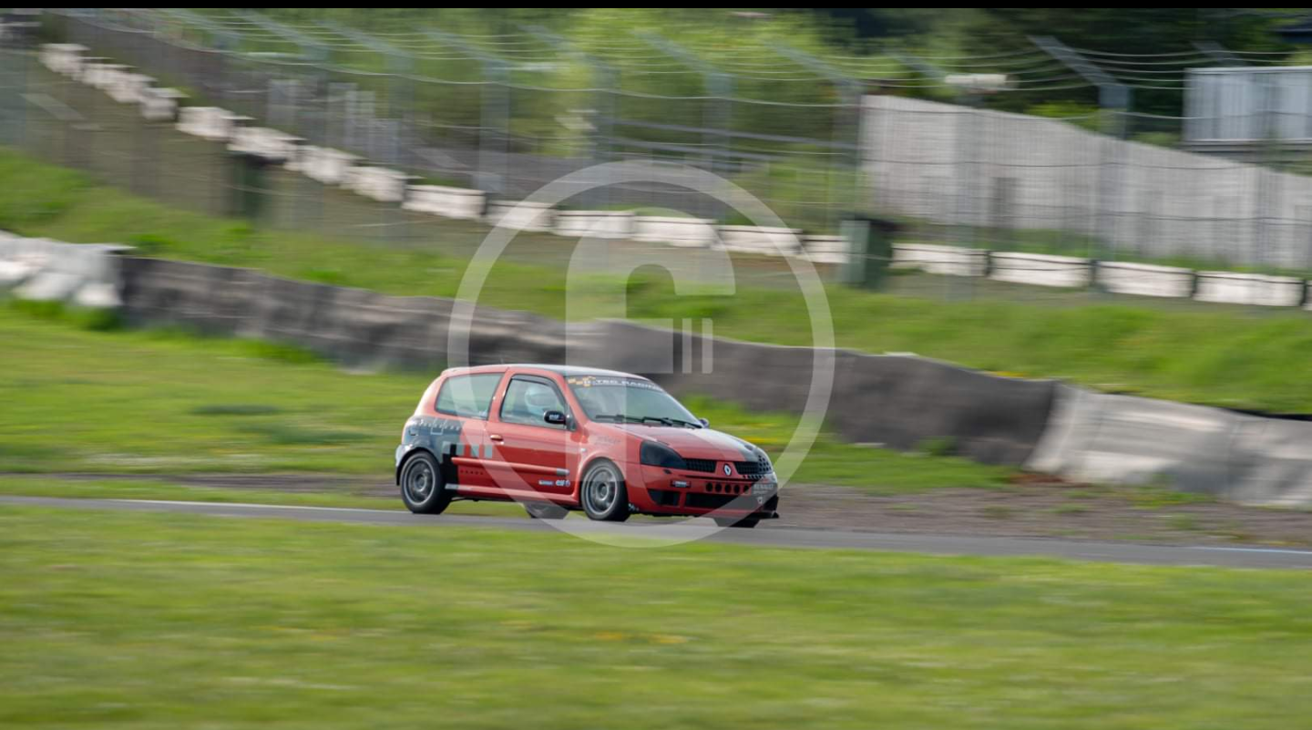

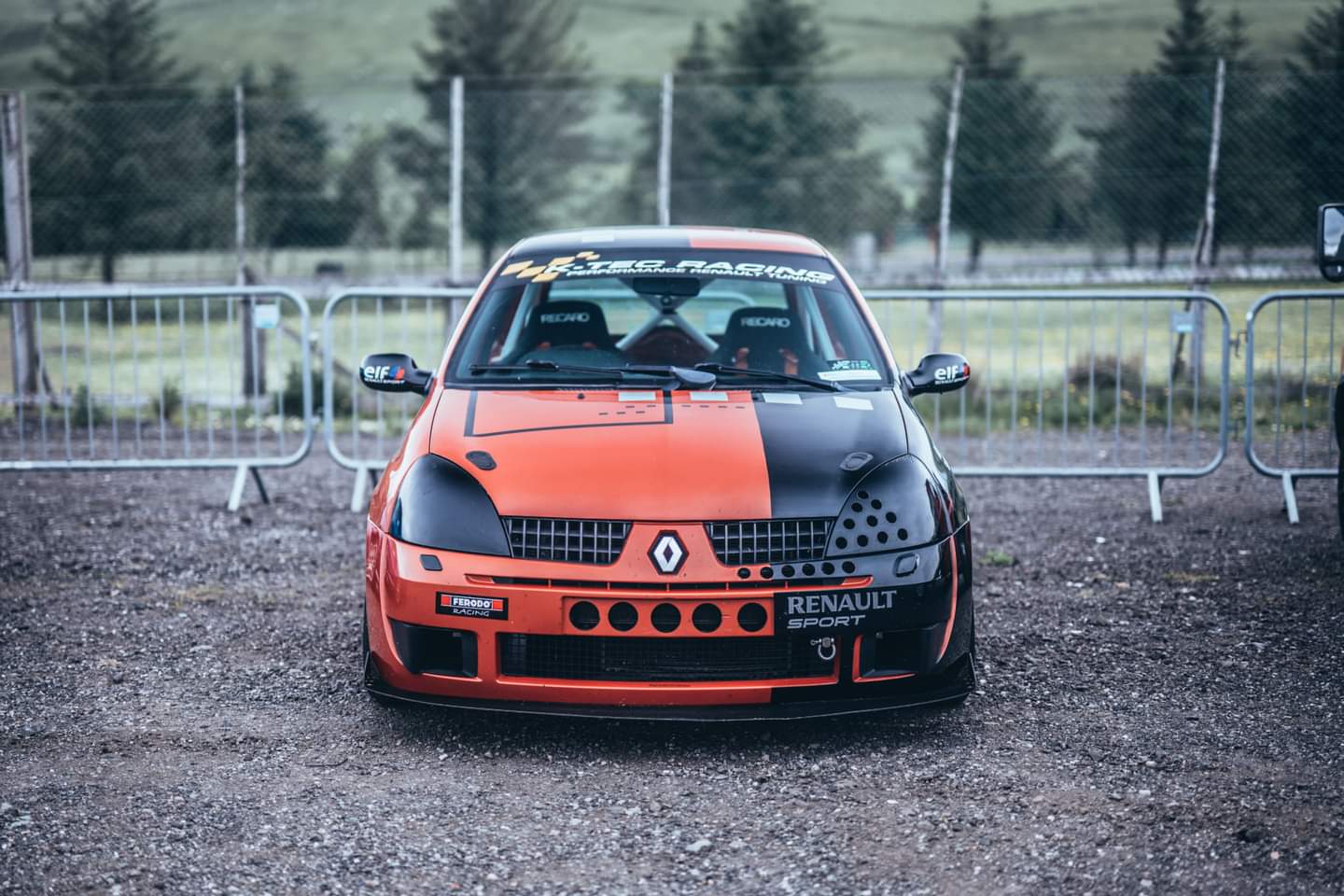

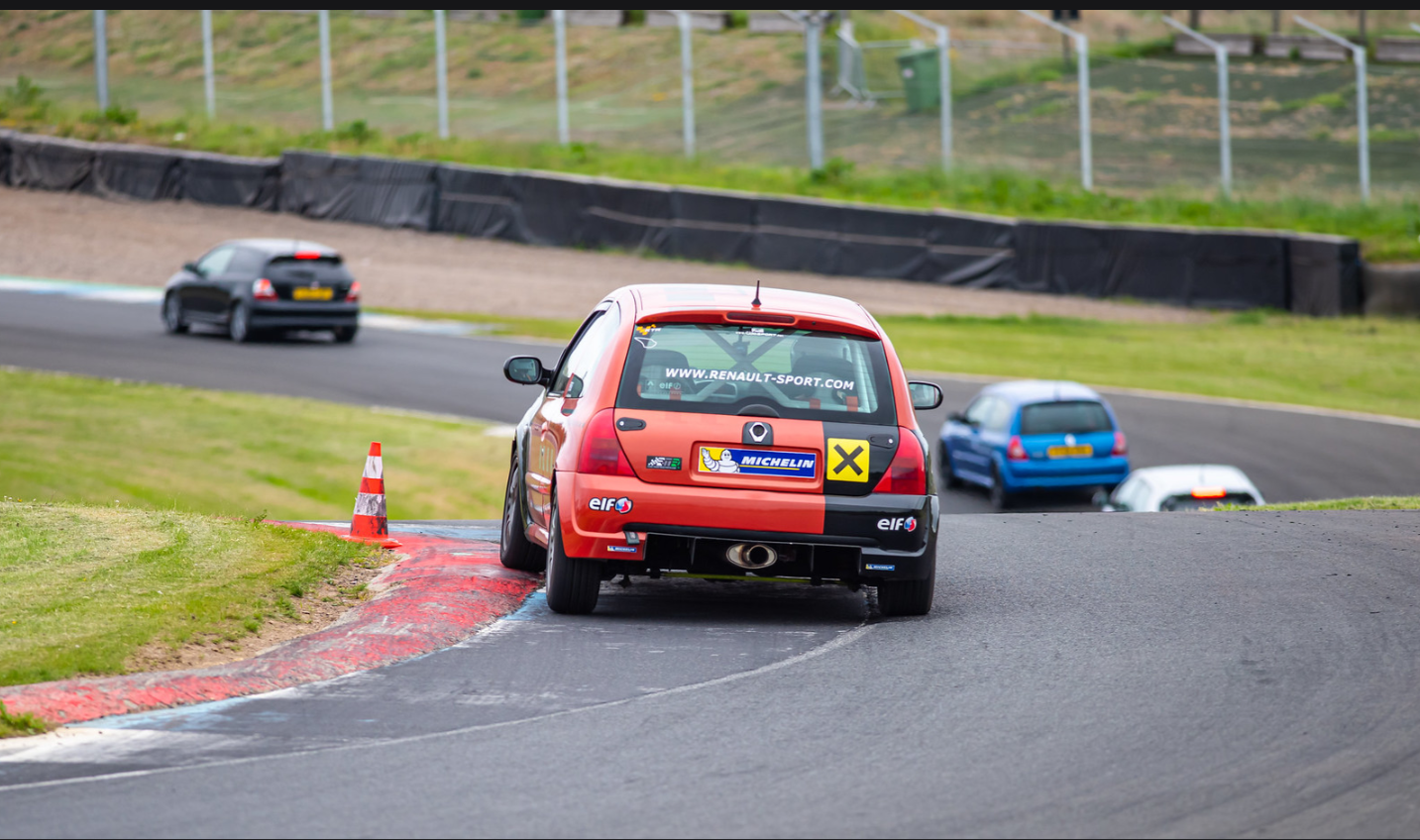

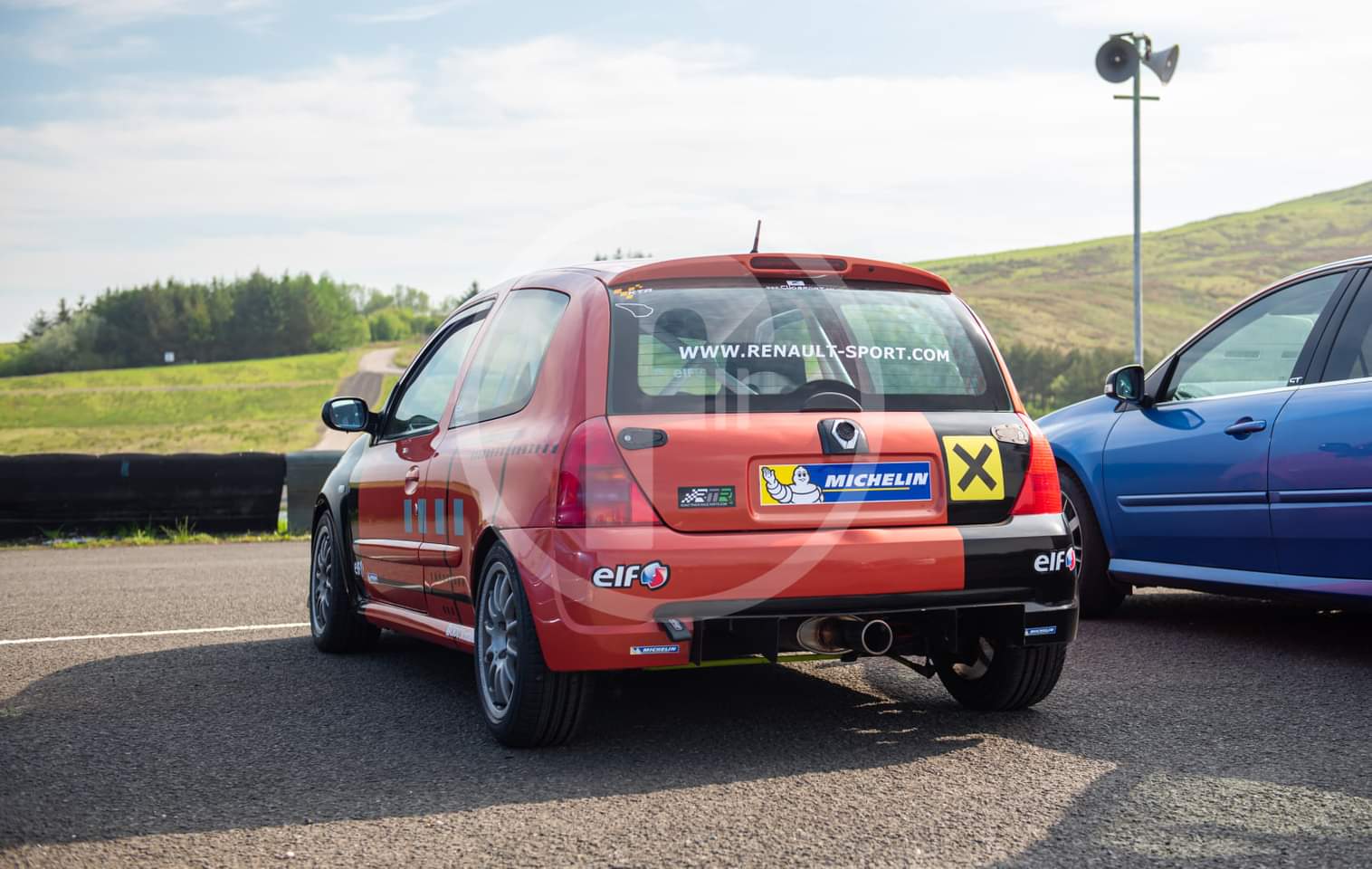

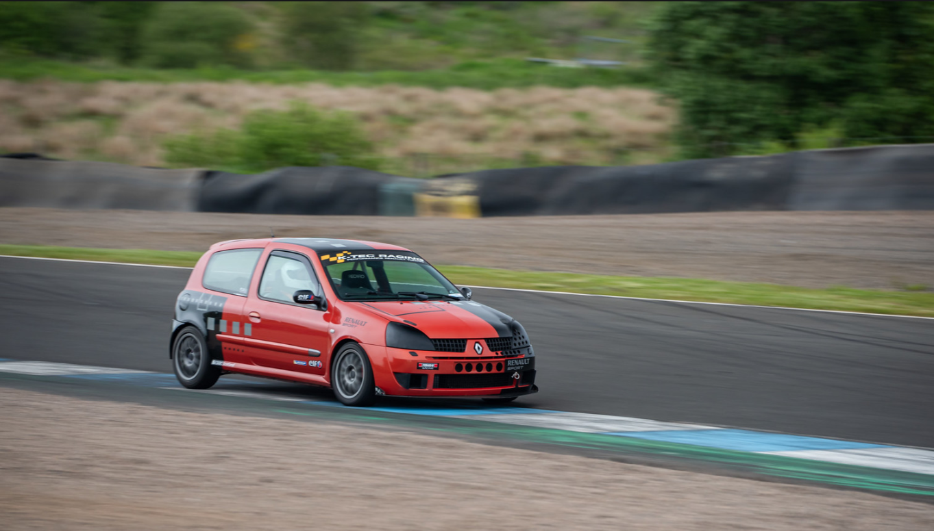

So Mondays track night, This was the 1st Outing for the clio this year and after getting the new brake set up fitted and the car to the standard that i want, buzzing to get out on track was an under statement!
Eager as anything I ended up showing up nearly an hour and a half early but that gave me plenty of time to get the car all sorted out before the session started.
I have a couple of videos of the car out on track but apparently the files are too big ill need to try find another way of uploading them on here.
The car was performing brilliantly the whole night and was feeling more confident using all the track provided and letting the car run wide onto the kerbs unlike my usual trying to stay centre of the track all the time. The new brake set up made a huge difference, able to brake later and no signs of fade at all and at the end of the session the pads still have loads of life.
The car was gripping brilliantly and was gradually getting more comfortable with higher speeds.
(All until a slight driver error)
Last lap of the night was feeling abit too confident and decided to enter Duffus dip a bit faster than im usually comfortable with and lets say a slight twitchy arse moment when the car let loose at the rear after hitting the kerb and sent me sideways, luckily I managed to correct it with just a slight bit of offroading but like i say driver error 🙈
Anyways on to the next one!

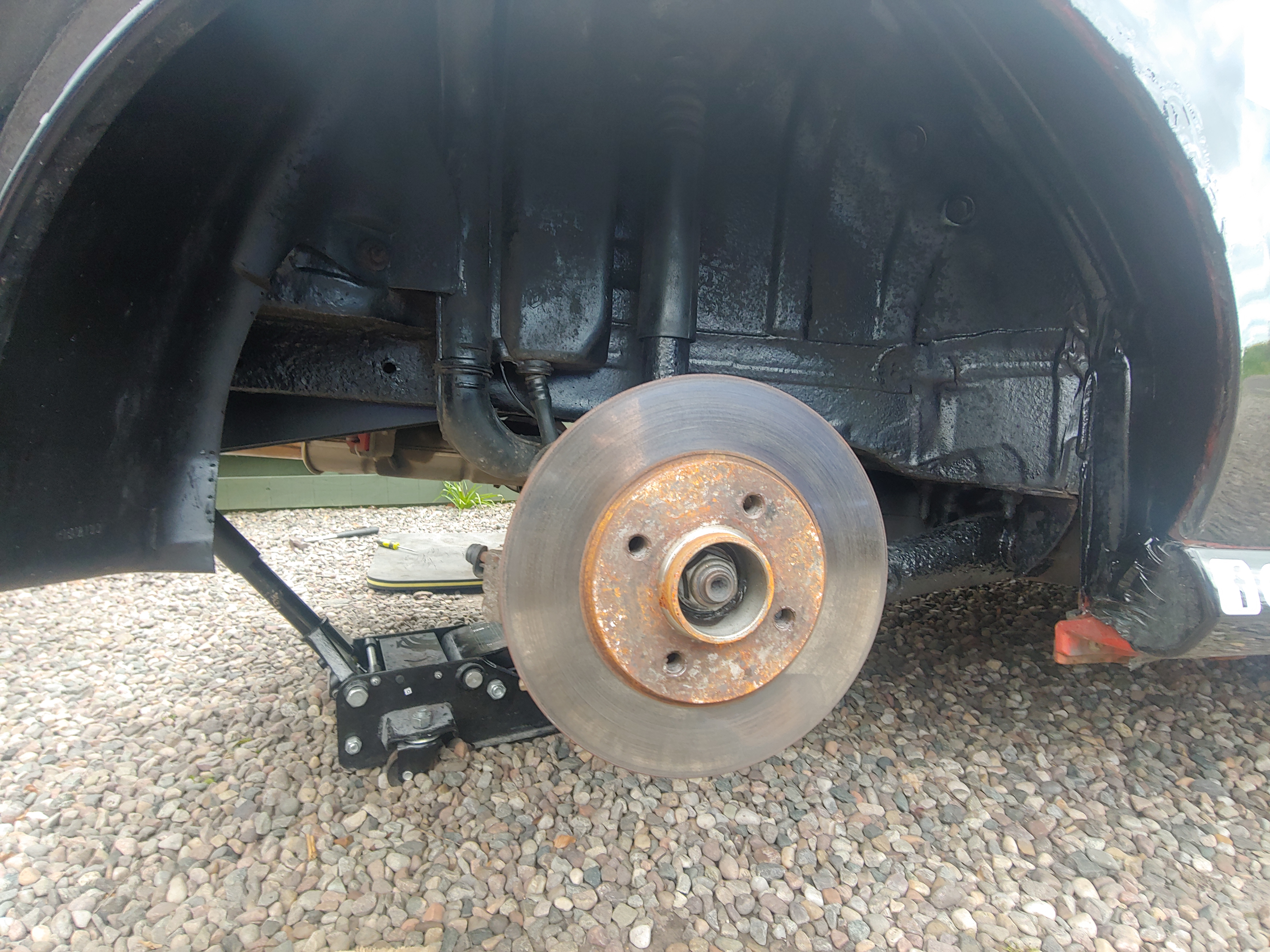

Gave the brakes a check over today. Fronts and rear are still like new.

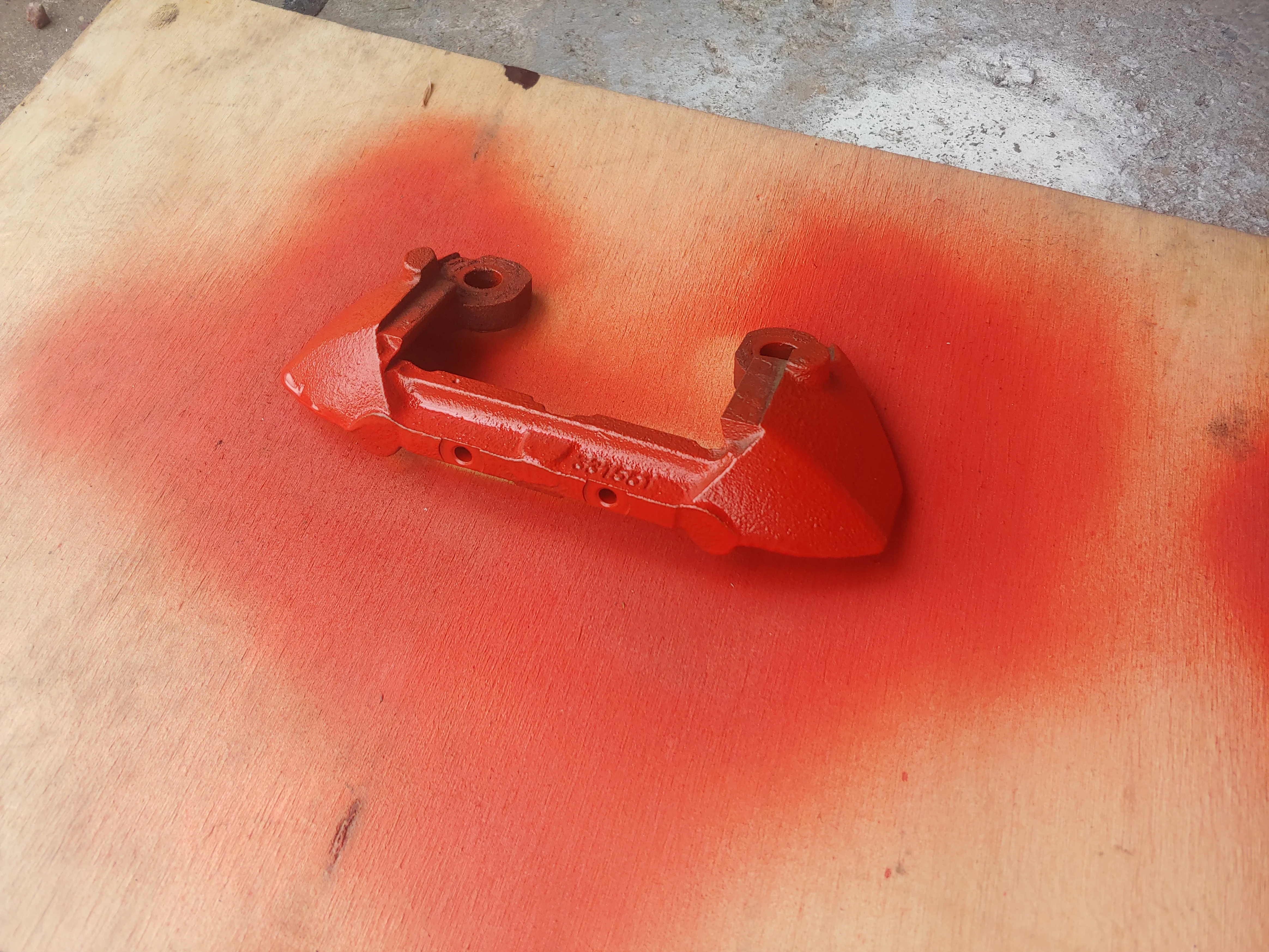

So whilst i was there I decided to do a spot of tidying up.
Painted the inner arches for a bit of protection and since the carriers were off I have given them a coat of inferno orange whilst i was at it. Didn't have red but they do match the front HiSpecs really well.

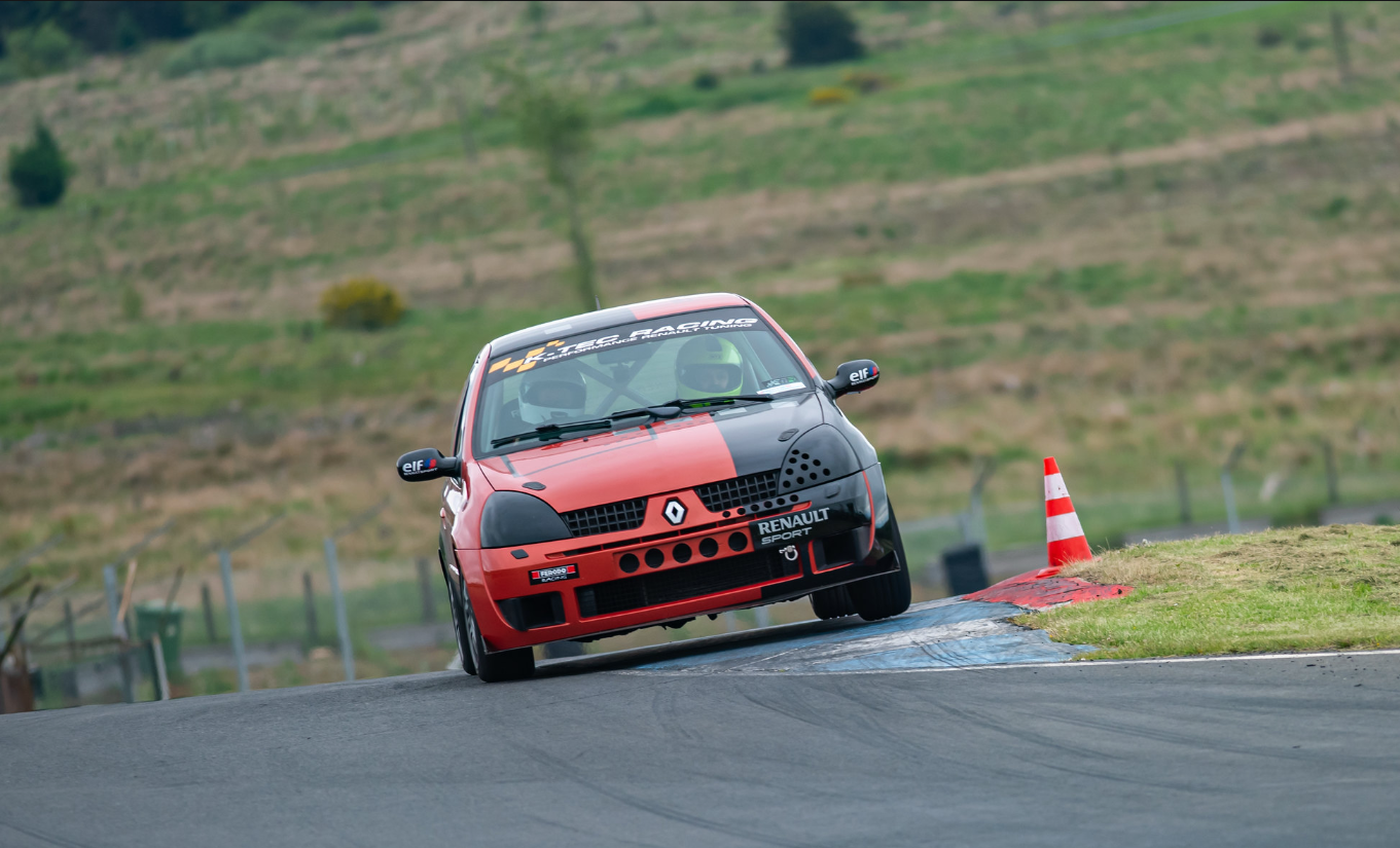

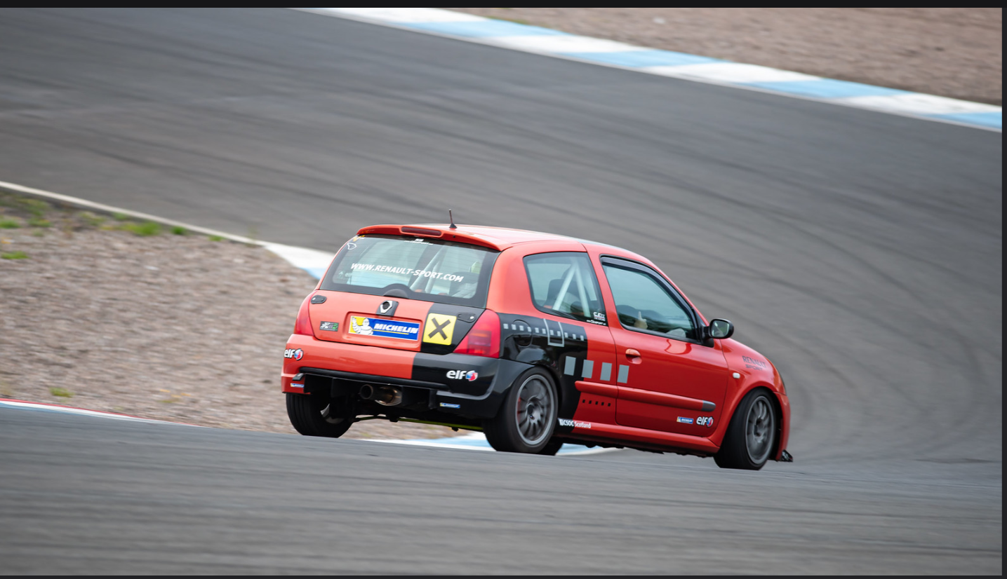

Had the clio back out at knockhill racing circuit on Wednesday night for a reverse direction track night! What a blast knockhill is in reverse!
Once again the car was performing great!
Heres a couple of pictures and videos. More will come soon im sure!

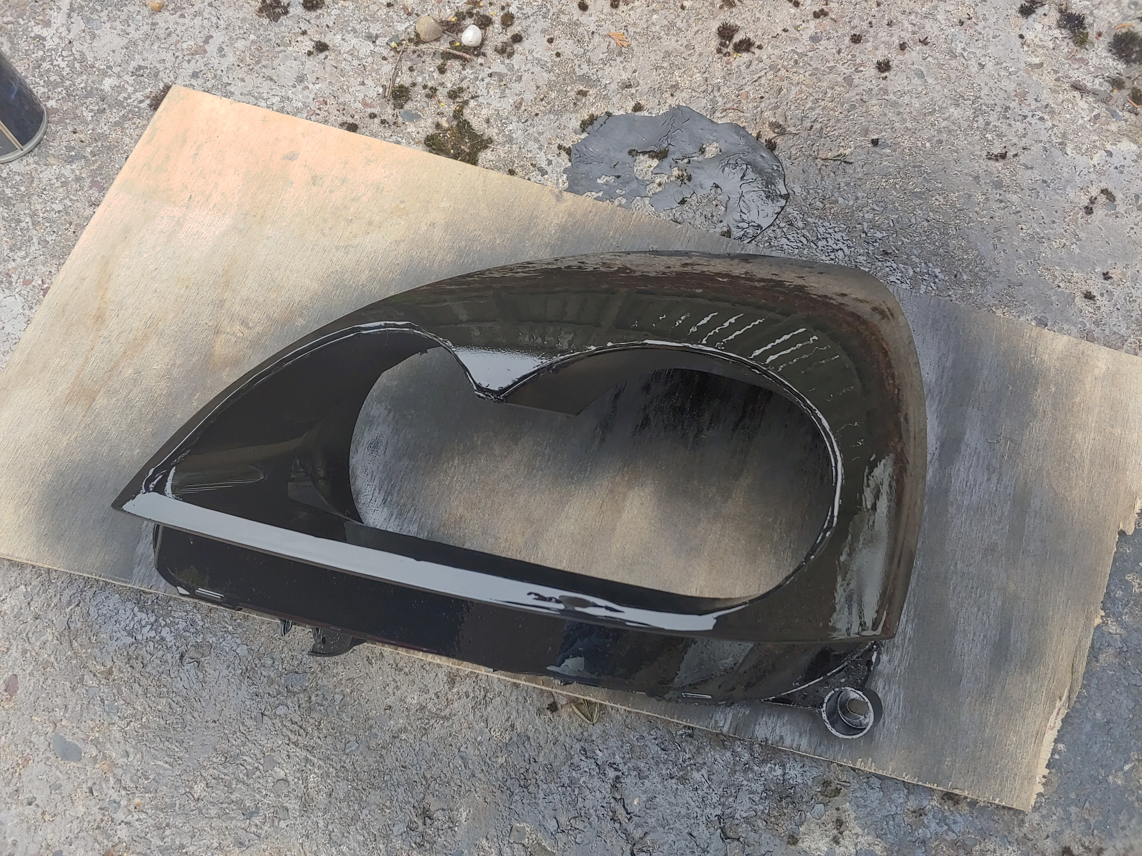

Got my hands on yet another headlight duct as a mate kindly given me this.
This one does have working indicators but its not really a sort of look I like, so working on a little something for that at the moment.
So whilst mucking about with the wiring for it I decided to give it a respray. Looks much better now.

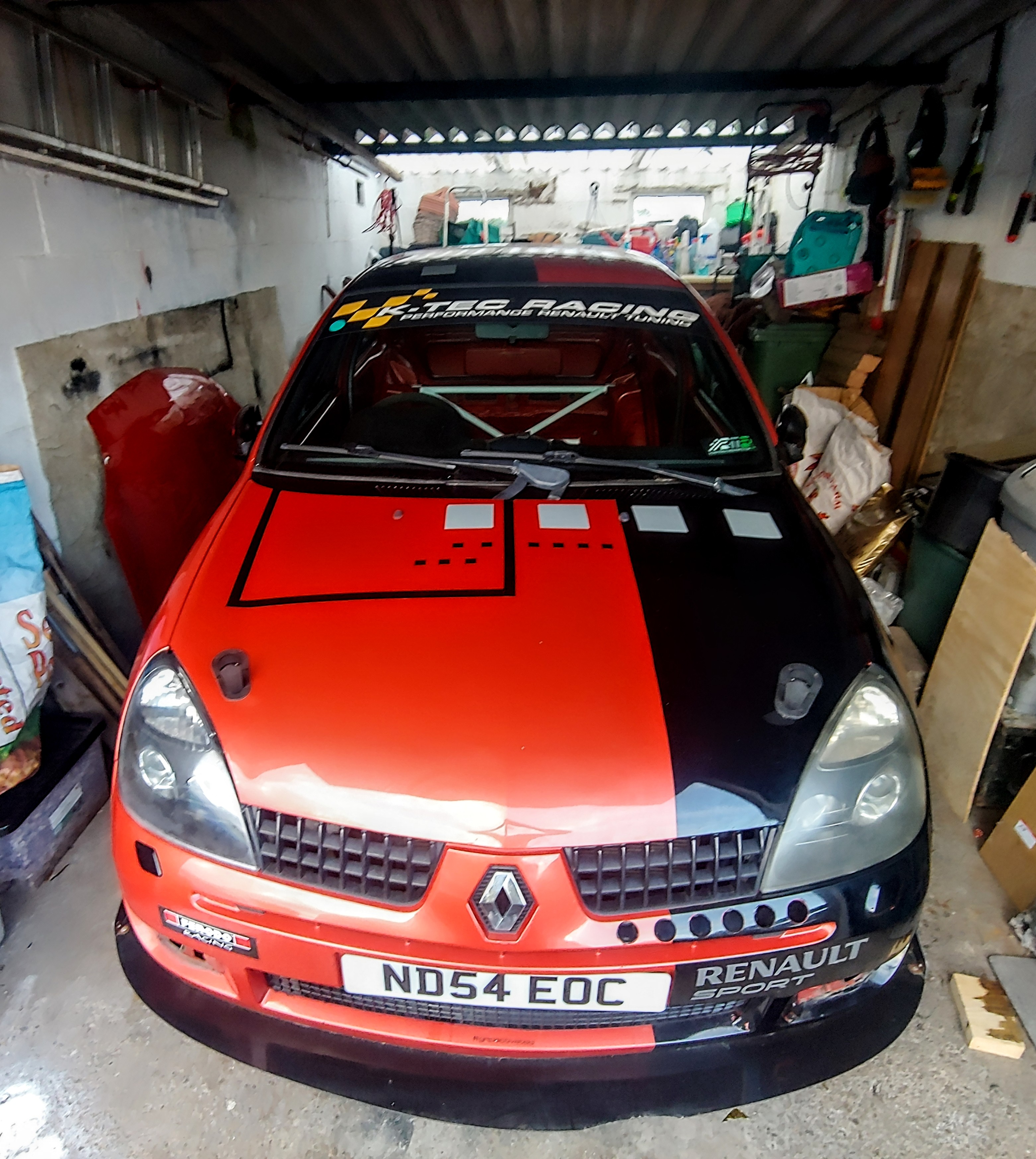

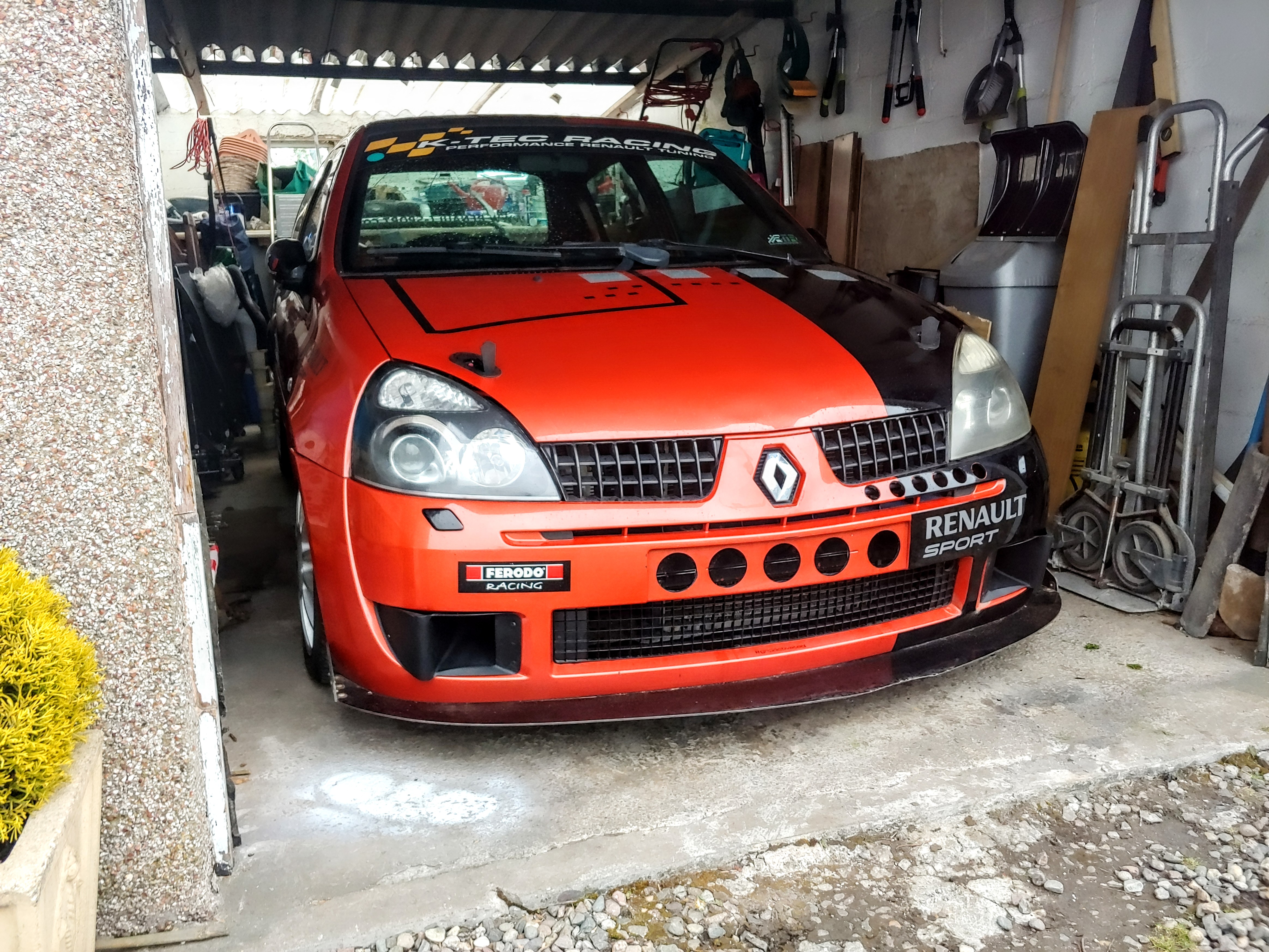

Got round to test fitting the new headlight blanks. Just need to get the battery relocated for the ducting to work and be effective.
Chuffed with how these have turned out. Be good to get these on on track.

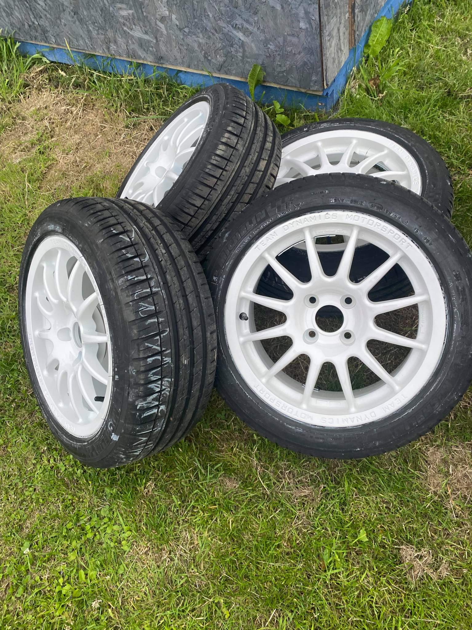

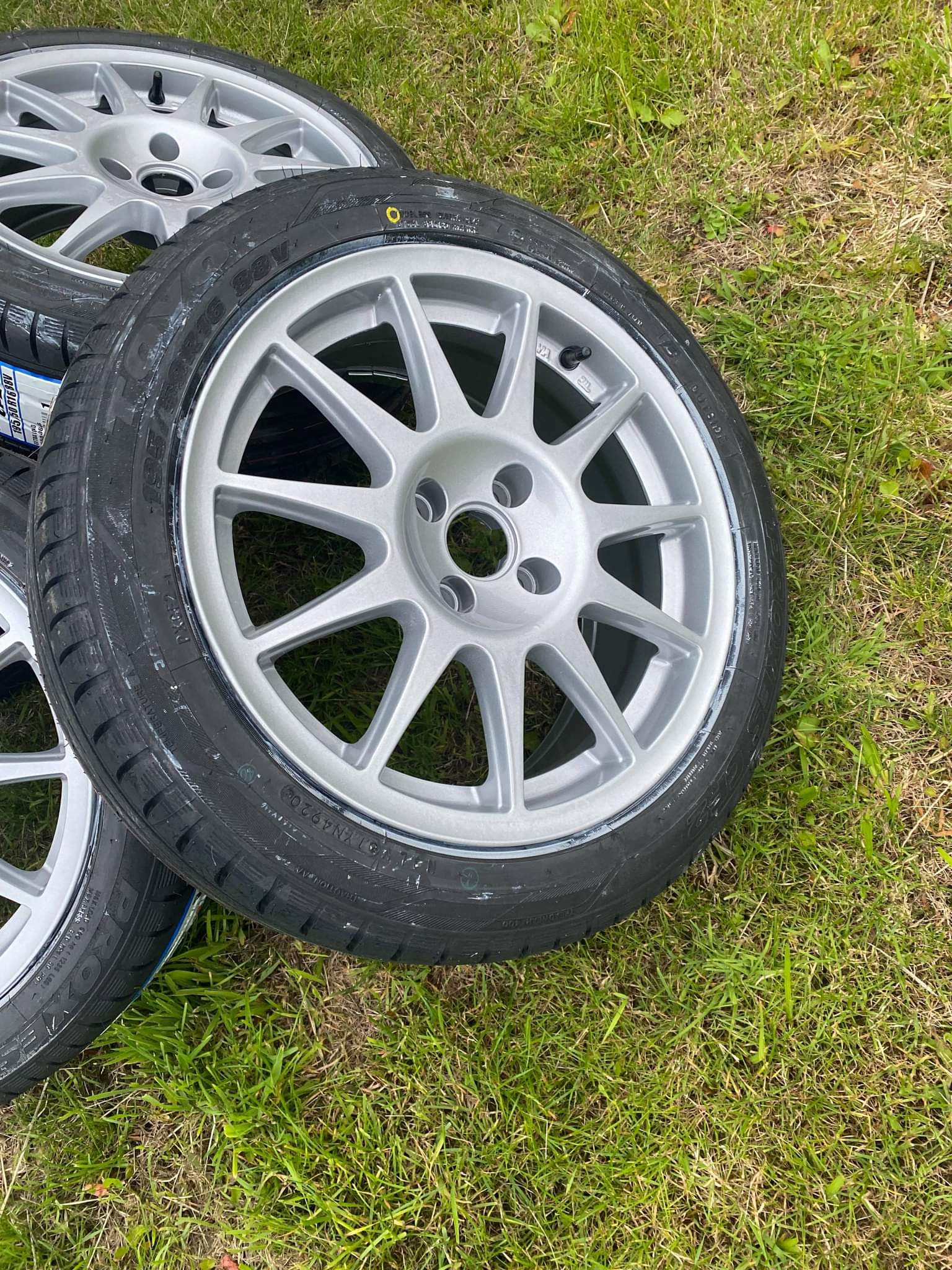

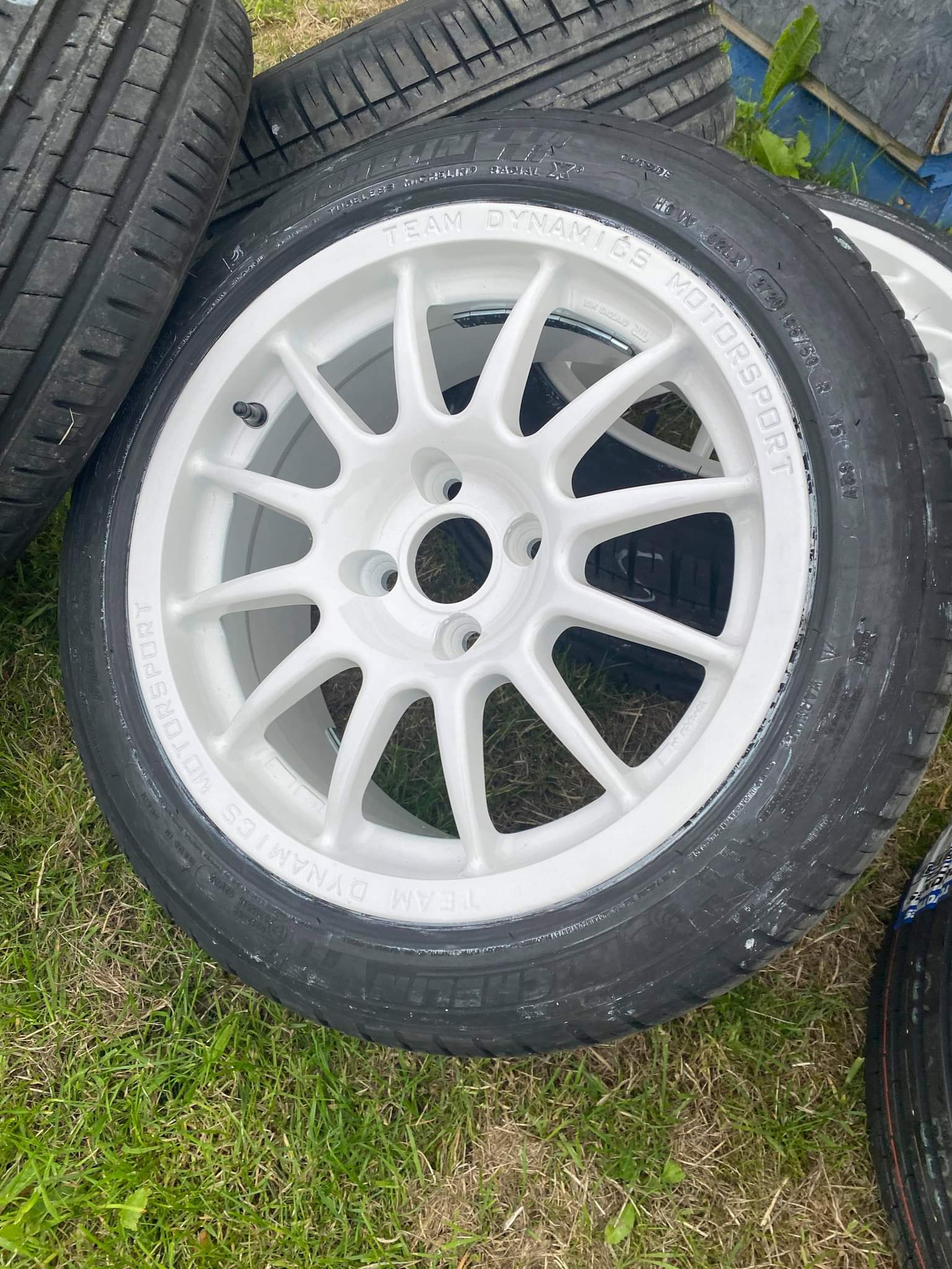

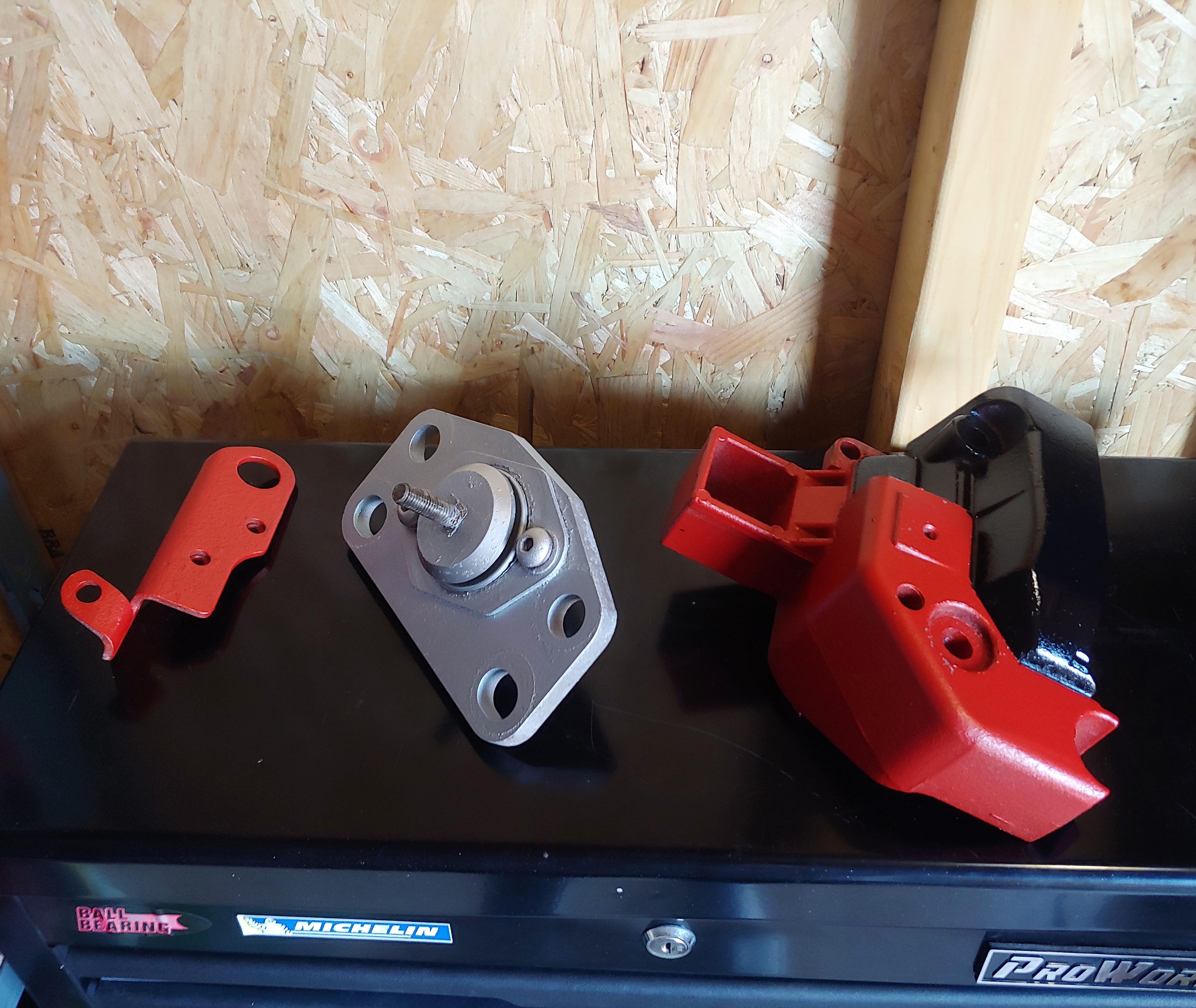

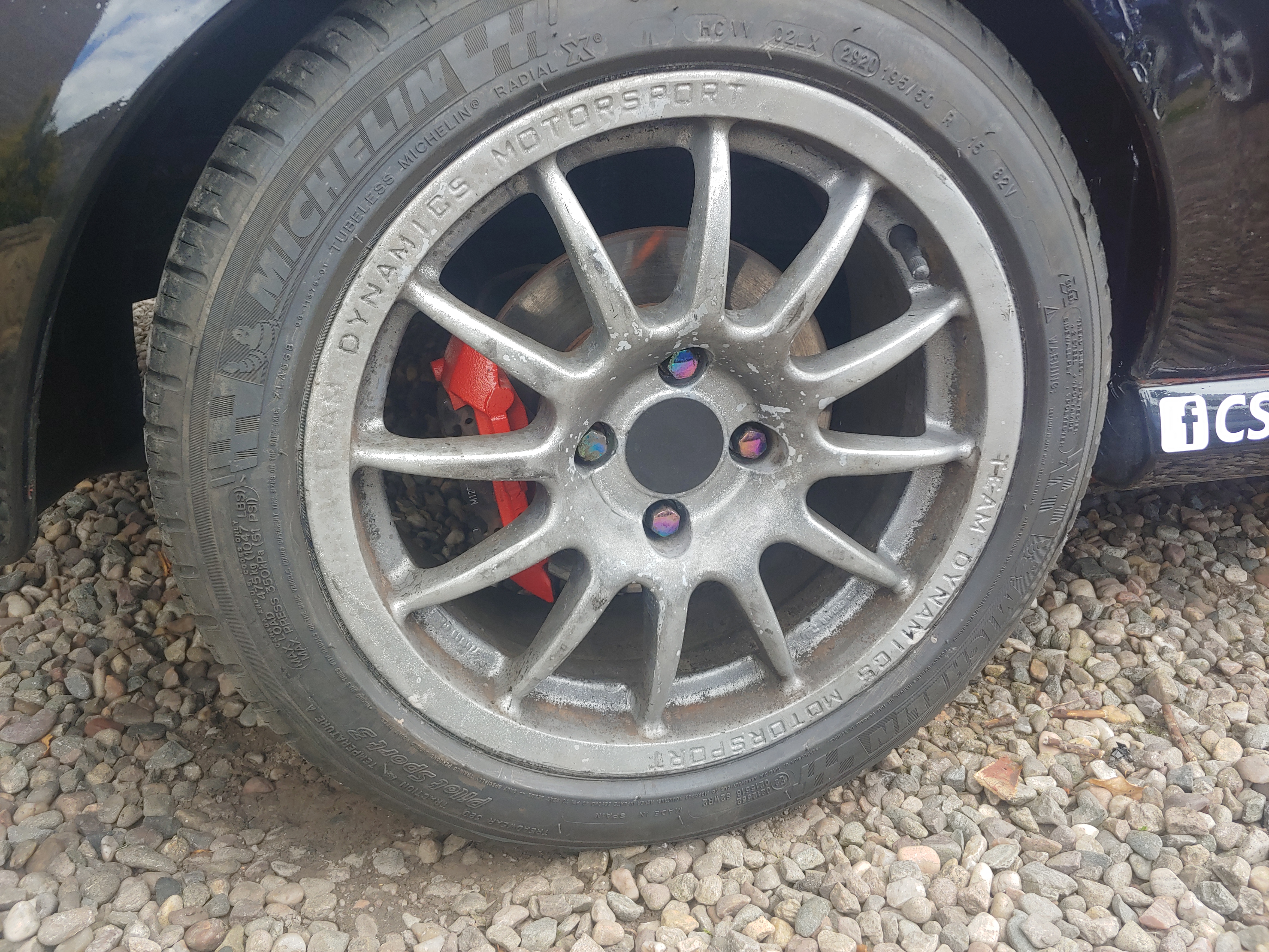

So the team dynamics on the car have been looking... Well, terrible to be honest as they were in desperate need of a refurb!
So thats exactly what i got done 👌 just back from the powdercoaters
Fresh coat of white to match the colour scheme in going with.
Since mine were getting done I got the girlfriends new wheels done for her car aswell
Set of fresh silver turinis for the cup.
