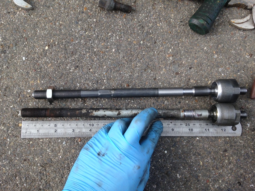

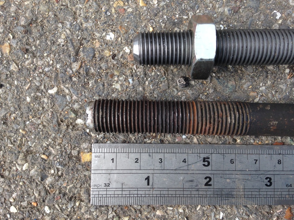

Just for reference matey. These are the ones I took off my non-cup 182 and these are the lemforders I replaced them with. The nut is approximately where the TRE goes up to.
You don't know the part number for the Lemforders you got do you mate? The ones I've got are definitely shorter than them ones.
Mines a non cup and got the SMI rack.
I'm so confused as from Googling both them part numbers come up at 282mm which, even the shorter ones in @GrahamS post look longer than that.

For non cup I think you need 320mm - the 305mm ones only get about 15mm of thread inside. Waiting for another set to turn up now from Micks Garage.
