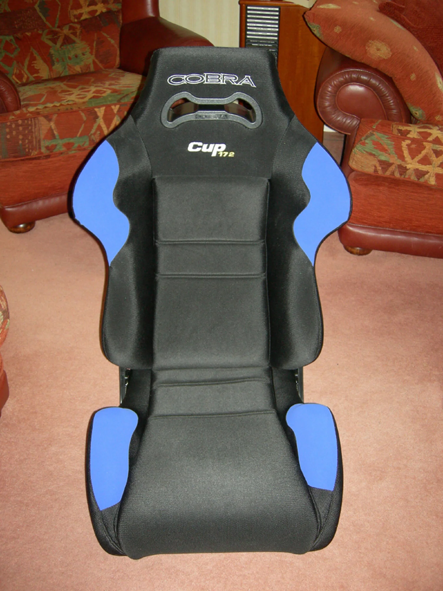

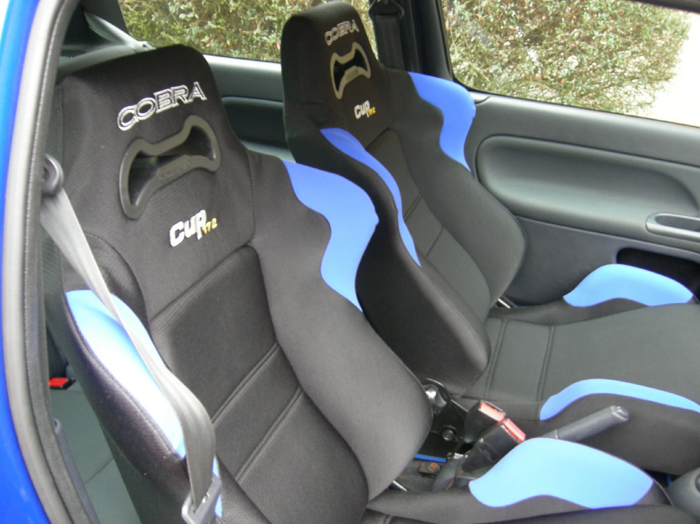

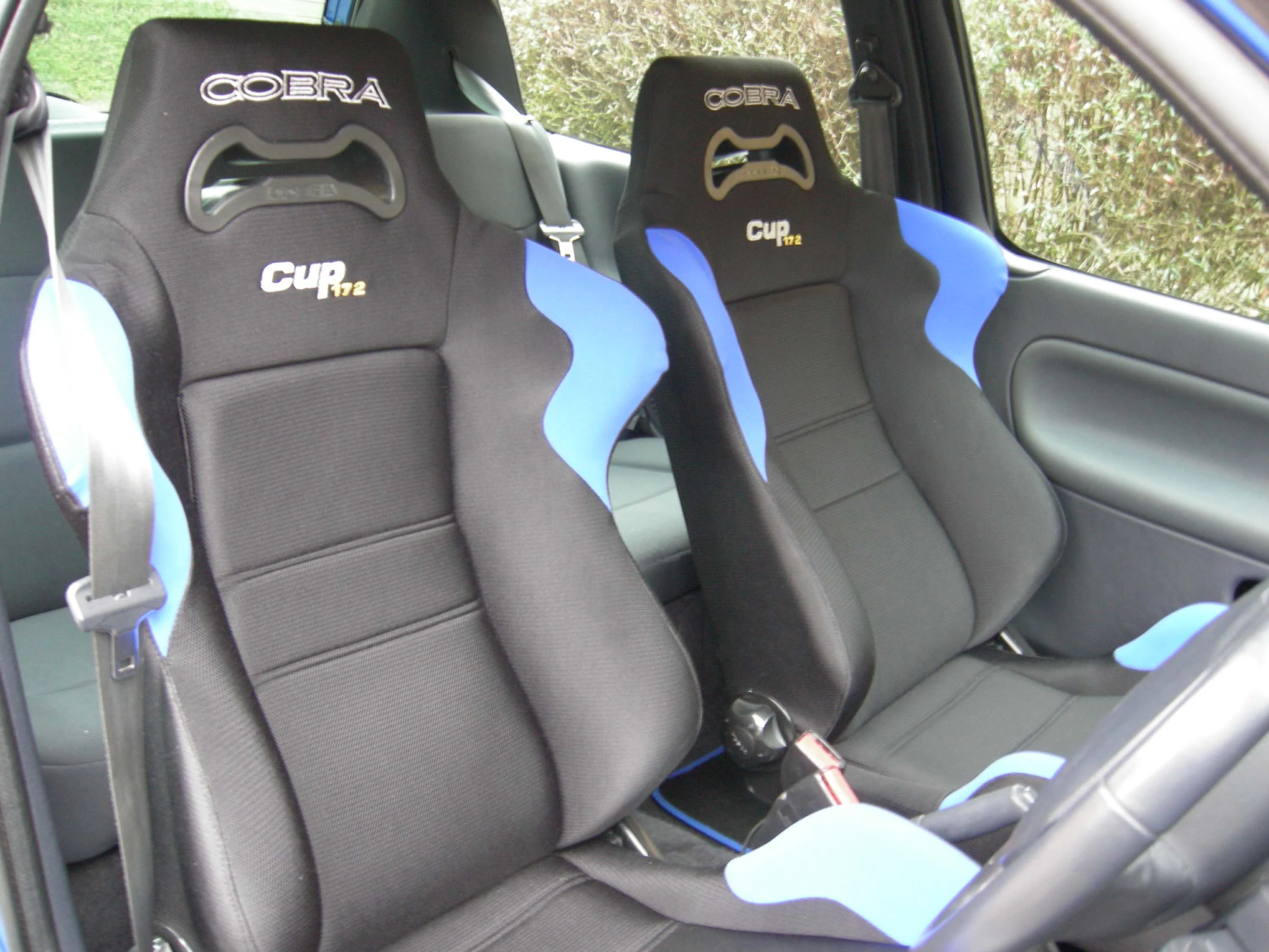

Hopefully these pics will come out OK
  2015 ST2(MO)/CorsaLE
^^ nice did you take the washers out in the end ^^ blue looks different - would have to see it in real life to make my mind up!!! what do you think - you pleased??? ;)
