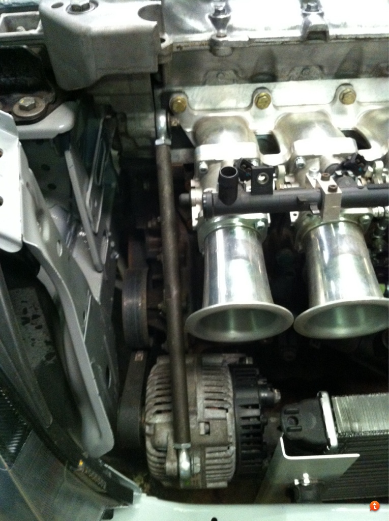

Me and Sam deleted power steering on ours as well as aircon. Cost less than £20 as doing it that way means no expensive conversion kits or different alternators, and a couple of hours of our time.

What alternator/aircon brackets you use Daniel ??
I used a £7 belt from a motor factor, my original alternator, and a Renault 11 alternator bracket from Renault @ £12.
No pics of mine sadly.
My mate used his original alternator, the £7 motor factor belt, and an adjustable bracket from screwfix for £15.
Here is his;
