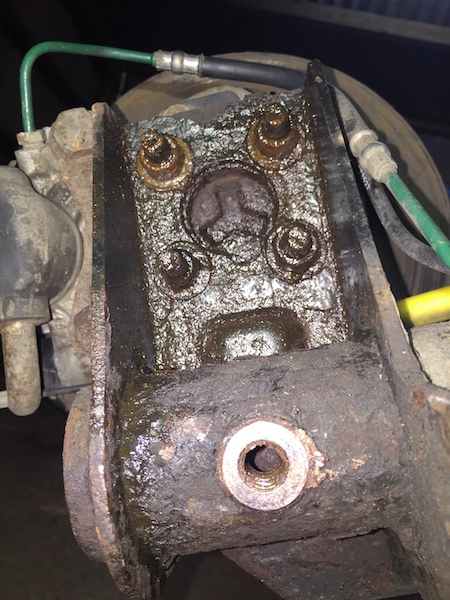

Im guessing that my rear hub bolt has burst and the reason for this is in the short video below.
I have been spraying these nuts at the back of the hub for the last 3 weeks almost every day with WD40 and then today i went to see if i could lose them off and i before i even tried i noticed it was just spinning.
Might as well have been coating it in mayonnaise.
Penetrating fluid is what you need to .. er .. penetrate into the threads of seized bolts. If that fails; heat is what you need.
Video not working...
I would also like to point out I'm buying new Torx bolts and nuts for these :up:
You need to access the torx head the other side to stop them spinning.... panic over, nothings broken. Lol :tonguewink:

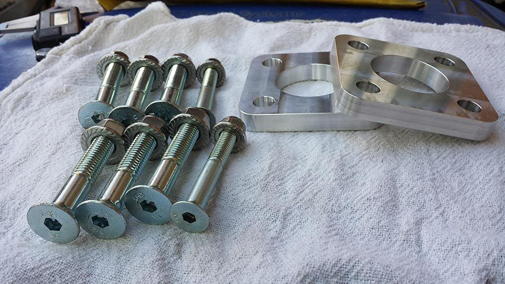

PMS sell the 10mm rear spacers for £25 and comes with new nuts n bolts. they also sell the nuts and bolts separately but you have to call them for that.
Very strange, when i did mine Adam told me that the bolts where NLA.
Anyway that's alot of money for a few bolts.
Just seen the PMS kit so going to buy that as i want spacers to match the fronts and £25 for a full kit seems very good.
