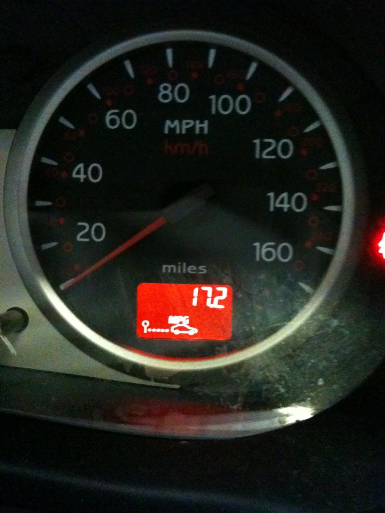

is this normal on a 172???

non standard 172 clock (140mph instead of 160mph)

You shouldn't have bought that in the first place. The clock is what I'd be most worried about, that sounds very dodgy.

Right, Lets break this down.
Those clocks aren't sport clocks, there from a non-rs, a very basic non-rs at that.
This would explain the lack of trip computer stuff.
Also explains the GAZ GAS light. It is the same place as the shift light on the rs, so when you floored that's why it lit up.
You haven't got traction control, It wasn't introduced til mid 2003.
You most probably have got auto light/wipers. Just need to turn it on etc.

I'm so annoyed cause I didn't know any of this when I brought it. but still they should have told me the clocks had been changed. Guess what else is worrying...on my warranty invoice it says millage '57,298' and I have only done like 57,1xx (something)

EDIT: From what you've just said, sounds like they've clocked it.

Hello, I have just purchased a Clio 172, 52 plate. I am not sure if some things are supposed to be there or not.
1. When I press the right hand stick to toggle the trip computer nothing happens. I thought a trip computer was standard on a clio 172?
2. No automatic windscreen wipers of lights
3. No traction control, definately thought this was standard!
4. Does anyone know waht the is? It came on when I put my foot down then went off. G
GAZ
S
Other than all of that, the engine is making a very horrible noise, sometimes doesn't start and stalls when the car is going slowly (not in gear and definately not stalling for obvious reasons)

Here's what the clocks should look like if you want to show it to the finance company. Also did you pay the £100 deposit by credit card because that will give you some protection.
