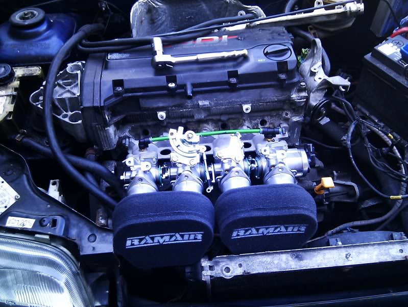

I have Russ's itb's ph1 172 running standard ecu, however im going to go stand alone onit, what shall i do about brake servo? this is what is currently tapped into the manifold, is there anyway of utilising this? or would have to take the manifold off and get something bigger tapped in?

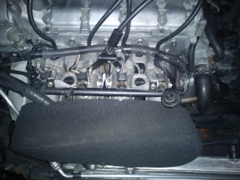

It currently has the brake servo running off the 'map bar' where the 4 vaccum hose's go, i surpose i could just block the map sensor end and keep the vaccum hose's and the bar and just run it like that ?

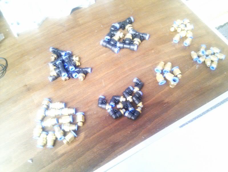

If your current setup is soft pipes then I'd change it ASAP, they suck flat under vacuum. Can do you fittings if you can't find any locally :)
He said he did have a problem with them sucking flat but they have since been replaced, and the brakes are fine, i will try to move the bar forward i think, and move the coil pack to the side
Im going to stick with what's on there, this was ment to be a cheap way to itb's, and ive already talked myself in to buying an ecu!
That current pipe from the mani to the MAP tank is good, they dont suck flat, (the pipe I used before did) though as Fred suggested a non return valve in the brake servo pipe will make the pedal travel less.

If you need anything from Pirtek I should be able to get it on the cheap ax my dad supplies hose to Pirtek :)
