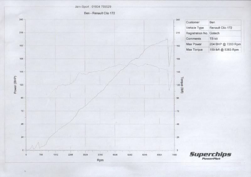

ITB'd cars, wheres your rev limit? any rr graphs?
looking for standard engines really, when i got my itb'd 172 the rev limit was set at 7800, which seemed high to me, i now have it at 7200, the car was mapped at rstuning with the 7800, is there power up that high? seems a bit high for standard b/e!?

Mine was at 7600, no power up there just nice to have te extra few hundred rpm to drag it out of corners

7800rpm is perfectly safe for a standard bottom end, its not to do with power having the rev limit that high, for the track day boys and racers etc it helps out on track

7800, went to 8k on rollers, no real increase in power, thought safer to limit it to 7800.
