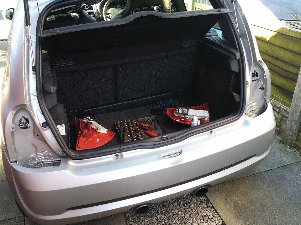

All belts were changed a few weeks ago by the lads at SC Autos, top service and now the engine runs very quiet again as the dephaser was one on the way out! Today I sorted out some little niggles including a horrible boot rattle, fog lights coming on when I brake or indicate and most importantly found out that my O/S lower wishbone ball joint is completely shagged so ordered a new one (Lemforder) for £16 delivered. FYI the fog light issue was the common rear light cluster, one side was completely rusted up so spend a while with some electrical cleaner and a small file and now it's all good again.

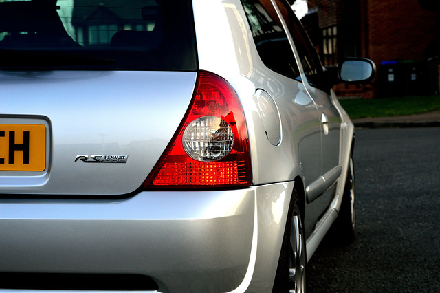

Spent all morning detailing the car then fitted the new RS style badge and a few stickers here and there, pretty disappointing with the CS Sport sticker I received in my membership pack. No matter what I did, the letters just wouldn't bond to the glass, ended up screwing it after spending about 15 minutes trying to apply it!
Fitting new badge

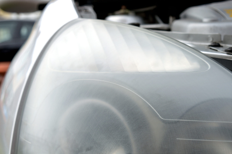

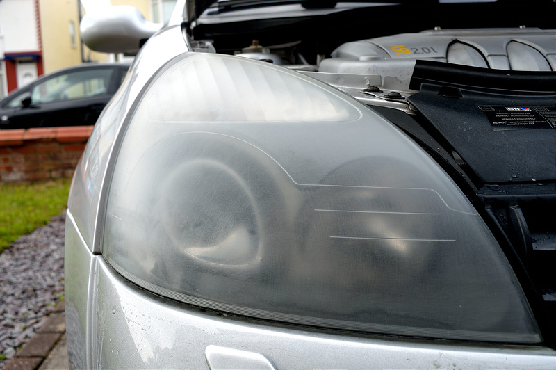

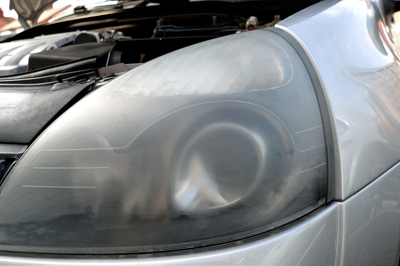

My headlights had begun getting a horrible yellow tint to them and were in need of a restore. Didn't bother with a kit as I've already got quite various grit sandpaper, DAS-6 DA and polishes.
I didn't think it would need too much wet sanding so I went with 800 grit followed by 1200. On final inspection it could be better so I'll probably have another go soon with 600. Overall pretty happy with it though! MOT has been done so sidelights back out again:wink:, really glad I managed to drop one back into the headlight housing though, really pleasing.
So for headlights I used 800 & 1200 grit sandpaper. Then I finished with Menzerna 400 on a cutting pad, finished with Menzerna 2200 on a finishing pad. Sealed up with AF Tripple & AF Tough Coat, Enjoy :up:
