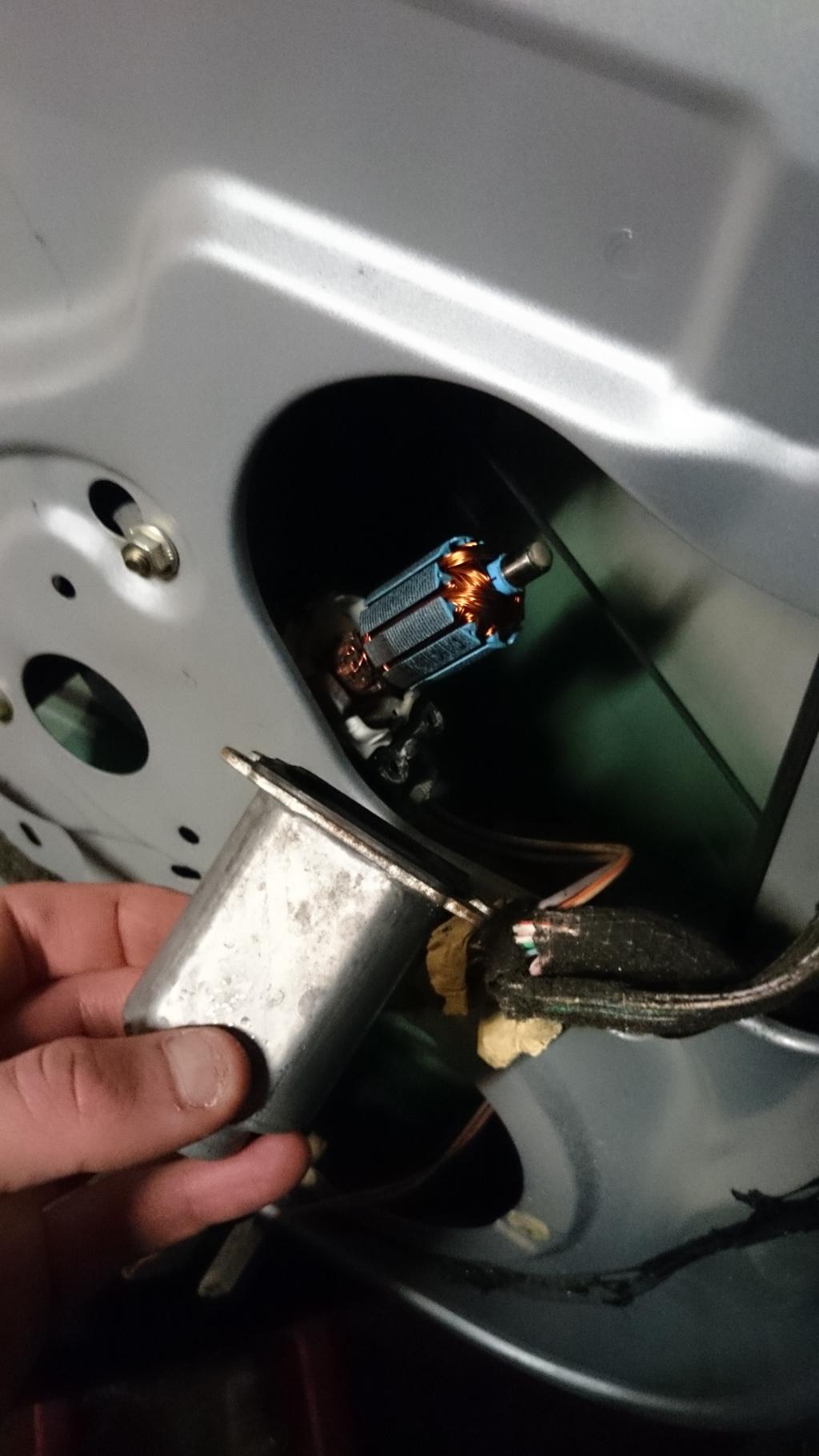

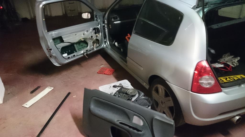

French rubbish!! my window regulator has stopped working and OBVIOUSLY it was in the open position when it happened! My evening was spent stripping it down, working out how the motor worked and then manually winding the window back up. I have disconnected the motor for now before I get a new one, although I will need to strip the door off and locate the rattle that has now developed!

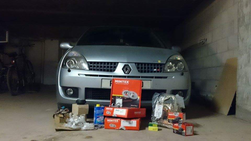

In other news, I have been spending again this evening! :p
So far I have sat around in my flat:
  • 6l of Engine oil
  • Oil filter and air filter
  • Sump Gasket
  • Genuine Renault topmount kit x2
  • 16mm hubcentric wheel spacers
  • 5mm wheel spacers
  • Front brake discs (Mintex)
  • Rear brake discs (Mintex) with bearings
  • Rear disc spacer/washer x2
  • Rear Hub nuts x2
  • New pads all round (Mintex)
  • AUX radio connection
  • Ate TYP200 Super Gold brake fluid
And tonight to top off the brake refresh, I have ordered a set of Matt Lewis Racing Braided Brake Lines! Next, its onto the suspension! :)

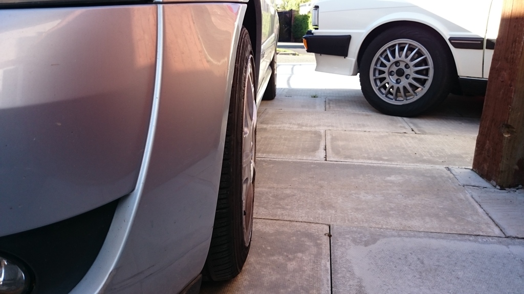

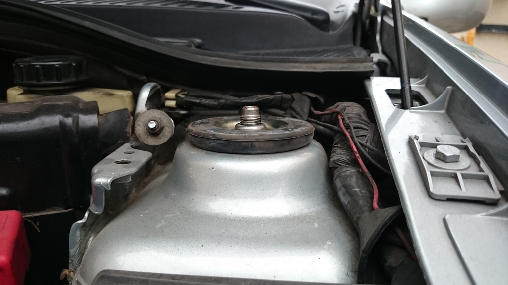

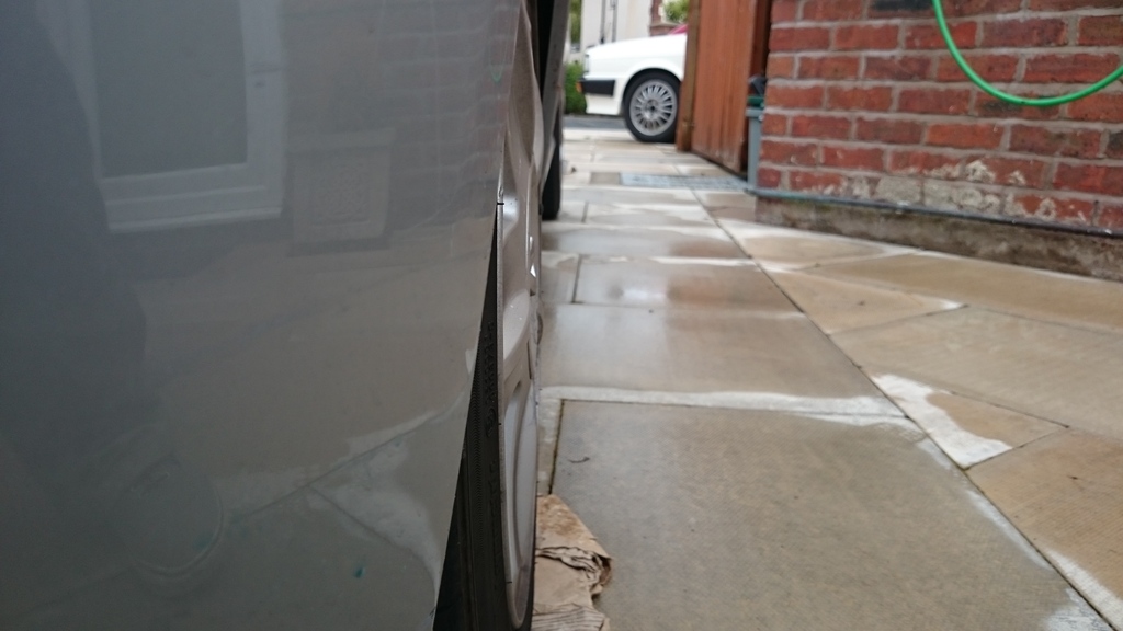

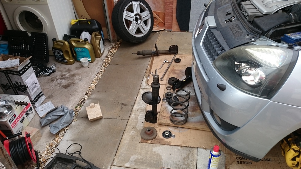

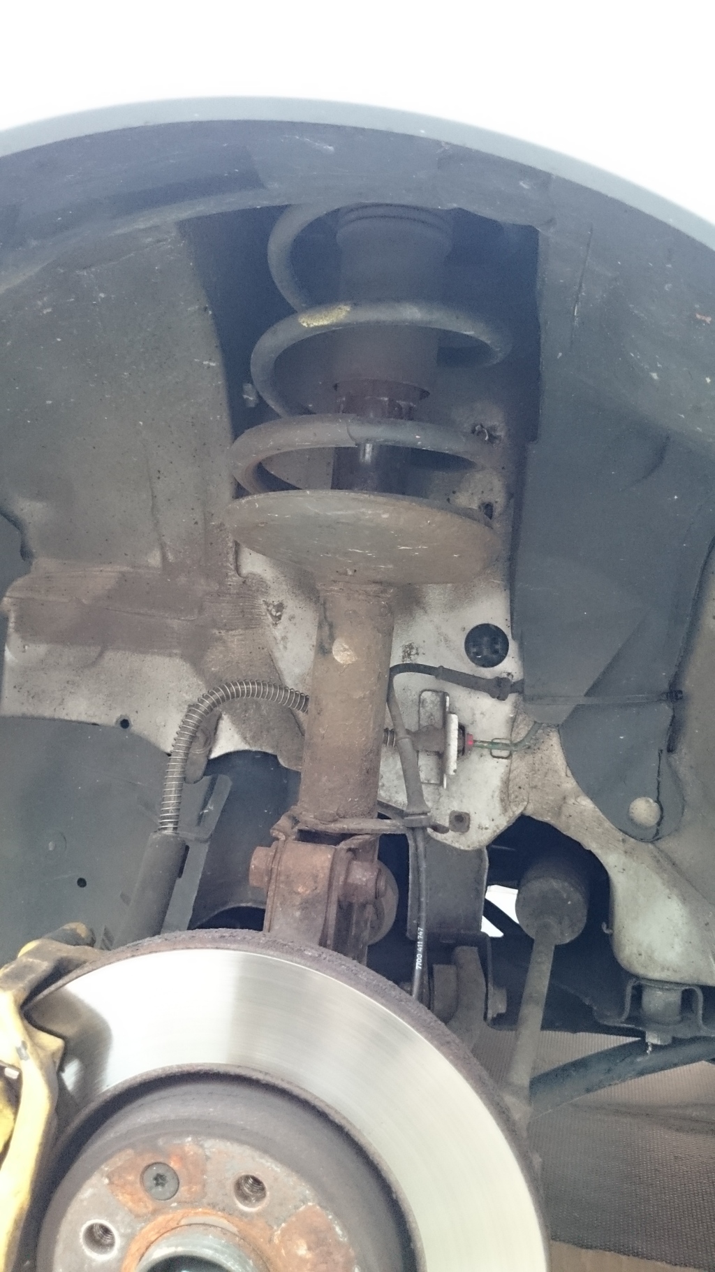

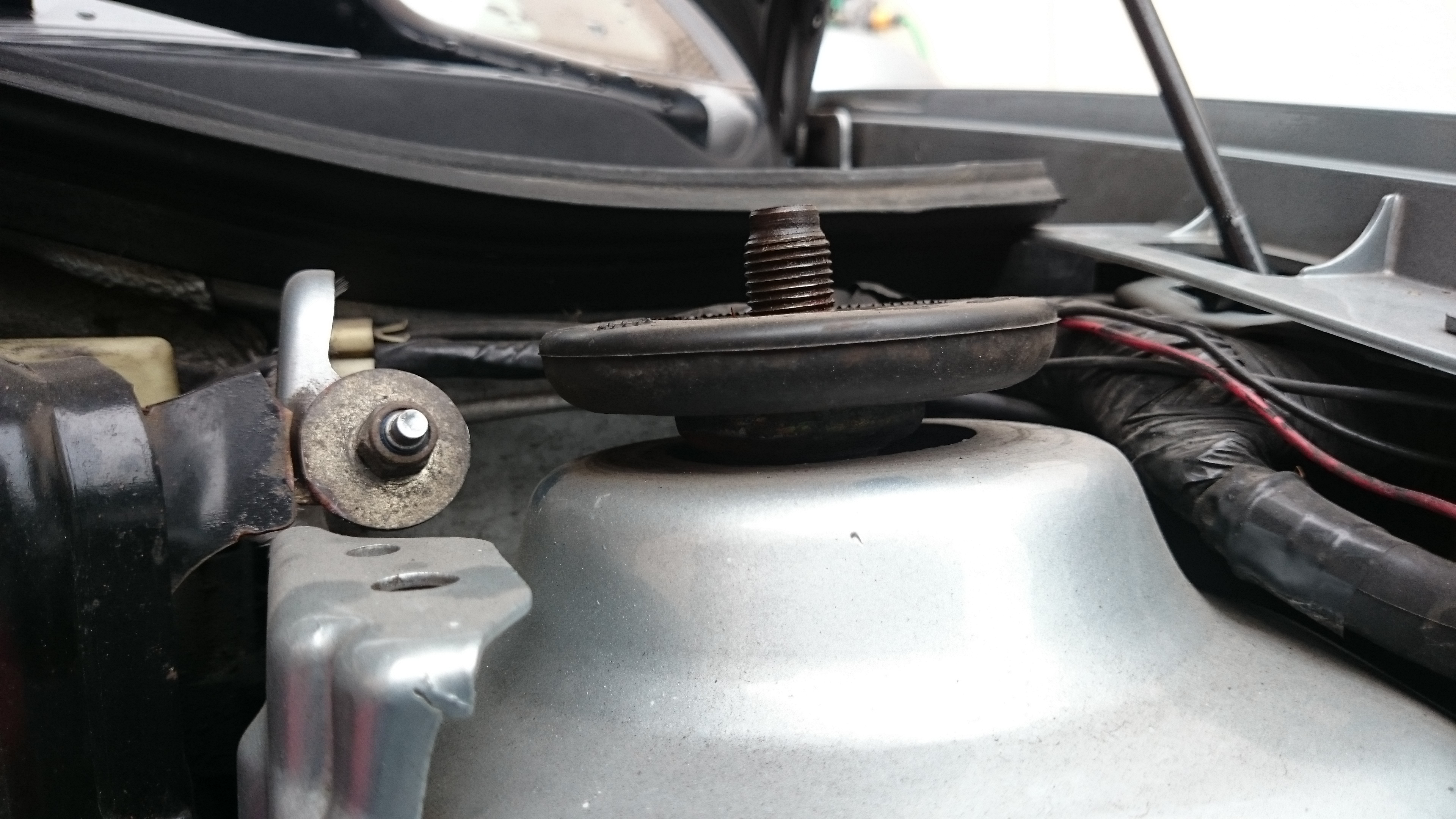

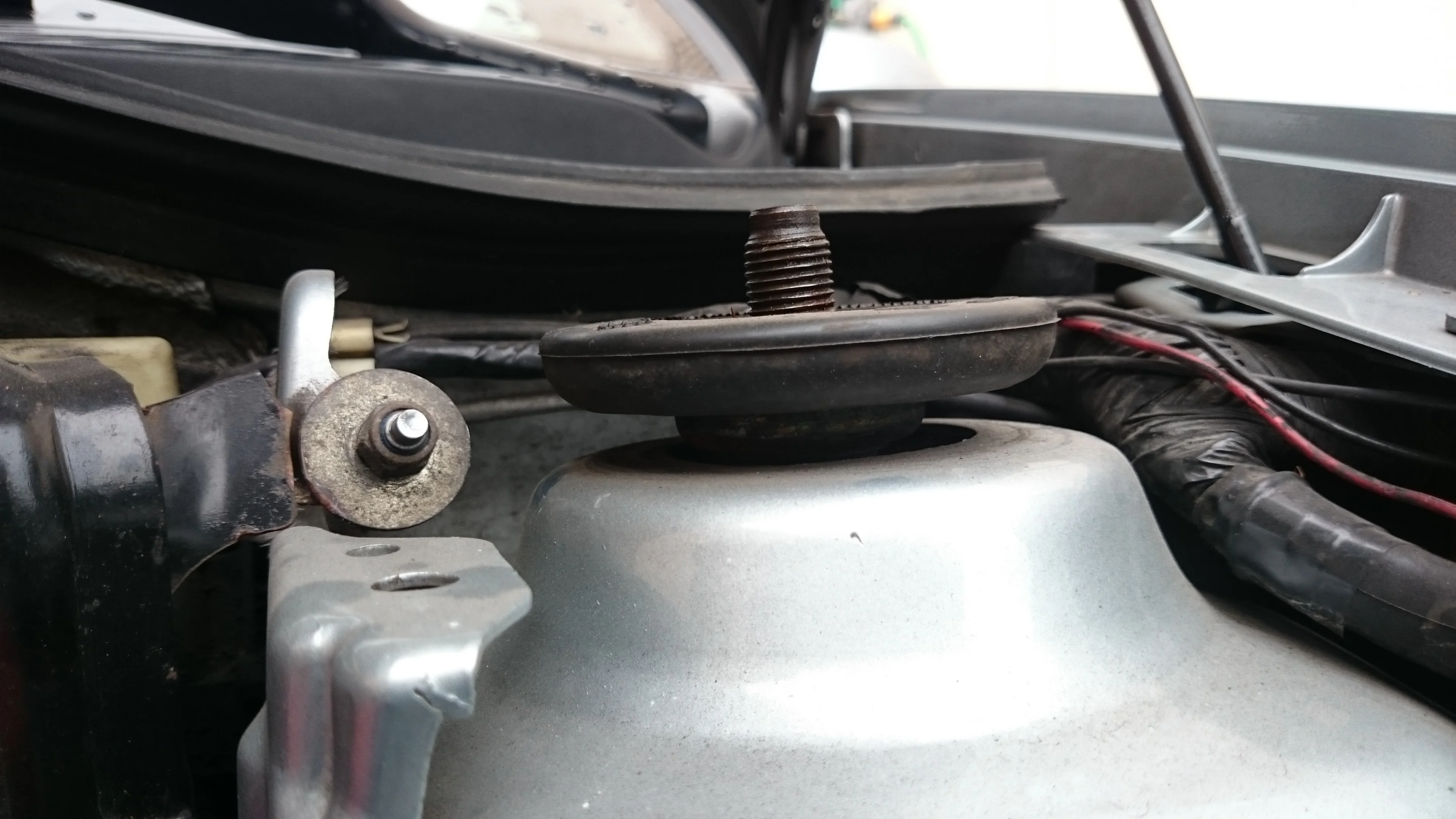

Made some progress on the clio today. New top mounts and cup dampers all round, spacers all round and fitted an Aux to the radio. Wasn't without problems though!!
Rears were easy enough to swap! Stripped the front dampers off in a few minutes as well, then when it came to building up the new ones with the new top mounts... I noticed the top hat spacer on one of the top mounts was totally different, about 3-4mm shorter. Once we built everything up it was pinching and not letting the bearing rotate. Luckily I was put in contact with a couple of members of the north-west clio sport Facebook page and an hour round trip later I was back on the drive rebuilding the dampers and Top mounts and putting the car back together. This time, with 5mm rear spacers and a set of 16mm fronts. Last part of the day, I fitted an Aux jack to the radio, unfortunately I totally forgot to connect the aerial! so that all needs to come out again to get my radio back! Tracking is the next job on my list and I still have a boot full of brakes and stuff to fit! (y)
Gappy old top mounts
Shitty camber due to knackered top mounts
Old crusty dampers.
All the new bits, mid swap.
New not so fucked up top mounts
16mm spacers in the front!
Now with added spacers and no shitty camber!

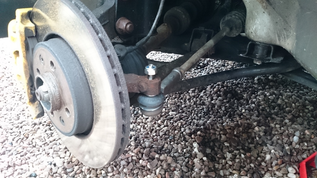

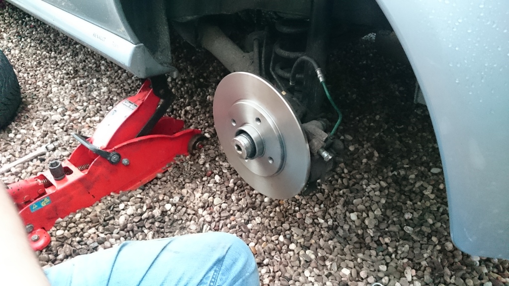

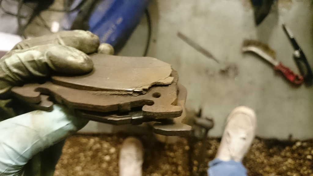

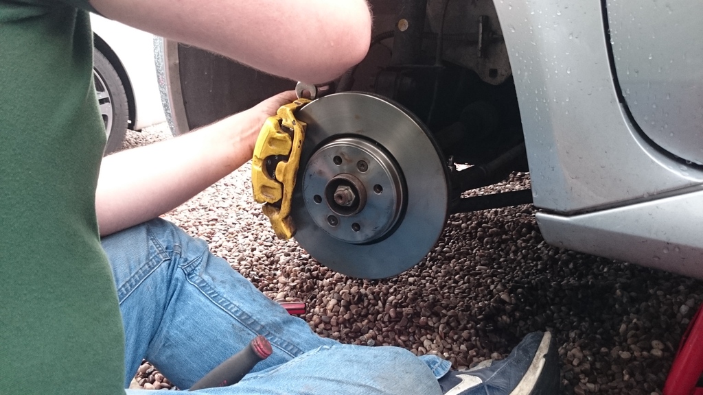

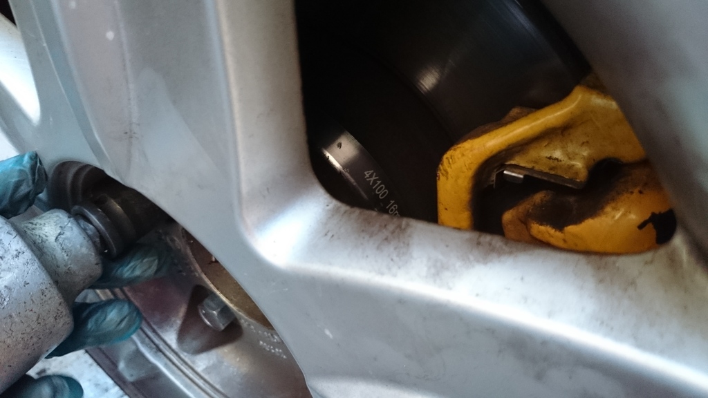

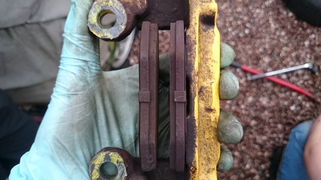

Fitted new track rod ends yesterday and all new brakes. Had to file a bit of the rear pads face down to get them in, belive thats the Mintex pads though, they all seem to come a tad too thick. :smile:
I did tighten the nut up!!

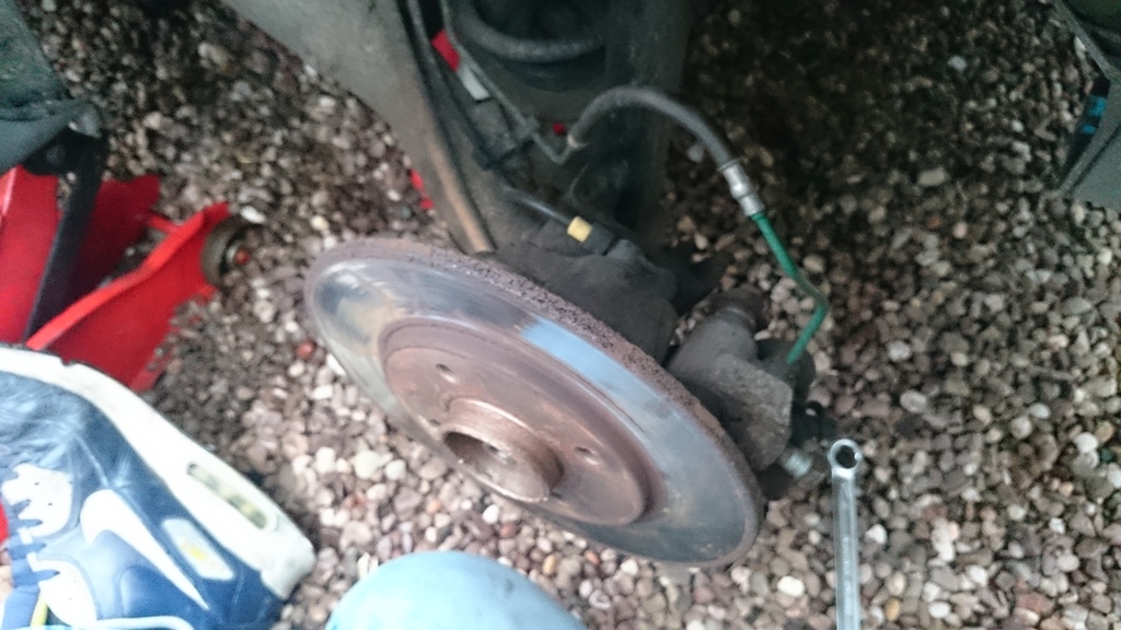

Old front pads didn't look too bad, but were heavily scored on the rear from the pitted discs.
Rear discs and pads were a terrible state and one of the bearings had given up and fell apart.

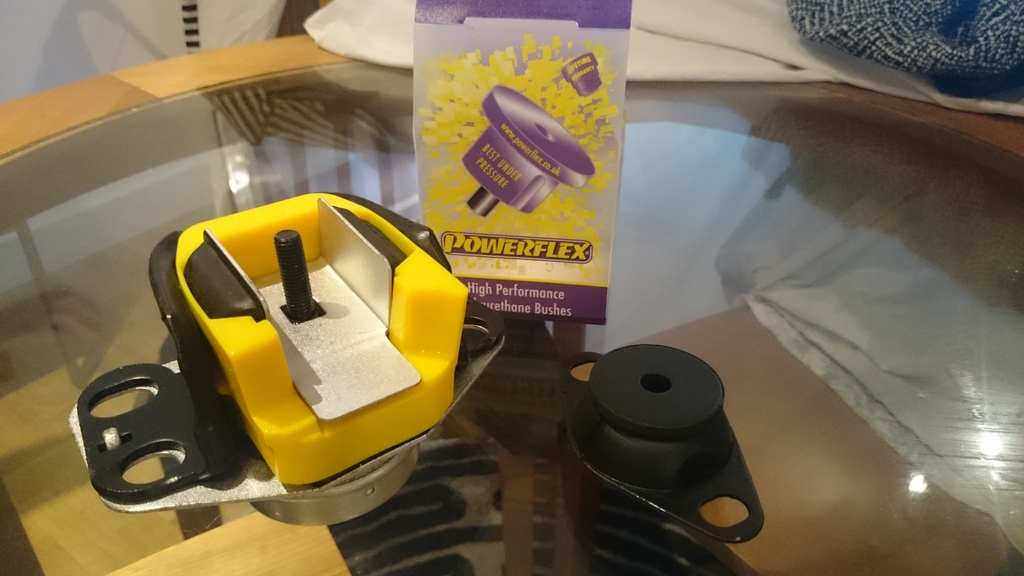

More parts! Picking up my new engine mounts Monday, apparently they have been delivered to my office!
Once I have those, I will get a weekend to stick them on along with this!
And finally do a brake fluid and coolant change and stick the new braided lines on. It's all coming together.
Jack
  Clio 172

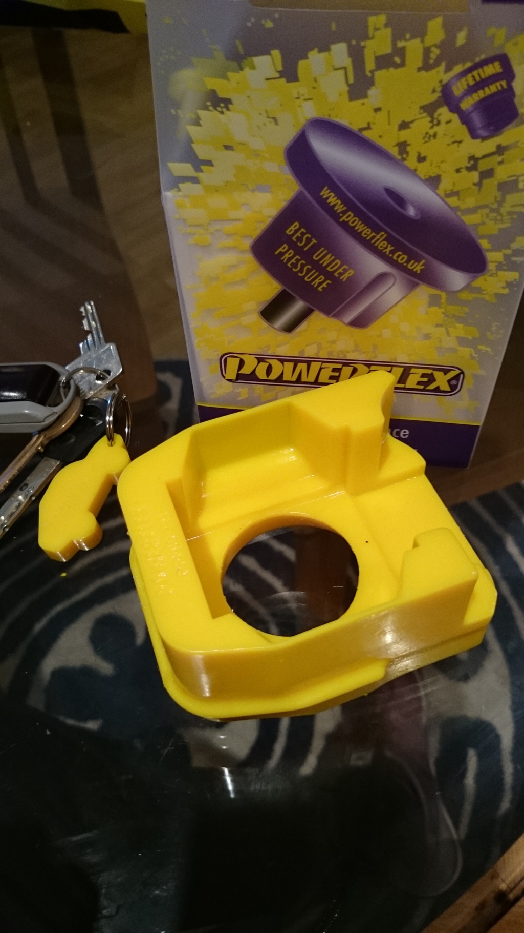

I fancy one of these. You fitted it yet?
No, pick up my new engine mounts tomorrow and need to find a weekend to get it all in. MOT is this month as well, so want to get it all done before then. :) will give feed back once it's on and sorted.
  Clio 172
Also don't suppose you have a Powerflex part number for it do you?
Sorry, I missed that bit of your post! Part number is PFF60-221
And here it is positioned in my new engine mounts. Got a new gearbox mount to throw on as well while I'm in there! :)

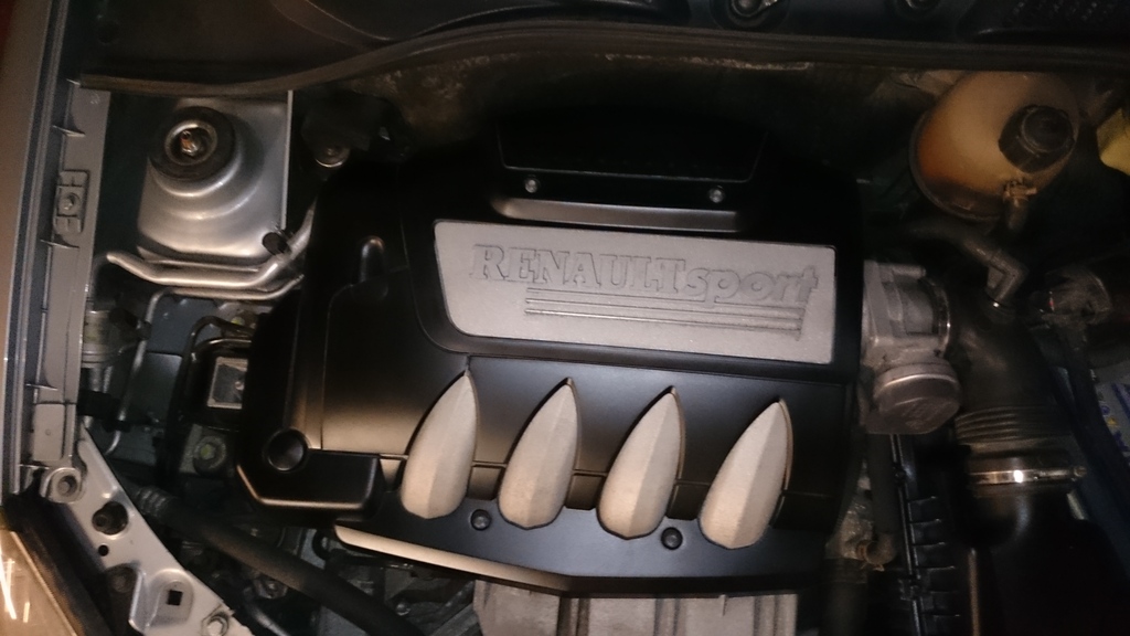

I moved the car into the garage, removed all the covers I wanted painting, gave them a good clean, sanded them a little bit, cleaned them some more and degreased them all and let them dry. Then set about putting a few coats of primer on and about 4 coats each of satin black. I then spent my day trying to shake the hangover and placing orders on ebay for a few other little bits and bobs for under the bonnet while the paint dried.
Once it was finally dry to the touch, I put it all back together and I am already pretty happy with how it looks under the bonnet! :)
I will give everything a good clean under the bonnet when the rest of the stuff arrives for the bay:

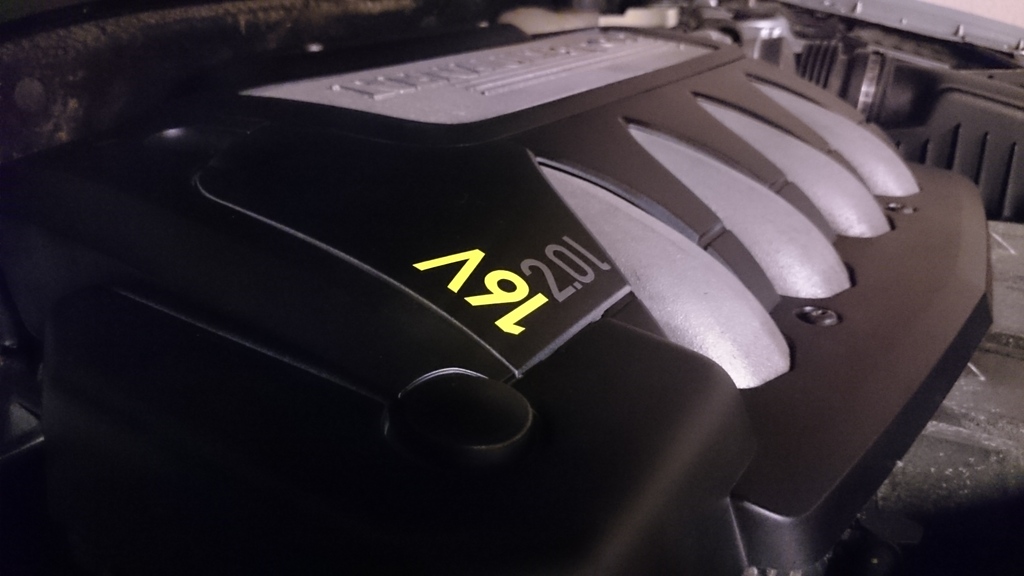

It's the little things. Put the engine cover stickers on to finish that off. Just got to get my battery cover in and order a new expansion tank.

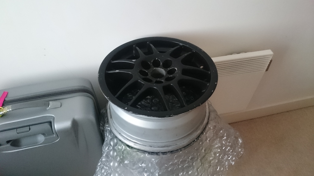

These also arrived today. :)
They need a refurb and are the non renault ones, but they were very cheap and I had been looking for weeks for a set, so snapped these up very quickly.

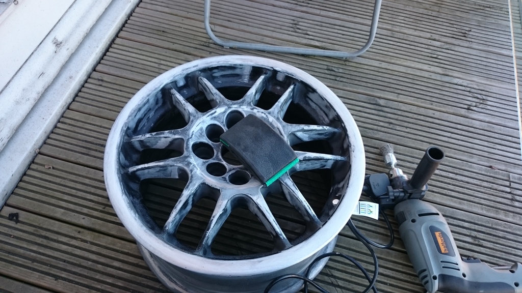

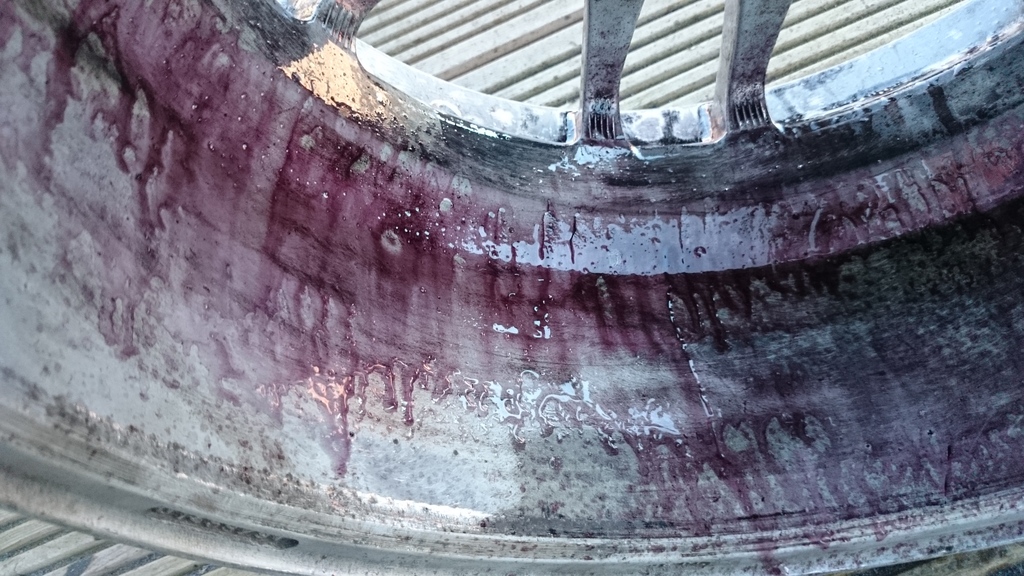

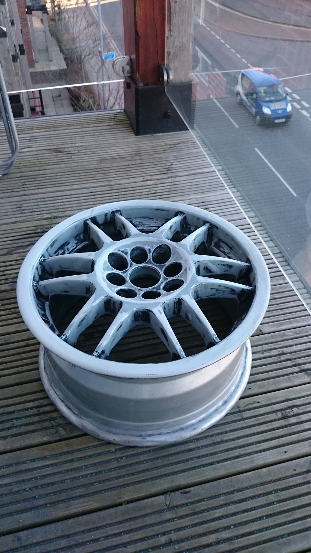

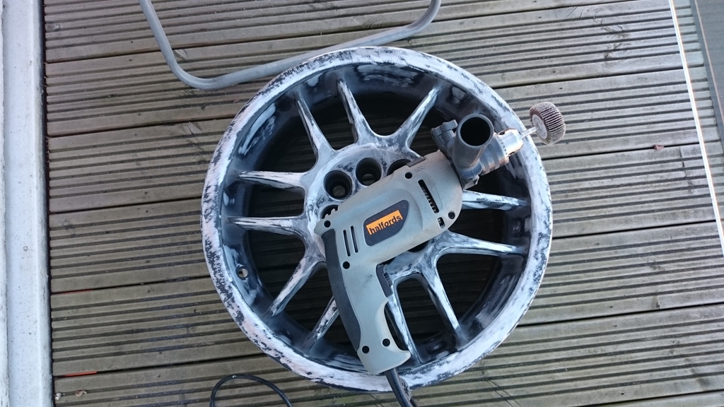

And the refurbishment begins!!
Two more to do next weekend and then onto primer and think about colours!
