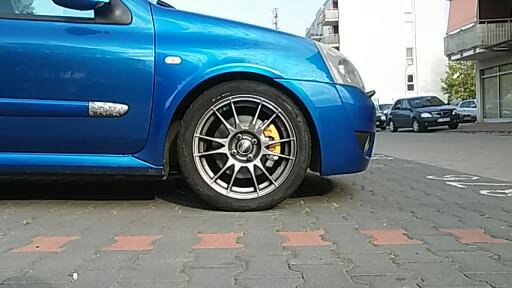

I can't remember, does yours run spacers? Mine are ET38, but unsure if the silver goes that wide. Thought they only come in ET43?
leeds2592
  Bean 182 + E70 X5
Not running spacers on my TD's at the minute but unsure on the offset as I can't see it anywhere on the wheels, need a proper look when they're next clean, must be pretty low though as they're quite flush with the rear arch.
TBF, I don't mind running spacers if I need to but I may just get a set of second hand ones that need refurbing and get them done in Silver if any come up.
Thank what I did mate. 16mm - 20mm will be perfect.

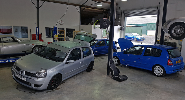

Took it to work on saturday to do a few bits, plus @MrBlonde wanted to do a few bits on he's cup too.

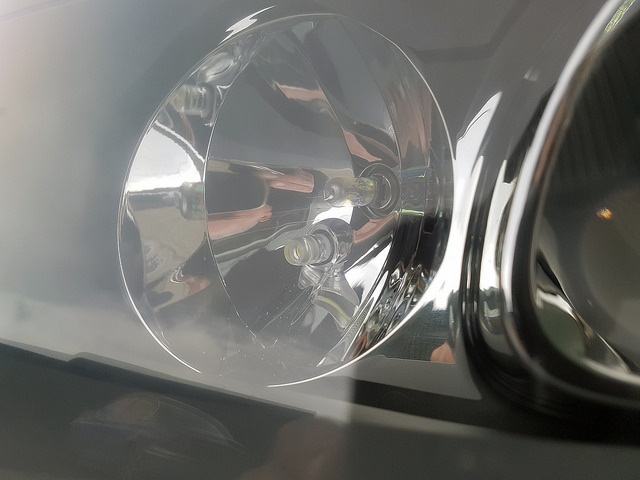

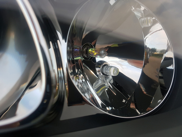

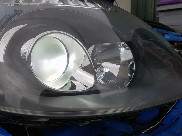

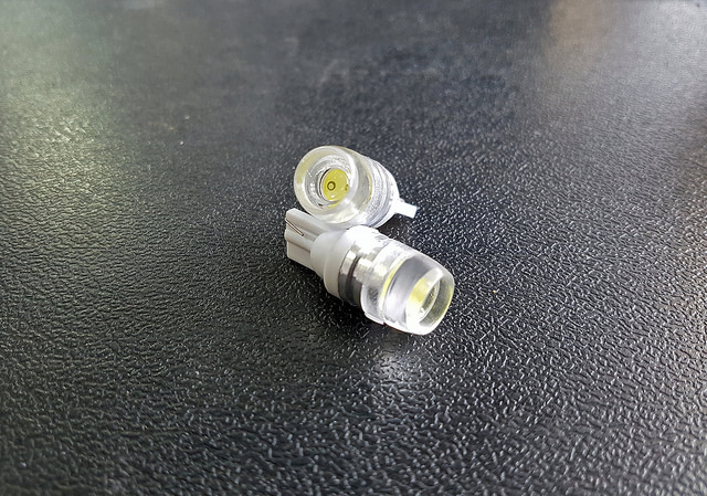

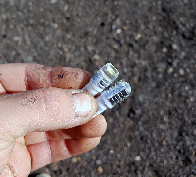

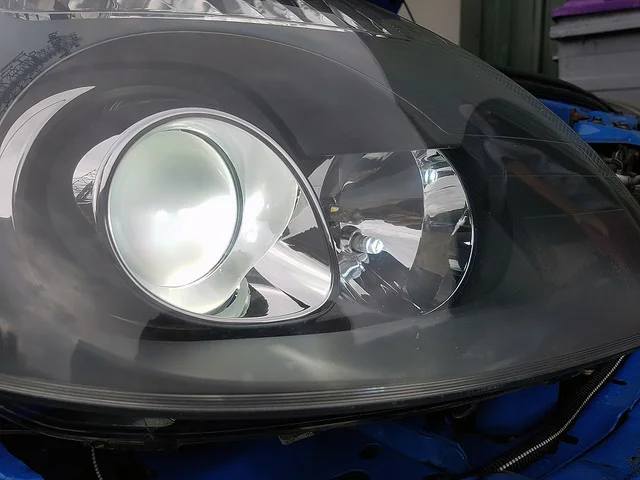

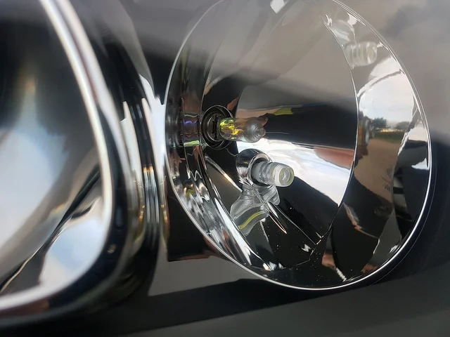

First job was to change the sidelight bulbs. My crees were lovely and bright but 2 have blown. I had only 1 sidelight and 1 map light, the other sidelight and interior light had blown. Perhaps i got a bad batch? These arent as bight as the crees but they are still better than standard, plus they are still white. They look OE in the headlamps so they'll do for now.
With the new rainbow effect full beam bulbs

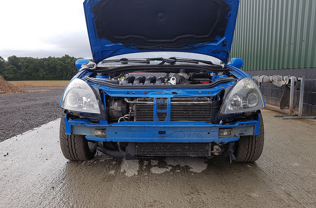

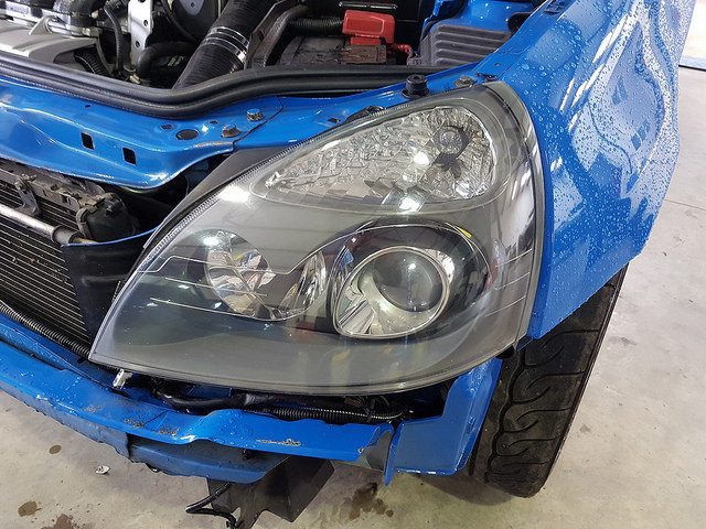

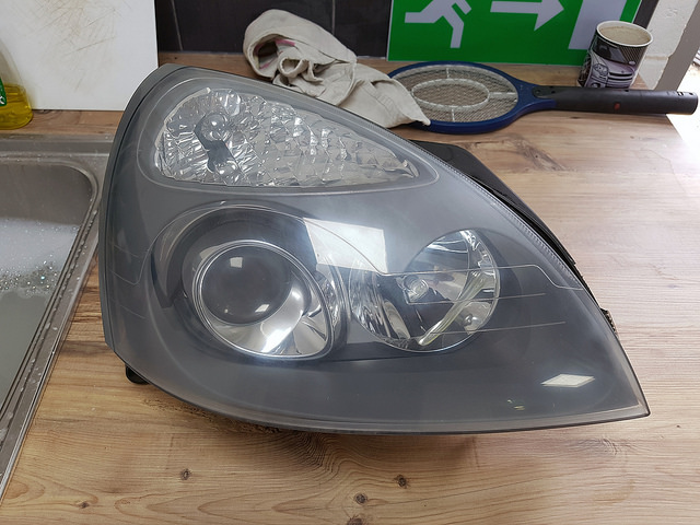

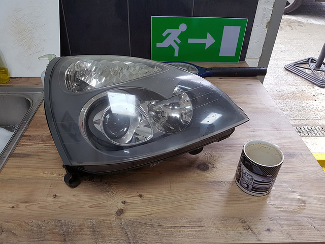

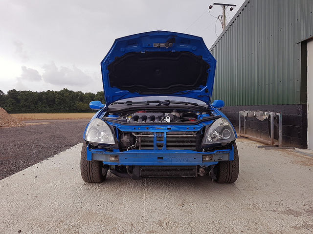

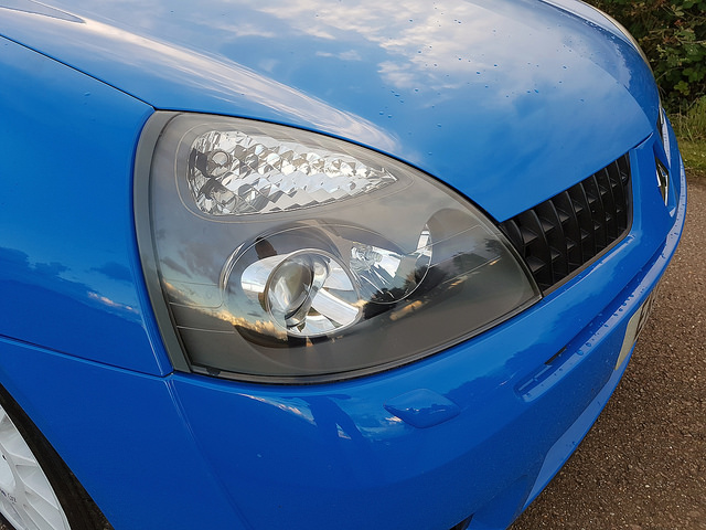

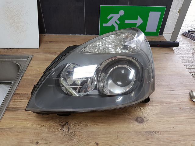

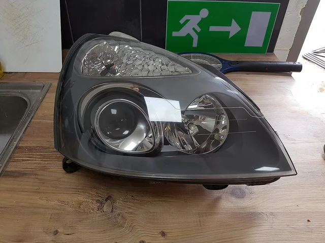

Next job was to clean the headlights. I don't have a machine polisher but wanted to do something as there was some heavy swirl marks on them and they looked dull in places. I used 1200, 1500, 2000 wet and dry with hot soapy water. Finished with G3 scratch remover and super resin polish.
Bumper off
Before
During
After

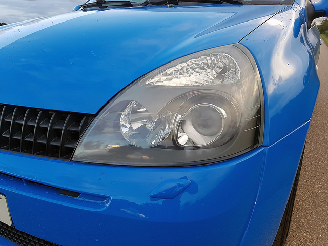

Very pleased with how they've come out, even more so because they was done by hand.
Drivers side done, passenger side needed
How the bulbs look for colour match with the xenons lit.
Passengers side done before final polish
All polished and fitted
Then my friends Jack and Tom came down as Tom was fitting bucket seats and harnesses to he's 172.

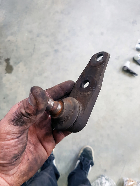

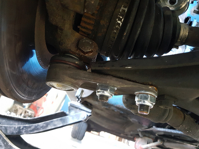

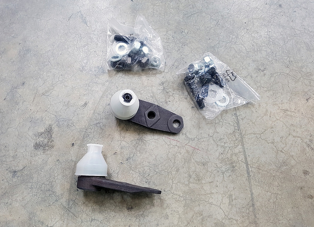

Earlier before we went to work i bought some lower ball joints from GSF as they had 42% discount. My plan is to change suspension parts before the driveshafts are changed as then once its all done, i'll get it aligned and it shouldn't need anything else (suspension wise) done then.
Was a bit awkward getting the pinch bolts out but we got there.

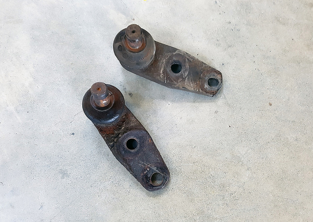

Old ones
One thing i forgot to fit was the plastic shim that goes on the pinch part. Is it really needed?
Next up will be top mounts and track rod ends. May possibly buy inners, but definitely get outers.

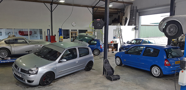

Decided to clear up and call it then.
Another few pics of the cleaned headlights

I had mtec's in my volvo that had the effect and seemed decent so i bought these as they looked the same but cheaper. Work well i must add, as i used them tonight :)
