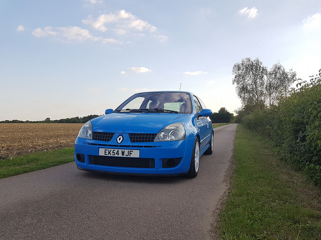

Here's how it looks now.
Looks fantastic now Mark - keep me updated on how your finding the GAZ's, I'm seriously tempted!
Can't help but think it could do with some spacers on the front? Front wheels look lost under the arches now it's a bit lower...

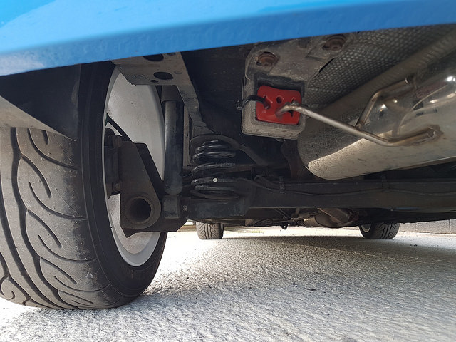

I have a knocking noise from the rear. I know it's not the suspension as it did this with the old shocks, plus these are new. Sounds like something is loose in the boot. Will need to look into that. It only does it on uneven ground.

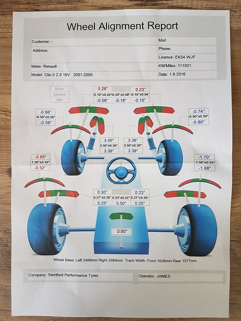

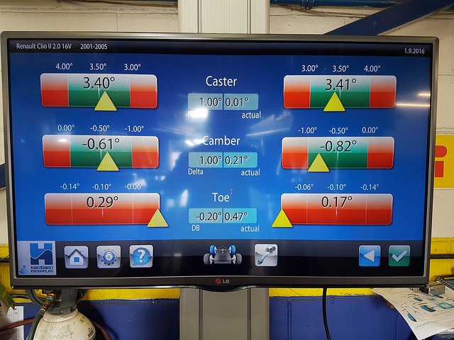

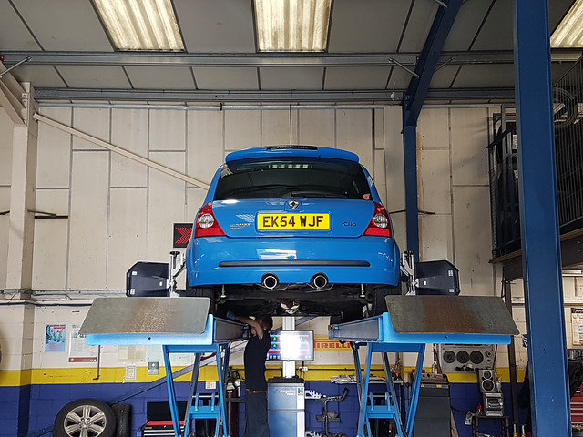

Going to book in for alignment on Saturday.

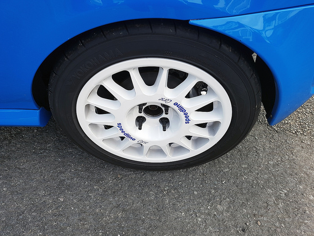

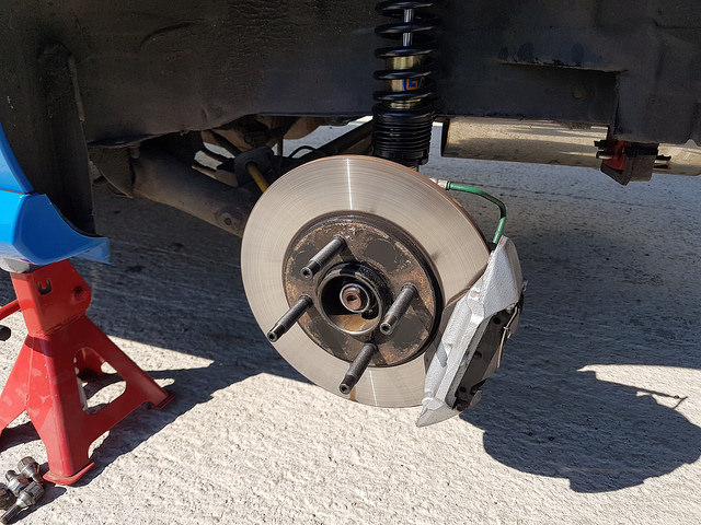

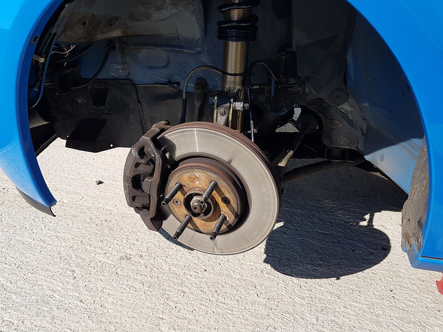

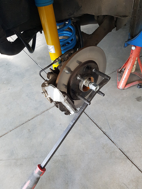

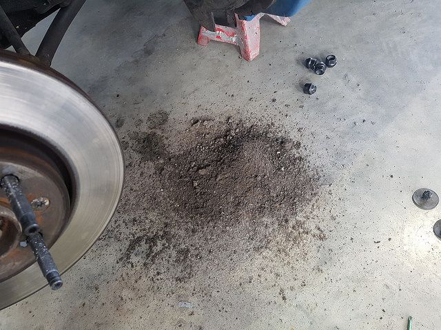

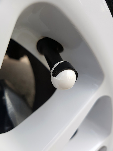

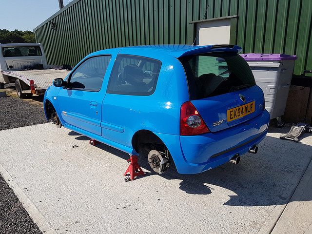

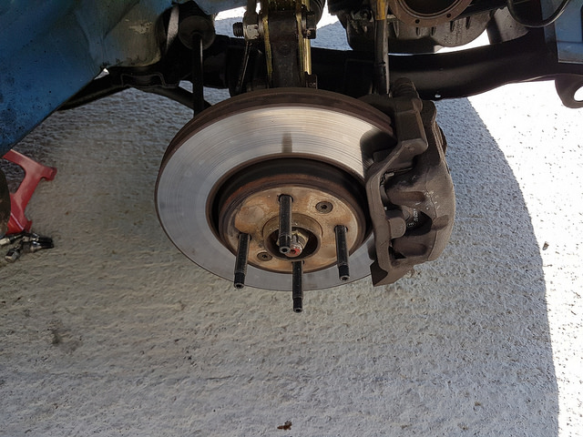

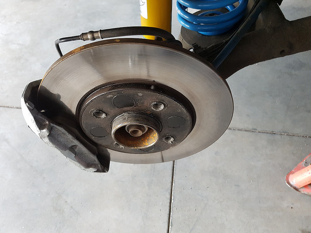

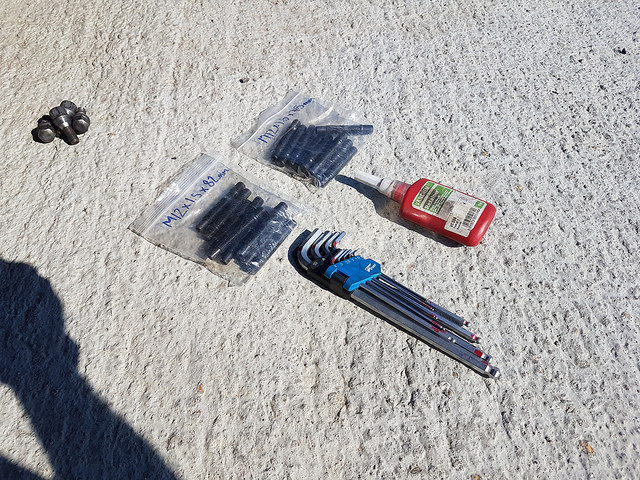

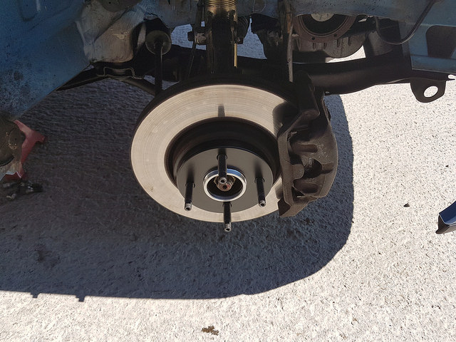

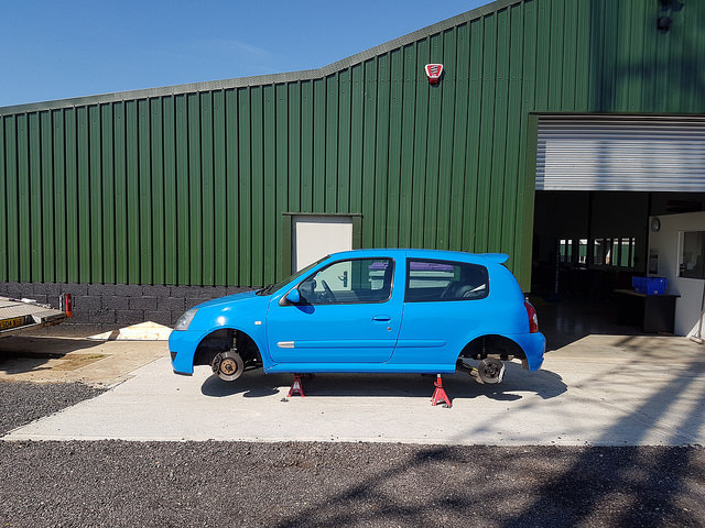

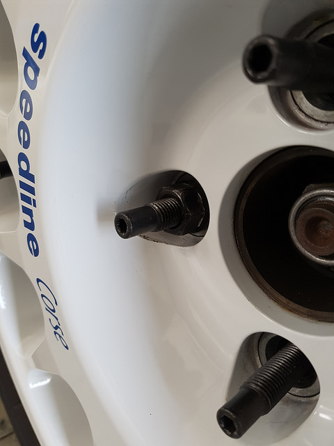

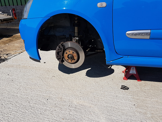

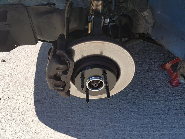

Got the studs and spacers fitted. Had a bit of a result: Phone up the stud company and wanted to order studs but didnt have my card details with me. Got the paypal adress and i said id send it in the afternoon, but didnt have time due to work. Came in after the weekend and nuts were here! Bit of a c**k up but im not complaining. Meant i could fit the studs now. I will get some longer steel ones at a later date, the GT50's probably in black.

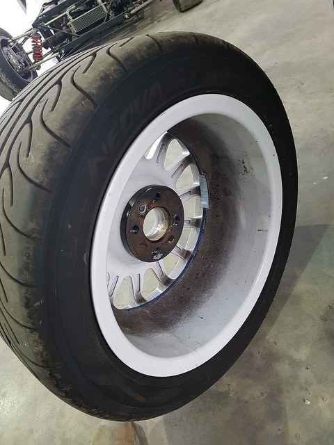

While the wheels were off i fitted the new 6mm rim tape

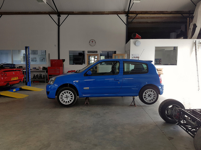

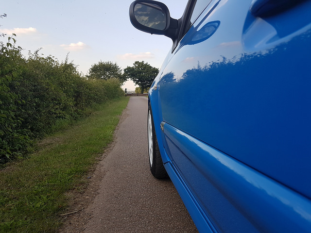

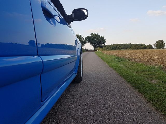

All fitted and pics taken to show how it sits. I was contemplating 5mm spacers but i dont think i will as i think it may rub unless i get the arches rolled which i dont want to do.

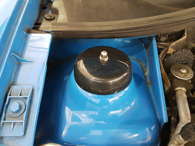

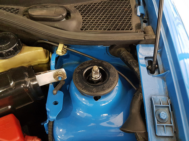

Got some top mount covers off @RyG so i could cover the holes in my turrets but they wouldn't fit over the coilover stems so out came the drill!
Not the best, but better than seeing gash holes for sure.

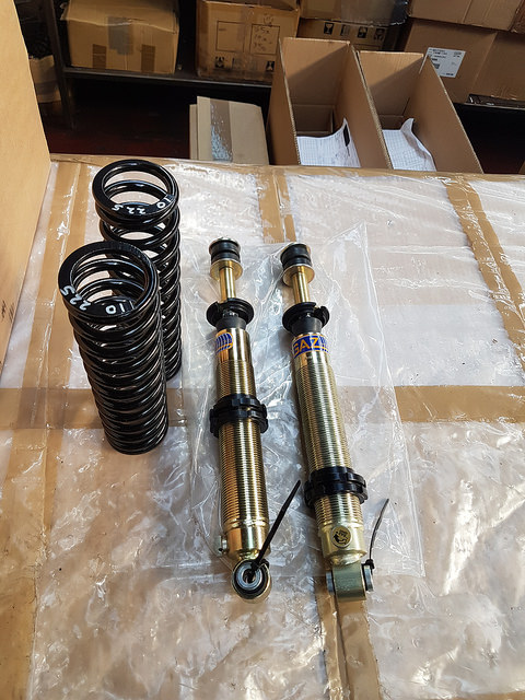

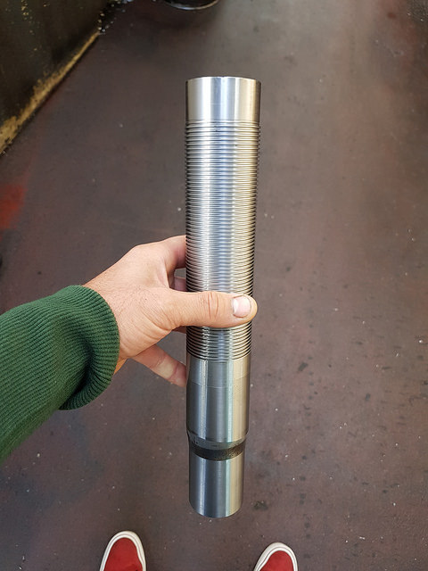

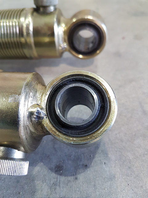

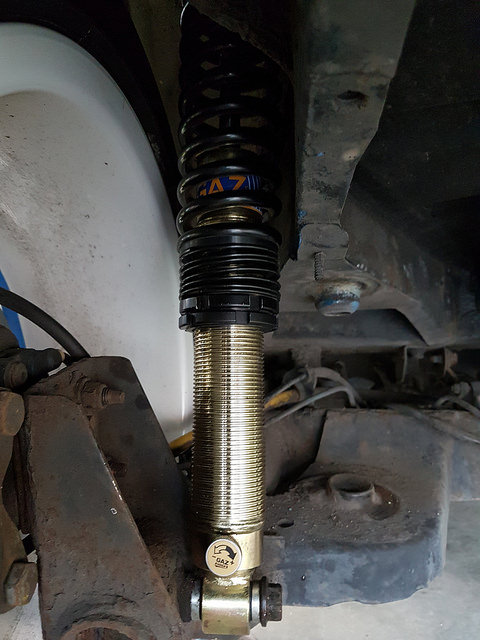

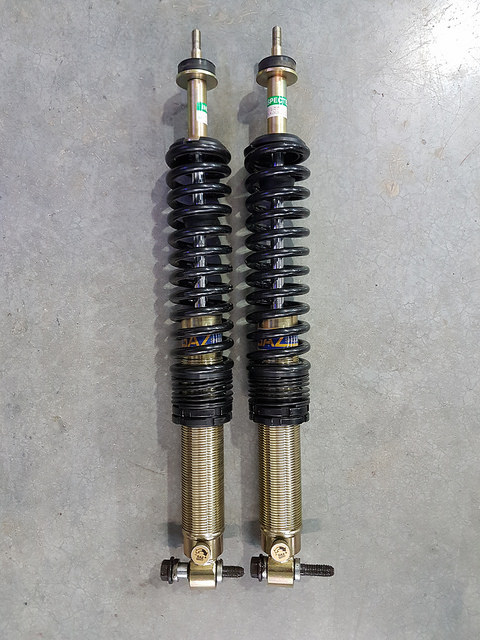

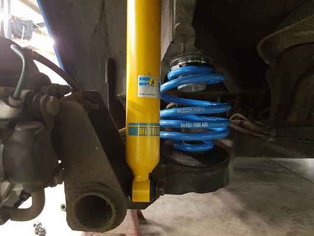

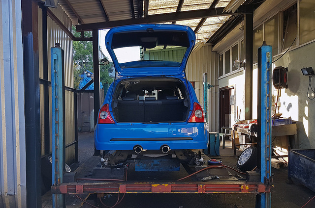

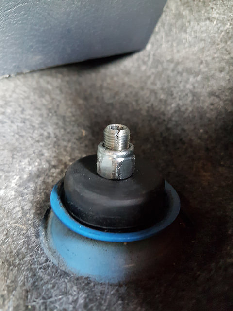

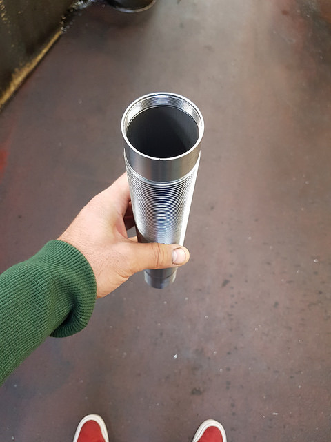

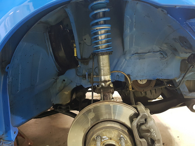

Recently i had a knocking noise on the rear. After a lot of investigation it turned out to be the rear coilovers. I tried everything, including swapping the helper springs round, removing them completely, rasing it, adjusting the damping, loosening the top mounts, etc! I even tried @MrBlond cup shocks and cooksports to see if it definitely was the coilovers, which clarified it was. I did somehow manage to get one top mount nut stuck and when i turned it with the allen key, it broke the stem! Needless to say i wasnt too happy!. After a call and few emails to Gaz direct, it was arranged to go up there today. Give them there dues, the service was spot on. They was very assuring it would get resolved hassle free and it did.

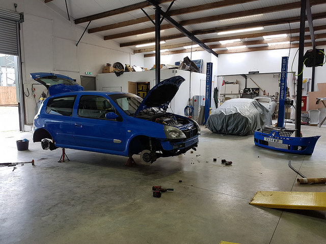

Drove up there today and after they had a look, it turned out the knocking was in fact the valving. Because of the nut/stem issue, they gave me 2x new rear coilovers and re-valved the shocks. All free of charge too. The 2 chaps that helped me today (Byron and Paul) were spot on, along with Warren the MD at Gaz. Cant fault them one bit. I went up there with Emily and after speaking to them and looking around the unit (which i took pics off and will upload them in here in a bit) we had a bite to eat in sainsburys and they even picked us up from there. Loads of praise to be had there, top customer service :) Drove around the industrial estate and then home all with no issues :smile:
Few pics.
All done!

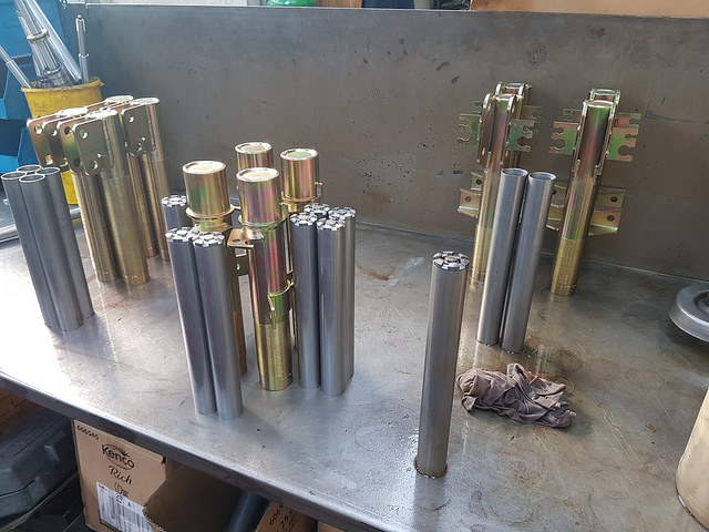

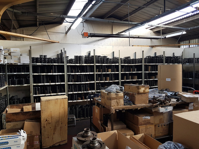

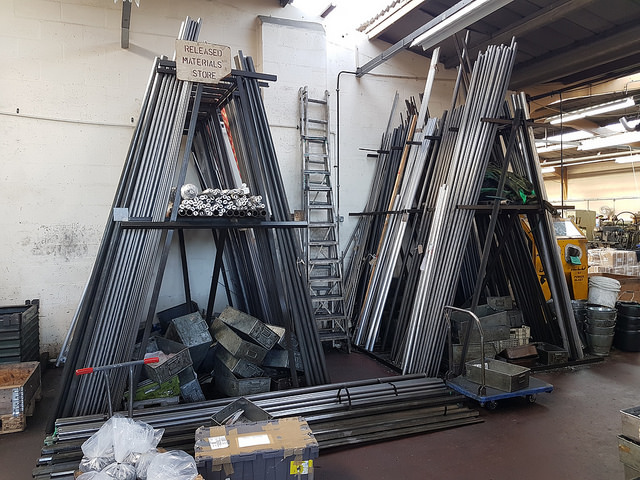

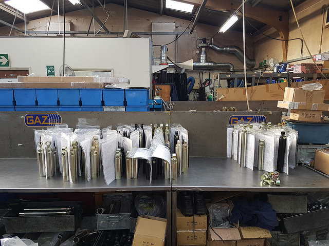

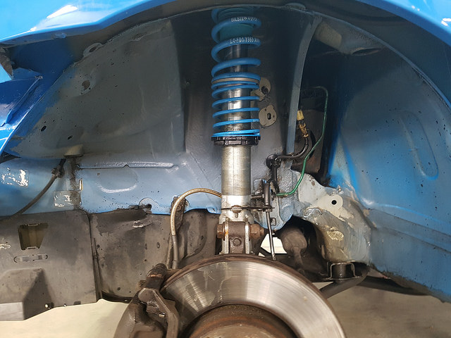

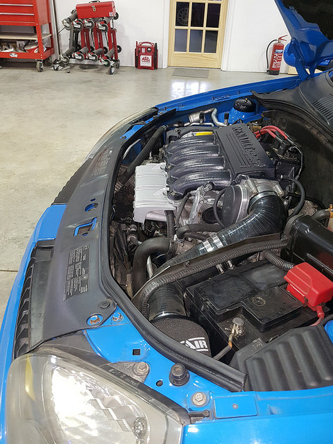

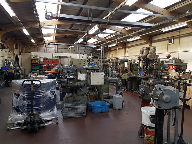

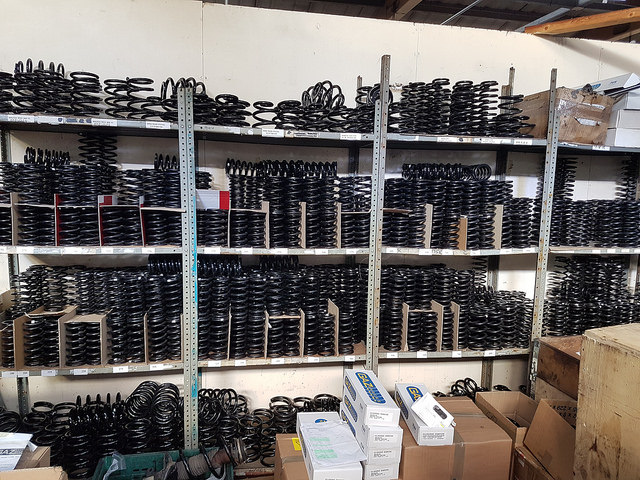

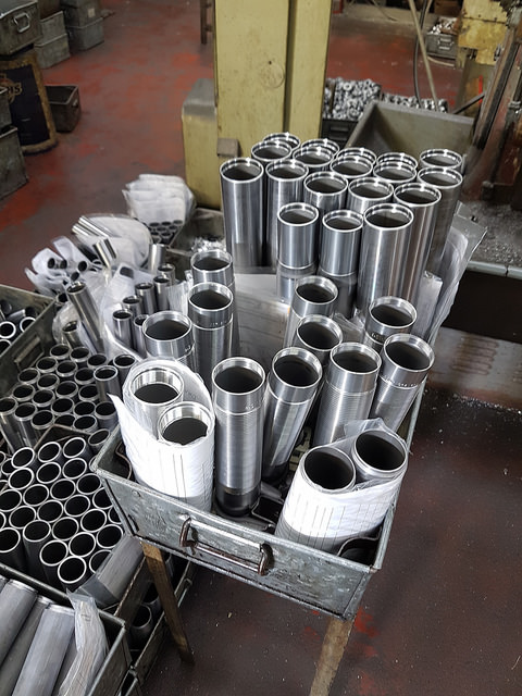

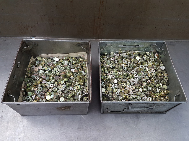

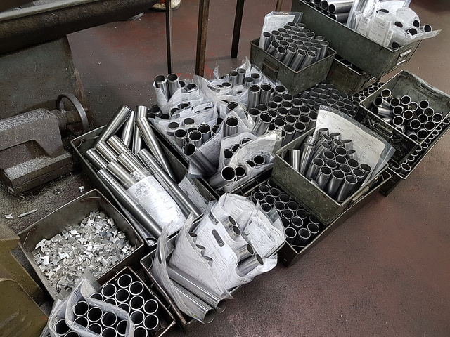

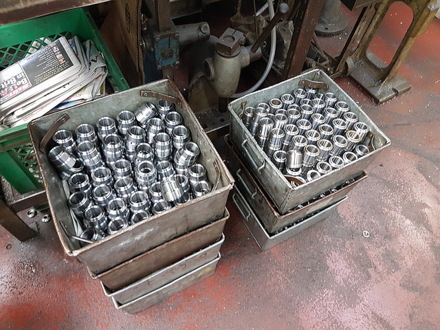

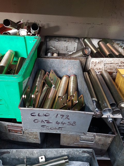

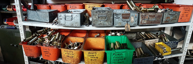

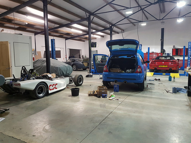

At the Gaz HQ (In no particular order). Proper old skool factory!
Forgot to mention that i had the car aligned too. However i do think that ive ordered too soft a spring with these coilovers on the fronts (275lbs) so i may opt for the common 325lbs for the fronts at a later date so the alignment will have to be done again. This isnt too much of an issue as im going to buy some bits soon. These consist of:

Really interesting seeing the GAZ HQ photos too, when you just see the end product, you never think about how they start life lol!
Thank you Steve. I asked if it was OK and they said it was fine. They let me roam around and its nice to see how things are made/done. Its also nice for others to see too so I thought I'd share in here :)

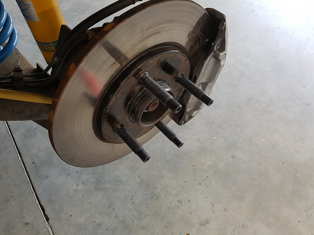

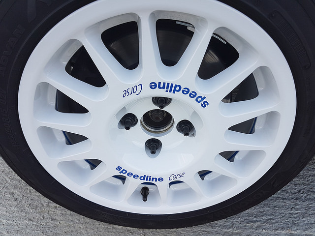

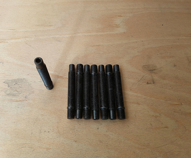

I ordered some 68mm studs as i was unhappy with how far the 75mm studs poked up. New ones turned up but turned out they sent out 90mm!
So a phone call to them and they sent out the correct ones. These then got lost in the post, so another phone call and i finally got the correct ones through.

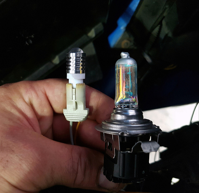

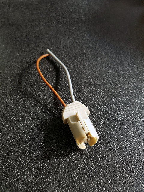

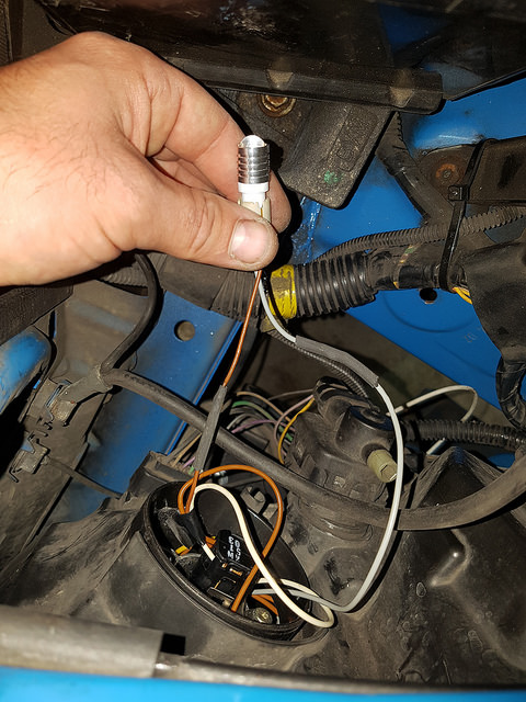

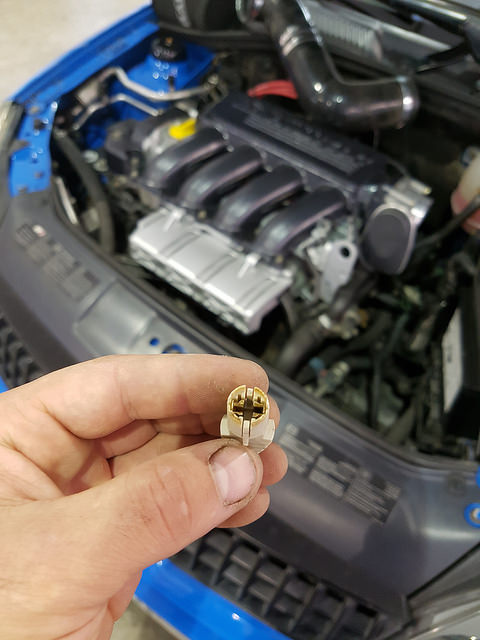

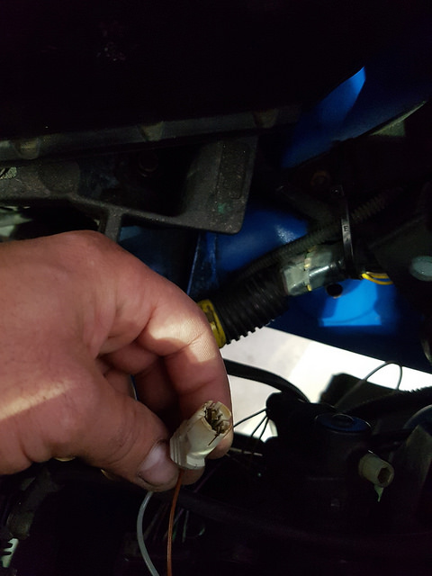

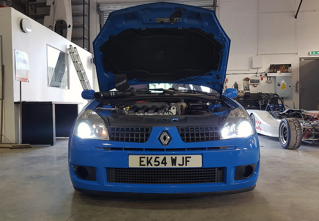

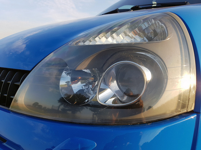

I managed to get a bulb holder off @Ads29 as it turned out my bulb holder was playing up.

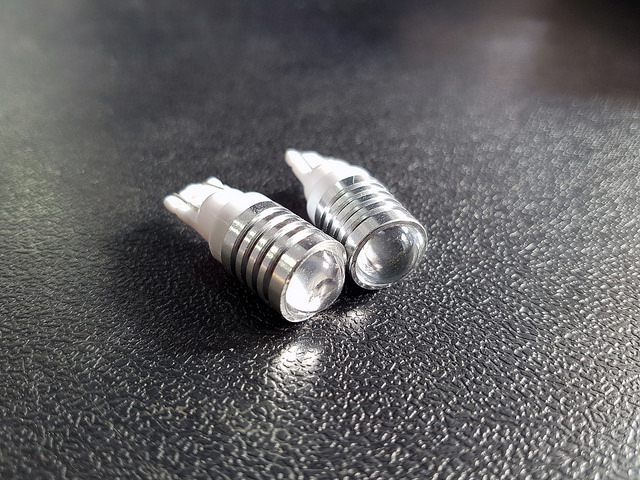

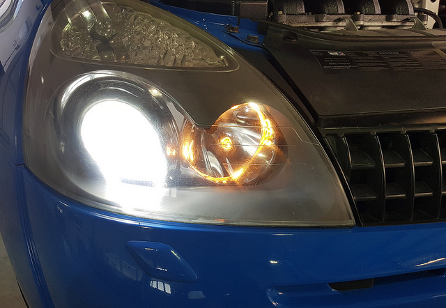

I also bought some cree sidelights and rainbow effect full beam lights.

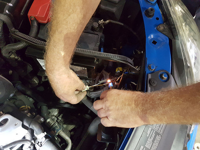

I then got a bloke at work to solder on the new holder as hes better at it than me!

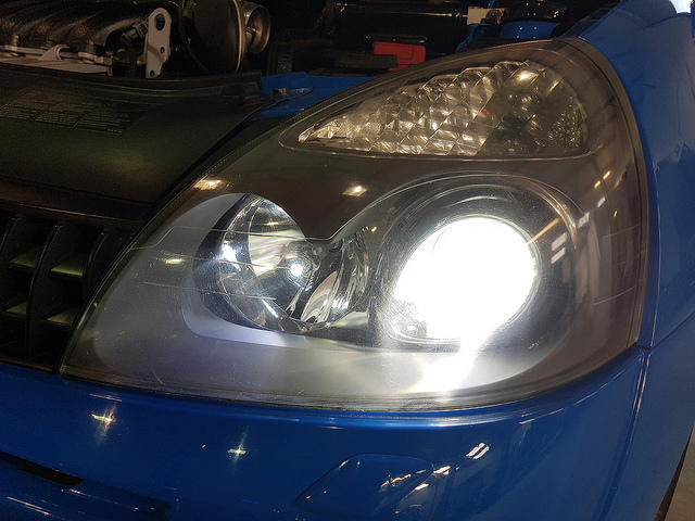

Standard Vs Cree
All fitted
Nice and subtle looking

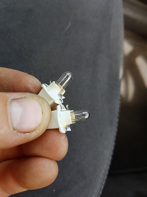

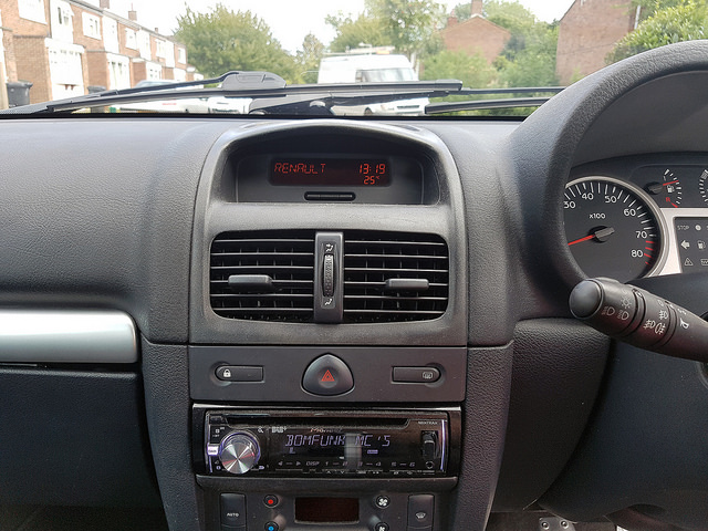

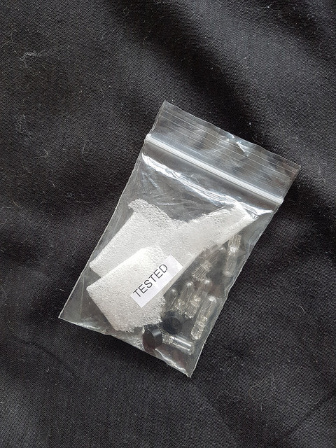

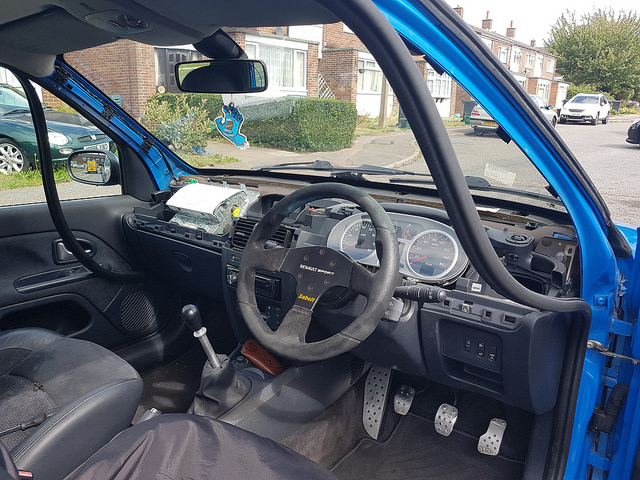

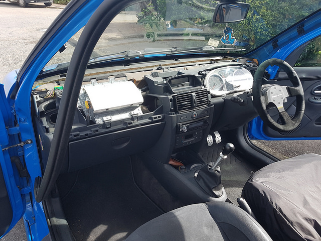

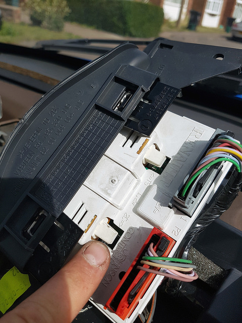

Next up was to change the dash clock bulbs. Ive been meaning to do this for ages as ive had the bulbs from when i had my BG!
Straddling!
Even came with a friend once the dash top was out!
Clocks out
And 2x worn bulbs!
New ones fitted and brightly lit!
All fitted and back together!

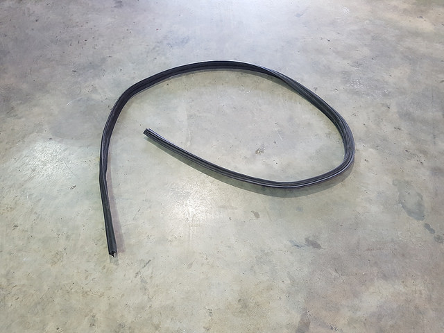

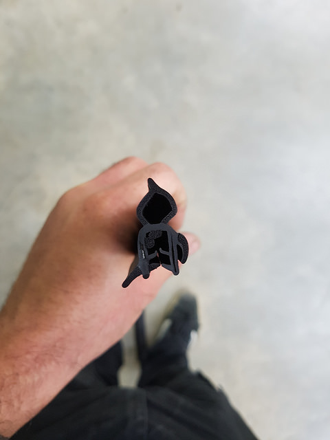

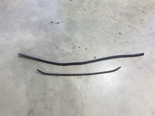

While i was at work i found some rubber that would be perfect to replace my broke standard one, plus i could lengthen it like the ph1's.
Then i make a purchase....
Apparently they had done 1000 miles. Unsure on that as they all say that but they haven't done much more and are in very good condition. I also got them at a great price and of course in 60mm spacing!

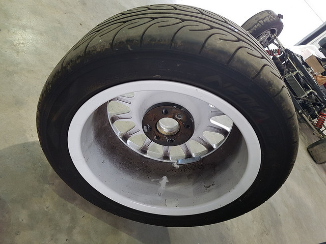

While fitting them i decided to remove the wheel tape.

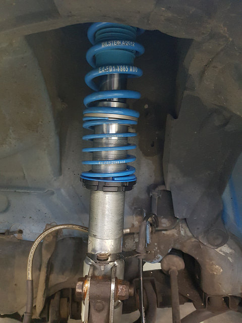

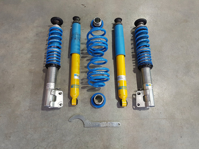

Now we use Gaz at work and have never had an issue. As you know mine knocked on the rear and Gaz sorted them out. Brilliant service there and can't fault them one bit. Ive been in cars with bilsteins and i had bilstein shocks with eibachs on my volvo but never owned coilovers. So let's talk the difference. As you know the Gaz's are damping and height adjustable, these just height. Gaz offer spring rates, these are fixed. Gaz do full coilover these do "normal" style. I liked my Gaz. They was very comfortable. I thought they was better than the cooksports in fact for soaking up bumps, plus you can go lower. Kit seemed OK to be fair. There a cheaper coilover and you can tell but for the money it's hard to fault them. But.... The Bilstein are far superior. The build quality is so much better. They look a better thought out kit. Oddly although there is more parts to the fronts, they are actually lighter. As for the damping, it's not needed at all. It's hard to describe but they are spot on during road driving/cruising around town but once chucked into a corner or bend they almost feel harder. It's like there progressive. Having driven to work on the Gaz's and home on the B14's the difference is very noticeable. Even the rear shocks are light. The springs look and feel a better quality than the Gaz/faulkner springs. Also the threads are finer meaning more fine tune ride height. I can now really see why they are raved about. In fact, I'd go to say that they ride better than my old BC's and they was nearly £800. Now I know there new on but I can honestly say, hand on heart that they are much much better than the Gaz's. Now I'm not slating the Gaz's but honestly between the 2, spend that extra. These will not disappoint you. You don't need the full coilover rear unless your going for fast road and track use on a regular basis as I feel that this setup soaks up the bumps better. Better ride, quality, design, etc. Worth the extra.

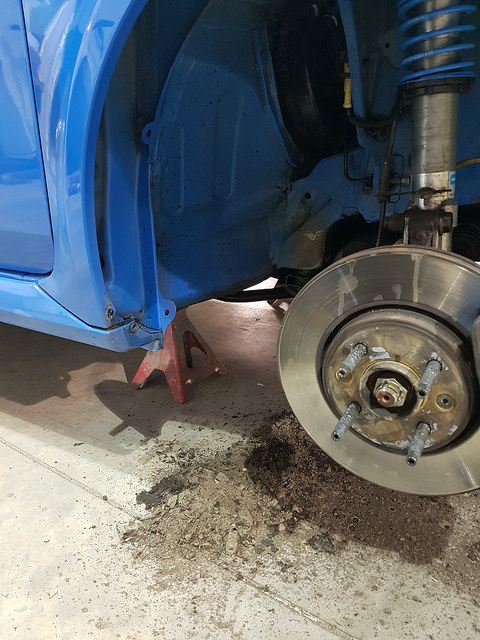

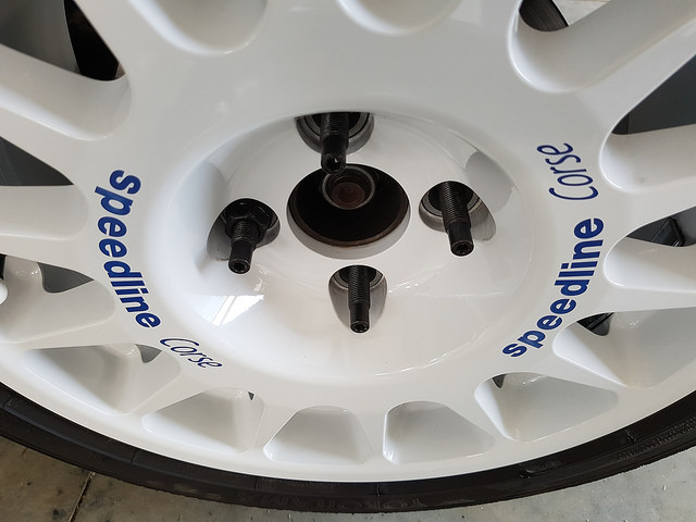

My 68mm rear studs finally turned up so i took the car to work to fit them. A few days before Emily took the car to work as i took hers for an MOT. When i came home she told me she pulled the handbrake up too far and heard something snap. Upon inspection, its the drivers side handbrake cable thats gone through the caliper. This will be fixed soon, but it made the stud swap a tad harder. Nothing a pry bar between the studs couldnt fix!
Double nut trick worked a treat!
68mm fitted
Cleaned the wheels while they was off too
Much better.

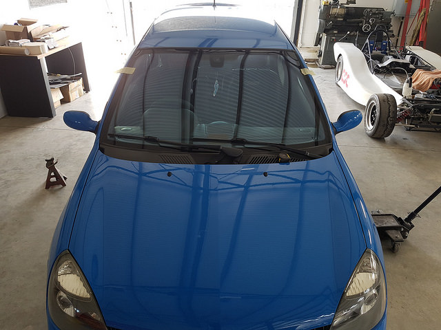

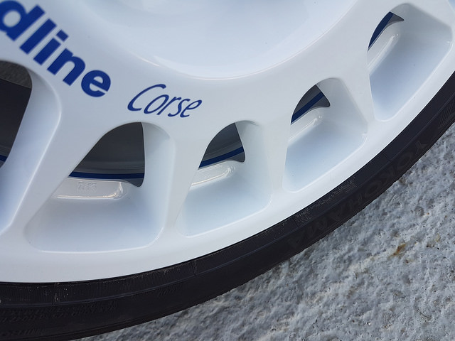

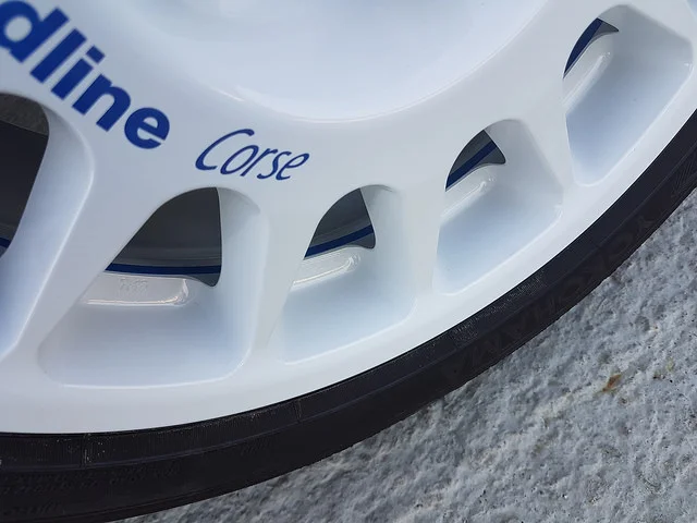

I also ordered some stickers from @LeeRS. This guy is a hero! I asked for some custom sized stickers and he came up trumps as always!! Thanks again mate!
The cutting was as neat as i could get it but i did go wide a few times.
Never mind, its close enough for me!

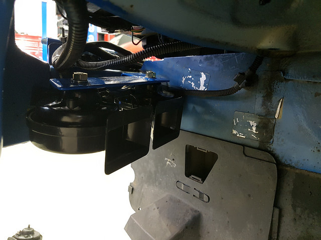

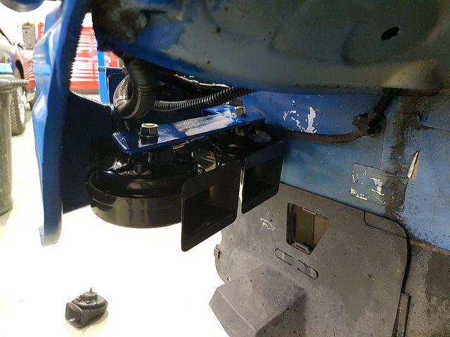

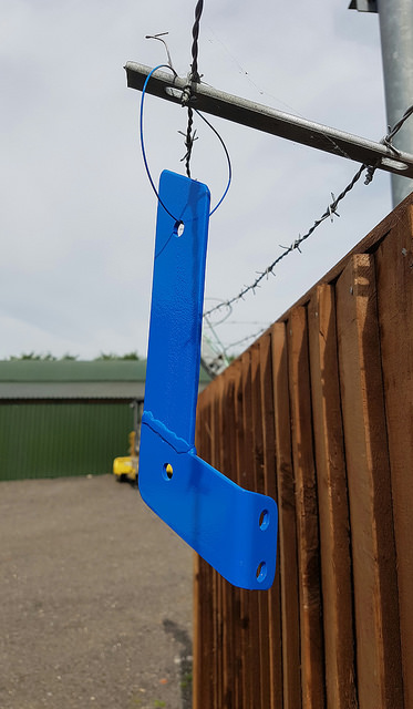

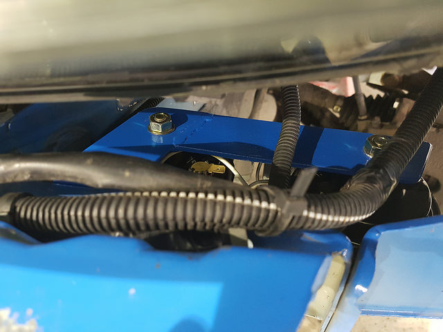

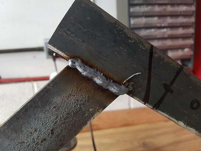

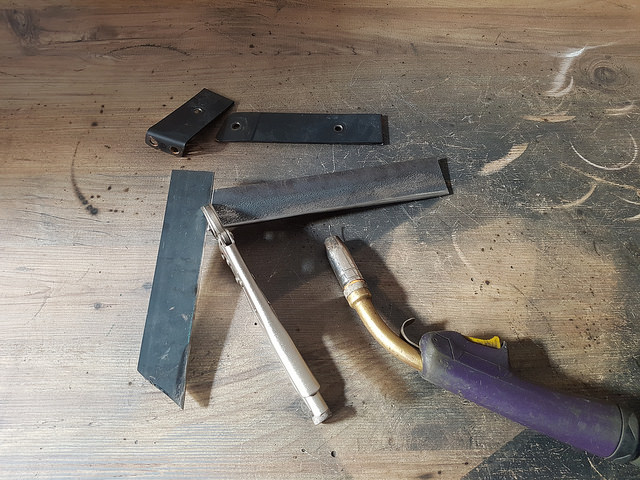

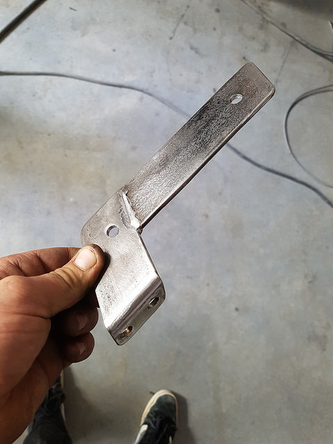

I decided to make my horn bracket a bit better.
Etch primered and painted in RB!

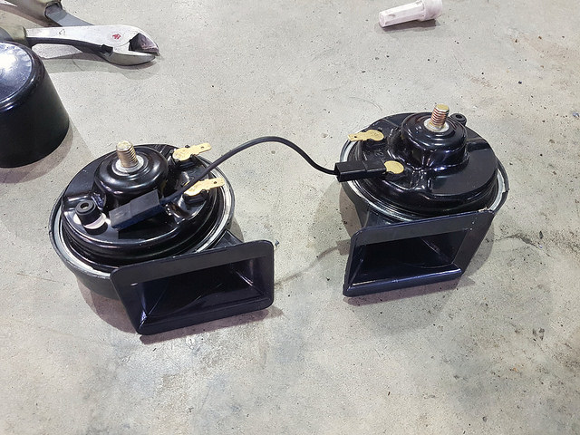

"Borrowed" some new horns from work!
Oddly, the horns dont want to work. I checked the fuse, which is fine. I even plugged in the old horns and still no luck. Any ideas?

They are great mate and having them next to the Gaz's was good to compere the 2.
Adjusters definitely go at the top. If you look the writing is the correct way up. If the adjusters went at the bottom then the writing would be upside down as the spring can only fit in the adjusters one way! ;)

Question in the coilovers, I'm thinking of putting the adjusters back on the rears of mine, how do yours fix in place at the top? I've got like a little metal disc and a bolt for mine but can't see how it'd work.
Cheers Ethan! I'm not sure about KW'S ones but these have a cup that sits over the top bump. The cup is threaded with the adjusters in that. The OE rubber sits at the bottom spring and onto the the beam as normal.

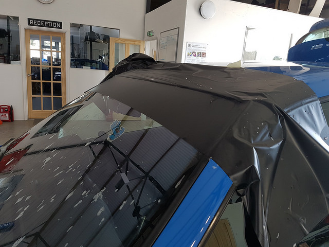

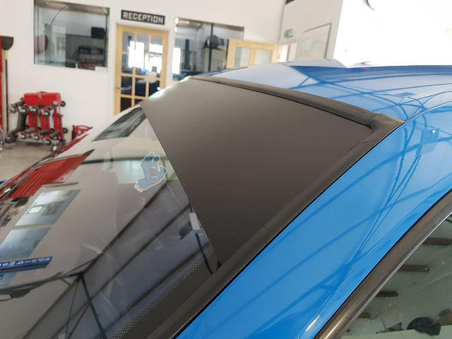

Nice application of the sunstrip.
They never trim perfect round the edges mate dont worry about that :smile:
Thank mate. It was a bit of a pig but got there in the end!
