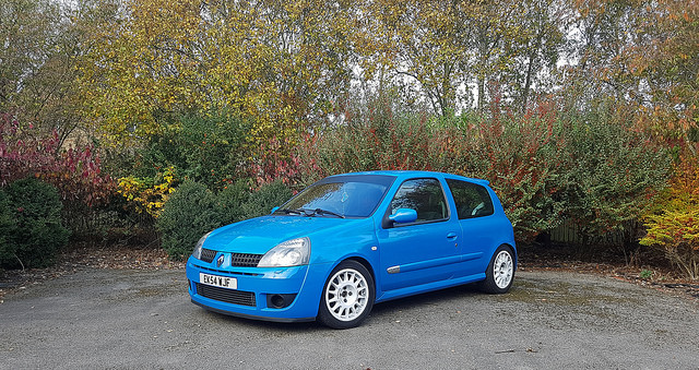

Been reading through your thread Dr Jekyll - I really love your car, the combination of the RB paintwork/white wheels/stance works so well - I particularly like that side profile photo with the moody sky-scape :cool:
You've obviously built up quite a knowledge base on these cars over time - & I've loved reading about the little touches/things that you done.
Thank you very much for the kind comments. It really is nice to know that other like what I do.
The moody pic I took when I left work one day. It was only taken on my phone but I thought it looked pretty cool with the sky like that. Plus I love a pic ;)

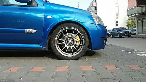

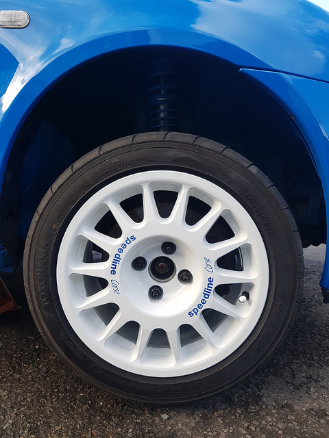

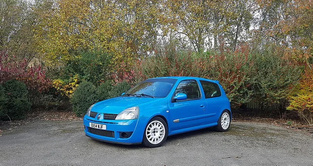

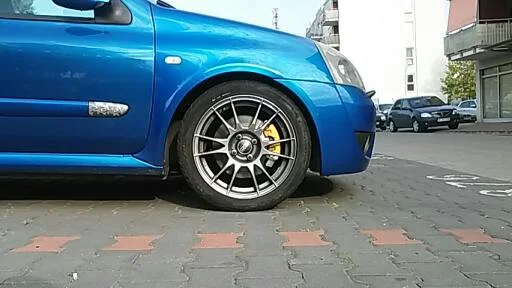

your car looks pretty low! I'm curious how much really cause I had some issues with mine the first time I got the coilies on it. It used to bottom out quite often so now it's like this:
That's probably the picture making it lower than it is. I'll get some pics tomorrow if I can of the arch gaps.

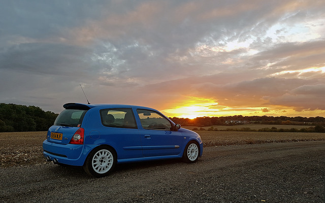

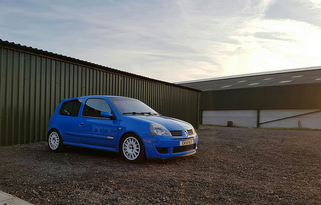

After leaving work one evening, the sunset was out and i thought it would make a decent few shots so i snapped away

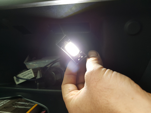

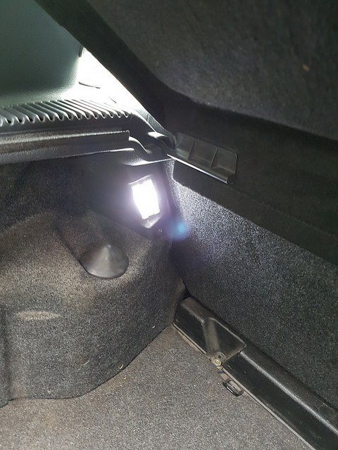

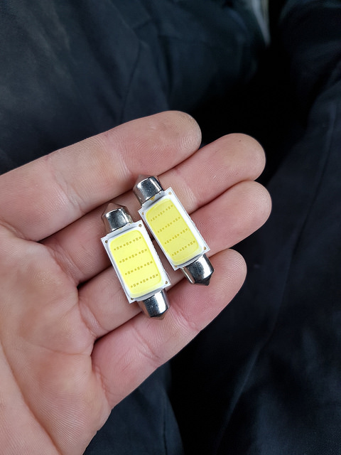

I bought some LED bulbs for the boot and glovebox

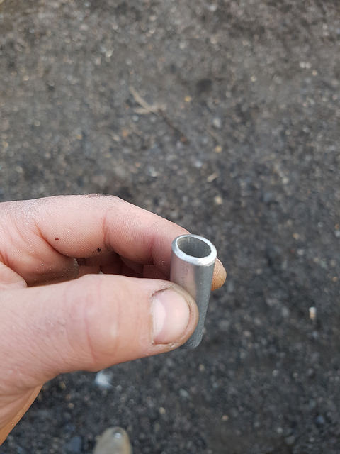

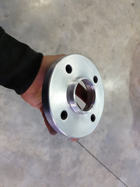

Decided to remove the back paint off the spacers as it was chipping in places

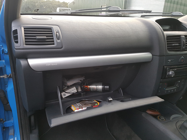

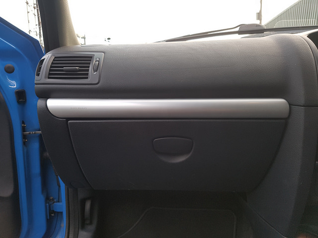

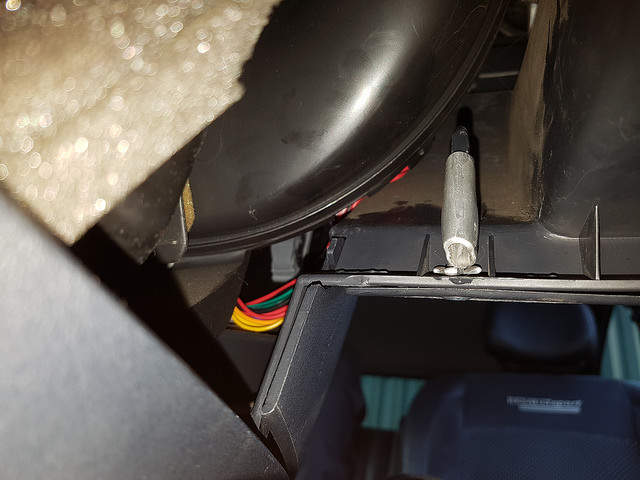

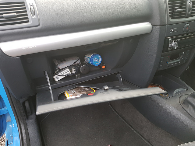

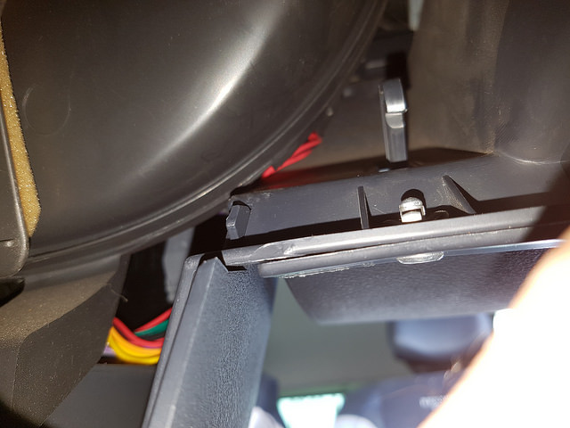

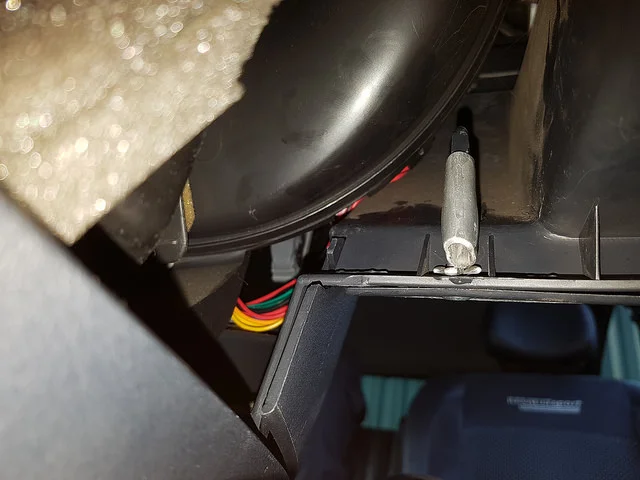

My glove compartment has been broke for a while so i managed to fix it. Works a treat now!
By doing this, it actually sits better too with no saggy ends like they all do! Result! It was also here that i decided i wanted to change the colour of the dash strips.

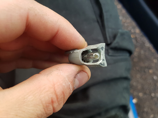

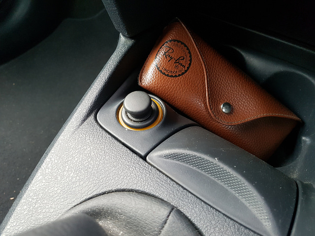

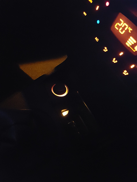

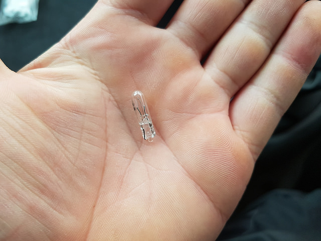

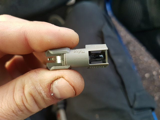

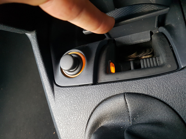

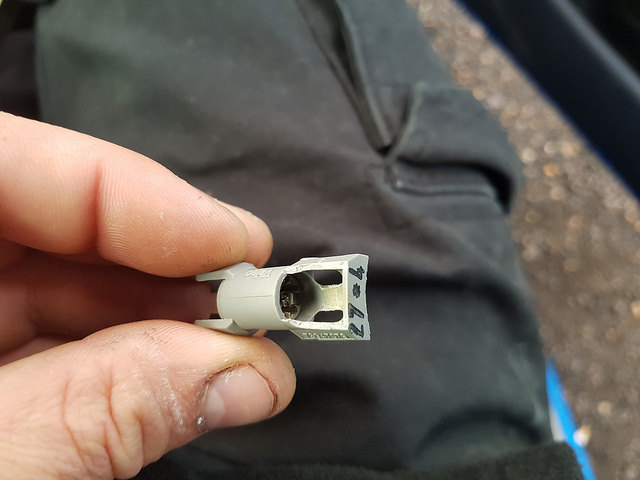

Had some dash clock bulbs spare so i decided to change the cigarette lighter bulb as its never worked. In fact, i don't think i've had had one working in any of my clios!
Definitely blown! When fitting the new bulb i found it virtually impossible to get it in so some adjustments were made!

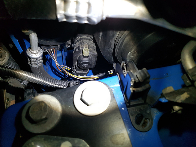

I adjusted the headlight height setting as mine was sitting way too low. Probably doesn't help being on a lowered car.

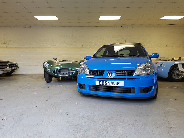

Lonely RB, early at work

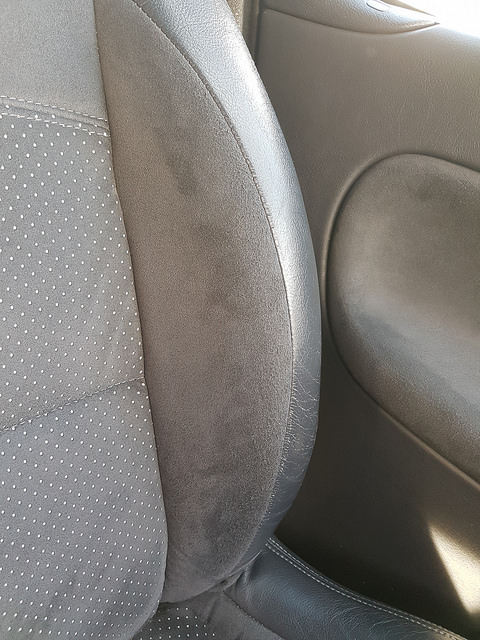

I also de-bobbled the seats
The seat belts need cleaning again as they've gone dirty. Unfortunately silver seat belts and my job don't go together! I will be doing the vanish gold method again as it worked really well last time!

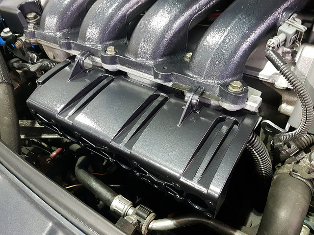

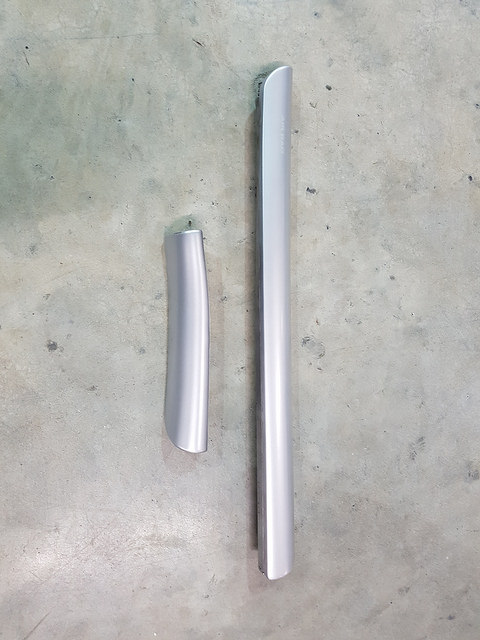

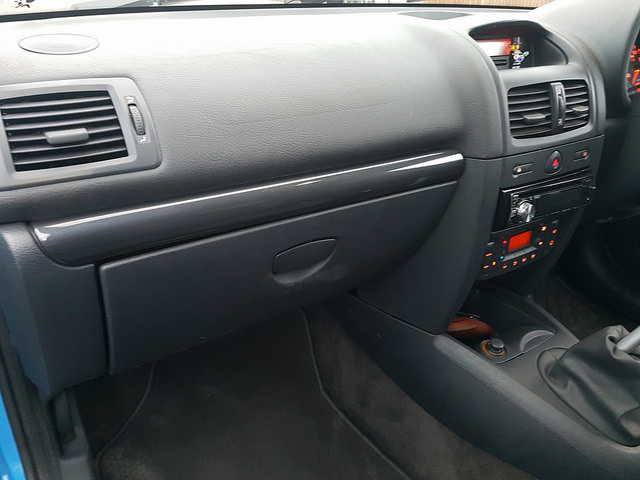

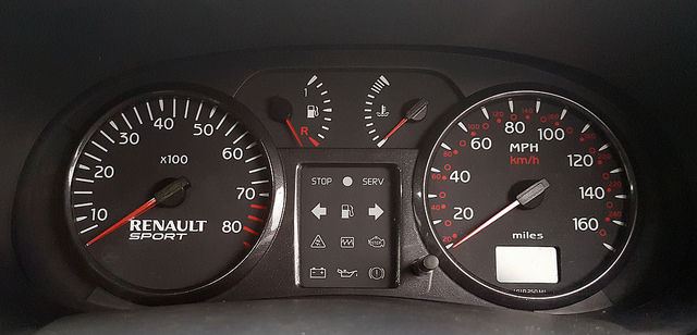

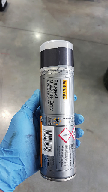

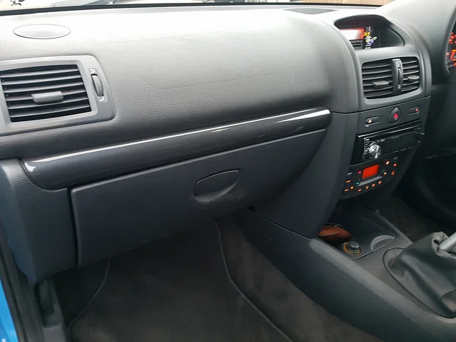

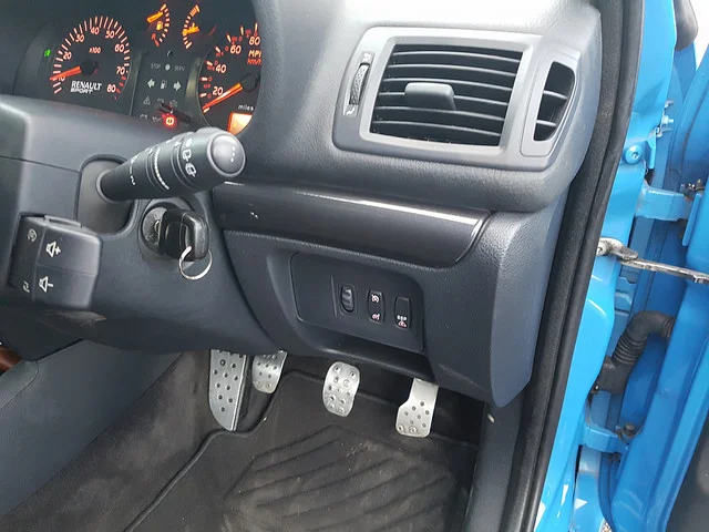

Dash strips have been sprayed. These are done in the same colour i've done my engine parts in, which is Peugeot Graphite Grey. They've come out really well, i'm very happy. They also need flatting back a tad but it'll be very fine as they look good as they are.
Its hard to capture the colour well but in some lights it looks subtle against the dash, but in other lights it really pops and breaks it up. Having a look and taking a inspiration form @RMDavis thread, i think im going to paint my BMS shifter the same colour.

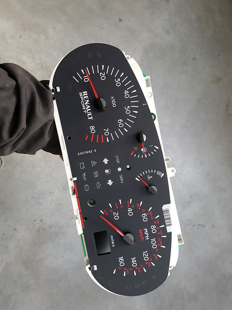

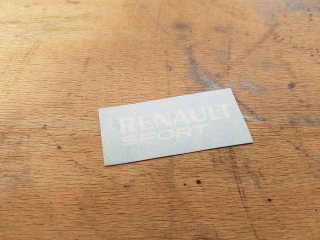

I had some stickers made up from @LeeRS a while ago and one was this little number to break up the rev counter.
I did also paint the clock surrounds the same colour but unfortunately i knocked it into a tray of acetone that was nearby that i had some calipers soaking in from another job! Gutted as it came out great 😧 Thankfully @cs_dave came to my rescue and is sending me out a replacement asap :smile: 2nd time round there will be NO chemicals in sight!

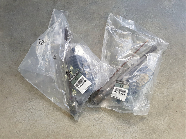

My driveshaft has been ordered. Got a genuine one from Renault but only for the drivers side as Renault no longer sell the passenger side 😧 We will establish this closer to the time of fitting. With this in mind, i want to do a suspension refresh. New genuine track rods have been ordered along with some Febi track rod ends. Im going to order some Febi top mounts and possibly some coilover covers this week also and hopefully fit them all this weekend.

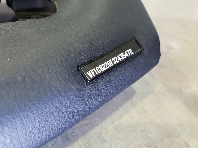

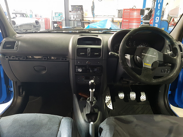

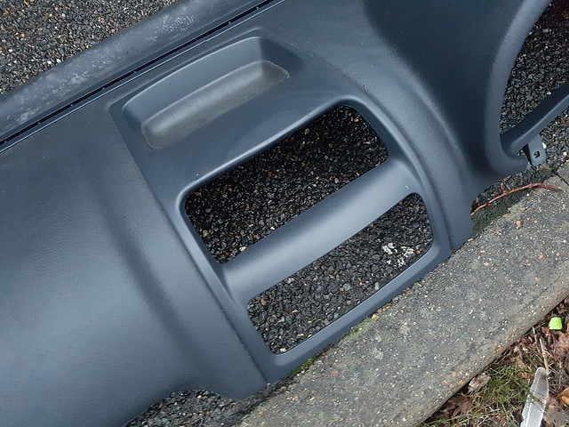

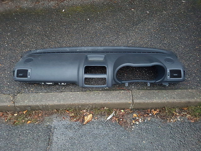

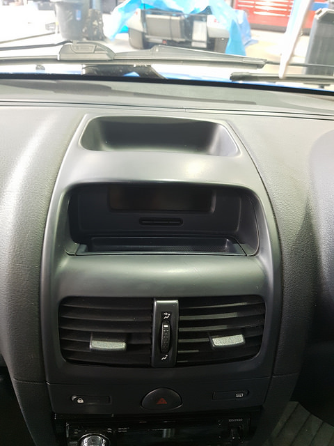

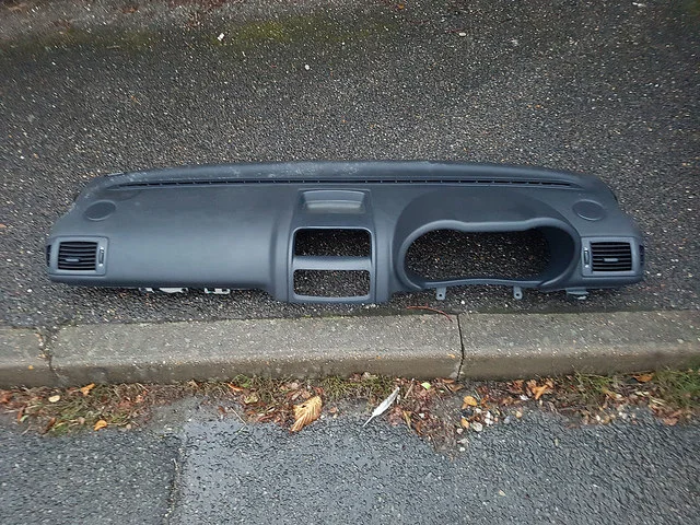

While i was at Alex's picking up the brakes, he had a DCI that he was breaking. I spotted the dash top which was in great condition, barring a bit of mould so i nabbed this up. I've been after one for ages as mine had gone all sticky and these dont have the soft touch film to them. It also matches my recently changed non sport hazard panel.
All cleaned up, vin number swapped, and all fitted.

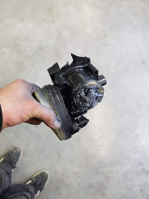

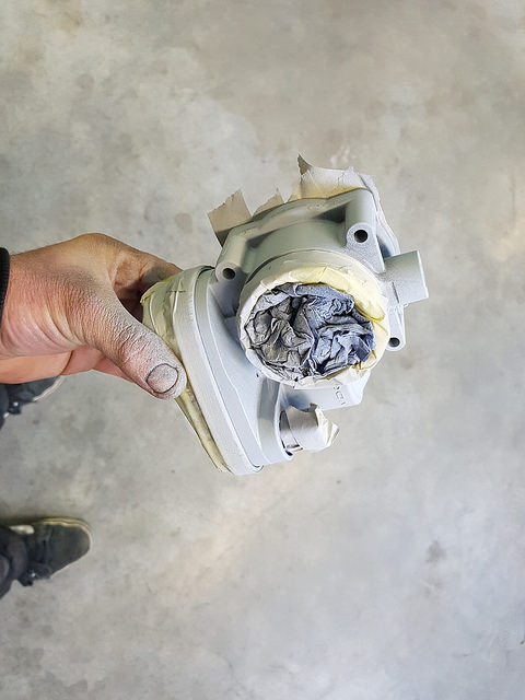

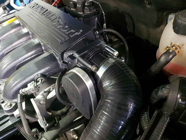

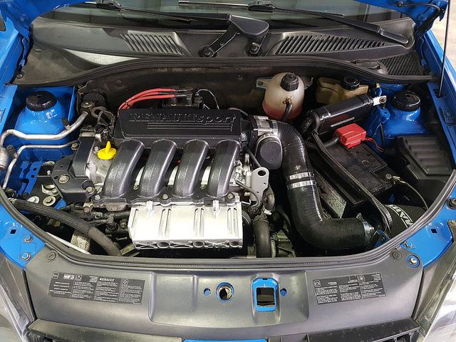

Once that was all done, i had some leftover paint so i thought i'd do my fuel rail guard which ive meaning to do for a while. I also decided to paint the throttle body too. The rail guard was sandblasted first, the TB wasn't, but took a brillo pad to it instead. Both was then etch primered, painted, lacquered and refitted.

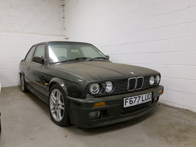

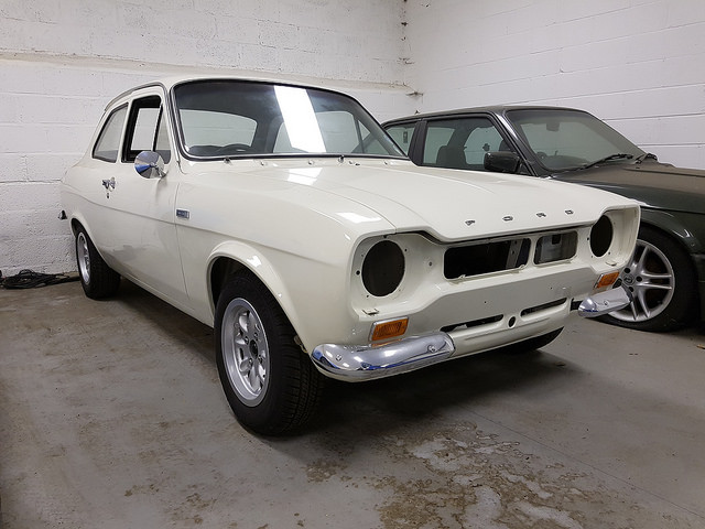

Did some work on a car in storage recently so why not get the RB in for a few snaps!

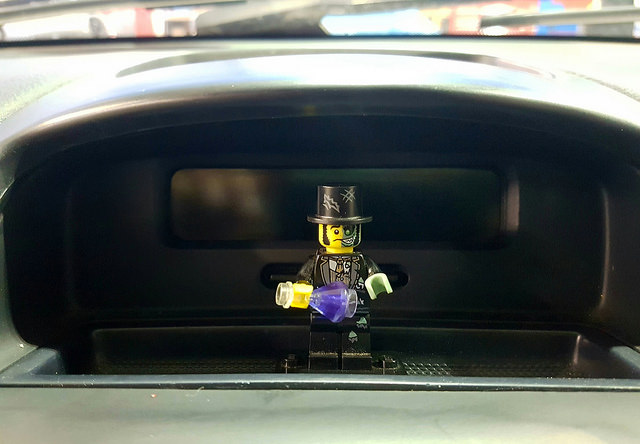

Also with the new dash in it means he's back...... Its Dr Jekyll! :smile: I didnt want to put him in on a sticky dash so i was waiting for a better dash to be fitted.

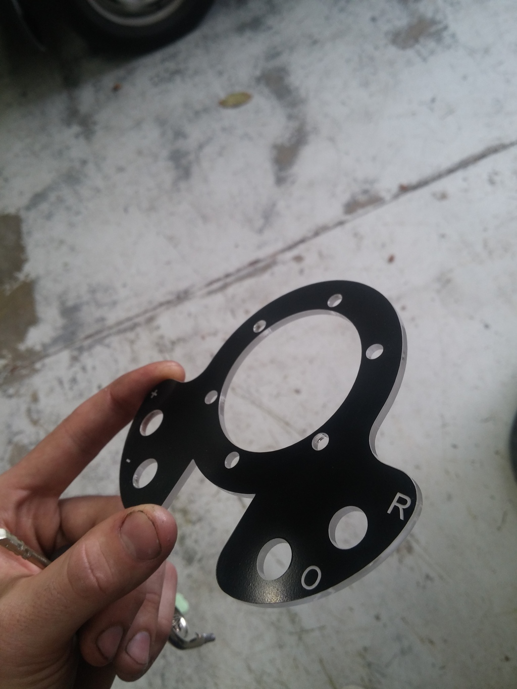

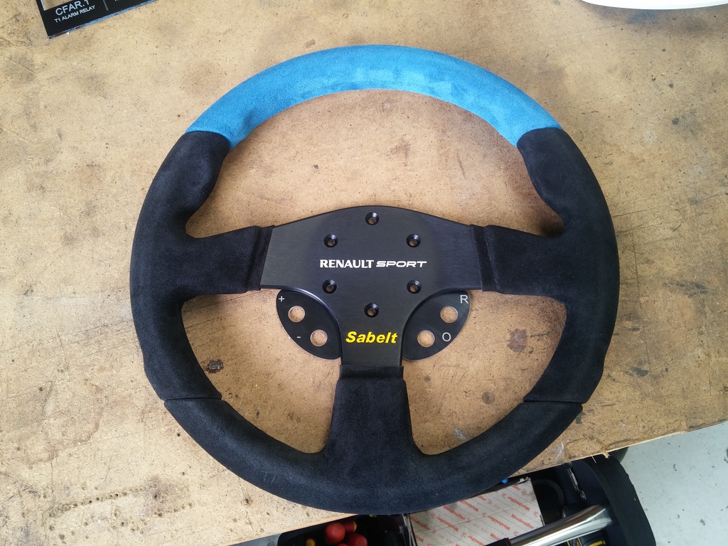

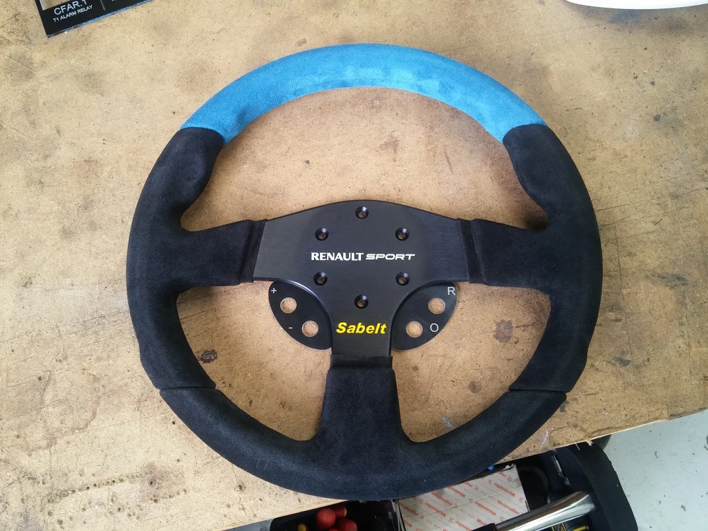

Im in talks/have ordered a cruise control bracket made. Once its made i'll pay and then get it sent to me. This fits around the Sablet wheel. I have ordered a all black 4 button one as i have a ph1 stalk with horn.
As you can see it fits nicely around the Sabelt. Im also in talks with snappy to get my Sabelt retrimmed. I love the wheel and wanted to do it to my old ph1 when i had one fitted. Now that they have been discontinued, it'll make this more special i think. Im going for blue alcantara top and black perforated leather all round :smile:

Great updates yet again, love that lego man Dr Jekyll that's brilliant 😂:up:
The little Renault Sport decal on the clocks is very cool btw and high five for taking the clocks apart, I couldn't/wouldn't want to try it, I remember taking the clocks out of my old Mk5 Fiesta Zetec-S and split them to sort a bulb issue and thought then, never again lol!
I'm so 50/50 about changing the wheel in mine, it's like an old van steering wheel its so big BUT it's been retrimmed by Snappy and looks great..... but I look at yours and others and love the button brackets etc, very neat - I was thinking "4 button!?" but then you mentioned the PH1 stalk :up:

Thank you. I did remove the clocks on my old BG when i ftted carbon ones so its not a hard job and one that i was comfortable with this time round. There is also a guide on here if you ever decide you want to do it and its only a 20mins job.
If i kept my original wheel then id defiantly get it retrimmed but a smaller wheel feels a lot better. Once its retrimmed and have the new bracket on, itll be perfect.

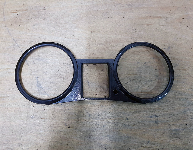

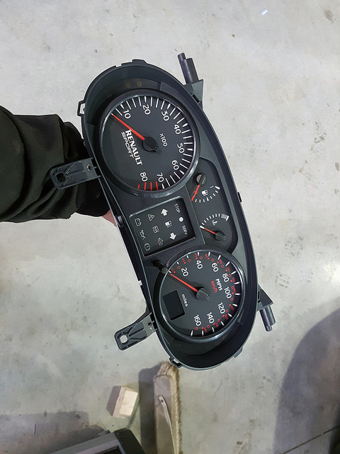

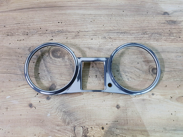

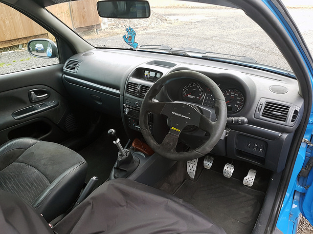

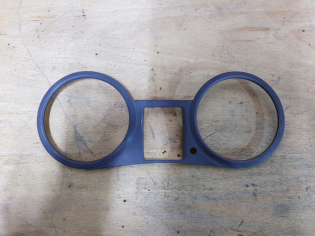

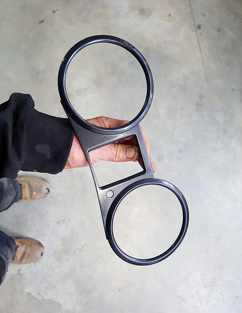

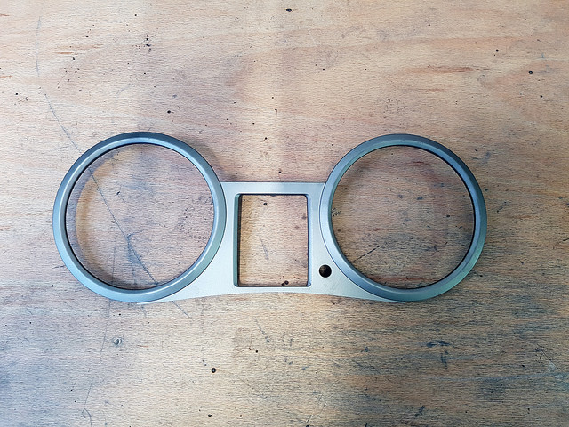

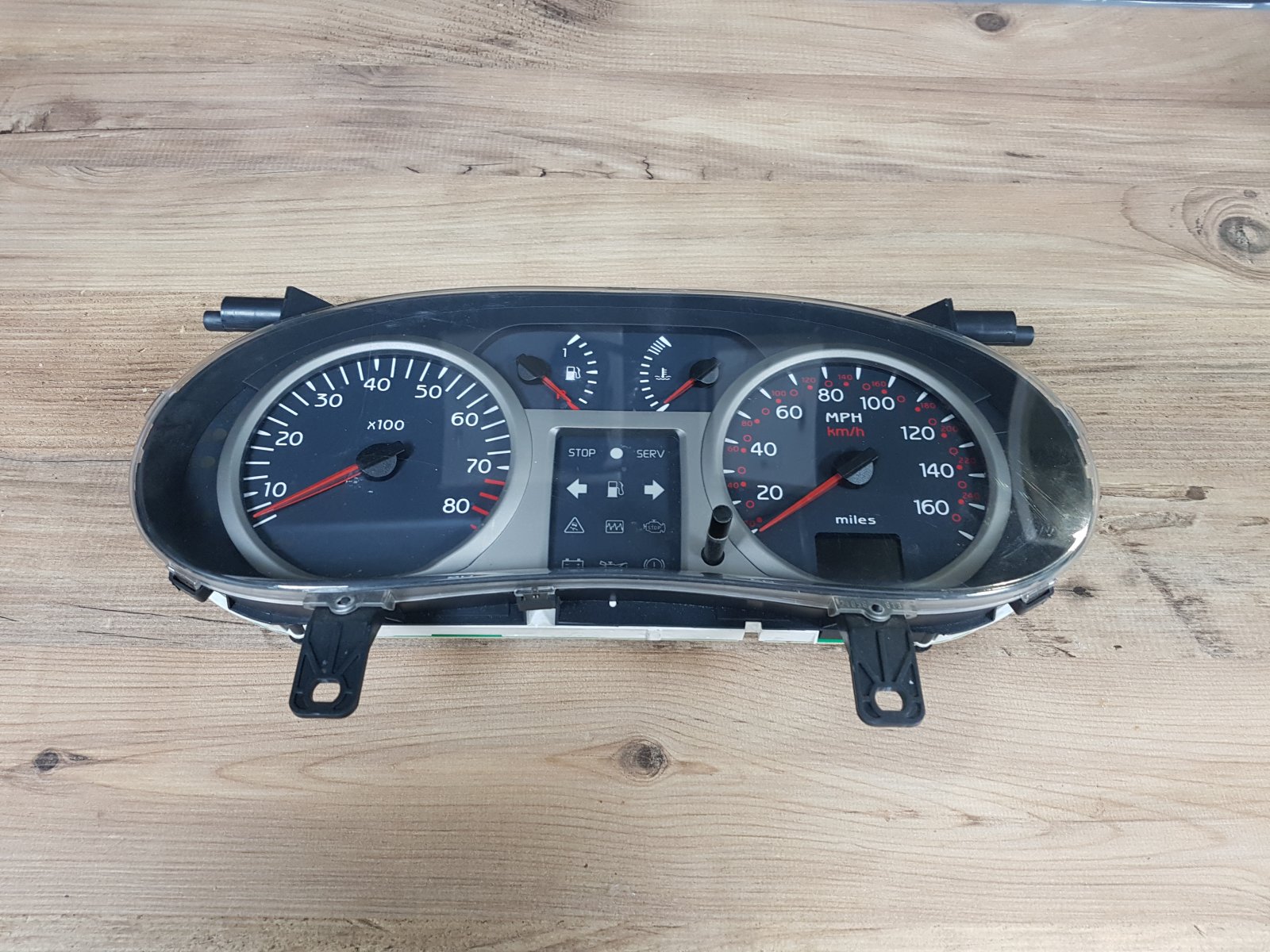

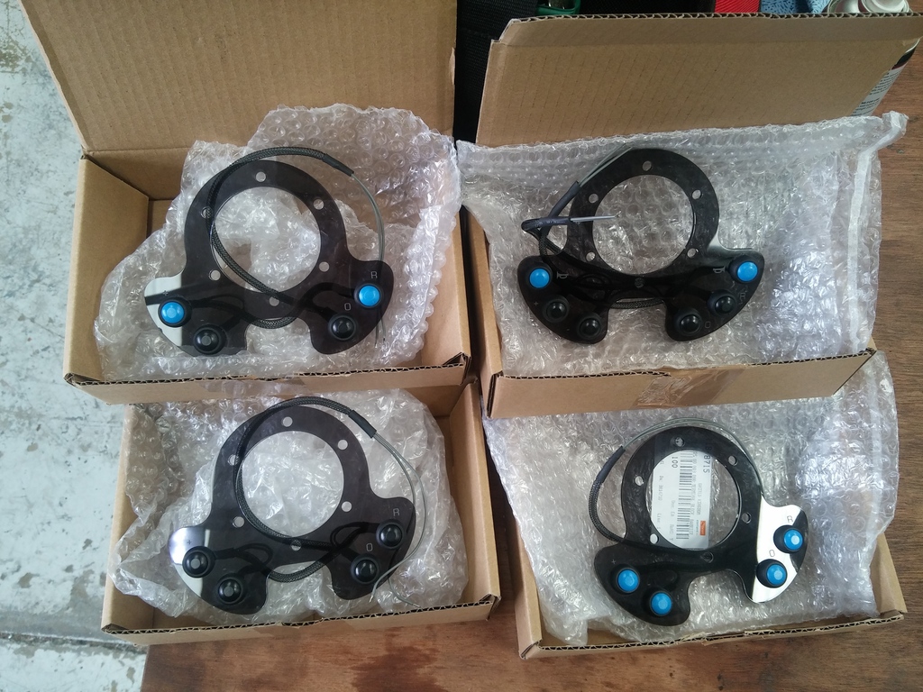

So as the new clocks were here, i decided to stay afterwork to paint them.
Bezel removed, rubbed down, etched, painted and lacquered. It did come out a bit peely but i left it over night to fully harden before i wet and dried it.

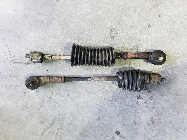

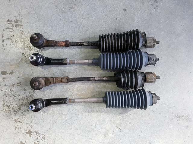

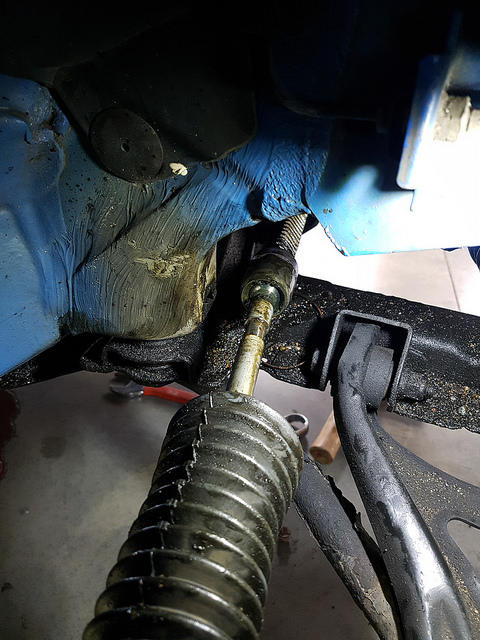

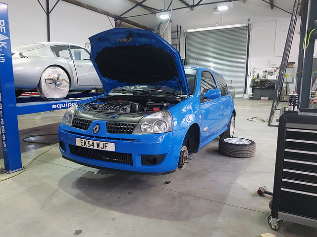

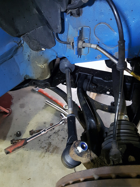

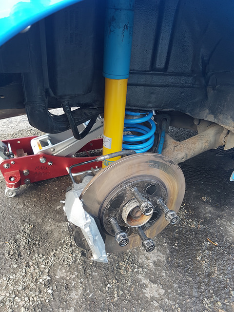

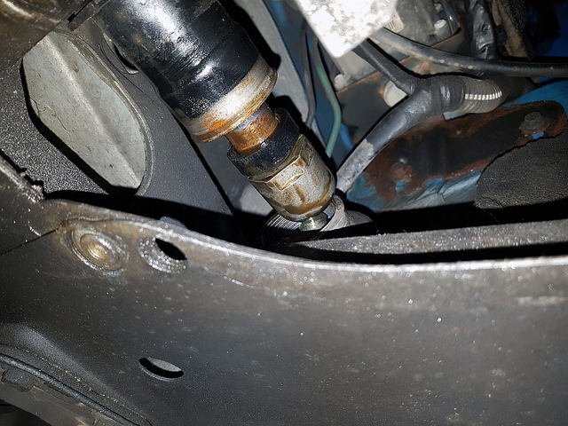

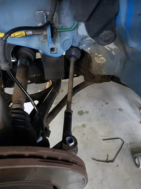

As my bossed asked if i would deliver a customers car on saturday, i decided to change my days off and come into work today to work on the car. Started as i normally would time wise.

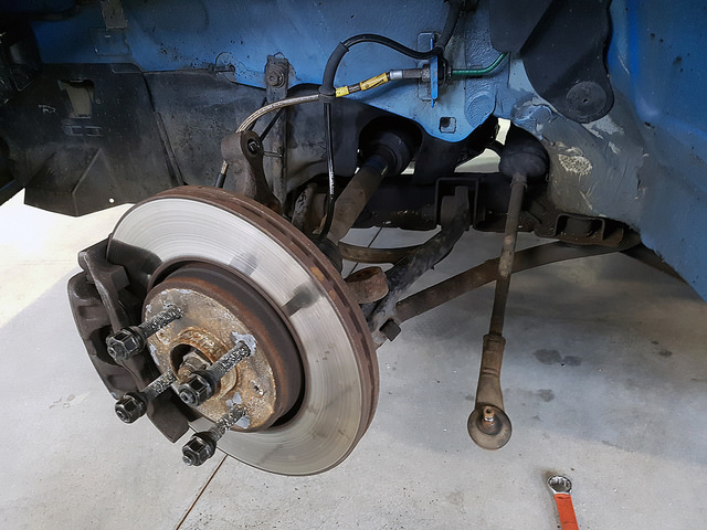

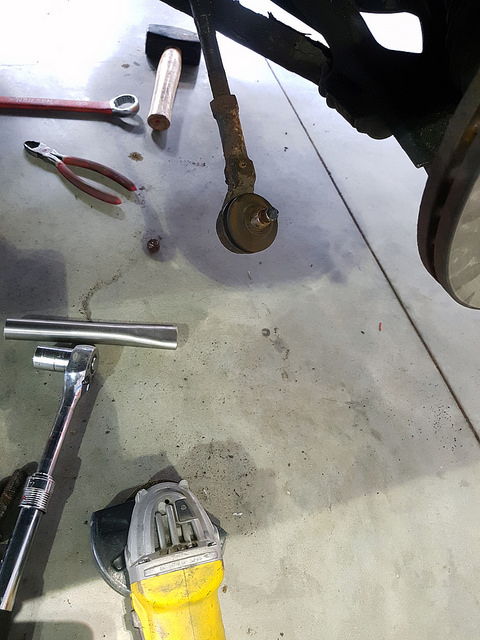

Near side track rod end undone
Offside track rod end removed, with the help of a grinder!

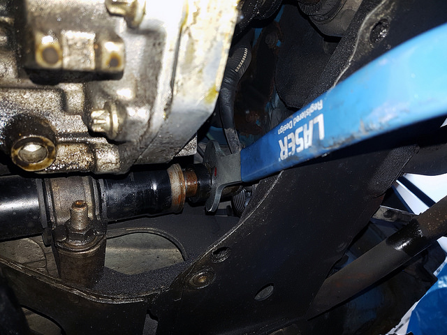

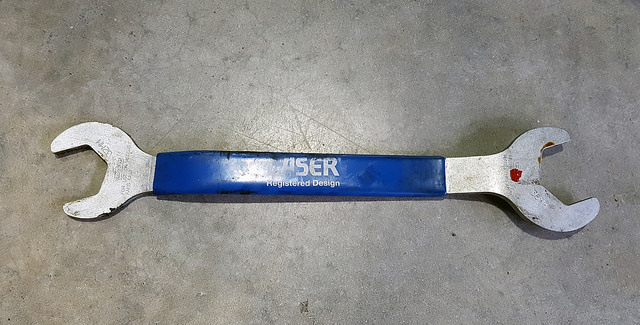

My viscous fan spanner came in handy as there is limited access due to the subframe
Viscous fan spanner by mark abbott, on Flickr

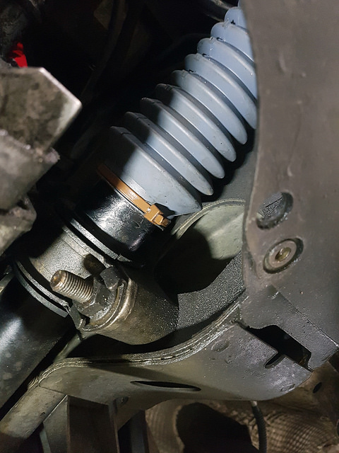

Passenger side came of easy, drivers side was a bit more harder but both finally removed.

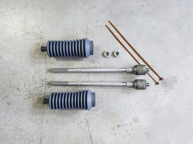

Old track rods inner and outer removed

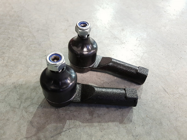

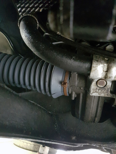

New track rods inner
Fitted the Febi track rod ends to the genuine track rods and compared them to the old ones to get a approx set length.
All fitted. The drivers side rubber was a pain to get onto the rack itself but i finally got there.

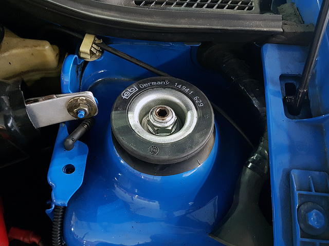

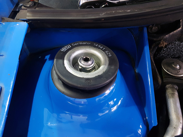

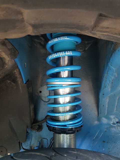

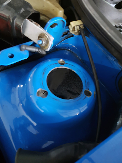

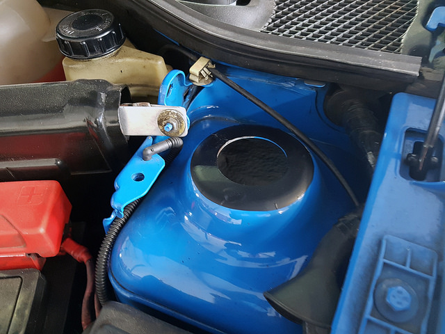

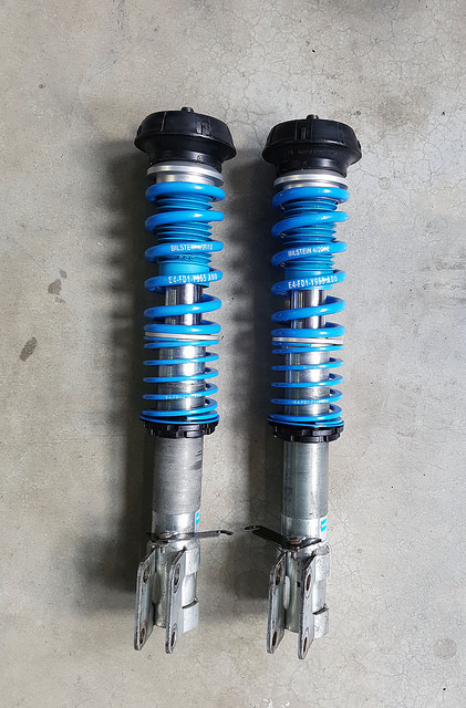

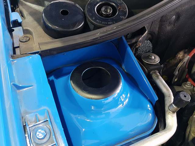

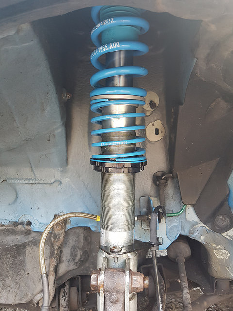

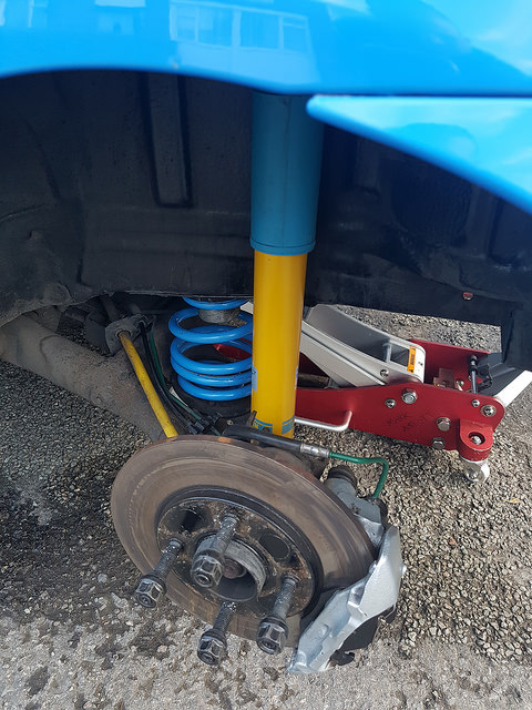

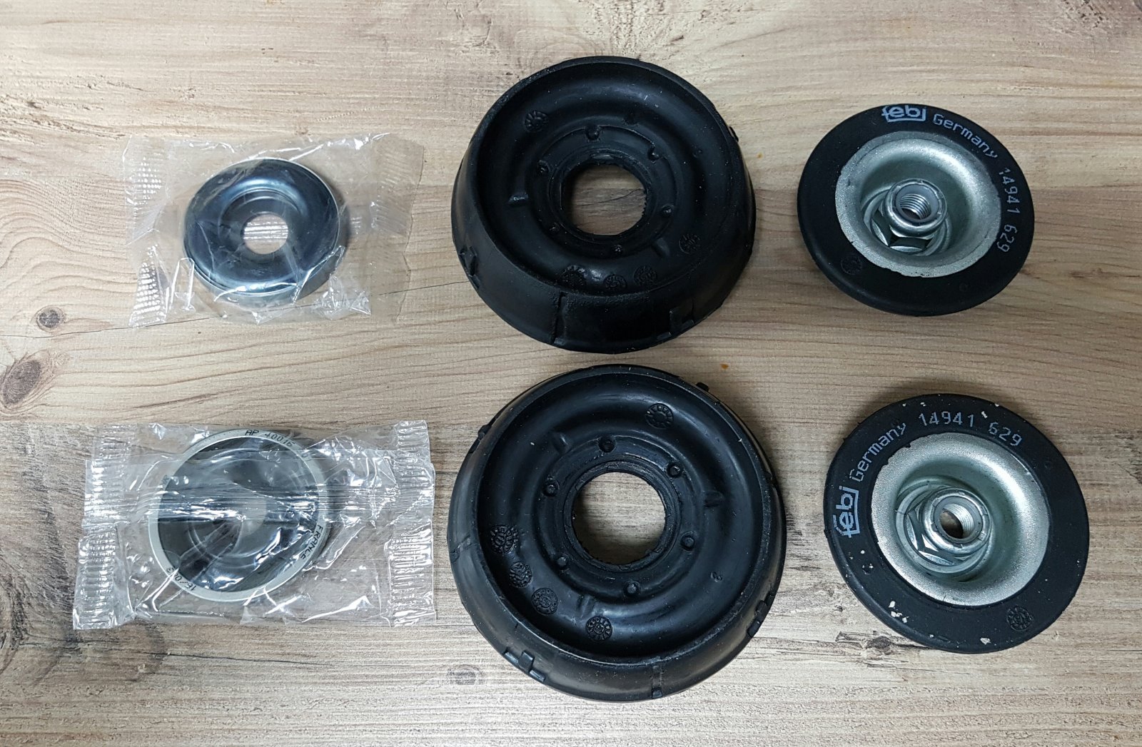

Cleaned up the Bilsteins and fitted the Febi top mounts

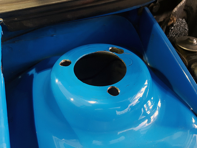

While the coilovers were off i thought i'd try and sticker over the old solid top mount holes. Its far from neat but was more of a trial. I'll probably remove it and find an alternative idea.
Suspension refresh complete
That done, i wet and dried the clock bezel, T-cut and polished it, and refitted it. I need to alter the fuel needle but will do that another day.
Interior with painted bits :smile:
They look dark in some lights and brighter in others.
Need to get the car aligned now, but instantly it feels tighter. Doesn't knock either so all is good :smile:

Those clocks look amazing, what colour is that? You might have said but I got lost in the pictures ;) White alloys just suits RB so much, keep the sunstrip looks good!
LeeRS
Have got a metallic pewter. or a slate grey.
I will send you samples of both on monday buddy.
Edit: the pewter looks like the colour strip on the top of that can.

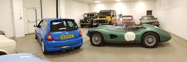

  Clio 182
Love the attention you've put into this - baring in mind the mileage and age she looks in great condition.
How do you rate the Bilstein dampers now that you've had them for a while?

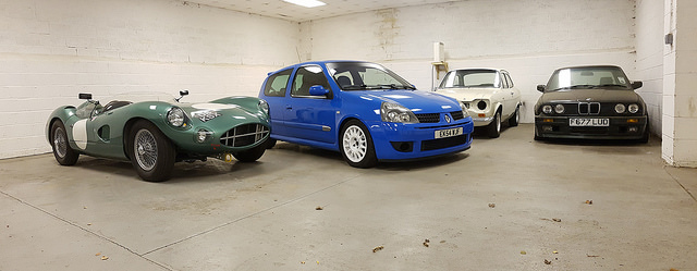

Also where do you work? Looks like some lovely machinery around!
