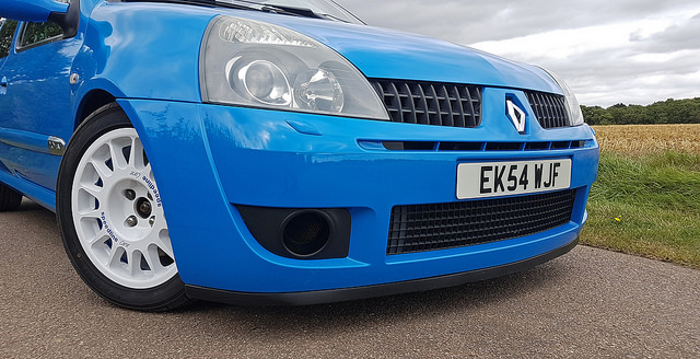

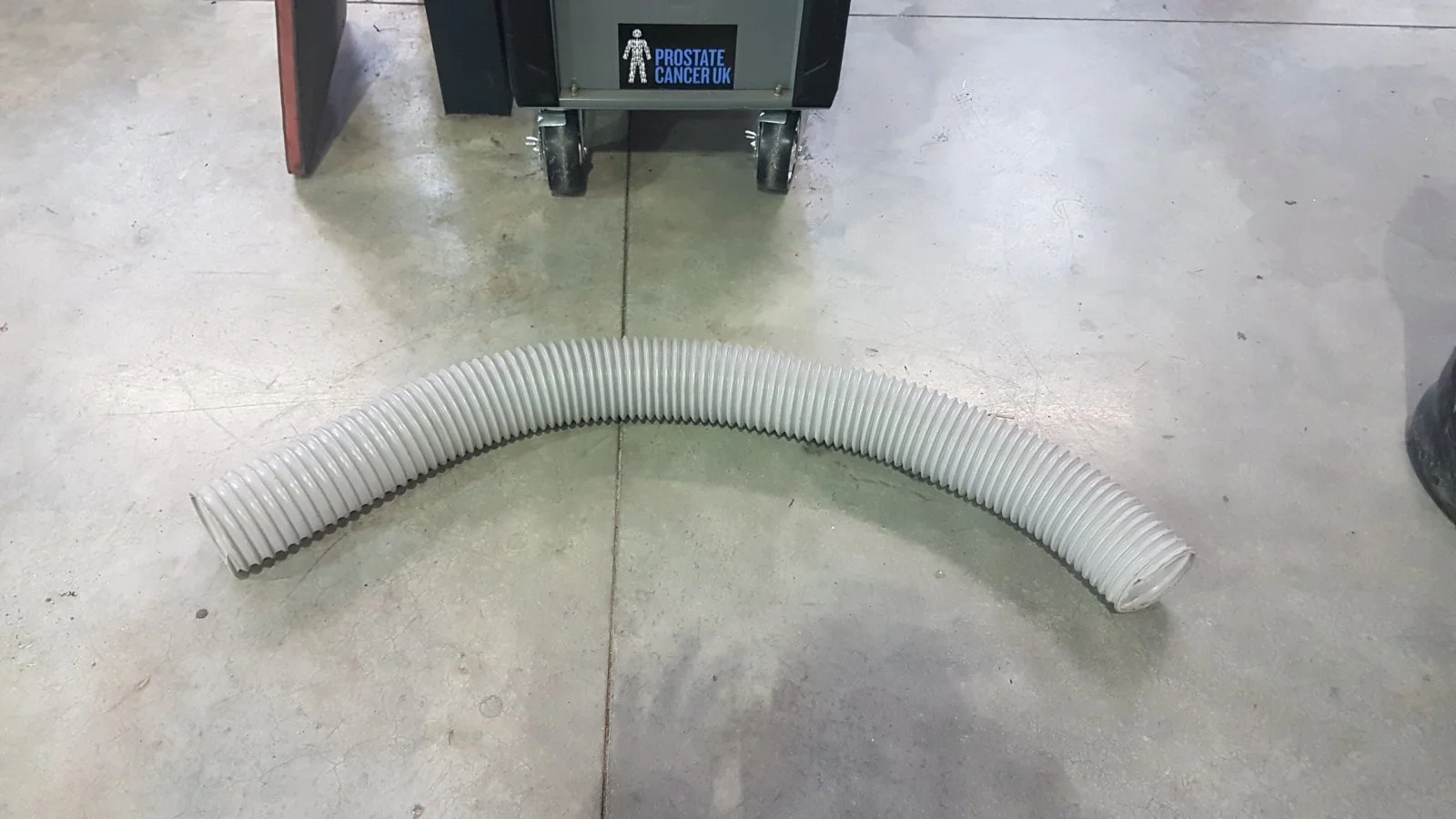

What ducting did you go for for the brake ducts? I need to feed some into mine now and trying to fabricate something so it properly points to the brakes.
Jekyll

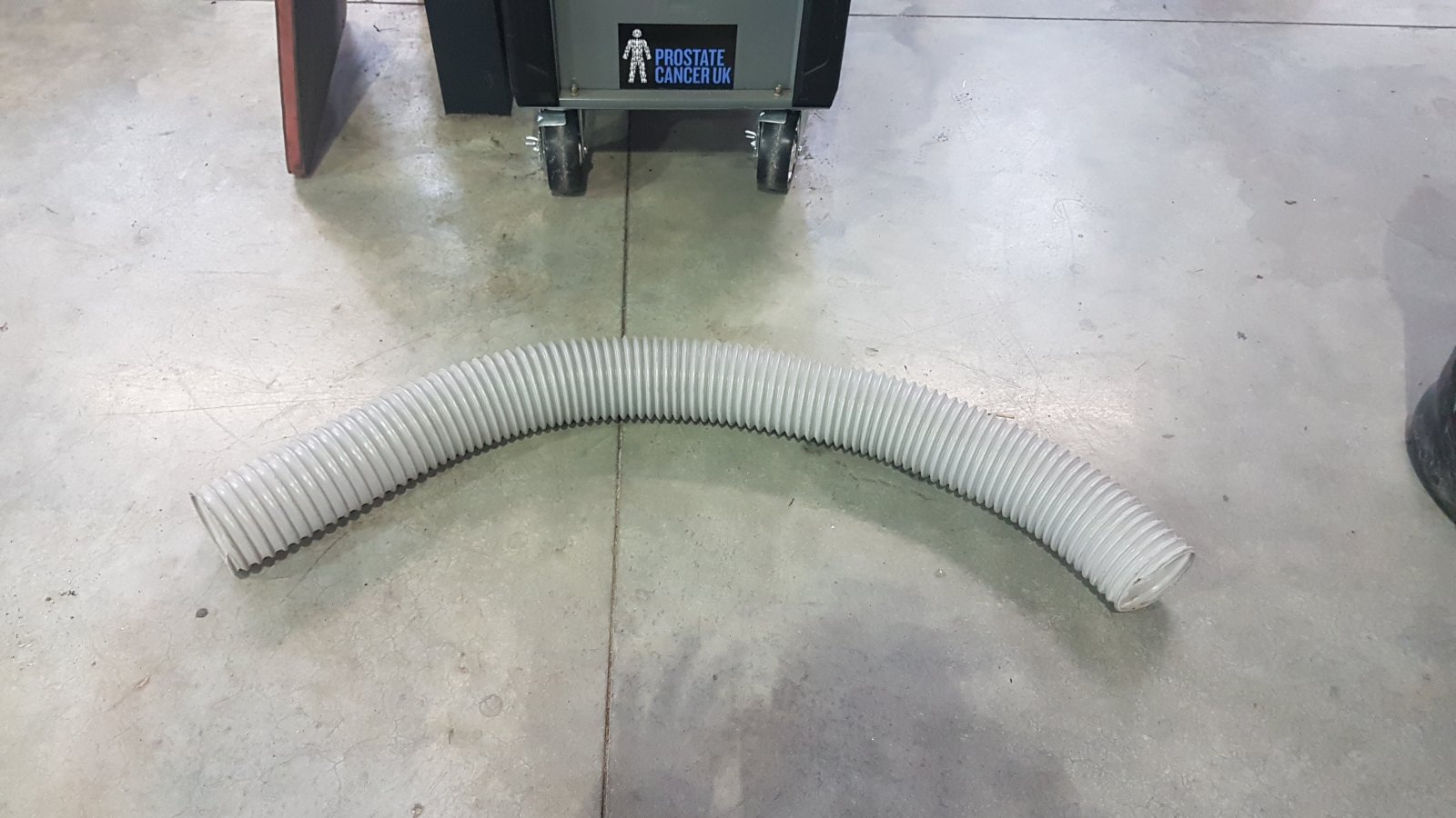

I haven't done the ducting yet Dan. I have some thick flexible pipe at work which looks like extraction pipe. It'll work fine but it's grey so I'm unsure it'll look good.
I'll take a pic of what it is anyway.
I might make a curved deflector plate out of aluminium and rivet it to the outside of the of the ducts so it faces towards the inner wall, if that makes sense?

Bare in mind I'm using a similar bass port to Mark bud. I went for some of this to use as my ducting.
http://www.ebay.co.uk/itm/370782118423
Hopefully it should do the job!

@Dr Jekyll are the brake ducts a tight fit? Found some 95mm ones cheaper but worried they wont fit without copious amounts of adhesive!
Jekyll
They are a tight fit yes. I'd recommend taking the surrounds out and sanding down the parts on the outside and then fitting them off the bumper.
95mm will be too loose I'd say, plus this way you know they won't be coming out!

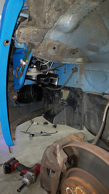

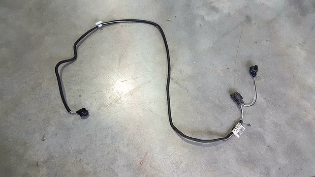

Fog light wires removed as they are no longer needed

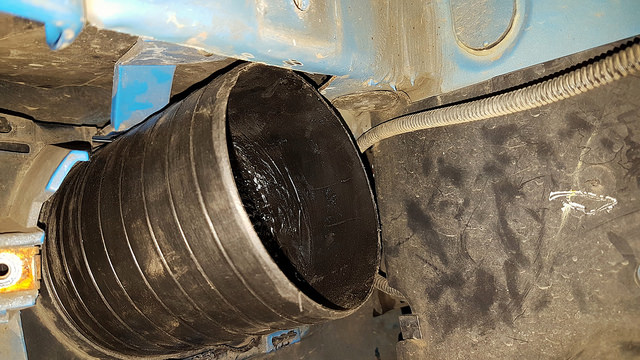

I think i'll need to take more out of the front crossmember if i want to add some air feed or an actual duct

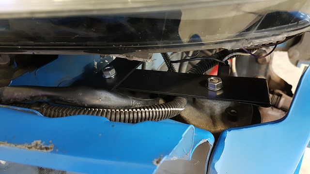

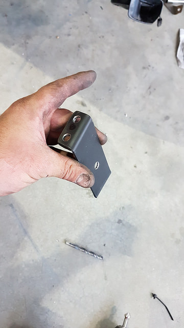

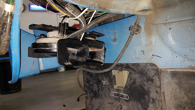

Decided to relocate the horn and make a bracket so its not directly on the chassis
I am going to redo the bracket better/make another one as im not overly happy with this, although it does work perfectly and is out of the way of the bass port.

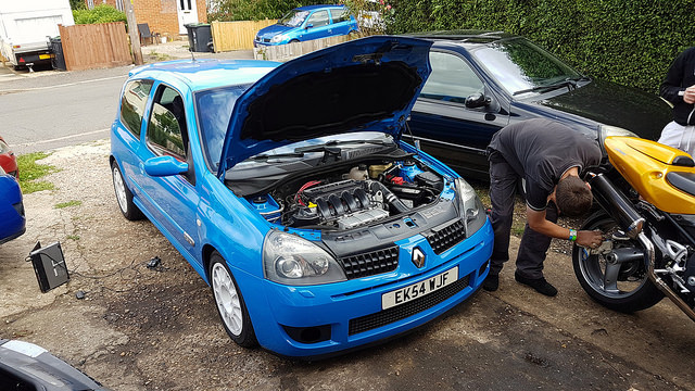

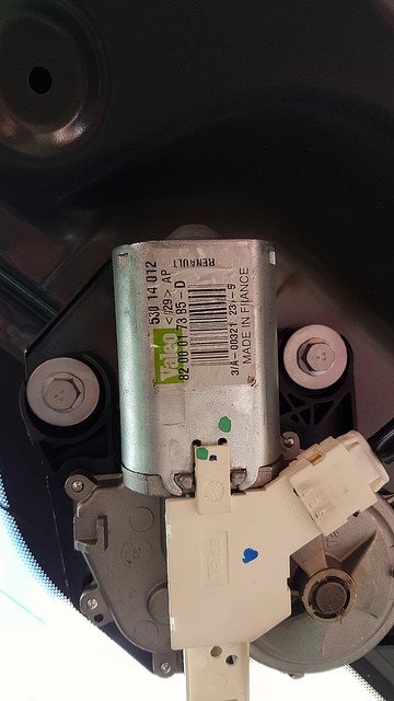

Went to Alex's yesterday (If you've read my previous threads you will know im good friends with Alex and he helps out on my cars loads!) to get him to look at my EML light as it hasn't gone off since ive removed the carbon cannister. He was also doing some work on missus car. Ive been telling her for years that her micra is actually french, to which her response has always been "french cars are s**t, jap cars are well built." Well this is picture proof after she saw the rear wiper motor had RENAULT written on it! 😂:tongueclosed:

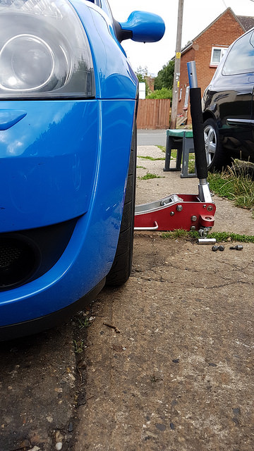

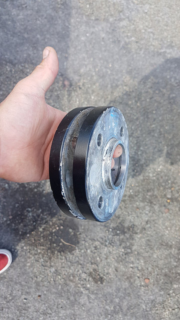

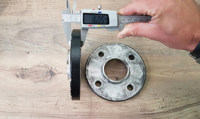

While i was there we got speaking about spacers and alex has a set spare of 16mm spacers...
Trial fitted
Decided i wanted them so i will fit these fully at a later date. Alex looked at the car with hes clip and it turned out after all my efforts that it was the air temp sensor not fully plugged in!
All wiped out so he was cleaning hes bike while i took a picture then took the spacer off
Alex's driveway just before i left

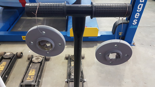

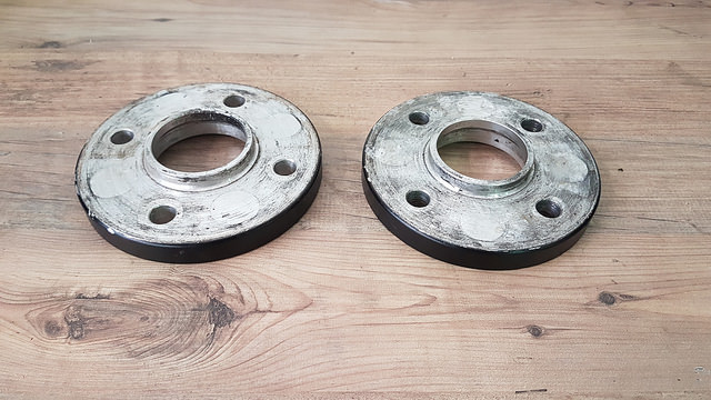

Took the spacers to work as i wanted to clean them up and paint them fully black.

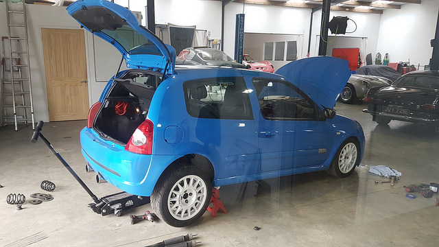

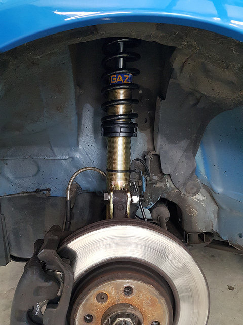

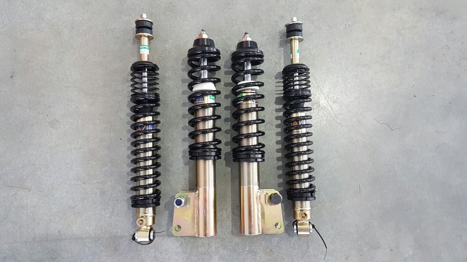

Then the coilovers turned up so i fitted them. Decided to take the day off and have a tinker day instead. Pics to come...
Jekyll

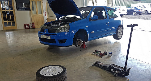

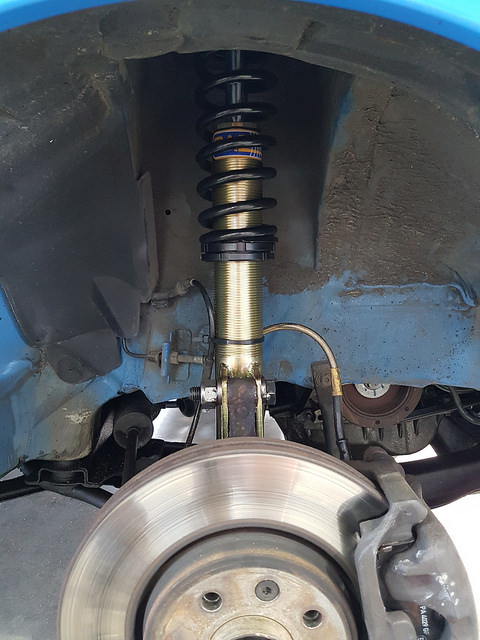

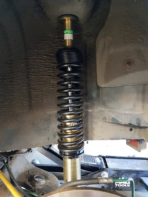

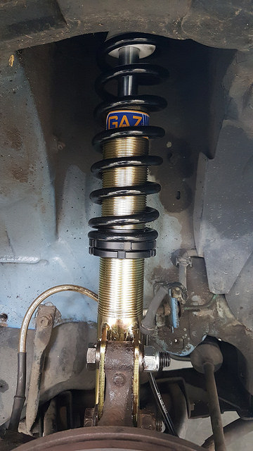

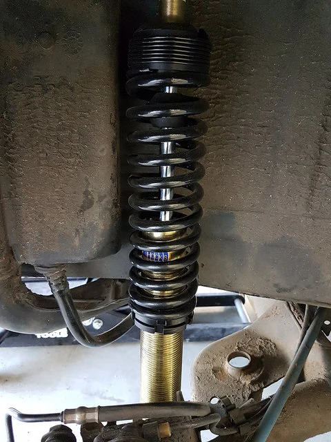

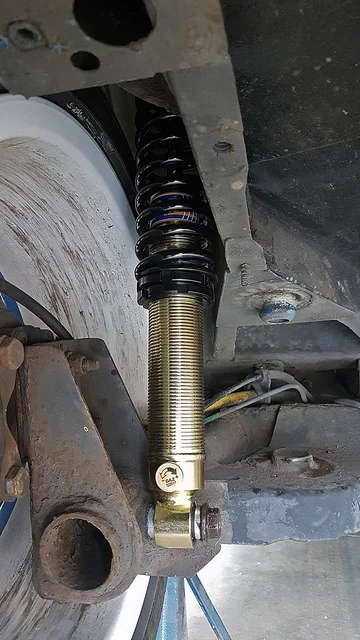

Started fitting the coilovers
Fronts done so stopped off for coffee and toast! Even Beamish had some!

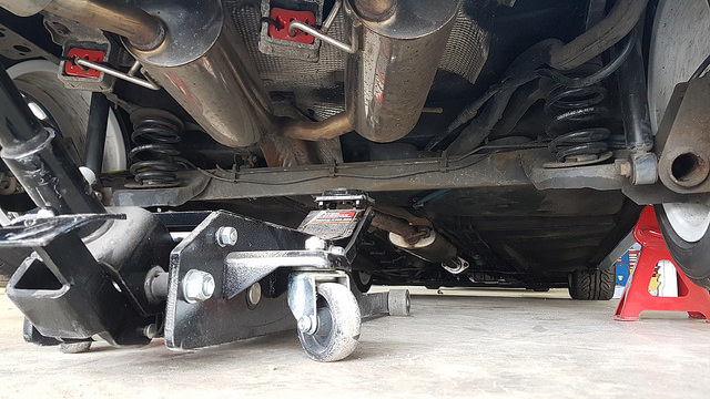

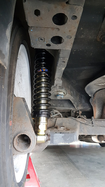

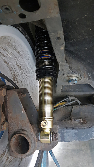

Then onto the rears
Touring car style!! Obviously it needed major adjustment!

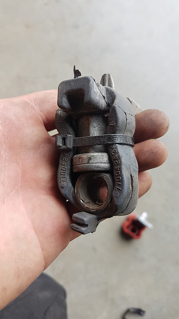

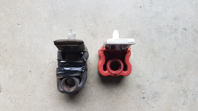

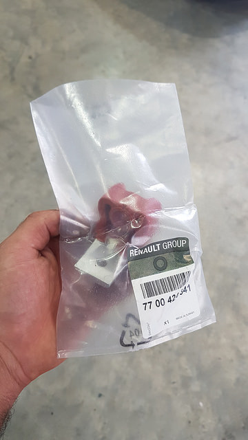

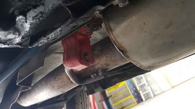

While the rear was up in the air my new genuine center exhaust mount came so i fitted that and removed the "modified" one!
All adjusted and done

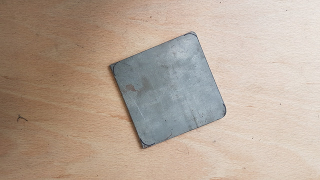

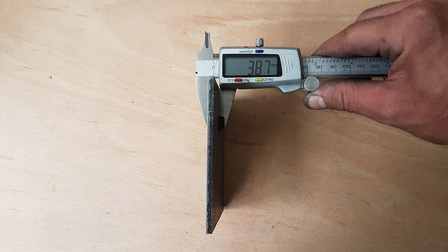

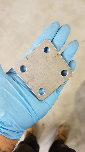

I also have been thinking of getting 5mm spacers for the rear but ive decided to make my own as ive found some 4mm steel at work.
It looks pissed in that pic but its not. Anyway, s'all good here as you can see. Bolt holes line up perfect.

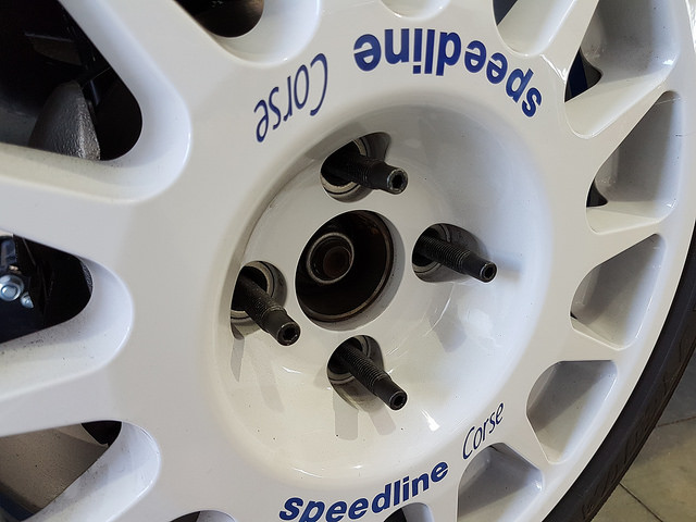

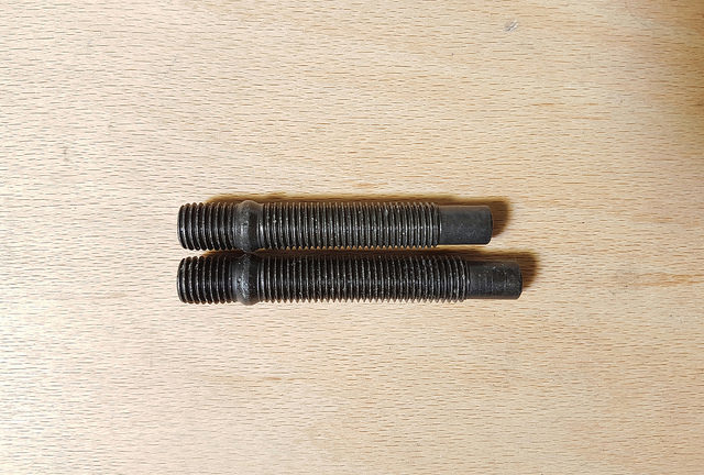

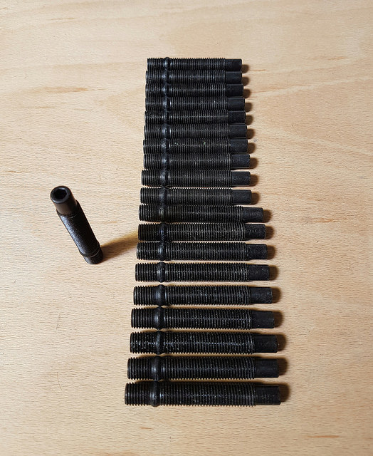

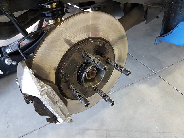

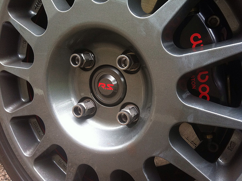

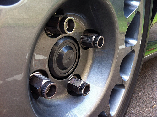

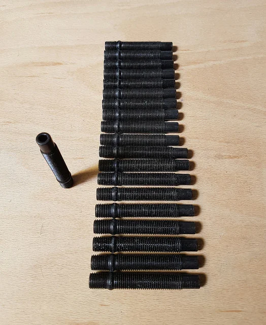

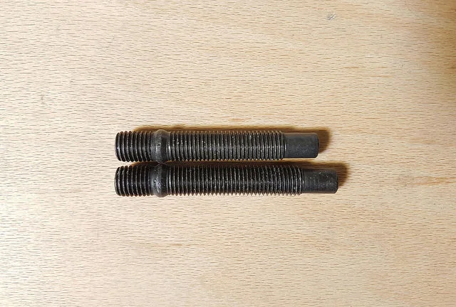

I also bought some new studs for the stud conversion. After some thinking, I've gone with 75mm rears and 82mm fronts. This will compensate the front spacers and the studs should sill have plenty of threads and still look the same after the wheels, front and rear.
They are high tensile 10.9 grade with allen key heads. Will order some nice wheel nuts for them. Probably get the same as my old BG ones as they looked quite smart I thought.

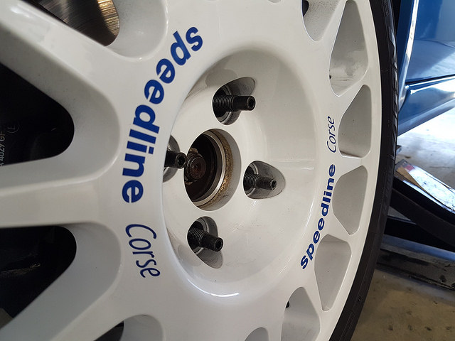

Studs came today! Great service and delivery and i even asked for 2 different sizes and was much cheaper than anywhere else! All high tensile 10.9 grade with allen key ends.

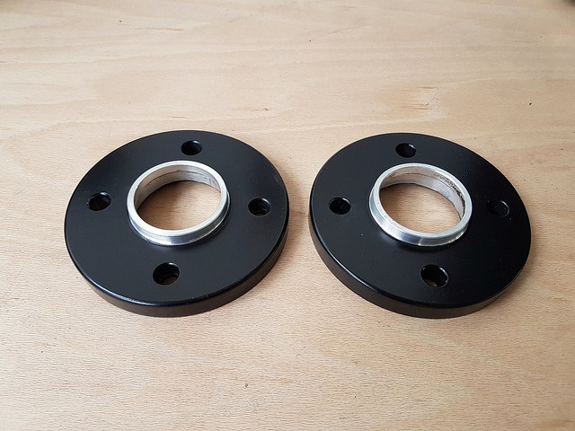

Spacers painted

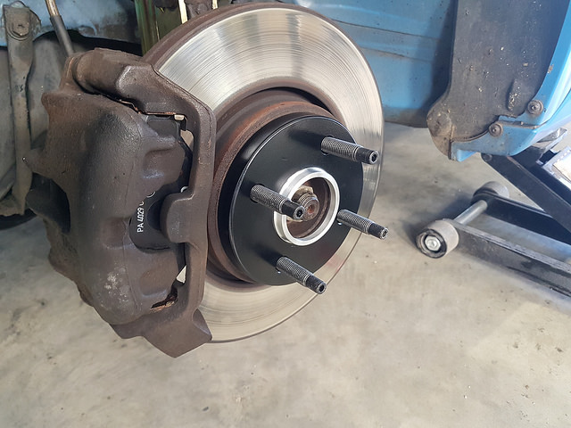

Trial fitted them all. Fronts:
Rears:
The rears "may" be a tad long but the next size down was 68mm which i thought was too small. Once i get some nice wheel nuts/lugs, they'll look fine.

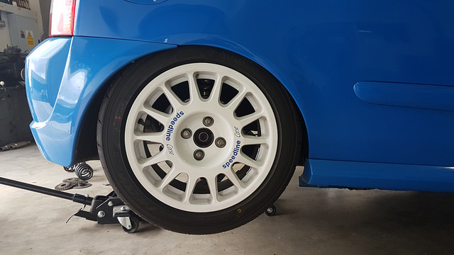

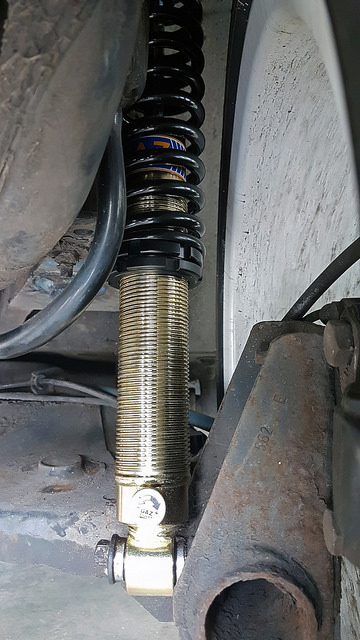

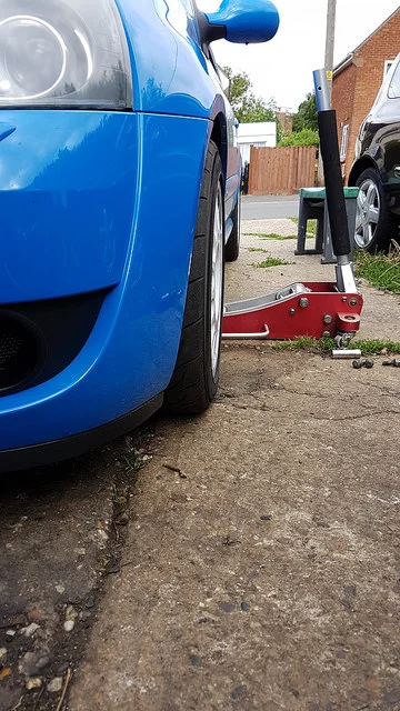

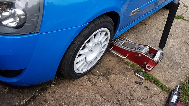

Little more playing with the height all round.
Here's how it currently sits. No rubbing now, but i want to do a few more turns down all round then I'll be happy.
