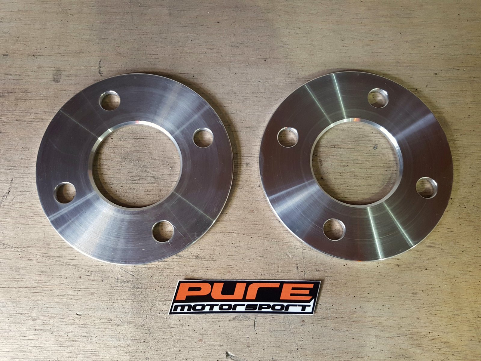

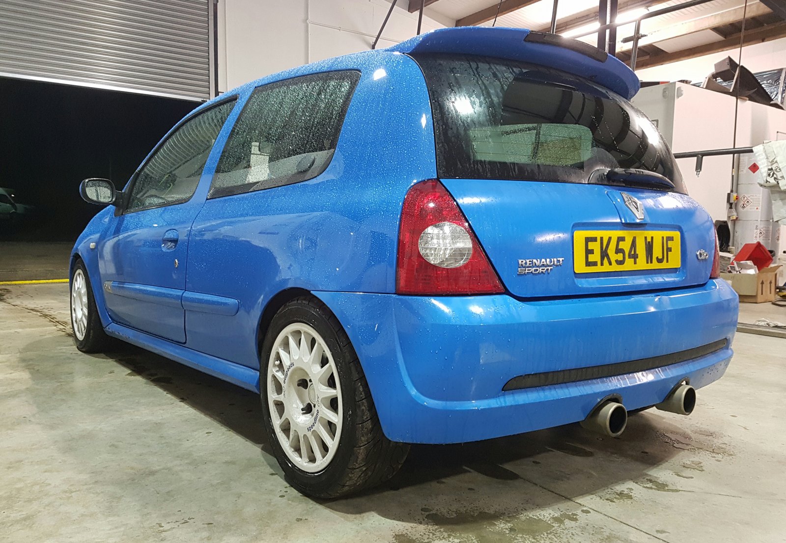

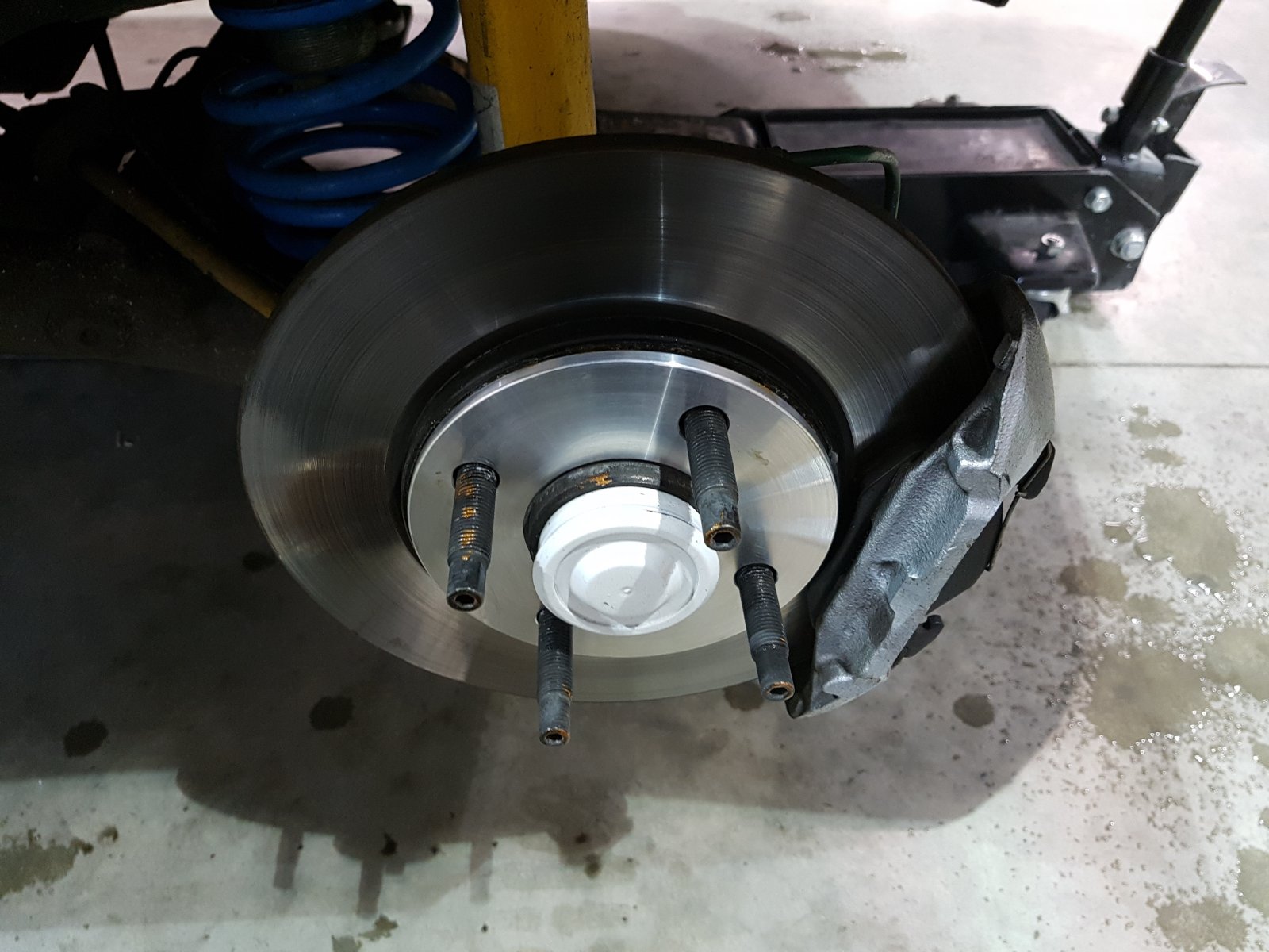

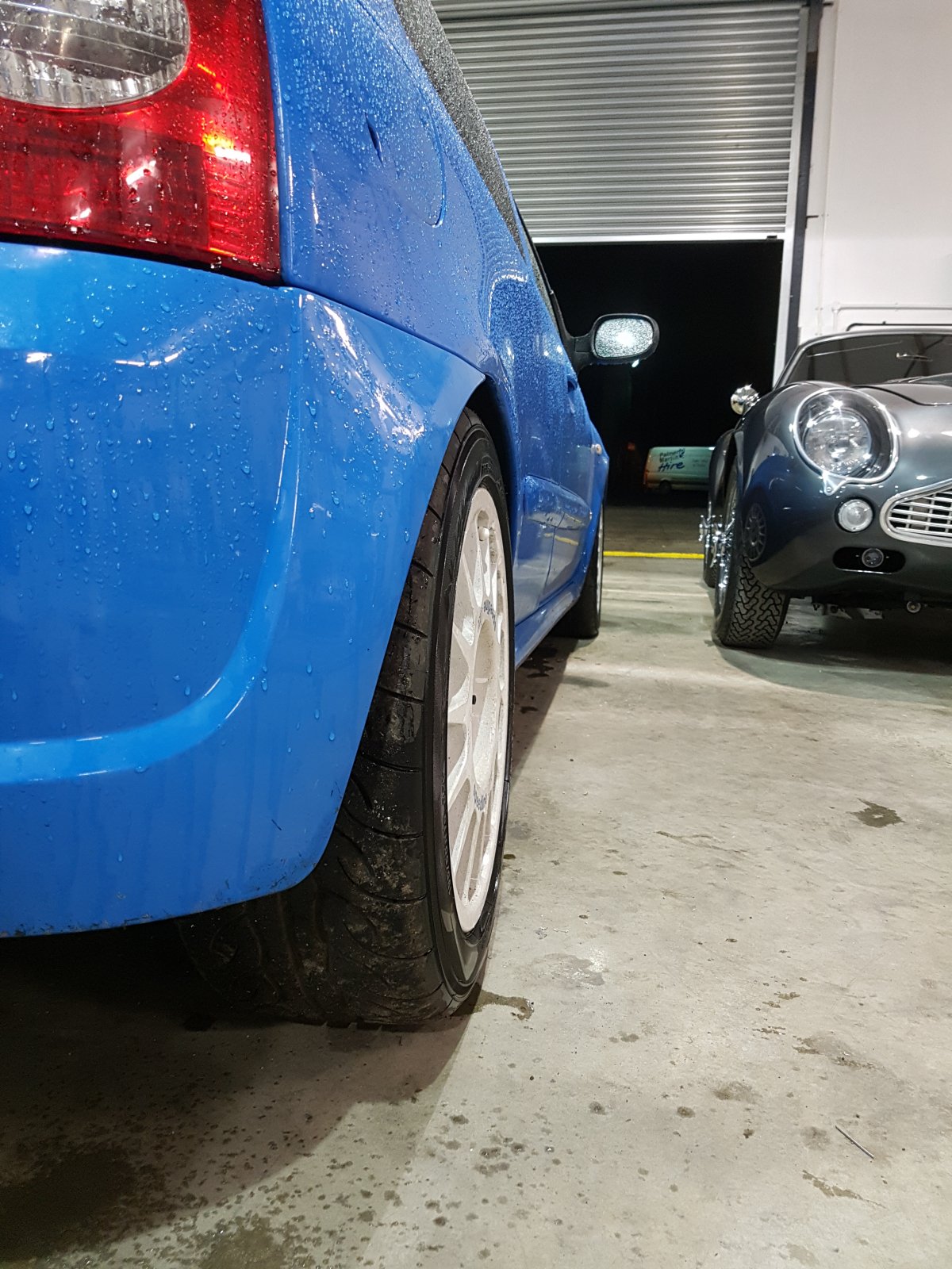

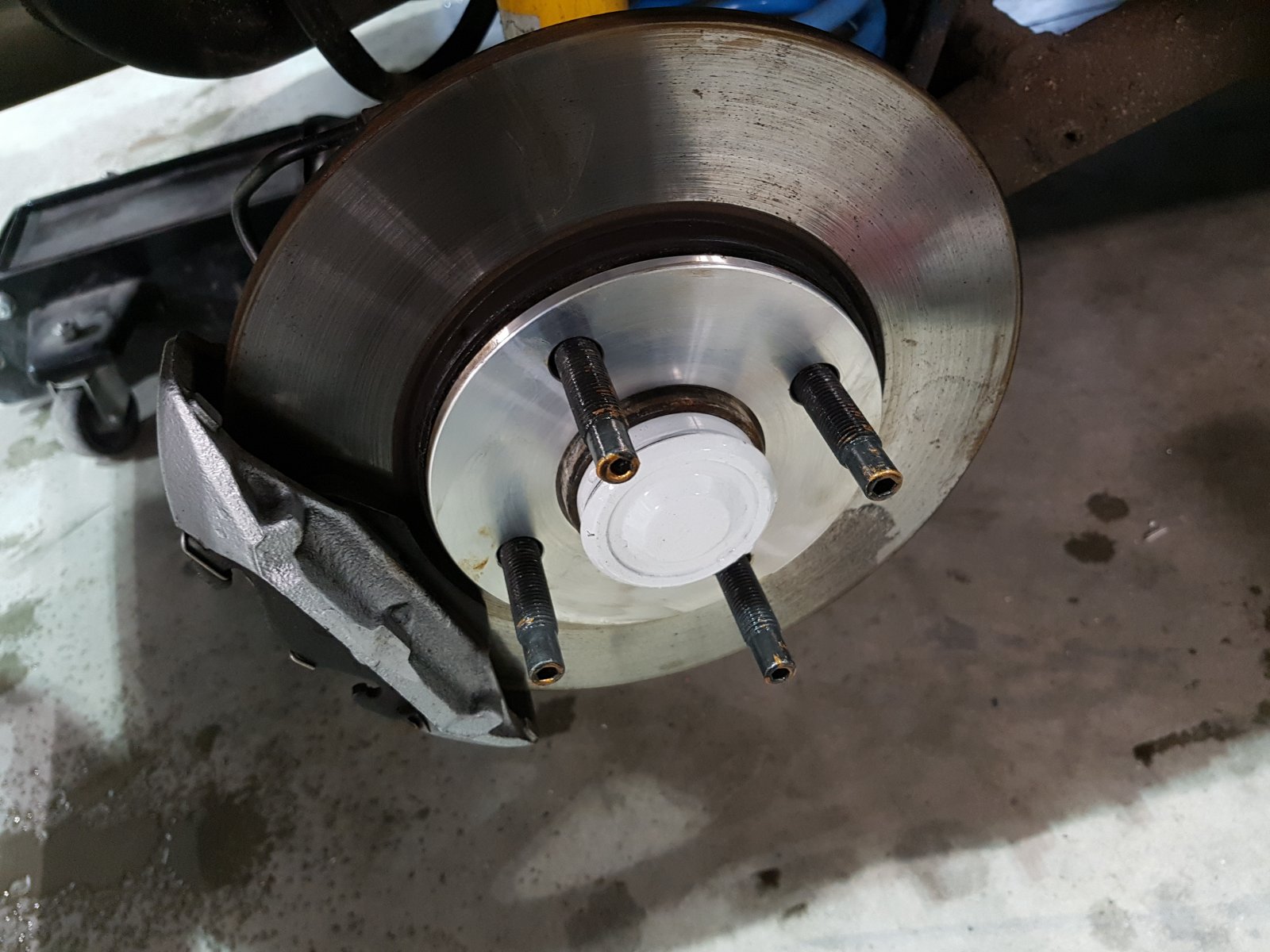

Pure motorsport 5mm rear wheel spacers came today. Only ordered them yesterday so great service there :smile:

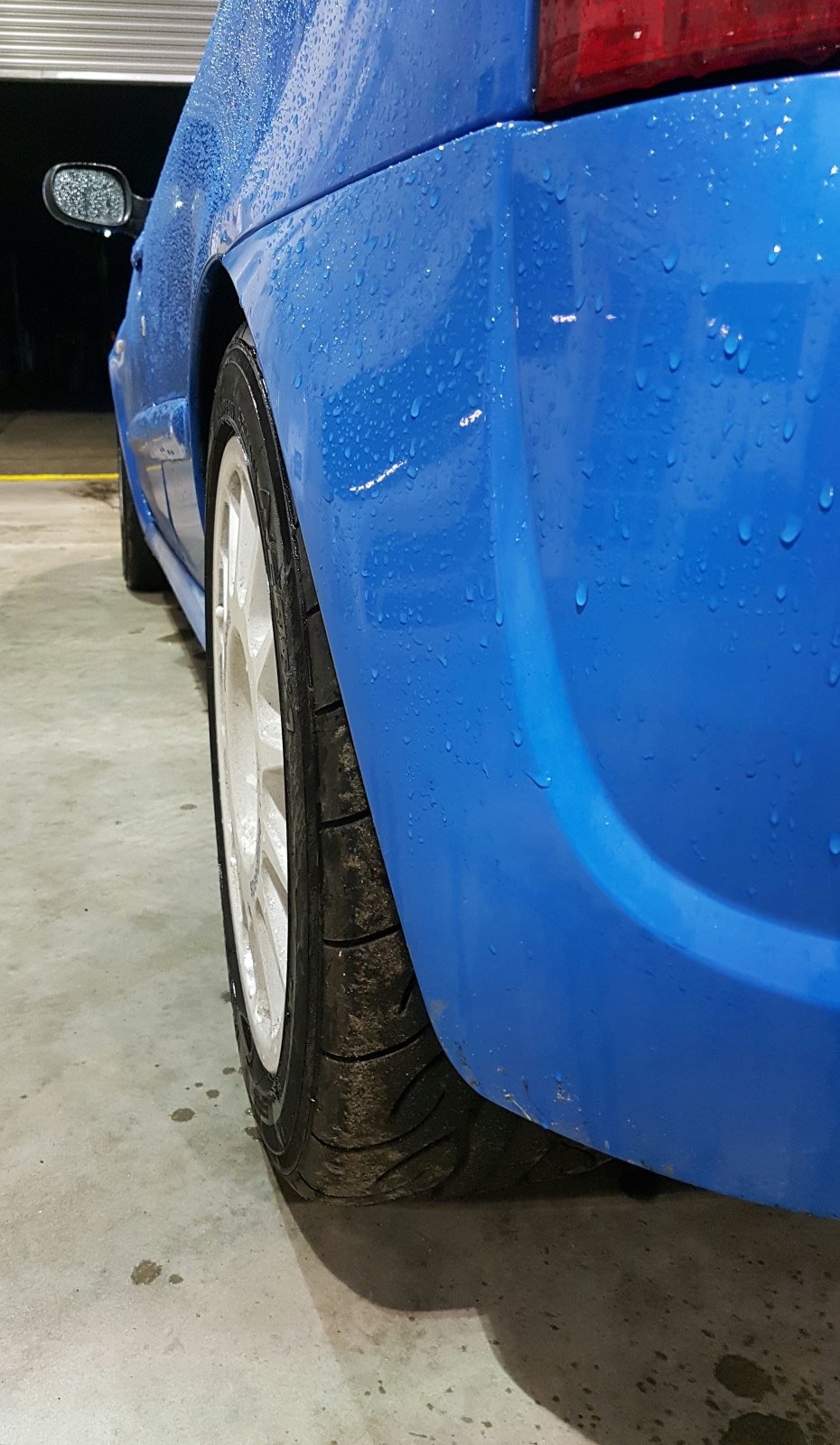

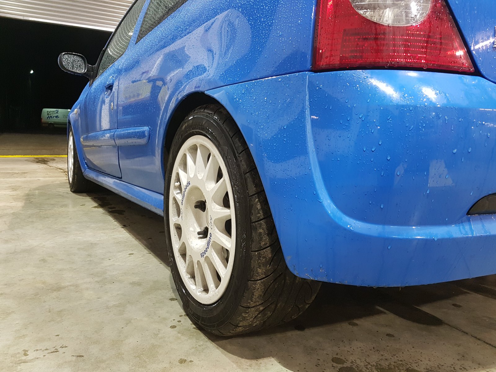

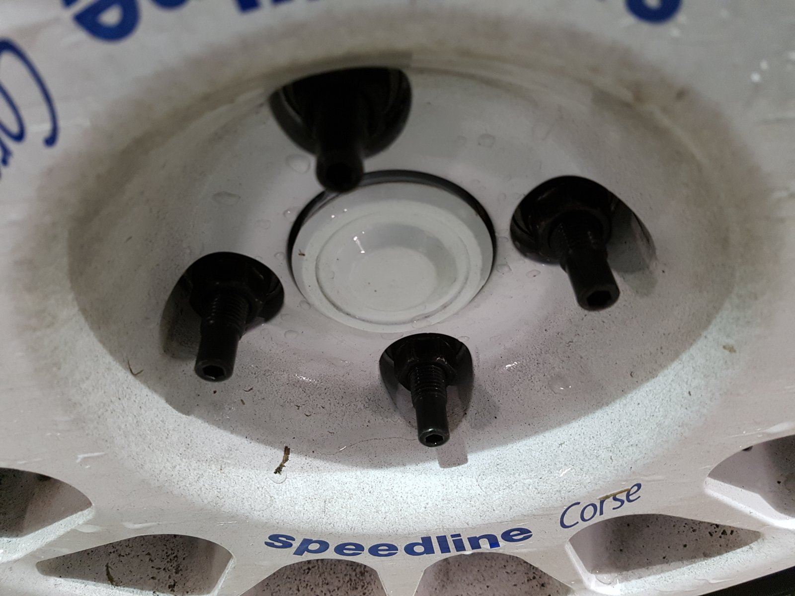

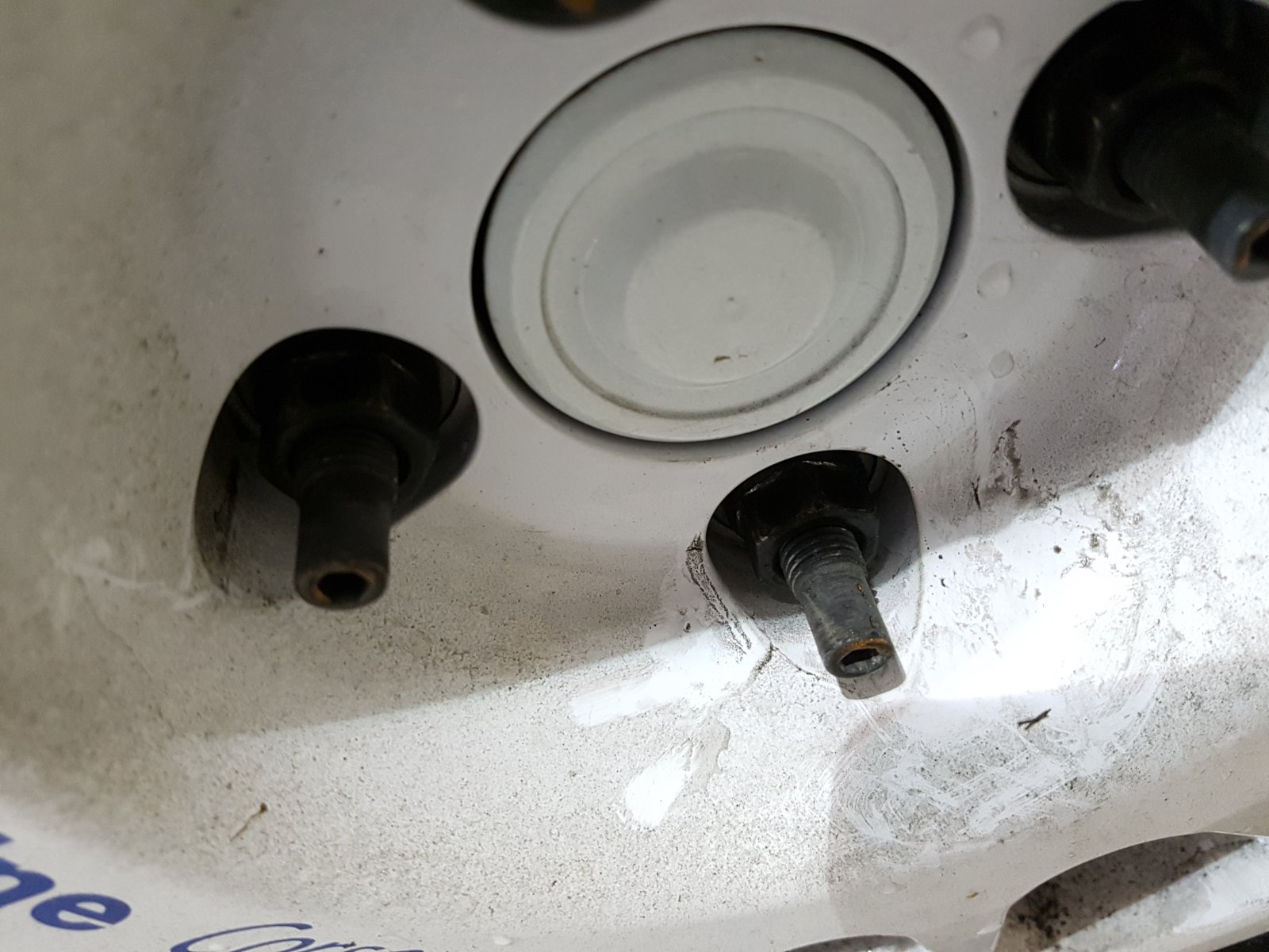

Fitted them tonight. The hub caps are now equal both front and rear, and so are the studs regarding the same amount of thread showing. Result!
Its as far as i can go spacing wise on the rear bit best of all it doesnt rub. All round good purchase!

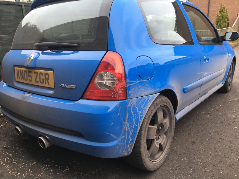

Excuse the dirty RB, its been shite weather and its been used everyday due to being a daily, but i cant be arsed to clean it yet!

Off topic, but spacer related, what did you run on your ph1? Are you just running 5mm on the back of the RB? What are you running on the front of the RB? Thank you in advance :smile:
Jekyll
Up close its filthy!
Spacers wise is this:
RB front: Hubcentric 16mm spacers
RB rear: 5mm rear wheel spacers
RB wheels: Speedline 2118s with ET38
Ph1 front: Bolt to hub hubcentric 20mm spacers.
Ph1 rear: 10mm hub spacers, no camber.
Ph1 wheels: F1s with ET43.

Probably missed it somewhere but how low have you got the coilovers at the back? Still got the adjuster in?

As for the rear, the adjusters are in but are wound all the way down (or up in this case as the platforms are above the rear springs)

I need to get a pic of mine in daylight so you can see what dirty is! Trust me, it shows it if it's bad enough!
Eta, this is from March, it's much much worse ATM
Got to love a dirty car, especially this time of year :smile:

I've currently got my adjusters out as it still sat a little high with them in although I get scrubbing everytime I go over a bump now, especially with someone in the passenger seat.
