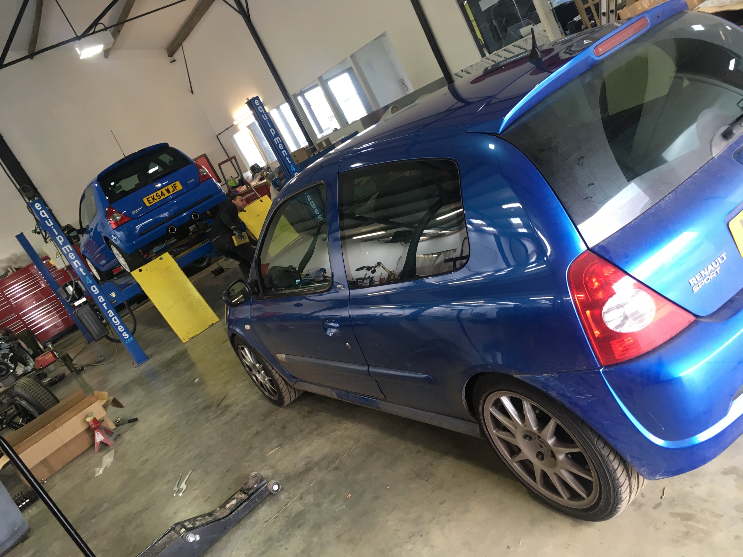

So on friday after work i decided to give it a much needed clean. Guy at work did he's megane too. It was like a little Renault Sport farm car wash!

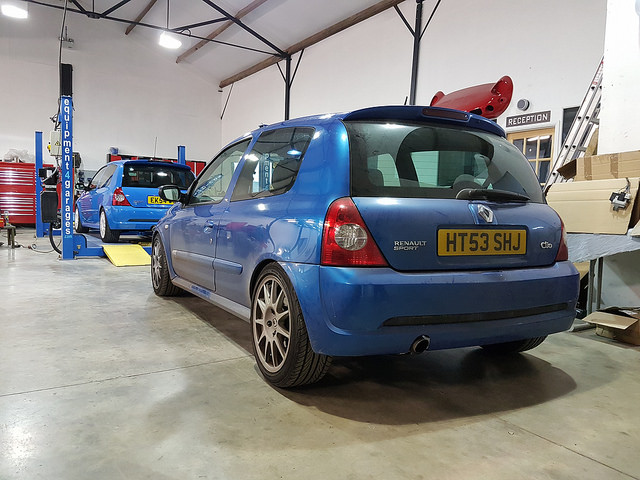

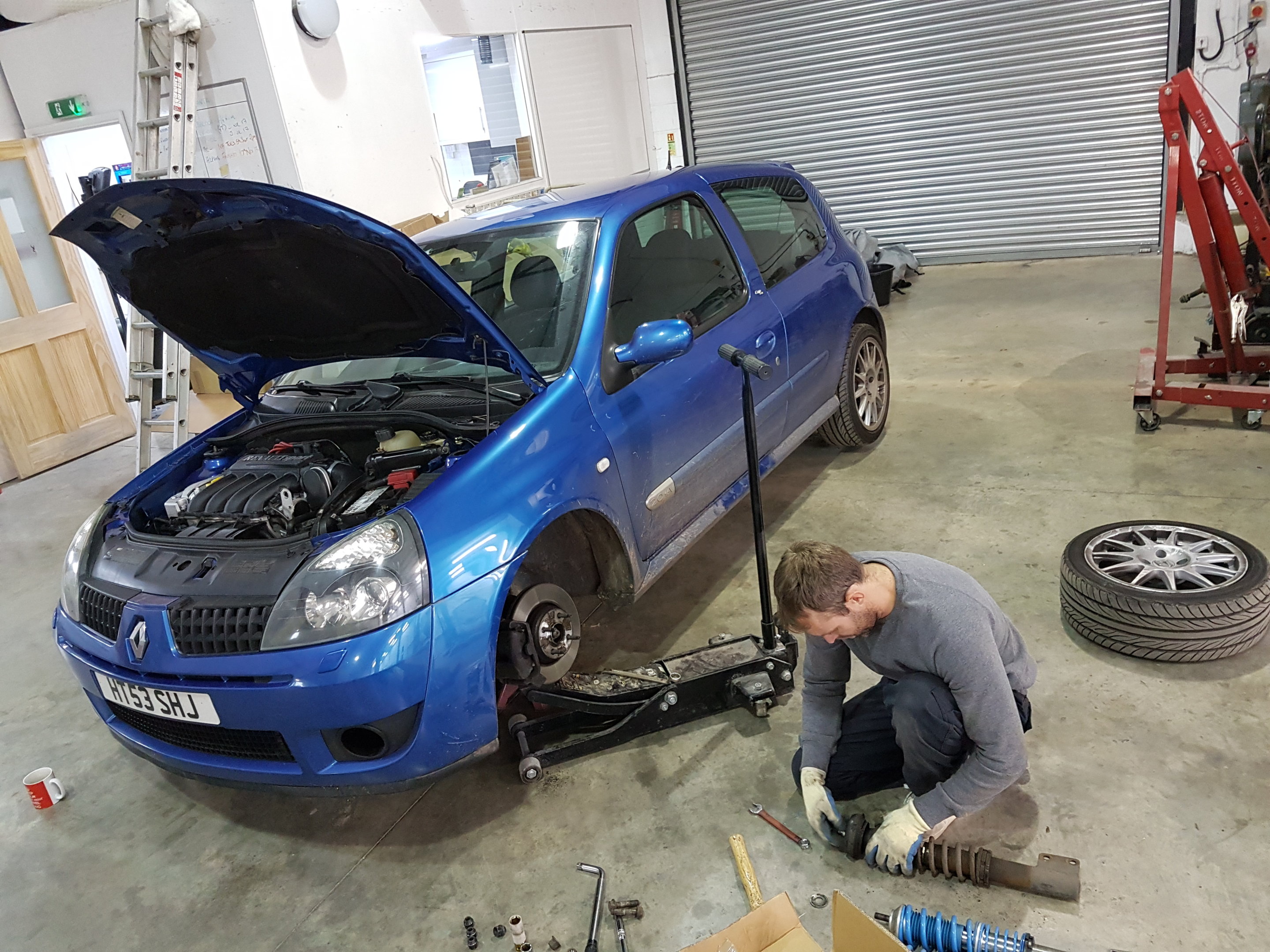

So then on saturday i planned to go to work and give the car a good checking over to sus out the noises. @MrBlonde wanted to fit he's newly acquired Bilstein coilovers too so we had a tinker day.

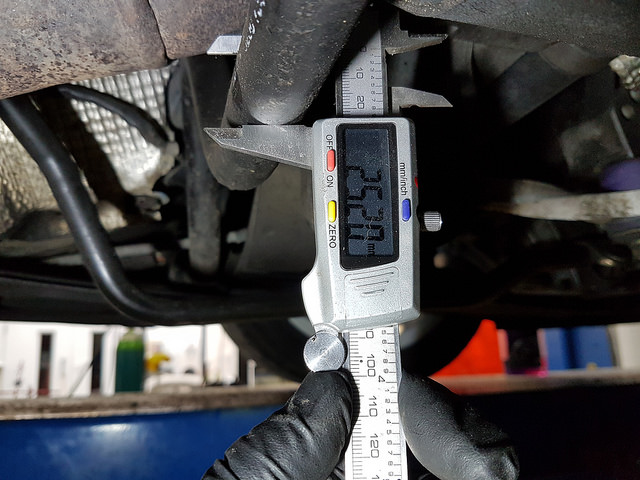

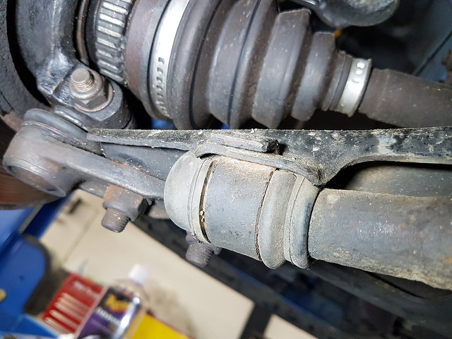

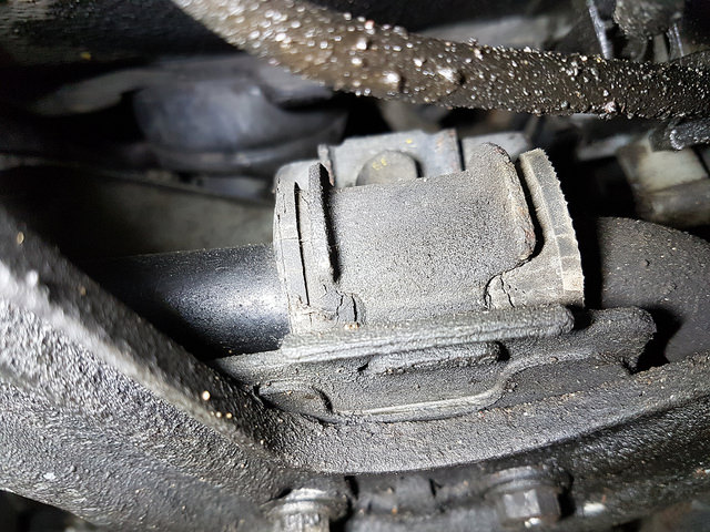

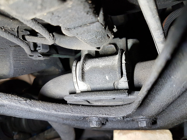

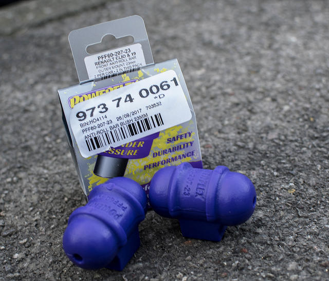

First up was to check the ARB bushes as i noticed one was perished a while back.

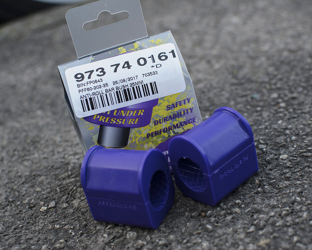

After a measure and some homework, i decided to polybush them as its not a lot of money. I have ordered some road/purple series powerflex ARB bushes, both inner and outer sets from Euro Car Parts as it was the same price and local to me. Pick them up tomorrow - 25mm inner, 23mm outer.

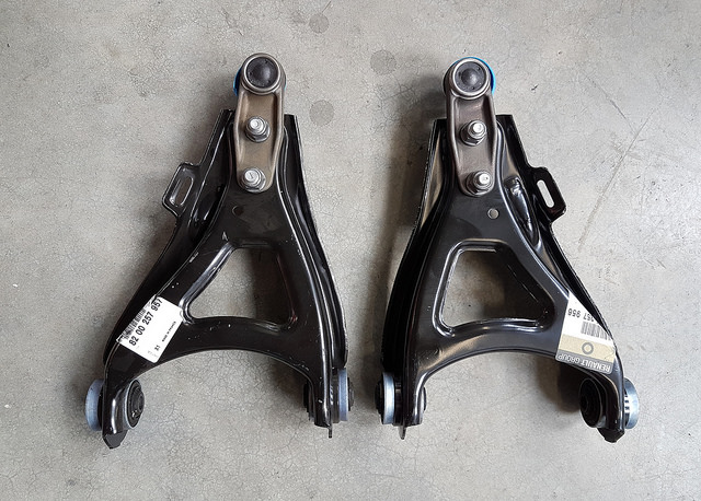

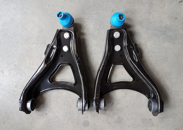

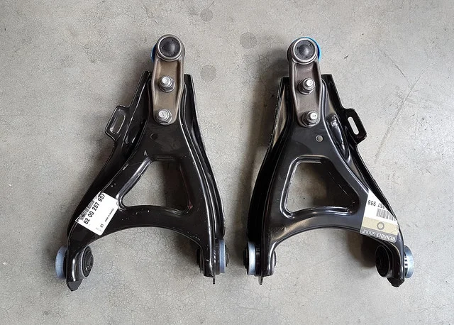

Ive also ordered some genuine lower arms. Since doing my driveshaft/gearbox oil swapped my tracking is out of bonk again. This is odd as all i did was jack it up. Ive changed every other suspension part up front barring these so i bit the bullet and ordered a set from Renault Wolverhampton. Should be here tomorrow as well.

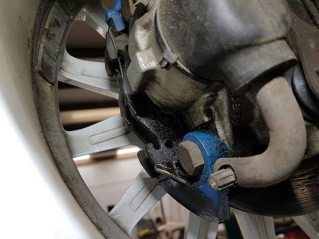

Next up was to check the brakes as i get a grinding noise under braking. Pads were fine, but then i see this on the rear near side:

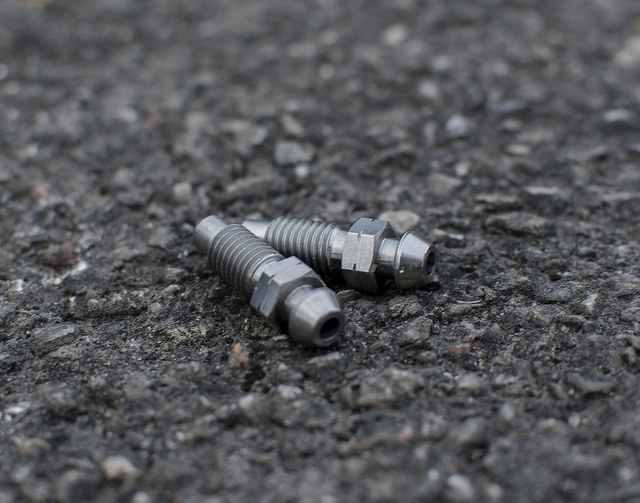

Yep, leaking caliper 😧 (Ignore the split pin, i somehow lost the original clip) So after a wanted post on here and the Facebook page, i found a member who is sending me a full set of good working rears, with all clips for a good price. The reason for this option was i've never known the rears to fail so im sure its rare and the cost of new ones would be racked up quickly. Now i know i'll need to bleed the system again, but earlier in the year my nipple had snapped on the NSF caliper on a earlier bleed. I contemplated buying a rebuild kit but then found this company that do refurb ones for not a lot.
https://brakeparts.co.uk/shop/Renault/Clio/06-12/Clio 2.0 16V Petrol/

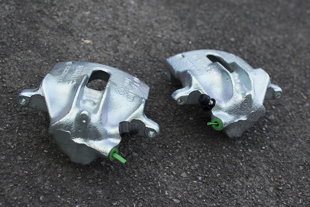

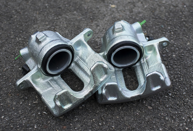

So i phoned up today and ordered a set of fronts. I also ordered new stainless steel bleed nipples too. They will be here tomorrow also. I will give them all a lick of paint before i fit them all. Will keep it blue i think, Although i am contemplating silver.....

A final pic of the RB leaving work today because the sunset looked good :cool:

MrBlonde
Good to see you got a set of calipers so quick mate & i will have to try and find a pair of Cup wishbones to fit,either new or maybe just fit poly ones to mine & new ball joints.
I managed to get one pic from Saturday.

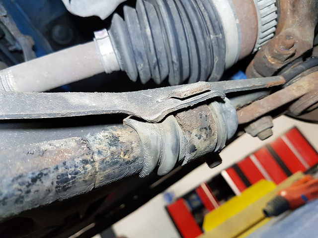

Great update as usual. Have you changed your ARB yet? Its not a fun job!
Cheers Tom.
I haven't yet? I presume it's a ballache? From reading, it's easier to drop the subframe which @Scrooge clairfied the other day. I'm hoping to do it on the ramp but unsure if it'll be free.
Yeah @Scrooge has been working his magic on mine to replace the front ARB bushes and its been a hard work! Though no fault of his own, we got a new clutch and the release bearing was broken, the steering column wasn't originally connected correctly and a million then the power steering pipe was f*cked! Apart from that it went well, however I think @Scrooge now hates me!
Scrooge
  E55 AMG
Not your fault at all mate, rusty subframe bolts, fucked rusty pipes and rubbish suppliers were the issue. Though looking forward to getting it back to you this week

Parts arrived today.
ARB bushes:
Budweg refurbished calipers:
New stainless steel nipples:
New genuine lower arms:
Im going to order another set of stainless steel nipples for the rear calipers that are coming. Also, i've decided to keep the colour of the calipers blue, so i will paint the new ones tomorrow and the second hand ones silver with the carriers blue when they arrive.
